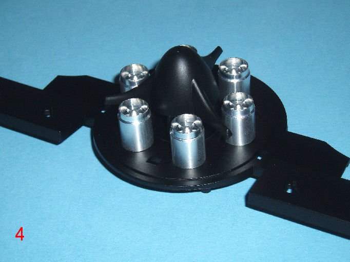

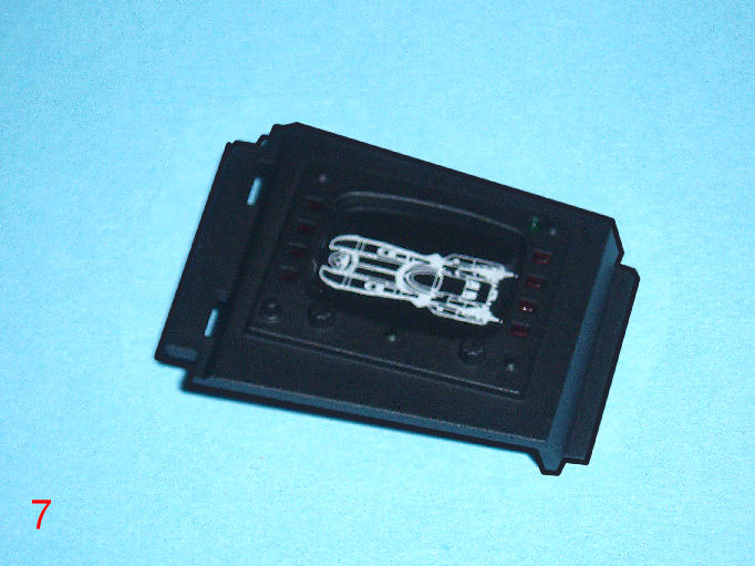

STAGE 3:
Reactor exhaust.
Pic 1: Press-fit the 6 x reactor tube shafts 3-9 into the base plate 3-1 as shown.

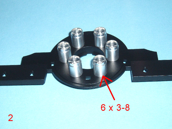

Pic 2: Press-fit the 6 x reactor tubes 3-8 in place over the shafts.

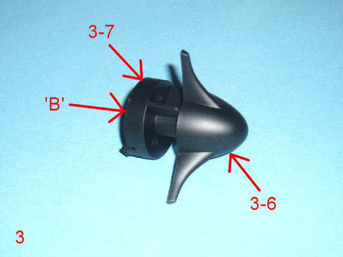

Pic 3: Fit the vent centre and base 3-6 and 3-7 together and fix from inside with 1 x ‘B’ screw.
Pic 4: Press-fit the assembly in place on the base.
It will only fit one way.
Pic 5: Press-fit the reactor vent 3-5 onto the base plate.

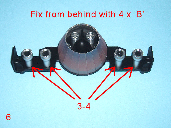

Pic 6: Fit the 4 x exhaust pipes 3-4 onto the base plate as shown and fix from behind with 1 x ‘B’ screw in each.

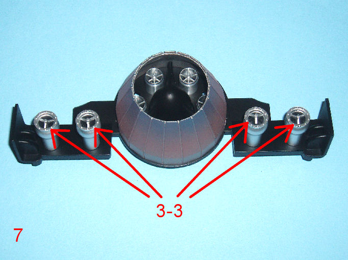

Pic 7: Press-fit the 4 x exhaust shafts 3-3 into the tubes as shown.
Make sure they are all aligned as shown.

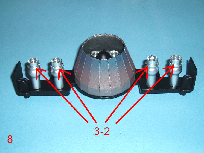

Pic 8: Fit the 4 x exhaust collars 3-2 in place as shown.
They will only fit one way.

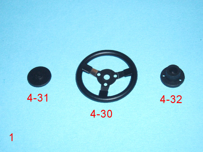

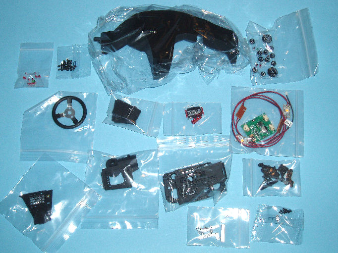

STAGE 4A:
Dashboard.

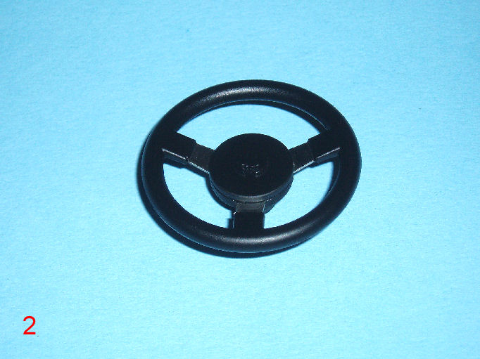

Pic 1: Locate the steering wheel parts 4-30, 4-31 and 4-32.
4-31 will fit on the front of 4-30 and 4-32 goes on the rear.

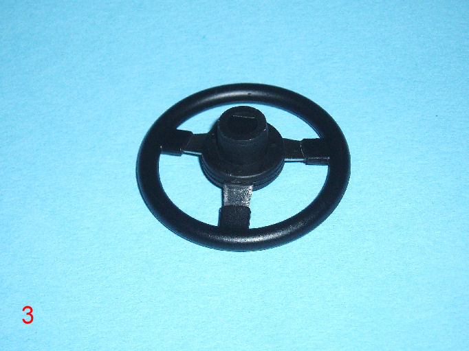

Pic 2: Parts assembled.

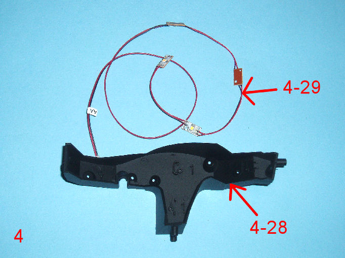

Pic 3: From behind.
Pic 4: Locate the dashboard 4-28 and the LED strips 4-29.

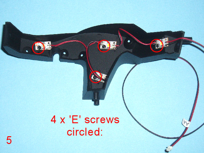

Pic 5: Fit the LED’S in the order shown with the plug wire on the right.
Fix with 1 x ‘E’ screw in each LED.

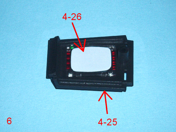

Pic 6: Fit the screen 4-26 inside the panel 4-25.
Pic 7: View from the front.

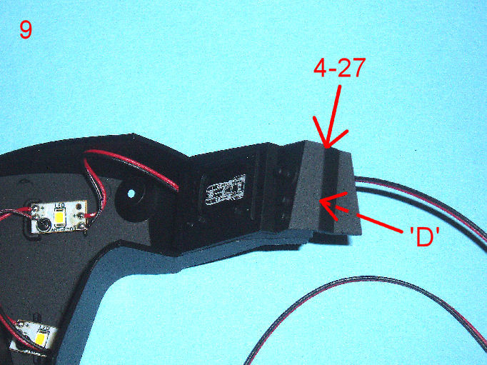

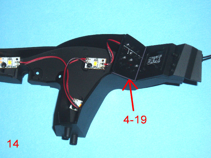

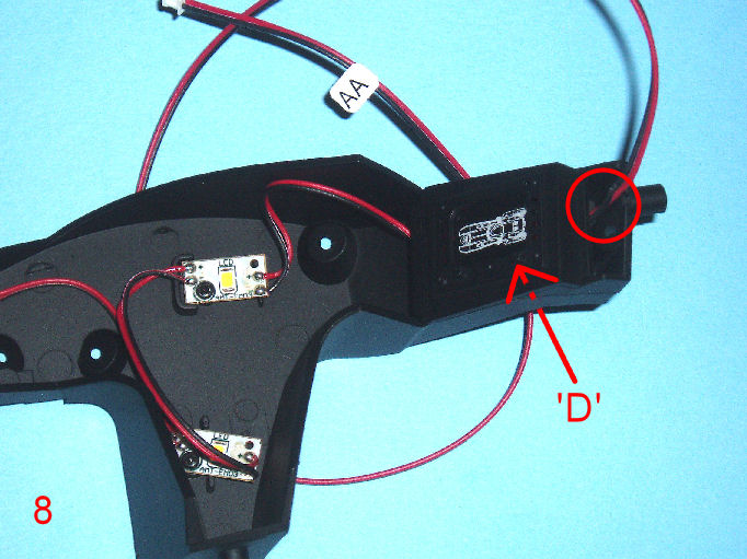

STAGE 4B:
Pic 8: Fit the assembly on the right of the dashboard and fix from behind with 1 x ‘D’ screw.
Note that the LED wire locates in the small groove on the end of the dashboard.
Pic 9: Fit the end panel 4-27 in place and fix from behind with 1 x ‘D’ screw.

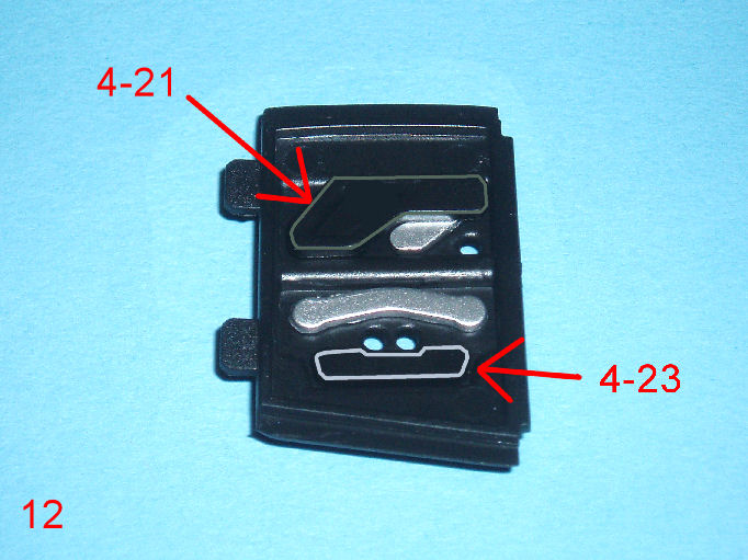

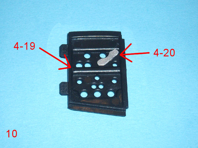

Pic 10: Fit the switches 4-20 inside the panel 4-19 as shown.

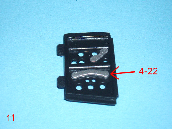

Pic 11: Fit the switches 4-22 in place.
Pic 12: Fit the switches 4-21 and 4-23 in place. They have been outlined for clarity.

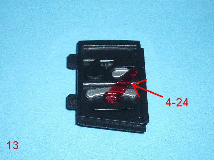

Pic 13: Fit the red light strip 4-24 in place as shown
Pic 14: Push-fit the assembly onto the dashboard as shown.

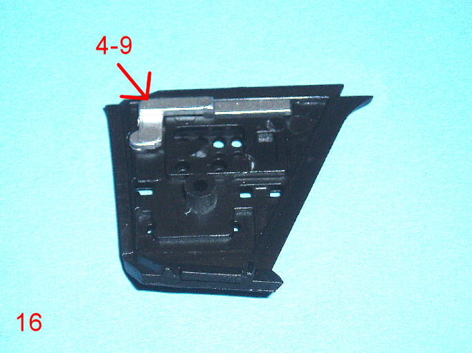

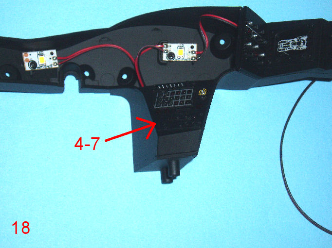

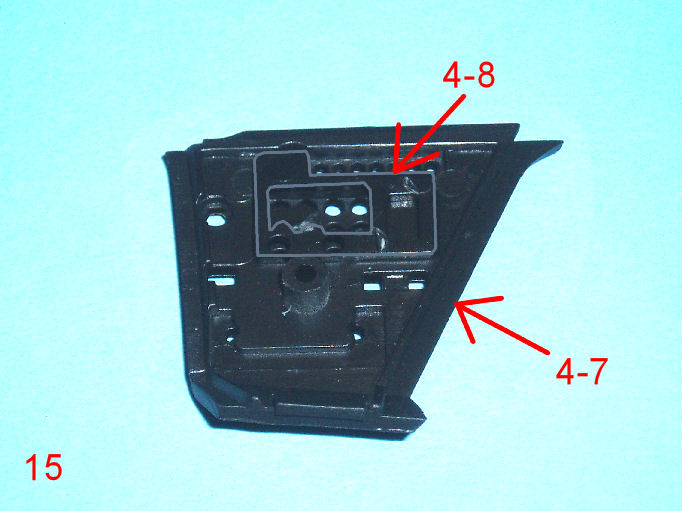

Pic 15: Fit the switches 4-8 in place on panel 4-7. They have been outlined for clarity.
Pic 16: Fit the switch strip 4-9 in place.

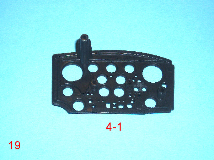

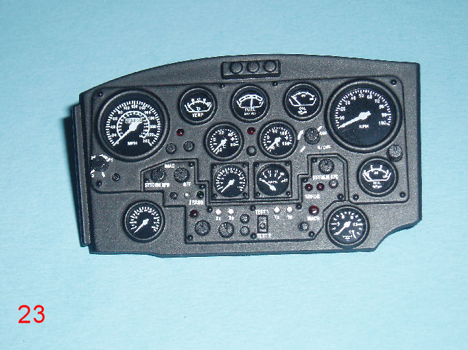

STAGE 4C:

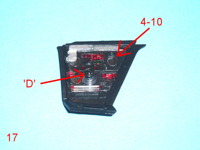

Pic 17: Fit the clear panel 4-10 and fix with 1 x ‘D’ screw.
Pic 18: Fit the assembly into the lower part of the dashboard.

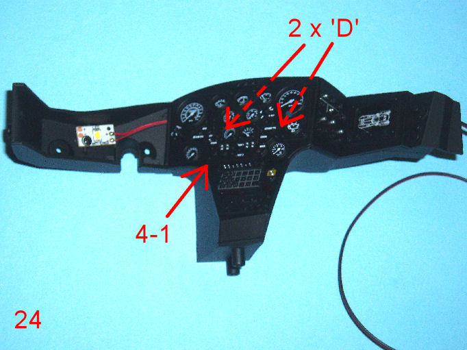

Pic 19: Locate the main panel 4-1.

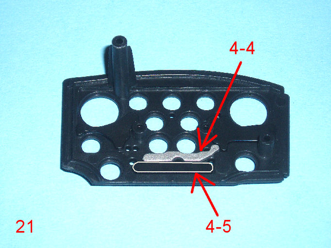

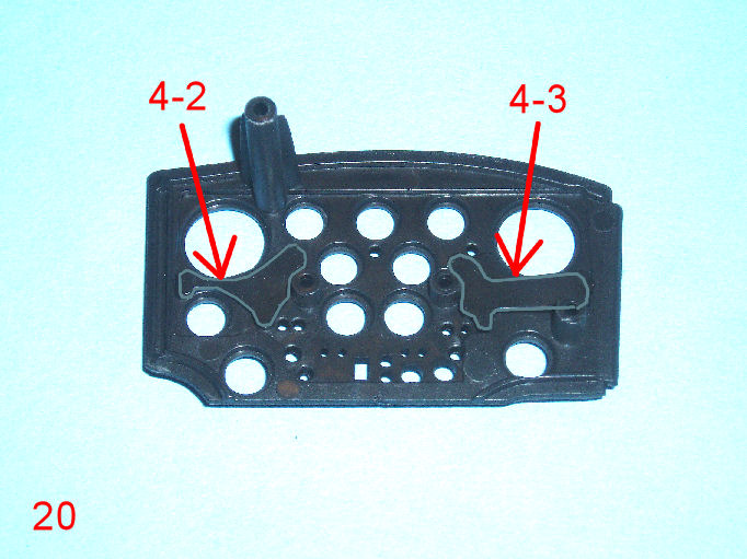

Pic 20: Fit the switches 4-2 and 4-3 in place. They have been outlined for clarity.
Pic 21: Fit the switches 4-4 and 4-5 in place. They have been outlined for clarity.
Pic 22: Fit the clear dial panel 4-6 in place and fix with 1 x ‘D’ screw.
Pic 23: Completed panel.
Pic 24: Fix the panel to the dashboard with 2 x ‘D’ screws from behind.

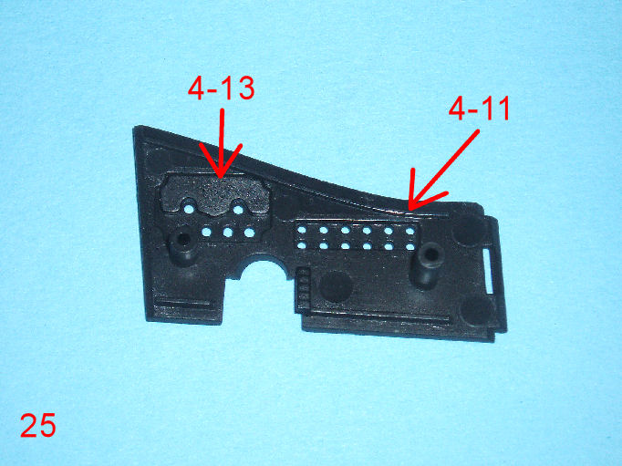

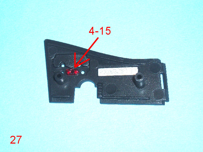

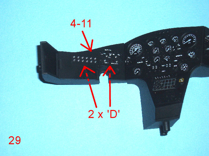

STAGE 4D:

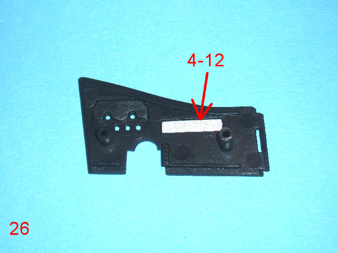

Pic 26: Fit the switch strip 4-12 in place.
Pic 27: Fit the red lights 4-15 in place.

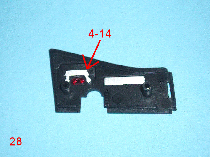

Pic 28: Fit the switch strip 4-14 in place.
Pic 29: Fix the panel to the dashboard with 2 x ‘D’ screws from behind.

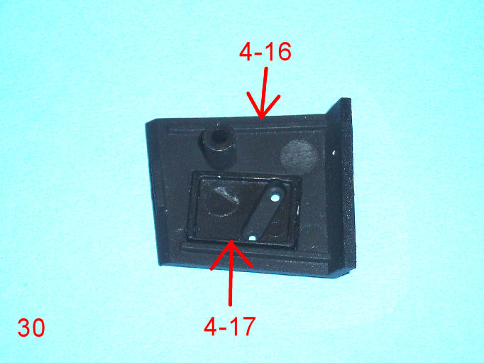

Pic 30: Fit the switches 4-17 into the panel 4-16.

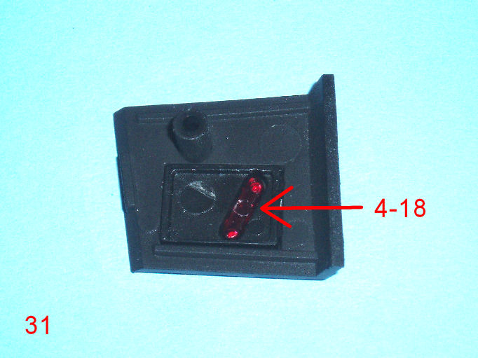

Pic 31: Fit the red lights 4-18 in place.
Pic 32: Fix the panel to the dashboard with 1 x ‘D’ screw from behind.

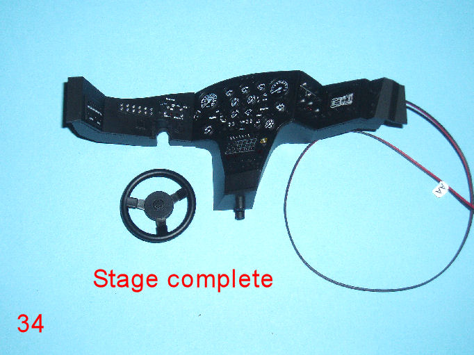

Pic 34: Store the parts safely for now

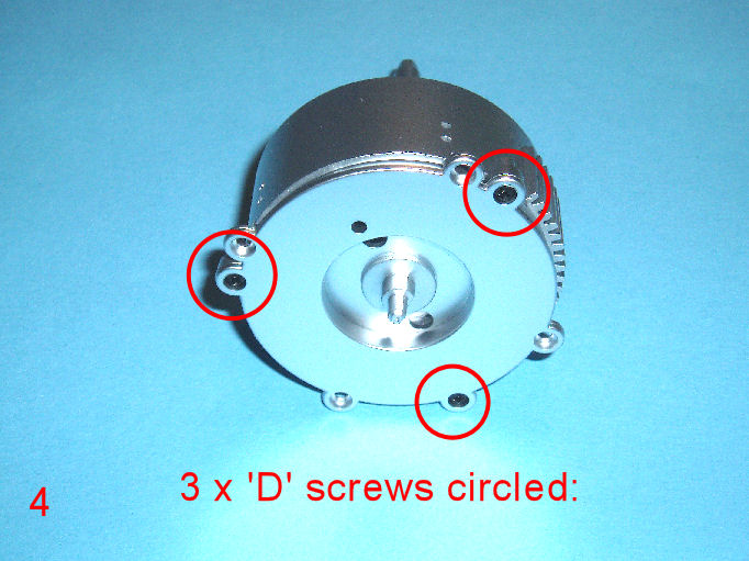

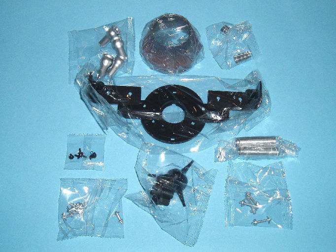

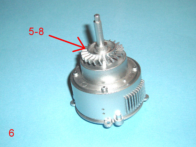

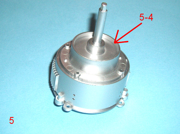

STAGE 5:
Turbine engine.

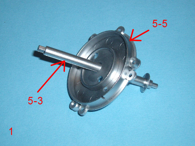

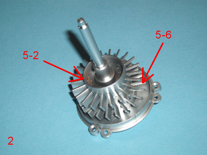

Pic 1: Pass the shaft 5-3 through the backplate 5-5 as shown.
Pic 2: Fit the blades 5-2 and 5-6 over the shaft.
Both sets of blades are the same.

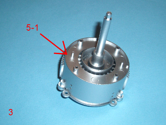

Pic 3: Fit the cover 5-1 to the assembly.
This will completely hide the blades – but you know they are there!
Pic 4: Fix the parts together with 3 x ‘D’ screws from the other side.
Pic 5: Fit the front cover 5-4 in place.
Pic 6: Push-fit the fan 5-8 into place on the shaft.
Pic 7: Fit the 2 x turbine pipes 5-7 into the locating holes in the casing as shown.
