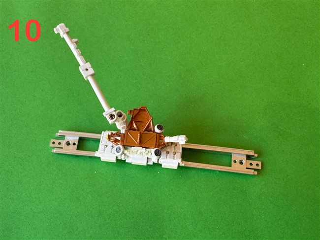

#1 Posted : 25 November 2025 10:34:42
Issue 87

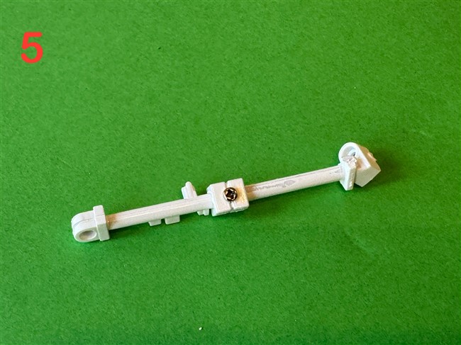

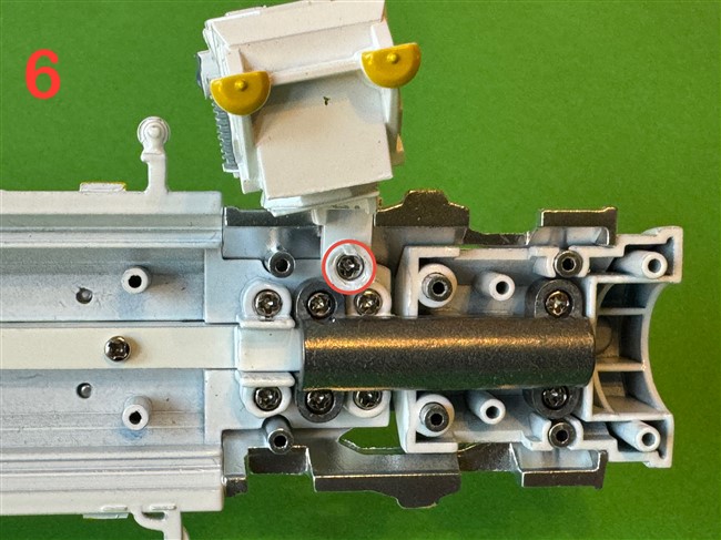

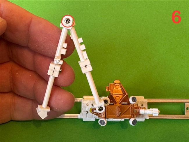

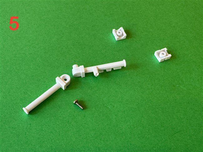

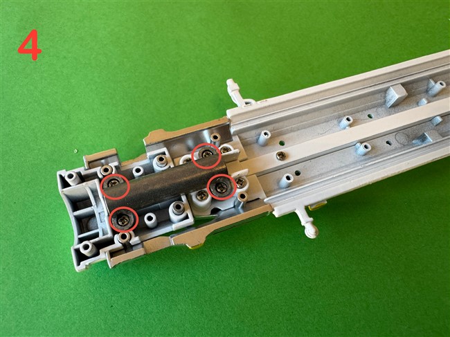

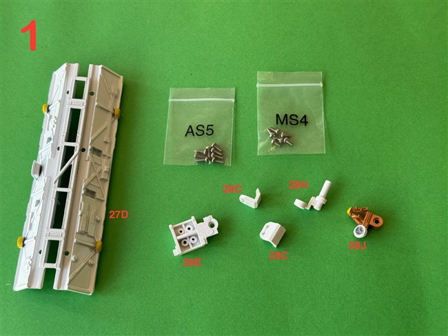

Fix piece 27D to the previous assembly using 4 x MS4 screws, pictures 2 and 3.
Fix both the 28C pieces to 28E using the AS5 screws as you did in the previous stage, pictures 4 and 5.
Take the assembly and attach it to the assembly from issue 85 using an AS5 screws, pictures 6 and 7.

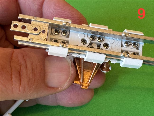

Push fit piece 28H into place as shown in picture 8, followed by piece 28J securing them both in place using an AS5 screw, picture 9.
Picture 10 shows the final assembly for this issue.

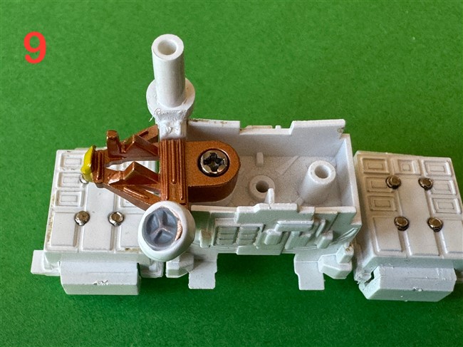

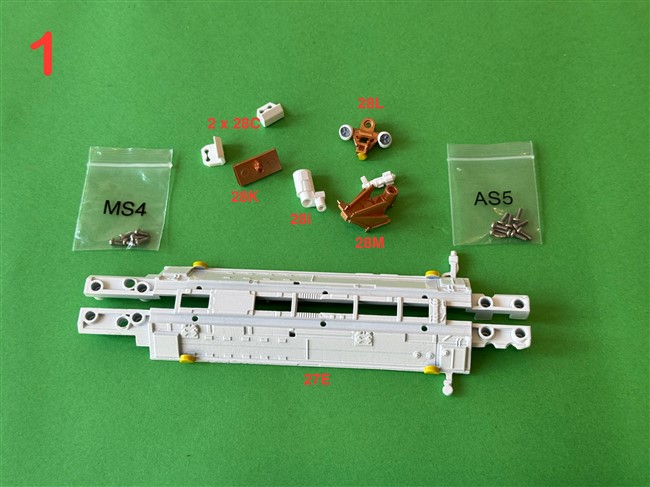

#2 Posted : 25 November 2025 10:38:18
Issue 88

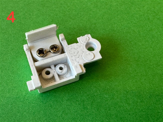

Fix piece 27E to the assembly of the previous stage using 4 x MS4 screws, picture 2 and 3.

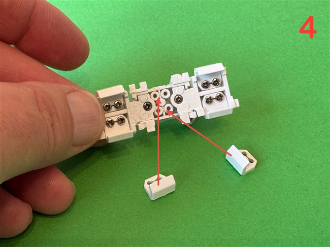

Attach both 28C parts as illustrated in picture 4, securing them in place using 4 x AS5 screws, picture 5.
Attach piece 28M using an AS5 screw, picture 6, then attach piece 28L next to it using another AS5 screw, picture 7.
Fix piece 28i in place securing it with an AS5 screw, picture 8.

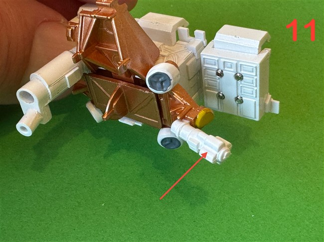

Push fit part 28K as shown in pictures 9 and 10, followed by part 28P, picture 11.
Picture 12 shows the final assembly for this issue.

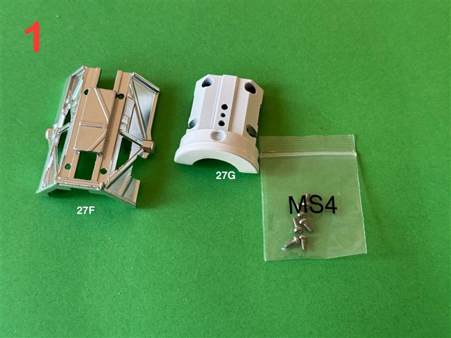

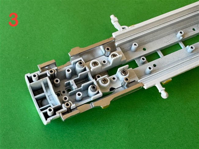

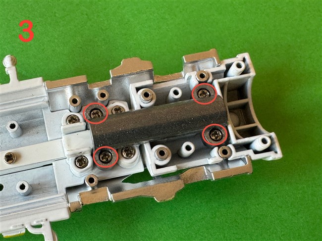

#3 Posted : 26 November 2025 19:44:56
Issue 89

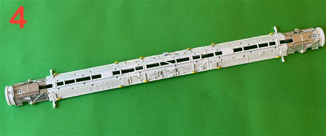

Fix piece 27F to the assembly from the previous issue using 4 x MS4 screws, picture 2.
Insert part 27G into the assembly as shown in picture 3.
Picture 4 shows the final assembly for this issue.

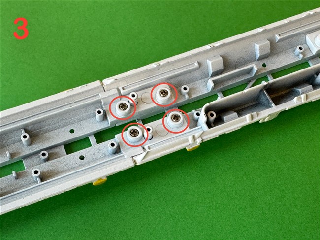

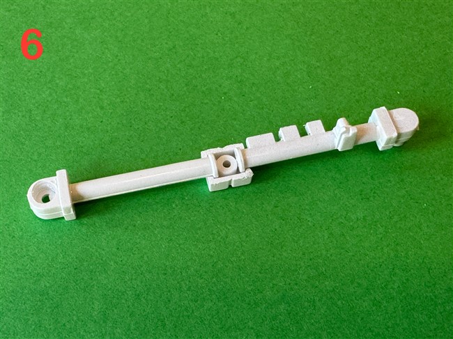

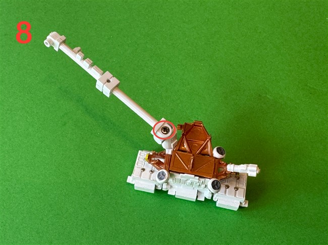

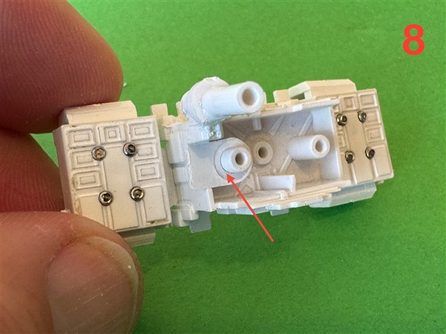

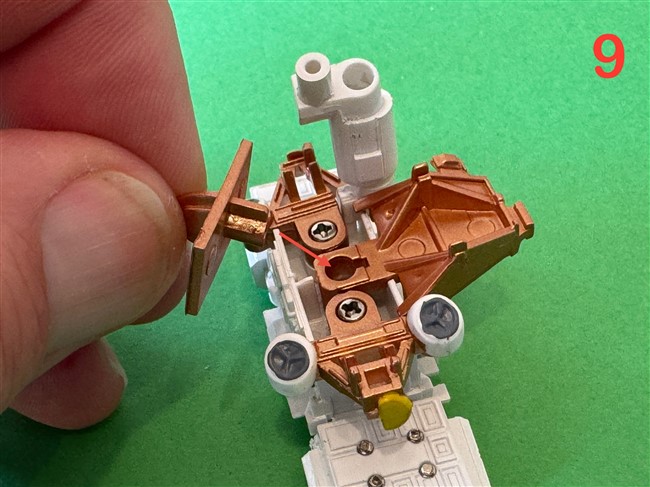

#4 Posted : 26 November 2025 19:46:56
Issue 90

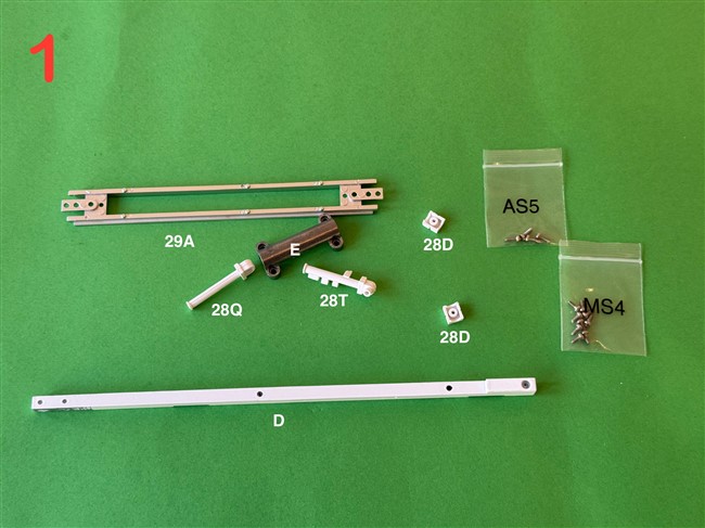

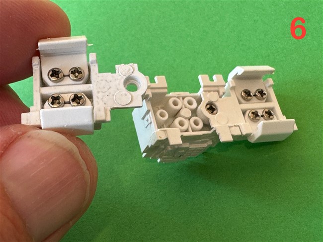

Fix piece D to the previous assembly using 2 x MS4 screws, pictures 2 and 3. Now fit part E using 4 x MS4 screws as shown in picture 4.
Take the parts 28D, 28Q and 28T, picture 5 and assembly the parts as shown in picture 6. Place the other part 28D over the assembly and secure it using an AS5 screw, picture 7.
Retrieve the assembly from issue 88 and attach the part as shown in picture 8 using an AS5 screw.
Fit piece 29A, by sliding it in place, picture 9.

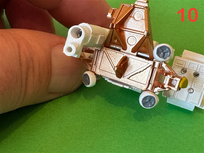

Pictures 10and 11 show the final assembly for this issue.

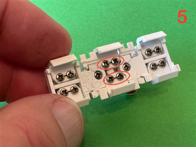

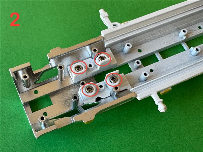

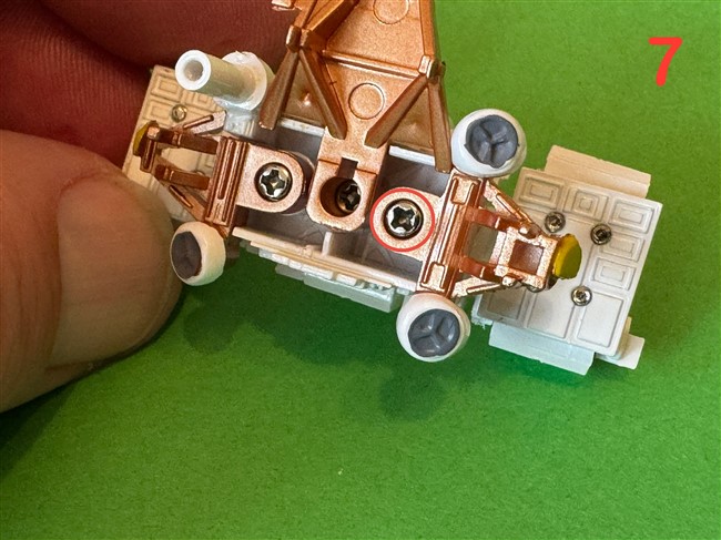

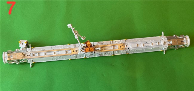

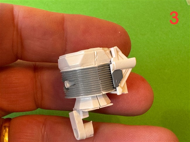

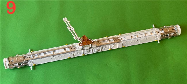

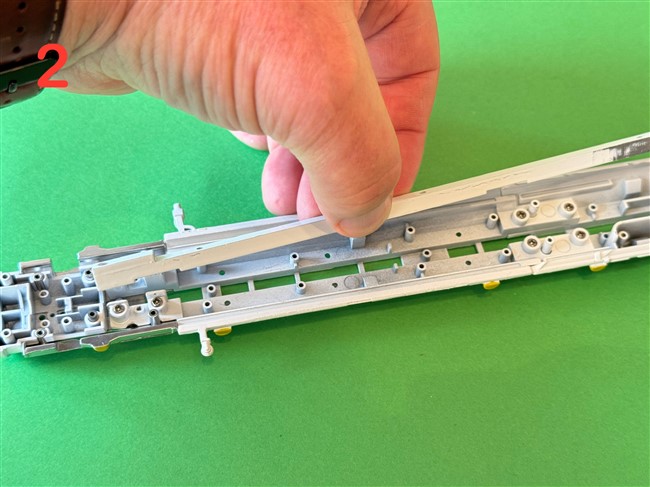

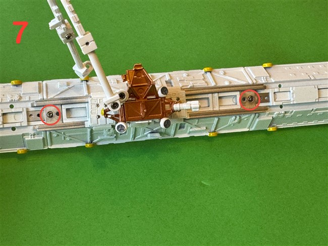

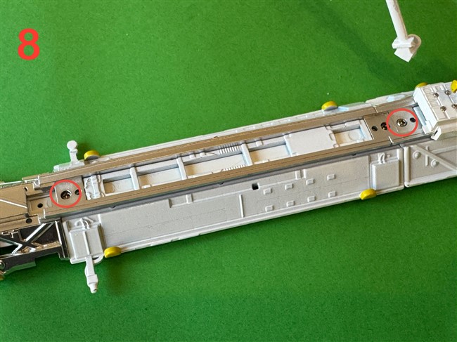

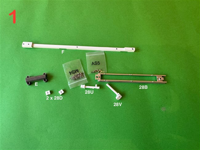

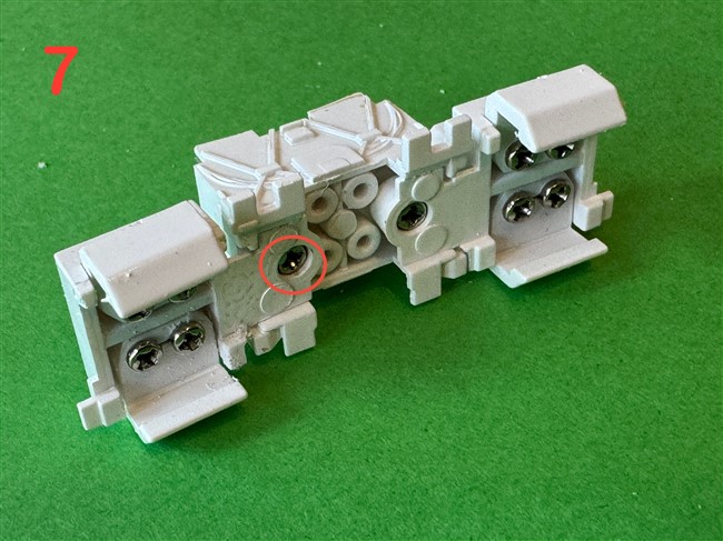

#5 Posted : 27 November 2025 19:27:07

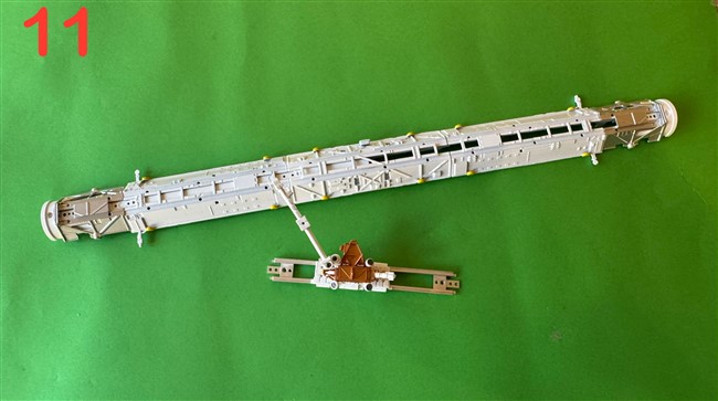

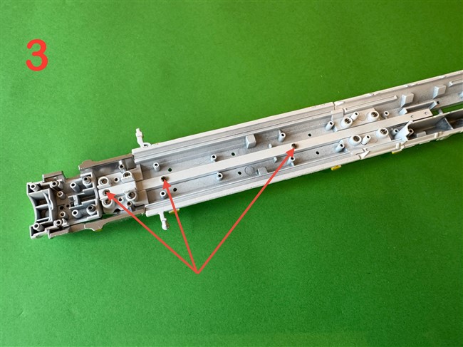

Issue 91

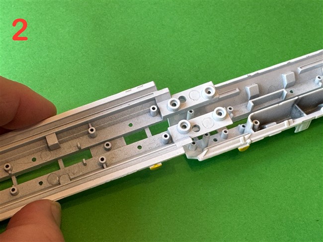

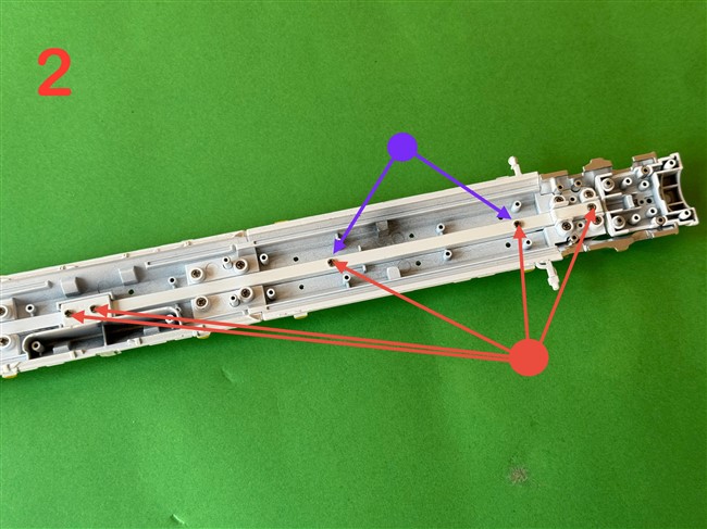

Fix piece F to the assembly put together in the previous stage and attach it using 5xMS4 screws as shown with the red arrows.
Note: The two middle screws were not quite long enough to secure the frame, so I used 2 x AS5 screws instead, picture 2, (purple arrows).
As before, fit piece E using 4 x MS4 screws as shown in picture 3.

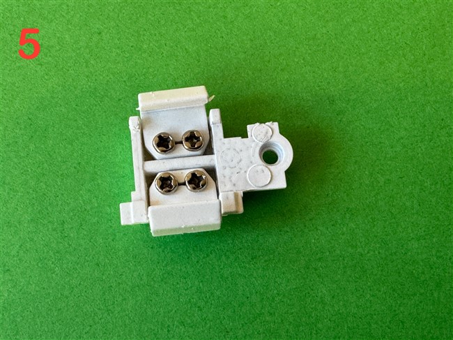

Attach the parts 28U, 28V and 28D as illustrated in picture 4. Attach another part 28D and secure the assembly using an AS5 screw, picture 5.

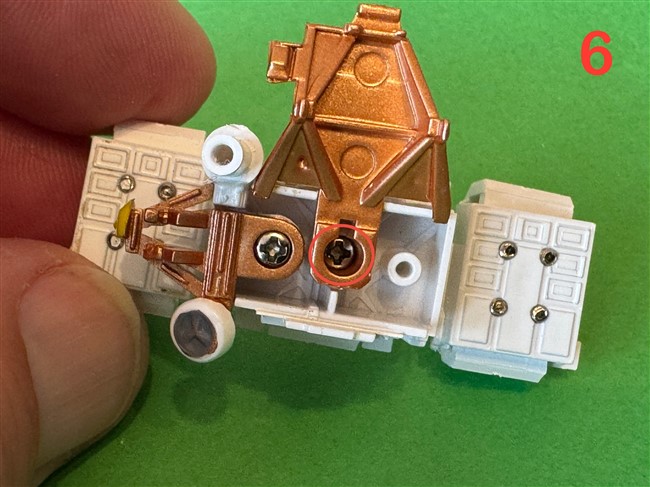

Fit the assembly to the previous assembly from the last issue using an AS5 screw, picture 6.
Fix the assembly onto the main frame assembly using 2 x MS4 screws as shown in picture 7.
Finally fit part 29B to the assembly as illustrated in picture 8, using 2 x MS4 screws.
Pictures 9 shows the final assembly for this issue.

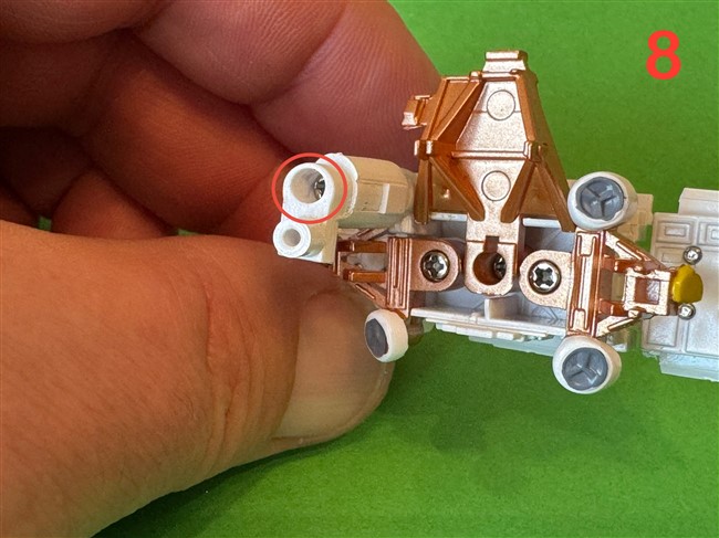

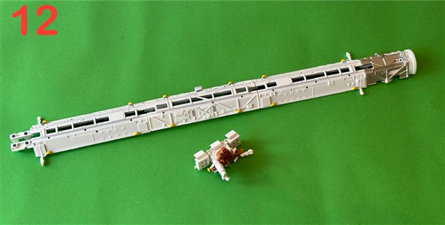

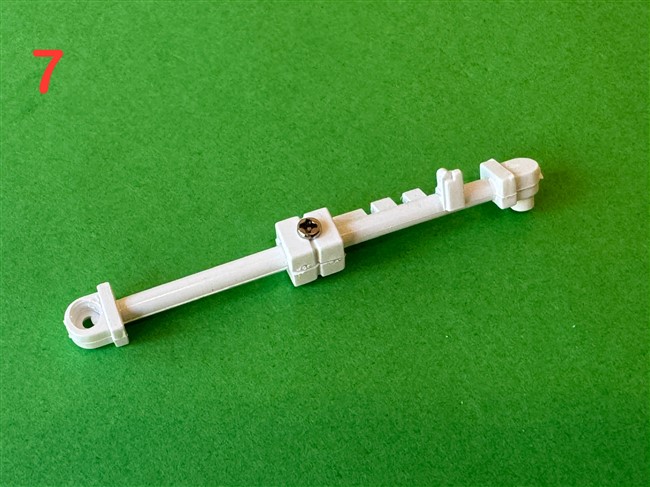

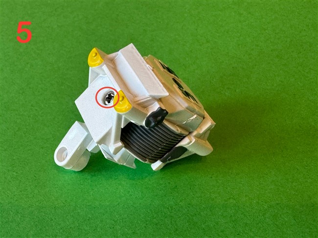

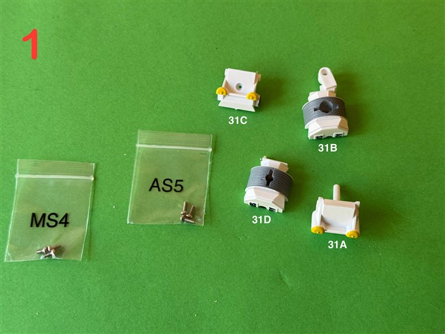

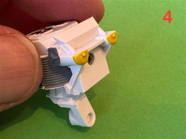

#6 Posted : 27 November 2025 19:29:25
Issue 92

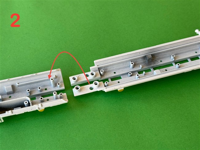

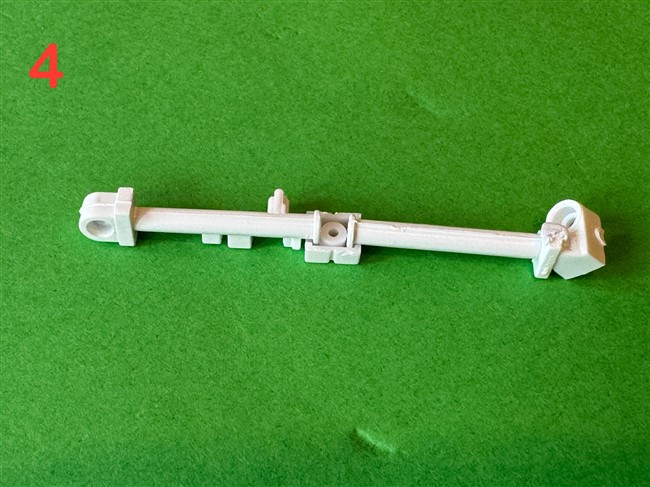

Place part 31A into part 31D, picture 2, then place part 31B on the assembly, picture 3.
Fix piece 31C onto the assembly and secure it in place using an AS5 screw, pictures 4 and 5.
Note: After fixing the screw, the assembly was still a little loose, so I applied a little glue to hold it together. Only do this if you have the same issue.
Attach this assembly to the main frame assembly as shown in picture 6.
Pictures 7 shows the final assembly for this issue.
