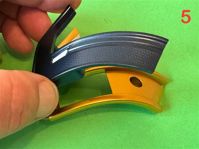

Position the upper blue left plate as shown in picture 2. Turn the assembly over and secure it in place using 2 x type E screws, picture 3.

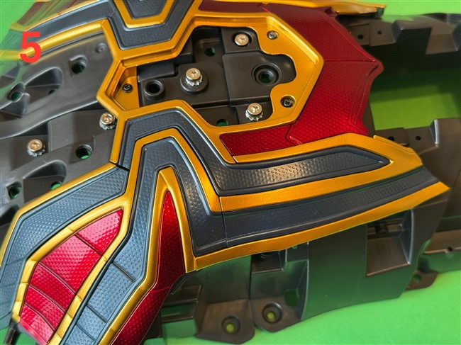

Position the lower left blue plate and push fit the three posts into the corresponding holes in the frame, picture 4. Picture 5 shows it in place.

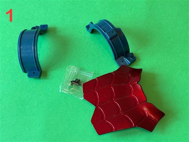

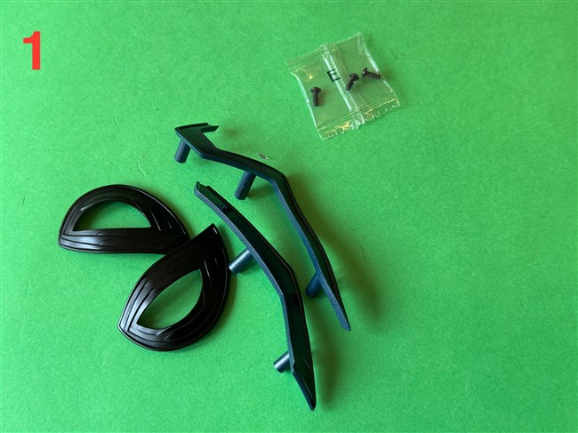

Issue 34
The Chest Symbol
There are also a third set of eyes with this pack. Again, remove the existing ones and replace with these if needed, picture 2.

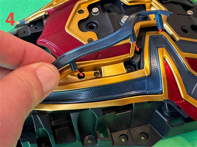

Push fit the right blue plate as shown in picture 3, then do the same with the left blue plate, picture 4.
Picture 5 shows the completed assembly for this issue.

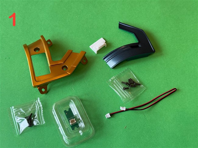

Issue 35

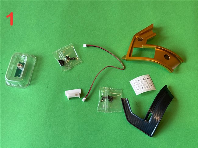

The Abdomen Sides
Place the inner LED housing inside the left abdomen blue plate, pictures 2 and 3. Fit the LED circuit board over the inner LED housing and secure using 2 x type G screws, picture 4.
Fit the assembly into the left side gold plate, picture 5. Turn the assembly over and secure it in place with 2 x type E screws, picture 6.

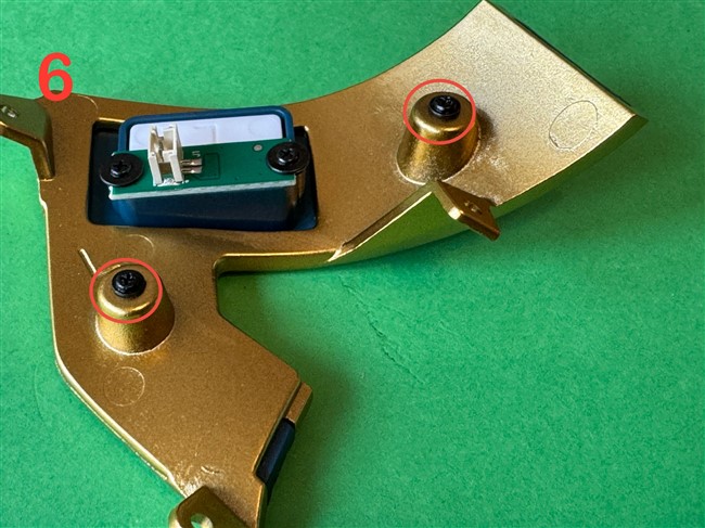

Place the assembly into position on the left side of the frame, picture 7 and sure it in place using 3 x type E screws, picture 8.

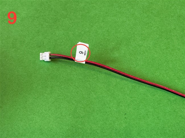

Take the LED cable that came with this issue and place the label marked 9 as shown in picture 9.
Note: I underlined the number nine as shown, so not to mix it up with cable number 6.
Push fit the cable into the LED circuit board, picture 10.

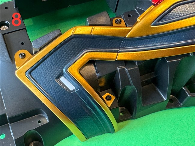

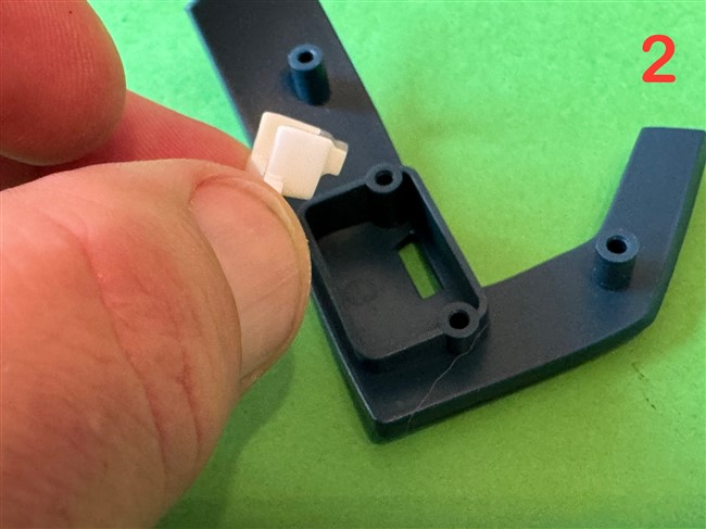

#4 Posted : 22 November 2025 18:26:02
Posts: 6,966
Points: 21,205
Issue 36
The Abdomen Sides

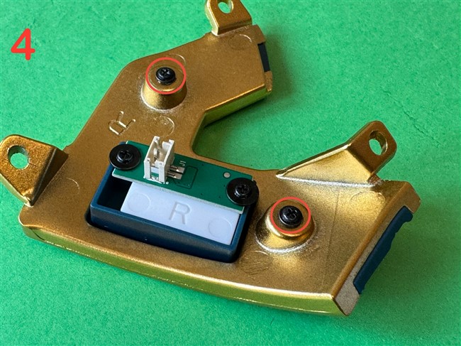

Place the inner LED housing inside the right abdomen blue plate, picture 2. Fit the LED circuit board over the inner LED housing and secure using 2 x type G screws, picture 3.
Fit the assembly into the right-side gold plate, then turn the assembly over and secure it in place with 2 x type E screws, picture 4.
Place the assembly into position on the left side of the frame and sure it in place using 3 x type E screws, picture 5.
Take the LED cable that came with this issue and place the label marked 10 as shown in picture 6.
Push fit the cable into the LED circuit board, picture 7.

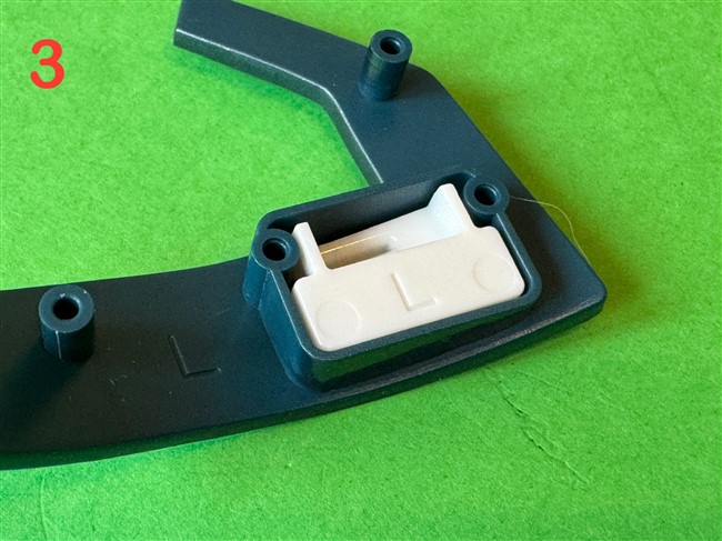

#5 Posted : 23 November 2025 18:02:53
Posts: 6,966
Points: 21,205
Issue 37
The Central Abdomen Plate

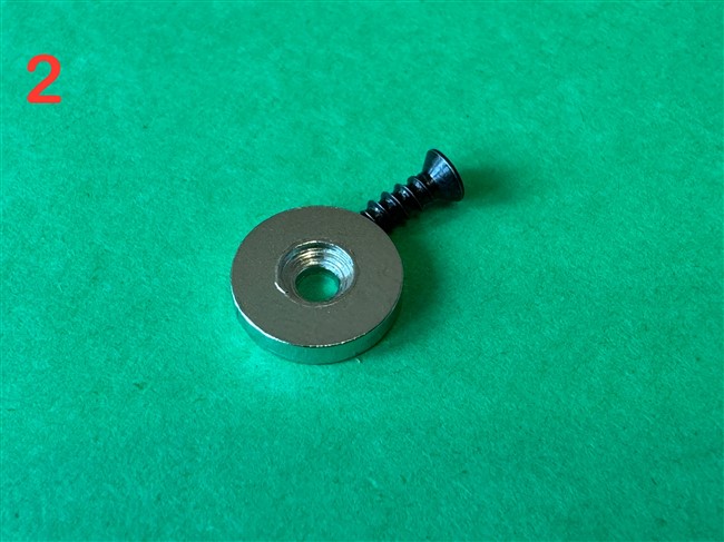

Lay the torso on the table. Insert a KB screw into the washers, picture 2. Attach all four washers to the torso as shown in picture 3.
Separate the magnets and insert a KB screw in each of them. Attach all four magnets to the abdominal plate as shown in picture 4.
Carefully fit the plate to its final position on the torso, picture 5.
