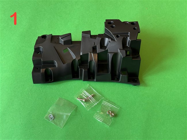

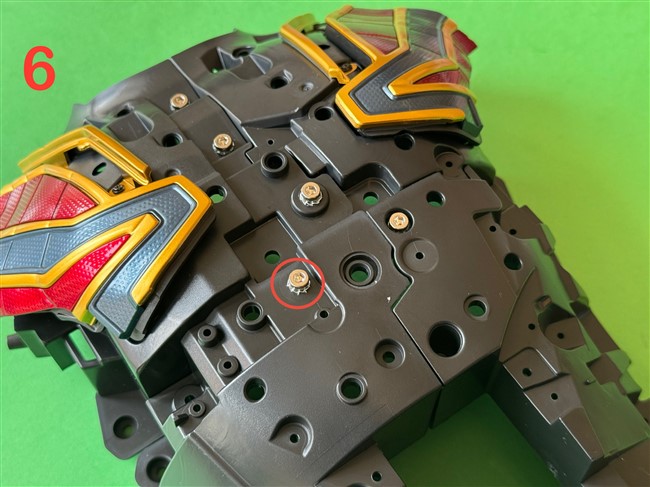

Issue 27

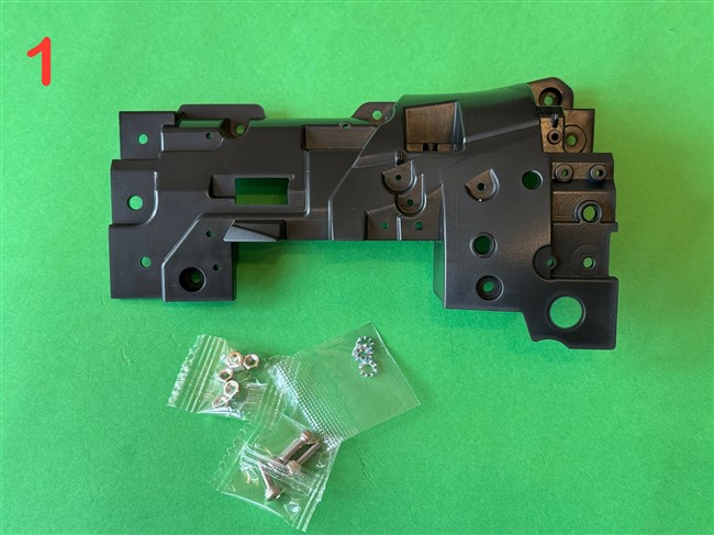

The Abdominal Structure

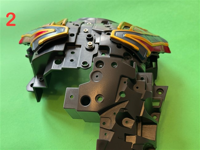

Retrieve the chest assembly from the previous issue, Arrange the left abdominal structure as shown in pictures 2 and 3.

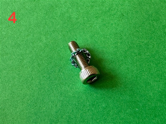

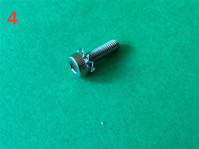

Prepare two type H bolts by placing a serrated washer on them, picture 4.

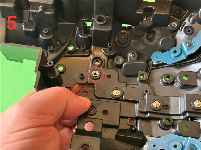

Turn the assembly over and place a M3 nut into the recess as shown in picture 5. Holding it into position, turn the assembly back over and insert the bolt into the nut, tightening it using the allen key supplied with this kit, picture 6. Place the other bolt and nut as shown in picture 7.

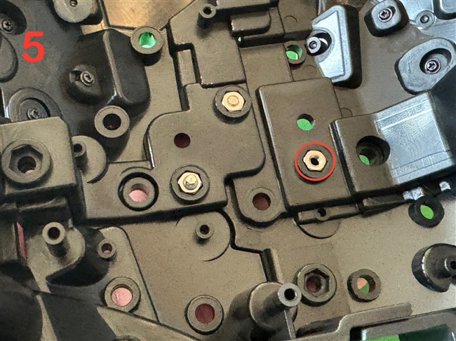

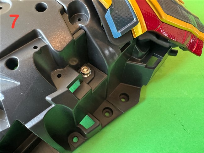

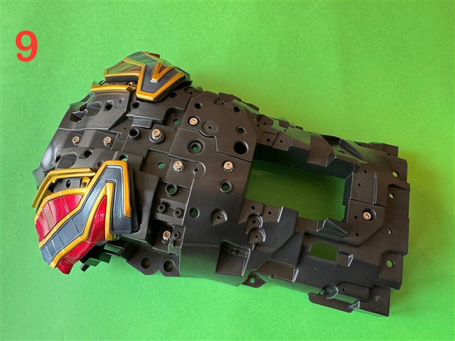

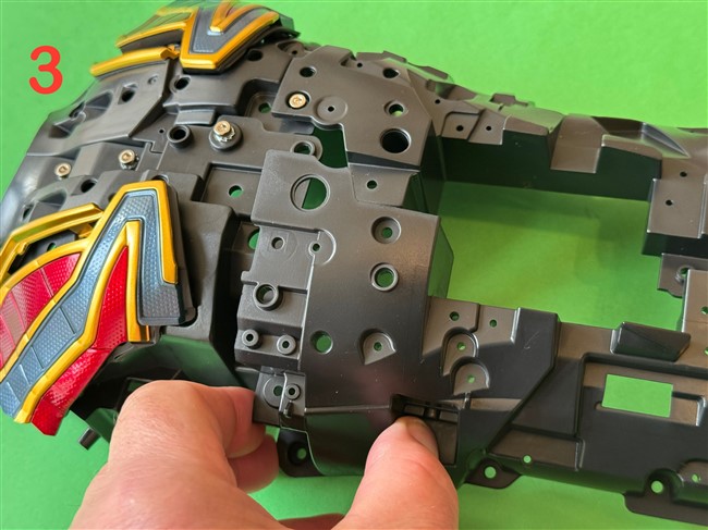

#2 Posted : 18 November 2025 10:33:10
Posts: 6,966
Points: 21,205

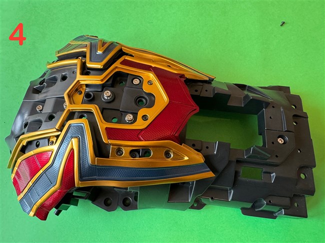

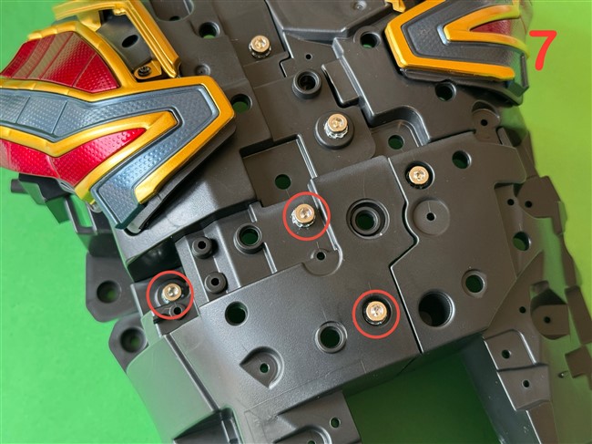

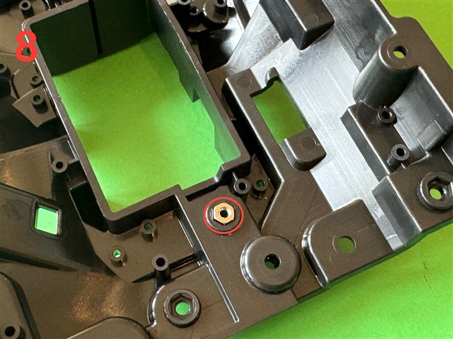

Issue 28

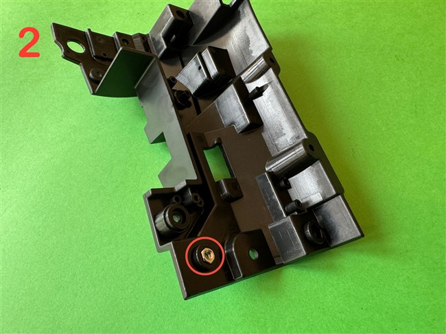

Before assembling the right abdominal structure, place an M3 nut into the recess at the back of the part, as shown in picture 2. DO NOT proceed with the assembly without placing this nut first.
Retrieve the chest assembly from the previous issue, Arrange the right abdominal structure as shown in picture 3.
Prepare the type H bolts by placing a serrated washer on them, picture 4.
Turn the assembly over and place a M3 nut into the recess as shown in picture 5. Holding it into position, turn the assembly back over and insert the bolt into the nut, tightening it using the allen key supplied with this kit, picture 6. Place the other bolts and nut as shown in picture 7.
Finally, place the last H bolt and nut as shown in picture 8.
Picture 9 shows the completed assembly for this issue.

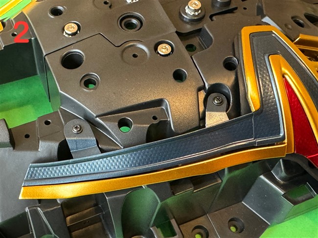

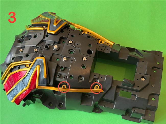

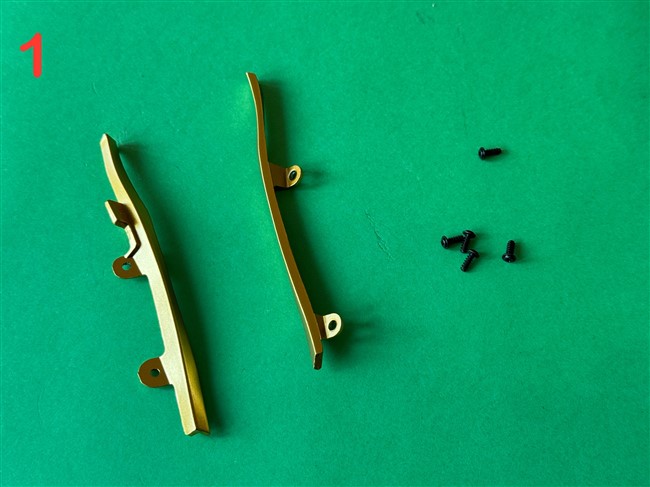

Issue 29
The Abdominal Details
Position the left abdominal detail and secure in place using 2 x Type E screws, picture 2.
Do the same on the right-hand side using the right abdominal detail, picture 3.

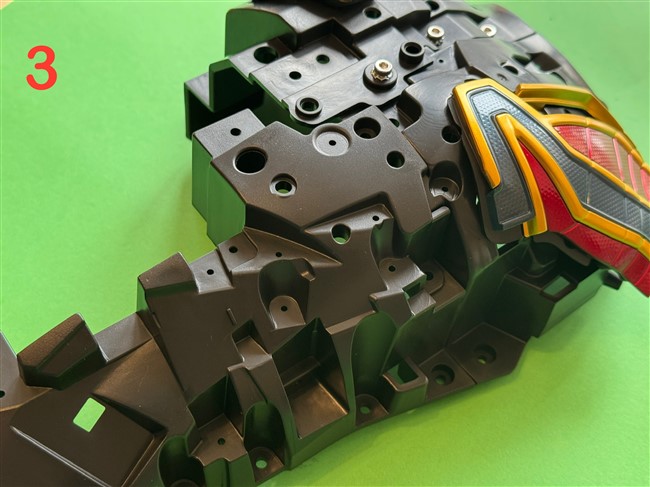

#4 Posted : 19 November 2025 19:00:24
Posts: 6,966
Points: 21,205

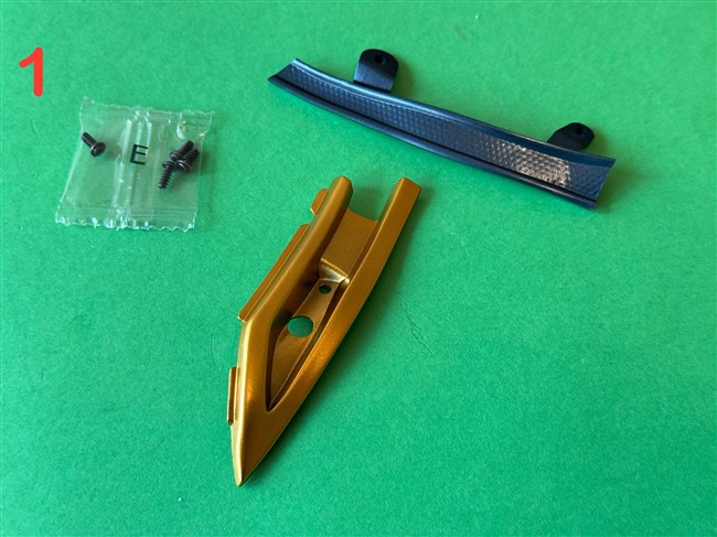

Issue 30
Place the left abdominal blue plate into position, securing it in place using 2 x E screws as shown in picture 2.
Finally, attach the inner detail and again securing it with an E type screw, picture 3.

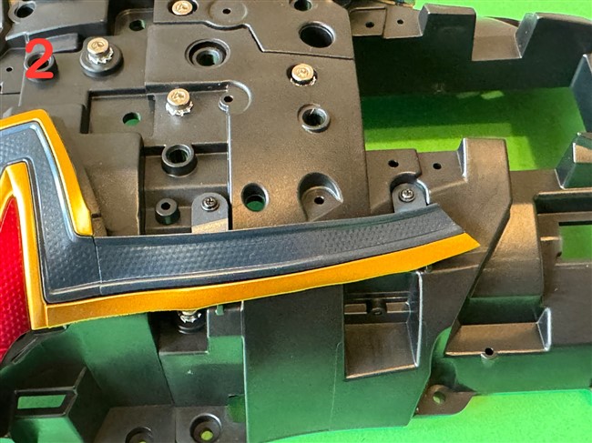

#5 Posted : 20 November 2025 20:59:58
Posts: 6,966
Points: 21,205

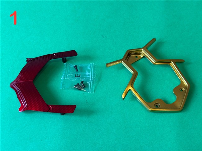

Issue 31
Place the right abdominal blue plate into position, securing it in place using 2 x E screws as shown in picture 2.
Finally, attach the inner detail and again securing it with 2 x E type screw, picture 3.

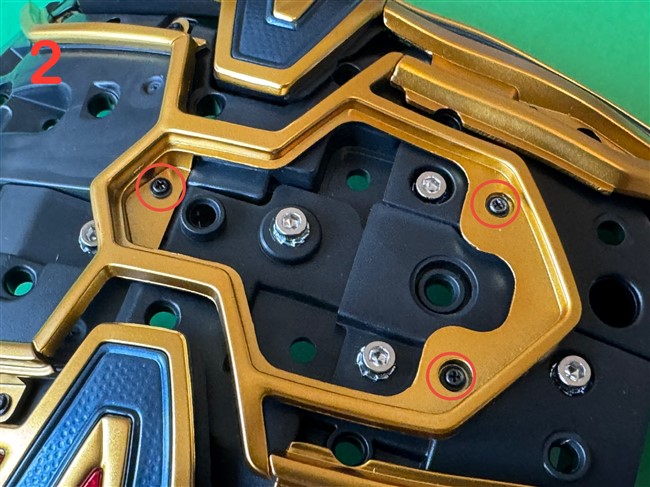

Issue 32
The Chest Symbol
Push the centre chest detailing into position and secure it using 3 x E type screws, picture 2.
Push fit the lower red chest place into position as shown in picture 3.
Picture 4 shows the completed assembly for this issue.
