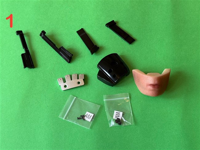

Picture 1 shows the parts for this issue.
The Hand with Connector, Head and the Gun.

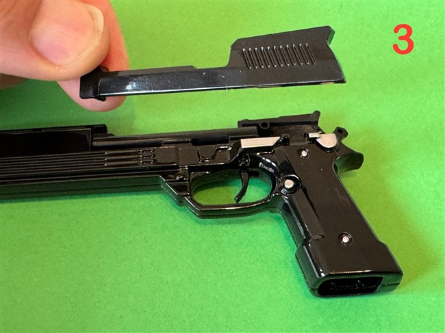

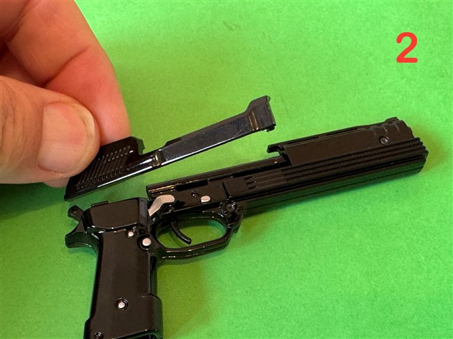

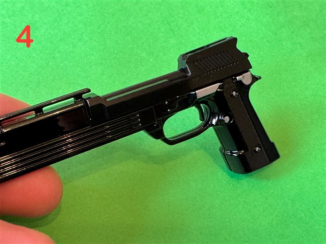

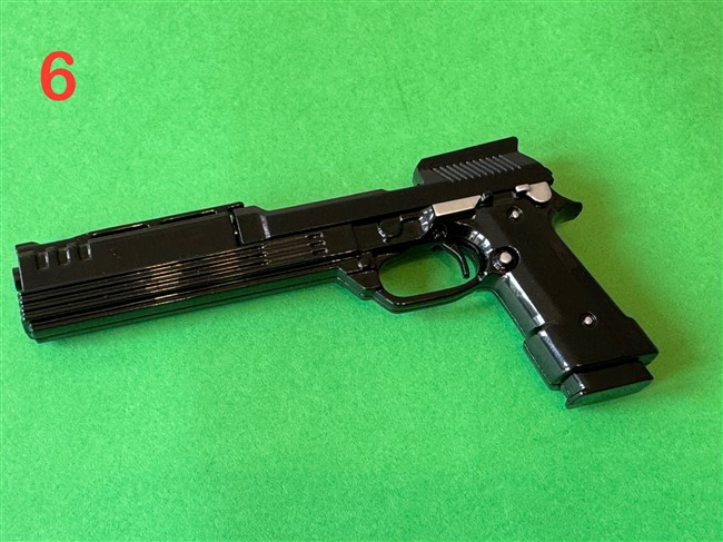

Place the right side of the slider (99E) over the barrel on the pistol, picture 2. Place the left side of the slider (99D) over the barrel, snap fitting the two sliders together, pictures 3 and 4.

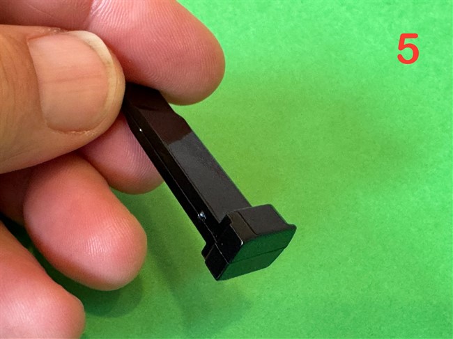

Join the two sides of the magazine (99F & 99G) together, picture 5. Insert the magazine into the compartment in the pistol grip, picture 6.

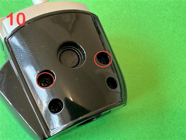

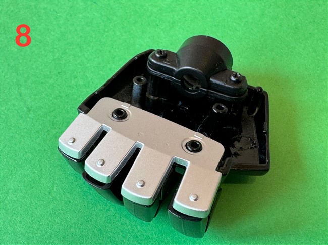

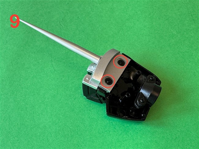

Place the finger cover (99B) over the inner side of the palm of the hand as shown in pictures 7 and 8. Place the data connector assembly over the finger cover and secure the two parts using 2 x WM screws, pictures 9 and 10.
That completes the assembly for part 1 of this issue.

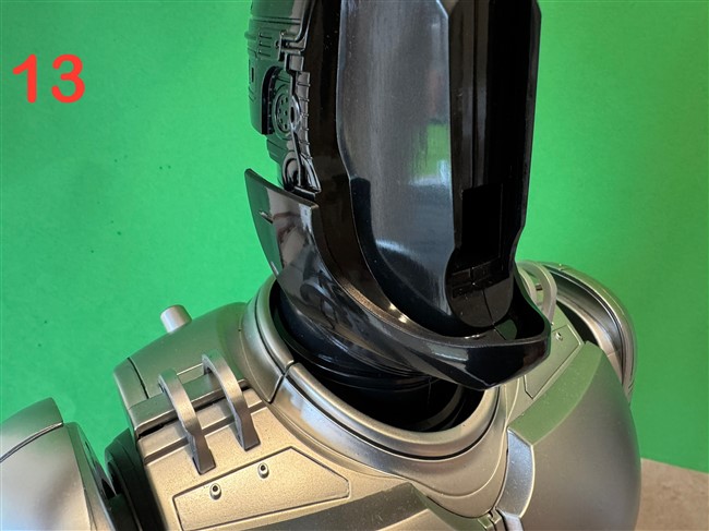

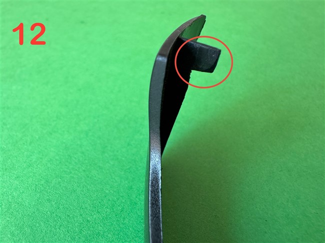

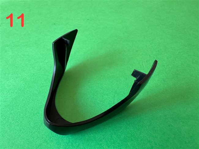

Note: In issue 98, I had some trouble with placing the chin guard onto the head, picture 11. I found that the tabs were too big to slot in the holes on the side of the head. If anyone has the same issue, I found that filing down the tabs on the sides slightly, picture 12, enabled the tabs to fit easier, picture 13.

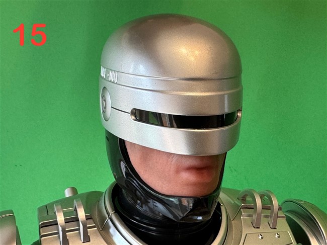

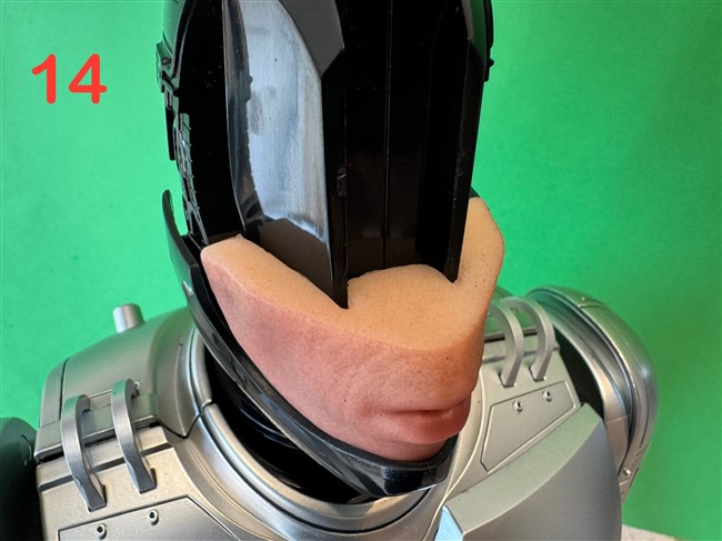

Remove the helmet and place the face (99A) over the front of the head, so that it rests on the tabs and the jaw, picture 14. Place the helmet back in position, picture 15.
That completes the assembly for part 2 of this issue.

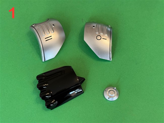

Issue 100
The Hand with Connector and Head.

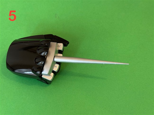

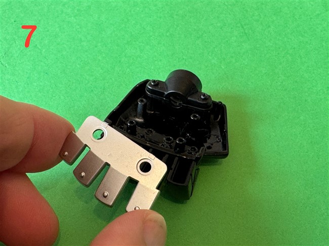

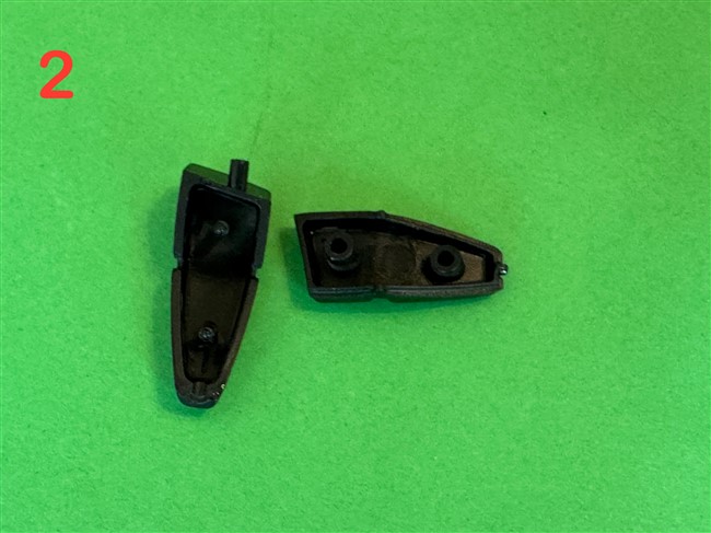

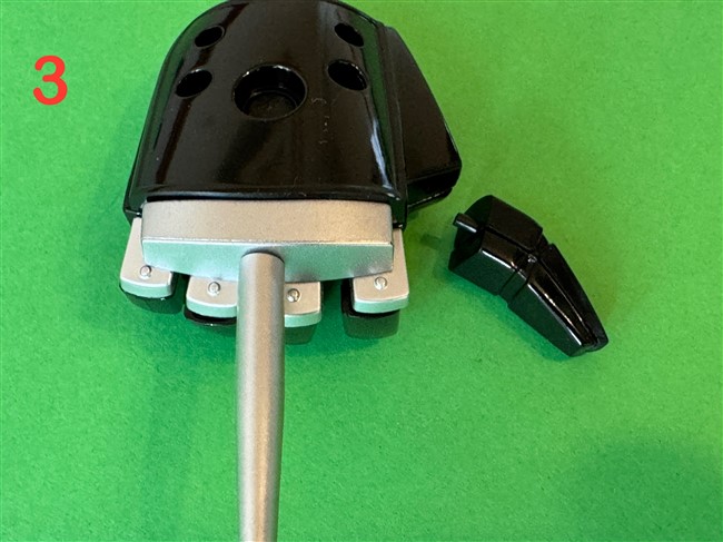

Snap fit the two parts of the thumb (100E & 100F) together, picture 2. Insert the thumb assembly into the hand as shown in pictures 3 and 4. Place the guard over the hand. This part is magnetic and should just snap into place, picture 5.
The hand with the connector is an optional part. Should you wish to use this part, then remove the right-hand guard and loosen the four screws on the back of the hand. Once you have taken the hand, loosen the four screws on the data hand and push it in place on the lower arm, tightening the screws before placing the guard back on.

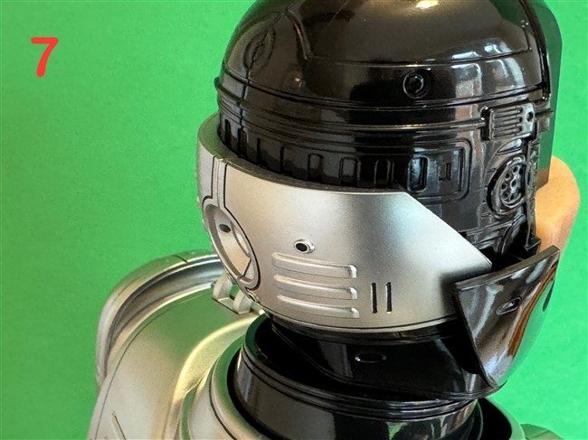

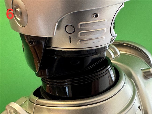

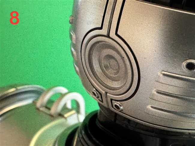

Push the left rear head guard (100A) into place as shown in picture 6. Do the same with the right-hand guard (100B), picture 7. Finally, place the connector (100C) in the centre of the two guards, picture 8.

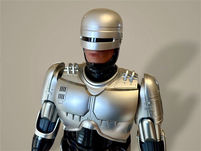

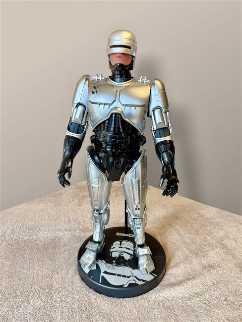

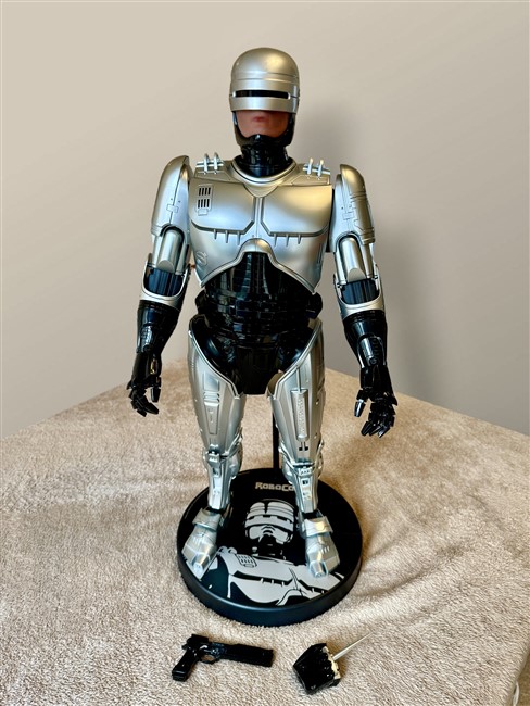

That completes the RoboCop figure.
The last three pictures are of him complete. More pictures will be in the finished gallery.
