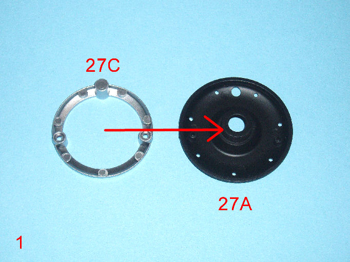

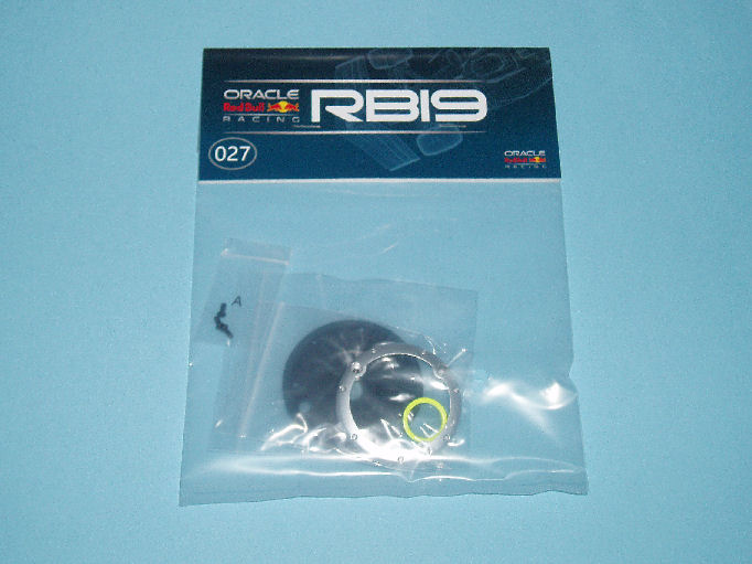

STAGE 27:
Front right wheel 1.
Pic 1: Locate the outer wheel parts 27A and 27C.

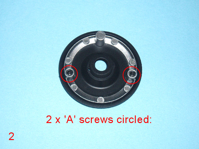

27C will fit inside 27A.
Pic 2: Fit the parts together as shown and fix with 2 x ‘A’ screws.
Pic 3: Store the assembly and unused part 27B safely for now.

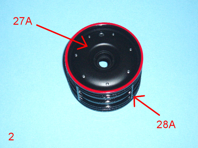

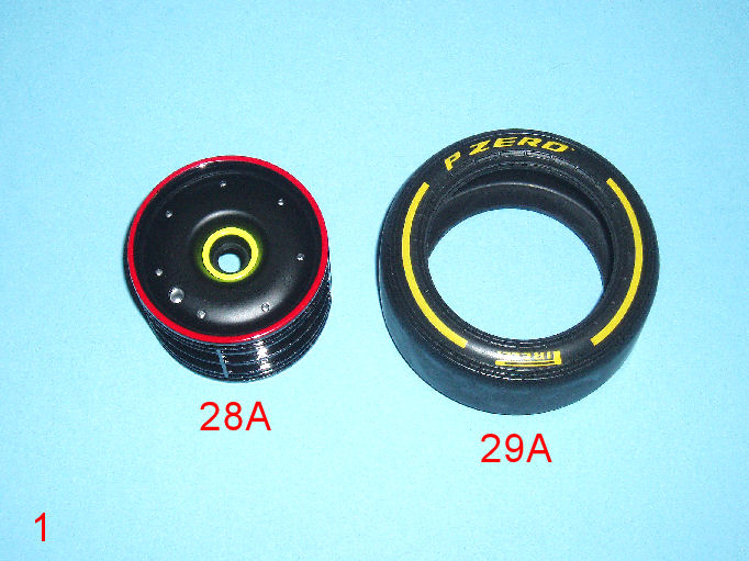

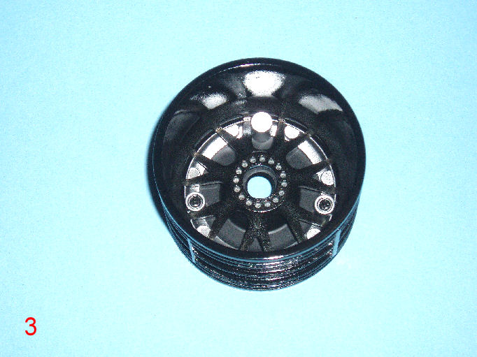

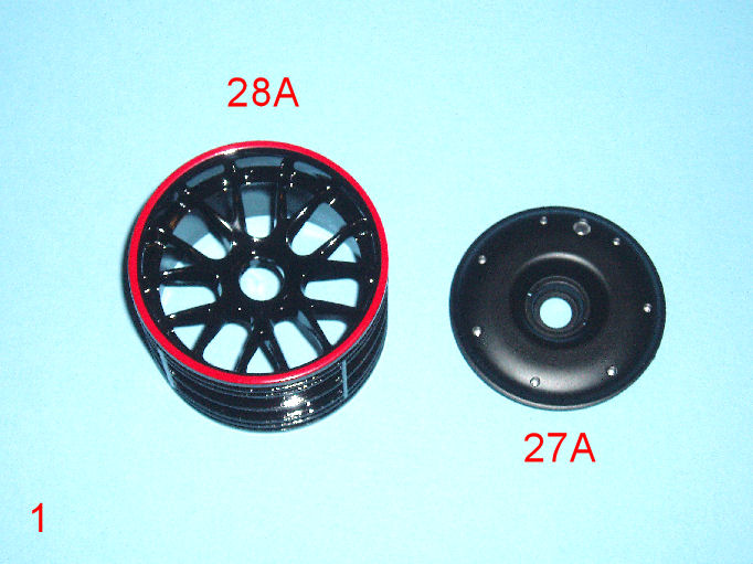

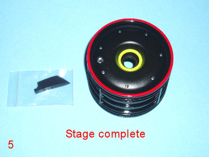

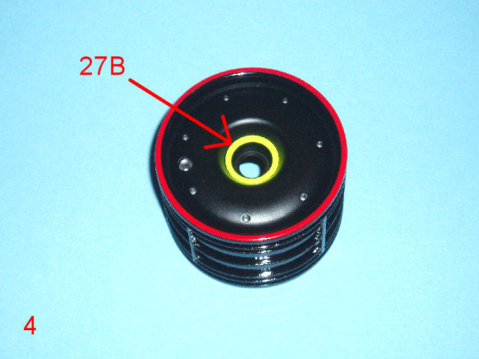

STAGE 28:
Front right wheel 2.
Pic 1: Retrieve the assembly 27A from the previous stage, and the wheel 28A.
Pic 2: Press-fit the cover 27A inside the front of the wheel 28A.
The protrusions on the rear of the cover will fit between the spokes on the wheel.
Pic 3: Shows how the parts fit together from the other side.
Pic 4: Press-fit the inner ring 27B saved from the previous stage in place.
Pic 5: Store the assembly and unused part 28B safely for now.

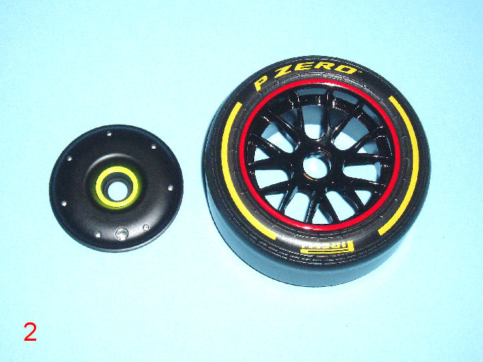

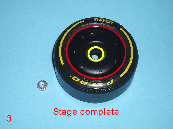

STAGE 29:
Front right wheel 3.
Pic 1: Retrieve the wheel assembly from the previous stage, and the tyre 29A.
Pic 2: Fit the tyre over the wheel.
To do this you may find it better to remove the wheel cover for now to prevent damaging it as you press the tyre in place.
This is at the builder’s discretion.
A good deal of pressure is needed to get the tyre to sit properly on the wheel rim on both sides.
Take your time here and be careful.
Pic 3: When the tyre is in place, re-fit the wheel cover if you removed it.
Save the assembly and unused wheel nut 29B until later.

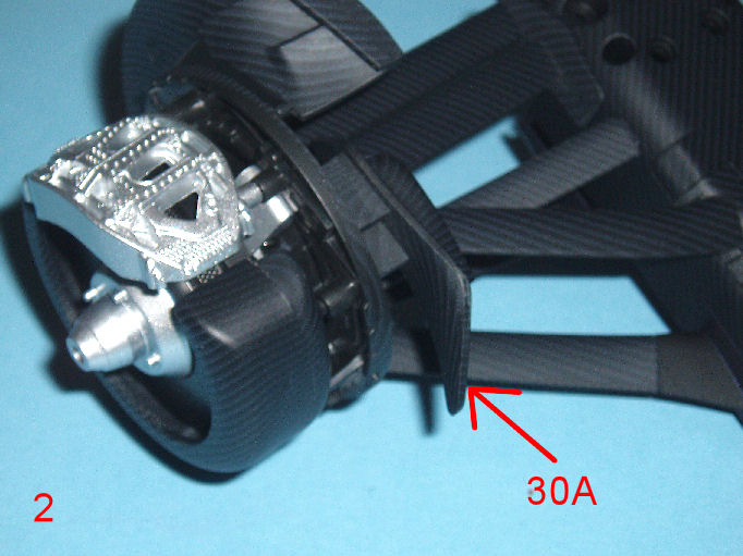

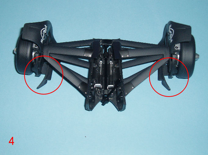

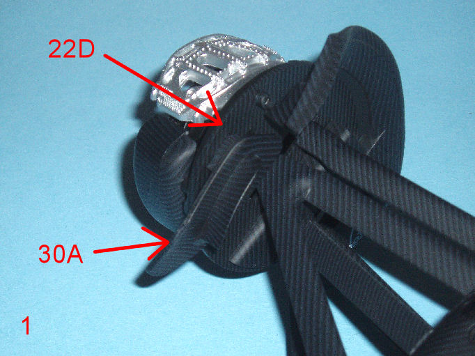

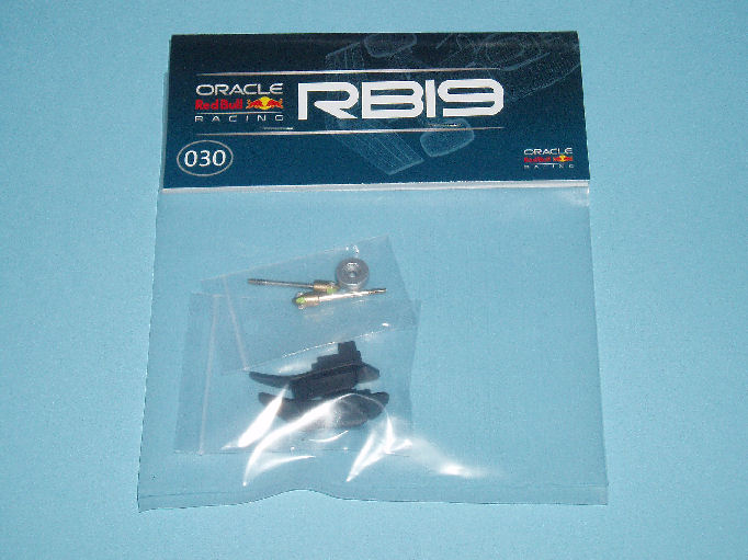

STAGE 30:
Brake disc deflectors.
Pic 1: Retrieve the front assembly and press-fit the right deflector 30A into the two slots in the brake back plate 22D as shown.
Pic 2: Shows the parts from the other side.
Pic 3: Fit the left deflector 30B in the same way.
Pic 4: Shows the parts from the other side.

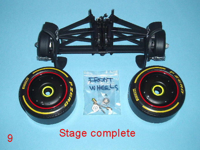

Pic 5: The printed instructions now suggest fitting the front wheels.
This is shown in the following steps but I am not actually fitting the wheels here as they are heavy and there is a risk of future damage to the assembly.
The wheels will be fitted at the end of the build.
This is entirely at the builder’s discretion.

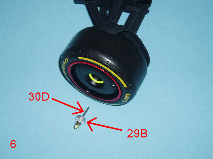

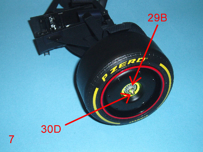

Pic 6: Fit the right front wheel in place and locate the nut 29B from the previous stage, and the axle 30D.
Fit them together as shown.
Pic 7: Fit the parts into the wheel centre and tighten the axle 30D.

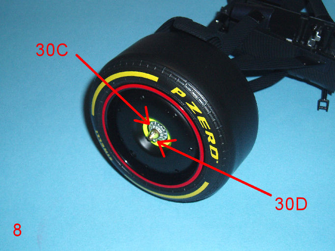

Pic 8: Repeat on the other side with the wheel assembled much earlier in the build, fixing it with the axle and nut 30C and 30D.
Pic 9: As mentioned, you can fit the wheels now, or save the axles and nuts safely, to fit the wheels later.

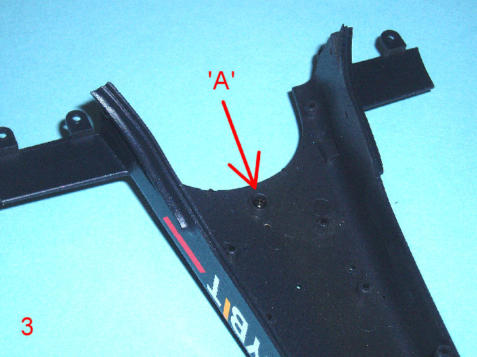

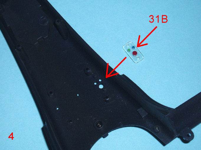

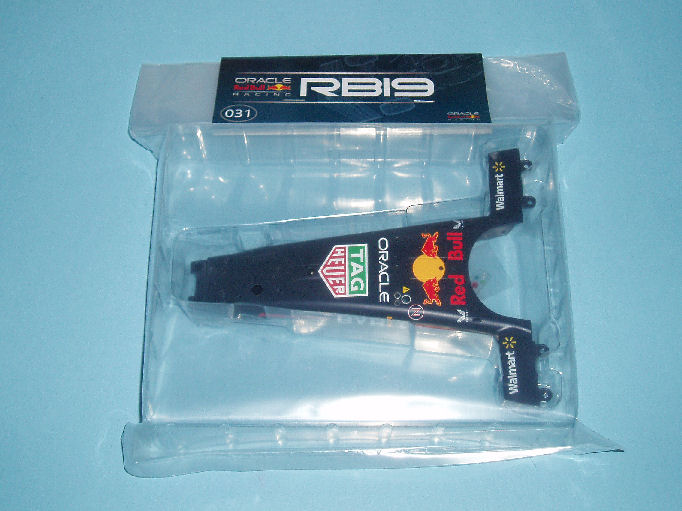

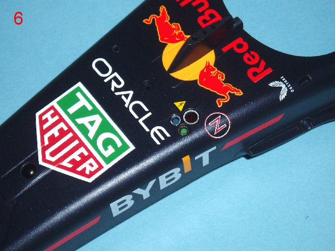

STAGE 31:
Front bodywork 1.

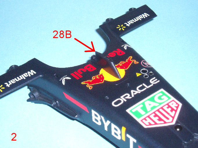

Pic 1: Retrieve the halo support 28B, and the front body 31A.
Pic 2: Fit the support 28B to the top of the body as shown.
Pic 3: Fix from underneath with 1 x ‘A’ screw.

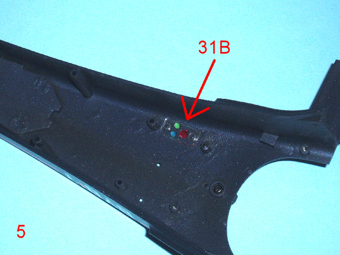

Pic 4: Locate the button plate 31B. It will fit in the matching holes on the inside of the body panel.
Pic 5: Press-fit the part fully in place.
Pic 6: Shows the parts assembled.
Pic 7: Store the assembly safely for now.

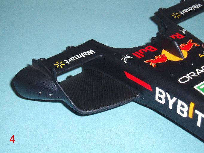

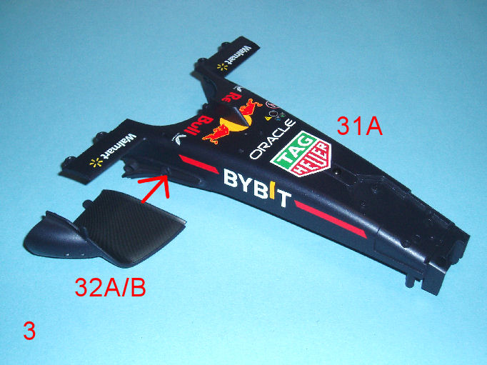

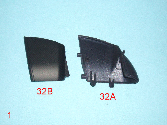

STAGE 32:
Front bodywork 2.
Pic 1: Locate the air intake parts 32A and 32B.
Pic 2: Clip-fit the parts together as shown.
Pic 3: The intake assembly will fit to the side of the body panel 31A.
Pic 4: Shows the parts fitted together.
Pic 5: Fix from the inside with 2 x ‘A’ screws.
Pic 6: Store the assembly and unused part safely for now.
