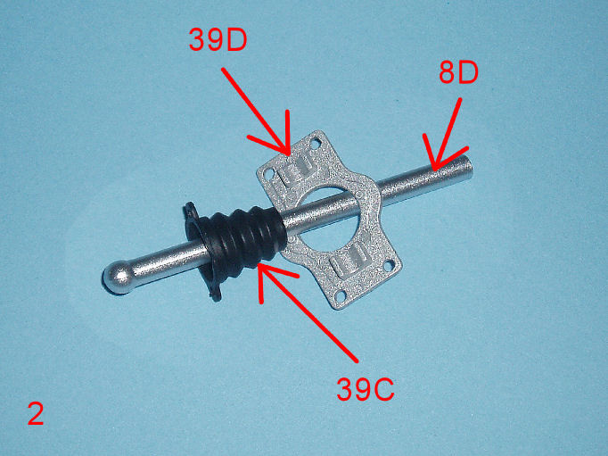

STAGE 39A:
Left front transmission.
Pic 1: Locate the stub axle parts 39A and 39B and fit them together as shown
Pic 2: Retrieve the shaft 8D saved from stage 8 and fit it through the gaiter 39C and then the plate 39D.
Pic 3: Shows the parts fitted together.
Pic 4: Fit the assembly to parts 39A/B and fix together with 4 x AM screws.
Pic 5: Fit the wheel guard 39G as shown and fix with 2 x AP screws.

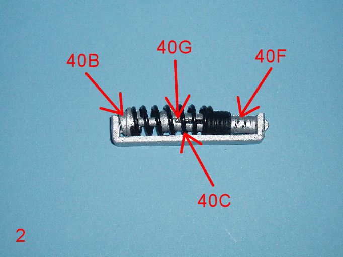

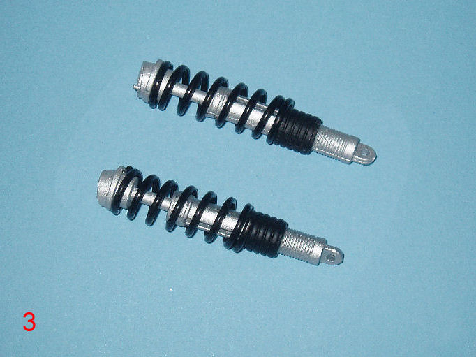

STAGE 40A:
Left front suspension.
Pic 1: Locate the spring and damper parts 40B, 40C, 40F and 40G.
Also, the build cradle 40I.
Pic 2: Using the cradle 40I, assemble the parts as shown, pressing one of the 40G pins into the hole in the end of 40B to lock the parts together.
Pic 3: Make two assemblies.
NOTE - Save the assembly cradle 40I for use in a future stage.
Pic 4: Retrieve the assembly from the previous stage and fit the shock absorbers/springs in place on the arm 39H as shown, fixing them using 1 x AM screw in each.
NOTE – the angled upper end of the shock absorber shown in red must be facing the way indicated.
Pic 5: Retrieve the main car assembly and fit the suspension in place on the front left side, fixing it with 2 x AM screws.
Pic 6: Fit the wheel arch 40A to the floor as shown, fixing it with 3 x AM screws.

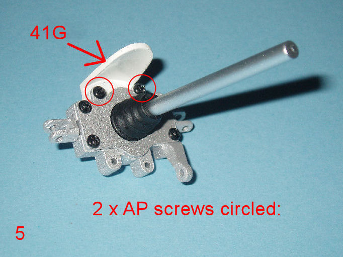

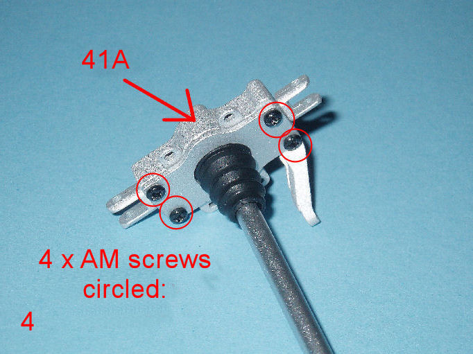

STAGE 41A:
Right front transmission.
Pic 1: Locate the stub axle parts 41A and 41B and fit them together as shown.
Pic 2: Retrieve the shaft 8D saved from stage 8 and fit it through the gaiter 41C and then the plate 41D.
Pic 4: Fit the assembly to parts 41A/B and fix together with 4 x AM screws.
Pic 5: Fit the wheel guard 41G as shown and fix with 2 x AP screws.

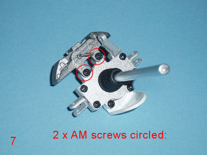

STAGE 41B:
Pic 6: Press-fit the brake pipe connector 41F into the caliper 41E.
Make sure it is angled as shown.
Pic 7: Fix the caliper to the main assembly with 2 x AM screws.
Pic 8: Fit the narrow end of the upper arm 41H to the main assembly in the position shown and fix it with 1 x BM screw.
Pic 9: Fit the brake pipe 41J to the connector 41F.
Pic 10: Fit the support 41I to the assembly in the position shown and fix with 1 x ANM screw from the outside at each end.
