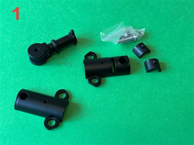

The Left Ankle

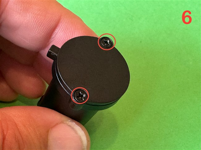

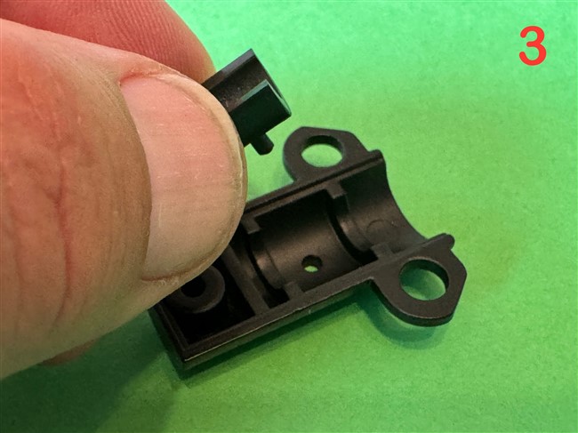

Place one of the spacers (10D) into both halves of the left ankle (10A & B), pictures 2 and 3. Picture 4 shows them in place.

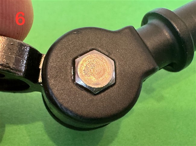

Retrieve the completed ankle joint from issue 8 and place its smooth circular end between the two discs of the left ankle (10C), picture 5. Secure the two parts using the hexagonal screw, two washers and the nut as shown in pictures 6 and 7.
Finally, cover the assembly with the two halves of the ankle covers. Note the part 10C has a pin at the end, this goes into the half with the slot, picture 8.
Picture 9 shows the complete assembly for this issue.

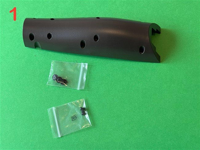

Retrieve the ankle assembly from the last issue. Place this in the narrowest part of the left calf (11A) and secure it in place using a GM screw at the back of the ankle assembly and 2 x EM screws at the front, picture 2.
Note: The magazine shows the ankle assembly attached in the calf in the upside-down position. This is incorrect and will not assemble in that position. Turn the assembly over and secure it in the position as illustrated in picture 2.

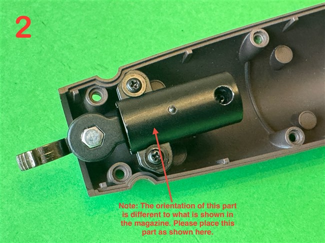

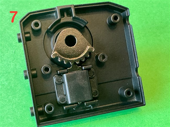

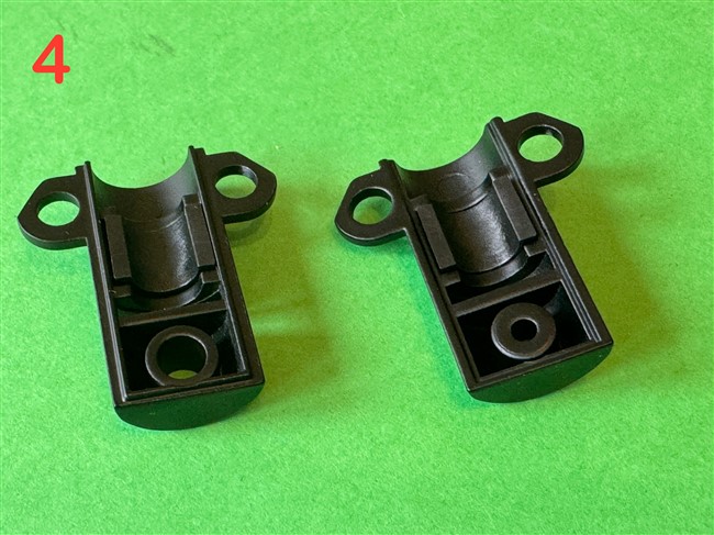

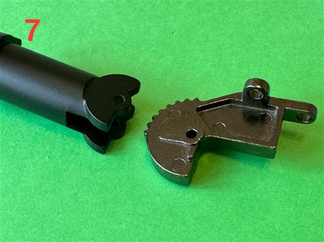

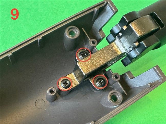

#4 Posted : 16 October 2025 10:36:56
Posts: 6,966
Points: 21,205

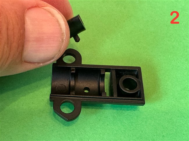

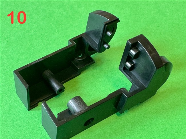

Issue 12

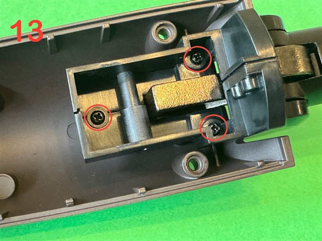

The Left Leg & Knee

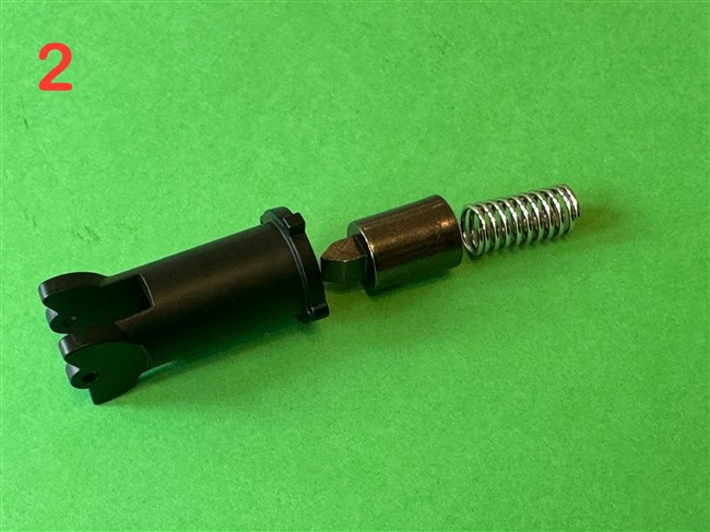

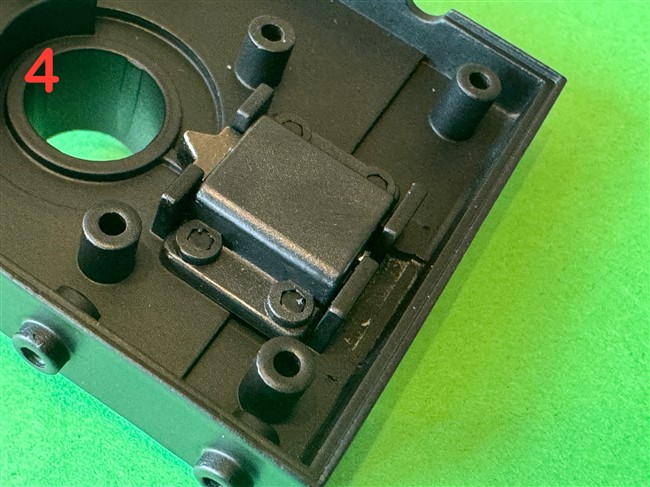

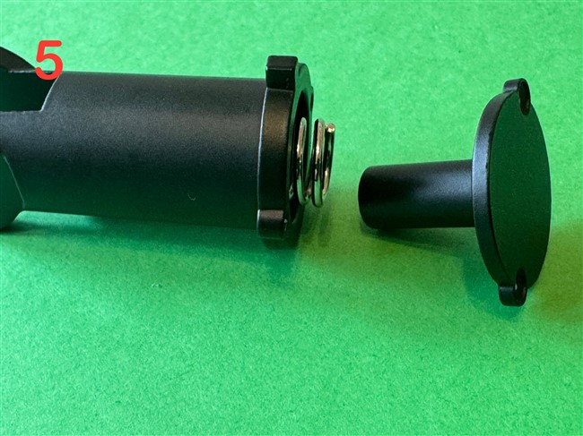

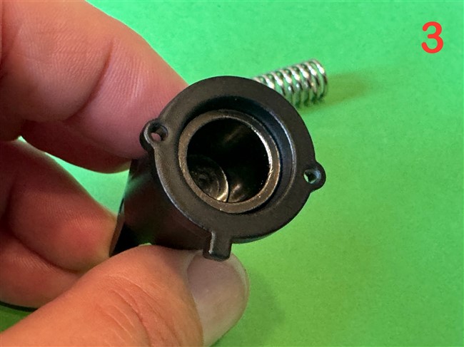

Insert the locking piston (12C) into the joint housing (12A). Insert the spring (12A), pictures 2,3 and 4. Close the housing with the cover (12E) and secure it using 2 x HM screws, pictures 5 and 6.

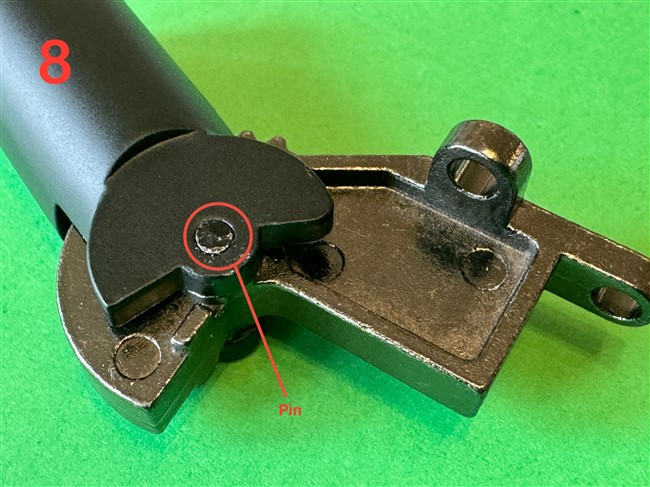

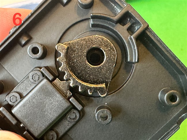

Position the gear (12B) on the joint, picture 7 and align the hole and insert the pin in the two parts, picture 8.
Place the joint assembly into the assembly from the previous issue, securing it in place using 3 x EM screws, picture 9.

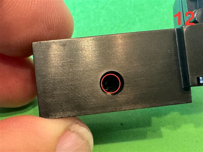

Assemble the joint covers (12G and 12H) and secure them together using a JP screw, pictures 10, 11 and 12.
Place the cover over the joint in the housing and secure using 2 x JM screws to the front and a KM screw at the back, picture 13.
Picture 14 shows the complete assembly for this issue.

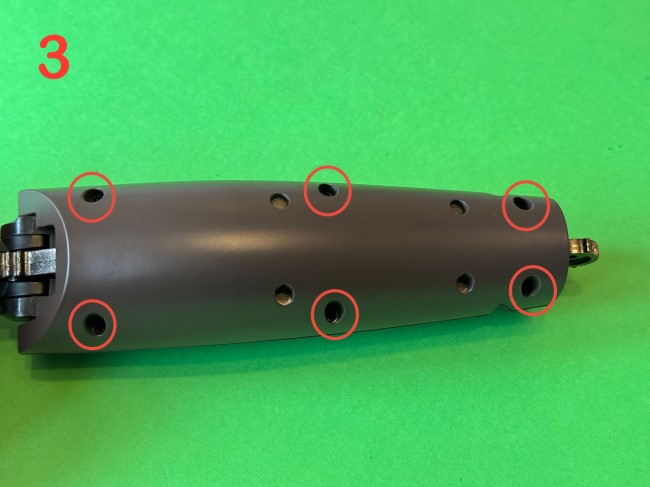

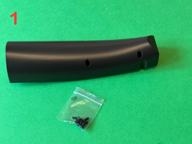

The Front of the Left Leg
Place the front of the left leg (13A) onto the assembly from the previous issue, picture 2.
Secure it in place using 6 x KP screws, picture 3.
Picture 4 shows the complete assembly for this issue.

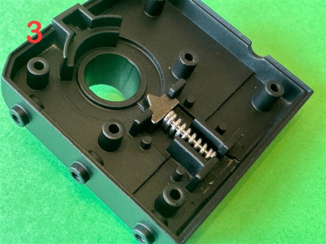

#6 Posted : 19 October 2025 15:39:43
Posts: 6,966
Points: 21,205
Issue 14

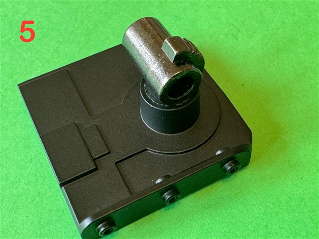

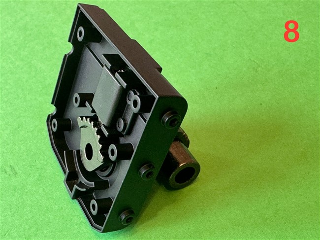

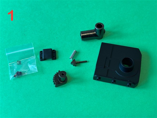

The Left Hip Joint
Before we start with this issue, the parts differ slightly from the magazine. I am waiting a reply from the production team as to whether this is correct.
In the meantime, I have gone ahead with the assembly.

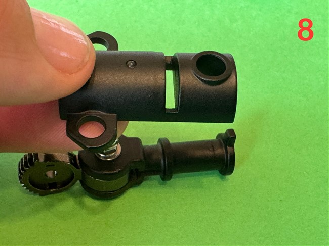

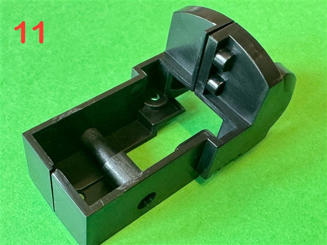

Slide the joint spring (14B) onto the rod (14C), picture 2. Place the assembly inside the gearbox (14A) with the rod engaged in the notches as shown in picture 3. Place the cover plate (14D) into place as illustrated in picture 4.
Insert the outer thigh joint (14E) into the box on the opposite side of the previous assembly, picture 5. Place the inner thigh joint (14F) by inserting it inside 14E, picture 6, then secure it in place using a GM screw, picture 7, making sure it is central to the locking rod.
Picture 8 shows the complete assembly for this issue.
