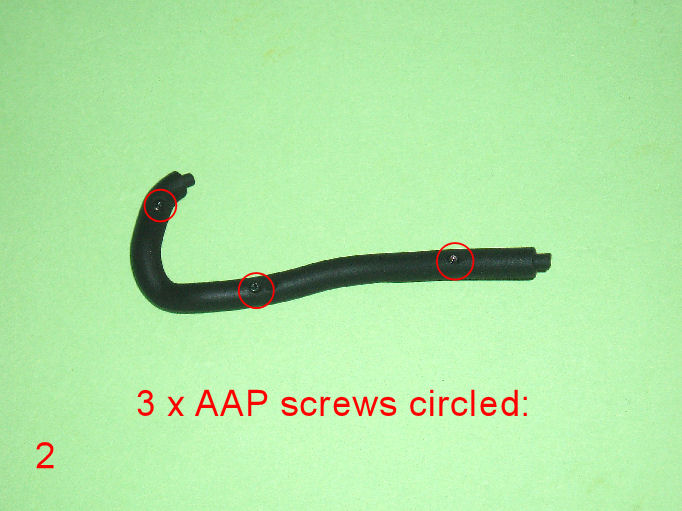

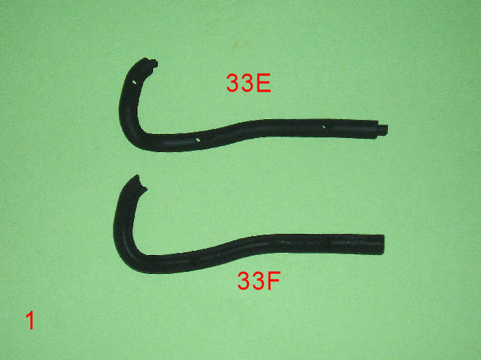

Pic 1: Locate the air hose parts 33E and 33F.
Pic 2: Fit the parts together and fix with 3 x AAP screws.

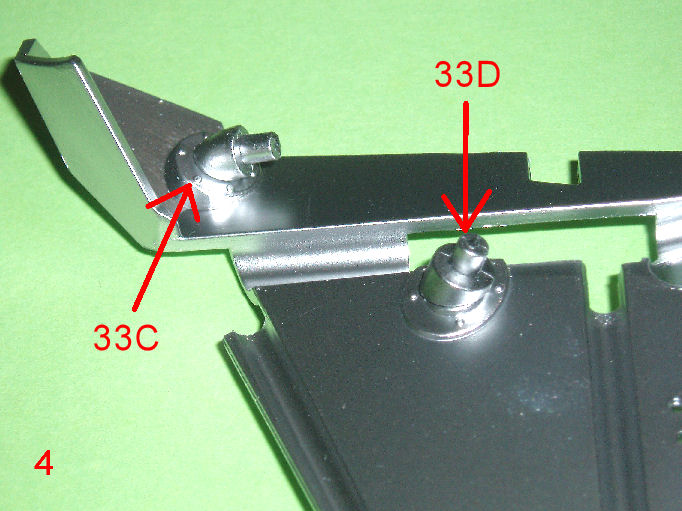

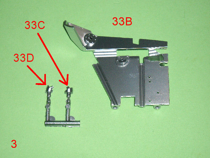

Pic 3: Locate the right bulkhead 33B and the two hose fittings 33C and 33D.
Pic 4: Press the two fittings in place as shown.

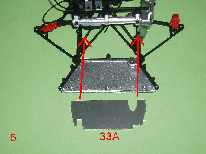

Pic 5: Retrieve the front frame assembly and the centre bulkhead 33A.
It will fit into the frame where indicated.

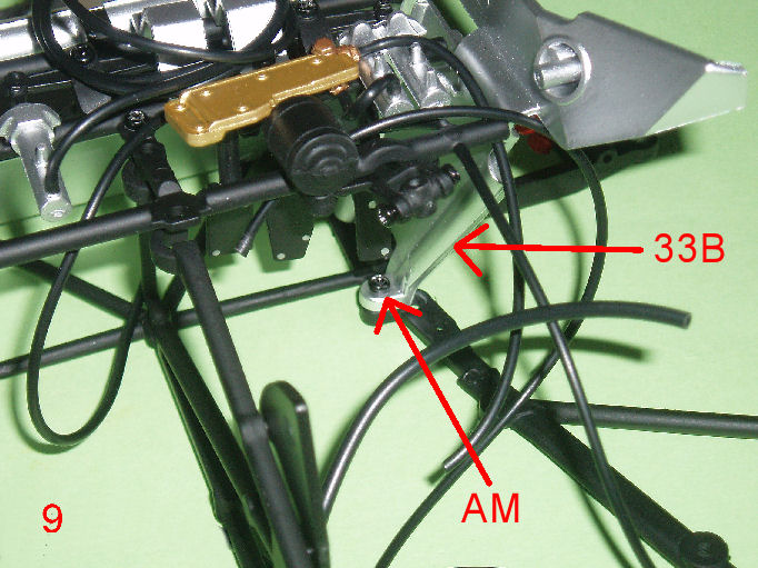

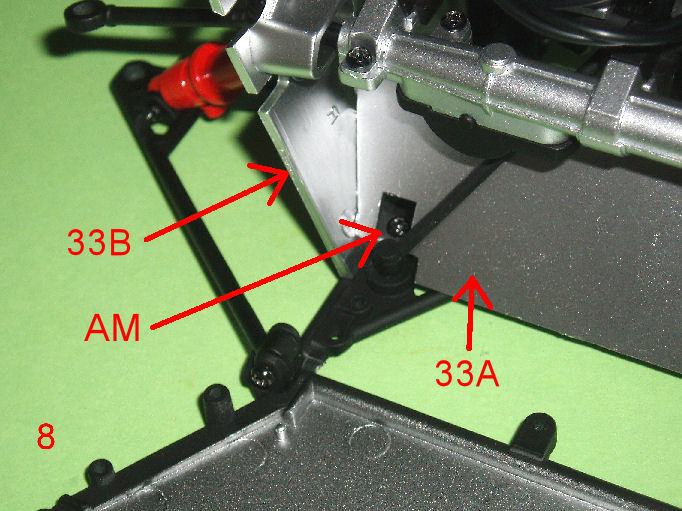

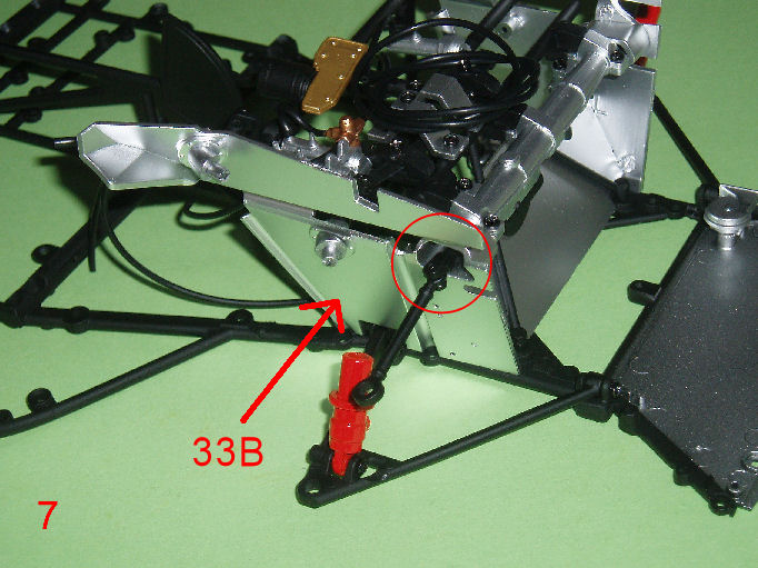

STAGE 33B:

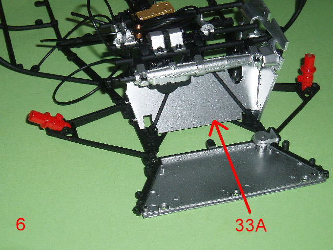

Pic 6: Slide the panel 33A into place from the left side, locating the pins on the right end in the holes in the side bulkhead.
Pic 7: Fit the side bulkhead 33B as shown.
It will be easier to fit the panel over the steering arm circled if the panel goes on at a 90 degree (vertical) angle and then is rotated down to fit.
Pic 8: Fit the pins on the end of the centre bulkhead 33A into the holes on the side panel 33B and fix the panel using 1 x AM screw into the frame as shown.
Pic 9: Fix the other end of the panel into the lower frame with another AM screw.
Pic 10: Store the assembly safely for now.

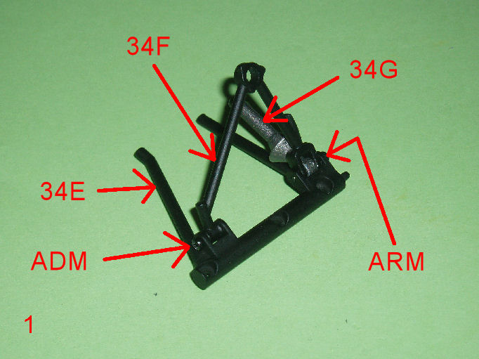

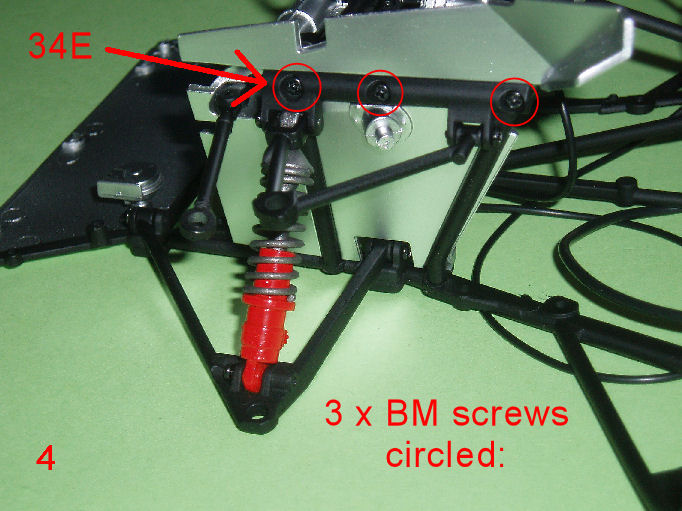

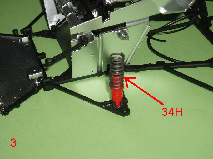

STAGE 34A:
Front left suspension.
Pic 1: Fit the suspension arm parts 34E, 34F and 34G together as shown.
Fix the left end using 1 x ADM screw.
Fix the other end the shock absorber part 34G in place, with 1 x ARM screw.
Pic 2: Shows the assembly from the other side.
Pic 3: Retrieve the main front frame and fit the coil spring 34H in place on the left side as shown.
Pic 4: Fit the suspension arm assembly built in steps 1 and 2 to the left side of the main frame as shown.
The shock absorber ‘leg’ will fit down inside the orange shock absorber body, inside the coil spring.
Compress the spring to fit the top of the frame 34E in place and fix with 3 x BM screws.
Pic 5: Turn the assembly upside down and secure the two legs of the suspension frame to the main frame using 2 x BM screws.

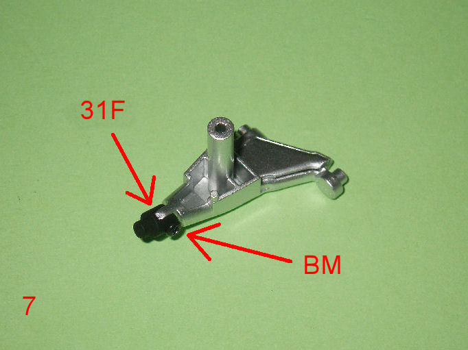

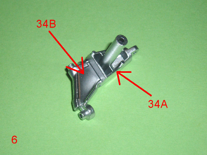

Pic 6: Press-fit the two parts of the hub 34A and 34B together as shown.

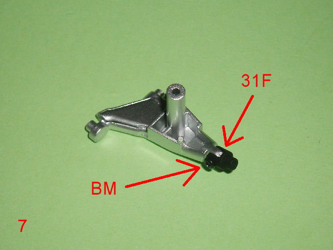

Pic 7: Retrieve the end fitting 31F saved from stage 31 and fit it to the end of the hub, securing it with 1 x BM screw.

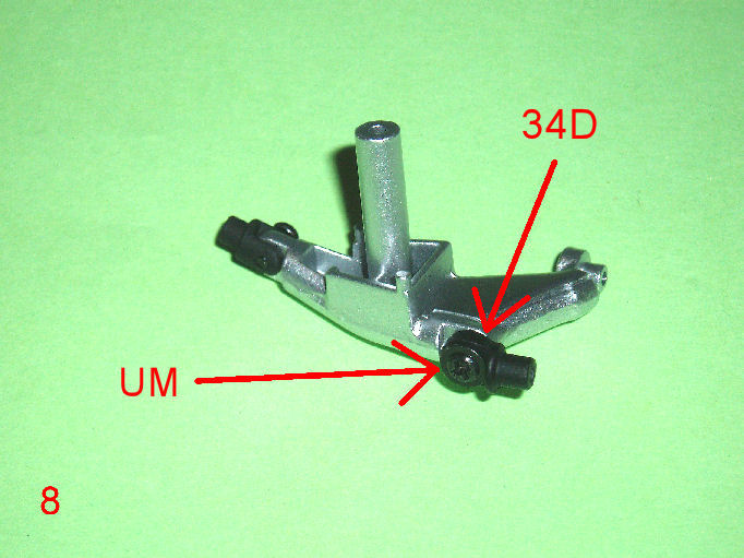

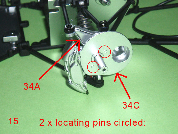

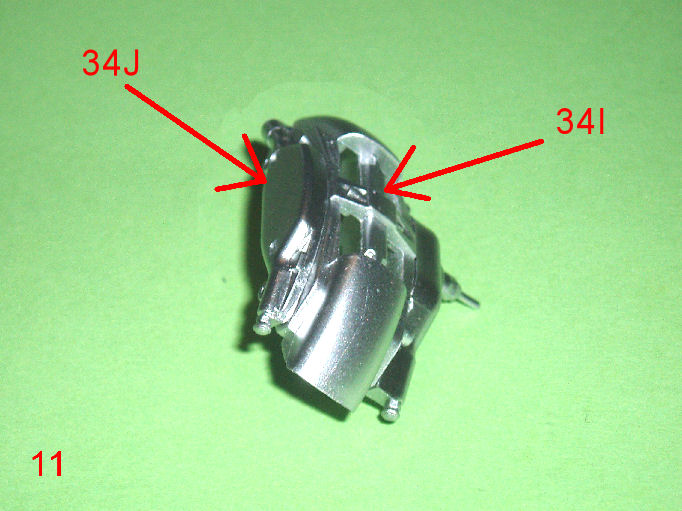

STAGE 34B:
Pic 8: Fit the bracket 34D to the other end of the hub as shown and fix with 1 x UM screw.

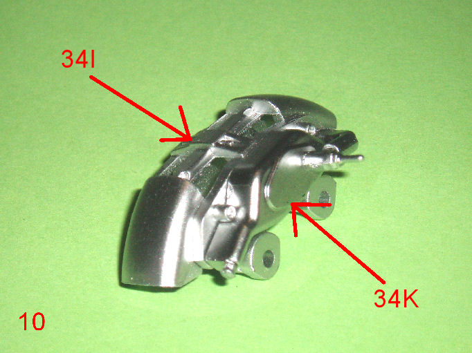

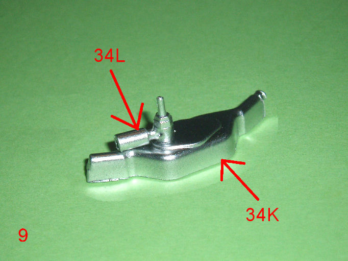

Pic 9: Press-fit the brake caliper parts 34K and 34L together as shown.
Pic 10: Press-fit the assembly to the side of the caliper 34I as shown.
Pic 11: Press-fit caliper part 34J to the other side of the assembly.

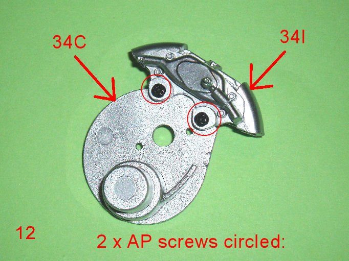

Pic 12: Locate the brake back plate 34C and fix the caliper assembly using 2 x AP screws.

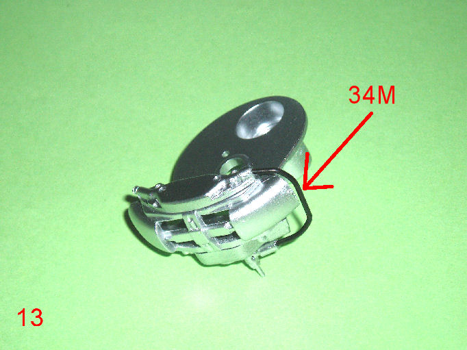

Pic 13: Press-fit the brake pipe 34M into the two holes in the end of the caliper.
It will only fit one way.

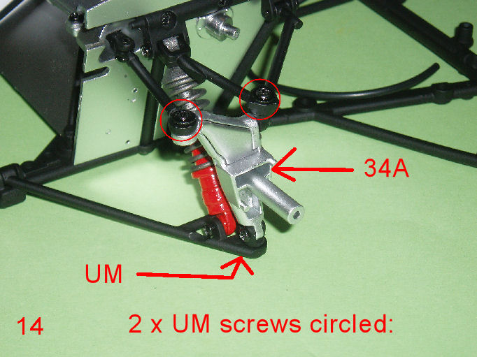

Pic 14: Fit the hub assembly to the left side of the main frame as shown and fix using 2 x UM screws at the top and 1 x UM screw up from underneath at the bottom.
Pic 15: Press-fit the caliper assembly onto the hub using the locating holes and pins as indicated.
Store the assembly safely.

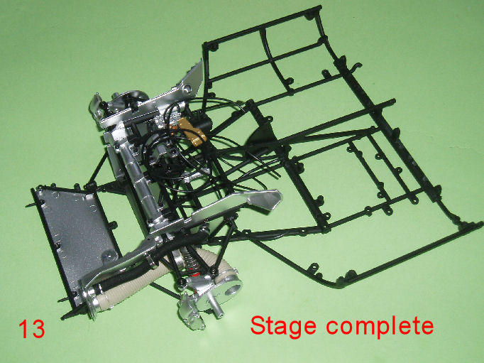

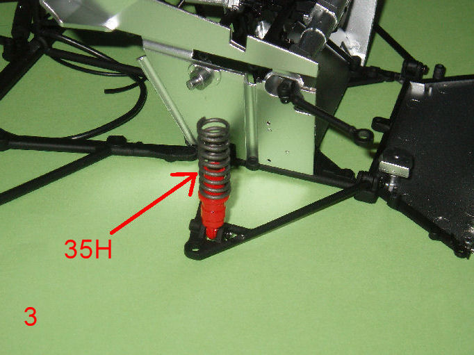

#5 Posted : 01 September 2025 10:40:32
Posts: 5,183
Points: 15,698

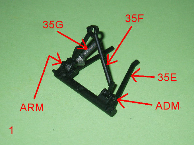

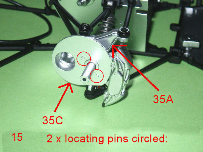

STAGE 35A:
Front right suspension.

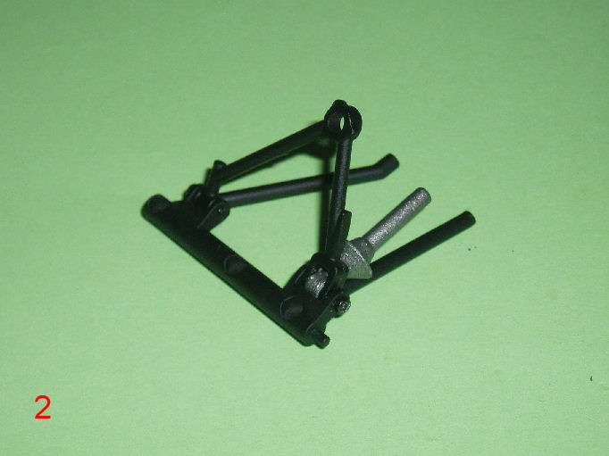

Pic 1: Fit the suspension arm parts 35E, 35F and 35G together as shown.
Fix the right end using 1 x ADM screw.
Fix the other end the shock absorber part 35G in place, with 1 x ARM screw.

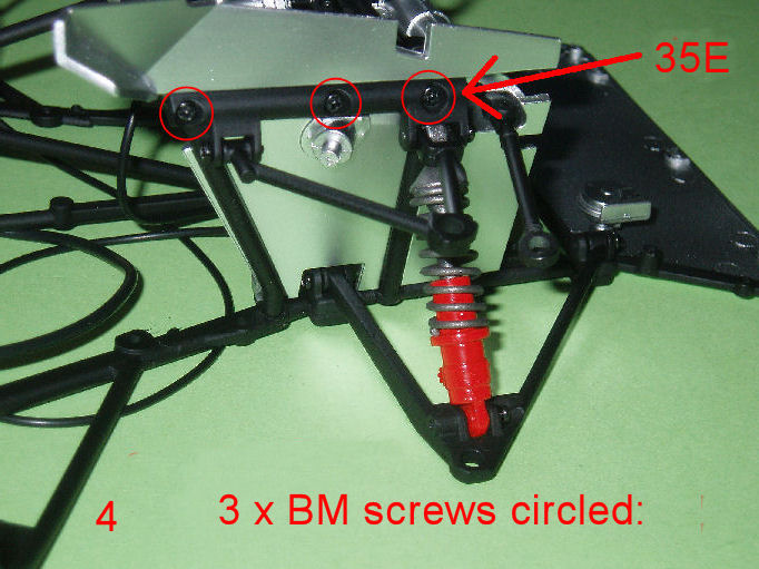

Pic 3: Retrieve the main front frame and fit the coil spring 35H in place on the right side as shown.
Pic 4: Fit the suspension arm assembly built in steps 1 and 2 to the right side of the main frame as shown.
Compress the spring to fit the top of the frame 35E in place and fix with 3 x BM screws.

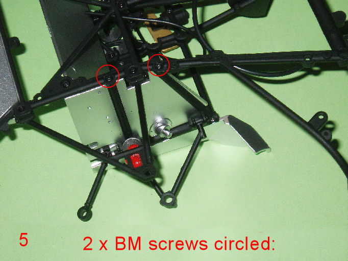

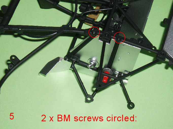

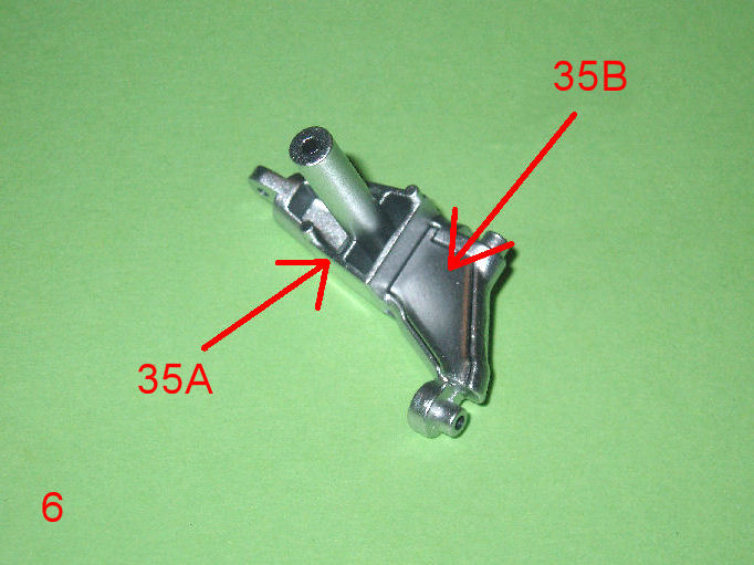

Pic 6: Press-fit the two parts of the hub 35A and 35B together as shown.
#6 Posted : 01 September 2025 10:44:06
Posts: 5,183
Points: 15,698

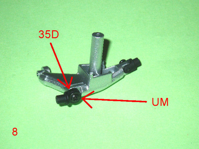

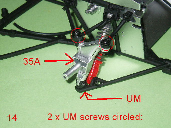

STAGE 35B:
Pic 8: Fit the bracket 35D to the other end of the hub as shown and fix with 1 x UM screw.

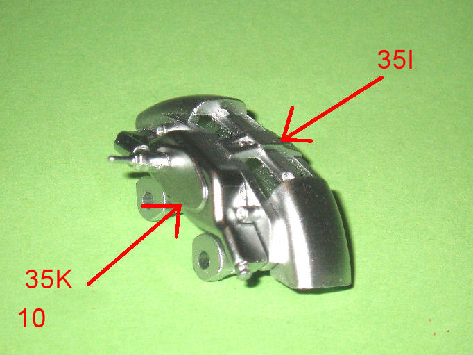

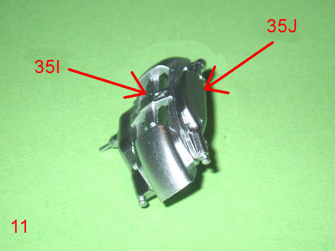

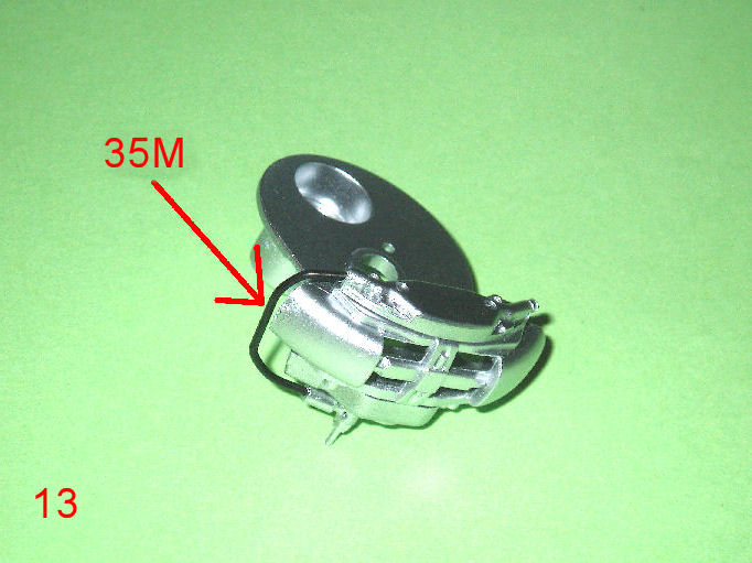

Pic 9: Press-fit the brake caliper parts 35K and 35L together as shown.
Pic 10: Press-fit the assembly to the side of the caliper 35I as shown.
Pic 11: Press-fit caliper part 35J to the other side of the assembly.

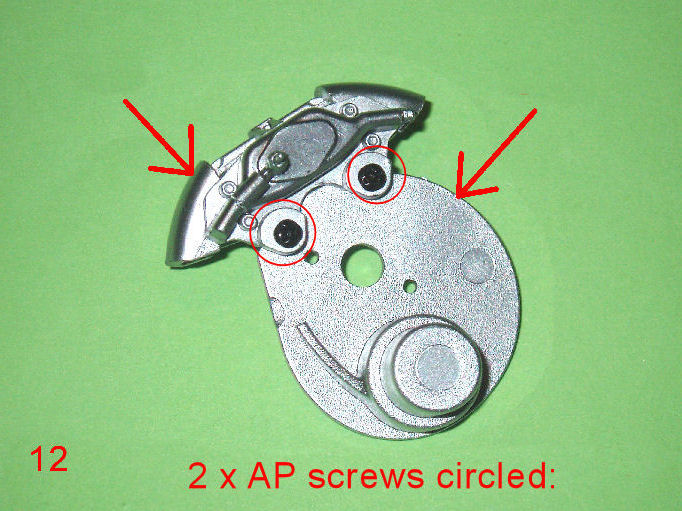

Pic 12: Locate the brake back plate 35C and fix the caliper assembly using 2 x AP screws.
Pic 13: Press-fit the brake pipe 35M into the two holes in the end of the caliper.
Pic 14: Fit the hub assembly to the right side of the main frame as shown and fix using 2 x UM screws at the top and 1 x UM screw up from underneath at the bottom.

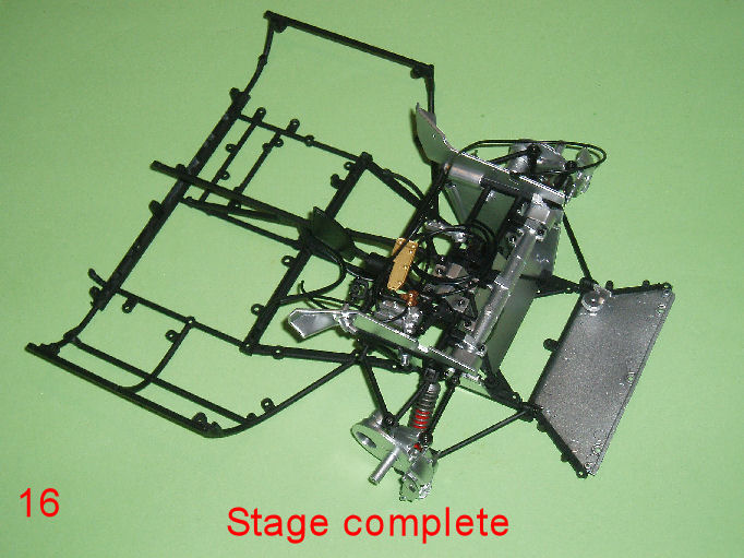

Pic 16: Store the assembly safely.

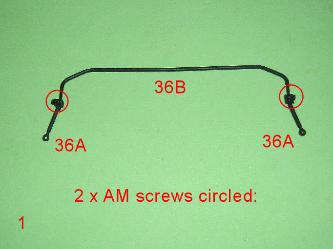

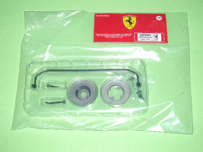

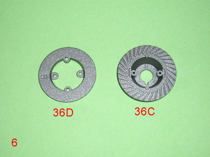

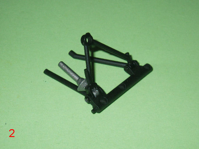

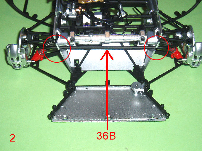

STAGE 36:
Anti-roll bar and disc.

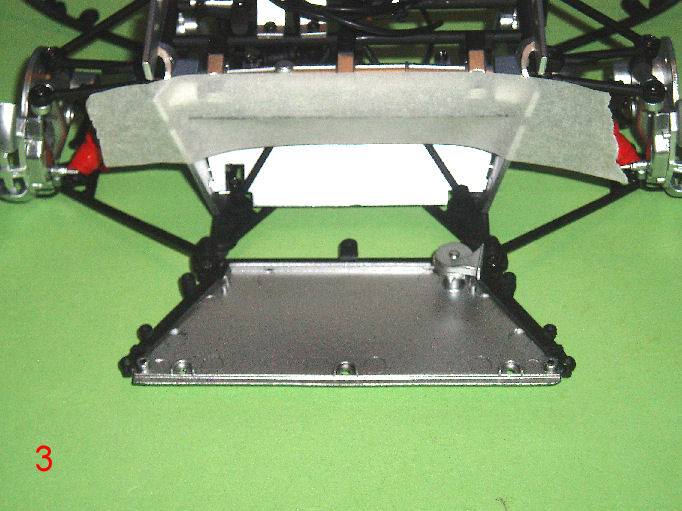

Pic 1: Fit the anti-roll bar parts 2 x 36A and 36B together as shown and fix from the outside using 1 x AM screw in each connection.
Pic 2: Position the assembly on the front main frame as shown with the arms 36A going through the hub and shock absorber, fitting the main anti-roll bar 36B in the cut-outs on the side panels as indicated.
Pic 3: It would be helpful for the next steps to secure the anti-roll bar in place with a strip of masking tape so that it doesn’t full out with the model upside down.

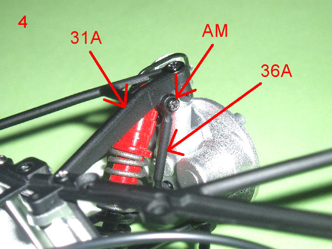

Pic 4: Turn the model upside down and fit the anti-roll bar arm 36A against the lower suspension arm 31A and secure with 1 x AM screw.

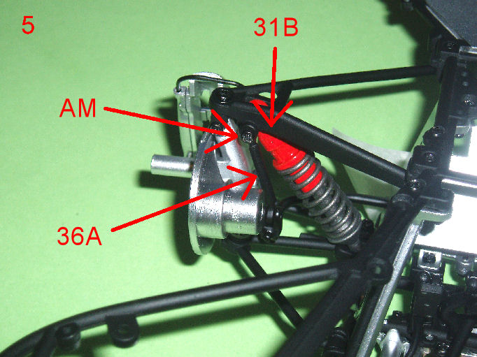

Pic 5: On the other side of the model, still upside down, secure the other anti-roll bar arm 36A to the lower suspension arm 31B with another AM screw.

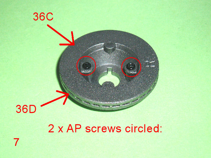

Pic 6: Locate the two disc parts 36C and 36D.
Pic 7: Fit the two parts together as shown and fix using 2 x AP screws.
Pic 8: Store the assembly and unused parts safely for now.

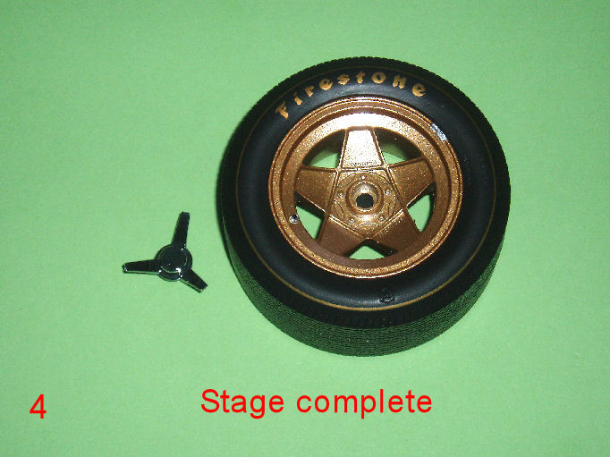

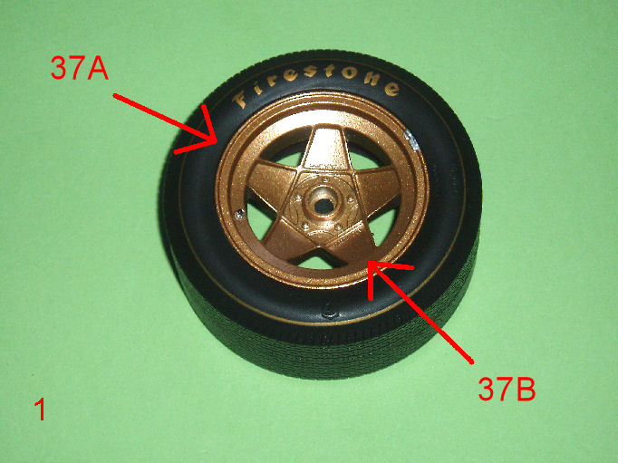

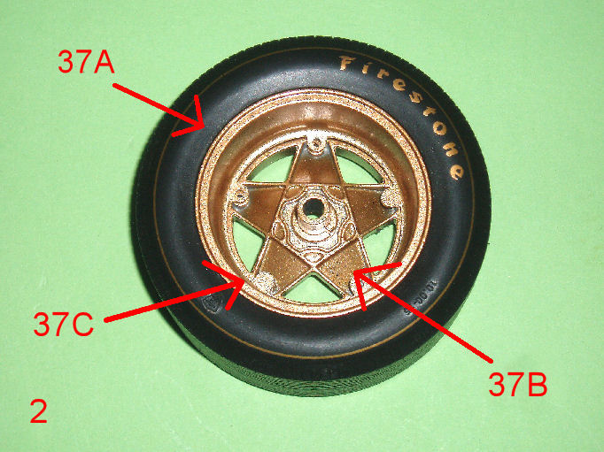

STAGE 37:
Right front wheel.

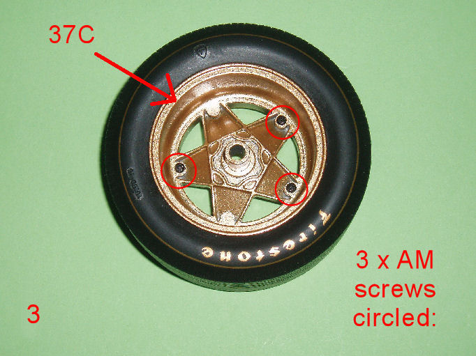

Pic 1: Fit the tyre and wheel front 37A and 37B together as shown:
Pic 2: Turn the assembly over and fit the wheel rear 37C in place, lining up the screw location tabs and holes.
Pic 3: Fix the parts together with 3 x AM screws.
Pic 4: Store the parts safely for now.

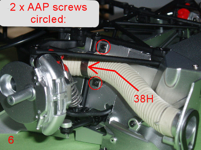

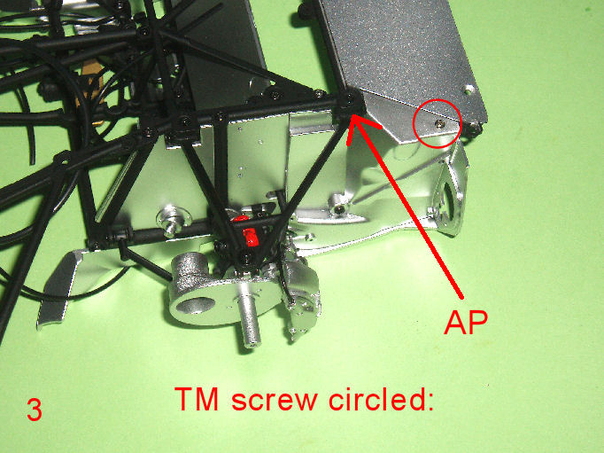

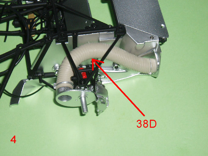

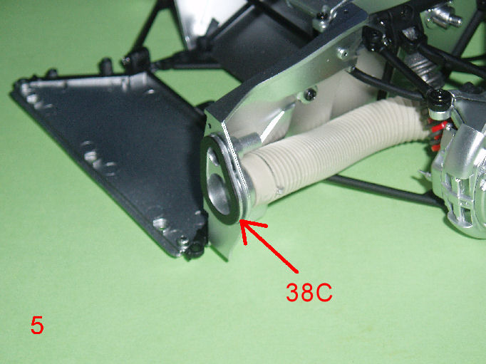

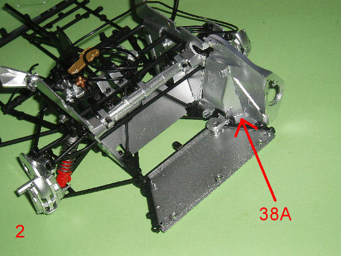

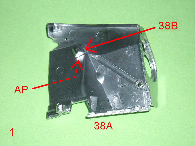

STAGE 38A:
Radiator left wall.
Pic 1: Fit the connector 38B to the panel 38A as shown and fix from behing with 1 x AP screw.
Pic 2: Fit the panel in place on the front frame as shown.
Pic 3: From underneath, fix the panel using 1 x TM screw and 1 x AP screw.
Pic 4: Fit the air duct 38D in place as shown.
Pic 5: Press the front clip 38C in place to hold the air duct.
Pic 6: Fit the bracket 38H over the air duct and fix it using 2 x AAP screws.

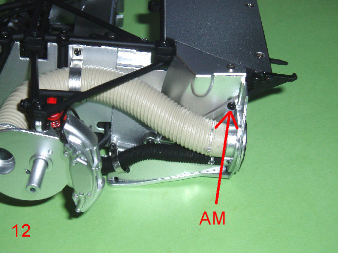

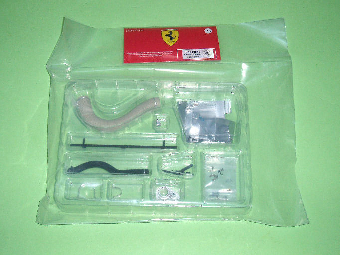

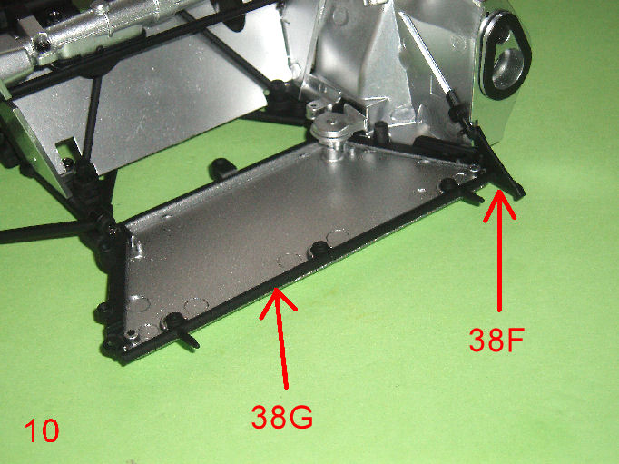

STAGE 38B:

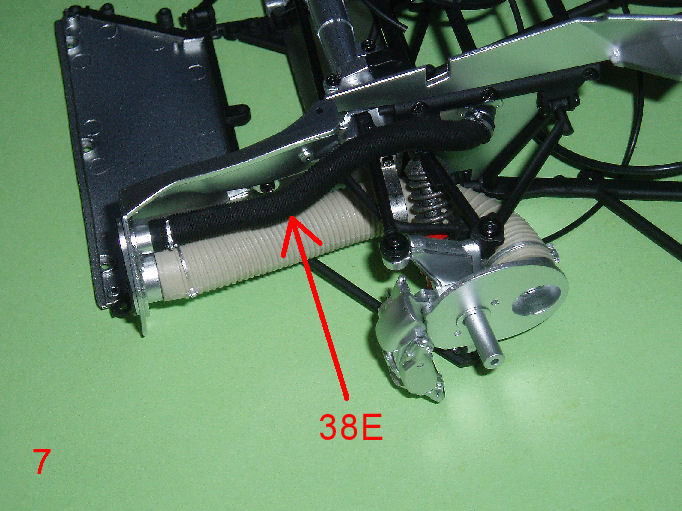

Pic 7: Fit the upper air duct 38E in place as shown.

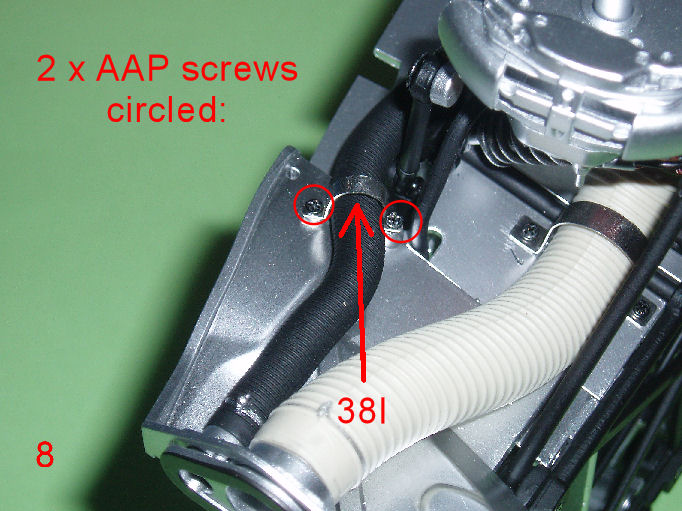

Pic 8: Fit the bracket 38I in place and fix with 2 x AAP screws.

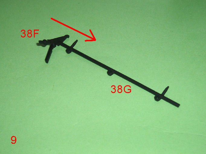

Pic 9: Press-fit the front frame support 38F onto the end of the frame bar 38G.

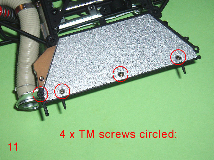

Pic 10: Fit the assembly in place on the front of the main frame as shown.
Pic 11: From underneath, fix the parts together with 4 x TM screws.

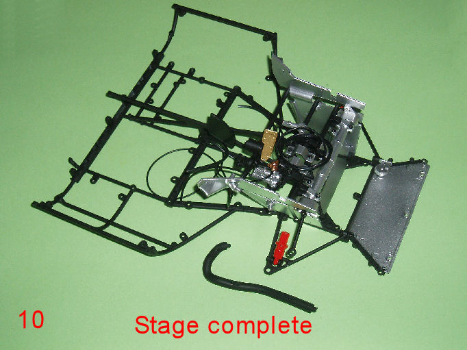

Pic 12: From the outside, fix the end of 38F in place using 1 x AM screw.
Pic 13: Store the assembly safely for now.
