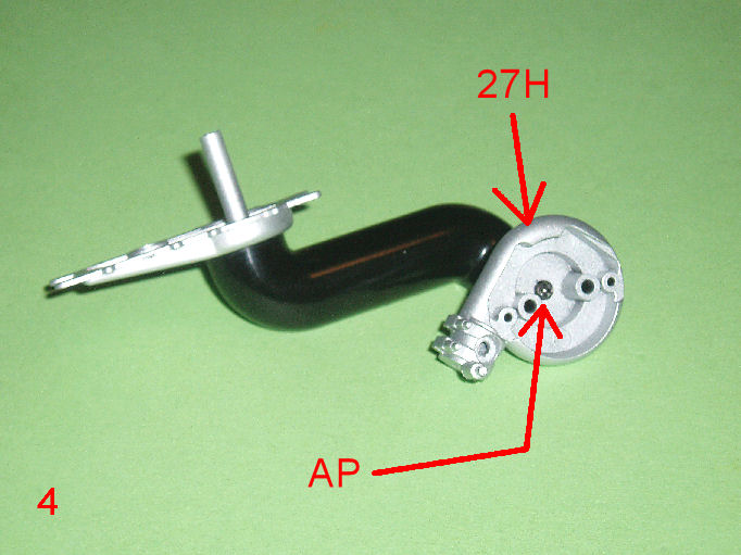

STAGE 27A:
Injection pump and turbocharger.

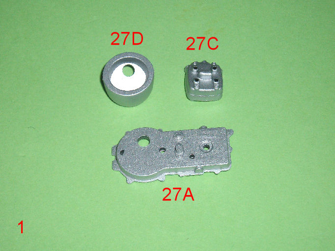

Pic 1: Locate the injection pump parts 27A, 27C and 27D.

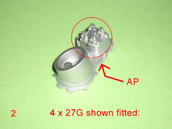

Pic 2: Press-fit the parts together as shown, securing 27C from underneath with 1 x AP screw.
Fit the 4 x pump fittings 27G as circled, aiming downwards.

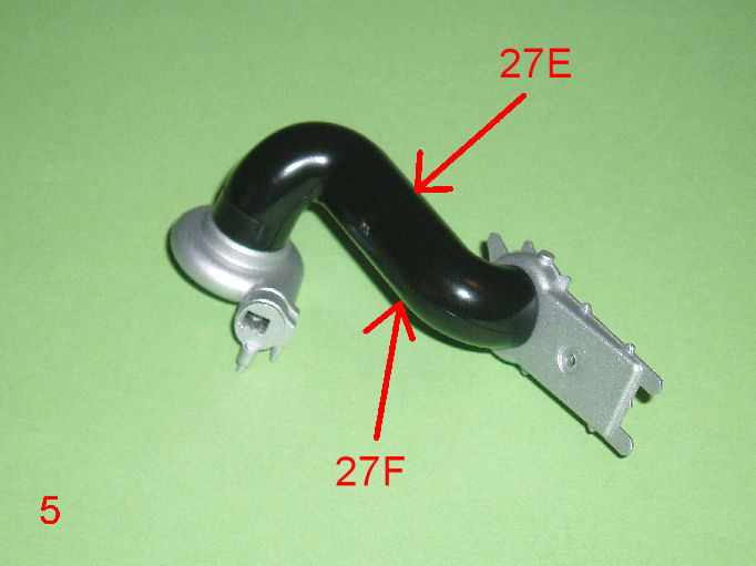

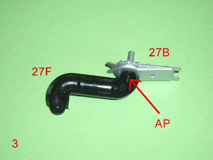

Pic 3: Fit the intake pipe half 27F as shown and fix with 1 x AP screw.
The parts have a small ‘keyway’ fitting so will only fit one way.
Pic 4: Fit the turbo part 27H as shown fixing it with 1 x AP screw.
Pic 5: Press-fit the other pipe half 27E as shown.

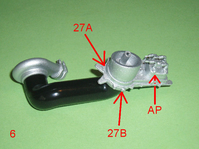

Pic 6: Fit the assembly 27A onto the base part 27B as shown and fix from underneath with 1 x AP screw.

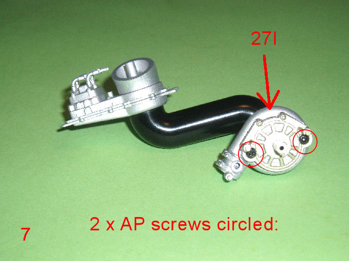

Pic 7: Fit the turbo cover 27I in place as shown and fix with 2 x AP screws.

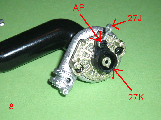

Pic 8: Fit the turbo hub and bracket 27K and 27J together as shown.
Note the small nut detail on 27J should be at the hub end.
Fix with 1 x AP screw.
Fit the assembly over the shaft on 27I.

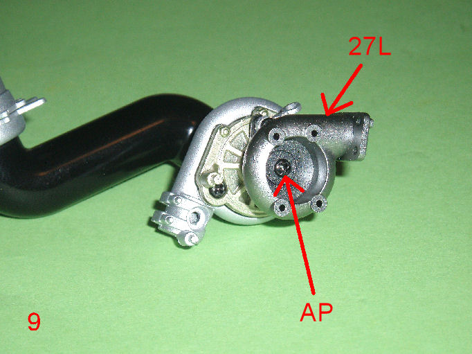

Pic 9: Fit the turbo manifold 27L and fix with 1 x AP screw.

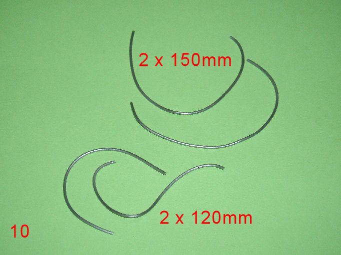

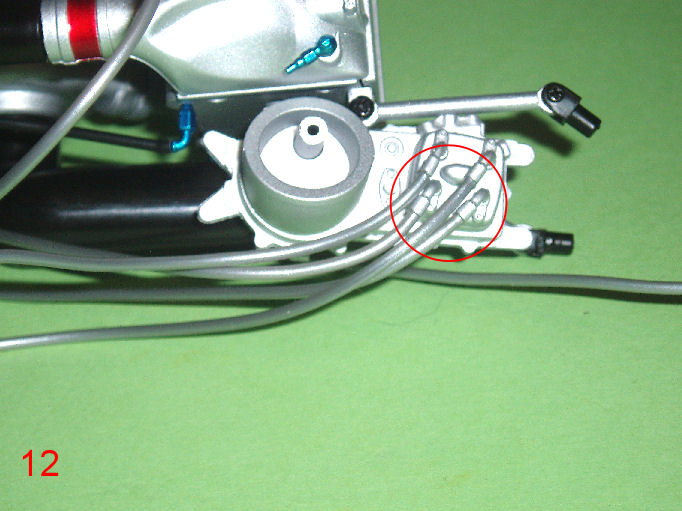

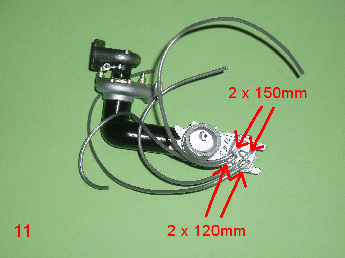

Pic 10: Cut 4 lengths of pipe from 27M to the sizes shown.

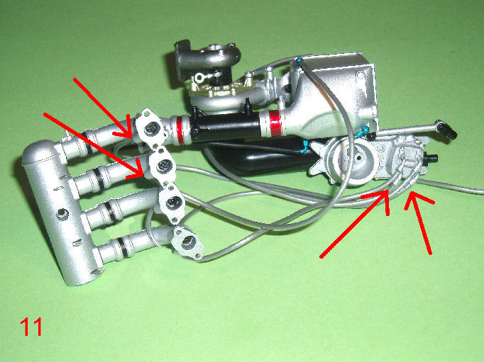

Pic 11: Fit the pipes to the injector fittings as shown with the 2 x 150mm pipes at the top and the 2 x 120mm pipes at the bottom.
Store the assembly safely.

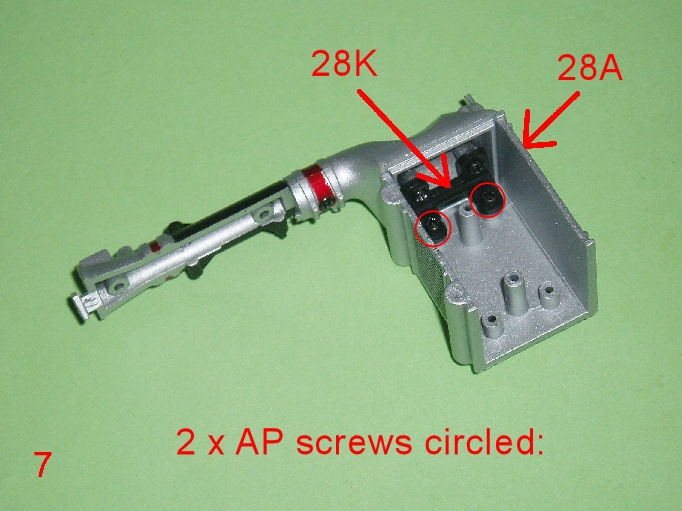

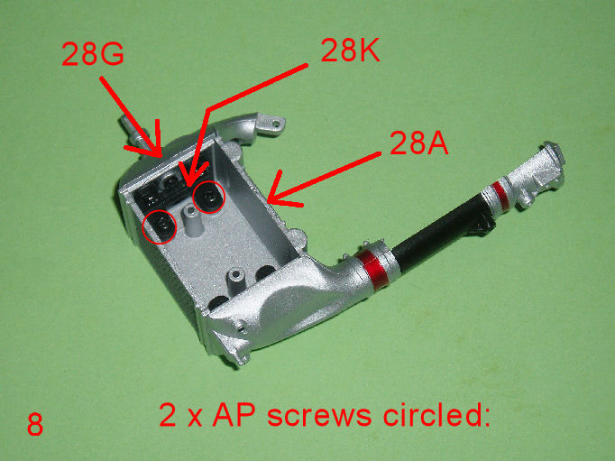

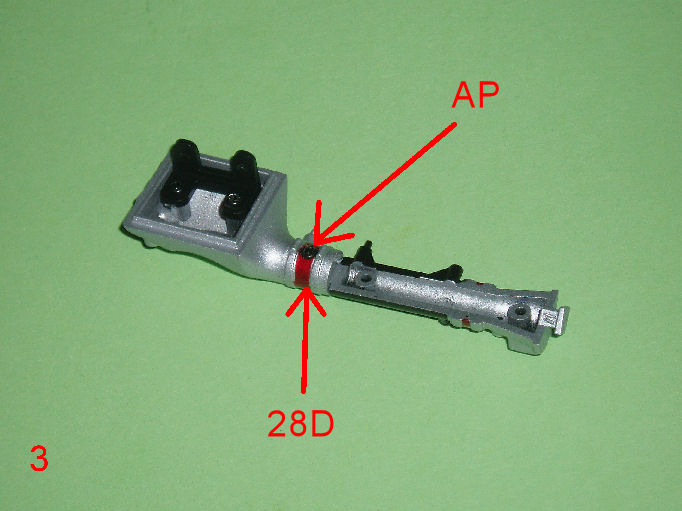

STAGE 28A:
Intercooler.

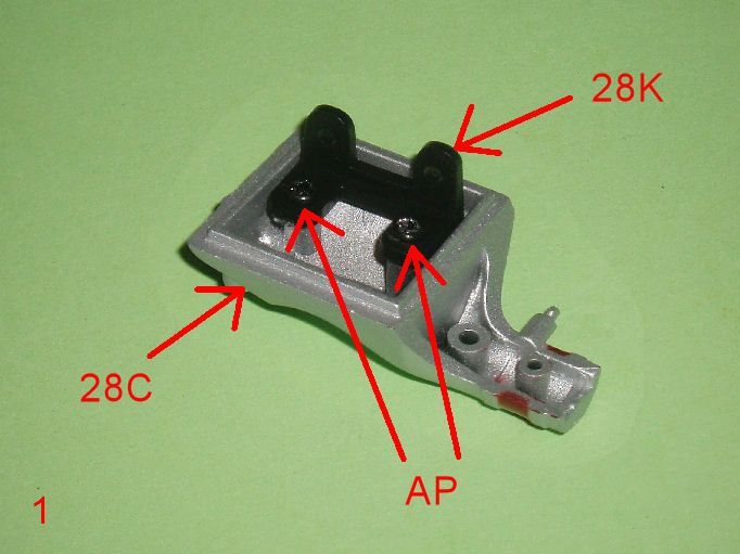

Pic 1: Fit the intercooler part 28C and bracket 28K together making sure the ‘square’ ends of the bracket locate on the posts inside the intercooler.
Fix with 2 x AP screws.

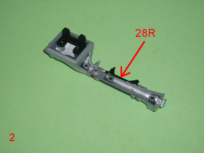

Pic 2: Fit the pipe half 28R as shown.
Pic 3: Fit the cap 28D and fix with 1 x AP screw.

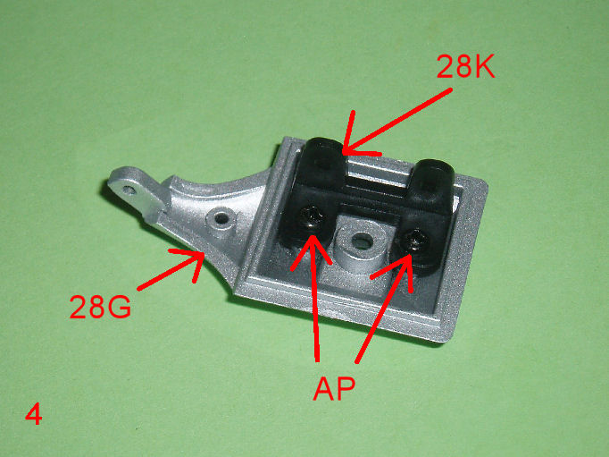

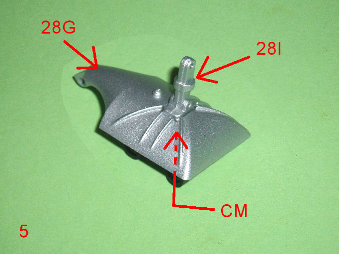

Pic 4: Fit the other bracket 28K to the intercooler part 28G in the same way as step 1 and fix with 2 x AP screws.
Pic 5: Fit the bottom bracket 28I into the hole in the top of 28G and fix from inside with 1 x CM screw.

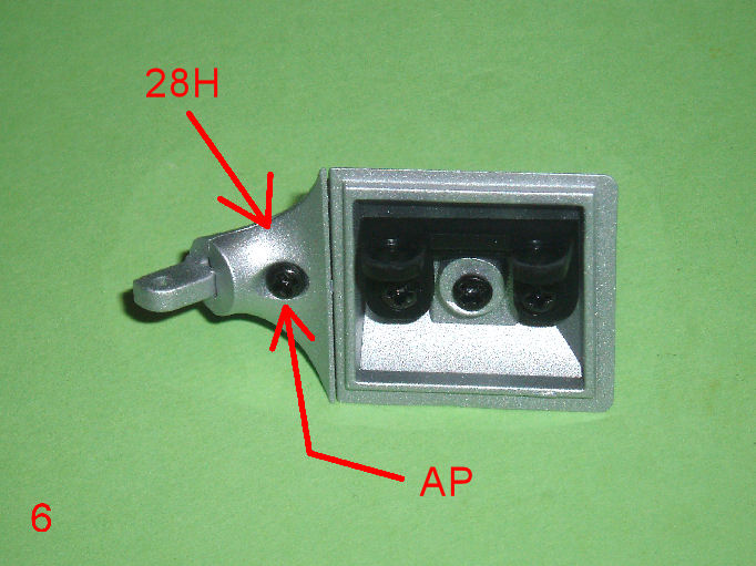

Pic 6: Fit the cap part 28H as shown and fix with 1 x AP screw.
Pic 7: Fit the assembly into the main intercooler 28A as shown.
Fix the bracket 28K using 2 x AP screws.
Pic 8: Fit the other end of the intercooler 28G as shown and fix through bracket 28K with 2 x AP screws.

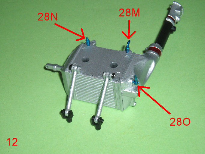

STAGE 28B:

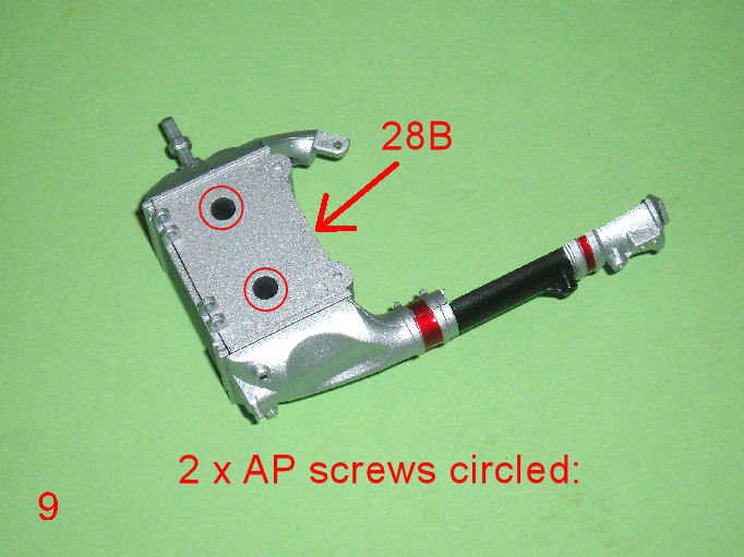

Pic 9: Fit the back panel 28B in place and fix with 2 x AP screws.

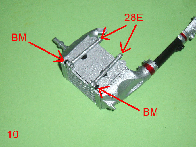

Pic 10: Fit the two support legs 28E to the intercooler as shown and fix from the outside using 2 x BM screws.

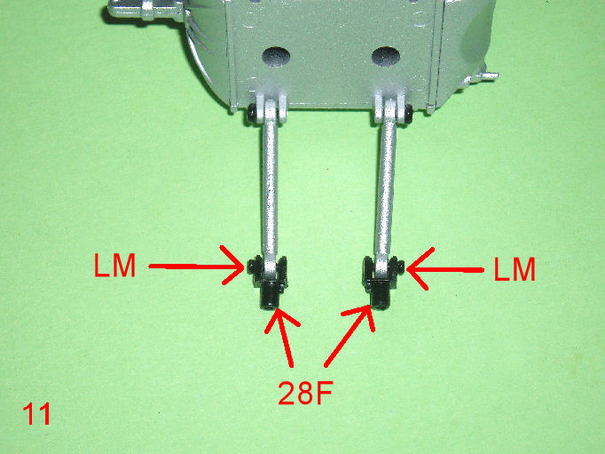

Pic 11: Fit the two end brackets 28F as shown and fix from the outside with 2 x LM screws.

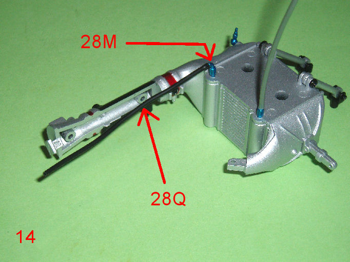

Pic 12: Fit the three hose connectors 28M, 28N and 28O in place as shown.

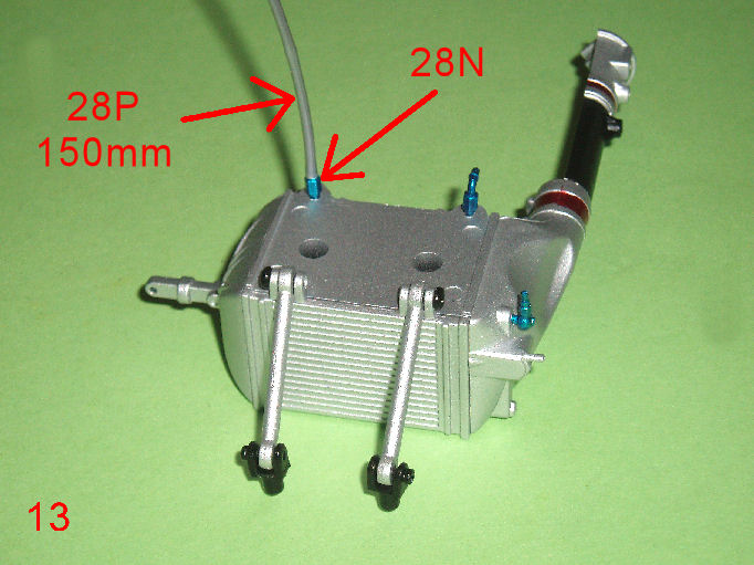

Pic 13: Cut a 150mm piece of hose from 28P and fit it to the end of the connector 28N.

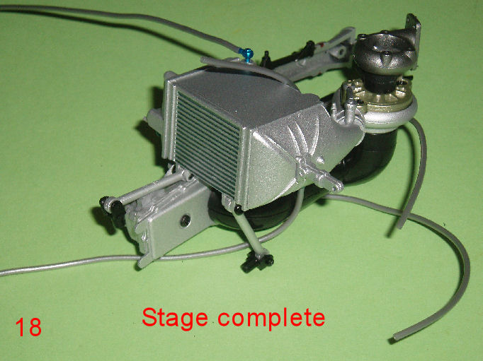

Pic 14: Fit the black hose 28Q to the connector 28M.

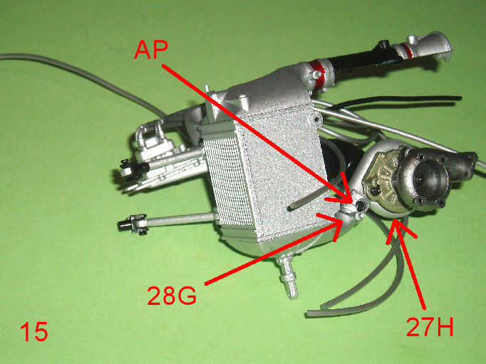

Pic 15: Retrieve the turbo assembly from the previous stage and fit it to the intercooler assembly as shown.
The tab on the end of 28G will fit inside the slot on the end of the turbo 27H.
Fix using 1 x AP screw.

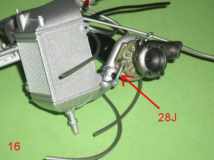

Pic 16: Fit the rear bracket 28J in place as shown.

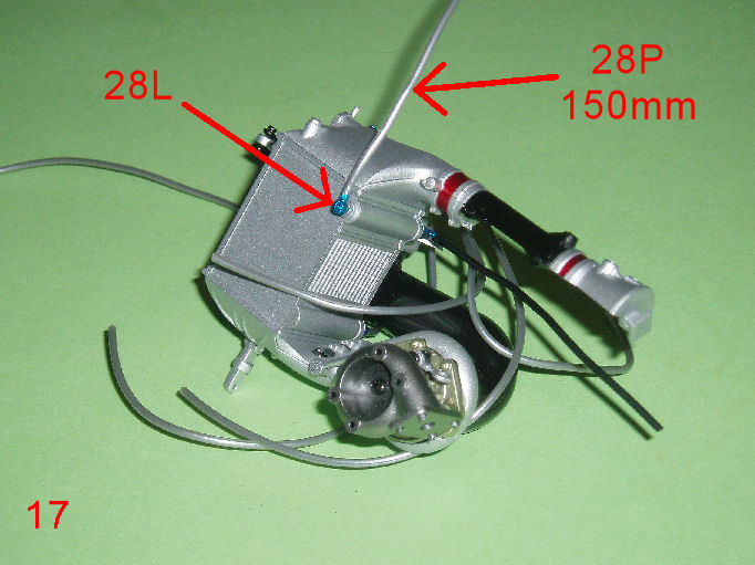

Pic 17: Fit the connector 28L to the intercooler and fit a 150mm piece of hose 28P as shown.
Pic 18: OPTIONAL DETAIL – You can add some contrast to the intercooler by colouring the grille slots using a fine black marker pen.
This is at the builder’s discretion.

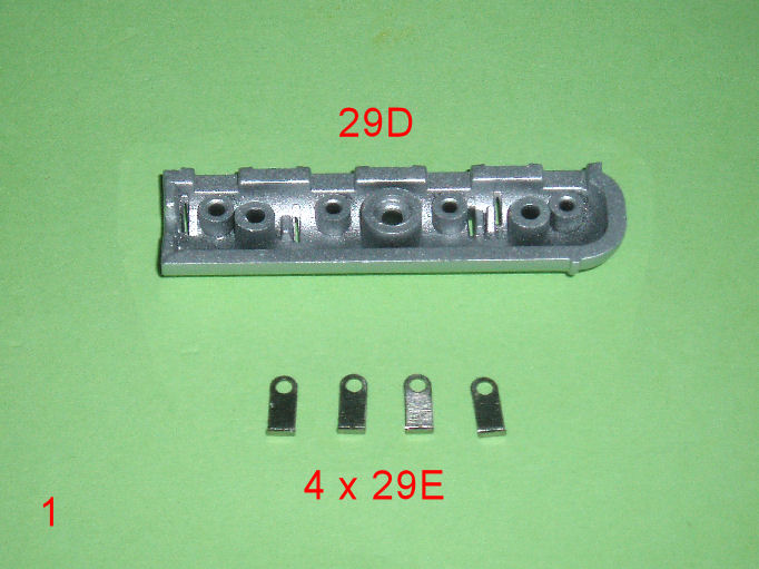

STAGE 29A:
Intake manifold.
NOTE: The printed instructions are missing some important steps.
These are detailed further on.

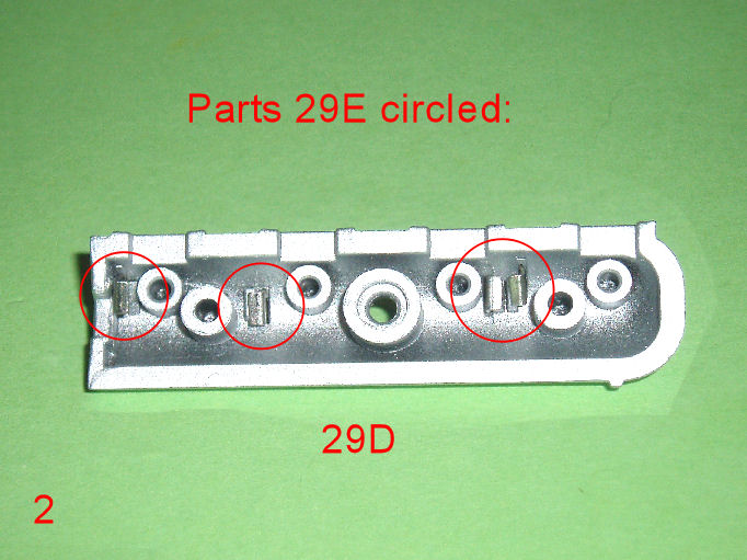

Pic 1: Locate the manifold part 29D and the 4 x brackets 29E.
Pic 2: From the inside, insert the brackets through the slots as shown.
Pic 3: Shows the brackets fitted.

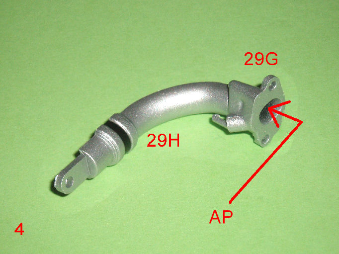

Pic 4: Fit the manifold cylinder and flange unit 29H and 29G together as shown and fix from the inside of 29G with 1 x AP screw.
DO NOT fully tighten the screw. The flange may need adjusting later.

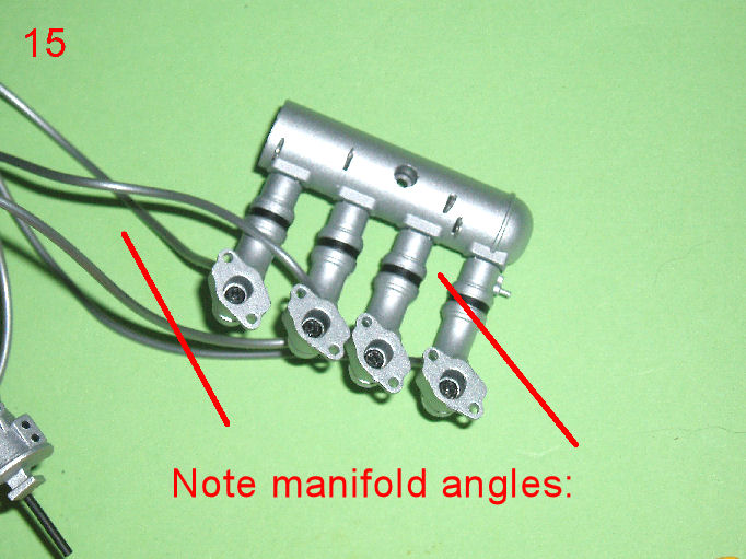

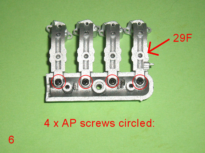

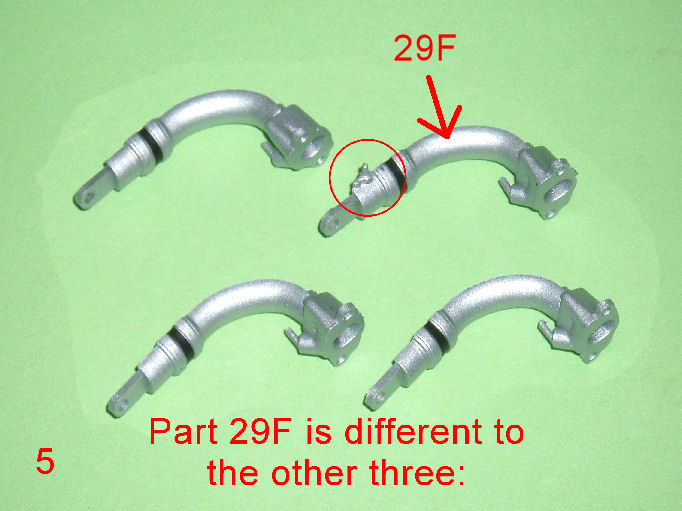

Pic 5: Assemble the other three sets of parts in the same way but note that 29F has a pin on one end that the other three do not have.
Make sure none of the screws are fully tightened.
Pic 6: Fit the manifold tube assemblies to the previously assembled manifold half as shown.
Note that 29F is at the right end of the assembly.
Fix the parts with 4 x AP screws.

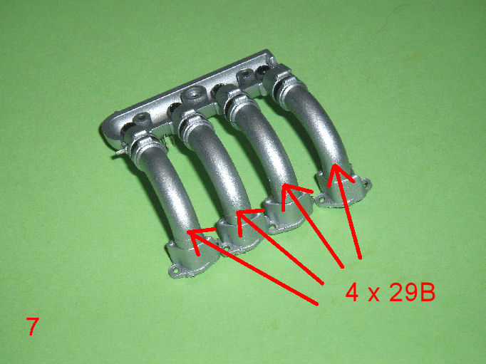

Pic 7: Press-fit the outer manifold tube parts 29B in place as shown.

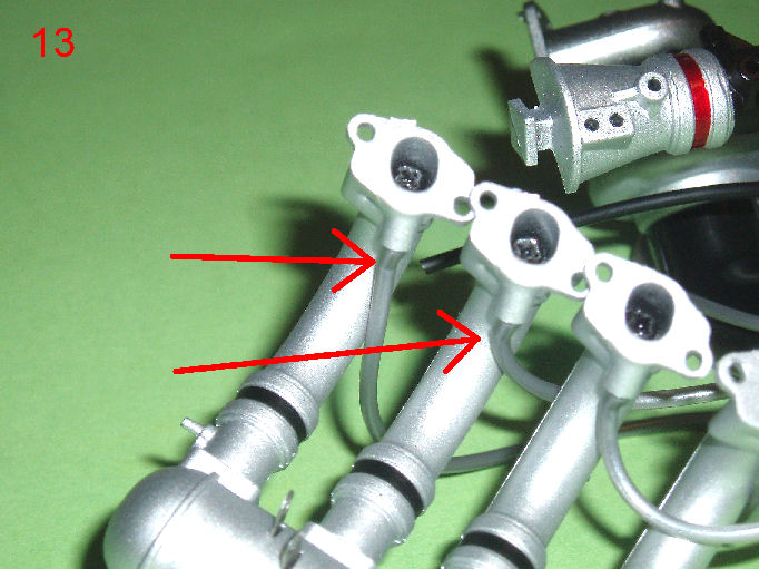

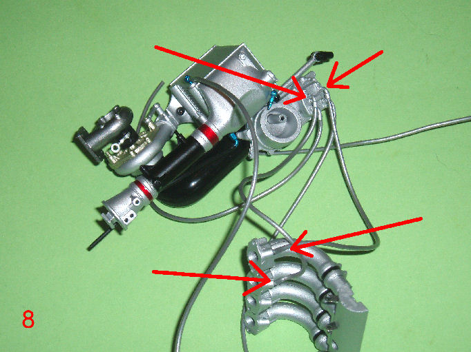

Pic 8: Retrieve the turbo intake assembly from the previous stage and fit the top two hoses from the group of 4 on the intake to the end two flanges on the manifold assembly as shown.

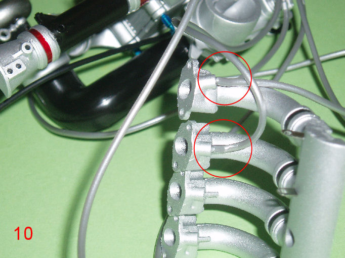

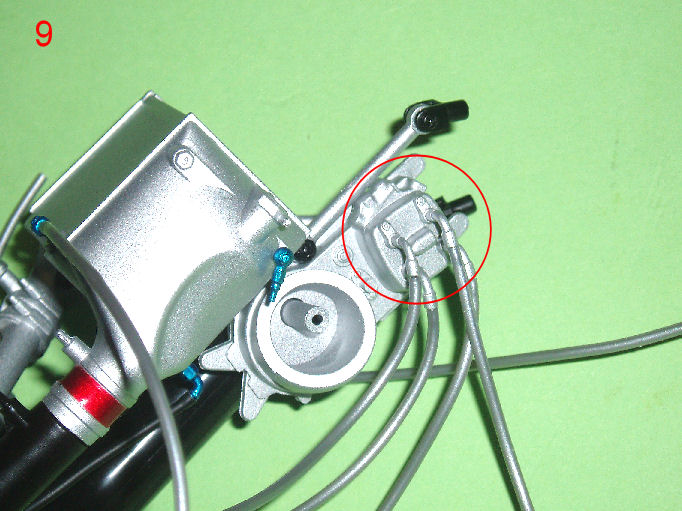

Pic 9: Shows a close up of the two hoses to use.
Pic 10: Shows a close up of where the hoses connect.
Pic 11: Fit the lower two hoses from the group of 4 on the intake to the other two flanges on the manifold assembly as shown.
Pic 12: Shows a close up of the two hoses to use.
Pic 13: Shows a close up of where the hoses connect.

Pic 15: Check that the manifold flanges are all angled as shown.
You should still NOT tighten the fixing screws in the centre.

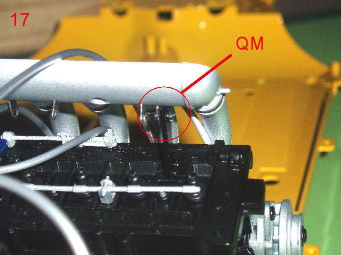

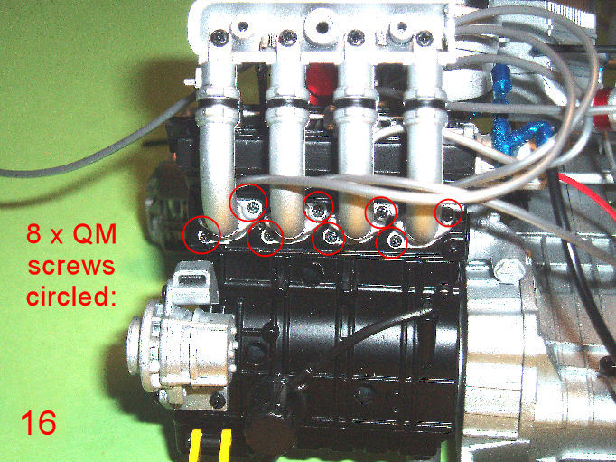

Pic 16: Fit the manifold to the engine as shown.
It now becomes clear why the manifold screws were not fully tightened as it will be easy to adjust each one into the correct position.
Fix the manifolds to the engine using 8 x QM screws.

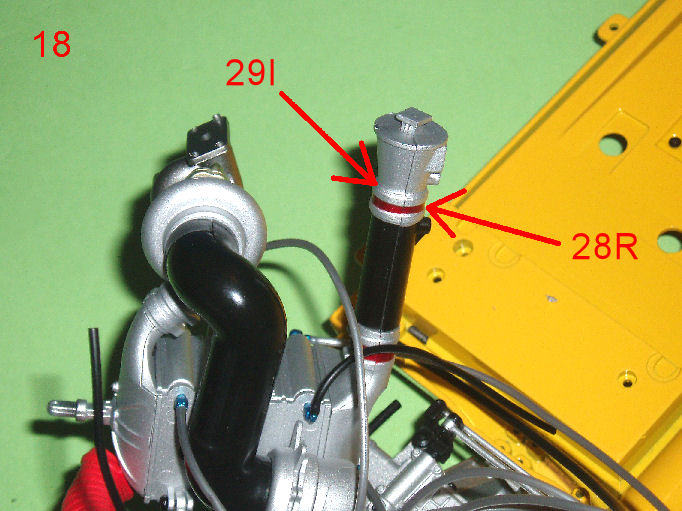

Pic 18: Press-fit part 29I onto 29R as shown.
Pic 19: Fit the turbo and intake assembly into place on the engine as shown.

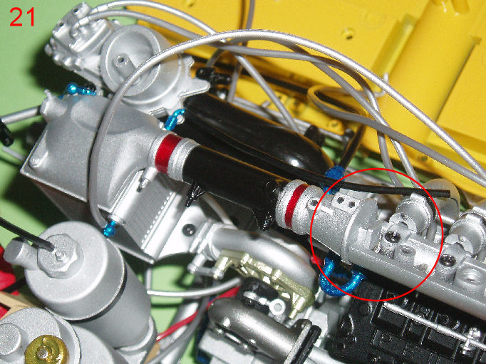

Pic 21: This shows where the end of the intake pipe will fit into the manifold on the engine.
The parts just clip together.

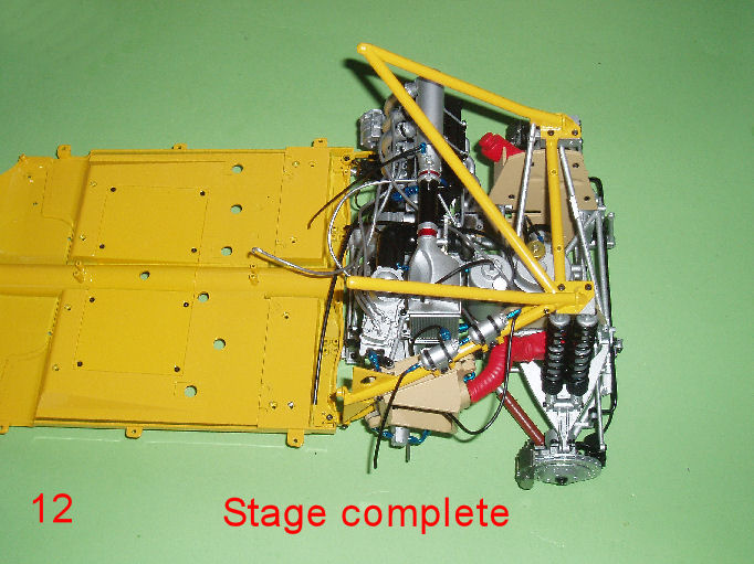

The build now continues in the same way as the printed instructions.

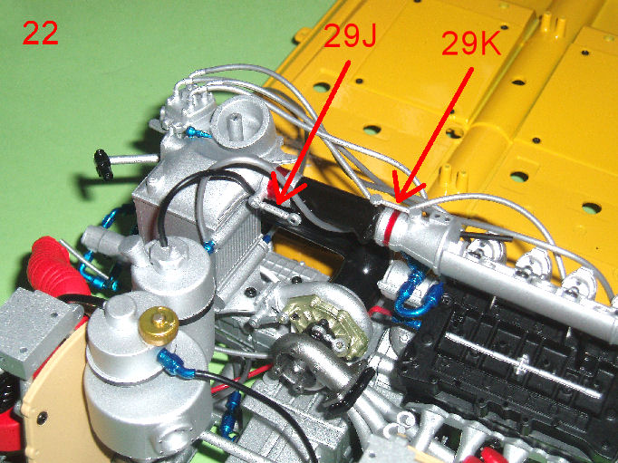

Pic 22: Fit the two brackets 29J and 29K as shown.

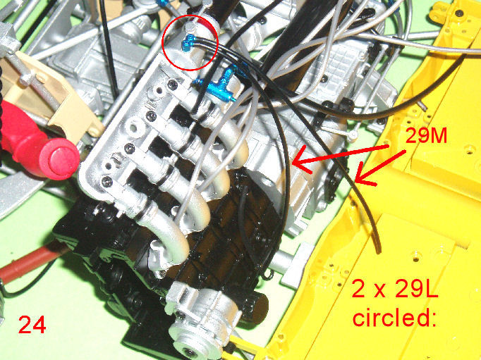

Pic 23: Cut the hose 29M into 2 x 100mm lengths.

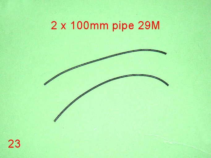

Pic 24: Fit the hoses onto the two unions 29L and then fit them both to the top of the manifold as shown.
Pic 25: Store the assembly safely for now.

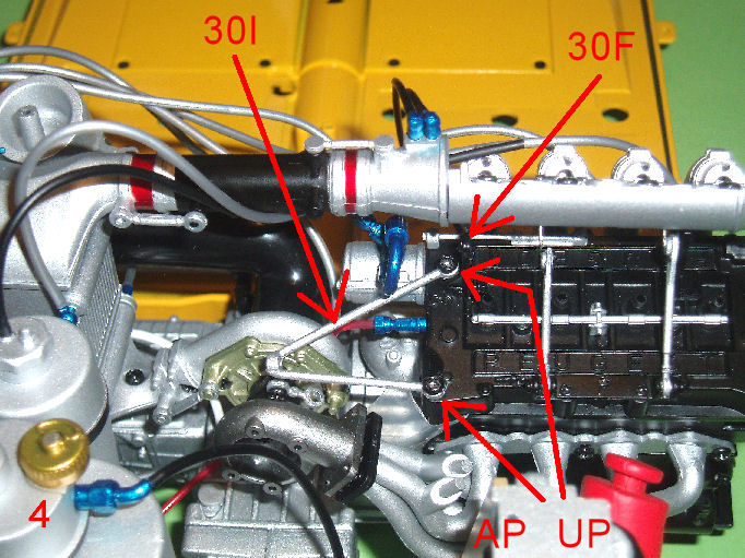

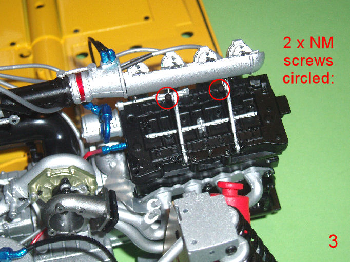

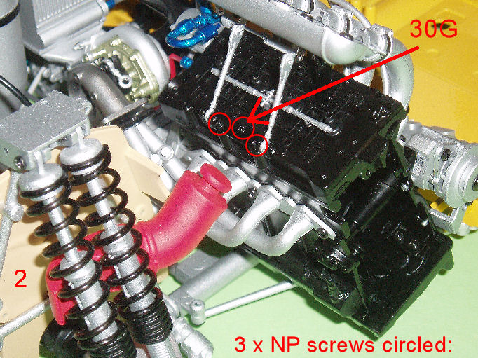

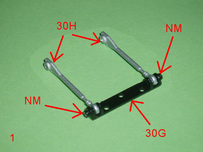

Pic 1: Locate the manifold tie rod parts 2 x 30H and 30G.
Fit them together as shown and fix using 1 x NM screw on each side, from the outside.
Pic 2: Fit the assembly to the exhaust side of the engine as shown and fix with 3 x NP screws.
Pic 3: Secure the top ends of each arm 30H to the two centre brackets 29E on the air box.

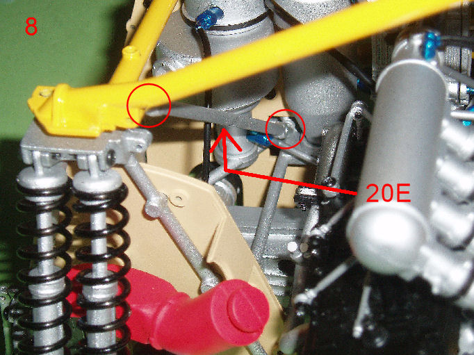

Pic 4: Fit the black angled bracket 30F to the hole on the top left rear of the engine.

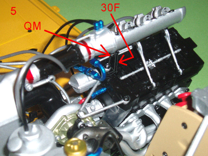

It will only fit one way.
Fit the angled tie rod 30I in place and fix with a UP screw at the rear, going through the bracket 30F, and 1 x AP screw at the front.

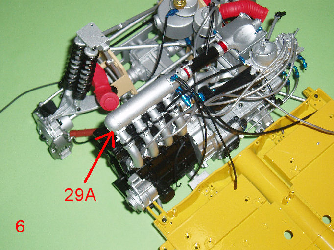

Pic 5: Fix the top of the black angled bracket 30F to the left tab 29E on the air box using 1 x QM screw.
Pic 6: Press-fit the upper air box cover 29A in place as shown.
Pic 7: Fit the connecting rod 27J to the bracket 30I using 1 x AM screw.

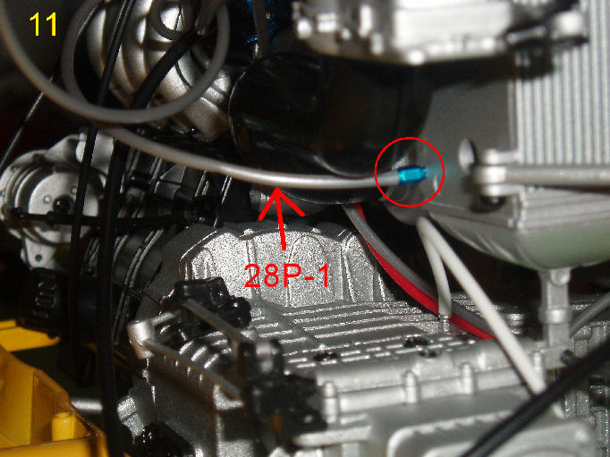

STAGE 30B:

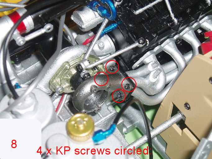

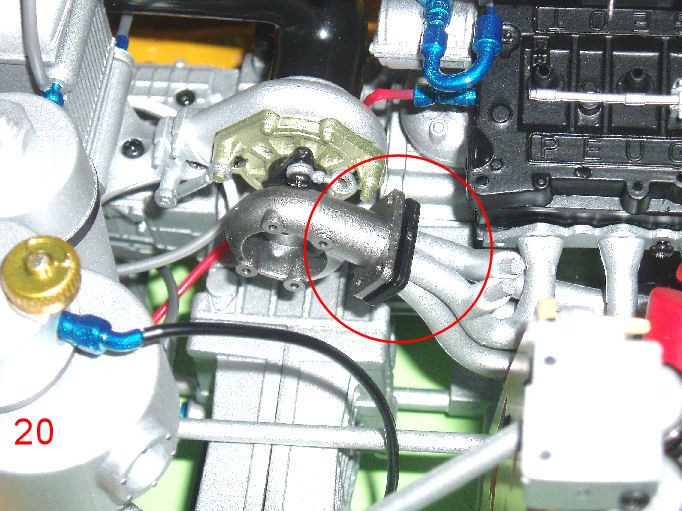

Pic 8: Connect the flange on the turbo unit to the exhaust manifold using 4 x KP screws.
The locating pin on the turbo will fit into the ‘D’ shaped hole in the exhaust.

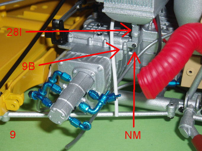

Pic 9: Fit the post on the bottom of the air-box 28I into the bracket on the casing 9B and fix with 1 x NM screw.

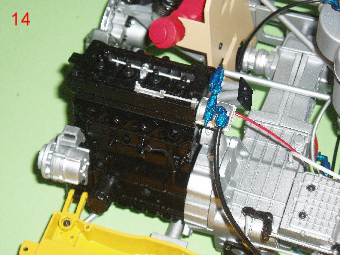

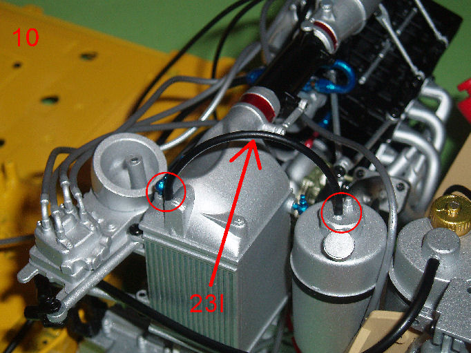

Pic 10: Connect the hose 23I between the two units as shown.
Pic 11: Locate the long hose 28P-1 which is fitted to the bottom left of the air-box.
Pic 12: Connect the other end of the hose 28P-1 to the upper pin on the blue connector 14F.

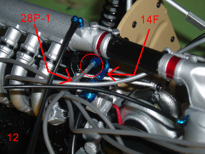

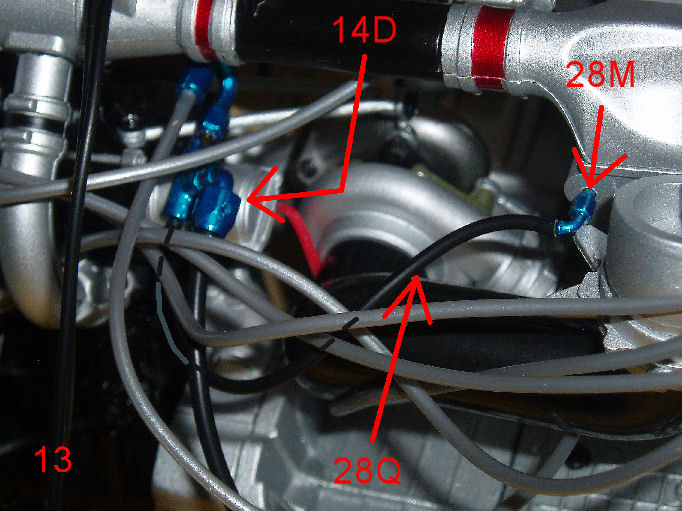

Pic 13: Connect the black hose 28Q between the connector 28M on the intake manifold and the lower pin on the connector 14D.

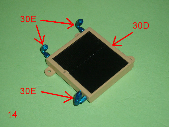

Pic 14: Press-fit the 3 x connectors 30E into the locating holes in the sides of the radiator 30D as shown.
Make sure they are facing the right way.

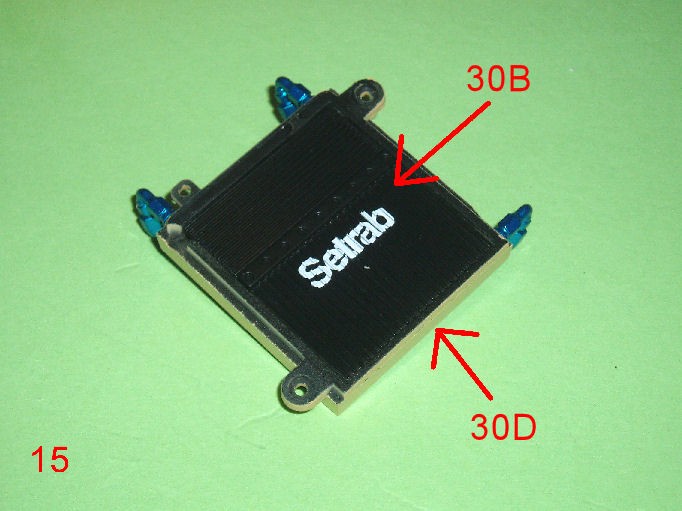

Pic 15: Turn the radiator over and press-fit the other part 30B in place.

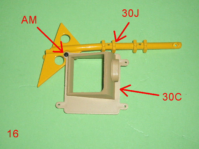

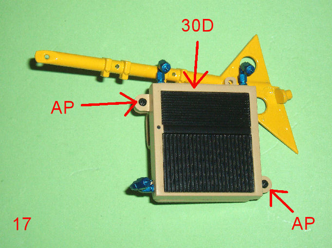

Pic 16: Fit the radiator shroud 30C to the retaining arm 30J as shown and fix with 1 x AM screw.
Pic 17: Fit the radiator assembly into the shroud and fix with 2 x AP screws.

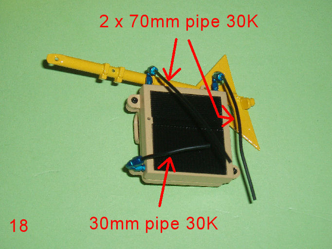

Pic 18: Locate the pipe 30K and cut it into 2 x 70mm lengths and 1 x 30mm length.
Fit the pipes to the relevant connectors as shown.

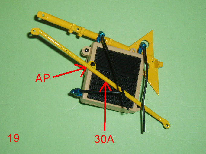

Pic 19: Fit the retaining bar 30A in place and fix with 1 x AP screw.

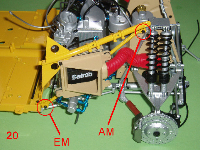

Pic 20: Fit the assembly to the side of the engine and frame as shown.
The retaining bar 30A will fix at each end using 1 x EM screw in the lower chassis bracket and 1 x AM screw in the upper silver frame.

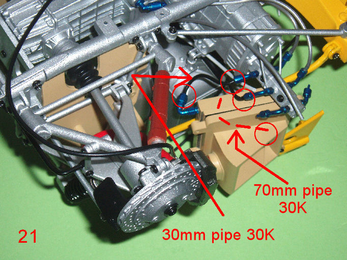

Pic 21: Turn the whole assembly over and locate the 70mm hose from the top right of the radiator, fitted in step 18.
Connect the pipe to the middle blue connector on the engine as shown.
Locate the 30mm pipe fitted in step 18 and connect it to the left connector on the engine.

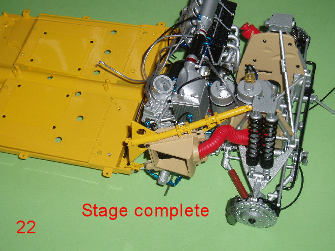

Pic 22: Store the assembly safely for now.

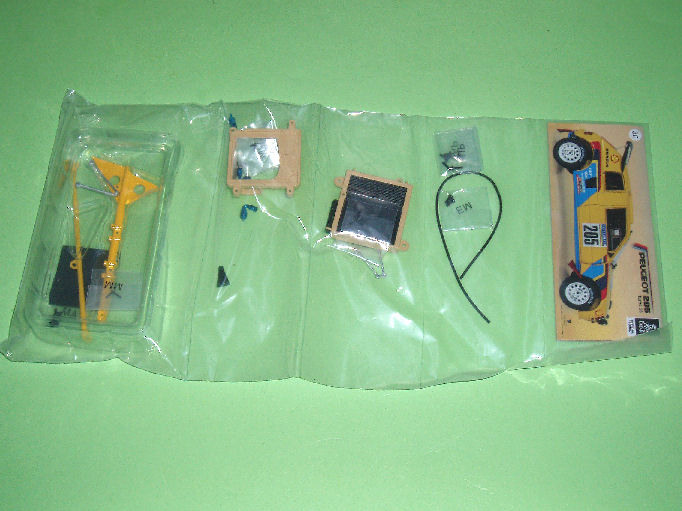

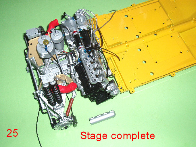

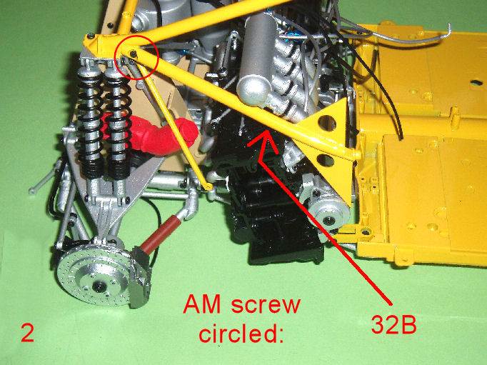

#11 Posted : 10 September 2025 10:48:30
Posts: 5,188

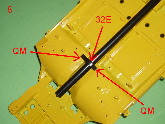

Points: 15,713

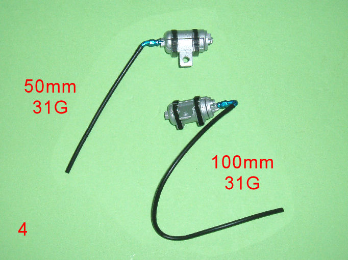

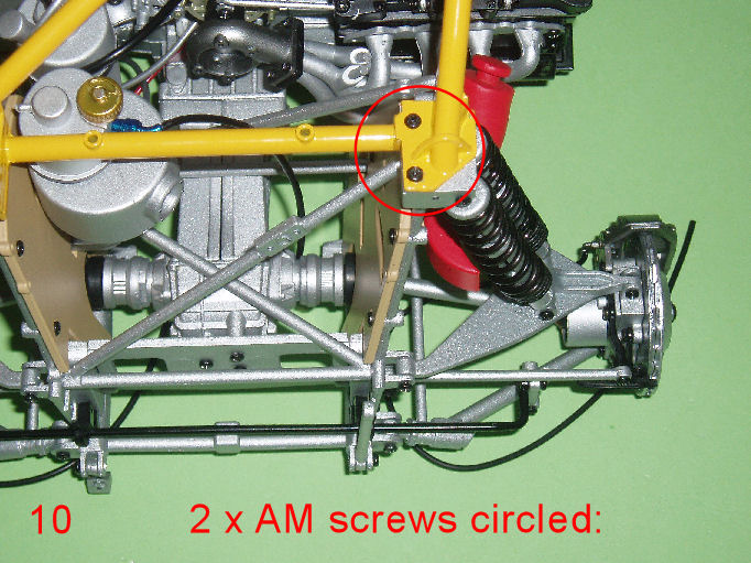

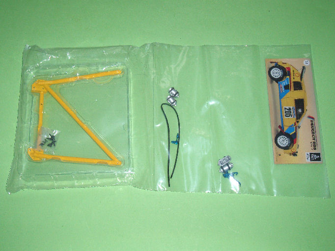

STAGE 31A:

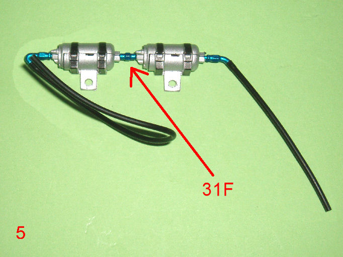

Fuel pumps.

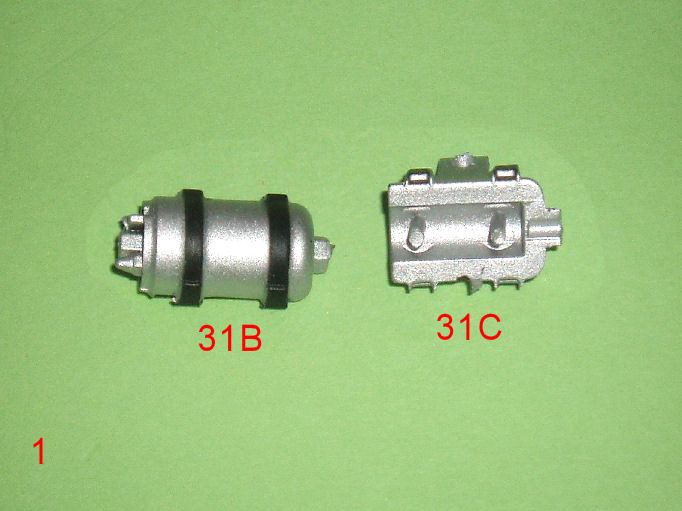

Pic 1: Locate the fuel pump parts 31B and 31C.
Pic 2: Press-fit the parts together as shown and assemble two sets.

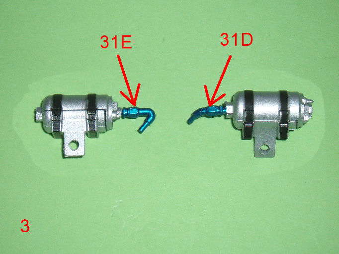

Pic 3: Press-fit the fuel line connectors 31D and 31E into place as shown.
You can distinguish the parts by the angle of the bends in the pipes.
Pic 4: Cut the hose 31G into two lengths of 50mm and 100mm.
Fit the pipes to the relevant connector as shown.

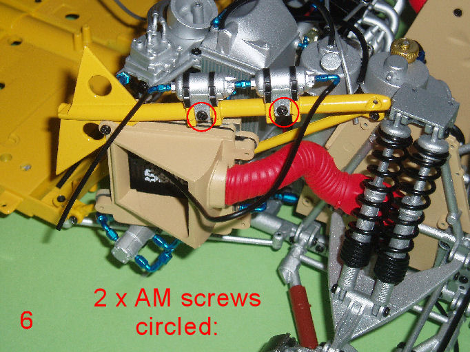

Pic 5: Join the pumps together using part 31F.

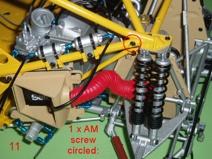

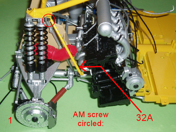

Pic 6: Fit the pumps to the upper engine frame as shown and fix with 2 x AM screws.

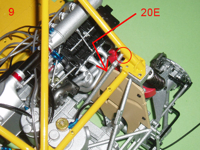

STAGE 31B:
Pic 7: Fit the new upper frame 31A to the assembly as shown and fix with 2 x AM screws on the left flange.
Pic 8: Retrieve the support bar 20E saved from stage 20 and fit it as shown with the lower end located in the hole circled.
The upper end will locate just behind the yellow frame shown.
Pic 9: This shows the location of the upper end of the part 20E.
Pic 10: Fix the right upper frame 31A as shown with 2 x AM screws through the flange.
Pic 11: Fix the fuel pump support arm to the main frame using 1 x AM screw.
Pic 12: Store the assembly safely for now.

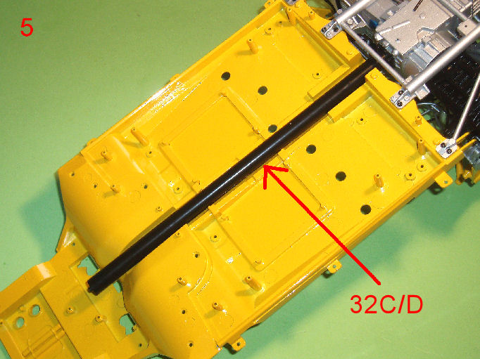

STAGE 32:
Right rear chassis and prop shaft.
Pic 1: Locate the frame bar 32A and fit it to the chassis as shown.
Fix with 1 x AM screw at the upper end.
Pic 2: Fit the larger cross bar 32B as shown and fix with 1 x AM screw at the left end.

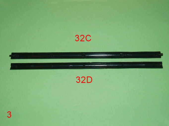

Pic 3: Locate the prop shaft parts 32C and 32D.
Pic 4: Press-fit the parts together.
Pic 5: Retrieve the main assembly and place it upside down.
Fit the prop shaft in place as shown with the larger fitting on one end going into the transmission case.
Pic 6: Fit the retaining bracket 32E in place and fix with 2 x QM screws.
Store the model safely for now.
