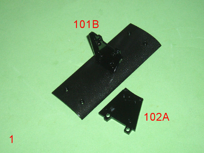

Pic 1: Retrieve the assembly 101A/B from the previous stage and locate the wing column 102A.

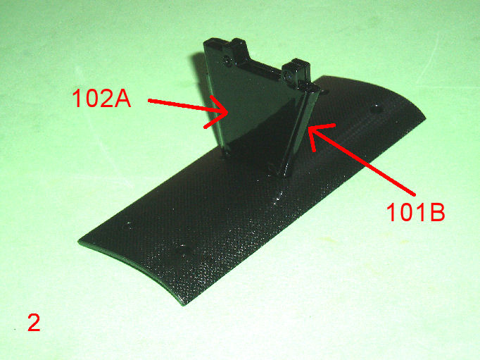

Pic 2: Fit the column half 102A against the other half 101B.

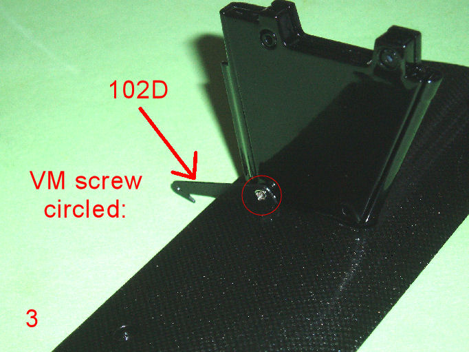

Pic 3: Fit the wing support hook 102D in place as shown and fix with 1 x VM screw.

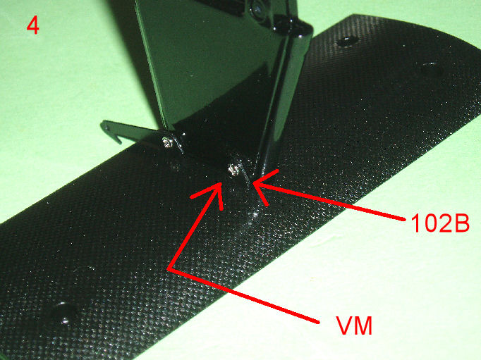

Pic 4: Fit the bracket 102B into the slot against the column as shown and fix with 1 x VM screw.

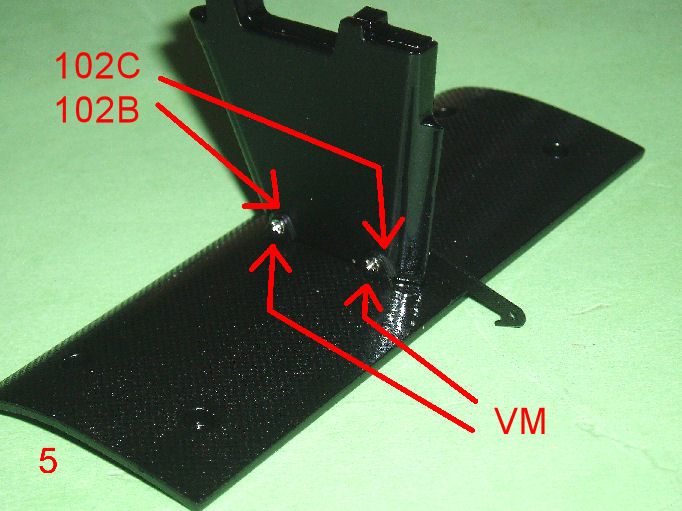

Pic 5: Turn the assembly around and fit the brackets 102B and 102c in the same way.
102C is identified as it has a shorted end to fit into the wing slot.
Fix each part using 1 x VM screw.

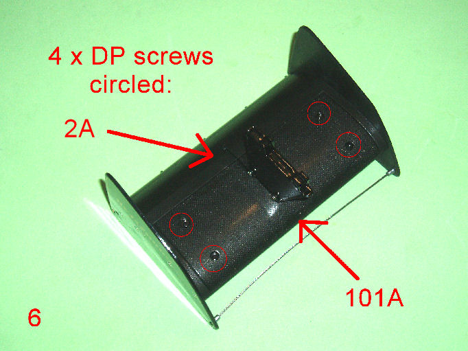

Pic 6: Retrieve the main wing assembly from stages 1 and 2 and fit the new parts in place as shown.
Make sure the hook on the wing support is under the main wing.
Fix together with 4 x DP screws.

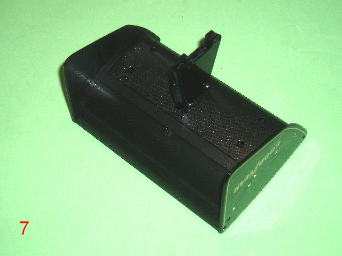

Pic 7: Shows the assembly from the other side.

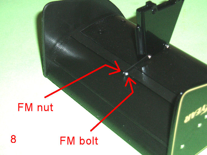

Pic 8: Make sure the hook on the wing support is under the main wing and located beside the bracket and fit the nut and bolt FM to fix the parts together.

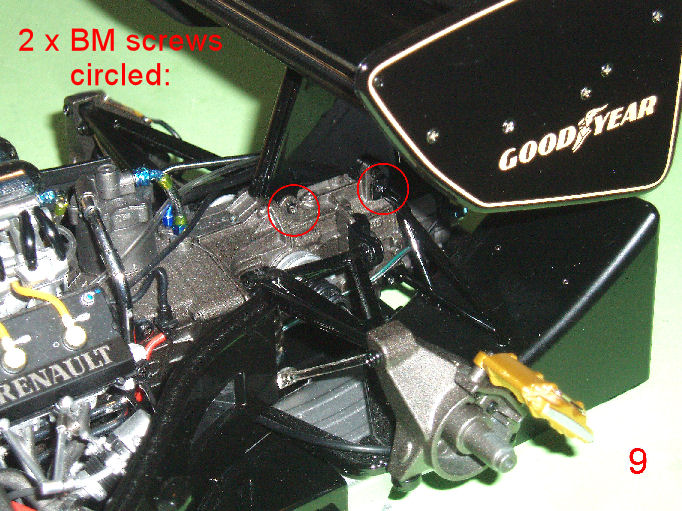

Pic 9: Fit the wing column up against the two locating brackets on the transmission case and fix using 2 x BM screws.

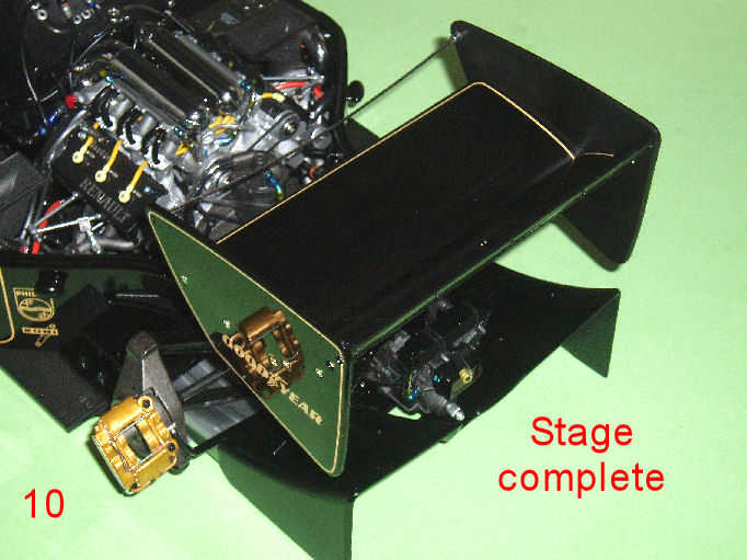

Pic 10: Shows the rear wing fitted to the car.
Store the model safely for now.

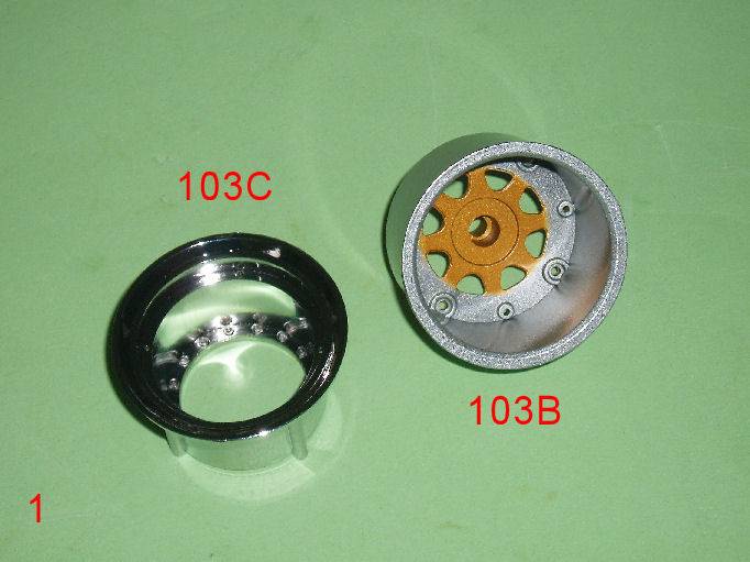

Rear right wheel:

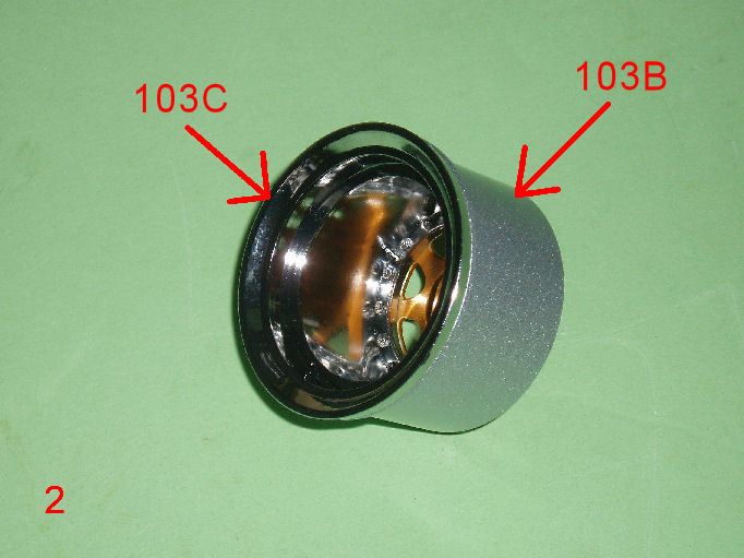

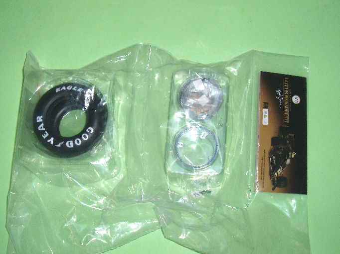

Pic 1: Locate the wheel parts 103B and 103C.
Pic 2: Fit the two parts together as shown making sure the screw locations line up on the inside.
Pic 3: From the other side, fix the parts together with 4 x DP screws.

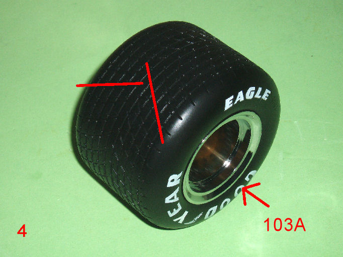

Pic 4: Press the assembly into the tyre making sure the tread pattern is as shown.

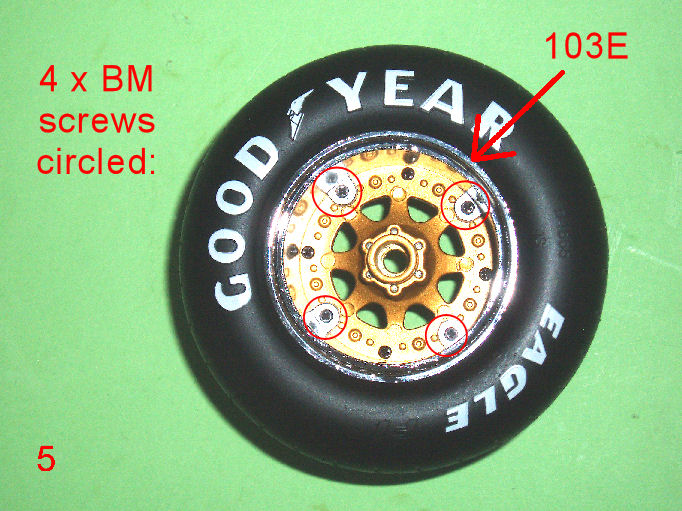

Pic 5: Locate the rear rim 103E.
Pic 6: Fit this in place, again making sure the screw locations are in line on the inside.
Fix with 4 x BM screws.

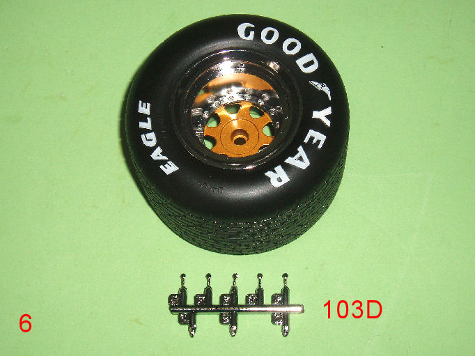

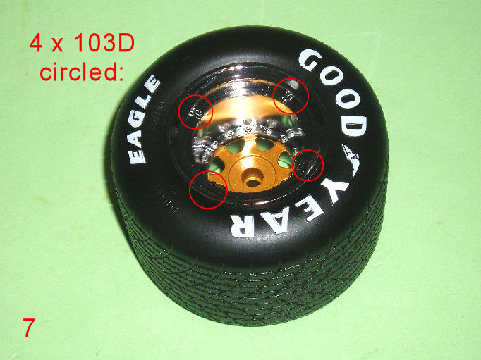

Pic 7: Locate the bolt sprue 103D.
Pic 8: Cut 4 x 103D bolts from the sprue and fit them into the holes in the outer rim.
The black bolt faces should point inwards.

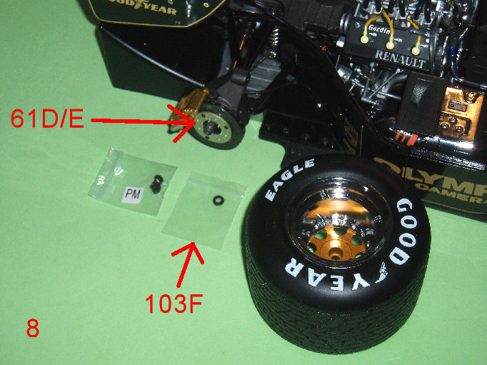

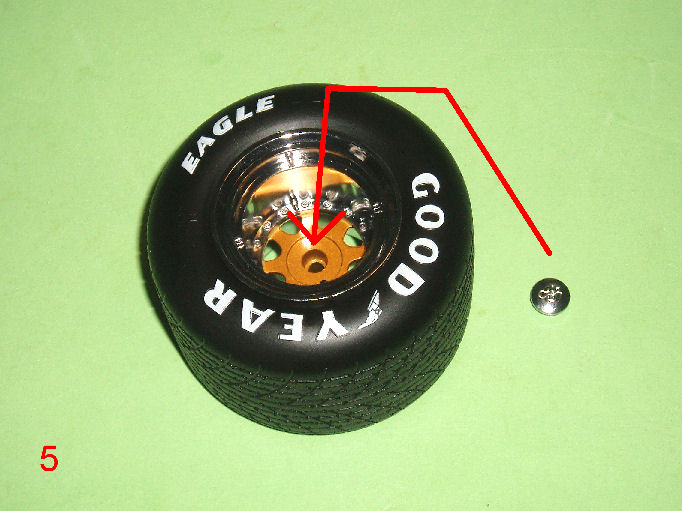

Pic 9: The printed instructions suggest you now fit the wheel.
First, fit the assembled brake disc 61D/E as shown, and then fit the wheel in place.
The washer 103F is fitted to the wheel centre next and then everything is secured using 1 x PM screw.
This stage has not been done here as the wheels are a very heavy element of the model and it might be advisable to fit them at the end of the build, when the model is no longer going to be turned upside down or moved about for assembly purposes.
This is of course at the builder’s discretion.

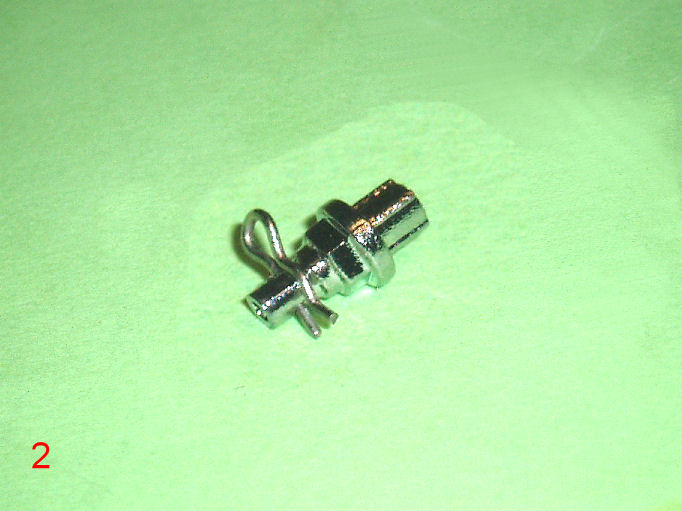

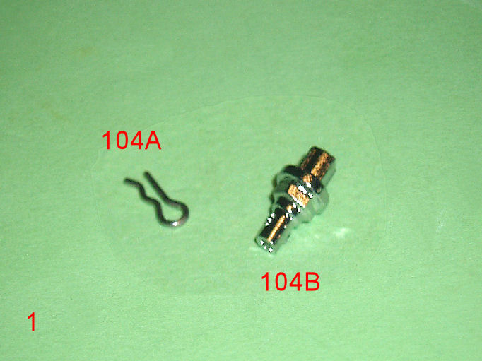

Pic 1: Locate the hub 104B and the circlip 104A.
Pic 2: Fit the parts together as shown.

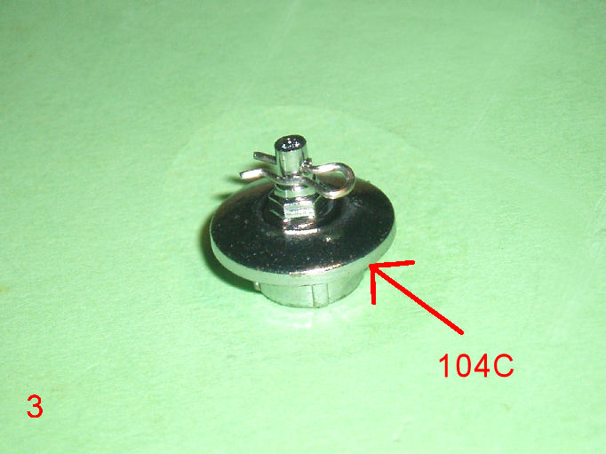

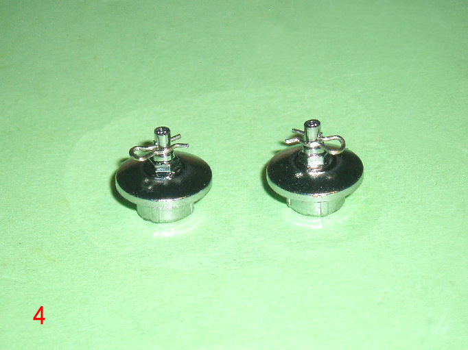

Pic 3: Press-fit the parts into the hub base 104C.
Pic 4: Assemble the other hub in the same way.
