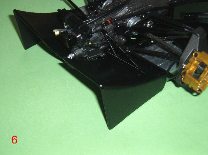

STAGE 97:
Rear diffuser arms:

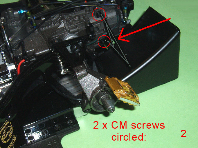

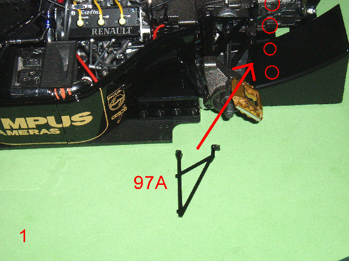

Pic 1: Locate the left diffuser arm 97A.
Note the four locating points on the model.
Pic 2: Fit the arm in place as shown. The fixing tabs on the upright end should be facing forwards.

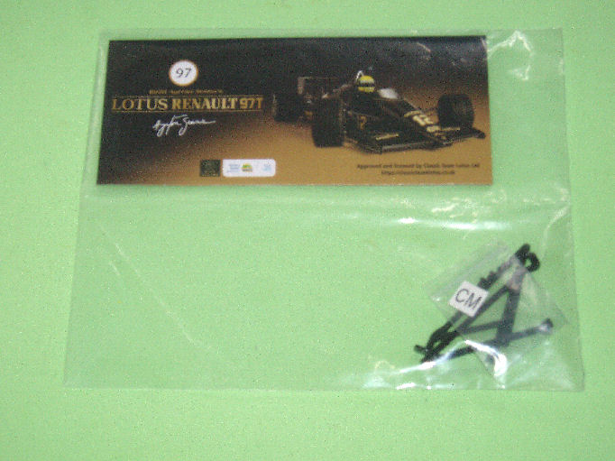

The two pegs on the lower arm locate in the holes on the top of the diffuser.
Fix using 2 x CM screws as shown

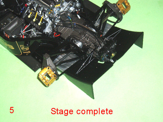

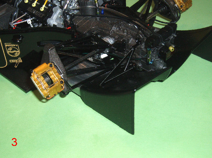

Pic 3: Shows the assembly from behind.

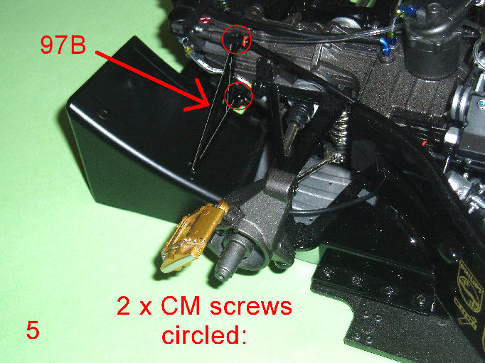

Pic 4: Locate the right diffuser arm 97B. It will fit to the car as before.
Pic 5: Fit the arm in place as shown. The fixing tabs on the upright end should be facing forwards.
Fix using 2 x CM screws as shown.
Pic 6: Shows the assembly from behind.
Store the model safely.

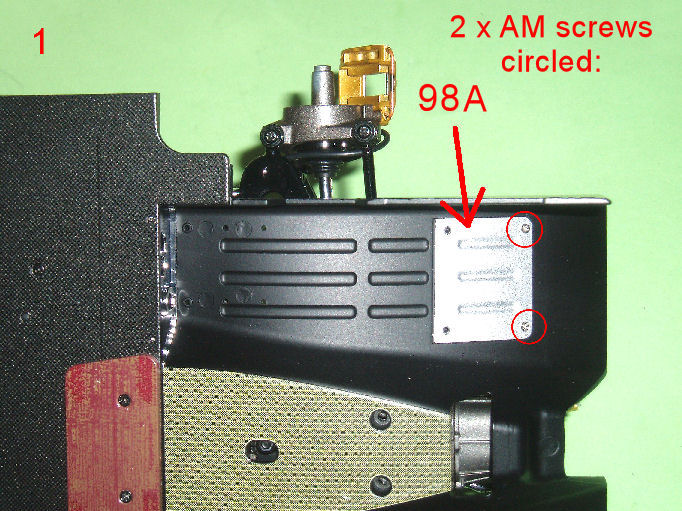

Rear left heat shield:
Pic 1: Fit the rear heat shield 98A as shown and fix with 2 x AM screws in the rear two holes.

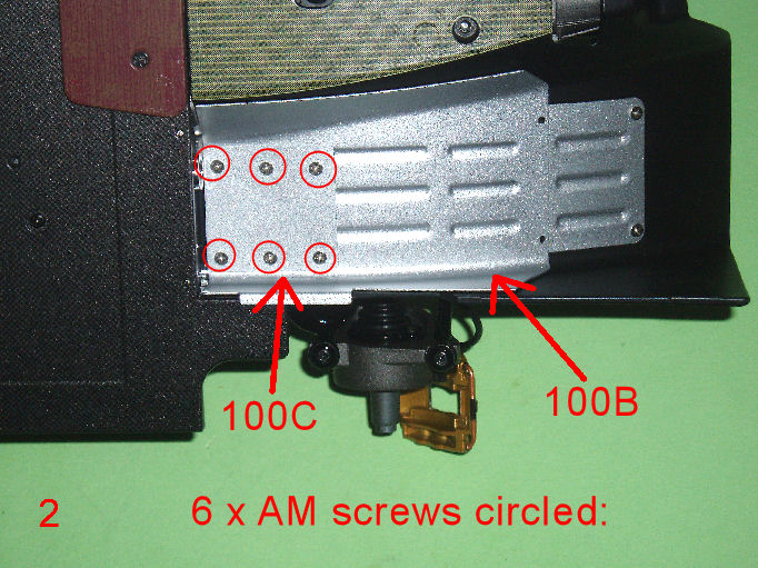

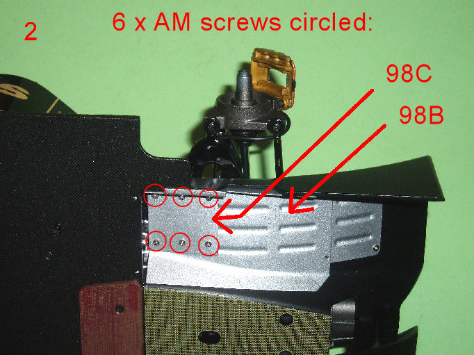

Pic 2: Fit the large heat shield 98B in place next, then the smaller shield 98C on top at the front end.
Fix the parts to the diffuser with 6 x AM screws.

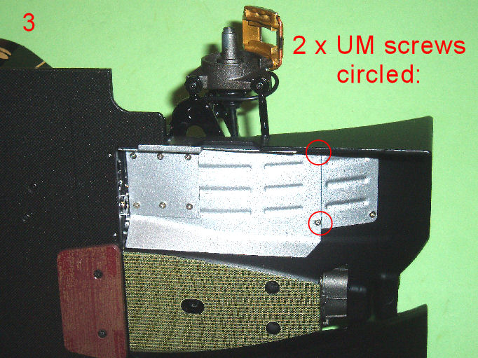

Pic 3: Fix the large diffuser 9B through the rear diffuser 98A and into the diffuser support arm using 2 x UM screws.

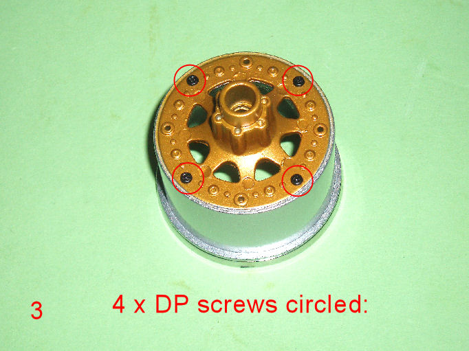

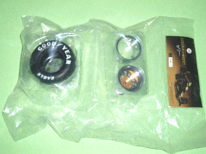

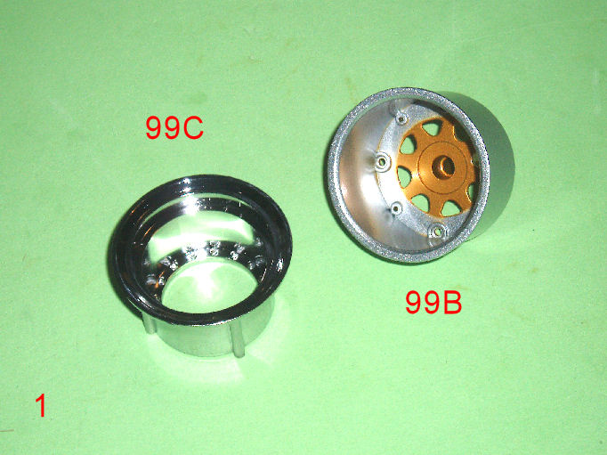

Pic 1: Locate the wheel parts 99B and 99C.

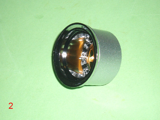

Pic 2: Fit the two parts together as shown making sure the screw locations line up on the inside.
Pic 3: From the other side, fix the parts together with 4 x DP screws.

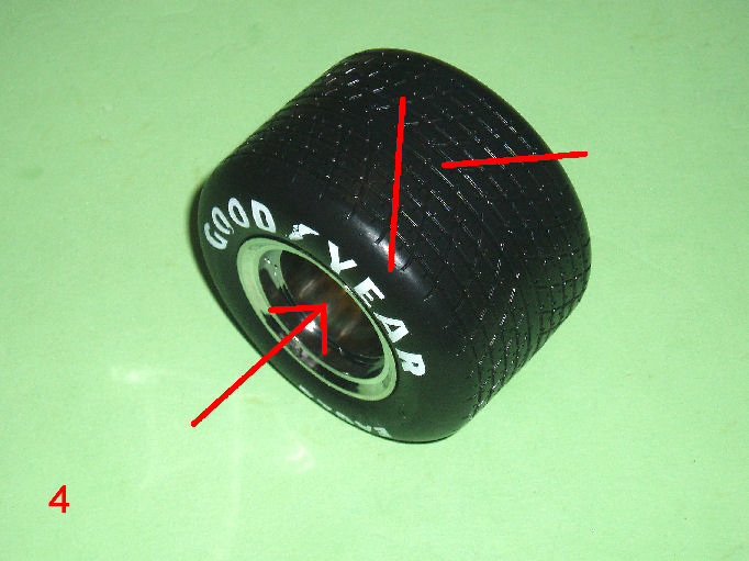

Pic 4: Press the assembly into the tyre making sure the tread pattern is as shown.

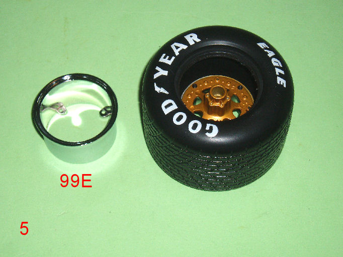

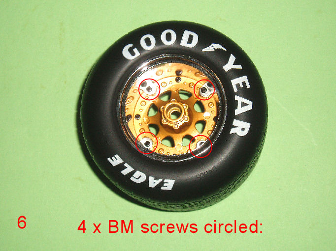

Pic 5: Locate the rear rim 99E.
Pic 6: Fit this in place, again making sure the screw locations are in line on the inside.
Fix with 4 x BM screws.

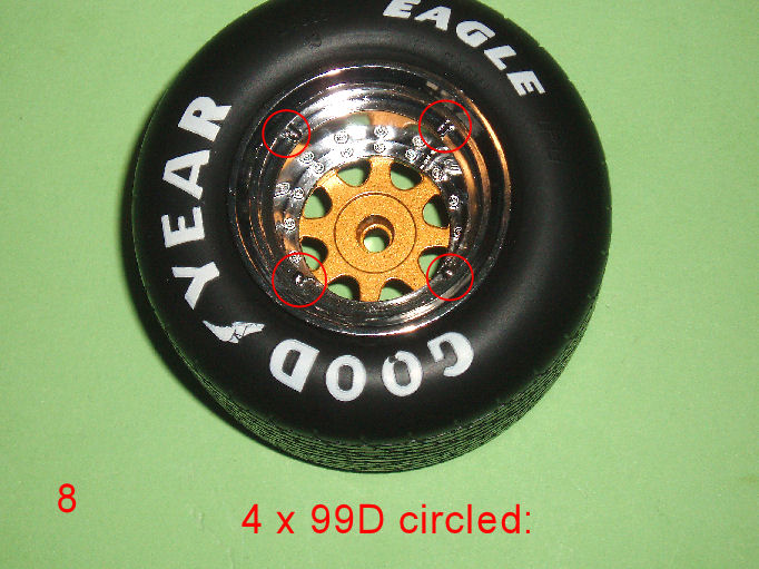

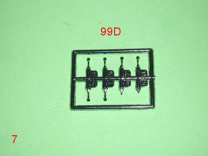

Pic 7: Locate the bolt sprue 99D.
Pic 8: Cut 4 x 99D bolts from the sprue and fit them into the holes in the outer rim.
The black bolt faces should point inwards.

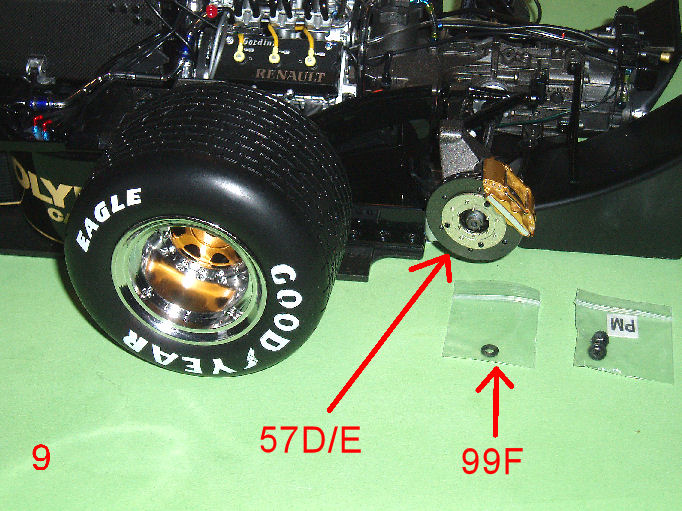

Pic 9: The printed instructions suggest you now fit the wheel.
First, fit the assembled brake disc 57D/E as shown, and then fit the wheel in place.
The washer 99F is fitted to the wheel centre next and then everything is secured using 1 x PM screw.
This stage has not been done here as the wheels are a very heavy element of the model and it might be advisable to fit them at the end of the build, when the model is no longer going to be turned upside down or moved about for assembly purposes.
This is of course at the builder’s discretion.

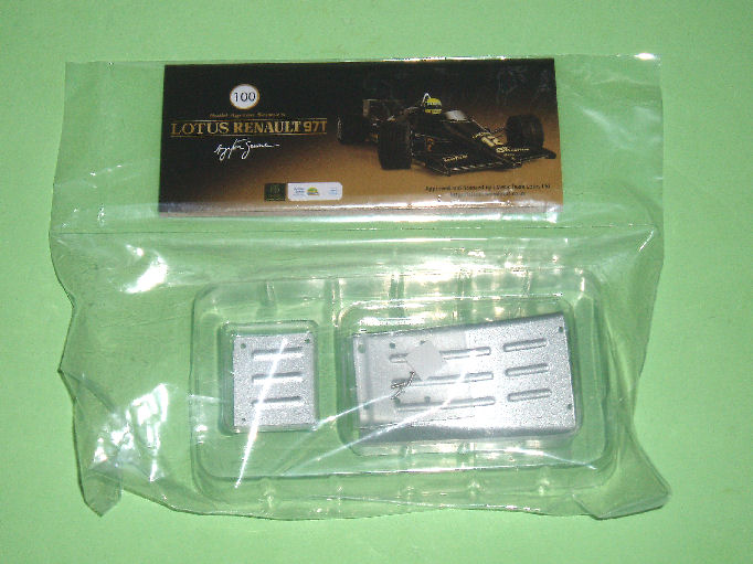

STAGE 100:

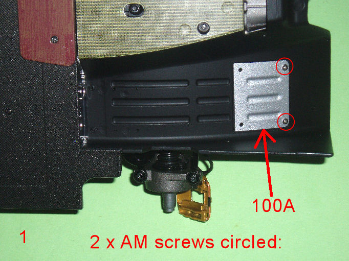

Right diffuser heat shield:
Pic 1: Fit the rear heat shield 100A as shown and fix with 2 x AM screws in the rear two holes.
Pic 2: Fit the large heat shield 100B in place next, then the smaller shield 100C on top at the front end next.
Pic 3: Fix the large diffuser 100B through the rear diffuser 100A and into the diffuser support arm using 2 x UM screws.

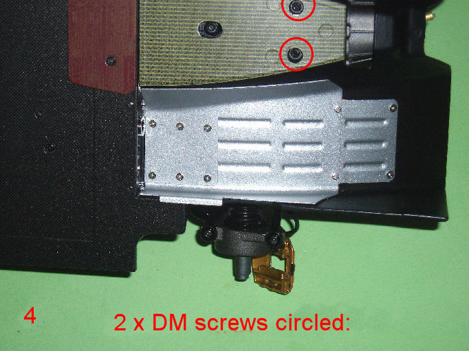

Pic 4: Fix the diffuser centre using 2 x DM screws as shown.
Pic 5: Shows the diffuser supports now fixed from beneath.

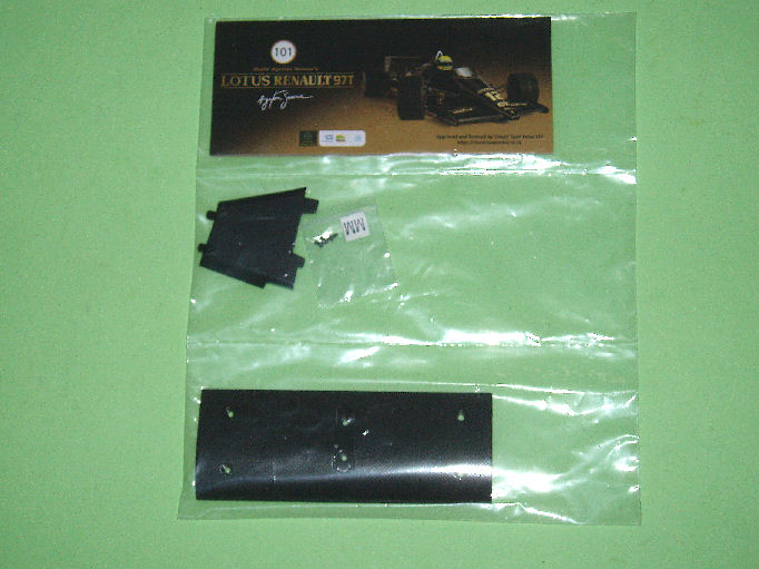

STAGE 101:

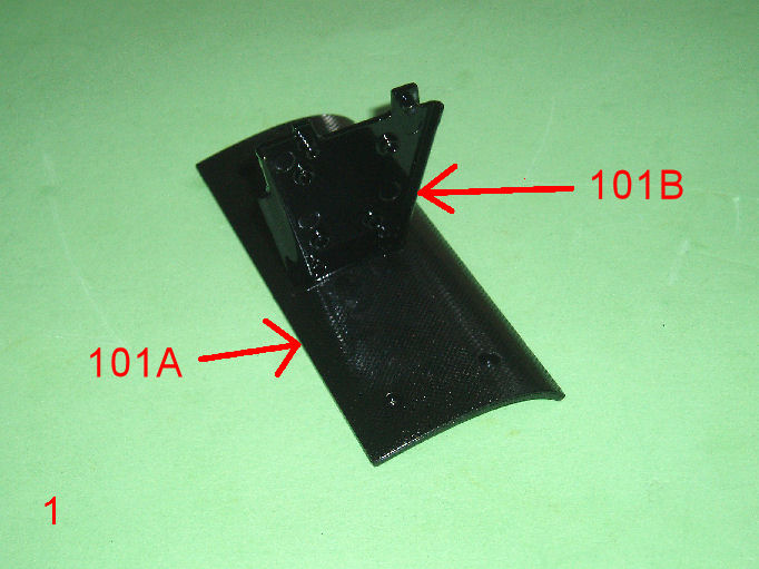

Rear wing assembly:

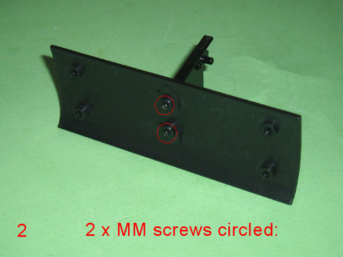

Pic 1: Fit the rear wing parts 101A and 101B together as shown.
Make sure each part is facing the way shown.
Pic 2: From the other side, fix the parts together with 2 x MM screws.
