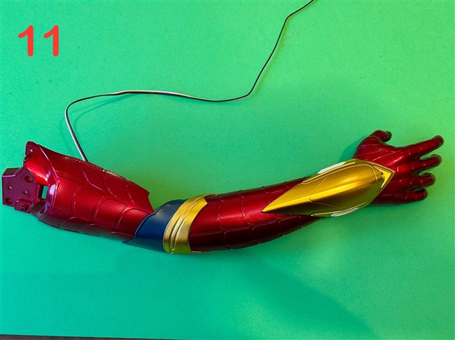

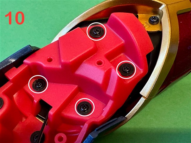

Issue 15
The Right Arm
Start by retrieving the assembled right arm from the previous issue and fit the inner forearm edge (01R) over the forearm, picture 2. Secure it in place using a type “E” screw, picture 3.
Rotate the arm and fit the outer forearm edge (02R), picture 4, securing it a type “F” screw, picture 5.
Retrieve the upper arm assembly and attach the outer elbow pad (03R), pictures 6 and 7. Secure it in place using two type “G” screws, picture 8.
Now feed the cable from the forearm through the central hole in the chassis as shown in picture 9.
Attach the two parts together using 4 x type “G” screws, picture 10.
Picture 11 shows the completed assembly for this issue.

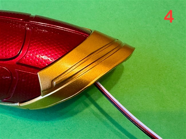

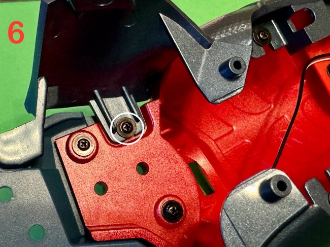

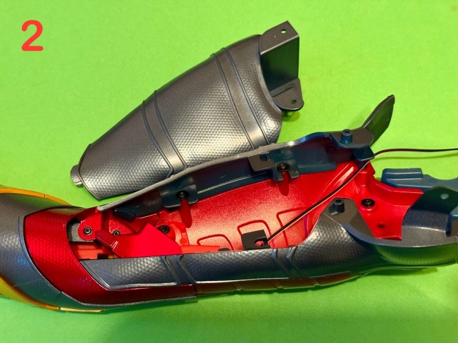

Issue 16
The Right Arm
Retrieve the arm assembly from the previous issue and fit the right elbow (01R), taking care not to trap the cable. Secure it in place using 2 x type “E” screws, picture 2.
Add the right elbow segment (02R) to the assembly securing it using 3 x type “E” screws, picture 3.
From the outside of the arm, fit the right upper arm chassis (03R) and secure it in place using 2 x type “G” screws, pictures 4 and 5.

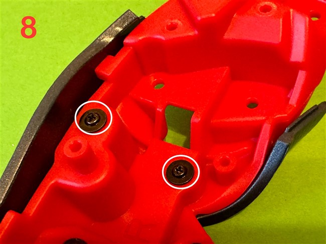

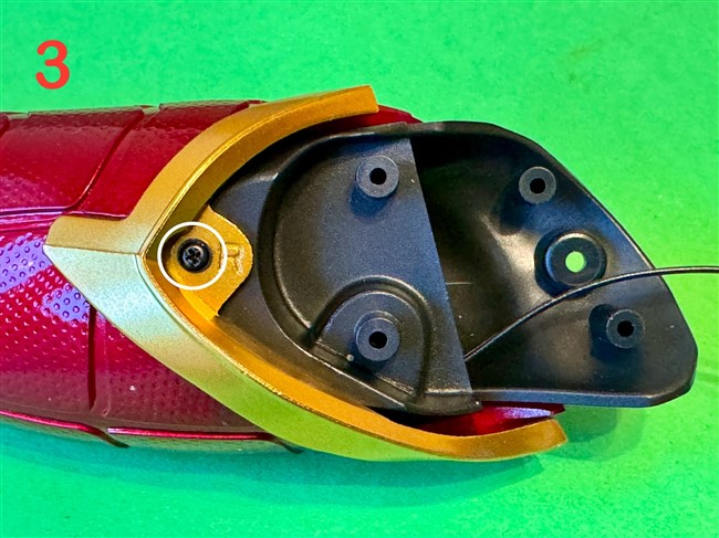

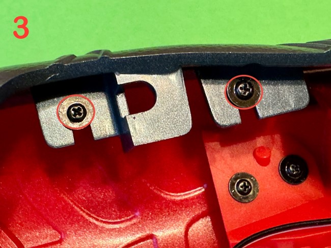

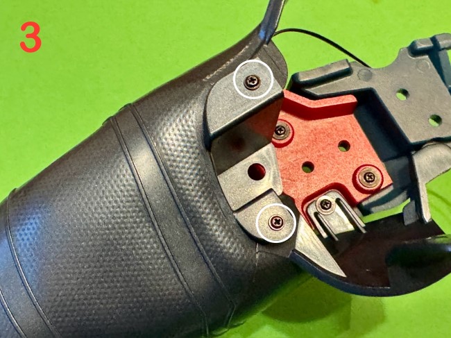

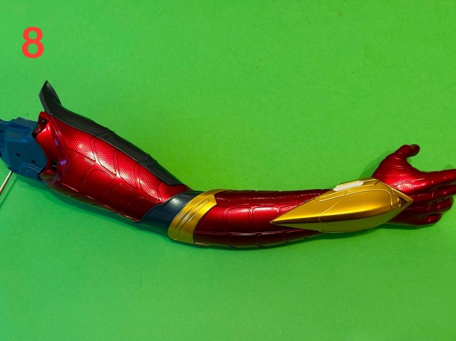

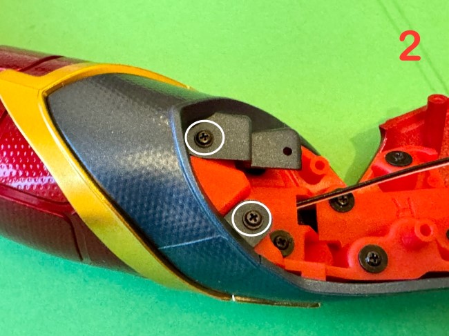

Issue 17
The Right Arm
Add the right arm cover (01R) to the arm assembly as shown in picture 2, securing it in place using 2 x type “G” screws, picture 3.

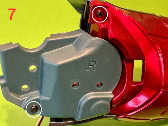

Now place the right arm cover (02E) in a similar way as before on the opposite side of the arm, again securing it in place using 2 x type “G” screws, pictures 4 and 5. Finish fixing the cover with a third type “G” screw as shown in picture 6.
Finally, secure the outer edge of the shoulder chassis using 2 x type “E” screws, picture 7.
Picture 8 shows the completed assembly for this issue.

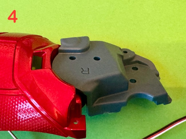

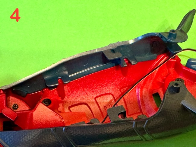

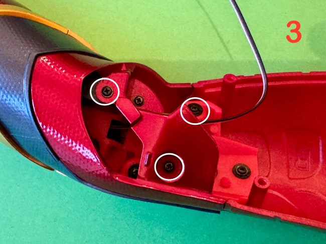

Issue 18
The Right Arm
Take the arm assembly and attach the right arm cover (01R) securing it using 2 x type “E” screws, pictures 2 and 3. Make sure the cable passes through the arm.

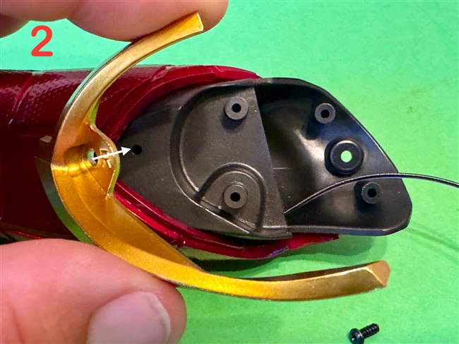

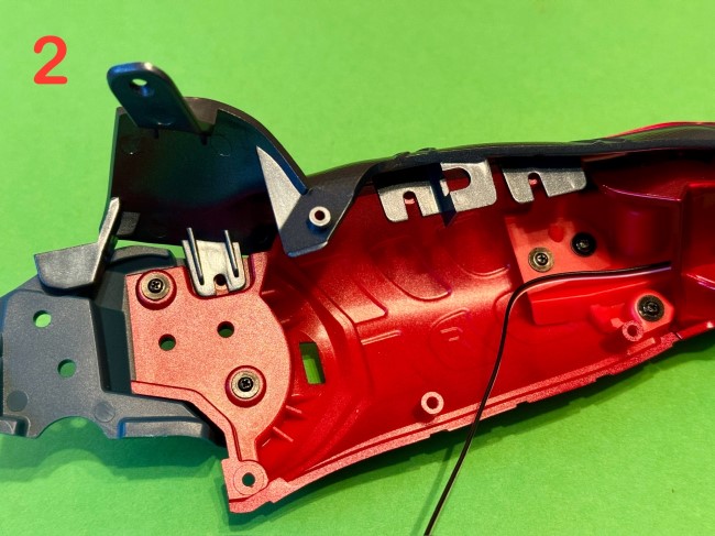

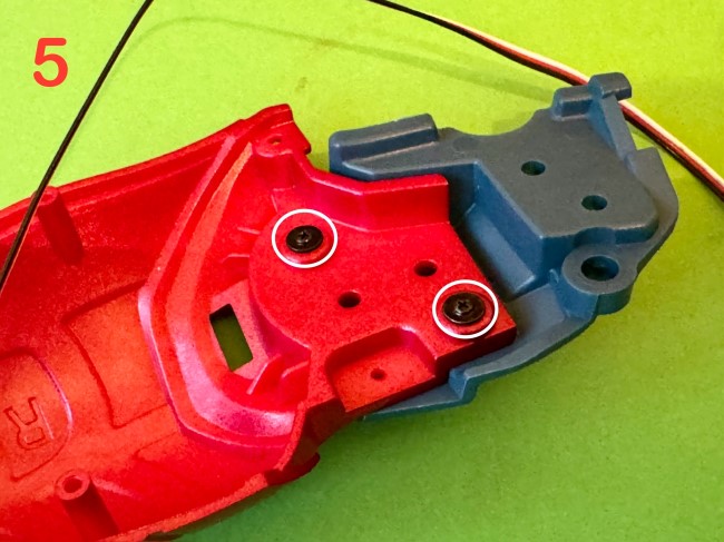

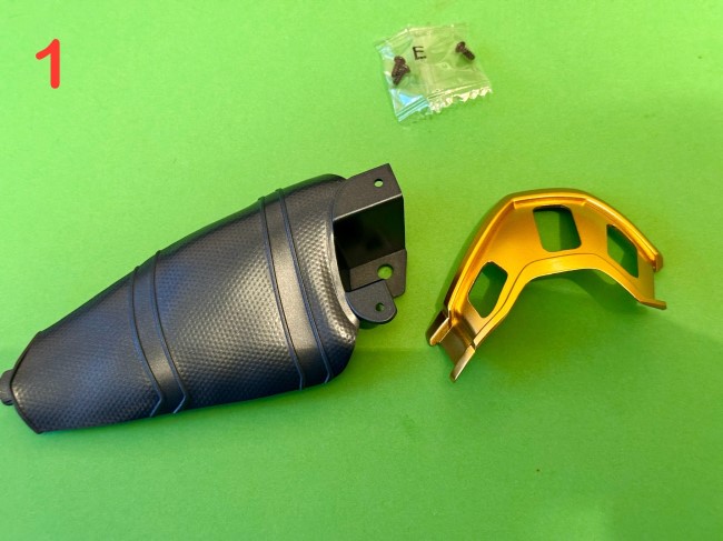

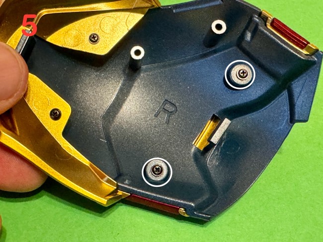

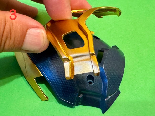

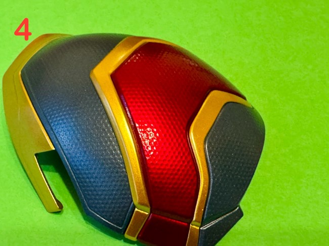

Issue 19

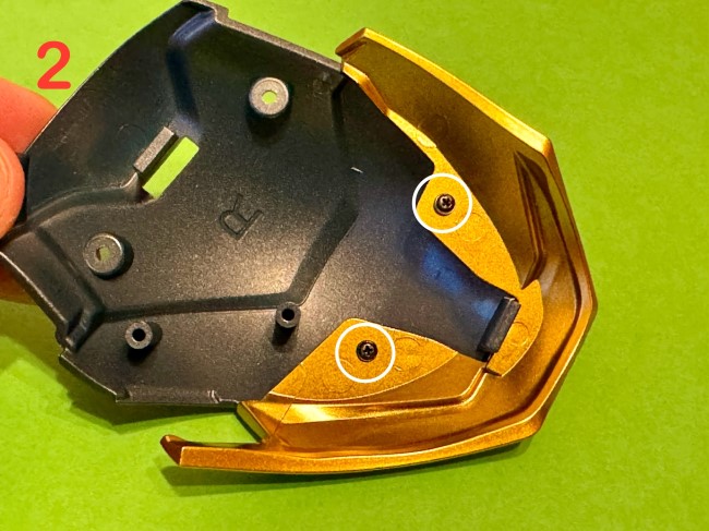

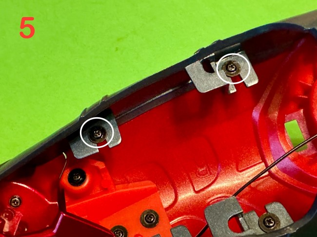

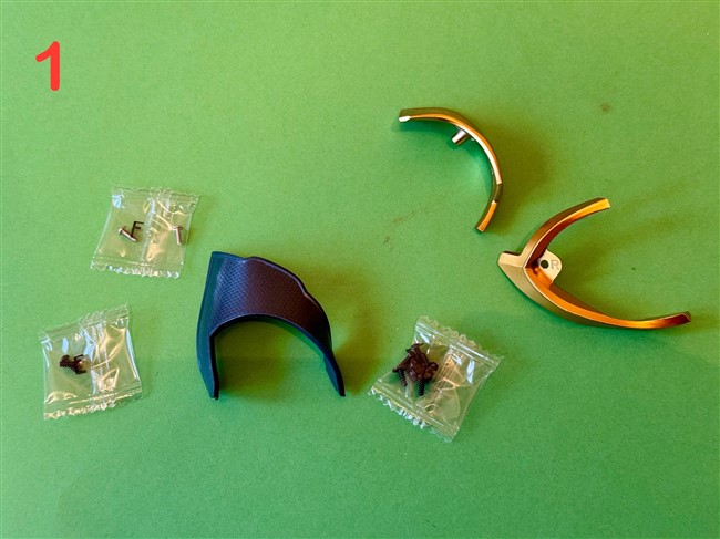

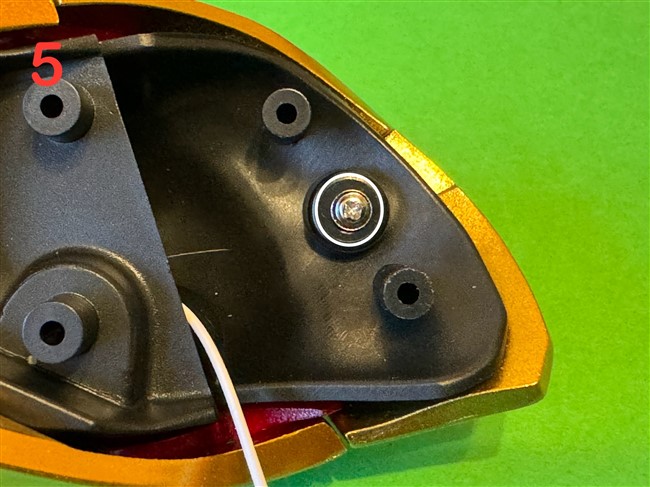

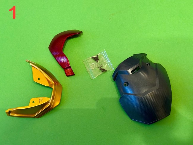

The Right Arm

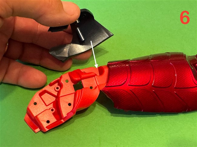

Begin by attaching the gold shoulder detail (01R) to the shoulder chassis (03R), securing them using 2 x type “E” screws, picture 2.
Turn the assembly over and place the upper gold shoulder detail, from the previous issue, over the shoulder chassis, picture 3, then place the red shoulder plate (02R) over the gold shoulder detail, picture 4.
Turn the assembly over once more and secure the parts in place using 2 x type “E” screws, picture 5.

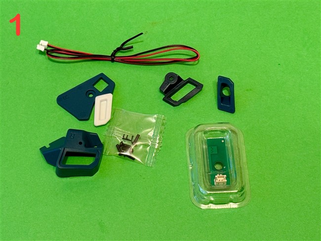

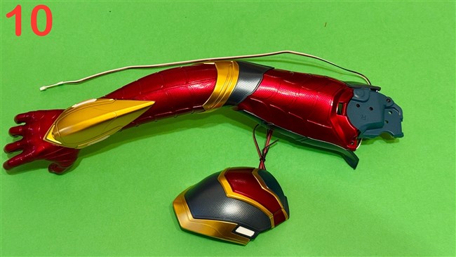

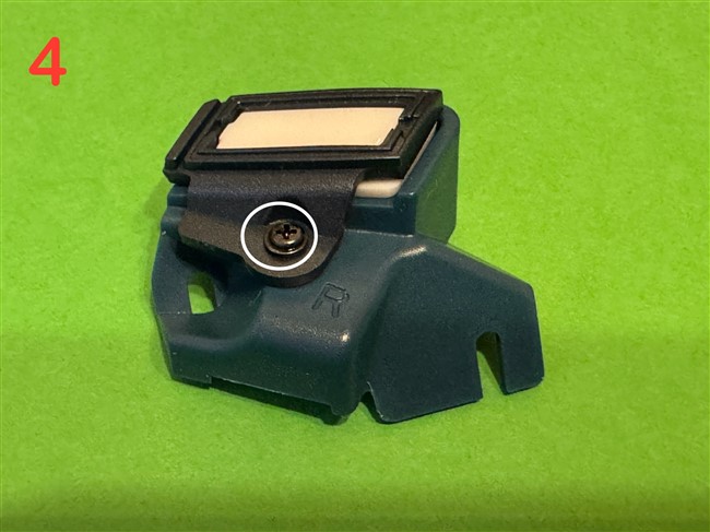

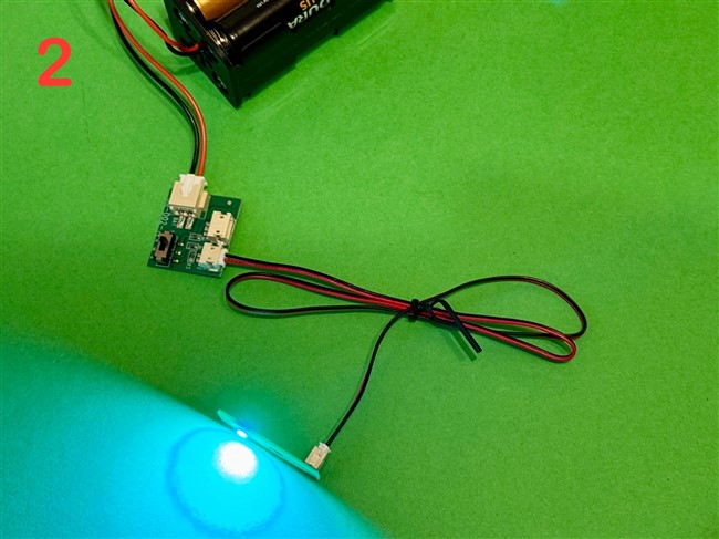

Issue 20
The Right Shoulder

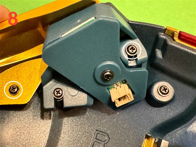

Start the issue by testing the light using the battery box from issue 2, picture 2.

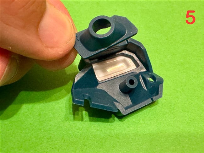

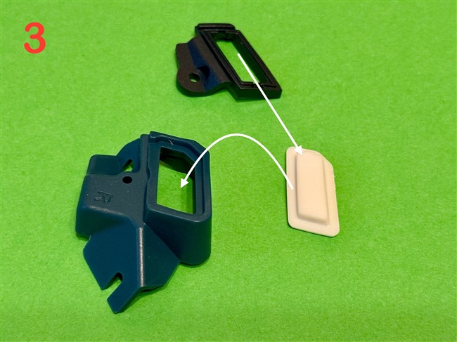

Fit the LED screen (05R) into the LED frame (01R) and then secure them to the LED base (02R), using a type “E” screw, pictures 3 and 4.

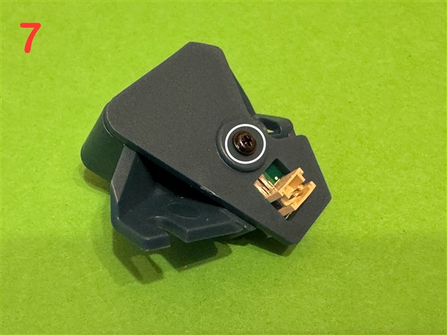

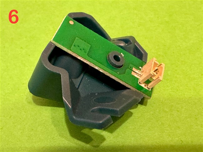

Turn the assembly over and place the LED bracket (03R) inside the assembly as shown in picture 5. Fit the circuit board (06) in place as shown in picture 6, followed by the plate (04R) securing it all in place using a type “E” screw, picture 7.

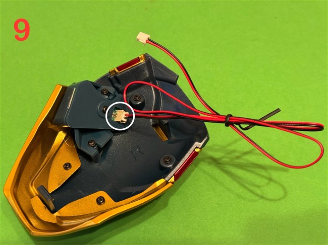

Fit the assembly into the assembly from the previous issue, securing it in place using 2 x type “E” screws, picture 8.

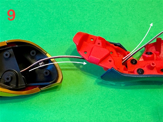

Insert one end of the plug into the connector. At the other end of the cable, about 3cm from the end, attach the tag marked “8”, picture 9.
Picture 10 shows the complete assembly for this issue and pack.
