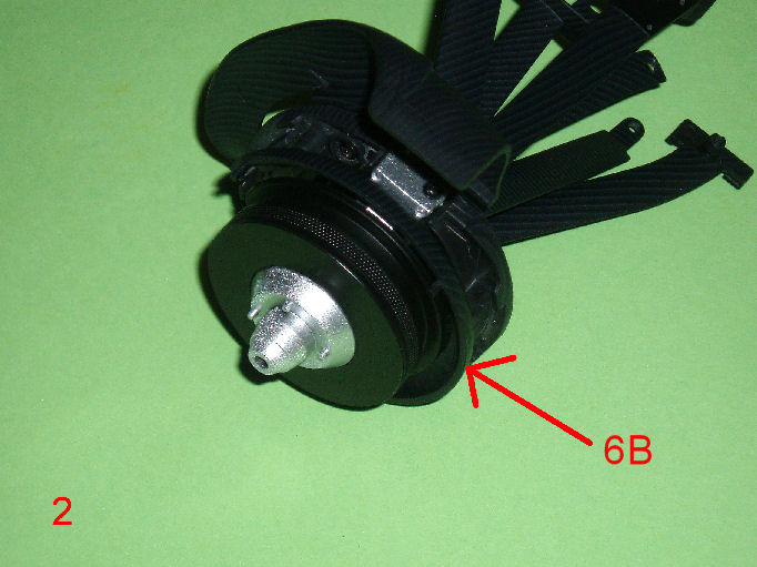

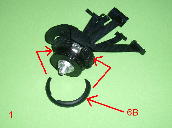

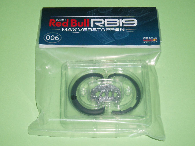

Pic 1: Retrieve the front left hub assembly and locate the inner brake disc cover 6B.
The two pins on the rear will fit in the holes in the hub 4I.
Pic 2: Shows the parts fitted together.

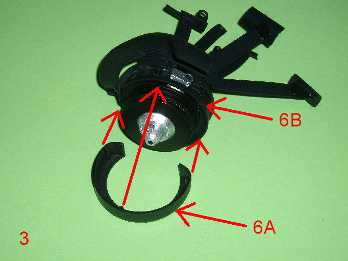

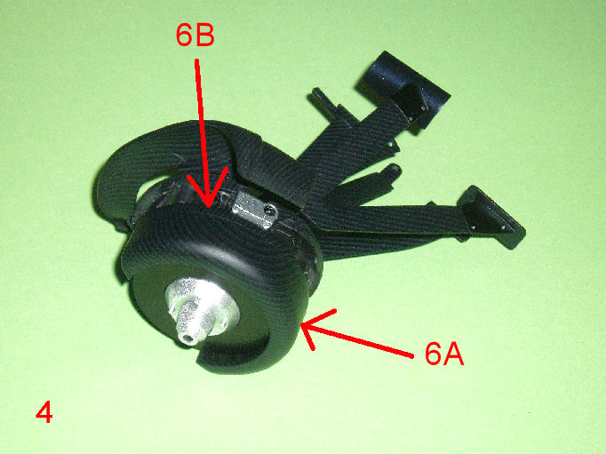

Pic 3: Locate the front disc cover 6A. This will fit to part 6B just fitted.
Pic 4: This shows the parts fitted together.

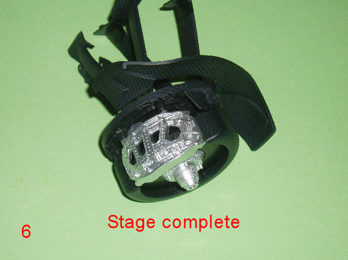

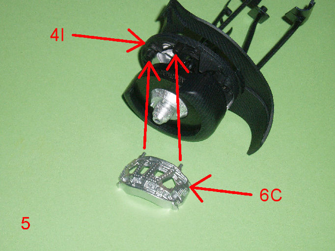

Pic 5: Locate the caliper 6C. This will fit to the hub 4I.
Pic 6: This shows the completed assembly.
Store the parts safely for now.

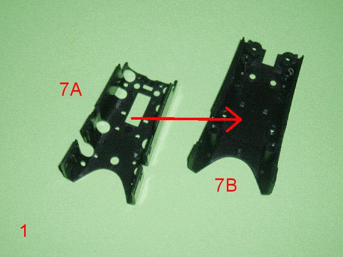

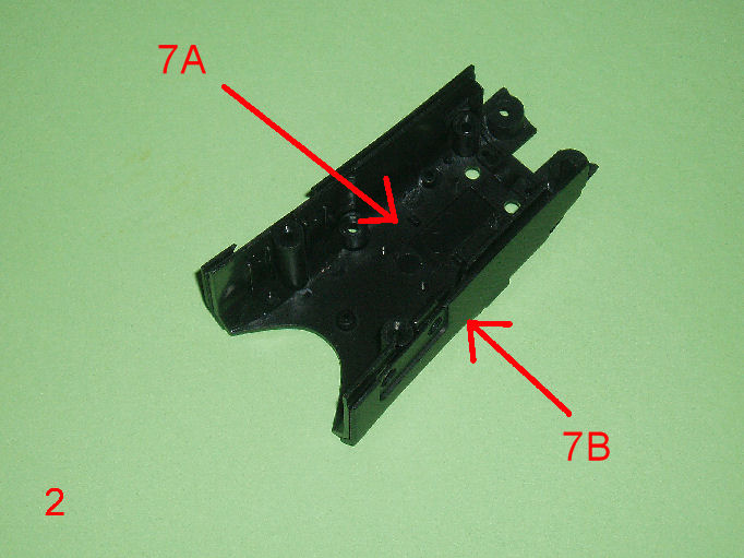

Pic 1: Locate the two parts of the survival cell 7A and 7B.
7A will fit inside 7B.
Pic 2: This shows the parts fitted together.

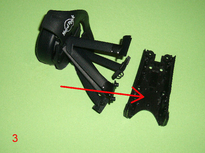

Pic 3: Retrieve the hub and suspension arm assembly from the previous stages.
This will fit to the side of the survival cell as indicated.

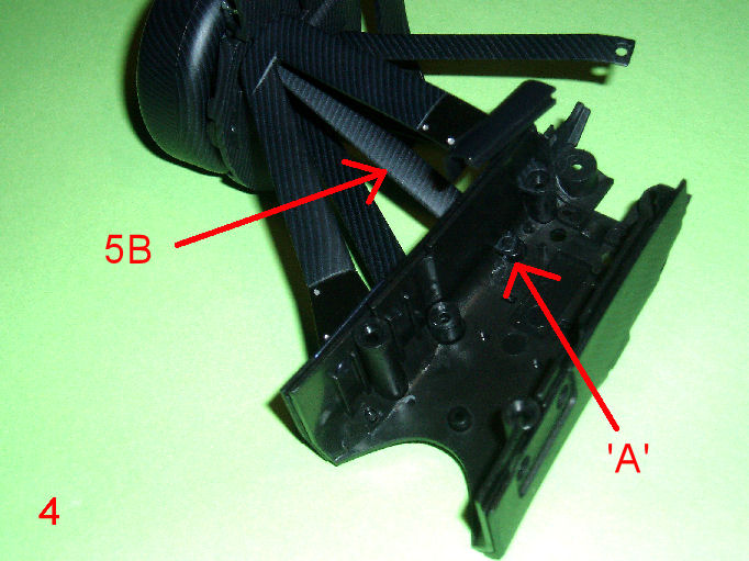

Pic 4: Fit suspension arm 5B through the slot in the lower front of the survival cell and fix with 1 x ‘A’ screw.

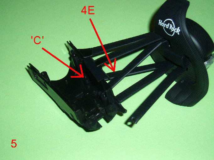

Pic 5: Fit the lower arm 4E through the opening near the lower rear of the survival cell. Fix with 1 x ‘C’ screw.

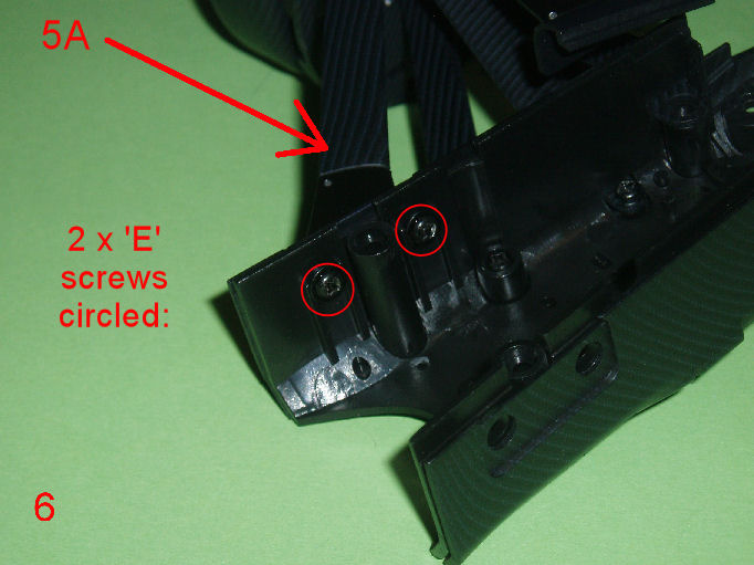

Pic 6: Fit the upper arm 5A through the two openings in the upper rear of the survival cell and fix using 2 x ‘E’ screws.

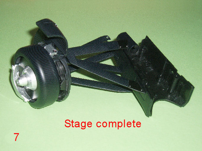

Pic 7: Shows the completed assembly.

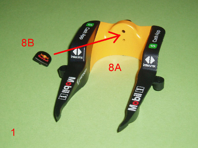

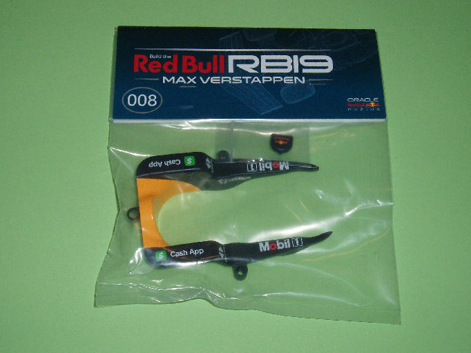

Pic 1: Locate the headrest and centre pad 8A and 8B.
The pad will fit in the two holes on the inner rear of the headrest.

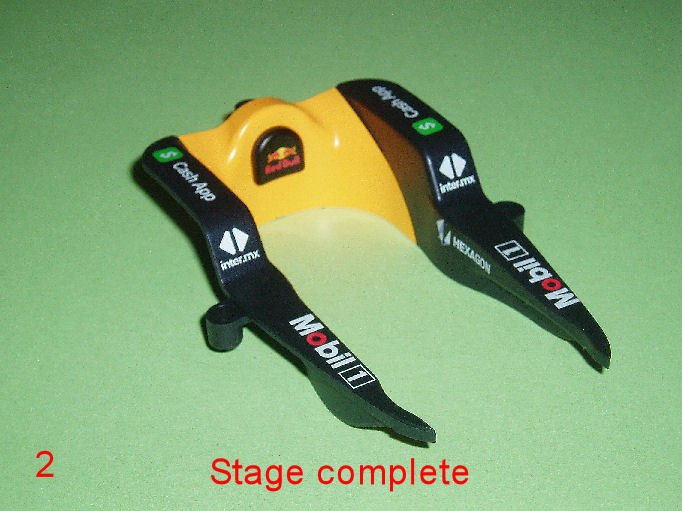

Pic 2: Shows the completed stage.
