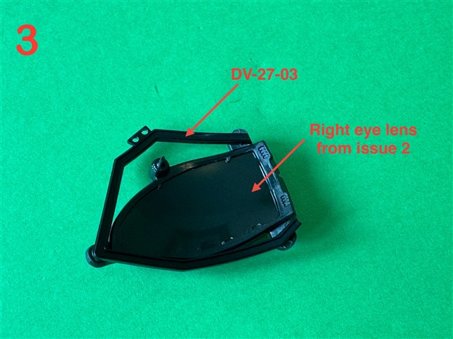

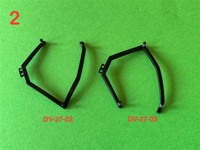

#1 Posted : 06 July 2025 16:18:19
Issue 27
The Helmet
Take the two eye frames and note the differences in the left and right parts. Picture 2 illustrates the correct numbered parts.

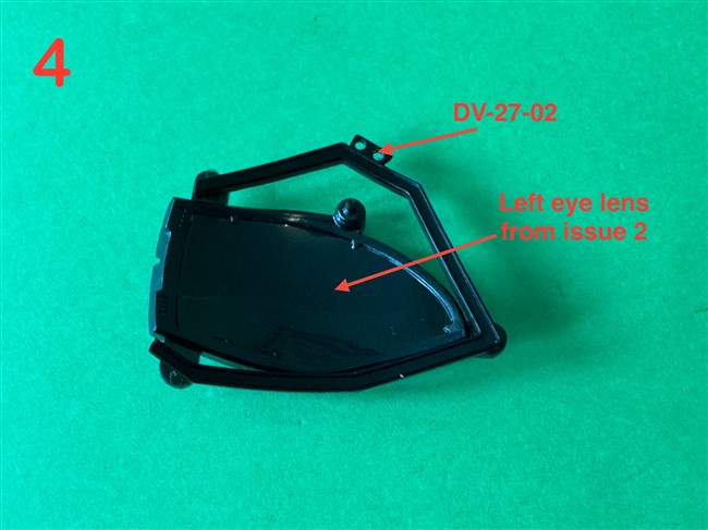

Take the right eye lens from issue 2 and attach the right eye frame (DV-27-03), picture 3. Do the same with the left eye, picture 4.
Place the left eye assembly into the mask pushing the pegs of the eye cover into their corresponding holes, picture 5.
Follow the same procedure for the right eye cover, picture 6.
Picture 7 show the complete assembly for this issue.

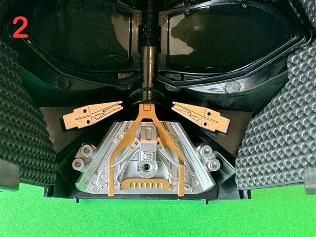

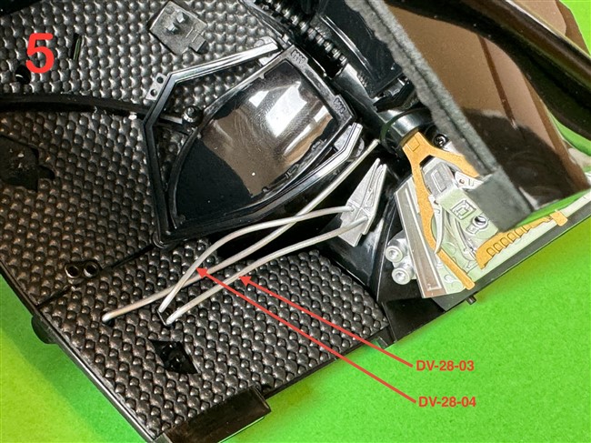

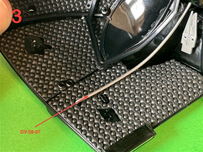

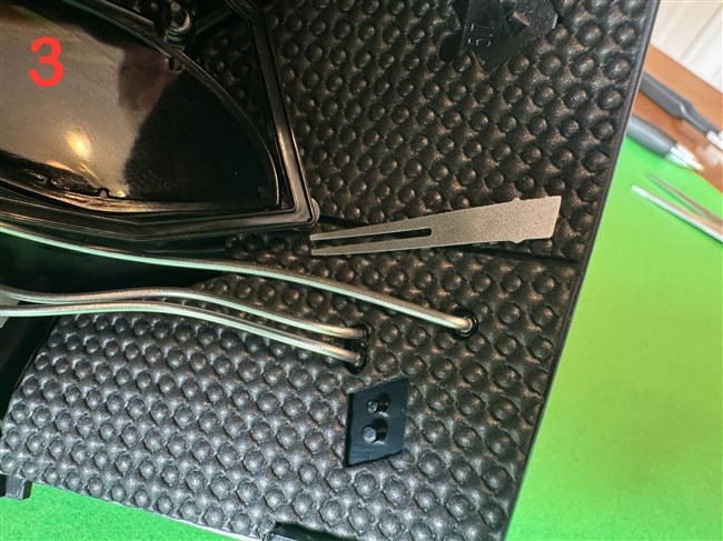

#2 Posted : 07 July 2025 19:58:36

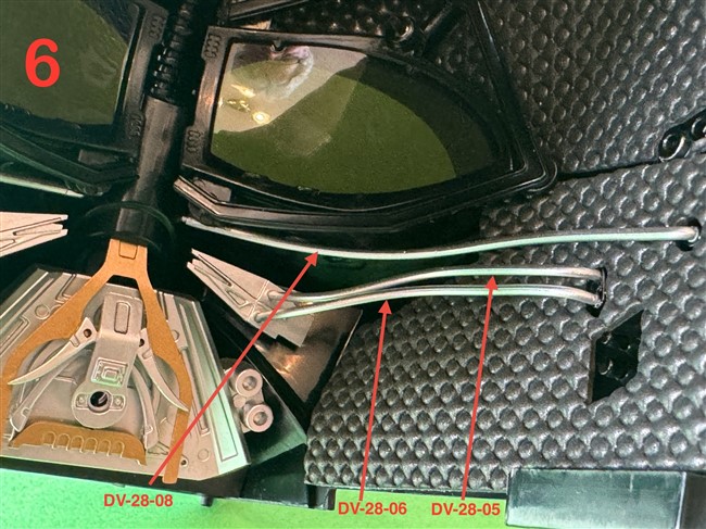

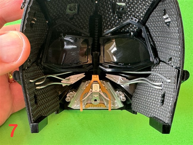

Issue 28
The Helmet

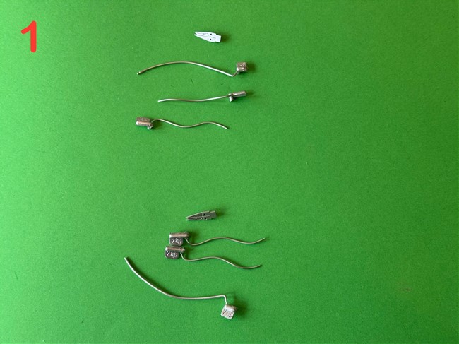

Fit the inner nose tube end pieces as shown in picture 2. They are marked with “L” and “R” on them.
Take the first of eye frame tubes. These are all individually marked with the tag on the end. Use the tube marked DV-28-07 and place it to the inner right-hand side of the inner mask, pushing both ends into their respective holes as shown in pictures 3 and 4. Take the next two right hand tubes, marked DV-28-03 and 04, and fit them as illustrated in picture 5.
Do the same with the left-hand side as illustrated in picture 6 using the remaining three tubes.

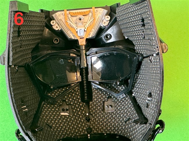

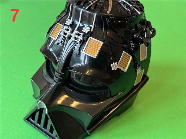

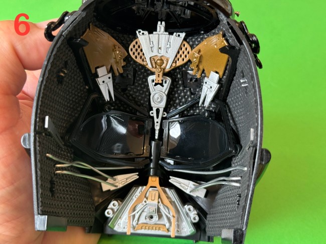

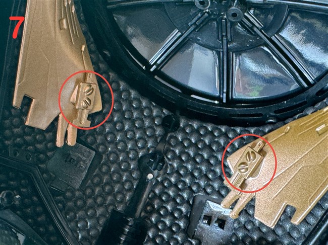

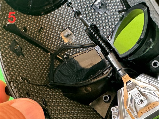

#3 Posted : 09 July 2025 10:47:42
Issue 29

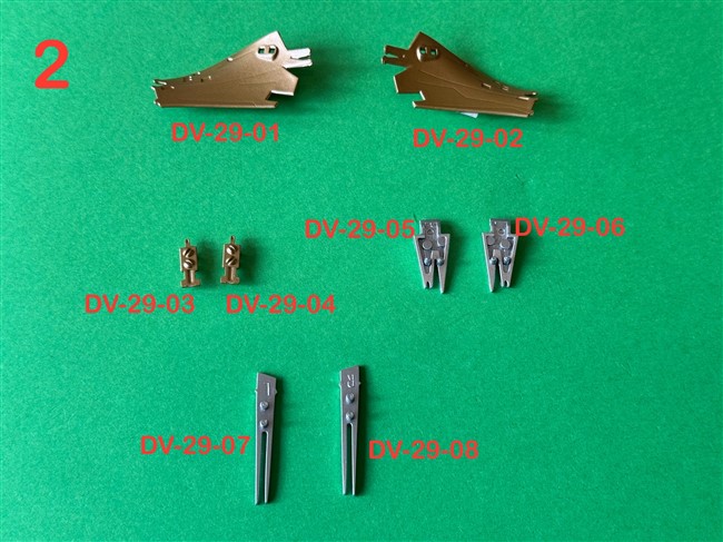

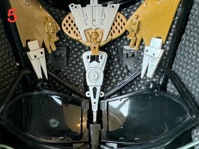

The Helmet

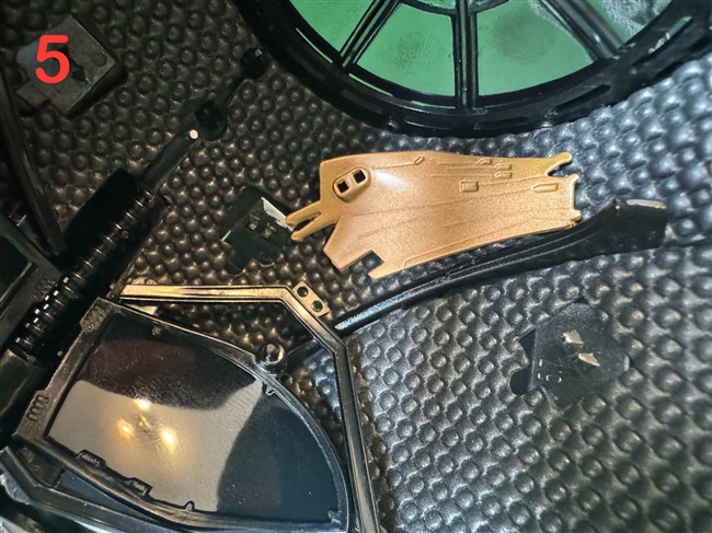

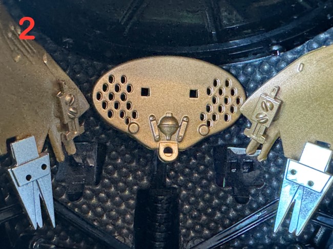

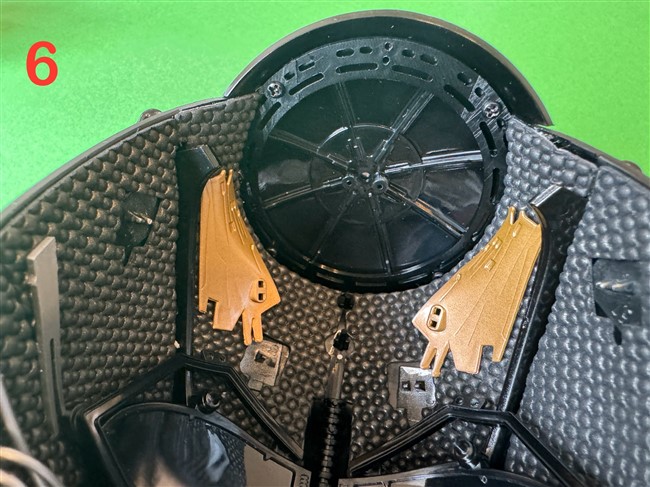

Note: The magazine has the last two parts on the first build page marked wrongly. Please see picture 2 for the correct numbered parts.
Take the right-hand inner cheek, marked “R” on the inside and place it as shown in picture 3. Do the same with the left-hand cheek, picture 4.
Remove the protective adhesive sheet from the right conductor plate and place it into position, picture 5 and again do the same with the left-hand conductor plate, picture 6.
Note: I found that the adhesive tape did not stick the part into place very well, so I used a little glue.
Attach the two internal conductor plate connectors onto the conductor plate as shown in picture 7.

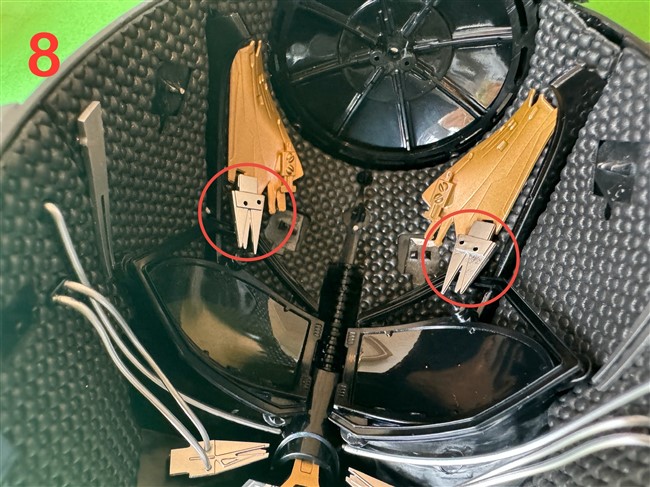

Finally, attach the two internal conductor plate end pieces by push fitting the two pegs into the eye frame, picture 8.

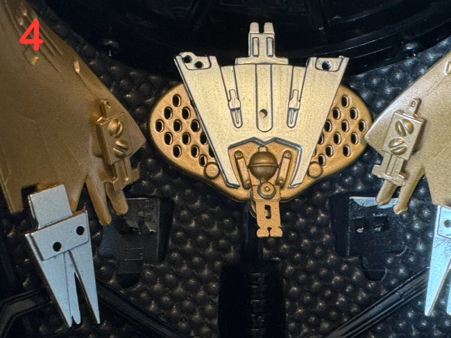

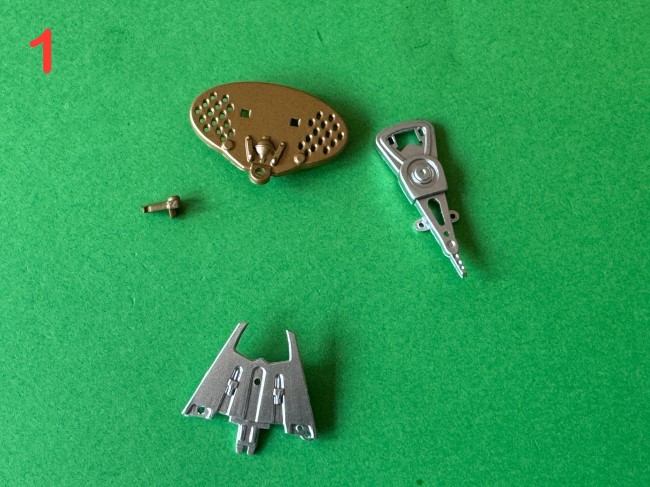

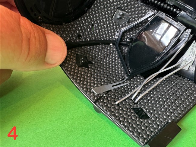

#4 Posted : 10 July 2025 15:42:27
Issue 30
The Helmet

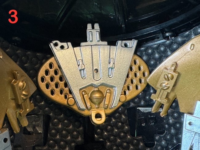

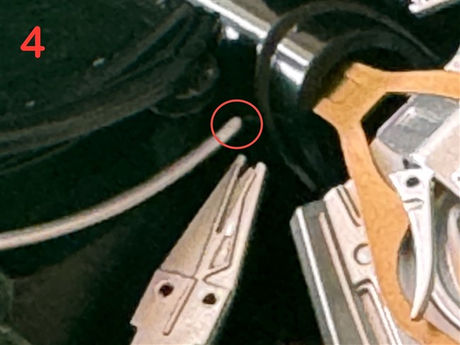

Retrieve the Darth Vader mask assembly and attach the internal brow plate to the inside as shown in picture 2.
Place the silver internal brow on top of the piece you’ve just added. This part has two pegs which slot into the holes of the brow plate, picture 3.
Insert the internal brow support at the bottom of the brow plate, picture 4.
Finally, insert the nose reinforcement as shown in picture 5.
Picture 6 shows the completed assembly for this stage.

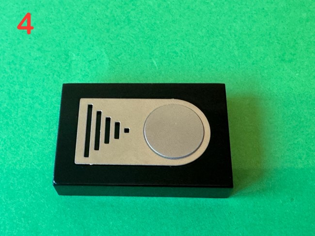

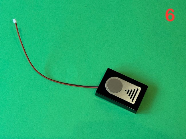

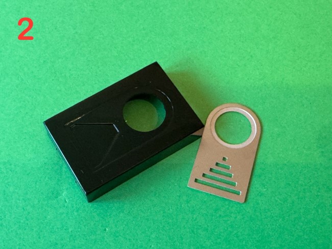

#5 Posted : 11 July 2025 14:50:48
Issue 31
The Belt

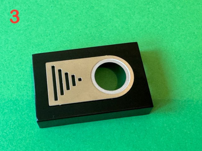

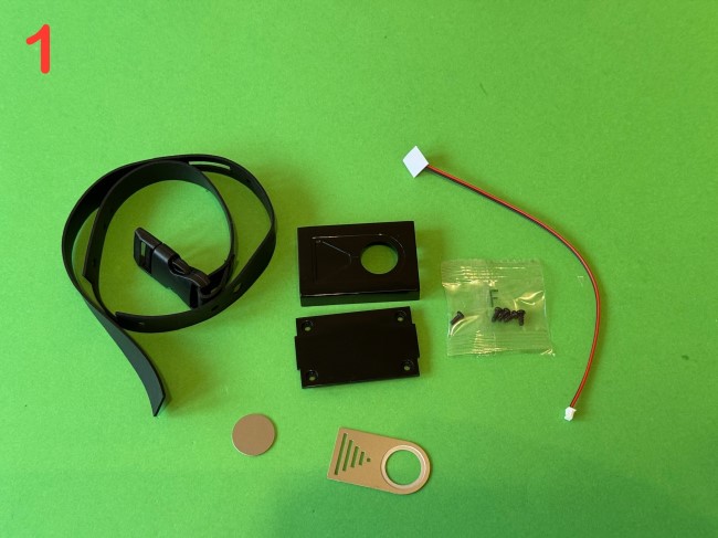

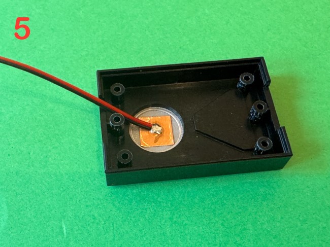

Remove the protective adhesive film from the metal buckle and stick it to the corresponding indentation on the buckle casing, pictures 2 and 3.
Remove the protective adhesive film from the contact button and attach it to the buckle panel as shown in picture 4.
Turn the assembly over and fit the button sensor with cable to the rear of the contact button. You will need to peel off the protective adhesive first, picture 5.
Note: Step 7 in the magazine is a little confusing as it refers to the circuit board from issue 21, please ignore this as this is incorrect.
Store the four type “F” screws and the belt buckle away safely. These will be used in a future issue.

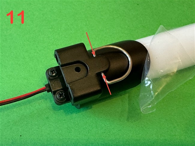

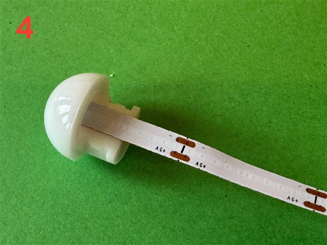

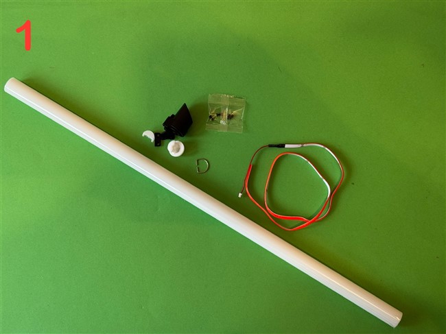

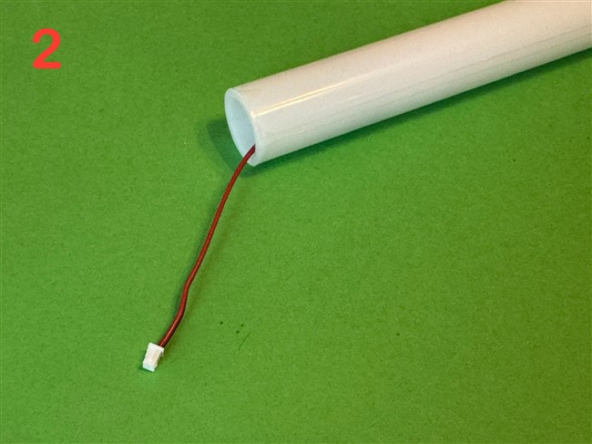

#6 Posted : 12 July 2025 17:14:05
Issue 32
The Lightsaber

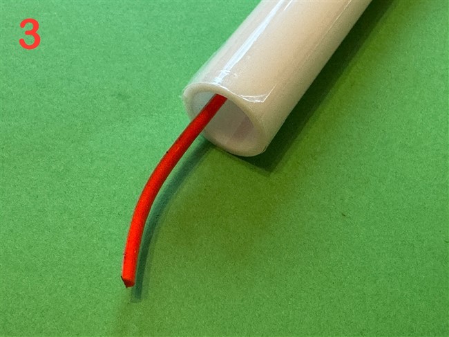

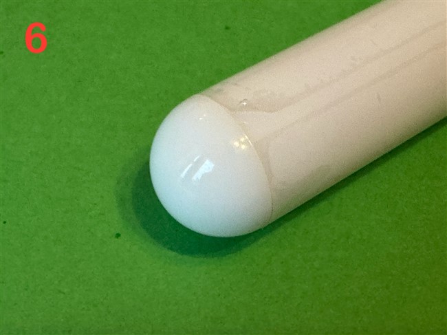

Take the lightsaber tube and insert the LED strip inside as shown in pictures 2 and 3. Note: leave the protective film on the lightsaber for now as this will stop it from getting scratched.

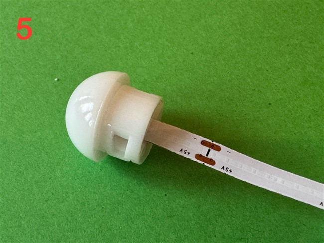

Place the LED strip cap over the end of the LED, picture 4. Attach the LED cap clasp and snap fit it in place as shown in picture 5. Push the end LED cap into the lightsaber tube, picture 6.

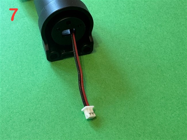

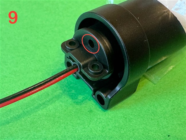

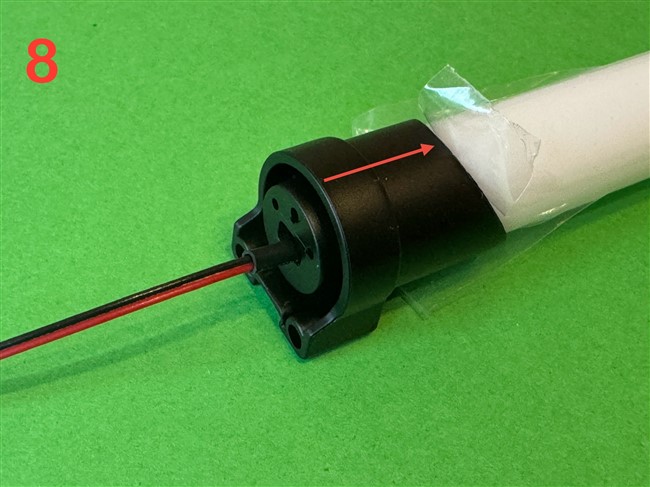

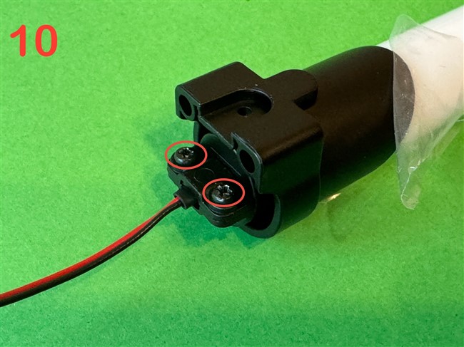

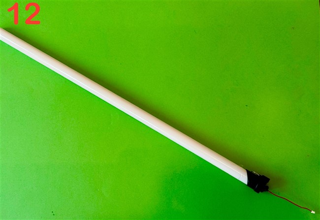

Take the front guard of the lightsaber and feed the other end of the LED cable through, picture 7. Push the guard over the lightsaber tube, picture 8. Position the upper support over the guard and secure it in place with a “F” type screw, picture 9. Turn the assembly over and attach the lower support, pulling the cable so it is taut. Secure it in place using two type “F” screws, picture 10.
Finally, attach the hilt buckle by slotting it into the two holes as shown in picture 11.
Picture 12 shows the completed assembly for this issue.
