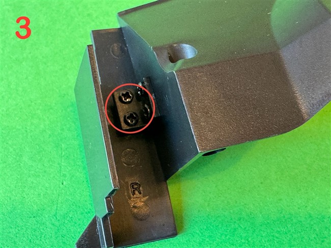

Assembling the Wheelarch

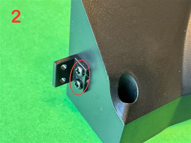

Fix the bracket (87E) to the side of the wheel arch (87A), and secure it using 2 x AP screws, picture 2. Secure the bracket to the end piece (87D) using 2 x AP screws, picture 3. Picture 4 shows the assembly. Push the brake fluid distributor (87C) into the wheel arch as shown in picture 5.

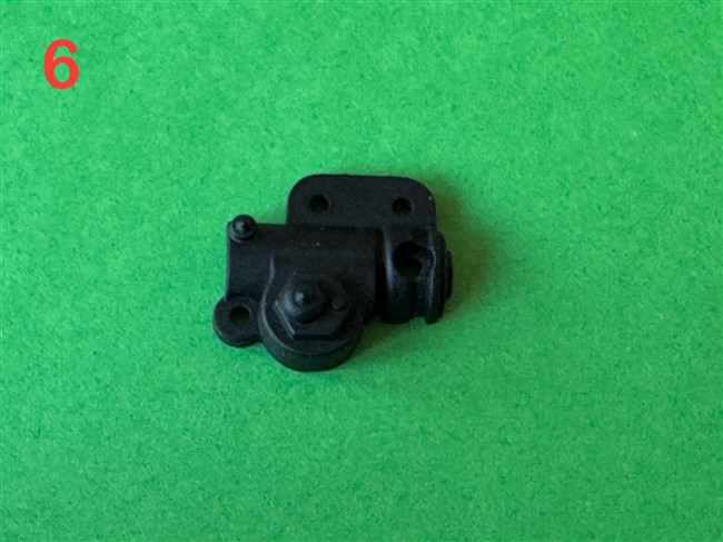

Replacing the Steering Gear Housing.
Picture 6 shows the replacement part from this issue. Undo the 4 screws from the old part, picture 7 and then replace it with the new part and secure it using the 4 screws that you removed, picture 8.

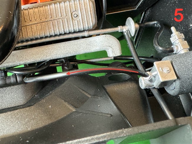

Fitting the Brake Fluid Pipes
Begin by fitting the pipe (87B) to the left engine block. It will push into place, picture 9. Fitting this part is not an easy task and took me a while. I used two pairs of tweezers, one to hold the pipe and navigate it in position, whilst the other grabbed the end and pushed it in place.

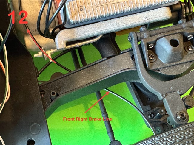

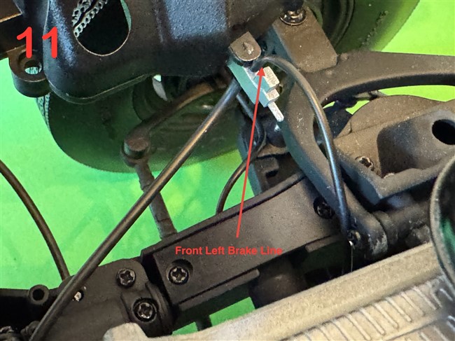

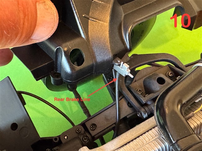

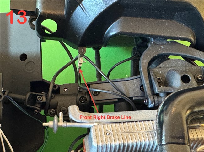

Fit the rear brake line into the distributor as shown in picture 10. Next, fit the front left brake line to the distributor, picture 11, and finally, the front right brake line, pictures 12 and 13.

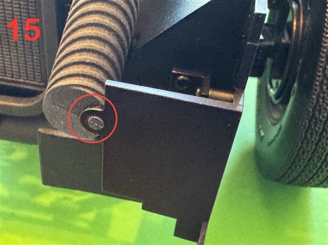

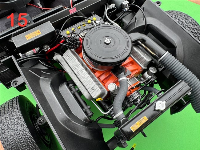

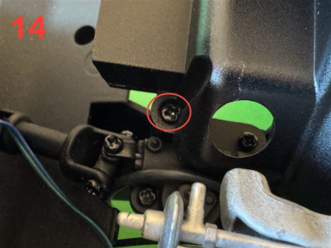

Installing the Wheel Arch
Secure the wheel arch (87A) to the front chassis using 2 x CM screws. Once secured, push the end of the air filter into the loop at the end of the wheel arch, pictures 14 and 15.

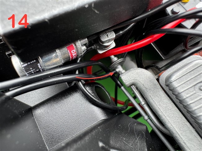

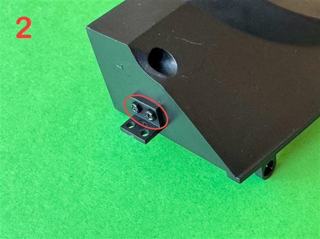

#2 Posted : 02 July 2025 19:41:26

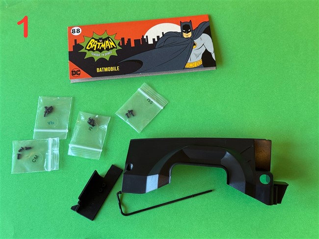

Issue 88 Part 1
Picture 1 shows the parts for this issue.

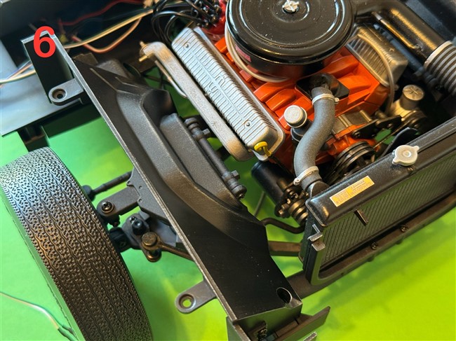

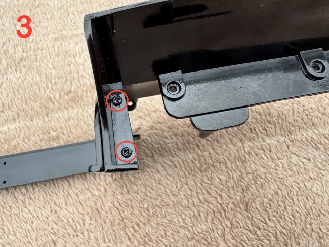

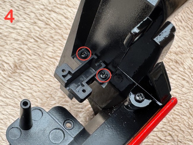

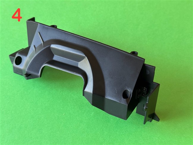

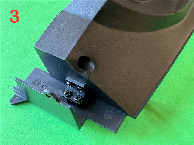

Fix the bracket (88C) to the side of the wheel arch (88A), and secure it using 2 x AP screws, picture 2. Secure the bracket to the end piece (88D) using 2 x AP screws, picture 3.
Secure the wheel arch (88A) to the front chassis using 2 x CM screws as shown in pictures 4 and 5. Picture 6 shows the wheel arch in place.

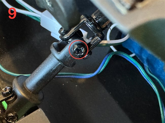

Installing the Steering Column and Firewall

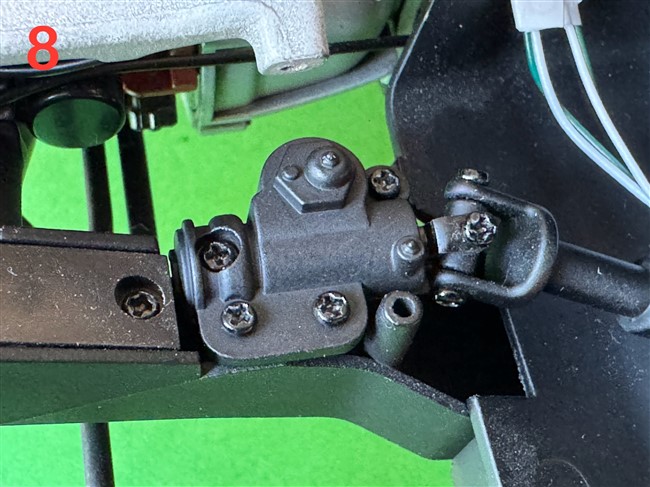

First, make sure the front wheels are facing straight forwards. Place the steeling column into the dashboard by threading it through the gap, picture 7. Connect the steering shaft to the steering column and connect the two together using 2 x SM screws, pictures 8, 9 and 10.

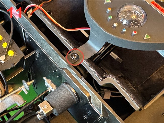

Finally, fix the upper dashboard to the firewall using 2 x FM screws, pictures 11 and 12.

Before we start to complete the engine, this next part of the build does require some patience. I used two pairs of tweezers, one in each hand, I did feel a bit like I was performing surgery.Laugh I will give a couple of tips along the way. I also cut some of the pipes down to size where necessary. So, let’s get started.
Push the 100mm hose onto the end of the pipe from the previous phase of the assembly, pictures 1 and 2.
Push the 70mm hose onto the pin on the side of the left radiator feed pipe, picture 3.
Push the 40mm hose on the pin of the left radiator feeding pipe, picture 4.

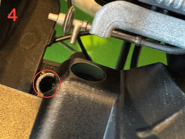

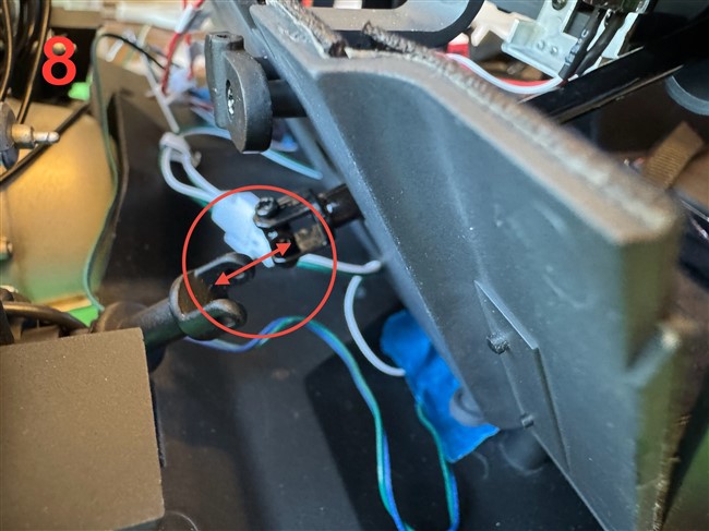

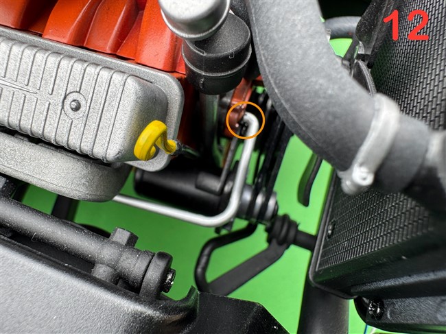

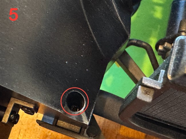

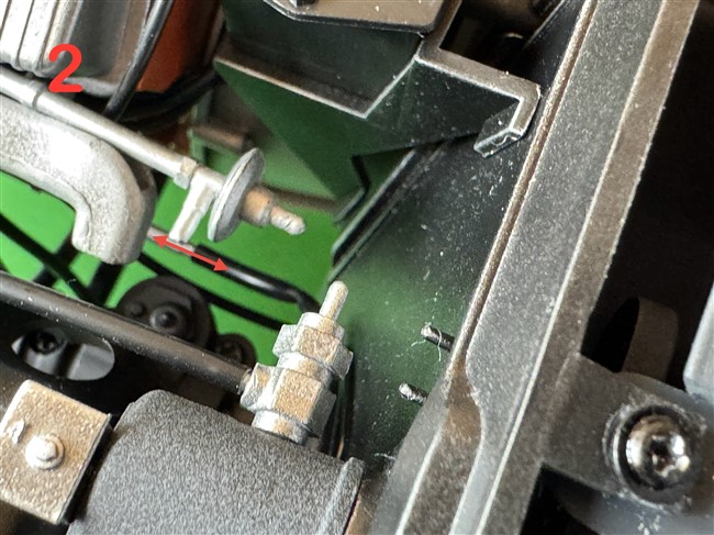

This next part is very tricky. Push the 110mm hose onto the free end of the brake fluid distributor that you attached to the wheel arch in the previous issue. The easiest way to attach this, as I found it was near impossible to attach by feeding the cable down through the engine bay, was to undo the wheel arch and carefully lifting it up to expose the distributor to allow you to attach the cable, picture 5.

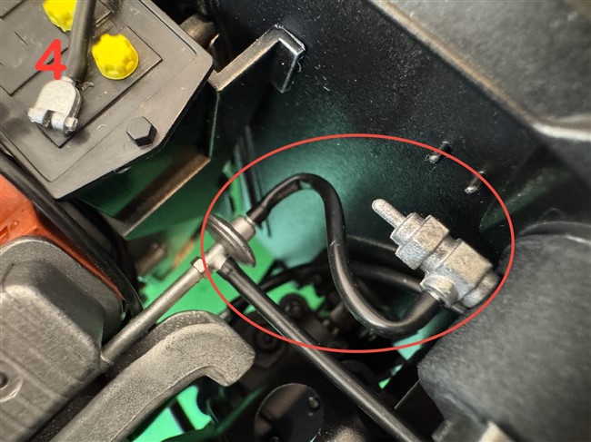

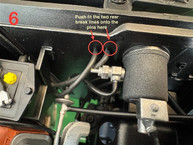

Attach the two rear brake lines onto the pins as shown in picture 6.

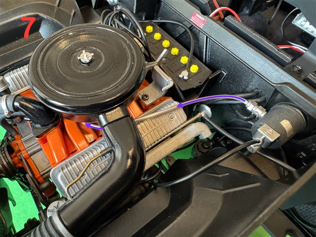

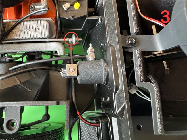

Take the grey vacuum line and push it into place on the power steering gear, picture 7.

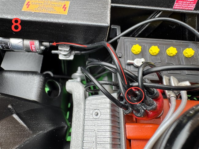

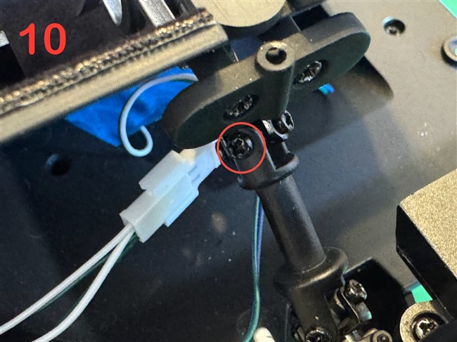

Install the cable from the starter motor to the centre of the distributer, picture 8.

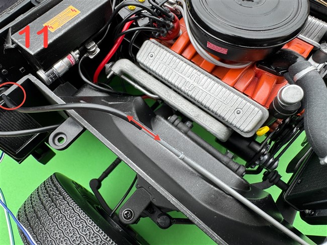

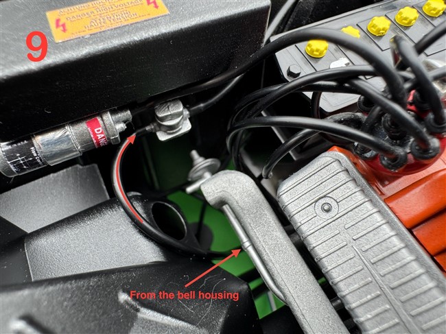

Take the cable from the bell housing under the engine and attach it to the fuse box, picture 9.

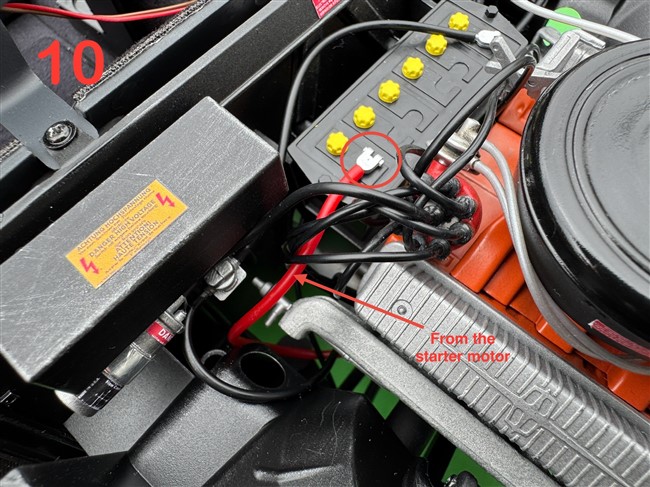

Take the cable from the starter, near the bell housing, and attach it to the terminal on the battery, picture 10. Note I have changed the cable to a red colour.
Take the 75mm hose from the firewall radiator and attach it to the pipe (88B). Carefully feed the pipe and cable down by the engine and push fit the end of the pipe, which has a tab that fits into the corresponding hole, in the water pump as shown in pictures 11 and 12. You will need a little perseverance with this.

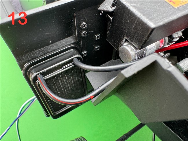

Finally, push the 95mm hose onto the right radiator feeding hose pipe, pictures 13 and 14.
Picture 15 shows the complete assembly for part 2 of this issue.

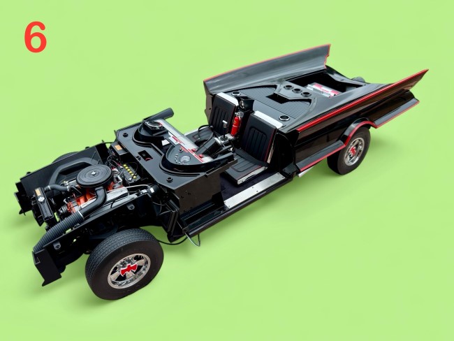

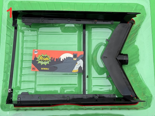

#4 Posted : 03 July 2025 14:56:04
Issue 89

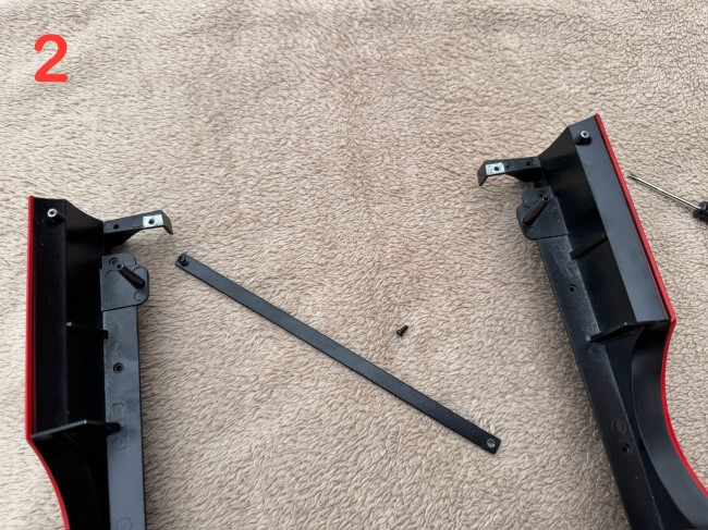

Removing the Shipping Beams

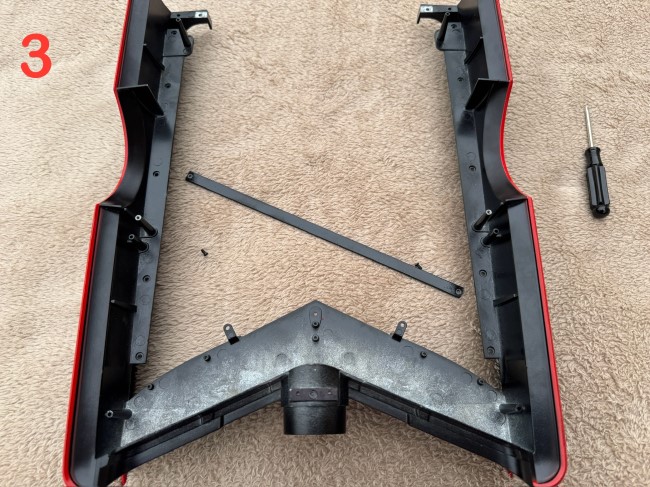

Remove the four screws holding the two shipping beams on the rear body panel (89A), pictures 2 and 3.
That complete this issue.

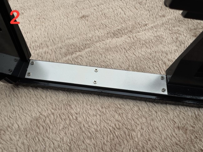

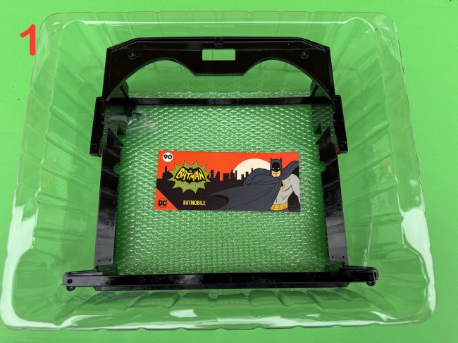

#5 Posted : 03 July 2025 15:09:39
Issue 90

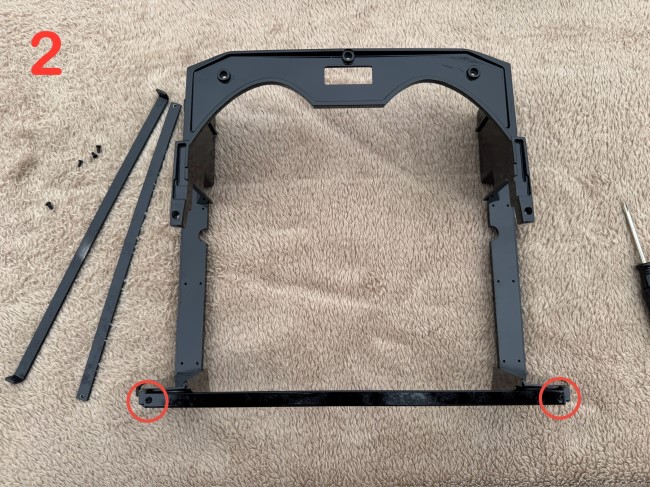

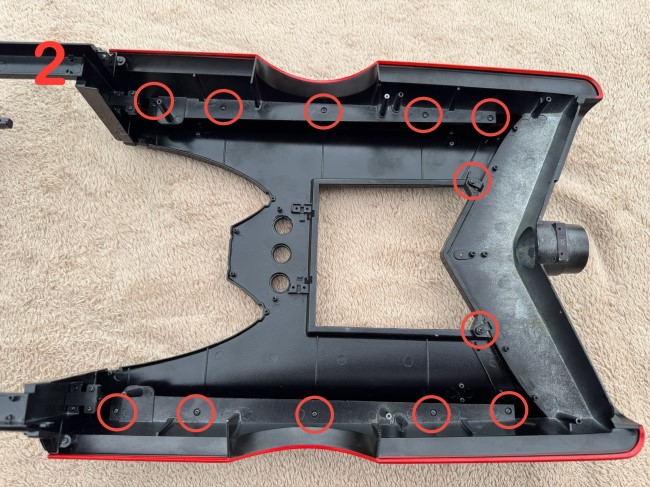

Remove the six screws holding the three shipping beams on the middle body panel (90A), picture 2.
Fitting the Frames Together

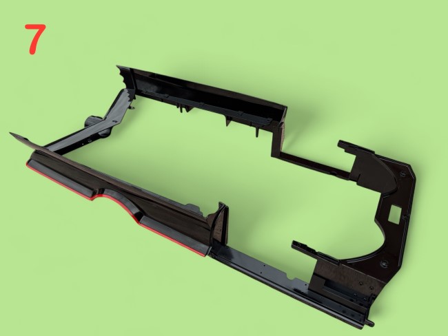

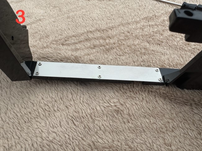

Fix the body frame middle to the rear body frame using 2 x EM screws on both the left and right sides of the frame as shown in pictures 3 and 4.

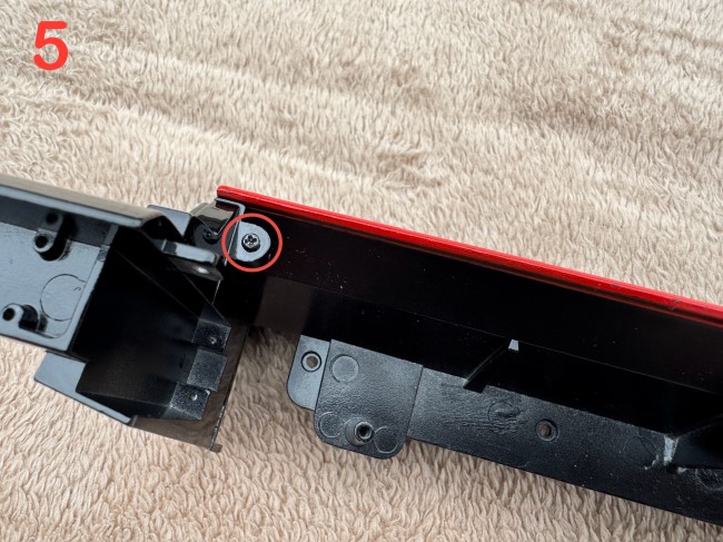

Turn the assembly over and place an EP screw, again on either side of the frame, pictures 5 and 6.
Tip: When securing the last two screws, turn the assembly over again and tighten up the previous four screws. I found that mine tightened up a little further.
Picture 7 shows the completed assembly for this issue.
#6 Posted : 04 July 2025 16:14:53
Issue 91

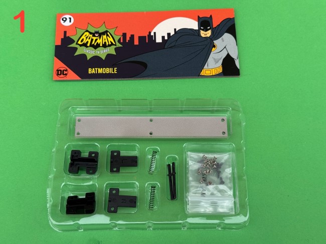

Installing the Kick Panels
Fit the two kick panels (91A) to the footwell of the body using 6 x ZM screws to each panel as shown in pictures 2 and 3.
Fitting the Left and Right Door Locks

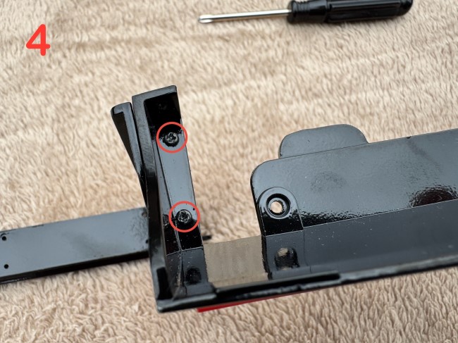

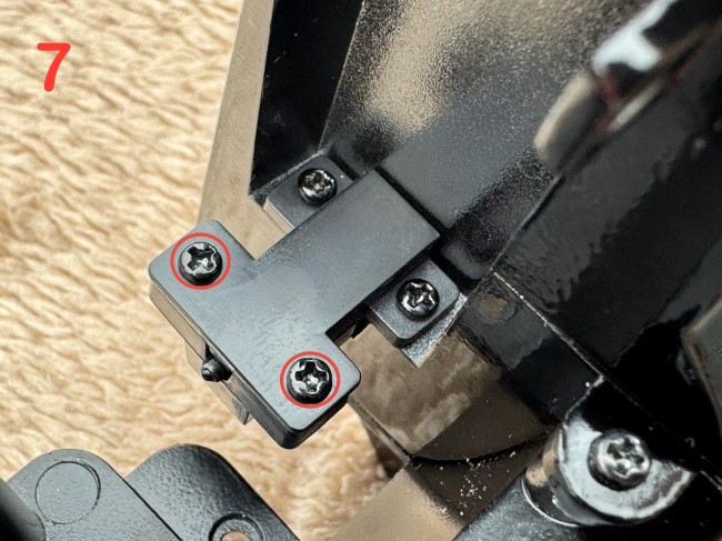

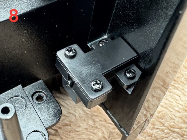

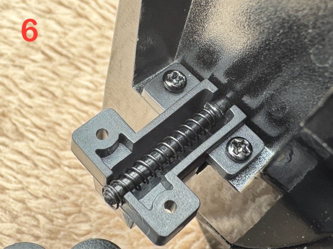

Use 2 x AM screws to fit the right door lock bracket (91E), picture 4. Take the door lock (91F) and place the spring (91G) over it as shown in picture 5. Place the lock and spring into the bracket, picture 6, and then fit the door lock cover (91B) in place using 2 x AP screws, picture 7.
Now do the same with the left door lock, picture 8.
#7 Posted : 04 July 2025 16:21:38

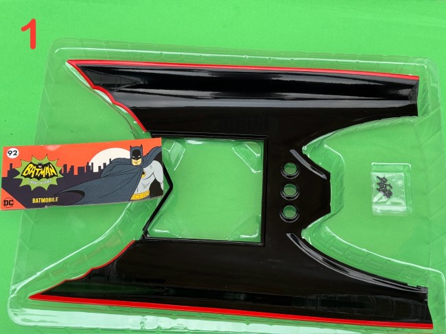

Issue 92

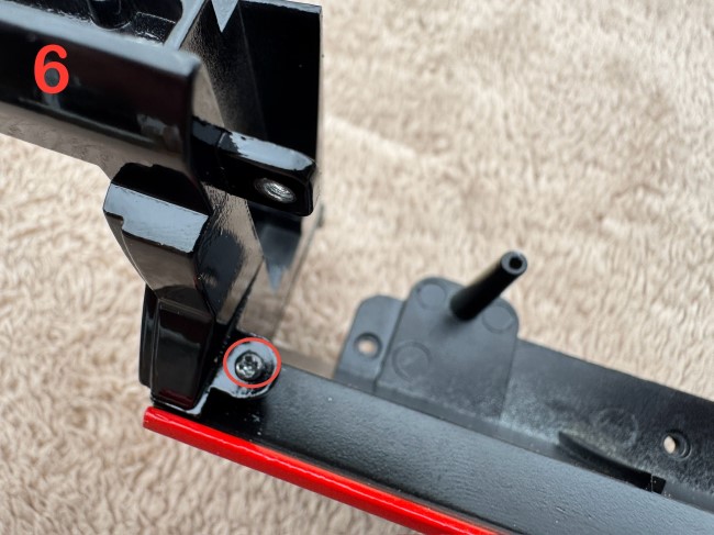

Fitting the Rear Body Panel
Take care not to scratch the body panel. I used a soft blanket to rest mine on. Secure the body panel (92A) to the body frame as shown in picture 2 using 12 x CM screws.
Picture 3 shows the panel in place.

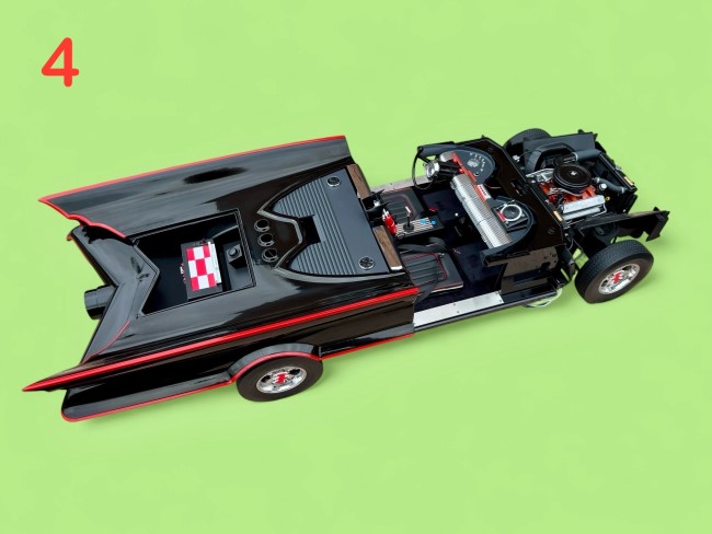

Pictures 4, 5 and 6 show the body temporarily fitted to the body to show what it will look like.
