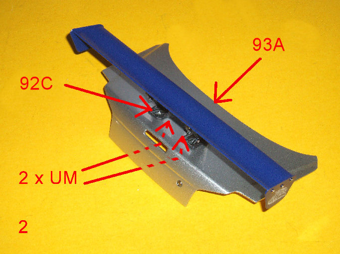

Boot lid.

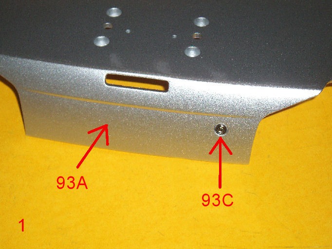

Pic 1: Press-fit the lock 93C into the hole in the lower right in the boot lid 93A.
Pic 2: Retrieve the spoiler assembly from the previous stage and fit it to the boot lid as shown.
Fix from underneath with 2 x UM screws.

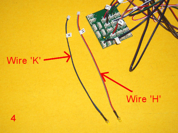

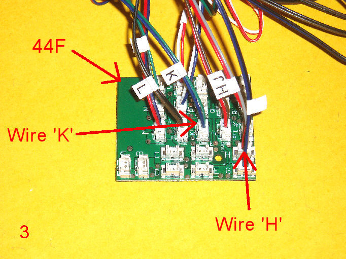

Pic 3: Retrieve the PCB 44F and locate wires ‘H’ and ‘K’.
Pic 4: Carefully unplug the wires.
Pic 5: Retrieve the main body shell and place it upside down as shown.

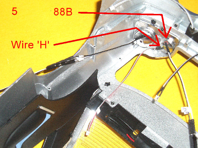

Fit the LED on wire ‘H’ into the hole on the reflector 88B.
Pic 6: On the other side of the car, fit the LED on wire ‘K’ into the hole in the reflector 88D.

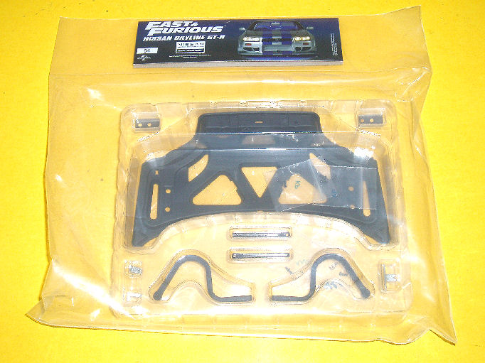

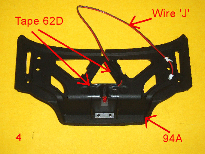

STAGE 94:
Boot lid.

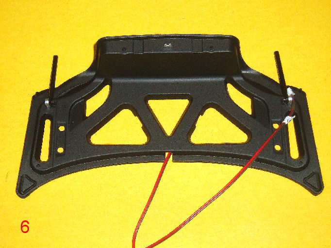

Pic 1: Fit the lock part 94B into the boot lid reinforcement panel 94A as shown and fix with 2 x KP screws.

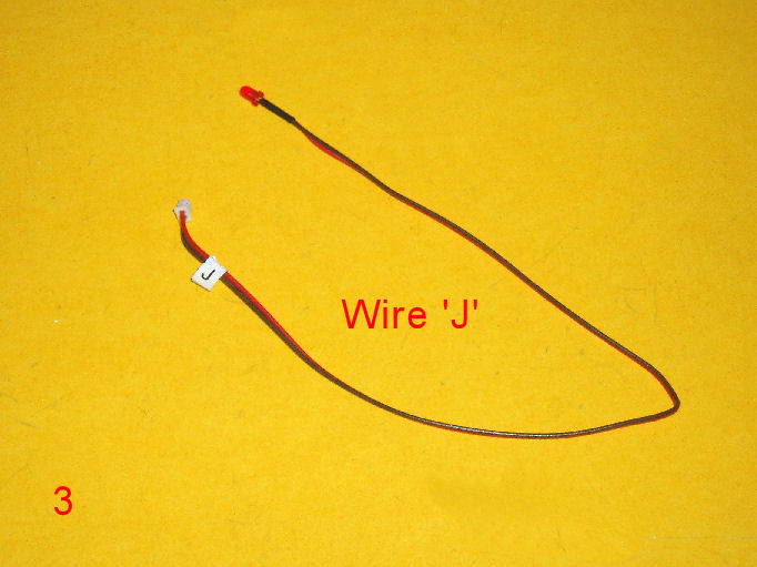

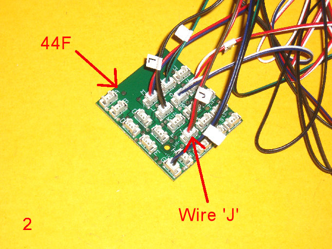

Pic 2: Retrieve the PCB 44F and locate the plug and wire ‘J’.
Pic 3: Remove the wire ‘J’.
Pic 4: Fit the LED on wire ‘J’ into the recess in the boot panel 94A as shown.
Run the wire along the reinforcing sections on the panel and fix in place with strips of tape 62D.

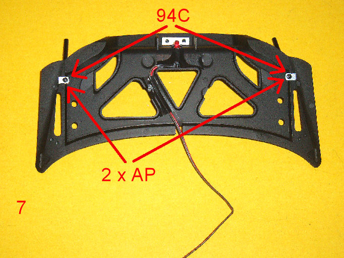

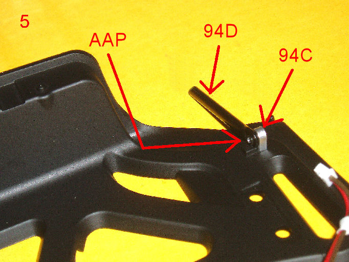

Pic 5: Fit the boot lid strut bracket 94C through the slot in the panel 94A from the underside as shown and fix one of the struts 94 in place using 1 x AAP screw.
Pic 6: Repeat on the other side.
Pic 7: Fix the brackets 94C in place from the underside using 1 x AP screw in each.
NOTE: These instructions are missing from the printed magazine.

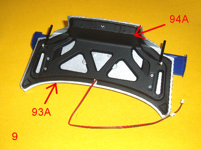

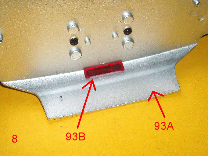

Pic 8: Retrieve the boot lid and red reflector 93A and 93B from the previous stage and fit the reflector in place.
Pic 9: Fit the reinforcement panel 94A in place as shown.

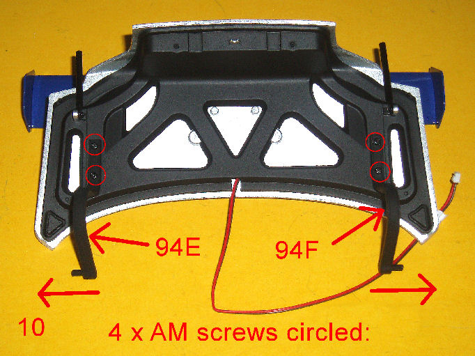

Pic 10: Fit the two hinge brackets 94E and 94F as shown making sure they are on the correct side with the angled hinge pin facing outwards.
Fix in place with 4 x AM screws.

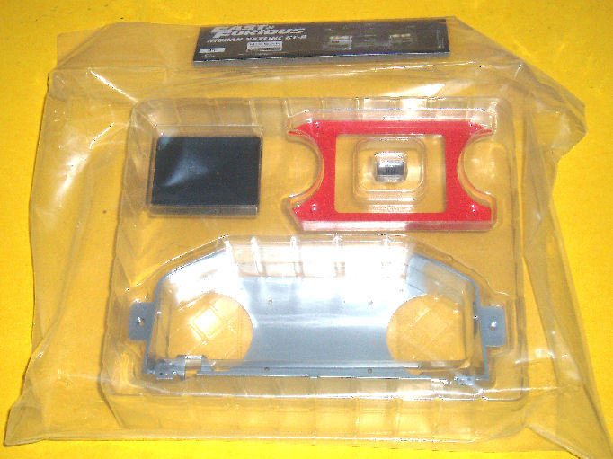

STAGE 95:

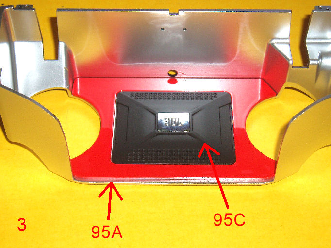

Sound system.

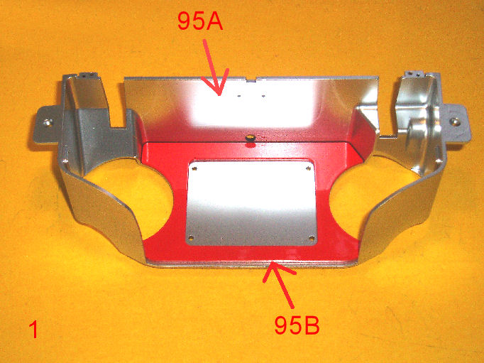

Pic 1: Press-fit the red mat 95B into the boot floor 95A.

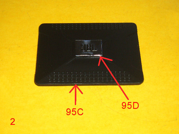

Pic 2: Press-fit the JBL badge 95D into the amplifier 95C as shown.
Pic 3: Press-fit the amplifier 95C into the boot floor 95A as shown.

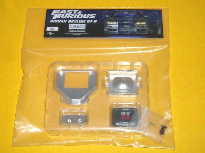

STAGE 96:
Sound system 2.

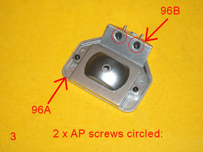

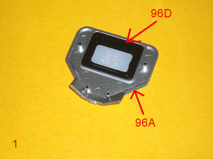

Pic 1: Fit the multimedia screen 96D into the housing 96A as shown with the wider end of the screen toward the flat end of the surround.

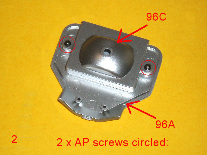

Pic 2: Fit the rear screen housing 96C in place on the front housing 96A as shown and fix using 2 x AP screws.
Pic 3: Fit the screen support 96B to the assembly and fix with 2 x AP screws.

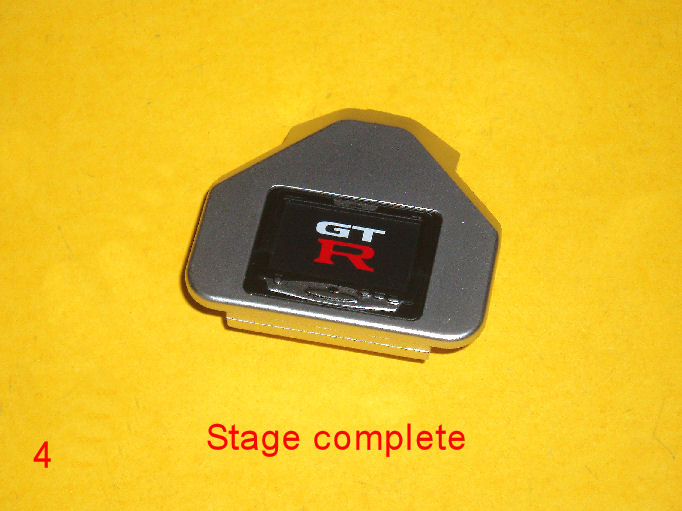

Pic 4: Shows the completed unit.

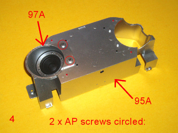

STAGE 97:

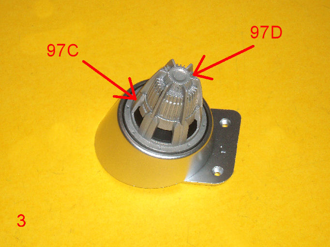

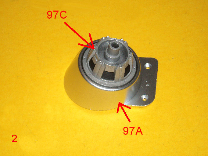

Sound system 3.

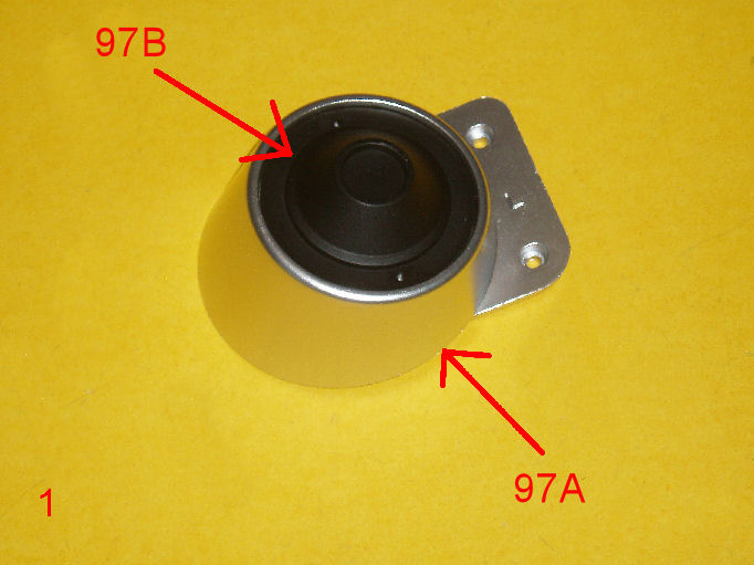

Pic 1: Press-fit the speaker 97B into the housing 97A.
Pic 2: Fit the subwoofer basket 97C to the assembly as shown.
Pic 3: Fit the subwoofer cap 97D to the subwoofer basket 97C.

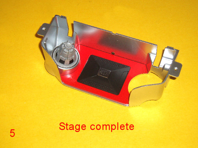

Pic 4: Retrieve the boot liner 95A from stage 95 and place it upside down in the position shown.
Fit the speaker assembly into the left aperture and fix with 2 x AP screws.
Pic 5: Shows the assembly so far.

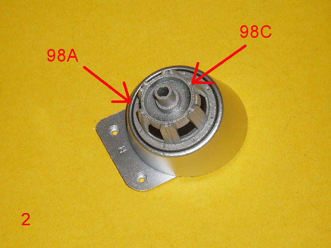

#6 Posted : 04 July 2025 10:06:37
Posts: 5,188
Points: 15,713

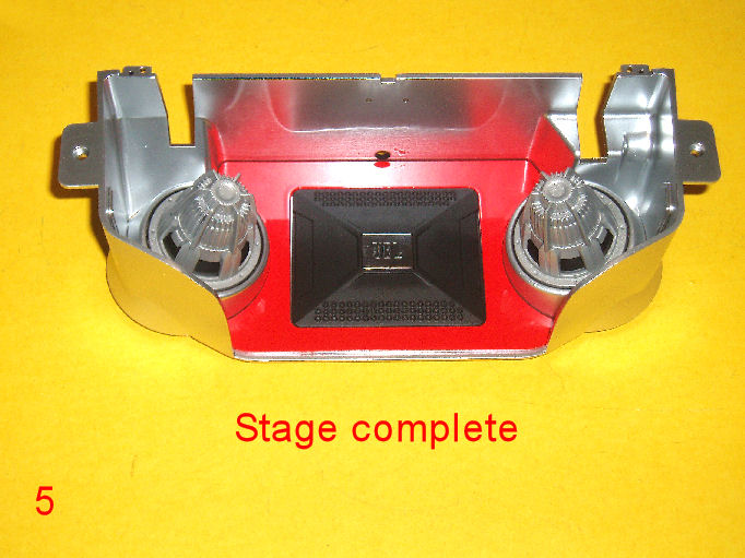

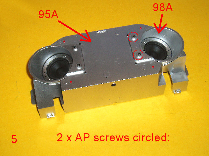

STAGE 98:
Sound system 4.

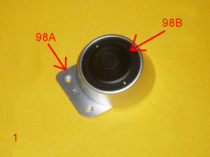

Pic 1: Press-fit the speaker 98B into the housing 98A.

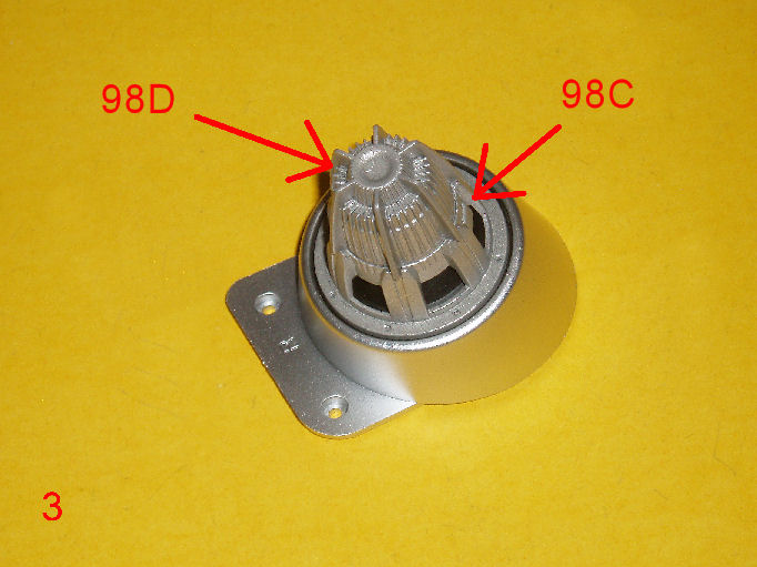

Pic 2: Fit the subwoofer basket 98C to the assembly as shown.
Pic 3: Fit the subwoofer cap 98D to the subwoofer basket 98C.
Fit the speaker assembly into the right aperture and fix with 2 x AP screws.
