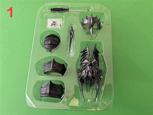

Picture 1 shows the contents of the parts for this issue.

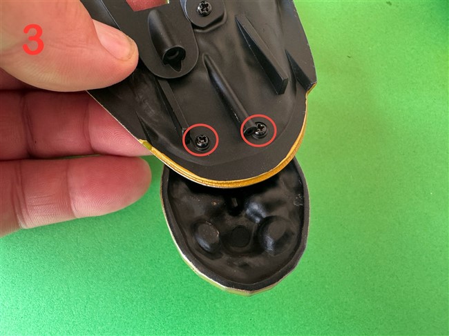

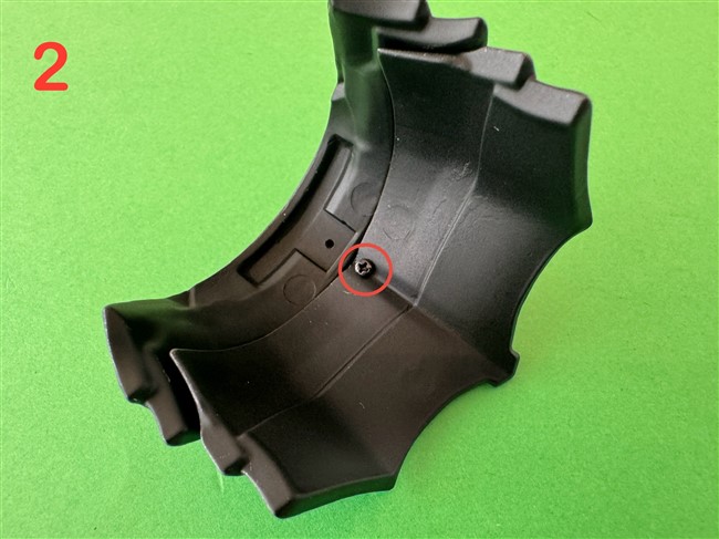

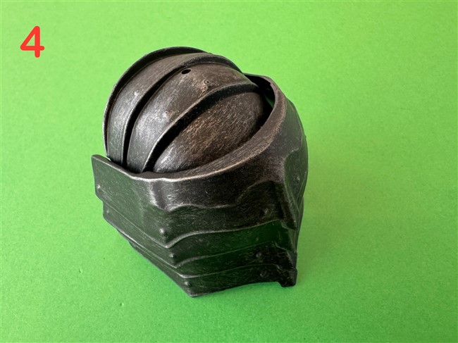

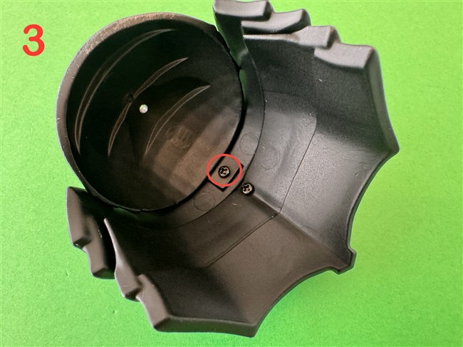

Take the helm’s lower rear lame (1A) and position it inside the helm’s upper rear lame (1B). Secure the two in place using an AM screw, picture 2. Position the helm’s skullcap into the recess of the helm’s upper lame and fit the square tab into the recess and secure with an AM screw, picture 3. Picture 4 shows the result.

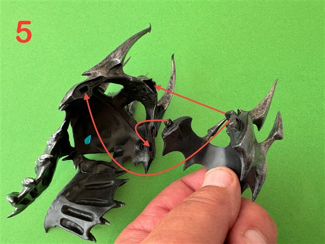

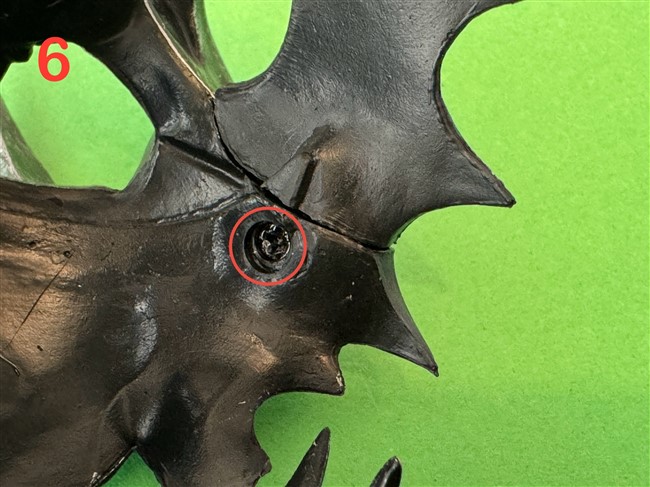

Position the crown (1F) onto the back of the Helm of Domination (1E) as shown in picture 5. Secure the two side tabs using a BP screw, pictures 6 and 7. Note: leave the top tab until later.

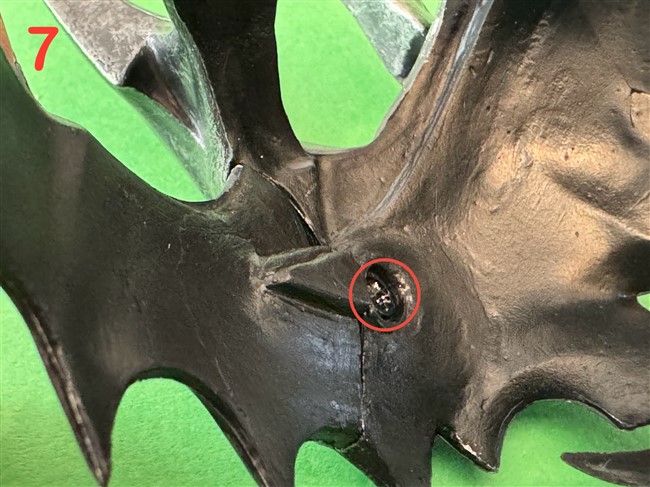

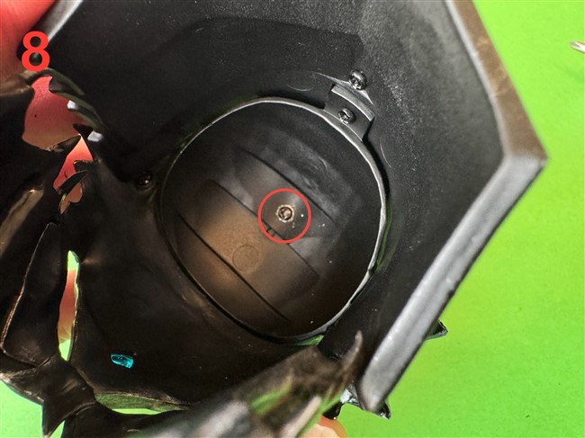

Take the helm skullcap and place it inside the Helm of Domination and secure it in place by placing a BP screw into the top tab, picture 8.

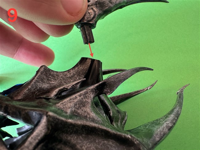

Finally, fit the top spike (1D) into the protrusion in the centre of the helm, picture 9.

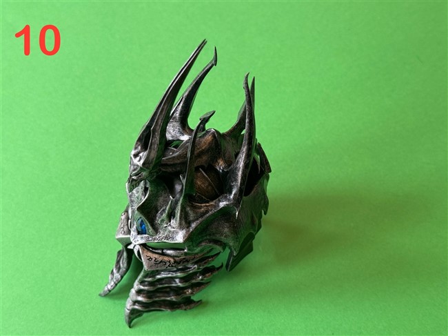

Picture 10 shows the complete assembly for this issue.

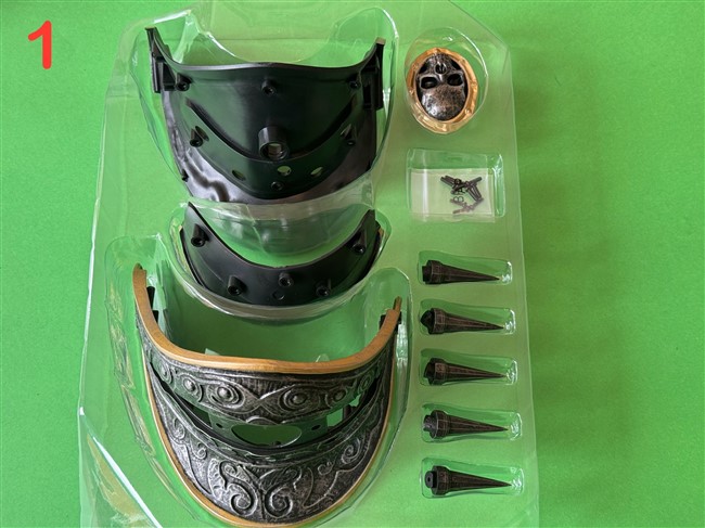

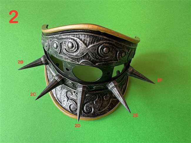

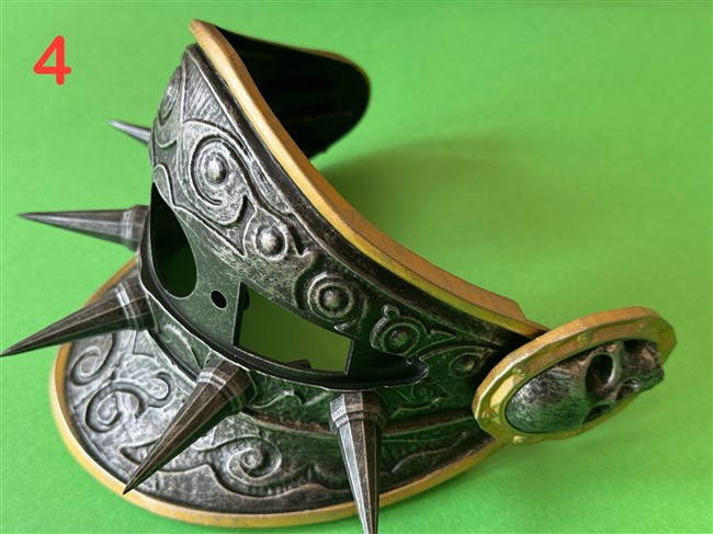

Position the five spaulder spikes (2B, C, D, E and F) as shown illustrated in picture 2 and secure them in place using AP screws.
Note: The spikes look very similar to each other. You will notice that some have a deeper tab on the ends. I would recommend test fitting them, placing them in order of assembly before fitting. They should all fit snug to the spaulder.
Attach the left spaulder rondel (2A) to the front of the spaulder using 2 x BP screws, pictures 3 and 4.
Picture 5 shows the complete assembly for this issue.
