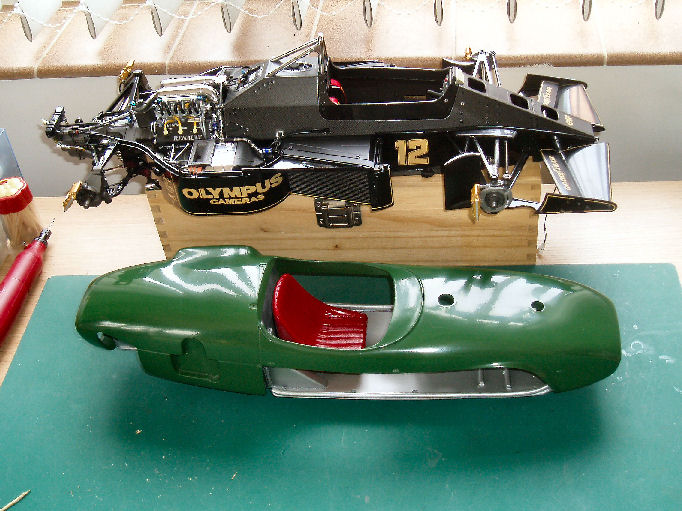

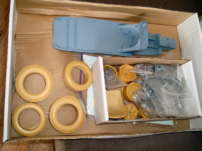

This is a very old kit from my stash.
Resin and metal - about 120 parts so it's pretty simple.
I think I'm going to do the green Jim Clark car.
I'll be doing this one 'in between' the main forum stuff.
Hopefully a fun build and for once, it's not a 'wreck restration'...BigGrin

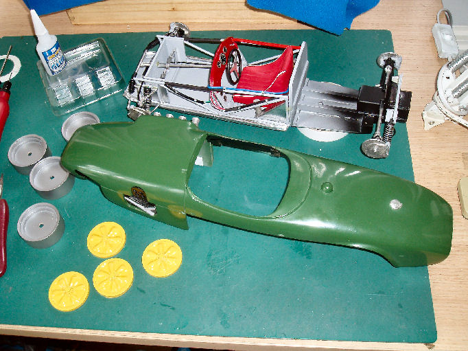

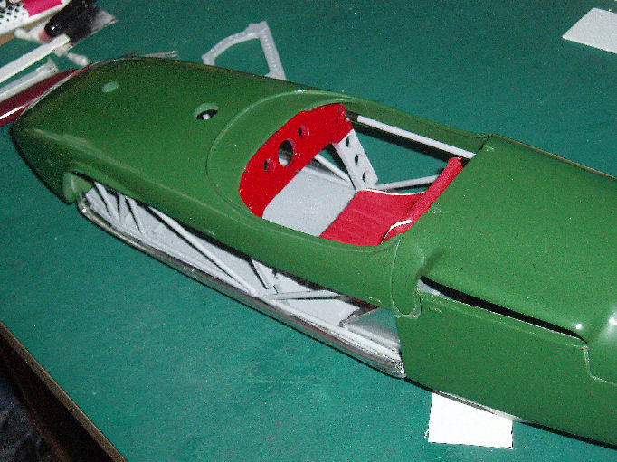

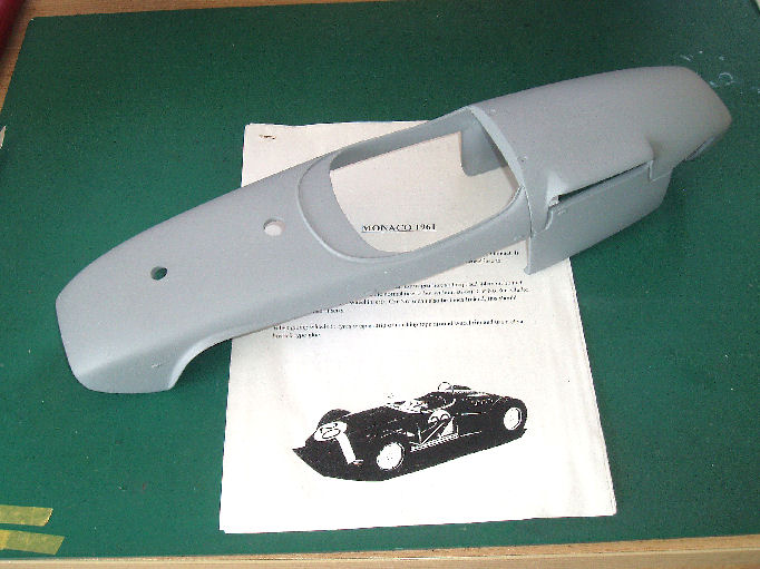

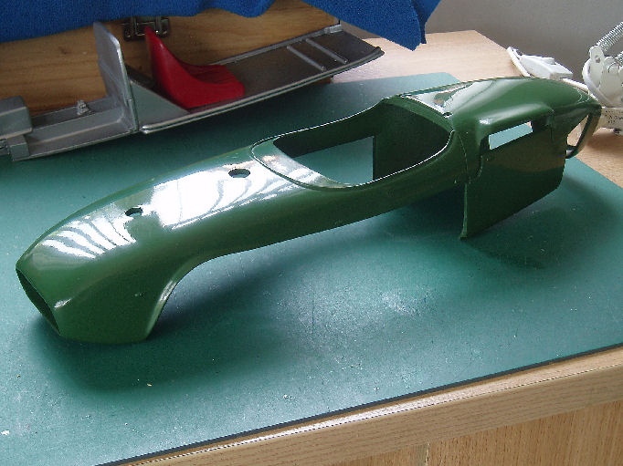

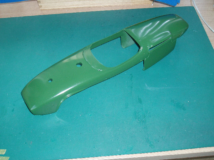

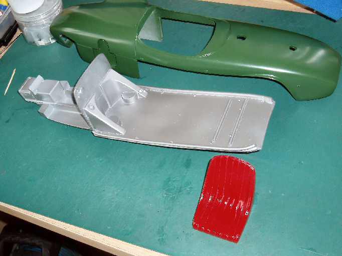

I've now given the body a few coats of old Lotus BRG.
Another few coats to add before a good polish.

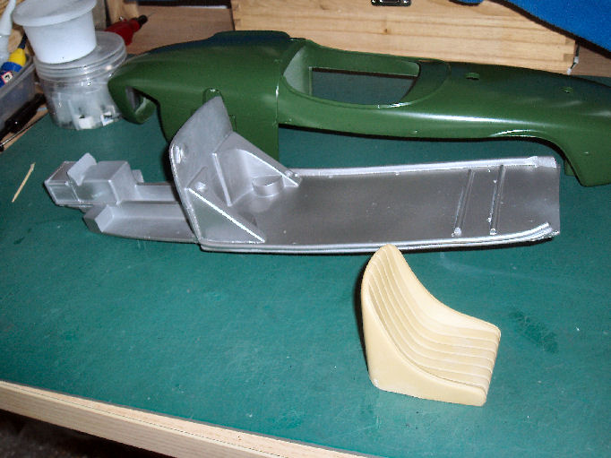

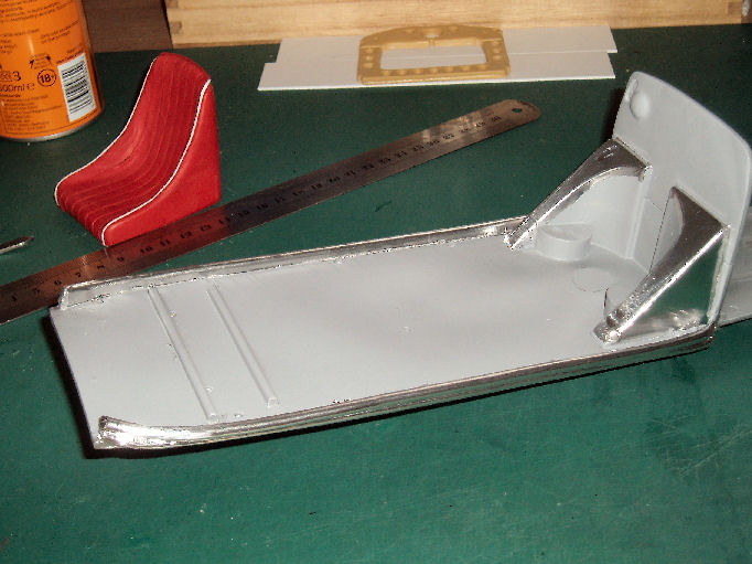

The floor panel was very badly warped so it was given a good soak in hot water, dried and a bit of weight in the middle.
Hopefully this will sort it.
I'm going to have to make my own body side panels as they are missing from the kit.
On we go...BigGrin

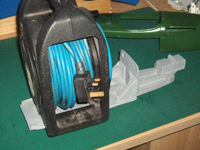

I think I've just about sorted the badly warped floor.
It's still not perfect but it will be screwed to the body later on which will sort any problems.

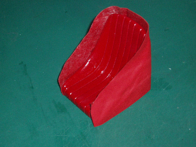

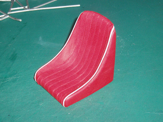

I'm going to trim the seat in leather but it's painted red first just in case there are any little gaps where the resin could show.
Hopefully not at all but as they say, better safe than sorry. LOL LOL LOL

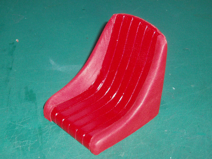

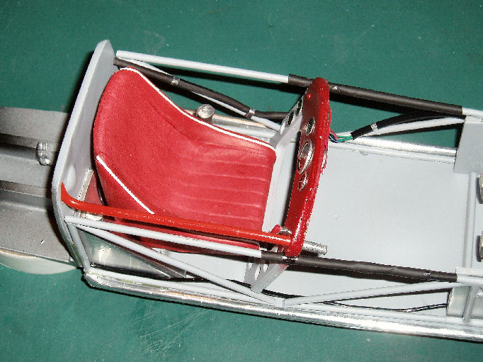

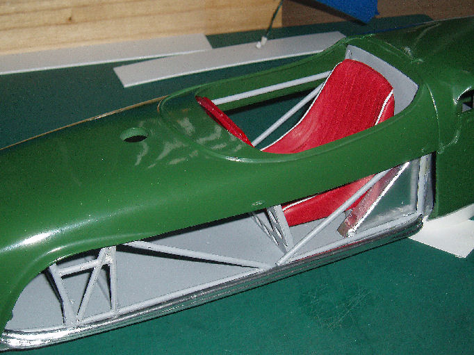

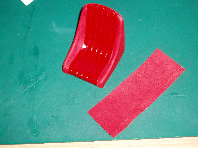

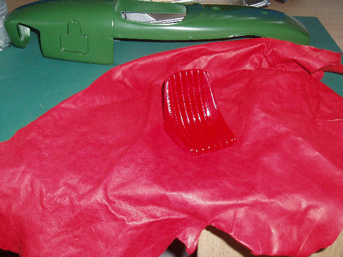

I've given the body a bit of T-cut and a buffing.
Still more to do but it's looking better.

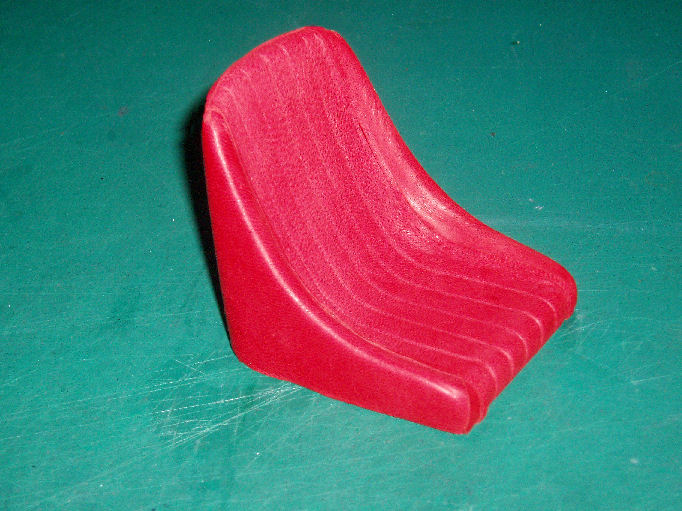

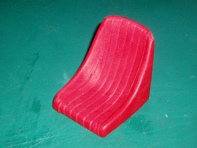

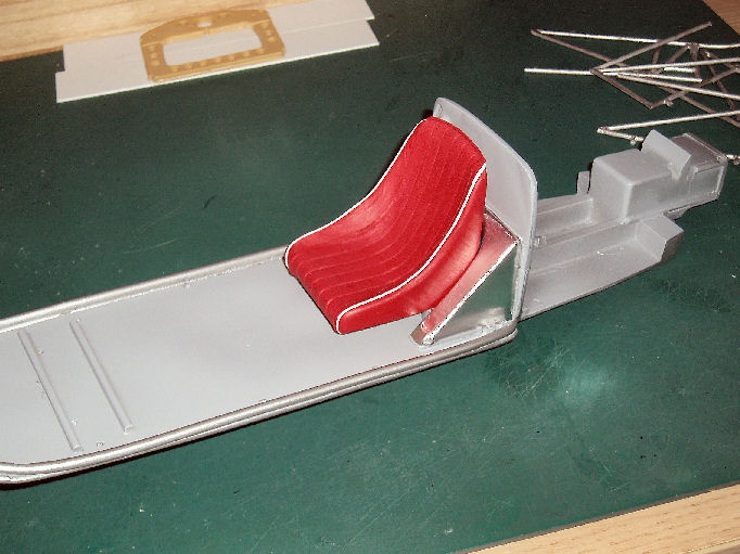

Next was to trim the resin seat in leather.
The resin casting was actually very good but I just feel that at this scale, real leather looks better.
In all it took me about an hour.

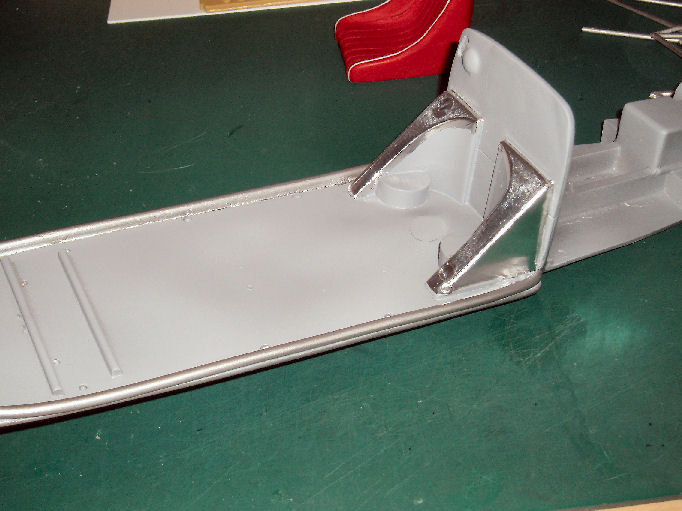

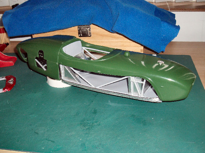

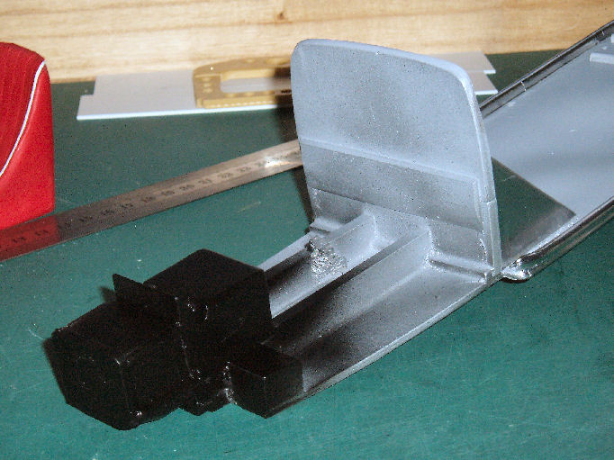

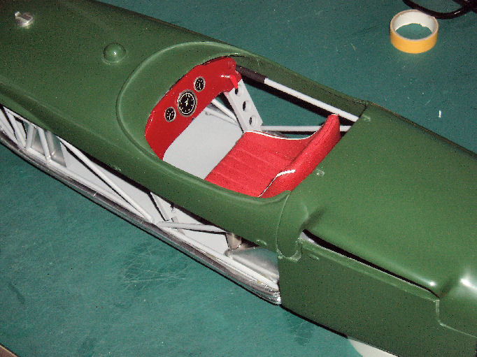

A bit more research on this one has shown the interior floor and engine bulkhead should be grey.
Sorted.
I've also foiled the two side tanks and the pipes, and added white trim to the seat.
Interior body frames next.

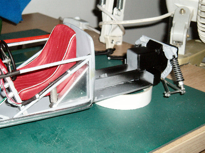

#7 Posted : 25 June 2025 14:02:20
Posts: 5,176
Points: 15,677

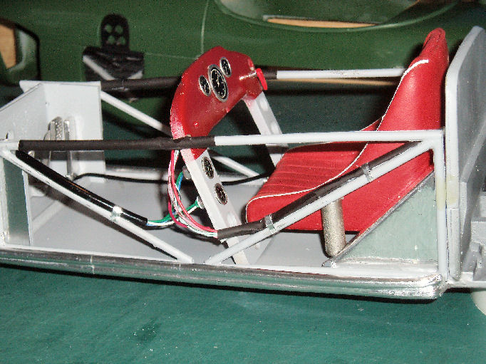

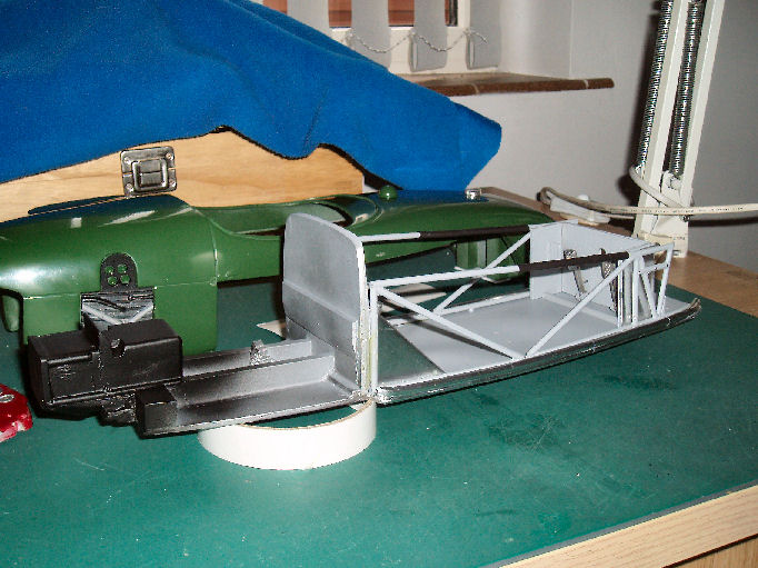

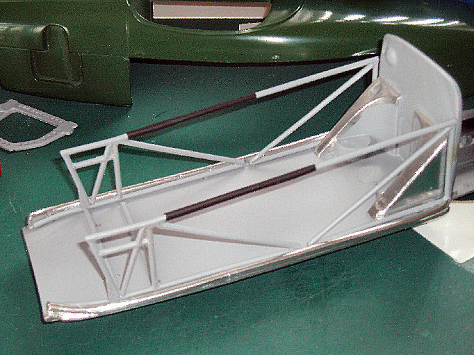

Moving on a bit with this one.
I've already mentioned that the instructions are possibly the worst I've ever come across. I'm having to Google just about every part of the real car to work out how the parts fit.
Testing the side frames, bulkhead/dashboard and seat. At least they fit although the side frame fixing pins on the bottom edges are out of alignment with the locating hols just a bit, so they won't fit without the pins being cut off.
On we go.LOL LOL LOL

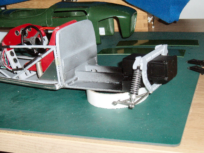

I've built the pedal box and fitted it to the floor.
The front frames aren't yet fixed in place as I want to check the front suspension setup first.
The body fits nicely so I'll be moving forwards with the suspension all-round before adding the dashboard/bulkhead and then fitting the body.
It's a very basic kit but it's a fun build.

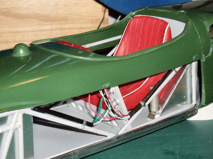

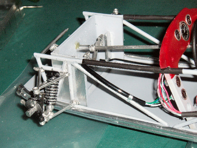

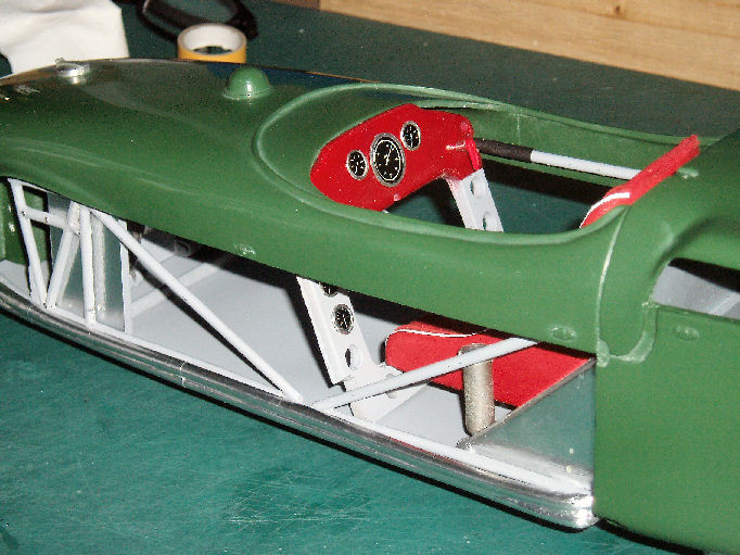

Dashboard and seat now fixed in place.
As I'm going to make the side panels removable, there needs to be some of the missing wiring and pipes etc that should be there.
I've added stuff to the back of the dashboard and an accelerator cable.
Still lots more to add.
On we go.

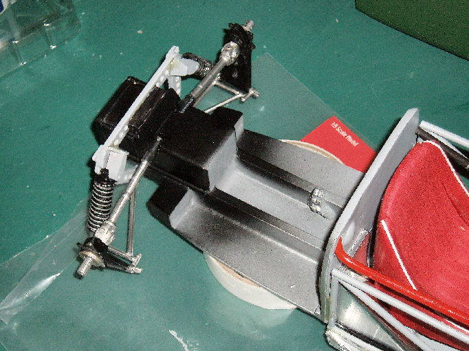

#12 Posted : 02 July 2025 17:59:48
Posts: 5,176
Points: 15,677

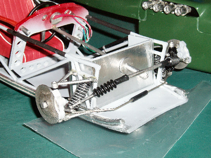

Back on this one for a while...
Starting to build up the rear suspension.
Like most kits of this type, parts fit where they touch.
Liberal use of epoxy glue required.LOL LOL LOL

#13 Posted : 04 July 2025 12:33:00
Posts: 5,176
Points: 15,677

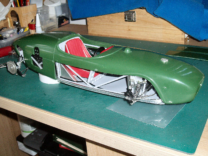

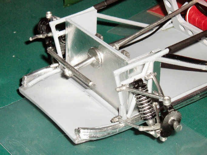

Suspension and steering now sorted all round.
As mentioned, the fixing points barely exist so the majority of parts have been adapted/altered/added to so the pieces can be built with a good degree of strength.
Assembled with cyano to begin with to hold the parts in place then epoxy added afterwards for proper strength.
Not long until the body is fitted permanently, then the side panels, wheels, detail bits and finally the decals.
Hopefully completed by this time next week. BigGrin

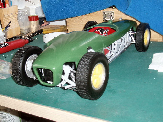

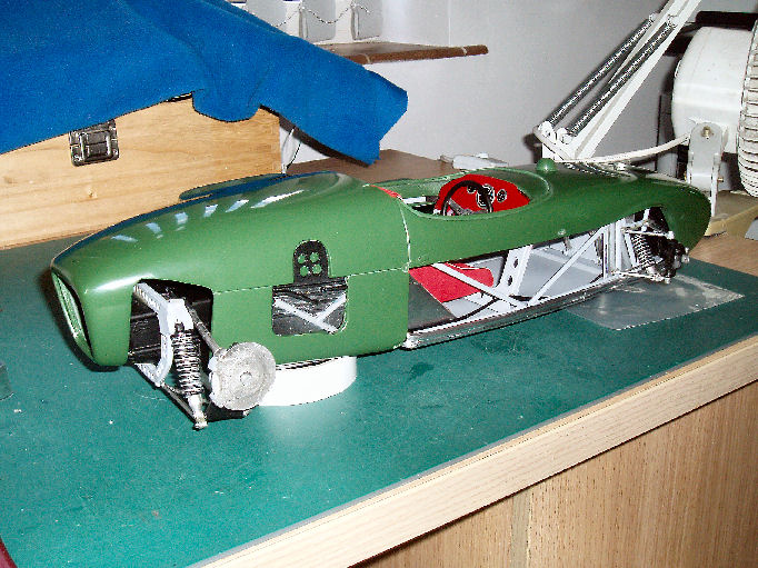

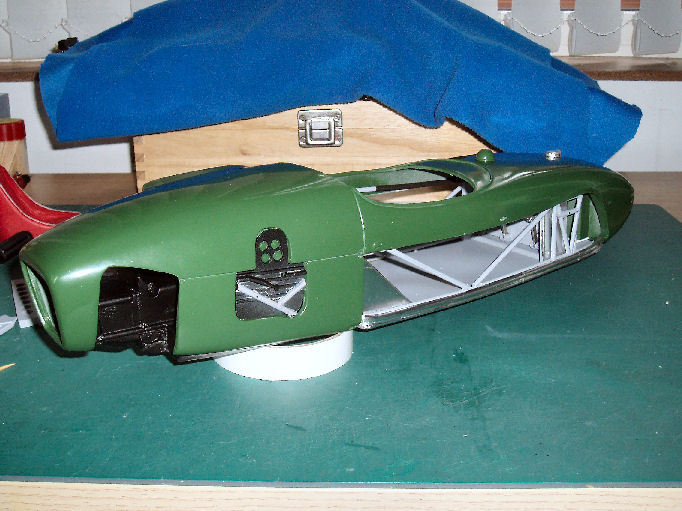

#14 Posted : 06 July 2025 13:04:23
Posts: 5,176
Points: 15,677

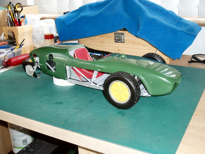

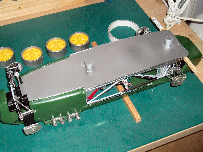

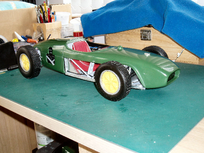

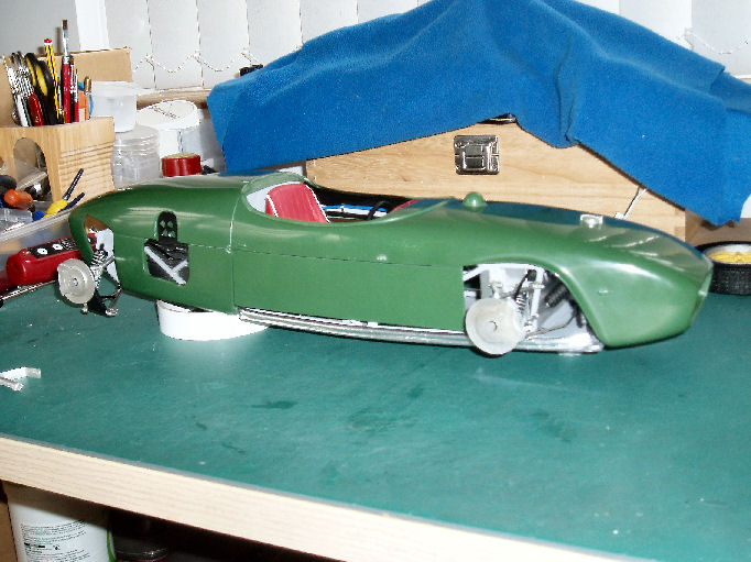

The body and chassis are now permanently fixed using epoxy and screws.
Wheels painted and assembled but not yet fixed to the car.
They are just standing in place for the pics.
Exhausts, mirrors, trailing arms, screen and decals to go...BigGrin
#15 Posted : 08 July 2025 15:21:03
Posts: 5,176
Points: 15,677
4 wheels on my wagon...
Getting there.BigGrin
