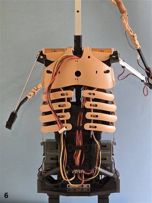

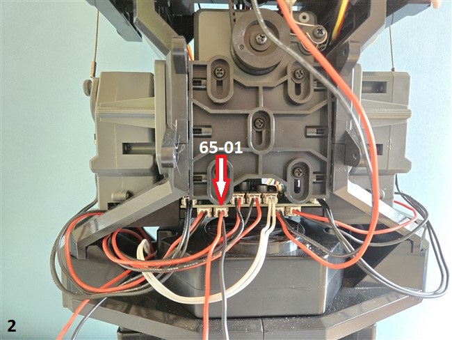

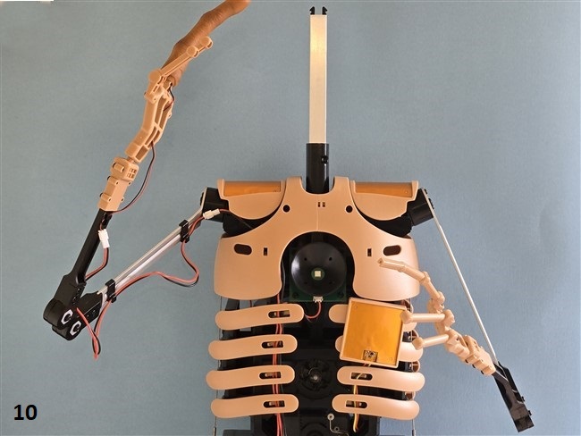

#1 Posted : 08 June 2025 23:15:39
Hi All, BigGrin
I`m back with the next pack of ET, that covers issues 87-92.

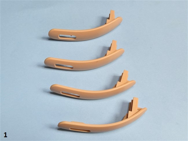

Parts supplied.....Pic 1, you also need ET(on his stand) and the two remaining cables from Issue 65. Blink
Start by plugging one of the cables 65-01 into the front/lower side of the circuit board, as indicated in Pic 2.

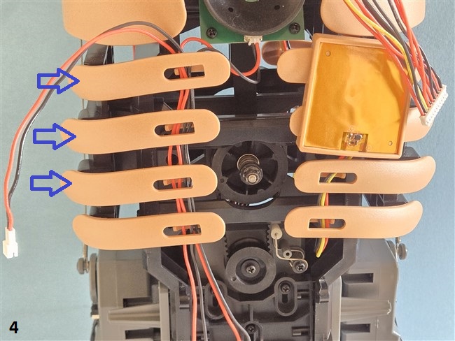

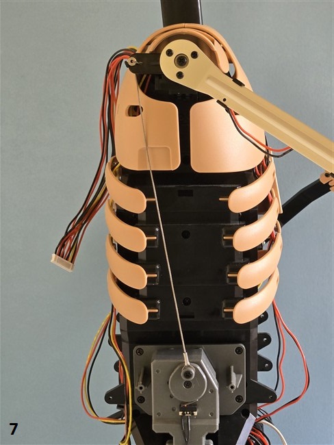

Take one of the ribs 87-01. Place the cable just fitted and the cable to ET`s heart and position them into the hook of the rib. Then fit the rib in the lowest position as shown in Pic 3.

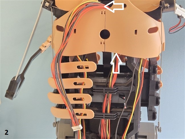

Now place both cables into the other three ribs 65-01 in the same manner as the first, Pic 4. The free end of the cable 65-01 is now passed under the chest plate as shown in Pic 5.

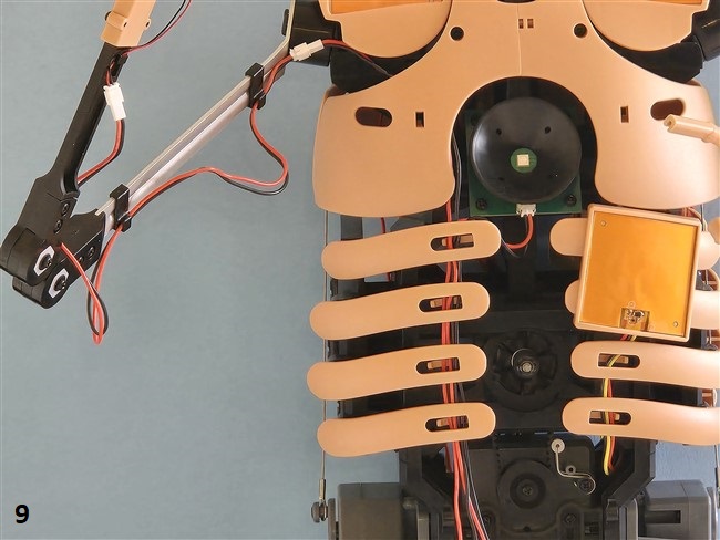

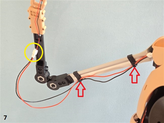

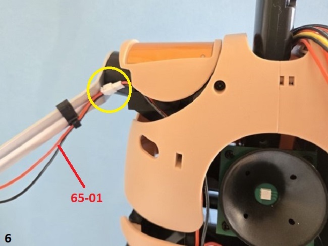

Connect the second cable 65-01 to the first and slot it behind the clip nearest ET`s shoulder, all in Pic 6. Then place the cable into the second clip of the upper arm and connect the loose end with the cable from ET`s finger, as shown in Pic 7.
Finally position the cable into the final clip (just below ET`s elbow) as shown in Pic 8.
Pics 9 and 10 show how things should look at the end of this update.

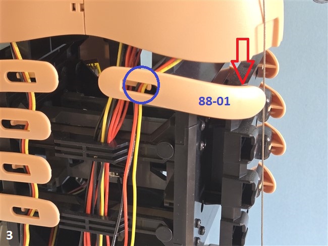

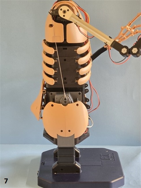

#2 Posted : 11 June 2025 15:47:16
Hi All, BigGrin
Its ET update time with Issue 88.
Parts supplied.....Pic 1, you will also need the main model assembly.
Before we start on any construction there`s a small tidy up to do. The large group of wires with the large plug need to be fed behind the rear upper back plate, see Pic 2.

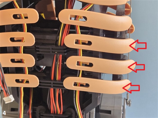

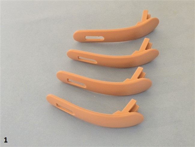

Now position the wires from the right shoulder sensor into the hook on one of the ribs 88-01 and press the rib into position as shown in Pic 3. With the wires not connected at the bottom end, I thought it easier to fit the ribs from top to bottom. It ends up the same either way.

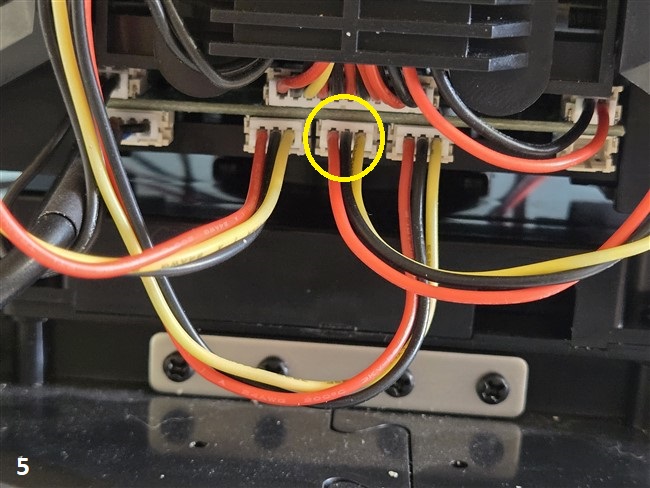

Fit the other ribs 3 x 88-01 in the same manner, Pic 4. Finally, plug the loose end of the wires into the rear/lower circuit board as indicated in Pic 5.
Pics 6 and 7 show the end assembly for this update.

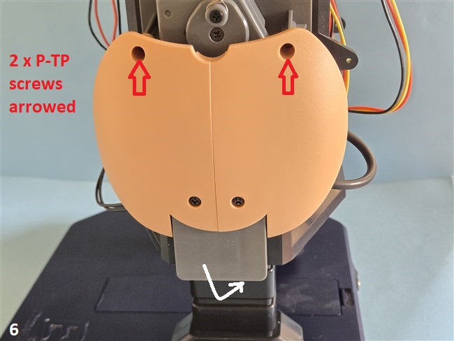

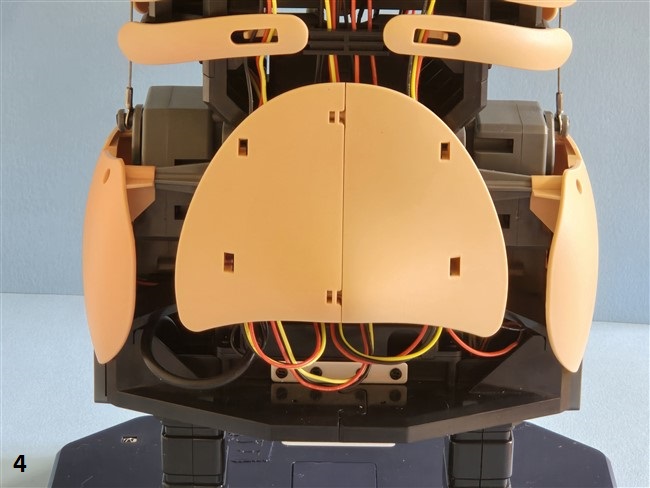

#3 Posted: : 14 June 2025 17:54:17
Hi All, BigGrin
Here we are with the Issue 89 update, where we fit ET`s left hip.
Parts supplied.....Pic 1, you will also need ET on his stand.

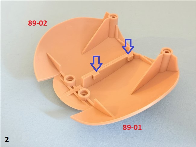

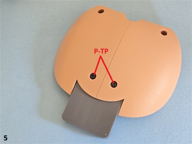

Start with the hip parts 89-01 and 89-02. Press the parts together, engaging the hooks on 89-02 over the edge of 89-01, as in Pic 2.

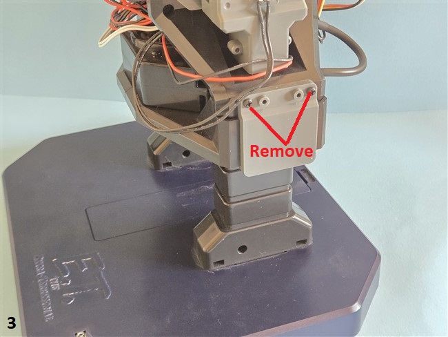

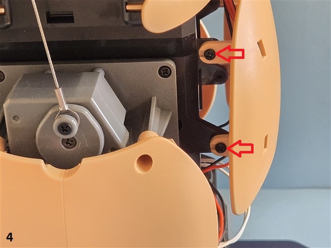

Working om ET`s left side, remove the two screws indicated in Pic 3 and the panel 63-02, shown in Pic 4. NOTE: At this point ET`s body is only connected to his legs on one side, so if you have to move him make sure the base is supported.
Fix the plate you just removed to the hip assembly and fix them together with 2 x P-TP screws, Pic 5. Now engage the hook at the bottom of the assembly into its previous position and fit the shoulder plates onto the long posts that emerge from ET`s side. Make sure all the parts are fully engaged and fix them together with 2 x P-TP screws as shown in Pic 6. The completion of this update is shown in Pic 7.

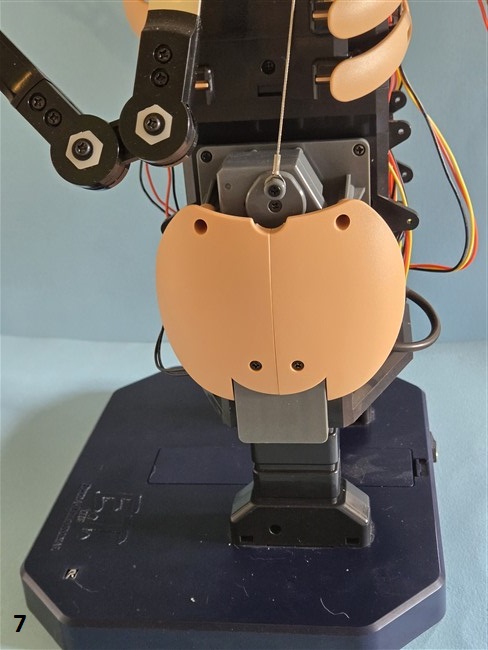

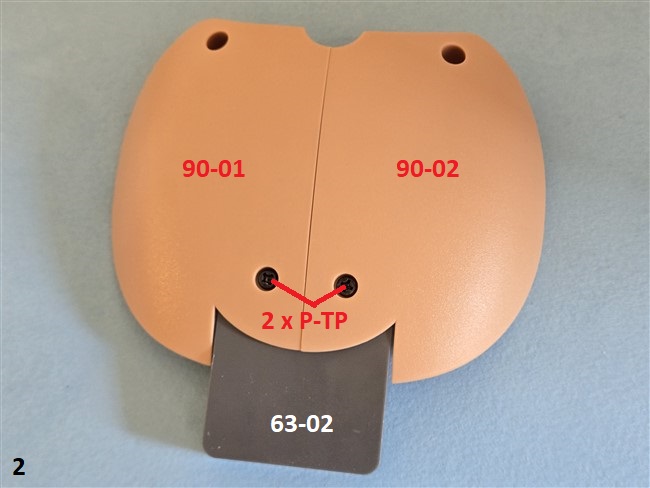

#4 Posted : 18 June 2025 17:04:57
Hi All, BigGrin
Here we are with the next ET update, Issue 90. This will be a shortened update as it replicates Issue 89, just the opposite side.
Remove the screws from the Torso to Leg connector plate 63-02 (right hand side) and remove the part. Press the parts 90-01 and 90-02 together and fix them to the part removed with 2 x P-TP screws, Pic 2.
Hook the bottom of the assembly back to the model and fix the top edge with 2 x P-TP screws, Pic 3.
Pics 4 and 5 show the end result of this update.

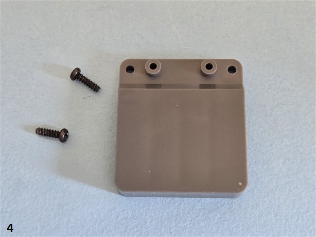

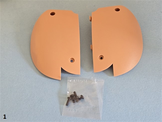

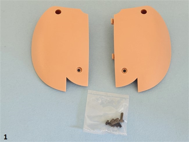

#5 Posted : 22 June 2025 17:38:09
Hi All, BigGrin
As we close in on the end of this pack, ET gets some more structural shaping with his stubby tail end.
Parts supplied.....Pic 1, you also need the main model on the stand.

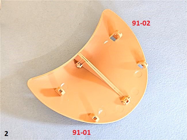

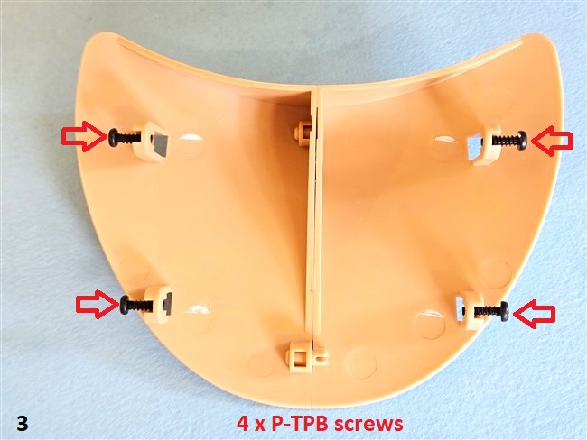

Start by pressing the parts 91-1 and 91-2 together, as shown in Pic 2 and then screw 4 x P-TPB screws slightly into place as shown in Pic 3.
Now with ET`s back towards you, position the previous assembly as shown in Pic 4, making sure that the unrestrained wires from the shoulders are now behind the added panel. Next tighten the four screws into the rear frame, two on one side shown in Pic 5, repeating on the opposite side.
ET should now have the structure shown in Pic 6 and Pic 7 to end this update.

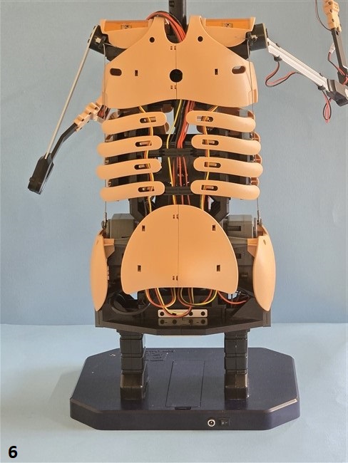

#6 Posted : 24 June 2025 18:07:30
Hi All, BigGrin

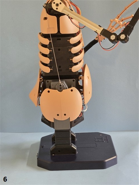

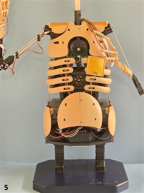

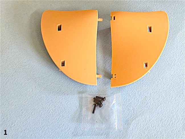

We`ve made it to the end of another pack (Not many left now), with Issue 92. Here we add ET`s front body shaping panel.
Parts supplied.....Pic 1, you will also need the main model on the stand.

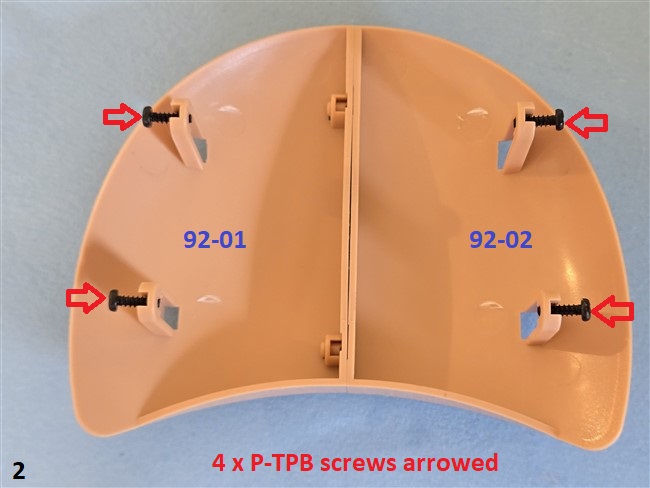

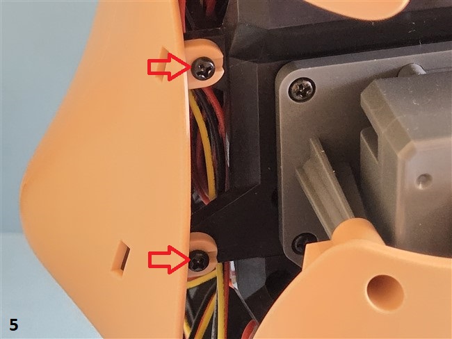

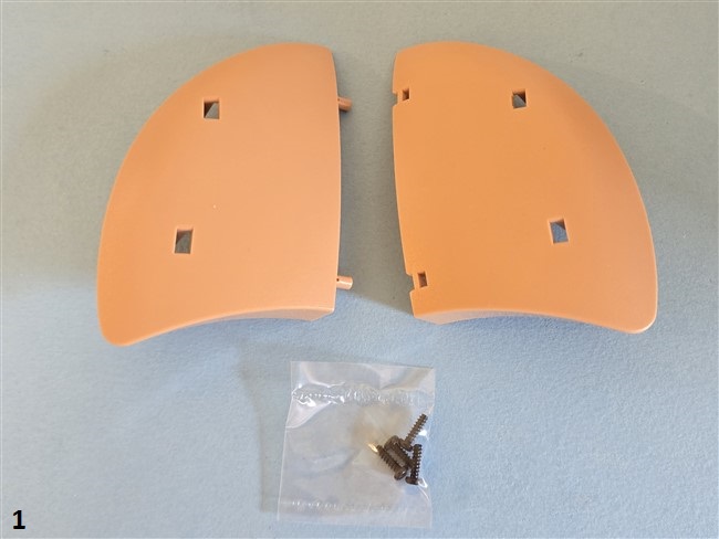

Press the parts 92-01 and 92-02 together and pre-fit the 4 x P-TPB screws, as shown in Pic 2.
Now place the assembly up to ET`s body, making sure that any untethered cables are positioned between the fixing points, as in Pic 3. Then tighten the four screws (two each side) as shown in Pic 4.
That`s all for this update, with ET`s new shape shown in Pic 5 and Pic 6.
