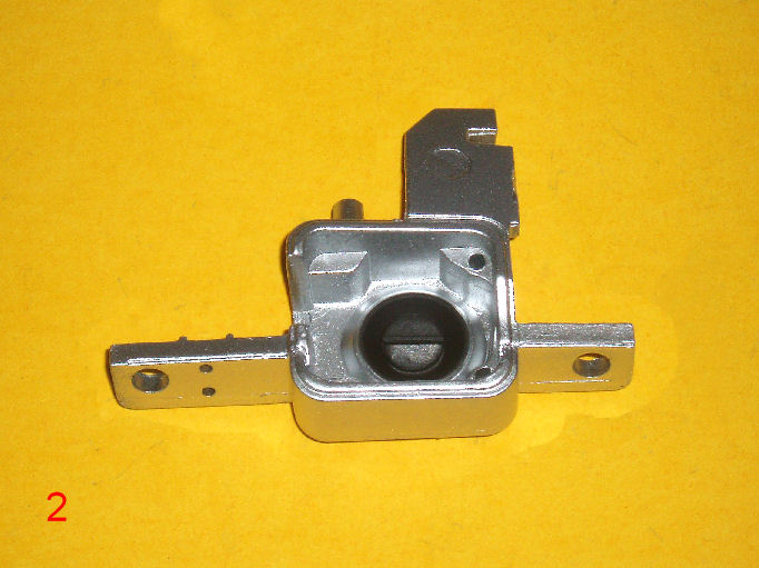

STAGE 87:

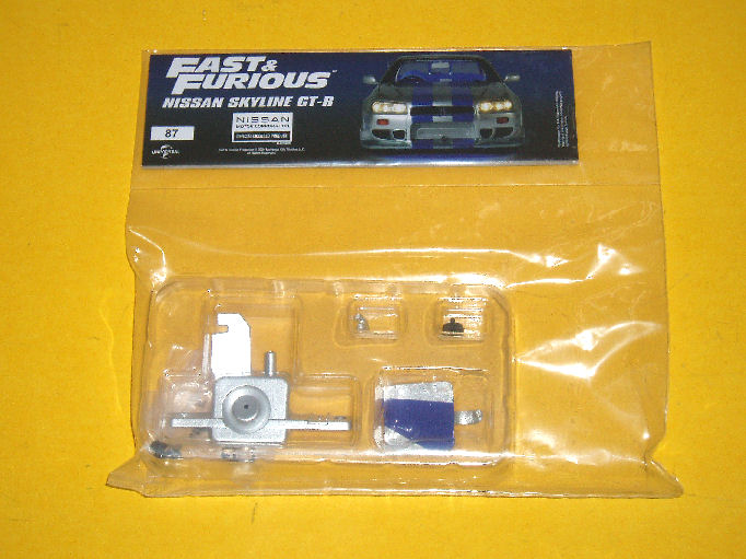

Fuel filler cap.

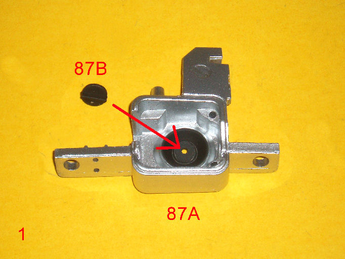

Pic 1: Locate the tank neck and fuel cap 87A and 87B.
Pic 2: Press-fit the cap into place as shown.
Pic 3: Retrieve the main body shell and turn it upside down.

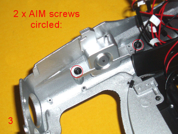

Fit the fuel assembly inside the body as shown and fix with 2 x AIM screws.
Pic 4: Fit the small bracket 87D as shown and fix with 2 x AM screws.

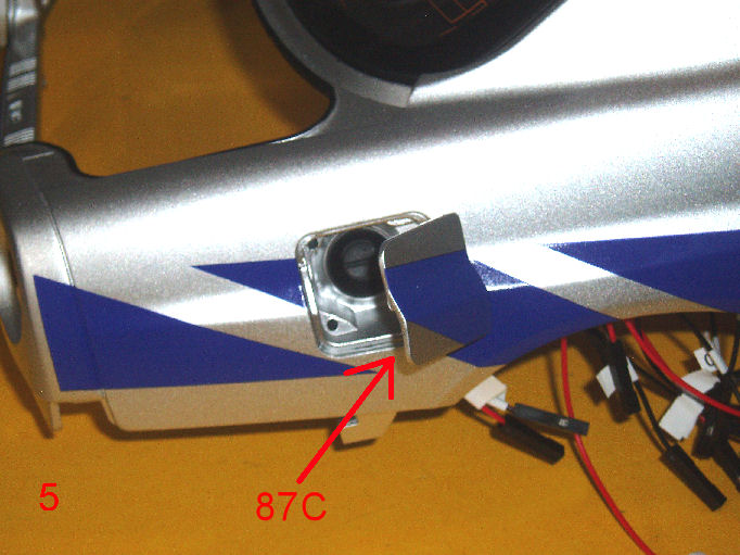

Pic 5: From the outside, fit the fuel cover flap 87C as shown so the arm goes through the inside of the body.
Pic 6: From the inside, secure the cover flap arm to the bracket 87D using 1 x IM screw.

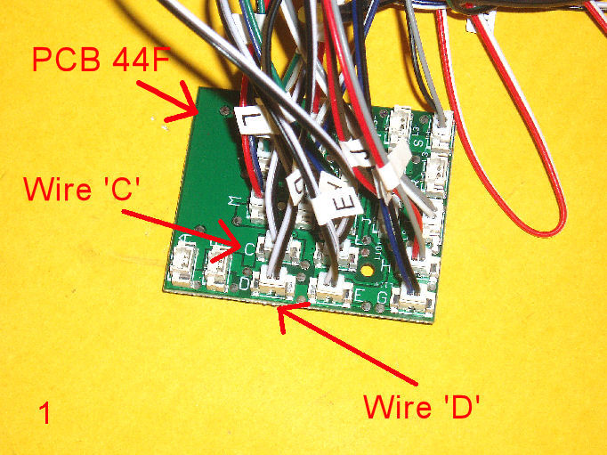

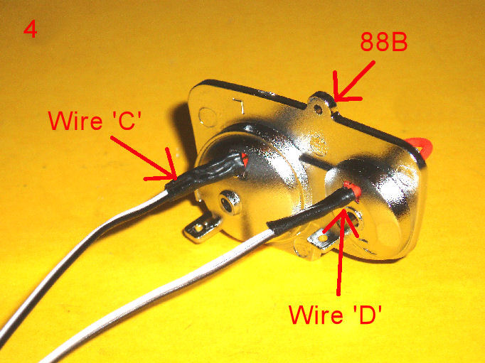

STAGE 88A:
Rear lights.
NOTE: There are several errors in the printed instructions for this stage.
Please take care and follow this guide.

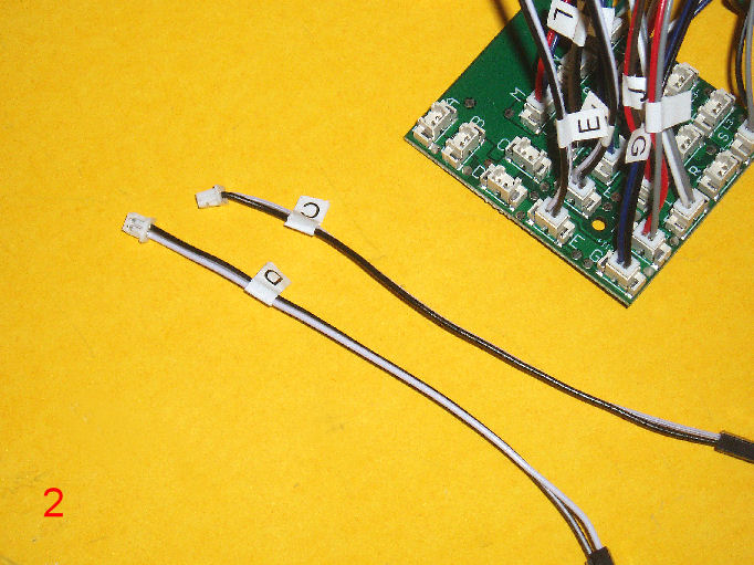

Pic 1: Retrieve the PCB 44F and locate the wires/plugs ‘C’ and ‘D’.
NOTE: In the printed instructions the wrong plug socket for wire C is shown.
Pic 2: Carefully unplug the two wires.

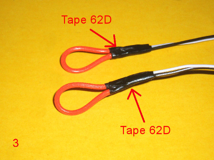

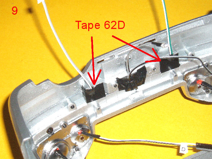

Pic 3: Using approx. 3cm pieces of tape from stage 62, wrap the wires together where the black and orange sections meet.
Pic 4: Locate the rear light 88B and feed the wires through the square holes as shown.
Fit the correct wire to each side.
NOTE: The part numbering in the printed instructions is very confusing. Follow the instructions here.

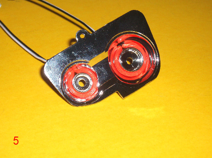

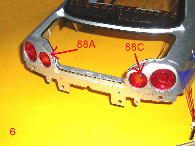

Pic 5: On the outside of the light, fit the LED’s as shown.
Pic 6: Press-fit the light reflectors 88A and 88C as shown, from inside the body.
They will only fit on the correct sides.
Pic 7: Turn the body upside down and fit the light as shown.

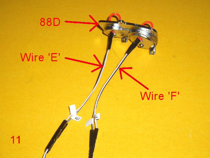

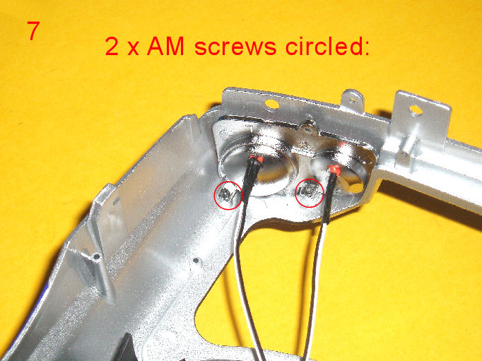

STAGE 88B:

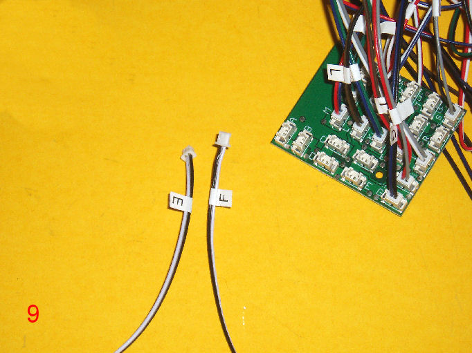

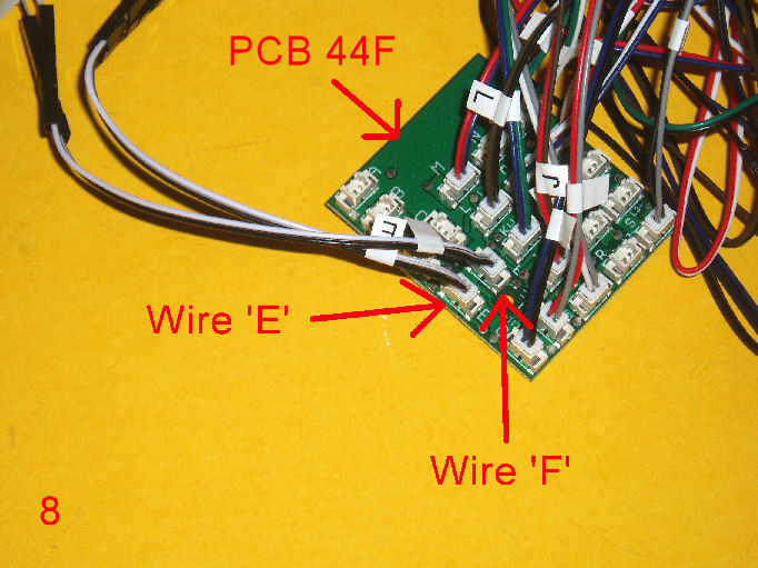

Pic 8: Retrieve the PCB 44F and locate the wires/plugs ‘E’ and ‘F’.
NOTE: In the printed instructions the wire numbering is again very confusing and also wrong.
Pic 9: Unplug wires ‘E’ and ‘F’.

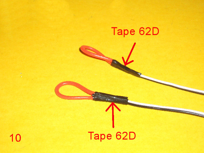

Pic 10: As before, wrap the wires using tape 62D.
NOTE: In the printed instructions wire ‘F’ is incorrectly labelled ‘C’.
Pic 11: Locate the rear light 88D and feed the wires through the square holes as shown.

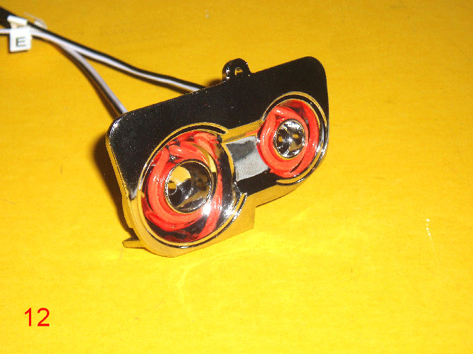

Pic 12: As before, loop the LED’s inside the light as shown.

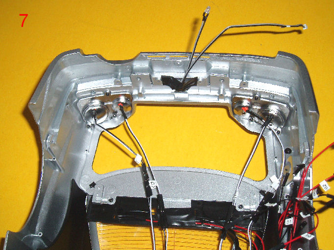

Pic 13: Turn the body upside down and fit the light as shown.
Care and patience is needed here as the parts are an awkward fit.

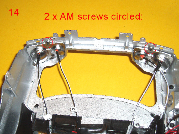

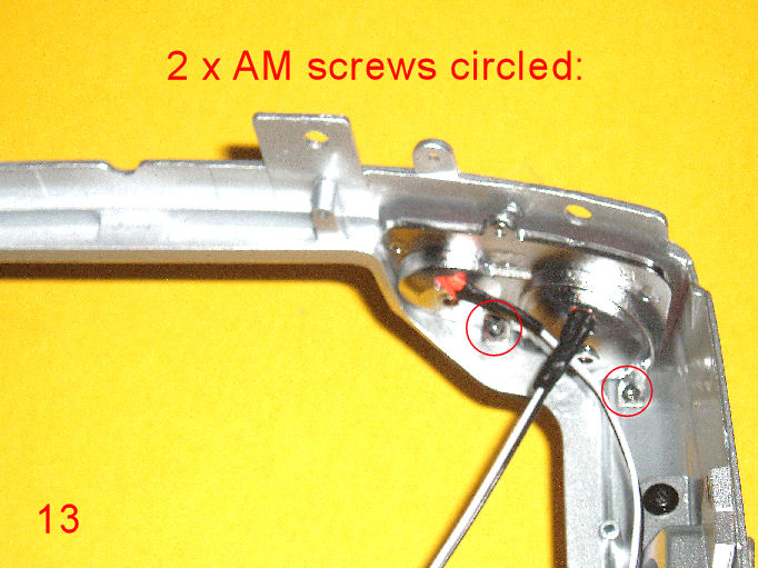

Pic 14: Fit two further AM screws as shown to secure the lights.

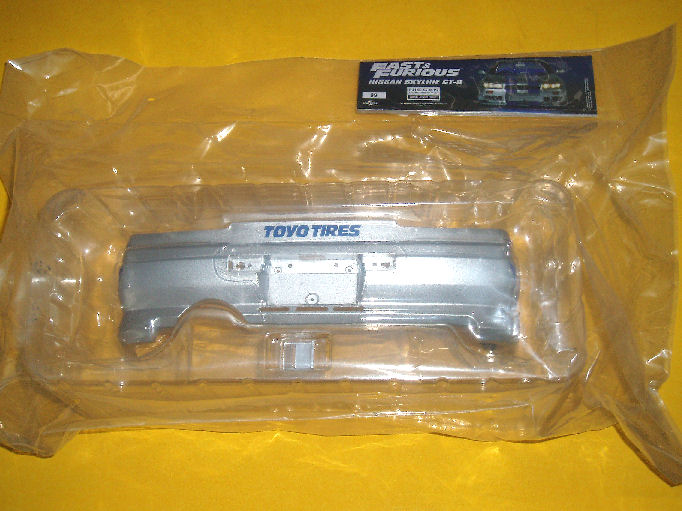

Rear Bumper.

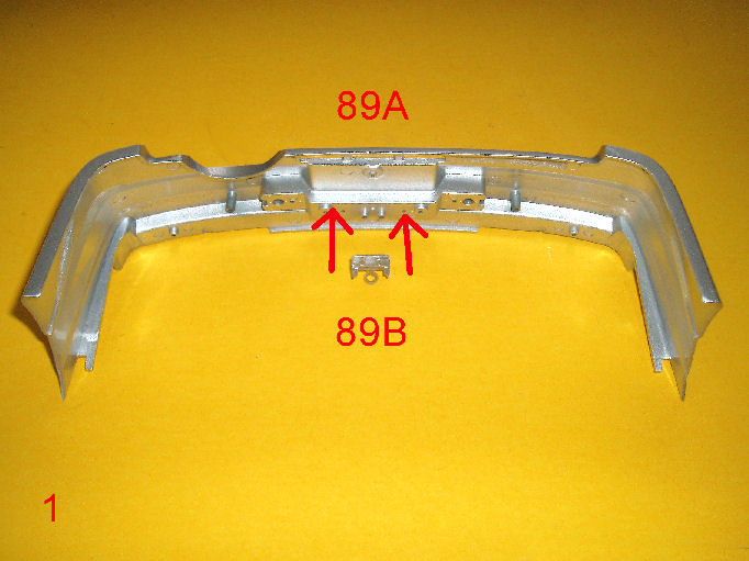

Pic 1: Locate the rear bumper and licence plate light holder parts 89A and 89B.
Pic 2: Fit the parts together as shown and fix with 2 x CM screws.

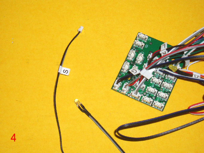

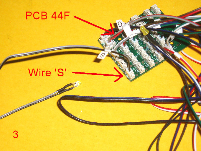

Pic 3: Retrieve the PCB 44F and locate the wire and plug ‘S’.
Pic 4: Carefully unplug wire ‘S’.
Pic 5: Fit the centre LED on wire ‘S’ into the hole on the licence plate lamp holder.

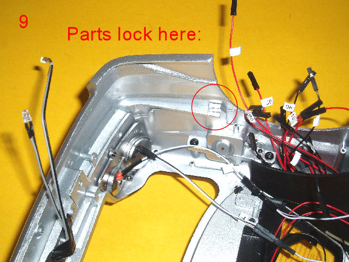

STAGE 89B:
Pic 6: Use a piece of tape 62D to hold the wires down.

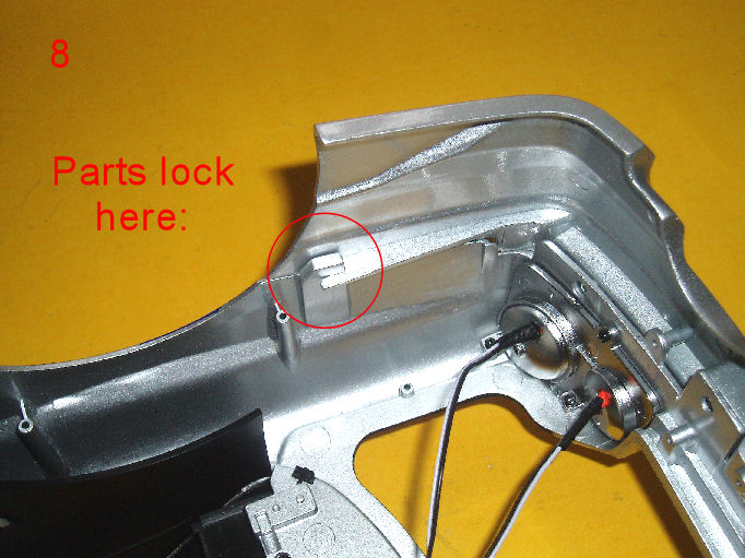

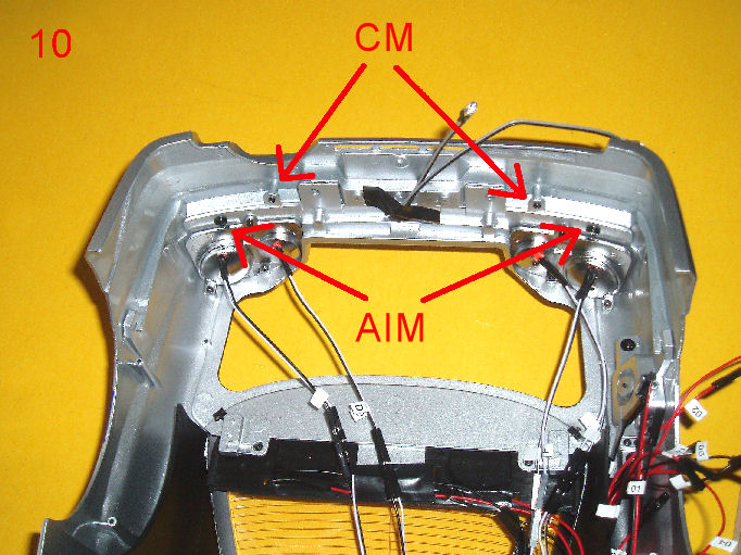

Pic 7: Retrieve the main body and turn it upside down to fit the rear bumper in place as shown.
Pic 8: The tab on the rear bumper must lock in place with the tab on the inside of the body as shown.
Pic 9: The tab on the other side of the rear bumper must also lock in place with the tab on the inside of the body as shown.

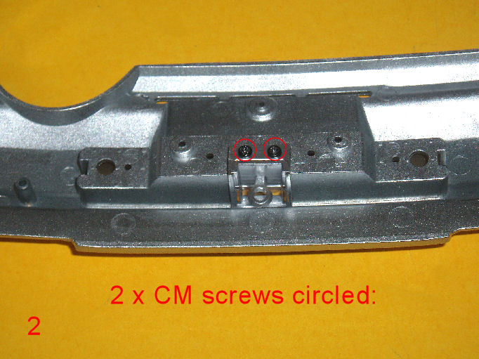

Pic 10: Fix the bumper to the body using 2 x CM and 2 x AIM screws.

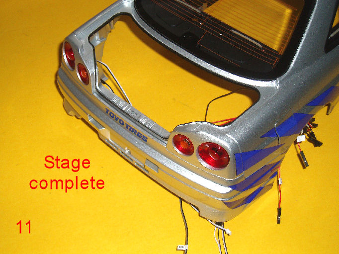

#6 Posted : 06 June 2025 14:43:02
Posts: 5,188
Points: 15,713
STAGE 90:
Licence plate and lights.

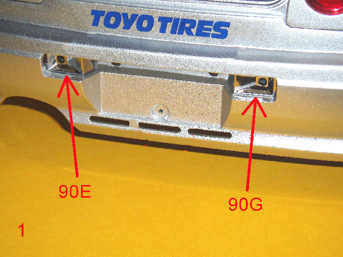

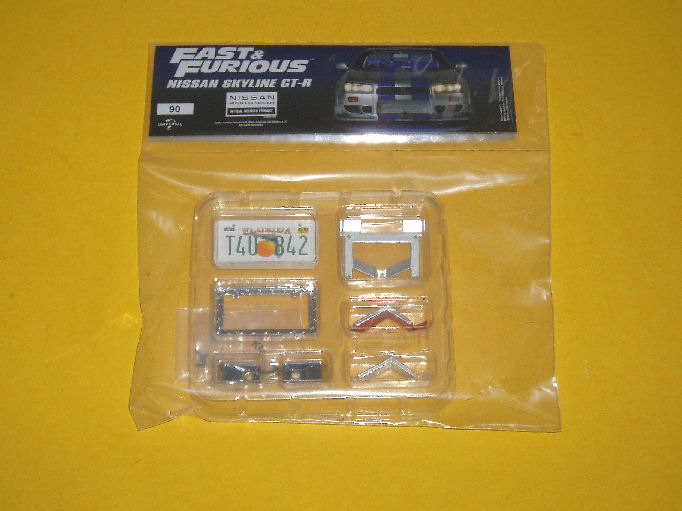

Pic 1: Retrieve the main body and fit the light reflectors 90E and 90G.
They are marked on the rear with ‘L’ and ‘R’.

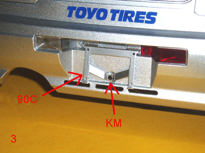

90E is ‘L’ and 90G is ‘R’.

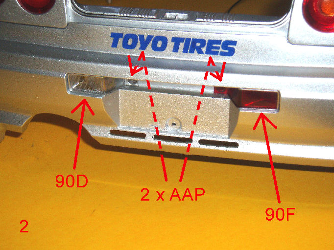

Pic 2: Fit the reflectors 90D and 90F as shown and fix from the inside with 1 x AAP screw in each.
Pic 3: Fit the licence plate holder 90C and fix with 1 x KM screw.

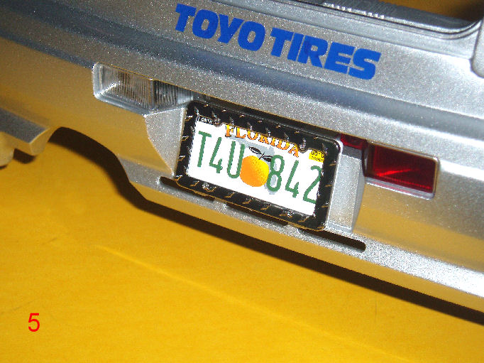

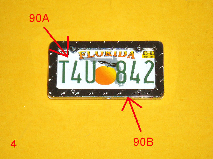

Pic 4: Press-fit the licence plate and frame together, 90A and 90B.
Make sure the two small inner projections on the frame are at the top.
Pic 5: Press-fit the assembly into the plate holder as shown.

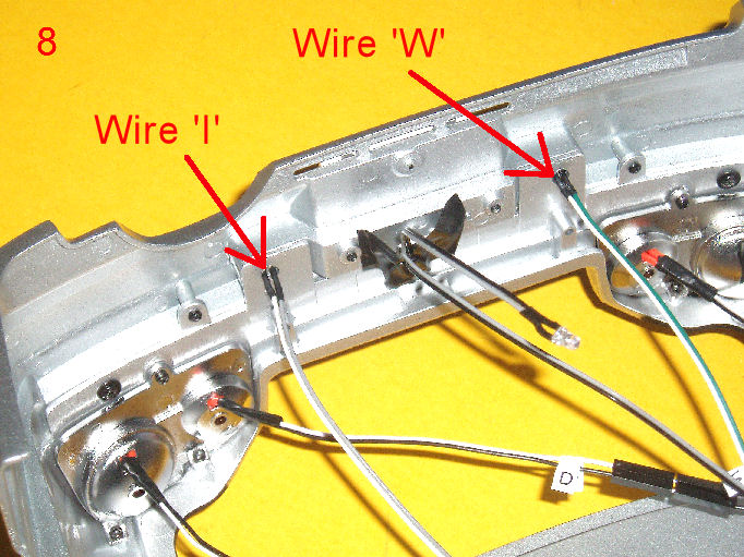

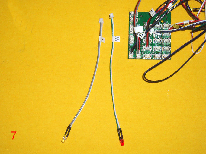

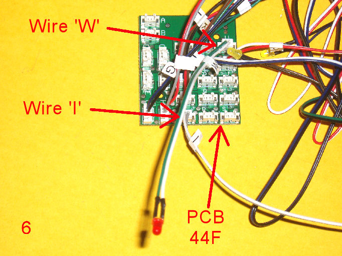

Pic 6: Retrieve the PCB 44F and locate the wires/plugs ‘I’ and ‘W’.
Pic 7: Carefully remove the wires.
Pic 8: Turn the car body upside down and fit the LED’s into the holes behind the lights as shown.
Pic 9: Bend the wires as shown and secure them using pieces of tape 62D.
NOTE: The printed instructions incorrectly call the tape 62A.
Store the model safely for now.

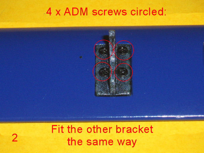

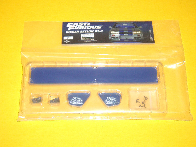

STAGE 91:

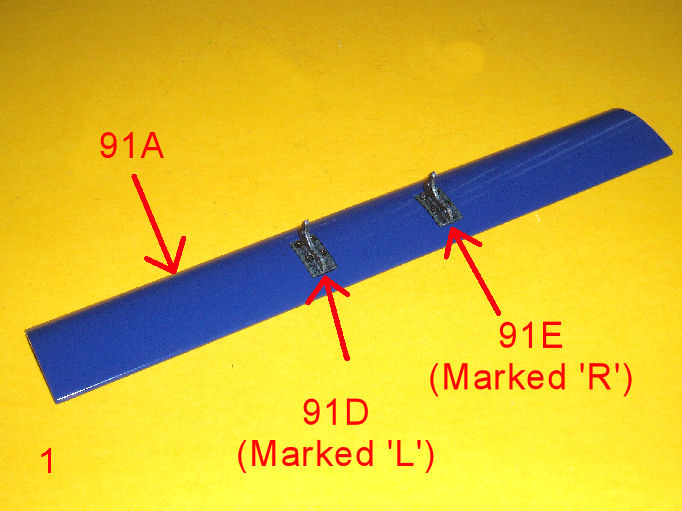

Rear spoiler.

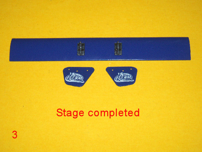

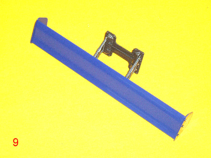

Pic 1: Locate the spoiler and mounting brackets 91A, 91D and 91E.
The brackets are marked on the inside ‘L’ and ‘R’.
Fit the brackets in place as shown. They will only fit one way.
Pic 2: Secure each bracket using 4 x ADM screws in each.
Pic 3: Store the parts safely for now.

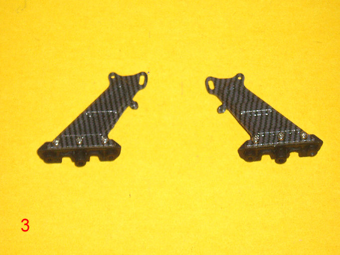

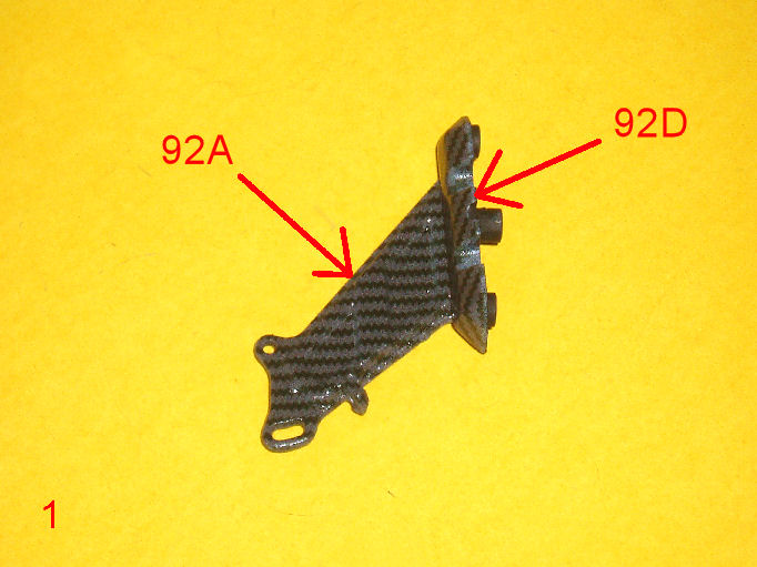

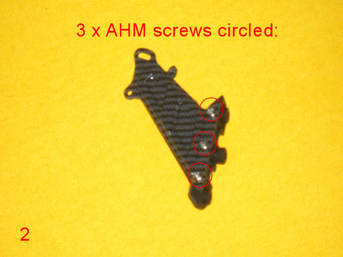

Pic 1: Fit the left spoiler mount parts 92A and 92D together as shown.
Pic 2: Fix the parts together from the other side with 3 x AHM screws.
Pic 3: Assemble the right spoiler mount in the same way.

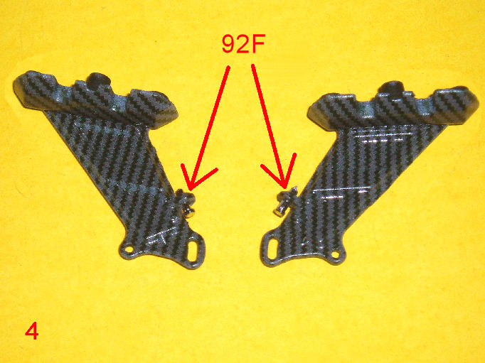

Pic 4: Press-fit the adjusting screws 92F into the bracket on each mount as shown.

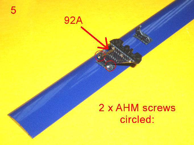

Pic 5: Retrieve the spoiler assembly from the previous stage and position it as shown.
Fit the left spoiler mount the outside of the bracket already on the spoiler and fix with 2 x AHM screws.

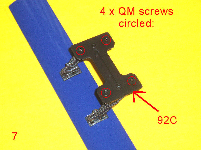

Pic 7: Fit the centre mounting plate 92C as shown with the plain black surface outwards.
Fix using 4 x QM screws.

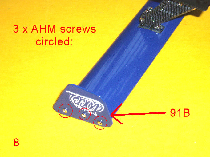

Pic 8: With the spoiler in the position shown, fit the left end plate 91B from the previous stage.
Fix using 3 x AHM screws.
Pic 9: Fit the other end plate in the same way.
