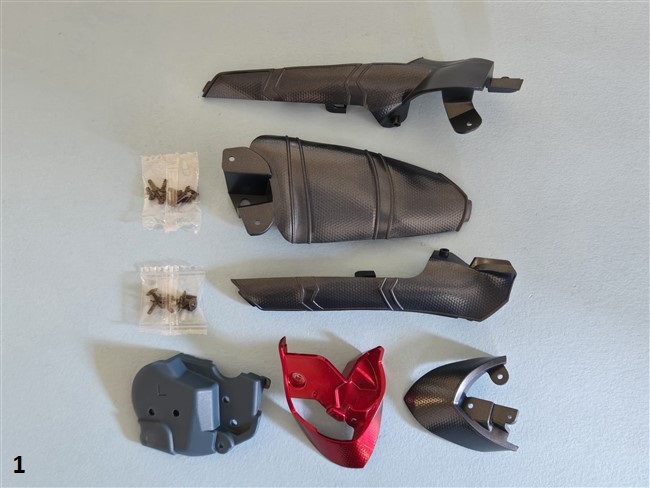

Parts supplied.....Pic 1, you will also need the left arm from issue 5.

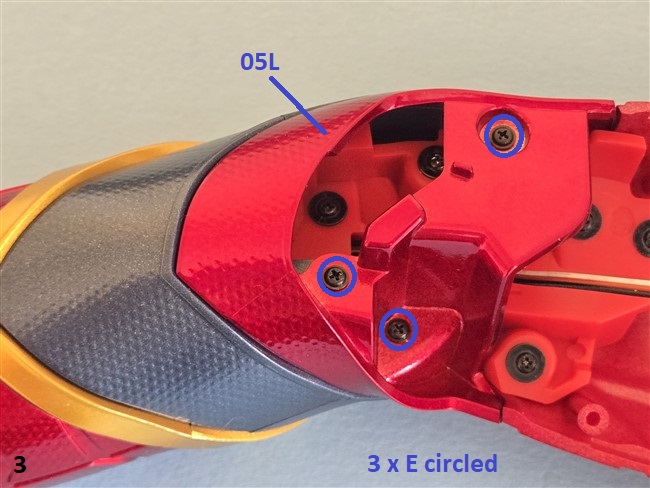

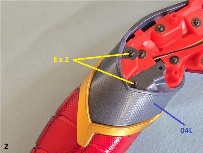

Position the left elbow cover 1, 04L, on the arm and fix it in place using 2 x E screws as shown in Pic 2. Then add the left elbow cover 2, 05L and fix that in place with a further 3 x E screws, Pic 3.

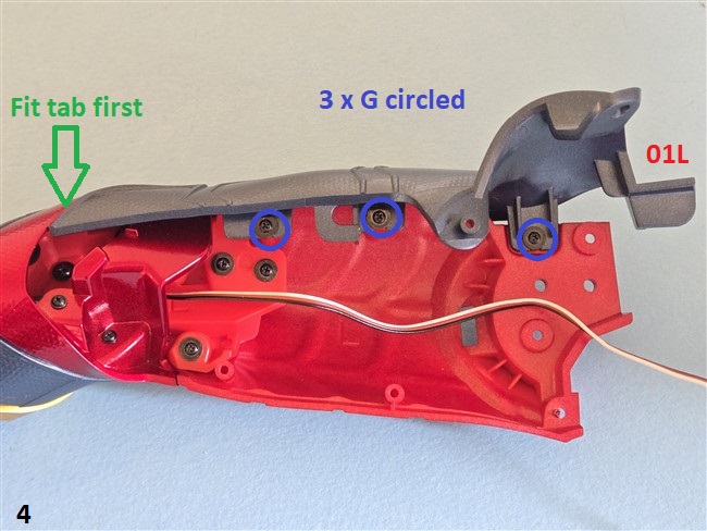

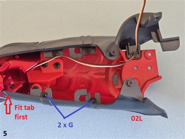

Take the arm cover 1, 01L and engage the tab first, then lower the part fully into position and fix with 3 x G screws as in Pic 4. Now position Cover 2, 02L in the same manner but only fix it initially with 2 x G screws, Pic 5.

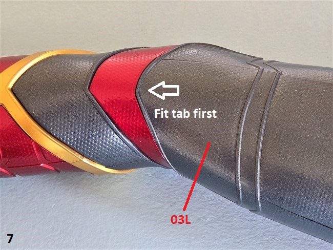

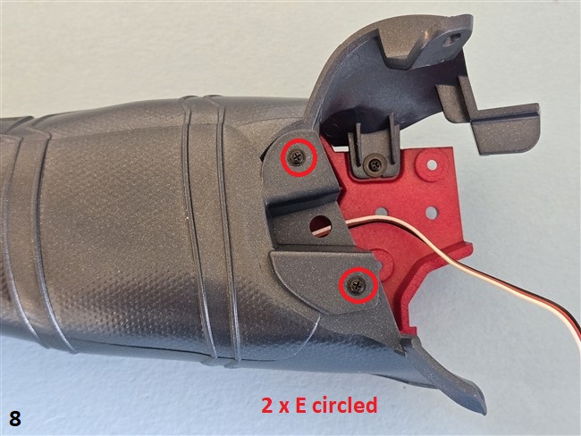

We continue with the Cover 3, 03L, engaging the tab first, Pic 7 and then fixing it in position with 2 x E screws as in Pic 8.

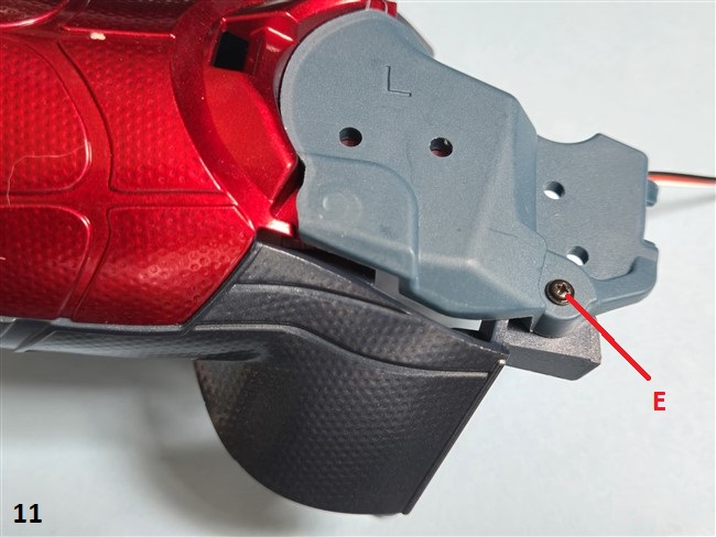

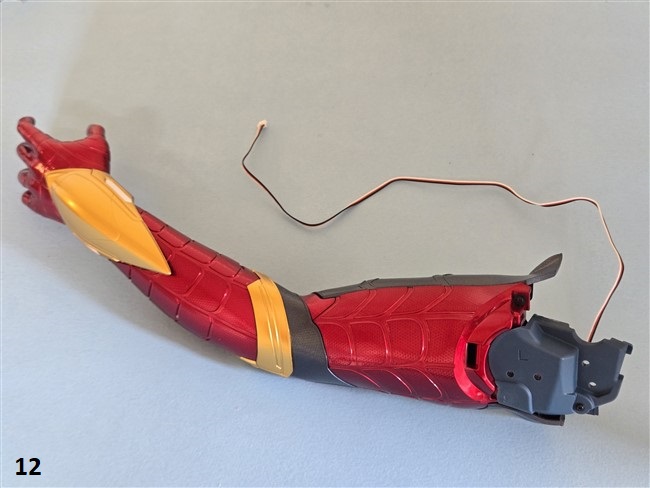

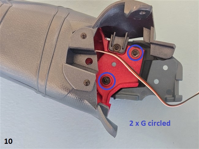

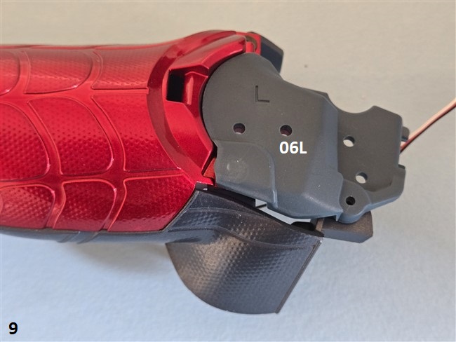

Now place the left upper arm chassis 06L as shown in Pic 9. Hold the parts together, turn them over and fix them using 2 x G screws as in Pic 10. Turn the arm back over and fix the chassis on the outside with a type E screw, Pic 11.

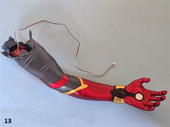

That completes the update for Issue 6, with Pics 12 and 13 showing the two sides of the left arm.

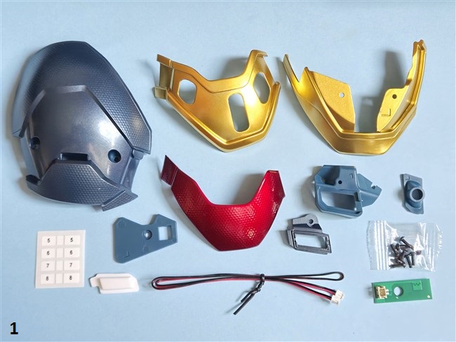

Coming up in three bite sized chunks is the Issue 7 update for Iron Spider. We start with the left outer shoulder assembly.
All parts supplied.....Pic 1.

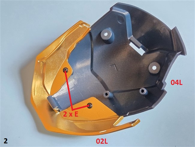

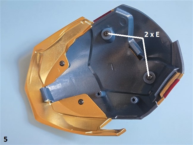

Start the construction by positioning the lower gold trim 02L onto the shoulder chassis 04L, fixing the parts together with 2 x E screws, Pic 2.

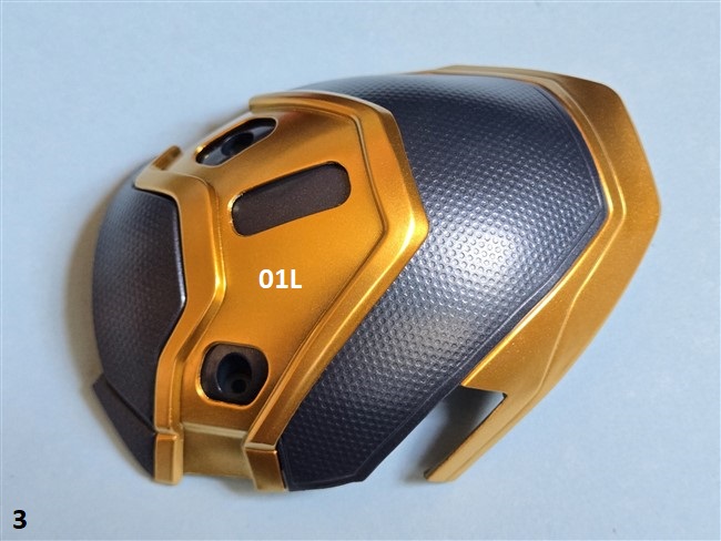

Next fit the Upper gold trim 01L as shown in Pic 3, followed by the Red shoulder plate 03L shown in Pic 4. Finally, hold the parts together and from the inside fix them with 2 x E screws, Pic 5.

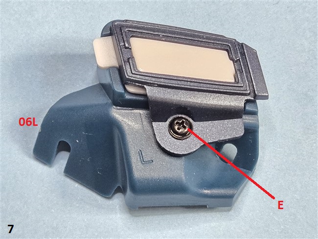

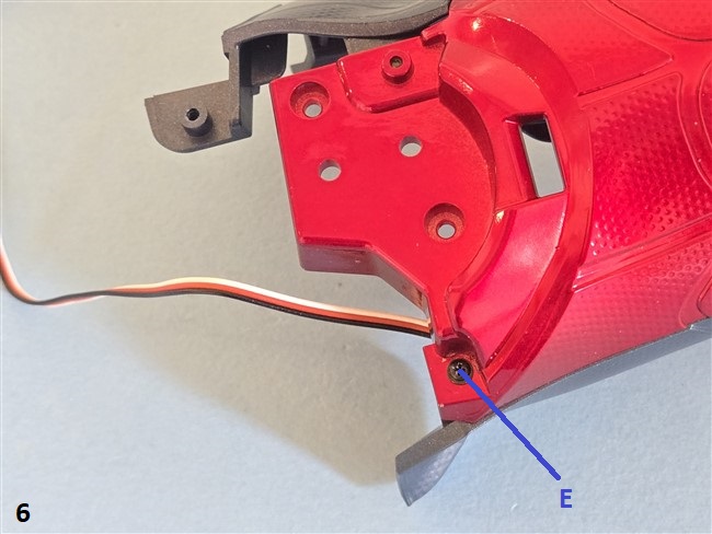

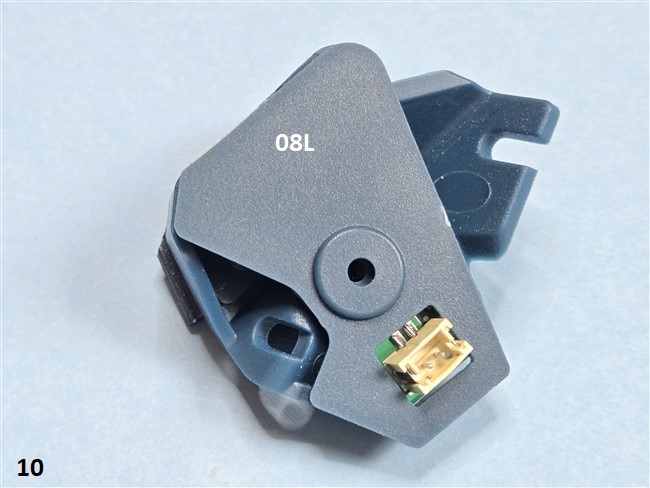

Start by positioning the LED display cover 09L into the frame 05L as in Pic 6. Hold the parts together and place them onto the LED base 06L, fixing them into position with an E screw, Pic 7.

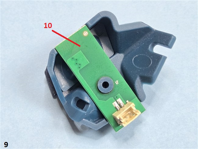

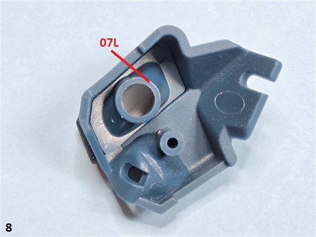

Turn the assembly over and place the LED bracket 07L in place, Pic 8. Add the LED circuit board 10 as in Pic 9, followed by the LED plate 08L as shown in Pic 10.

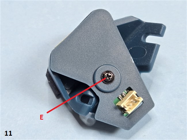

Finally, hold the parts in position and fix with an E screw, shown in Pic 11.
That completes the internal assembly. Final assembly coming soon.

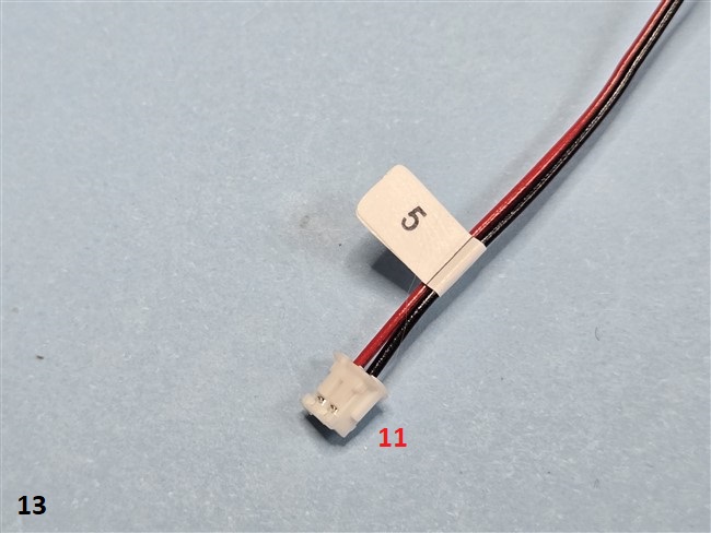

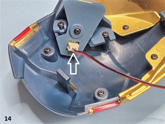

Now position the number five self adhesive tag onto one end of the cable 11, shown in Pic 13. Then plug the other end of the cable into the socket on the inside of the shoulder assembly, Pic 14.

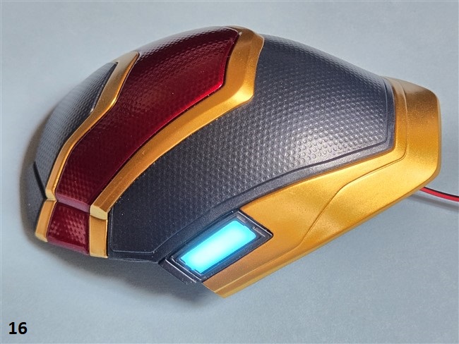

Pic 15 shows the final assembly for this update. I chose to retest the LED operation at this point with the result shown in Pic 16.

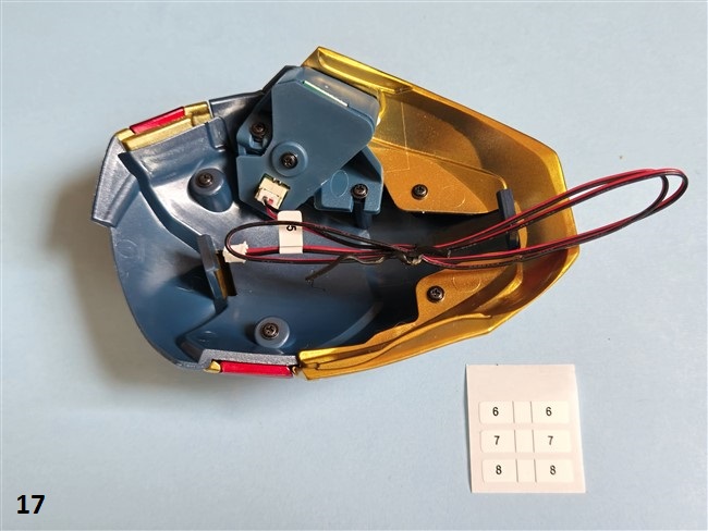

Store the shoulder assembly carefully for later and retain the unused self adhesive number tags for later in the build, Pic 17.

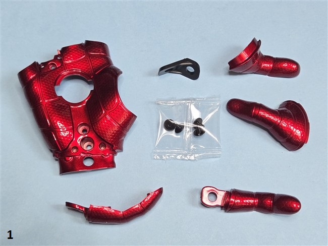

Parts supplied.....Pic 1. Please note that some parts have an ID number on them. This number will appear in brackets in this write up.

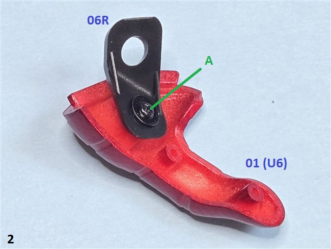

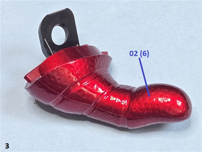

Starting with the thumb construction, position the thumb connector 06R onto the thumb part 01(U6) and fix it with an A screw, as in Pic 2. Then press the second thumb part 02(6) into place as shown in Pic 3.

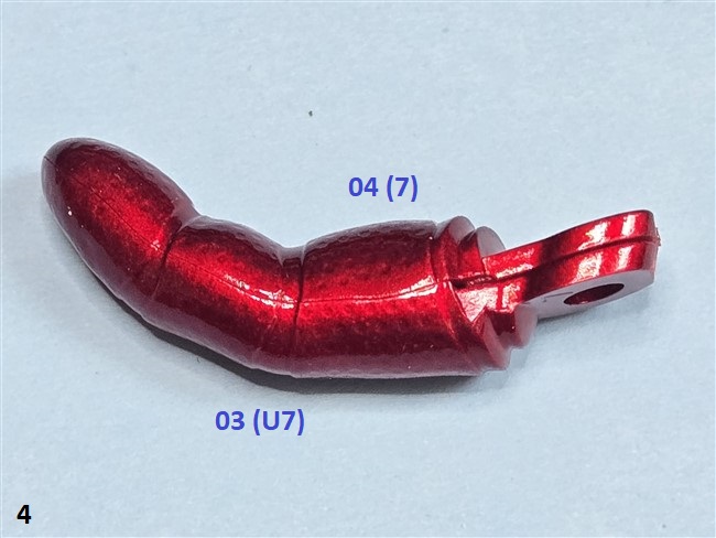

Next, construct the index finger, by pressing the parts 03(U7) and 04(7) together as shown in Pic 4.

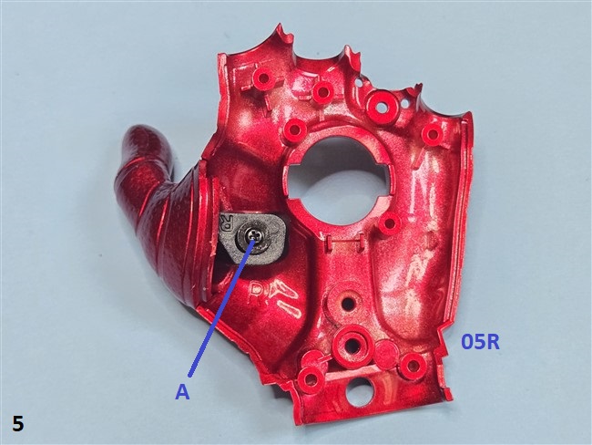

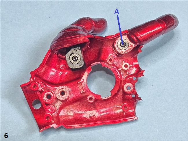

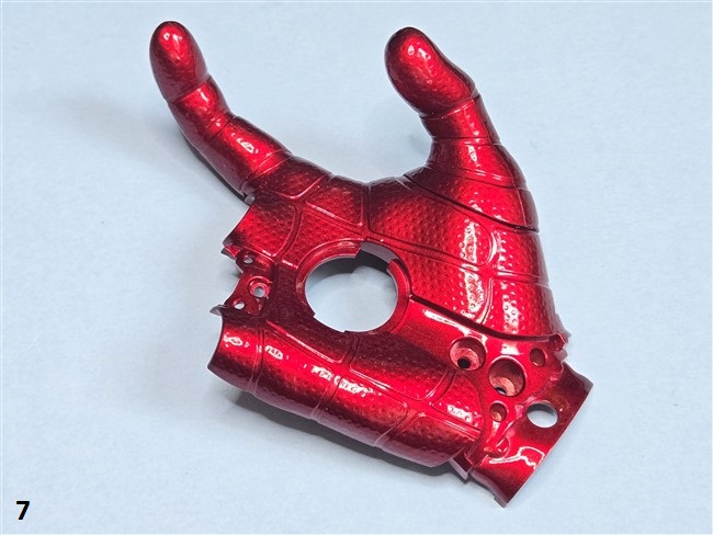

Now position the thumb into its place on the palm of the hand 05R, fixing it with an A screw as in Pic 5. Finally position and fix the index finger, using a further A screw, Pic 6. Pic 7 shows the assembly at the end of this stage from the palm side.
