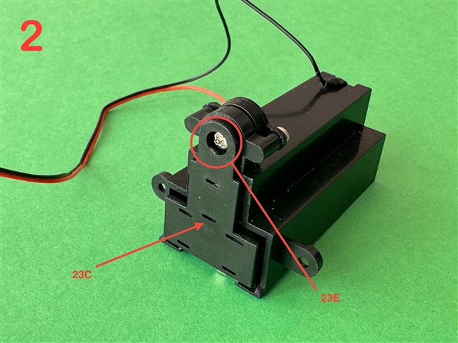

Insert three AAA batteries (Not Supplied) into the saucer section battery box. Use the new battery box cover (23C) that came with this issue and secure it using the silver screw (23E), picture 2.

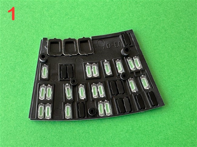

Take the deck panel (23A) and fit the escape pod covers (23B) so the red line on each one is furthest away from the tapered end. Place 3 dark windows (23D) into the panel, picture 3.

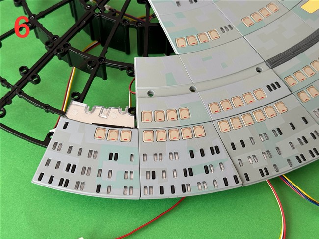

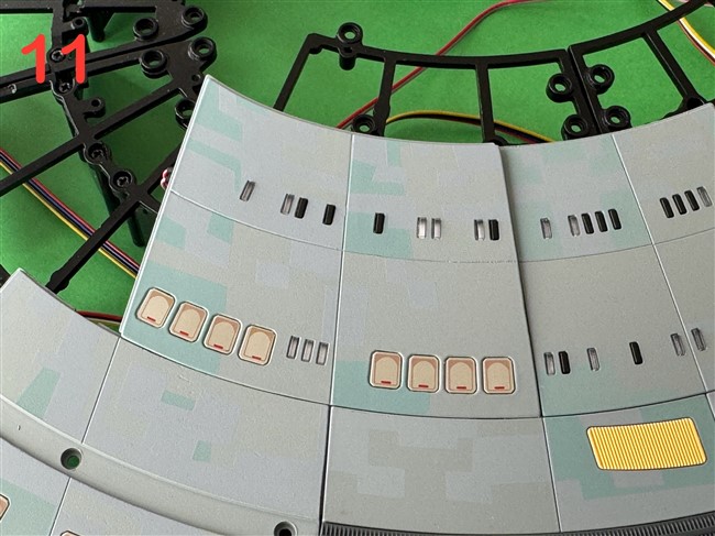

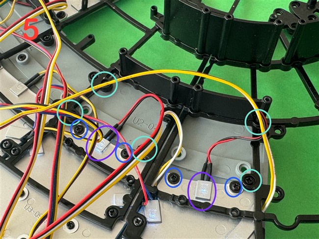

Follow the illustration in picture 5 by first placing the two LED lights into the top of the reflector panel, circled in purple. Then place the BM screws as circled in green, and finally the EM screws circled in blue.
Now, using the battery box and the PCB board as before test the lighting, picture 6.

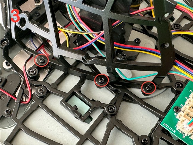

Retrieve the battle section neck assembly and position the left neck bracket (24I) on the underside as shown in picture 2. Place 3 x BM screws as circled in picture 3, and then place an FM screw as shown in picture 4. Picture 5 shows that assembly complete.

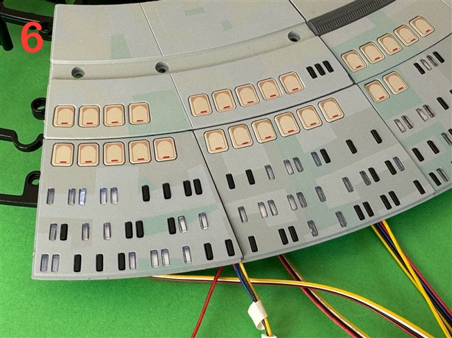

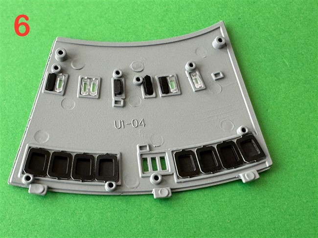

Take the deck panel (24A) and place the pod covers, dark and clear windows into the panel as you have done with previous panels. Picture 6 shows how the parts are positioned.

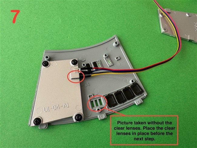

Place the reflector (24C) onto the panel inserting the LED with the yellow and black cable at the end into the side as shown in picture 7.
Note: You will also see in picture 7 that the three clear windows have not be placed in the panel. Please do so before attaching the next reflector.

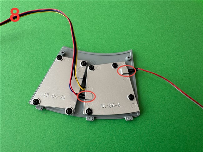

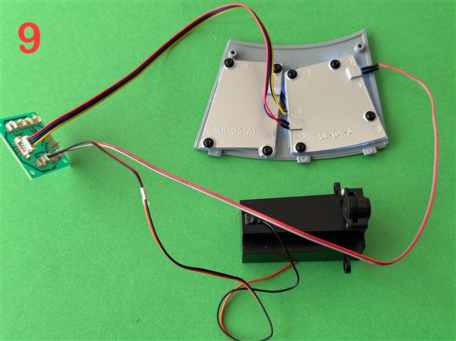

Place the reflector, part (24B) on the panel, inserting the LED with the red and blue cable into the inner side, whilst the LED with the red and grey wire to the outer top side. Secure the reflector panel in place using 4 x EM screws as shown in picture 8. Test the lighting with the PCB with the battery plugged to socket “F”, picture 9.

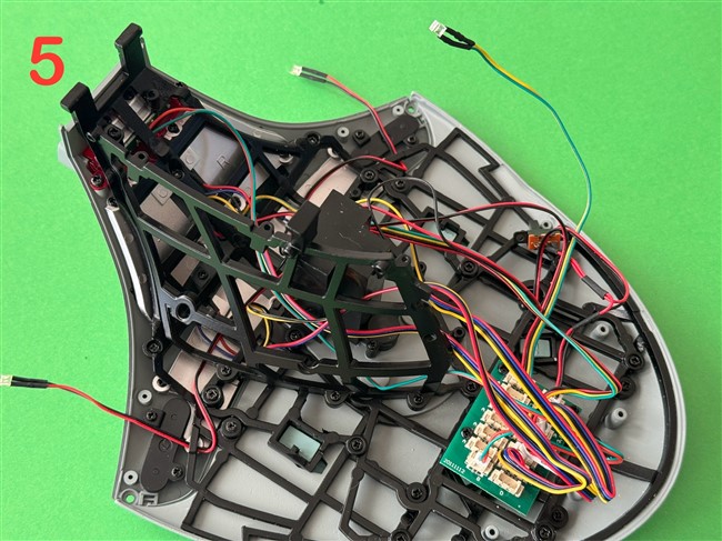

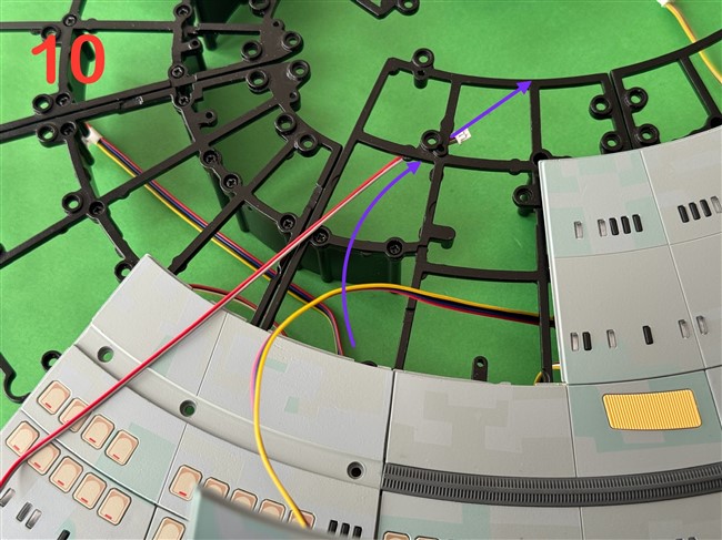

Place the deck panel onto the saucer structure by carefully threading the cables through the frame as shown in pictures 10 and 11.

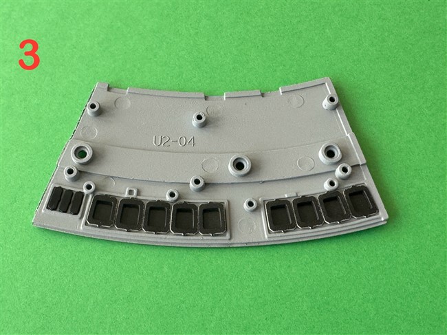

#3 Posted : 27 June 2025 13:27:05
Issue 25

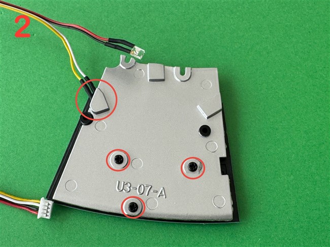

Take the deck panel (25A) and fit the escape pods, clear and dark window pieces as shown in the first picture. Next, place the reflector (25B) on the rear of the deck panel. Take the deck panel lights (25E) and plug the LED bulb with the yellow and white cable into the slot as illustrated in picture 2. Secure the panel using 3 x BP screws.
Thread the cable through the saucer skeleton as shown in picture 3, feeding the cable back through the saucer skeleton as shown in picture 4. Turn the assembly over and secure the panel using 2 x DP screws, picture 5. Picture 6 shows the panel in place on the frame.

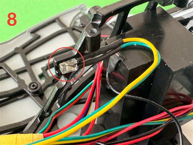

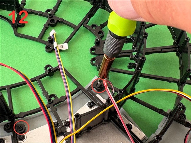

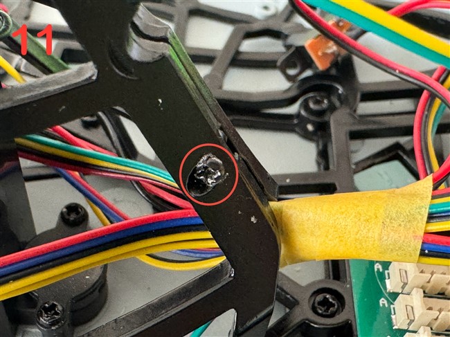

Retrieve the battle section neck assembly and gather the cables neatly to the centre. I used some tape to hold them together, picture 7. Take the LED bulb with the yellow and green wire and place it into the slot in the left neck bracket, picture 8.

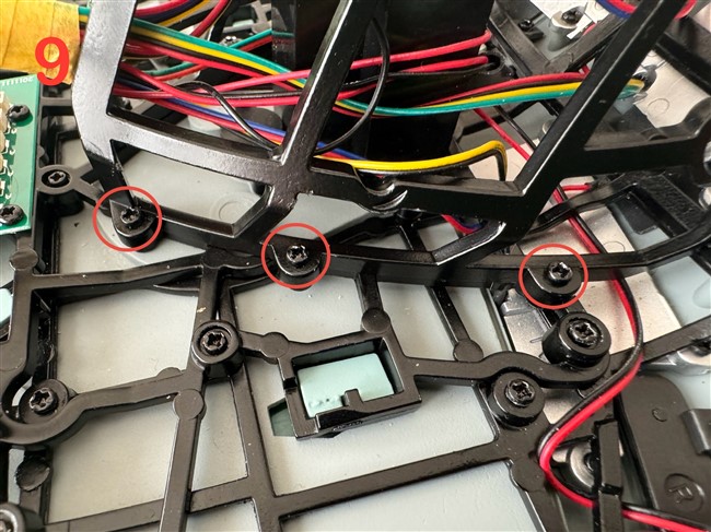

Position the right neck bracket (25G) onto the frame as you did with the left bracket, making sure the cables move freely between the two brackets. Secure the bottom part of the bracket with 3 x BM screws, picture 9, followed by an FM screw at the top, picture 10. Finally place an AM screw to the front side to complete the assembly, picture 11. Make sure you do not trap any of the cables when securing the assembly.
Picture 12 shows the complete assembly for this issue.

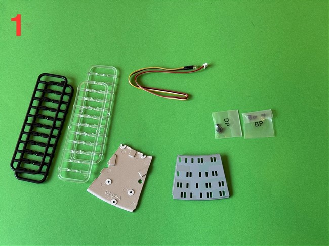

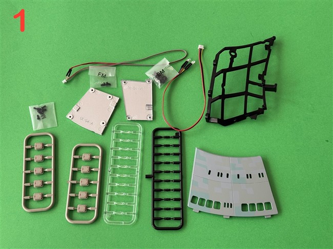

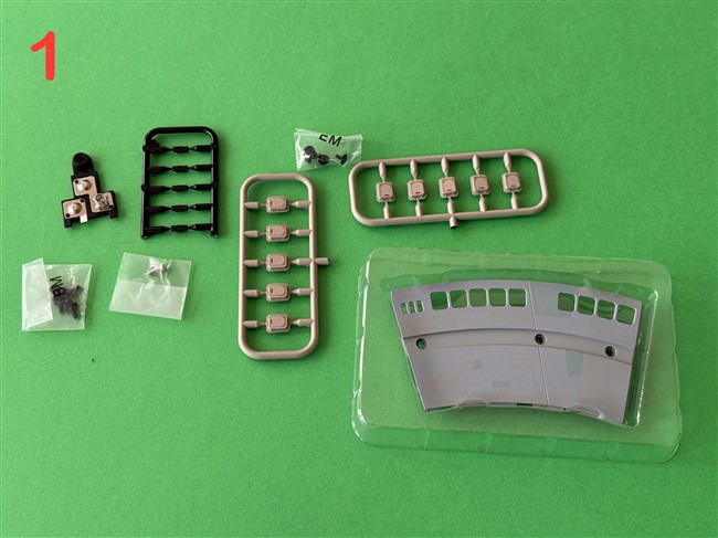

Picture 1 shows the parts for this issue

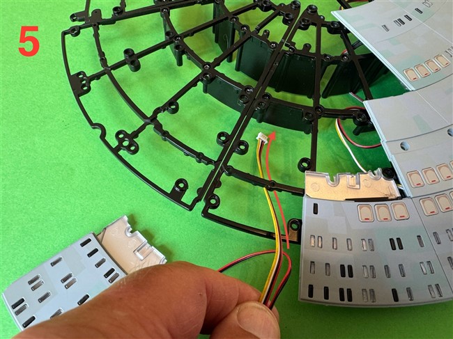

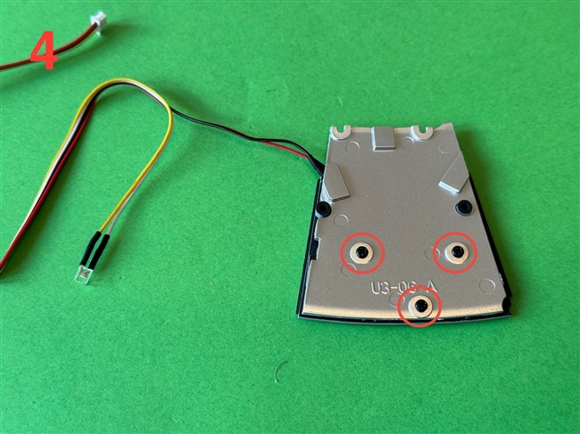

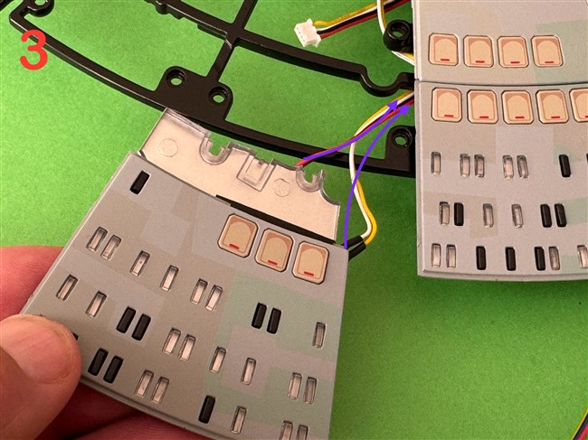

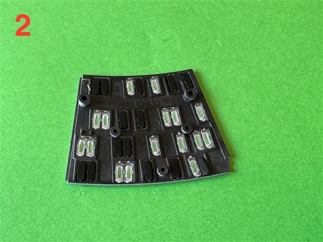

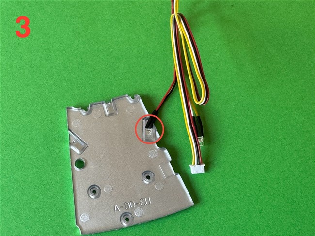

Take the deck panel (26A) and fit clear and dark window pieces as shown in the picture 2. Take the wiring loom supplied in this issue and place the LED with the black and red cables into the reflector panel (26B), picture 3.

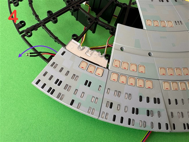

Next, place the reflector on the rear of the deck panel and secure it in place using 3 x BP screws, picture 4.

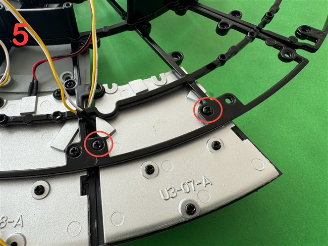

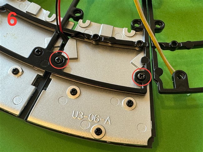

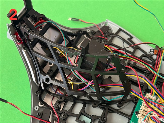

Thread the cable through the saucer skeleton as shown in picture 5. Turn the assembly over and secure the panel using 2 x DP screws, picture 6.

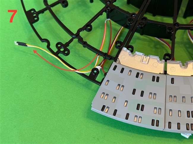

Finally, feed the LED cable with the yellow and white cables back through the skeleton frame as shown in picture 7.
