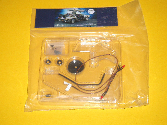

STAGE 72:
Inner door panel.

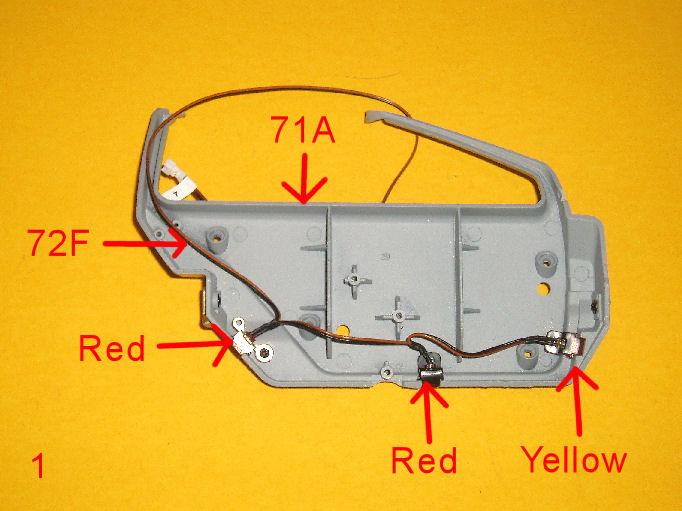

Pic 1: Fit the LED light wire into the door panel 71A as shown with the correct colour LED’s fitting in the respective sockets.

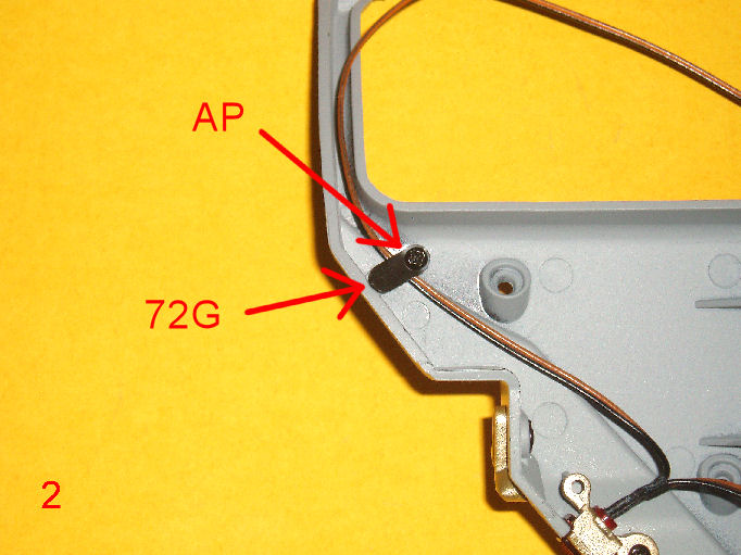

Pic 2: Fit the wire so it runs inside the window frame channel. Fit the retaining clip 72G and fix with 1 x AP screw.

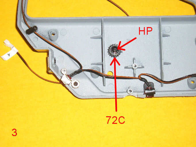

Pic 3: Locate the thinner cog wheel, 72C and fit it to the upper post inside the door panel. Secure with 1 x HP screw.

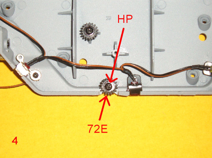

Pic 4: Locate the thicker cog wheel 72E and fit it to the lower post on the door panel, with the recessed face upwards. Secure with 1 x HP screw.

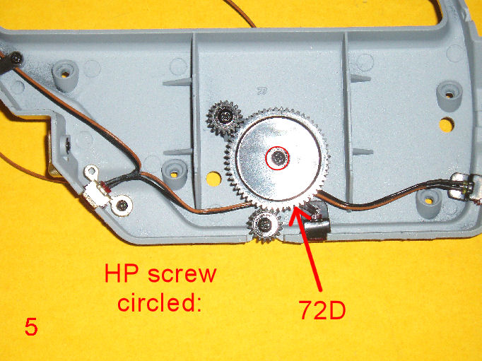

Pic 5: Fit the large cog wheel 72D to the central post, between the other two cogs. Secure with 1 x HP screw.

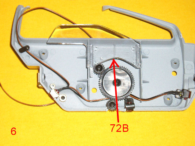

Pic 6: Fit the smaller window, 72B in place, locating the cogged edge in place on the door panel.
Store the door panel and unused window safely for now.

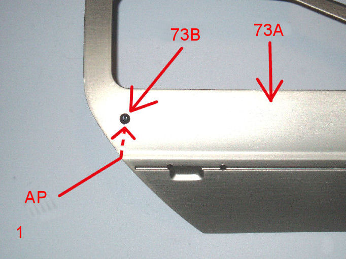

Pic 1: Fit the lock, 73B into the door shell 73A and fix from behind with 1 x AP screw.

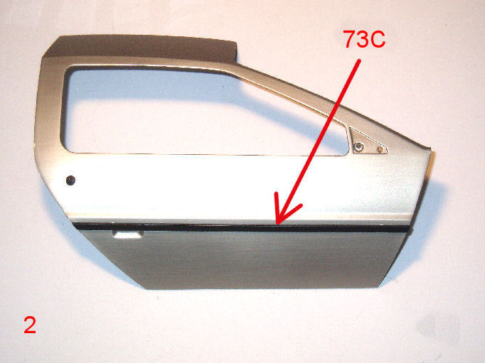

Pic 2: Fit the trim strip 73C to the door as shown.
It will only fit one way.

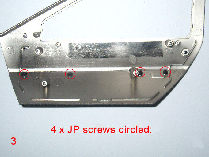

Pic 3: Secure from behind with 4 x JP screws.

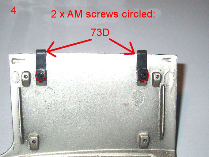

Pic 4: Fit the two roof brackets, 2 x 73D to the upper door panel as shown and fix with 2 x AM screws.

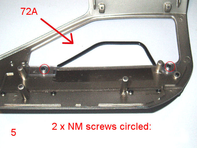

Pic 5: Fit the side window 72A in place inside the door and fix with 2 x NM screws.

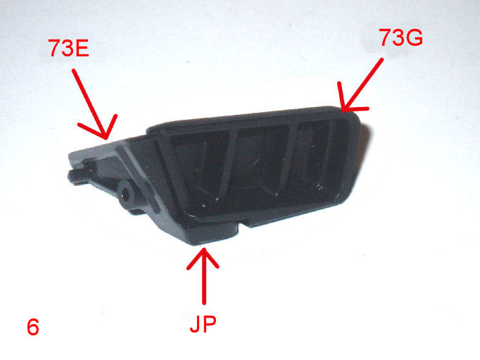

STAGE 73B:
Pic 6: Assemble the mirror parts 73E and 73G as shown. Secure them with 1 x JP screw from underneath.

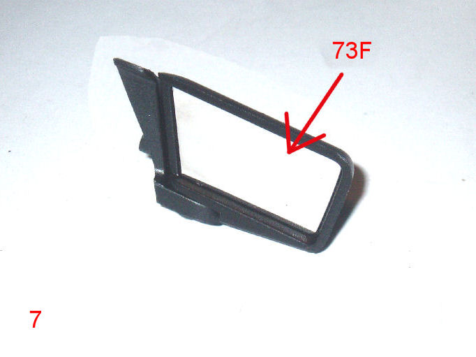

Pic 7: Peel the backing paper from the mirror, 73F and fit it to the assembly.

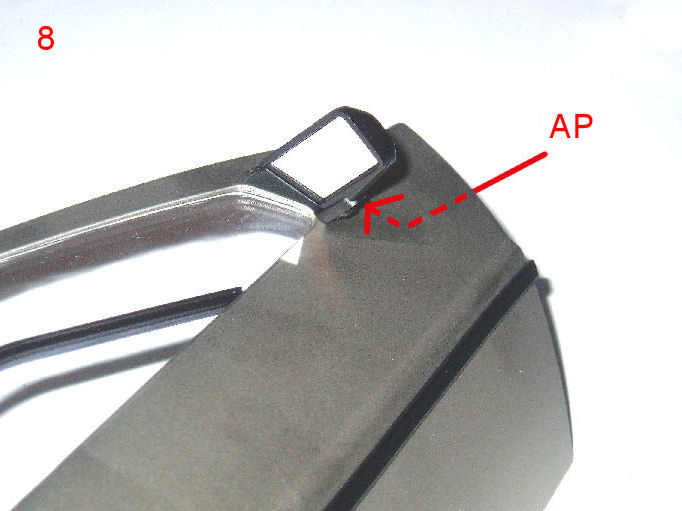

Pic 8: Fit the mirror to the door as shown and fix from behind with 1 x AP screw.

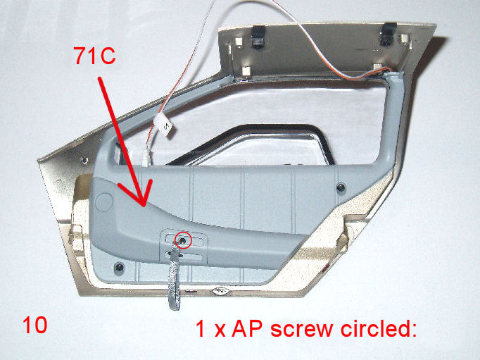

Pic 10: Fit the arm rest part 71C as shown and fix using 1 x AP screw.
Store the parts safely for now.

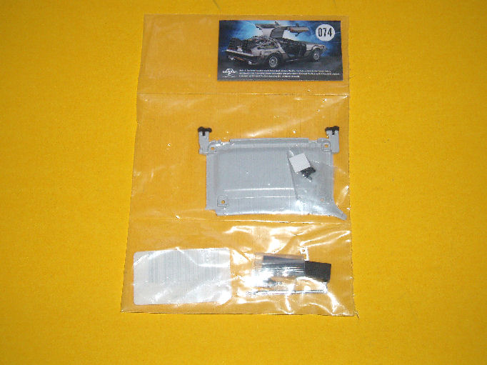

STAGE 74:
Fitting the door.
NOTE: There may be an unexplained black rectangular part in the pack.
This does not appear in the build instructions and seems to serve no purpose.
However, it might be wise to store this part 'just in case'.

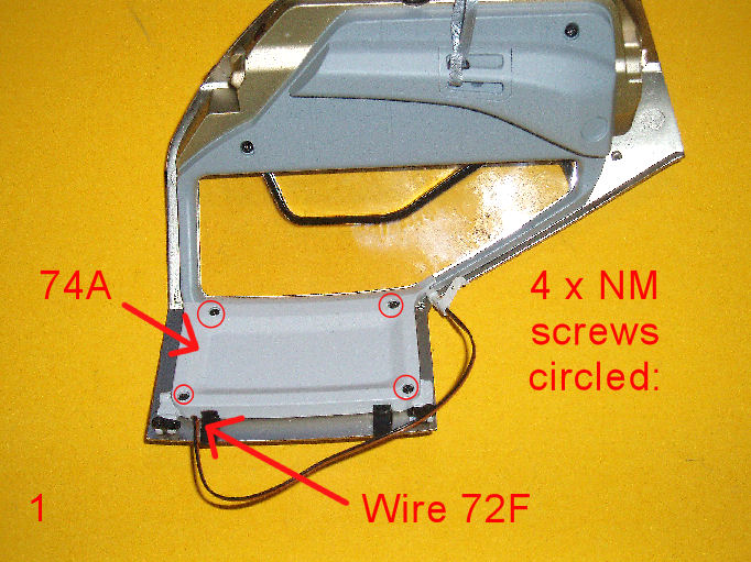

Pic 1: Fit the inner roof panel 74A to the inside top of the door and fix using 4 x NM screws.
Make sure the wire 72F exits through the small slot as shown.

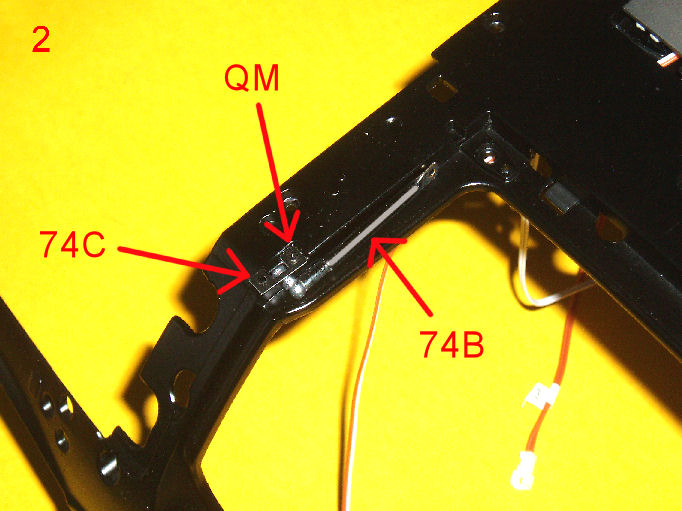

Pic 2: Fit the hydraulic arm 74B as shown and secure with the bracket 74C.
Fix using 1 x QM screw.

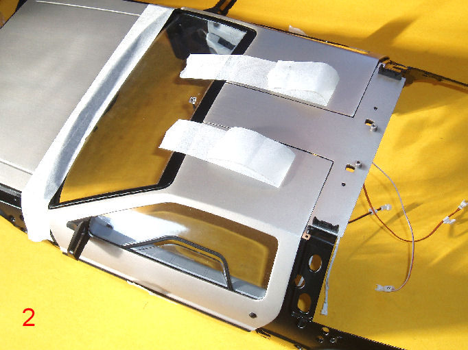

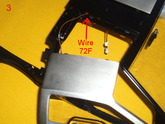

Pic 3: Feed the wire 72F through the opening in the body roof as shown.

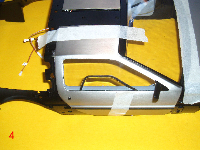

Pic 4: Carefully locate the hinges on the upper edge of the door in their locating holes on the body.
With the door in place, temporarily secure it with low tack masking tape.
It will make the next step far easier.

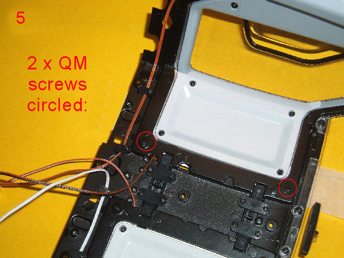

Pic 5: Turn the body over and fix the hinges in place using 2 x QM screws as shown.
Make sure the screws are tight but not over tight as this could result in stripping the threads in the body.

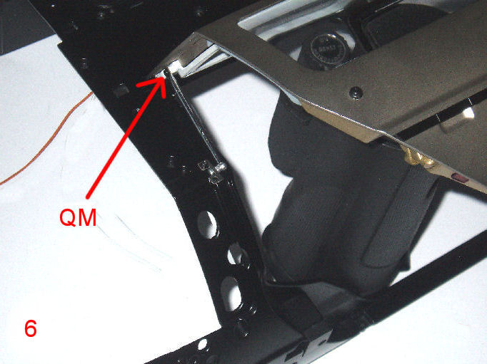

Carefully prop the door open and fix the end of the hydraulic arm 74B to the upper edge of the door as shown using 1 x QM screw.

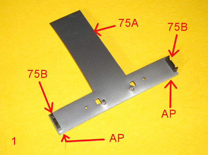

Pic 1: Fit the two brackets 2 x 75B to the edges of the roof panel 75A and fix from underneath using 1 x AP screw in each.

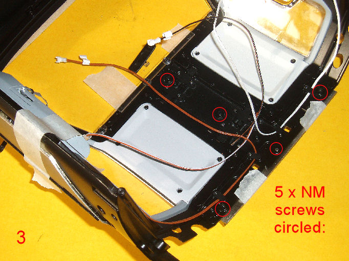

Pic 3: With the body upside down, secure the roof panel from the inside using 5 x NM screws.

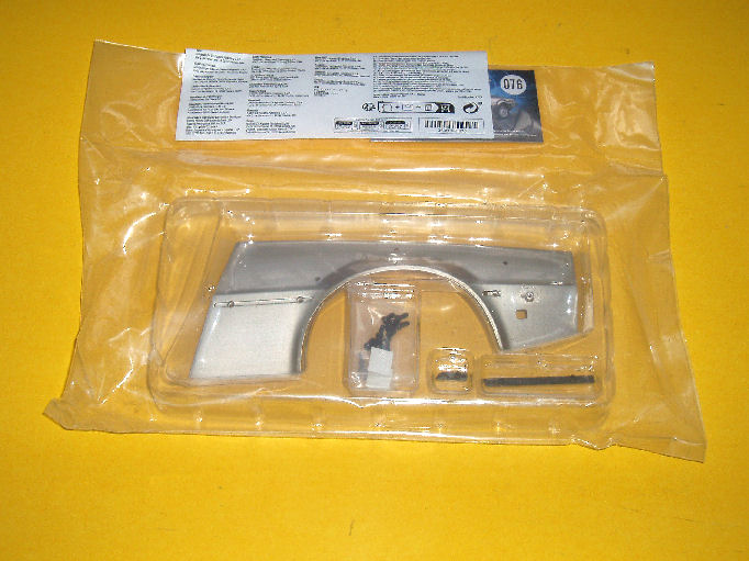

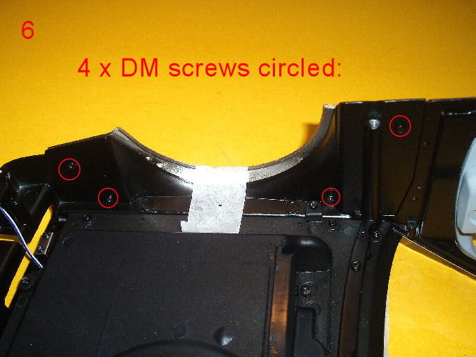

Front wings/fenders.

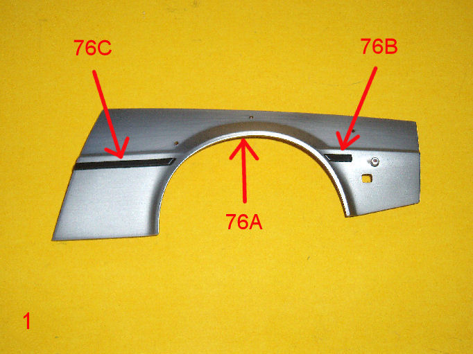

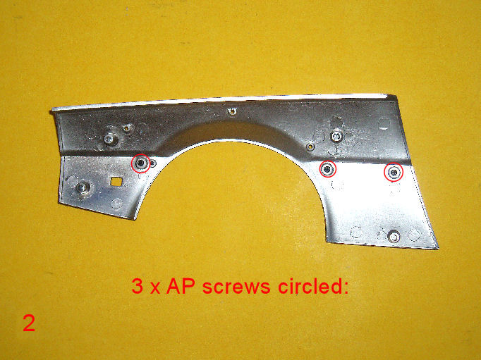

Pic 1: Fit the two trim parts 76B and 76C to the front wing panel 76A.
Pic 2: Fix from the other side with 3 x AP screws.
Pic 3: Fit the wing panel to the car body.
You may find it helpful to hold the part in place with low tack masking tape.
This is at the builder’s discretion.

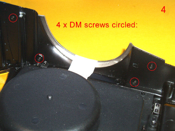

Pic 4: Turn the model over paying attention that the doors do not fall open if you have not secured them with low tack masking tape.
Fix the wing panel from the inside using 4 x DM screws.
Perseverance is key here as some of the screws are very difficult to get at.
Pic 5: Retrieve the assembled front wing from stage 2 and fit it to the other side of the car.
Pic 6: Turn the model over paying attention that the doors do not fall open if you have not secured them with low tack masking tape.
Bear in mind some of the screws are very difficult to get at.
Store the model safely for now.
