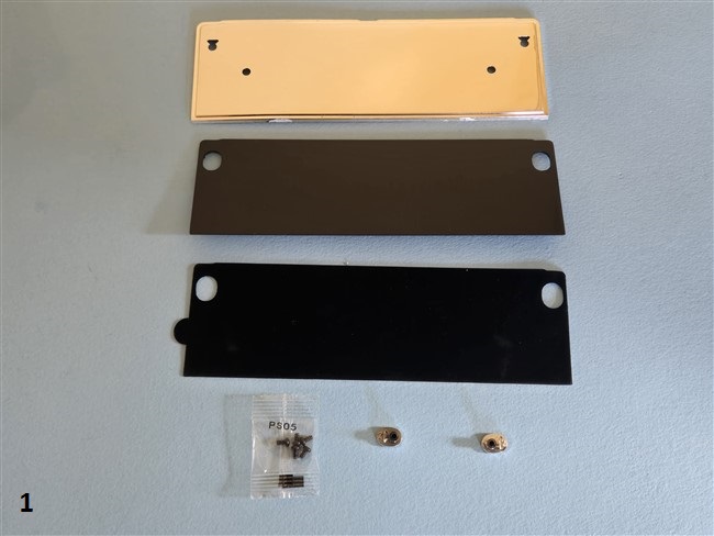

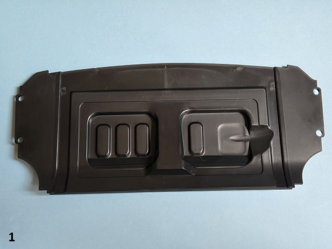

Parts supplied.....Pic 1, you will also need the interior assembly.

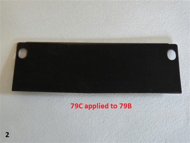

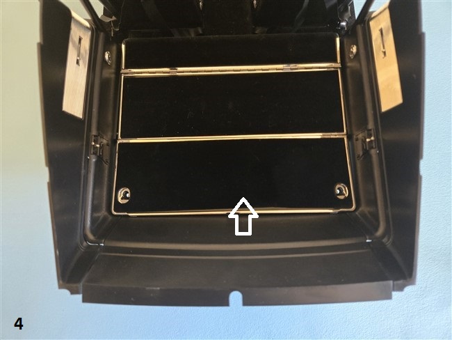

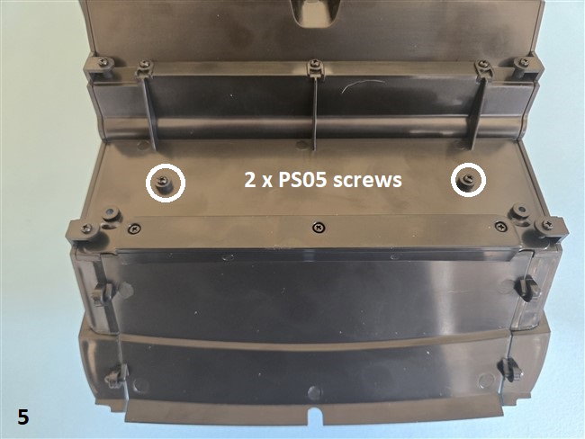

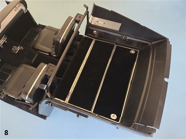

Remove the backing paper from the carpet 79C and carefully apply it to the smooth side of the rear platform base (2) 79B, Pic 2. Take the previous assembly and place it into the rear platform base (1) 79A, as in Pic 3. Now place this assembly into position in the rear of the interior assembly, indicated in Pic 4. Hold the panel in position and from underneath the rear floor, fix it in place using 2 x PS05 screws, Pic 5.
Place the rear seat locks 2 x 79D into the rear panel, Pic 6 and fix them in place using a further 2 x PS05 screws, shown in Pic 7.
That`s it for this update, with the final assembly shown in Pic 8.

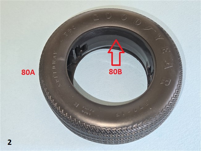

Just a short update today for the 1:6 Mustang, with issue 80.
We`ve been here four times before, but here we go with the start of the "spare" wheel.

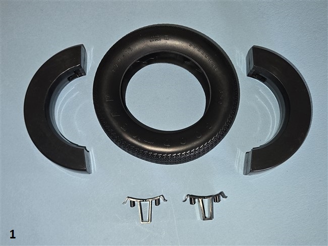

Parts supplied.....Pic 1.

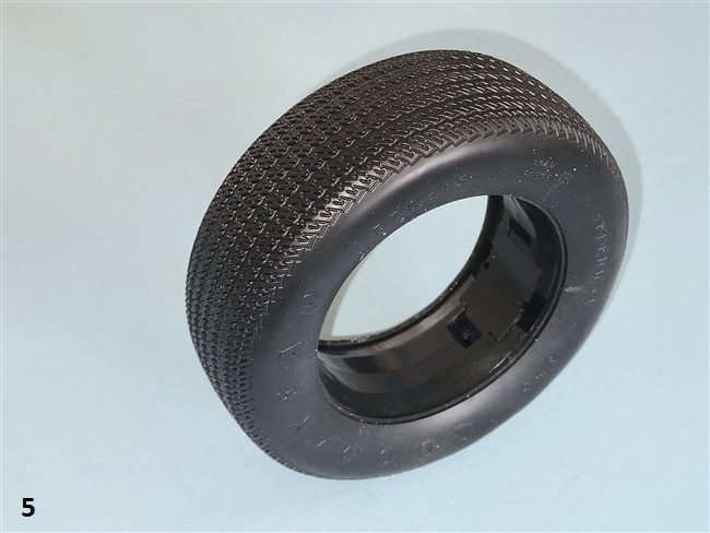

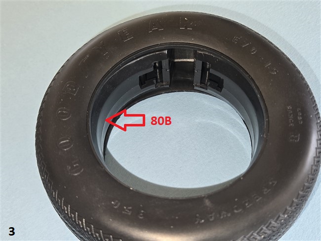

Position one of the internal tyre parts 80B inside the tyre 80A, Pic 2. Then repeat with the second part 80B, Pic 3.

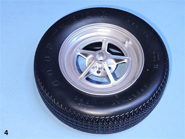

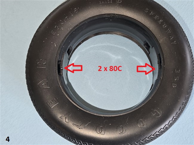

Now press the clips 2 x 80C into place as indicated in Pic 4, with the final assembly shown in Pic 5.

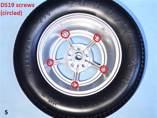

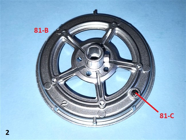

Parts supplied.....Pic 1, you will also need the tyre from the previous update.

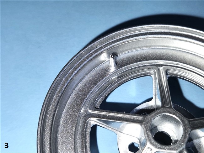

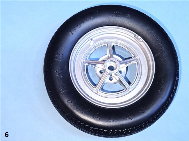

Press the tyre valve 81-C into position through the outer wheel part 81-B, as in Pic 2. The outer side is shown in Pic 3.

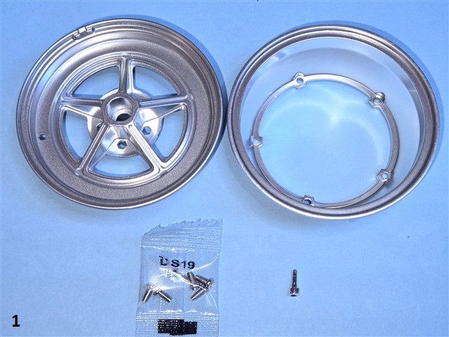

Now place the previous assembly into position with the tyre from issue 80. Pic 4, noting that the lugs of the wheel part must engage with the slots in the inside parts of the tyre. Hold the parts in position and add the inner wheel part 81-A (make sure the lugs engage with the inner tyre parts), then fix the wheel parts together with 5 x DS19 screws, indicated in Pic 5.
That`s all for this update, with the final assembly shown in Pic 6.

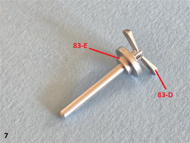

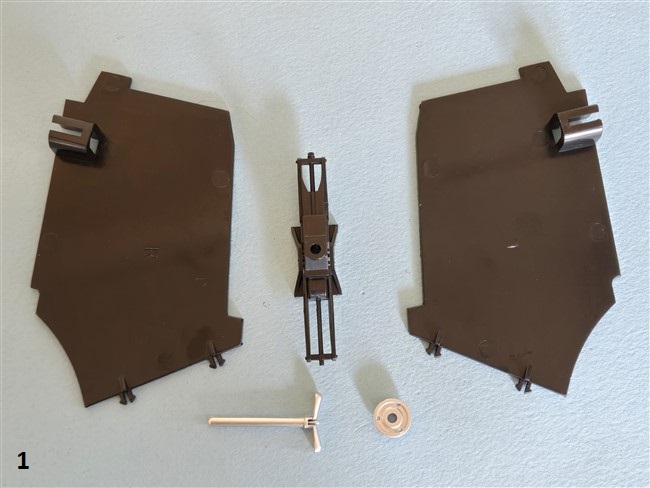

Parts supplied.....Pic 1, you will also need the part supplied in issue 82, the spare wheel/tyre from issue 81 and the main chassis on the wheels from Blink oodles ago. (Even the Mag writer can`t remember)
Start with the part from issue 82 - 82-A and press the two posts of the right side trunk panel 83-B (CAREFULLY) into place, Pic 2. Being just as careful, repeat with the left panel 83-A as in Pic 3.

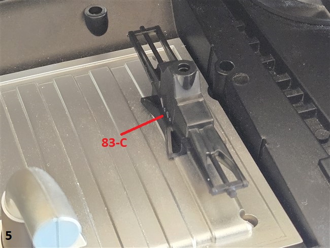

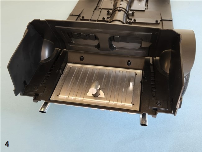

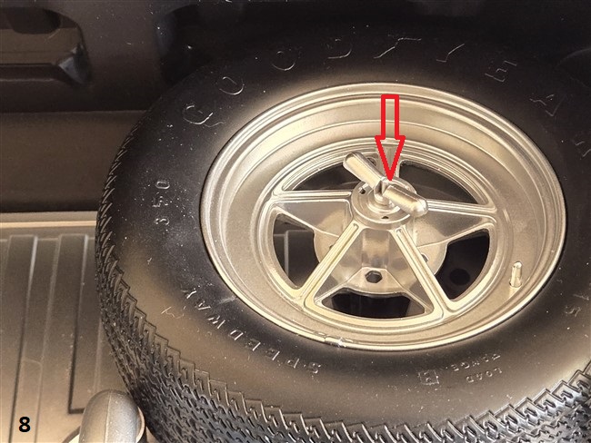

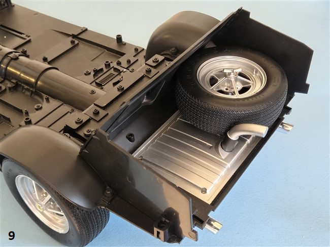

Now position the previous assembly into place on the rear of the chassis, Pic 4, making sure that the side panels fit correctly. Then press the jack 83-C onto the post on the right of the boot space (trunk), Pic 5.

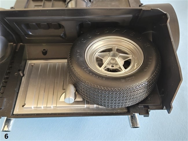

Place the spare wheel/tyre over the jack as shown in Pic 6. Then assemble the spare wheel lock from parts 83-D and 83-E as shown in Pic 7 and finally pass the lock through the spare wheel and into the hole in the jack, Pic 8. The final assembly for this pack is shown in Pic 9.
