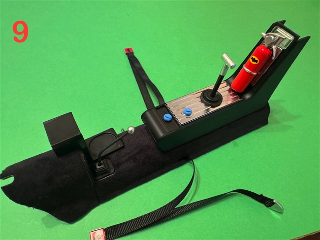

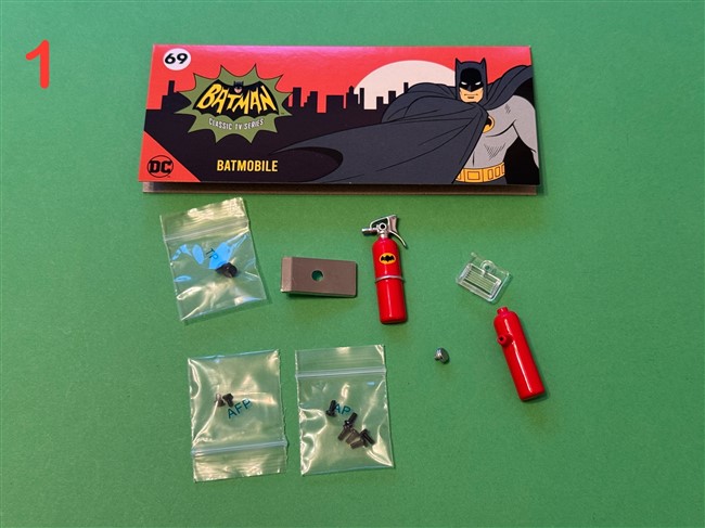

#1 Posted : 22 March 2025 19:18:06
Issue 69
Picture 1 shows the parts for this issue.

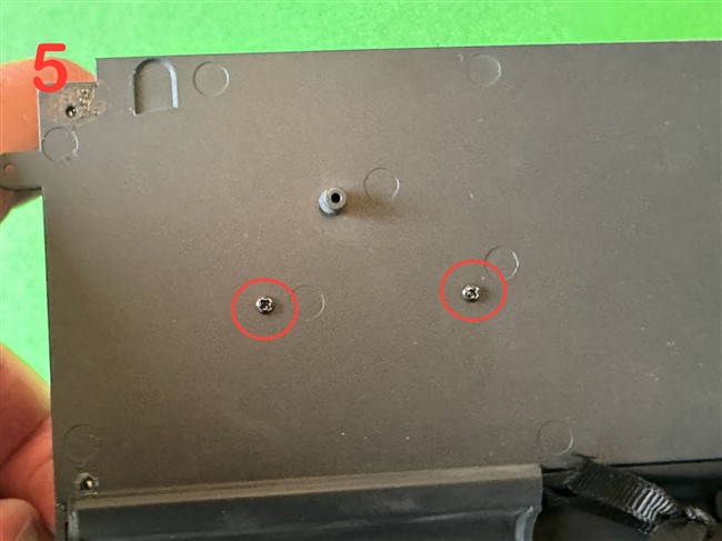

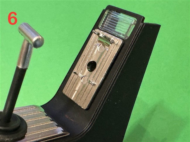

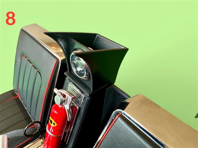

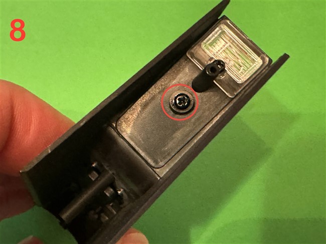

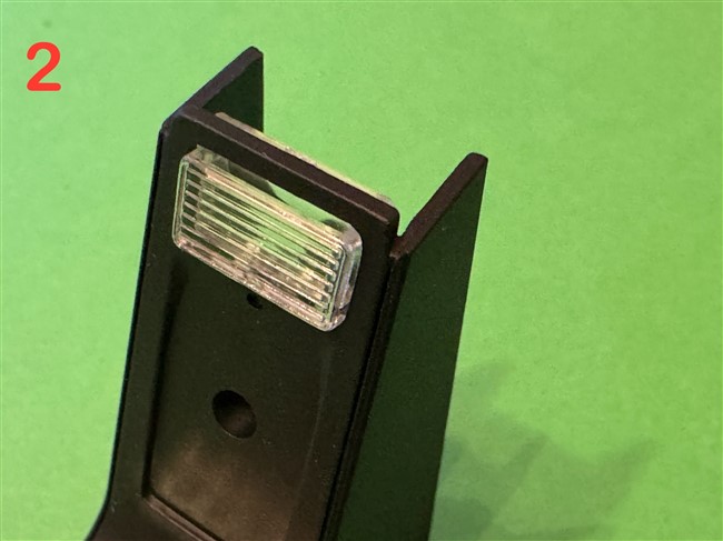

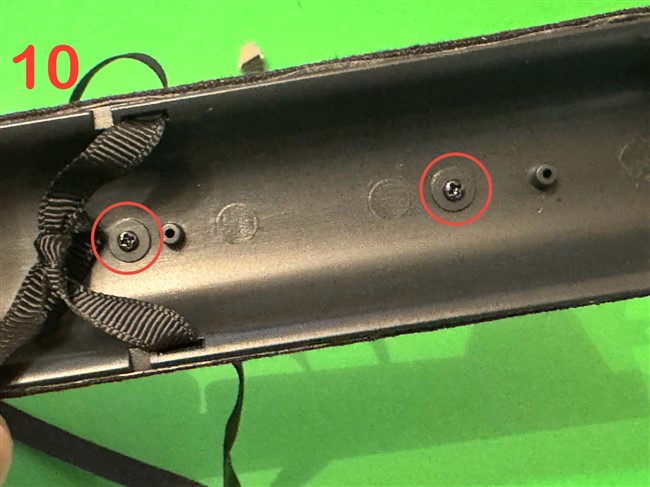

Place the interior light panel (69E) on the inside of the central console, picture 2, then secure with an AFP screw, picture 3.

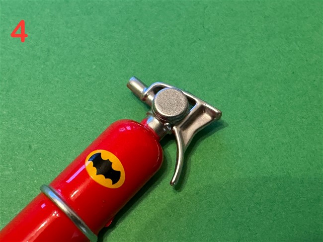

Push the pressure gauge (69C) on the front of the fire extinguisher (69A), picture 4. Push fit the rear of the fire extinguisher (69B) onto the front, picture 5.

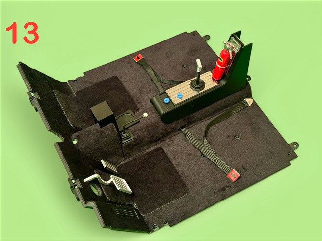

Insert the fire extinguisher bracket (69D) onto the central console, picture 6, then place the completed fire extinguisher onto the bracket, picture 7, and secure with a TP screw at the rear, picture 8.

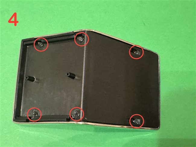

Now take the console assembly and place it on the console base, picture 9. Turn the assembly over and secure in place using 2 x AP screws as shown in picture 10.

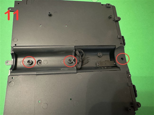

Place the completed assembly in the centre of the interior floor and secure using 3 x AP screws as shown in picture 11.

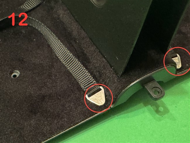

Fit both the seat belt pieces by push fitting the pins in place, picture 12. You may wish to use a little glue to hold in place.
Picture 13 shows the complete assembly for this issue.

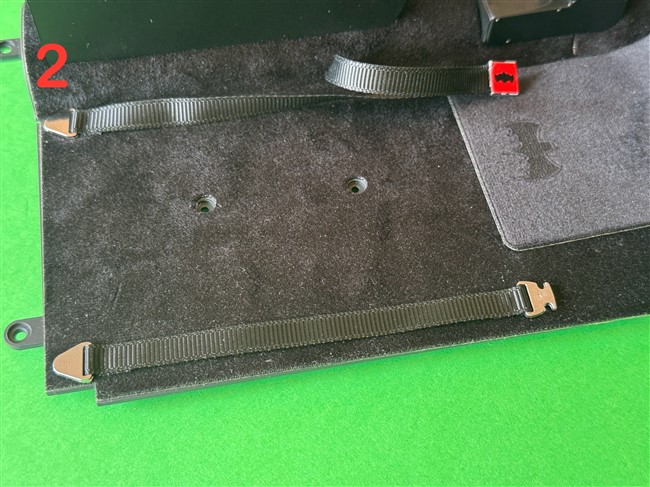

#2 Posted : 23 March 2025 18:31:46

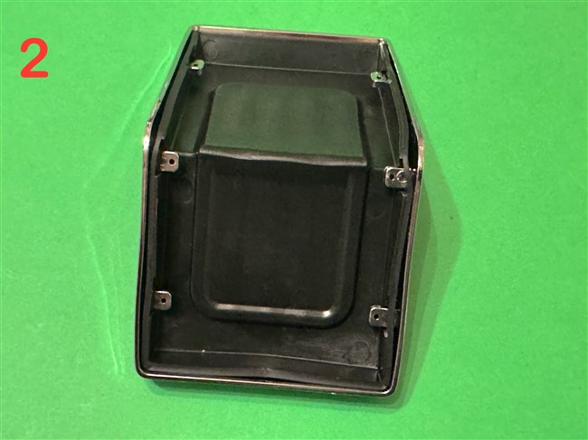

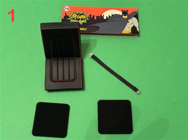

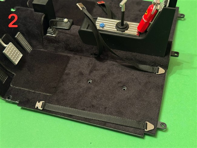

Issue 70
Take the driver’s seat belt (70C) and push the pin into the floor. The buckle should be facing towards the pedals, picture 2.

#3 Posted : 23 March 2025 18:33:15

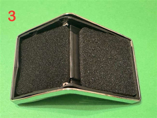

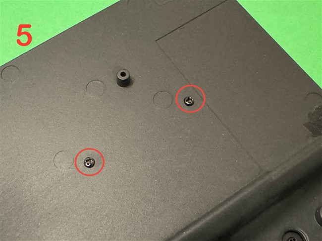

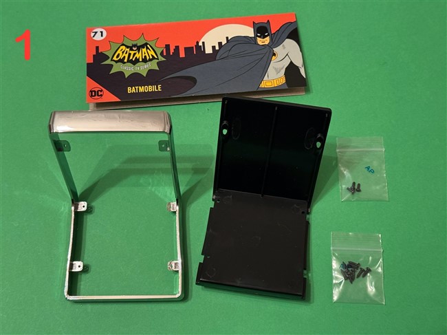

Issue 71
Fit the driver’s seat (70A) inside the seat frame (71A), picture 2. Place the two sponges (70B) on the reverse on the driver’s seat, picture 3.
Using 6 x AIP screws, secure the driver’s seat back in position as shown in picture 4.
Turn the interior floor over and secure the completed seat in place using 2 x AP screws, picture 5
Picture 6 shows the complete assembly for this issue.

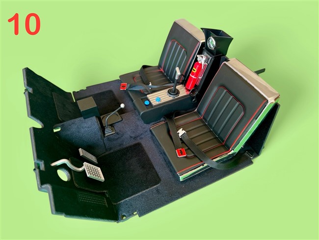

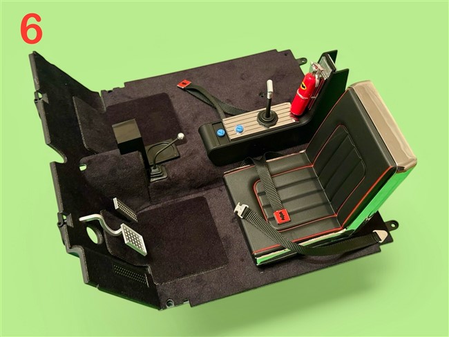

#4 Posted : 24 March 2025 22:52:51
Issue 72
Take the driver’s seat belt (72C) and push the pin into the floor. The buckle should be facing towards the pedals, picture 2.

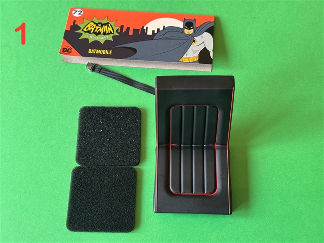

#5 Posted : 24 March 2025 22:54:32

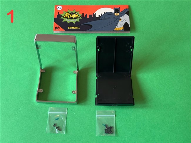

Issue 73
Fit the driver’s seat (72A) inside the seat frame (73A), picture 2. Place the two sponges (72B) on the reverse on the driver’s seat, picture 3.
Using 6 x AIP screws, secure the driver’s seat back, (73B) in position as shown in picture 4.
Turn the interior floor over and secure the completed seat in place using 2 x AP screws, picture 5.

#6 Posted : 25 March 2025 21:52:14

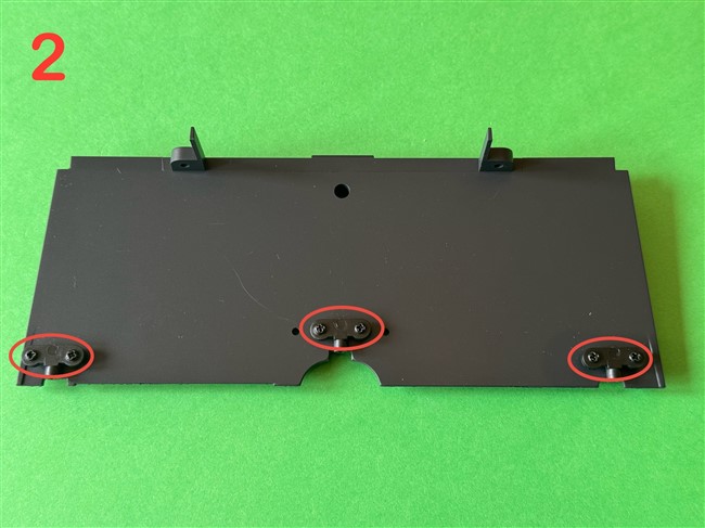

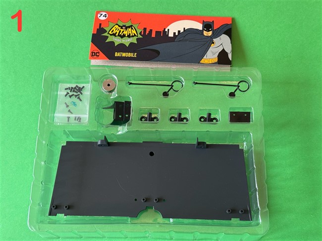

Issue 74

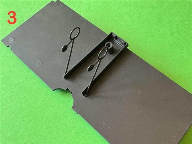

Using two CP screws for each of the three brackets (74B), secure each bracket to the bulkhead (74A) as shown in picture 2.
Turn the bulkhead over and place the two ejector seat pins in position, pushing them into the holes, picture 3. I used a little quick drying glue to make sure they are held in place securely.

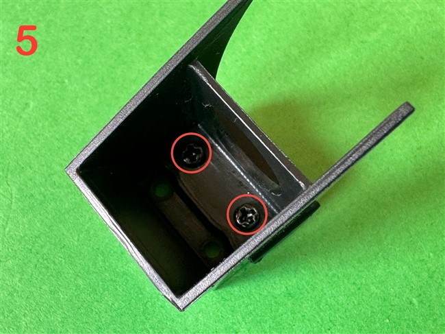

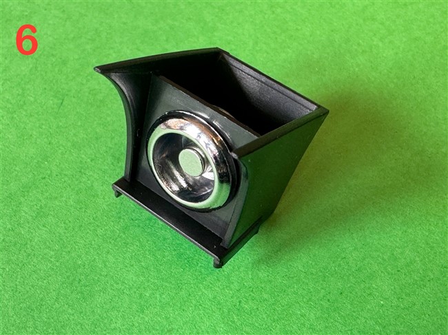

Secure the interior light console bracket (74E) to the interior light console (74C) using two AP screws, pictures 4 and 5. Now push fit the interior light (74D) into the light console, picture 6.

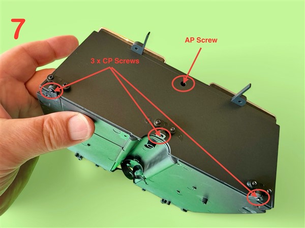

Return to the assembly of the cockpit section and fix the rear bulkhead using 3 x CP screws and 1 x AP screw as shown in picture 7.
Place the interior light console assembly on the rear bulkhead, picture 8 and secure in place using 2 x AP screws, picture 9.
Picture 10 shows the complete assembly for this issue.
