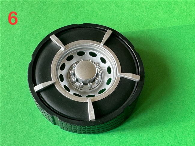

#1 Posted : 11 March 2025 21:39:55
Issue 92

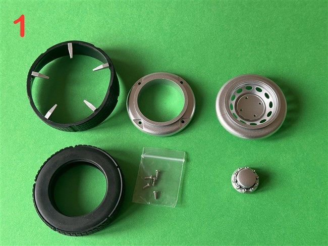

Picture 1 shows the parts for this issue.
Assembling the Leg

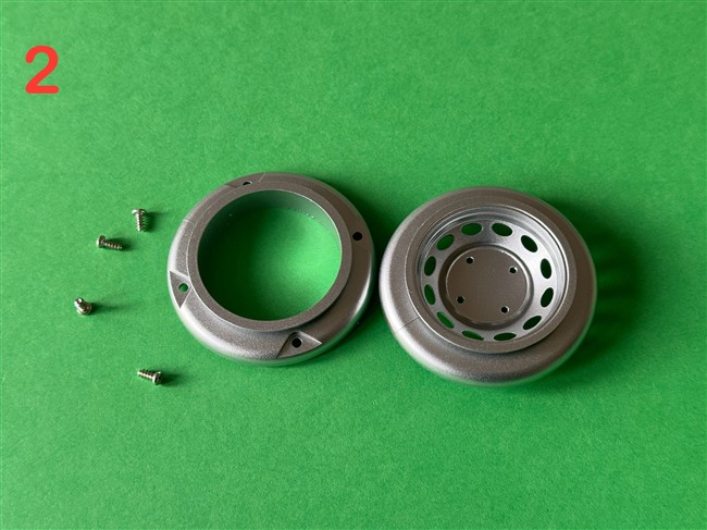

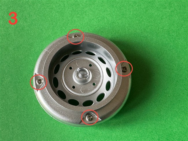

Attach the inner rim (92C) to the outer rim (92B) and secure the two with 4 x IP screws, pictures 2 and 3.

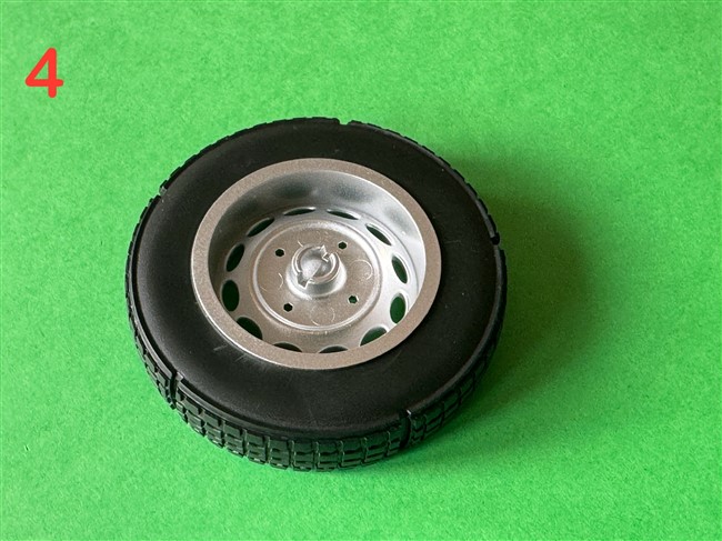

Fit the rim assembly inside the tyre (92D), picture 4. Note: If you warm up the tyre with hot water first, it will make the fitting over the rim much easier.

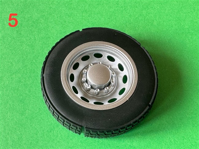

Fit the hub (92E) to the outer side of the rim as shown in picture 5.
Finally, fit the cover (92A) over the tyre with the metal end pieces on the outer side, picture 6.
That completes the assemble for this issue.

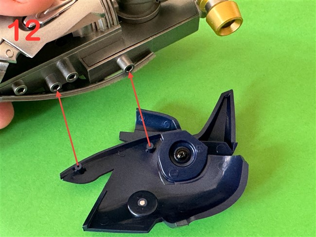

#2 Posted : 12 March 2025 19:29:21

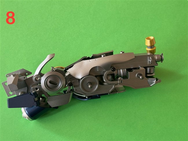

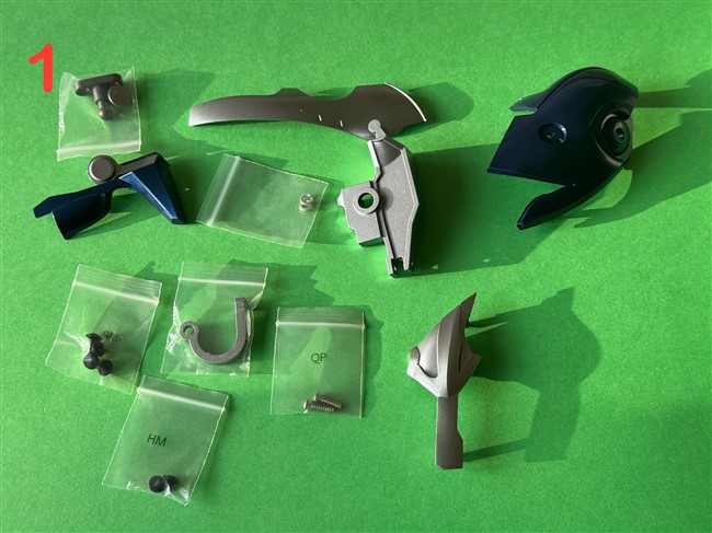

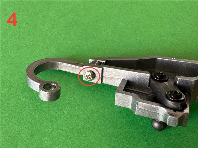

Issue 93 Part 1
Assembling the Leg

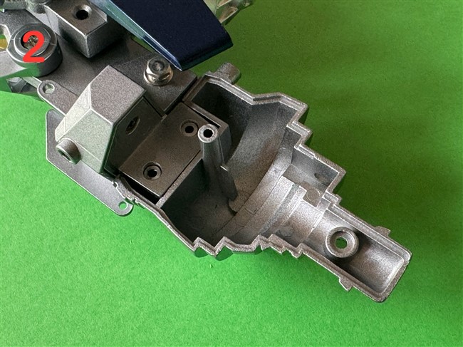

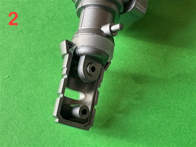

Insert the upper leg ball joint (93G) into the inside of the frame (93F) and secure with 2 x MP screws, pictures 2 and 3.
Fit the arm (93C) into the lower notch and secure it with a QP screw, picture 4.

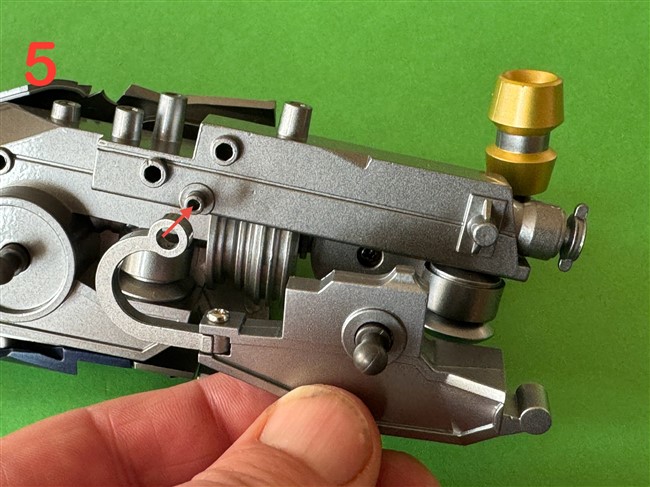

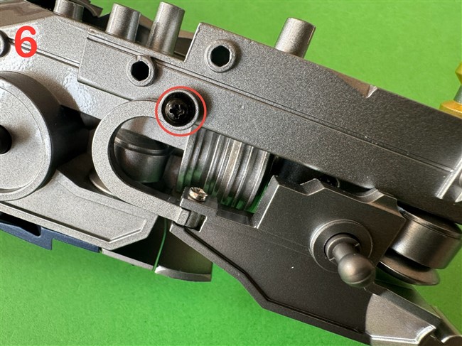

Retrieve the leg assembly and locate the pin on the outer side and secure the arm using a HM screw and washer, pictures 5 and 6.

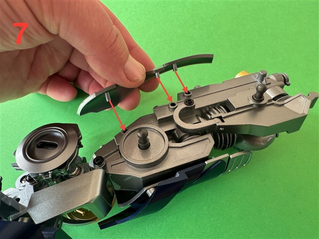

Fit the lower plate (93E) into the three side pins as indicated in picture 7.
Picture 8 shows the assembly complete for part 1 of this issue.

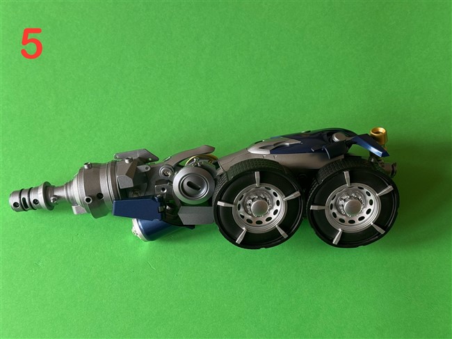

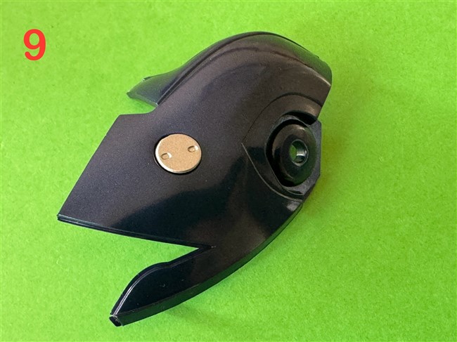

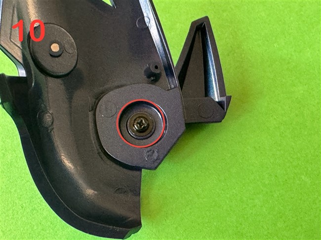

#3 Posted : 12 March 2025 19:38:54
Issue 93 Part 2
Assembling the Leg

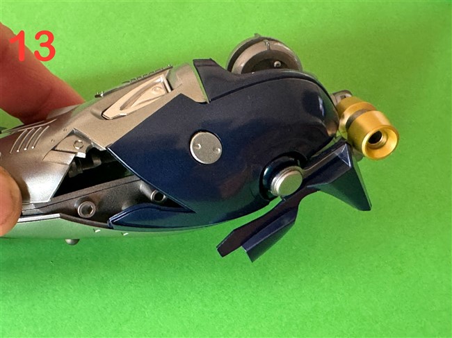

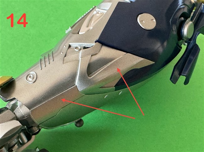

Fit the end cap (93H) into the recess of the front plate (93A), picture 9. Then insert the secondary thigh plate (93B) into the front plate and secure with an MP screw, pictures 10 and 11.

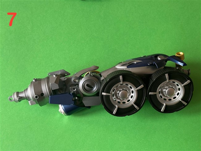

Fit the assembly on the front of the leg as shown in pictures 12 and 13. Next, snap fit the lower front thigh detail (93D) into the three pins, picture 14.

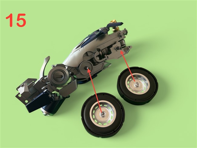

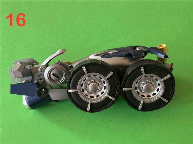

Retrieve the wheels from issues 89 and 92 and push fit them on the ball joints as shown in picture 15.
Picture 16 shows the assembly complete for part 2 of this issue.

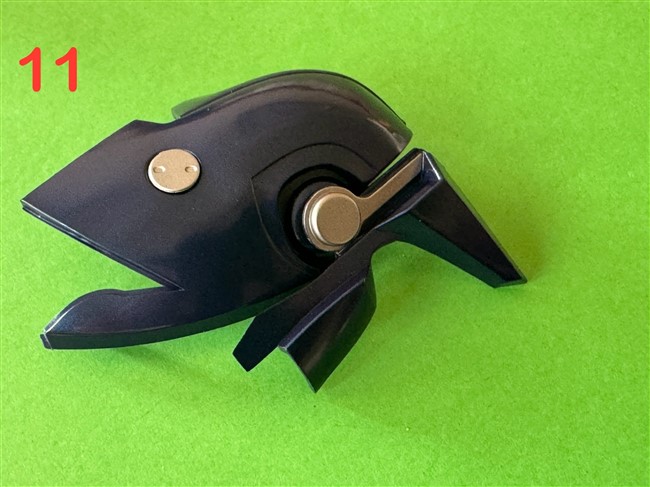

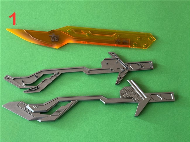

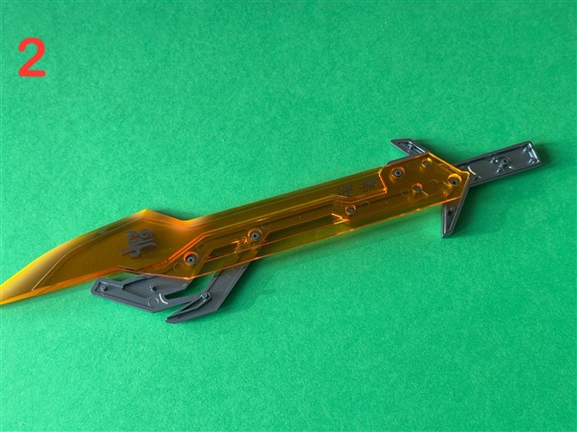

#4 Posted : 14 March 2025 10:40:35
Issue 94
Picture 1 show the parts for this issue.

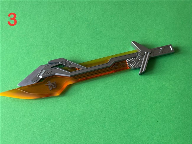

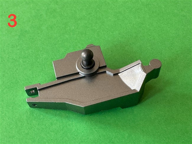

Assembling the Battle Sword
Take the right side of the sword (94A). Inside it, fit the blade (94C), picture 2.
Holding the two pieces in position, add the left side of the sword (94B), so that all the pins connect. Pust the pins in place working up and down the sword, gradually pushing the pins all the way in, picture 3.

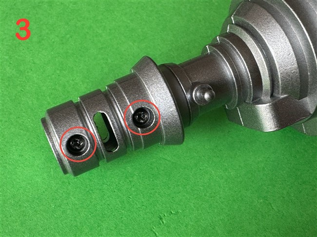

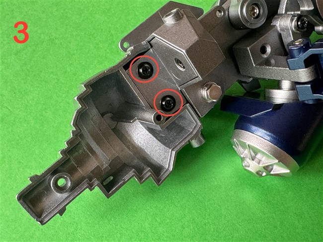

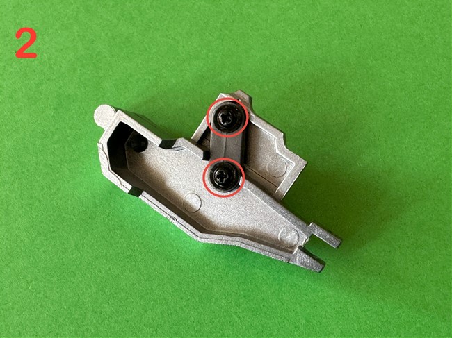

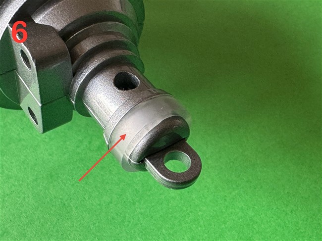

#5 Posted : 17 March 2025 10:09:11
Issue 95

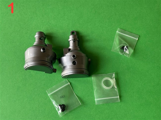

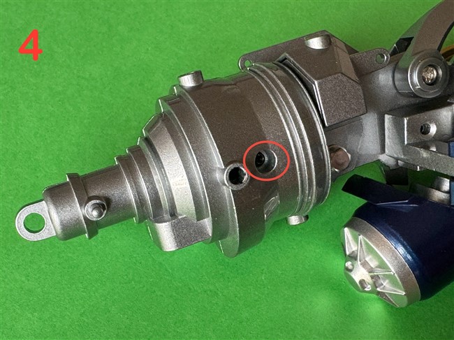

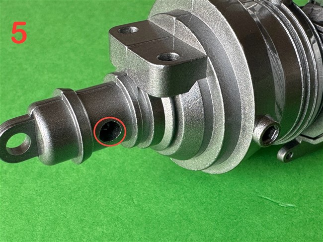

Assembling the Left Leg
Attach the lower leg end cap (95B) to the lower end of the left leg, picture 2. Secure it in place using 2 x GM screws, picture 3.
Now attach the other half of the lower leg end cap (95A) and secure using 2 BM screws, pictures 4 and 5.
Push the silicone washer (95C) onto the end of the ankle, picture 6.
Picture 7 shows the assembly complete for this issue.

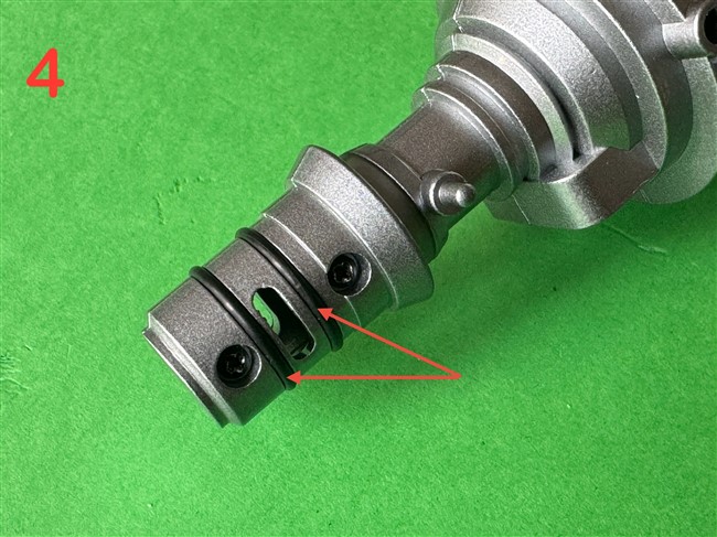

Issue 96

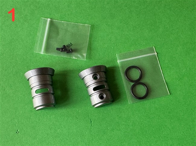

Note the orientation of the ankle parts (96A and 96B) when fitting them to the lower end of the leg as shown in pictures 2 and 3. Secure the parts using 2 x BM screws.
Push the two washers (96C) into the slots as indicated in picture 4. Note: Softening these in hot water first, helps putting them in place easier.
Picture 5 shows the assembly complete for this issue.
