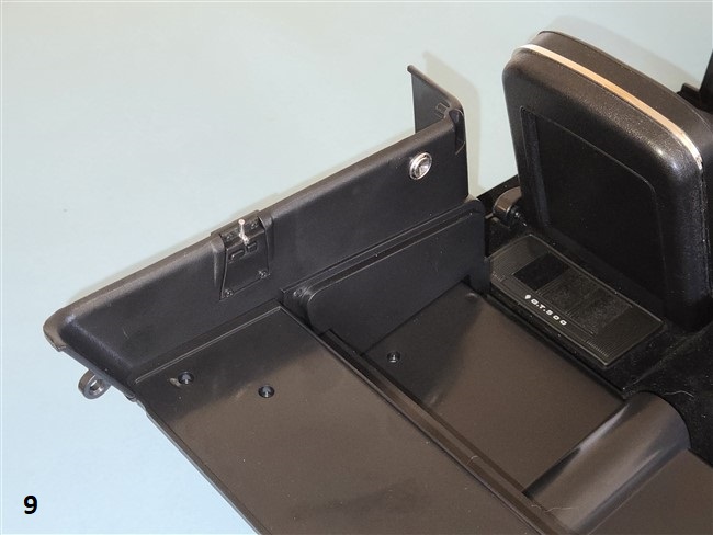

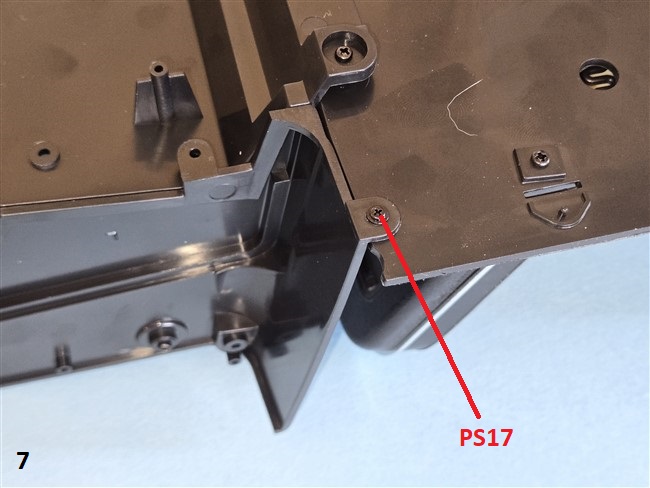

#1 Posted : 03 March 2025 16:25:51
Hi All, BigGrin
Here we go with the next pack #16, that covers Issues 69 - 73.
In this issue #69, we start building up the interior of the passenger compartment.
Parts supplied.....Pic 1, you will also need the interior section from the last update.

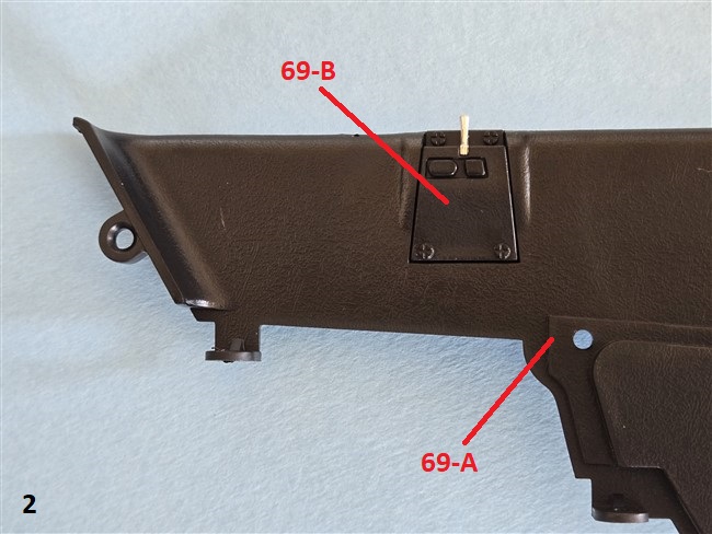

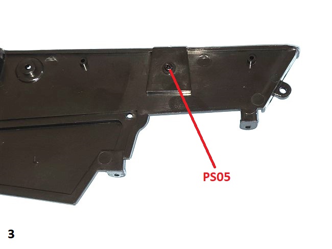

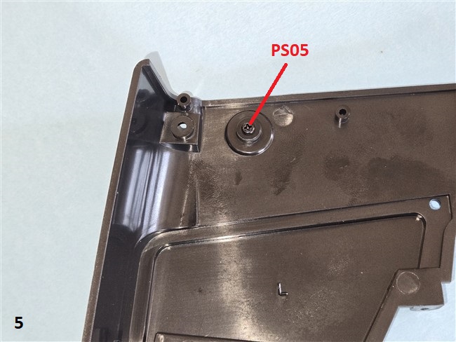

Start with the interior panel 69A and position the rear seat folding mechanism 69B in place, Pic 2. Hold the parts together and fix them from the rear using a PS05 screw, as in Pic 3. Now place the fitting 69C into the panel as in Pic 4 and secure it with a PS05 screw, Pic 5.

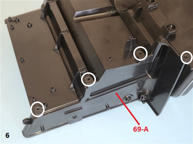

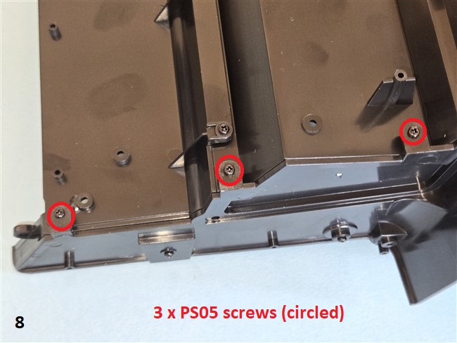

Bring the interior assembly from the last update to the table. Place it upside down and position the new panel 69A as shown in Pic 6. Now fix the side panel into position using a PS17 screw, Pic 7 and 3 x PS05 screws as in Pic 8.
The final assembly for this issue is shown in Pic 9.

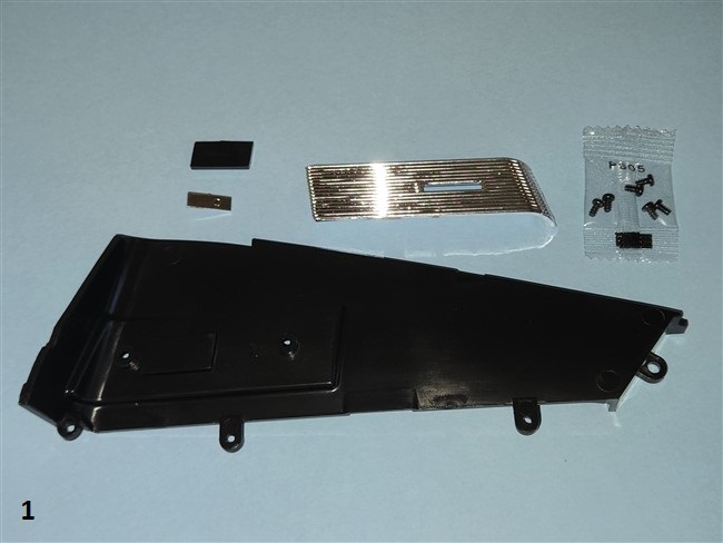

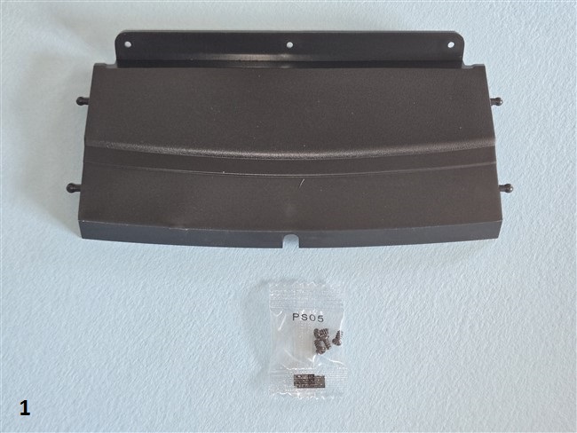

Parts supplied.....Pic 1, you will also need the inner cabin assembly from the last update.

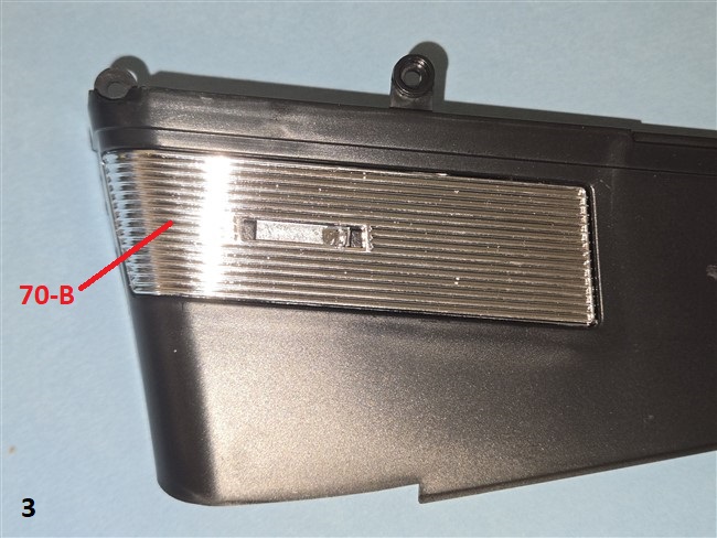

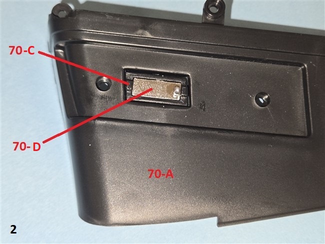

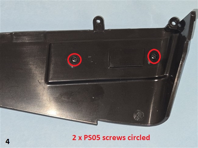

Start with the left rear upper panel 70A and insert the ventilation lever holder 70-C, followed by the ventilation adjustment lever 70-D as shown in Pic 2. Next, place the left ventilation grille 70-B in place to retain the previous parts and then, (whilst holding the parts in place), fix them from behind using 2 x PS05 screws as indicated in Pic 4.

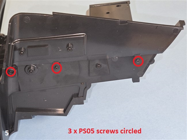

Now position the assembly onto the rear left side of the cabin interior from the previous stage 69 and fix it into position using 3 x PS05 screws, as shown in Pic 5.

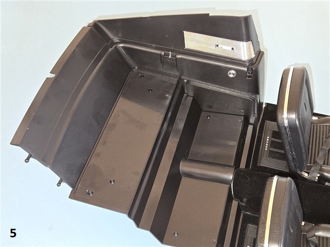

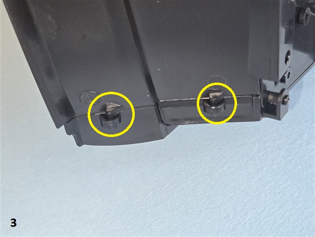

#3 Posted : 08 March 2025 18:27:52
Hi All, BigGrin
Time for the next update, with Issue 71. In this update we add the rear wall of the passenger cabin area.
Parts supplied.....Pic 1, you will also need the internal cabin from the previous update.

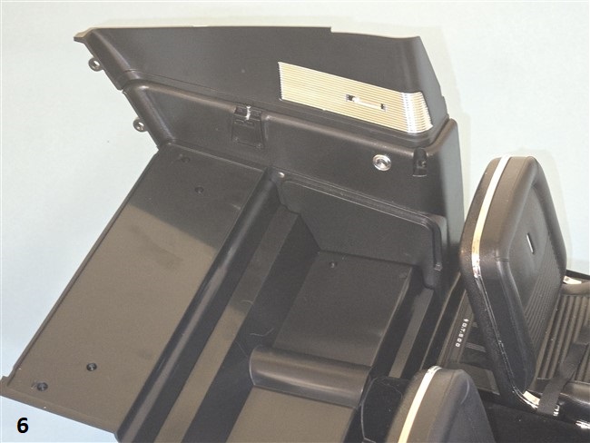

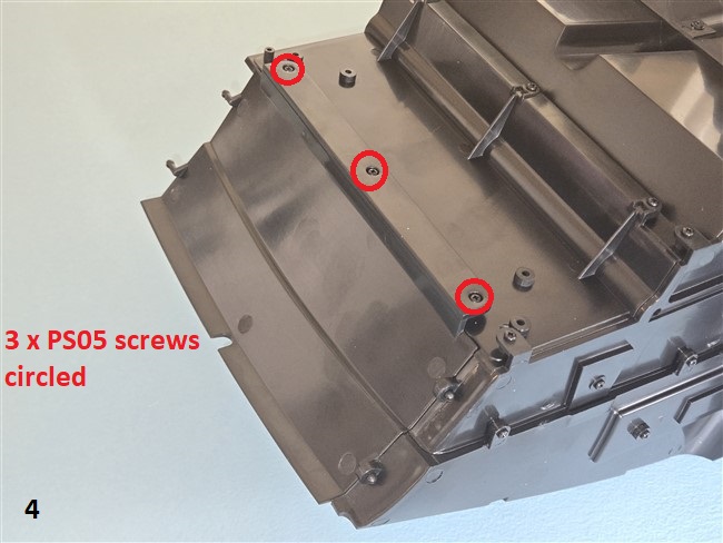

With the cabin assembly on the table, press fit the two posts of part 71A into the side panels as in Pic 2, with a closer Pic 3 for detail.
Now connect the long side of the panel to the existing floor, using 3 x PS05 screws as shown in Pic 4.
That`s all for now, Pic 5 shows the rear end of the cabin and Pic 6 showing the whole cabin area.
(Derek) Admin

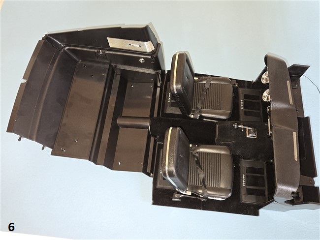

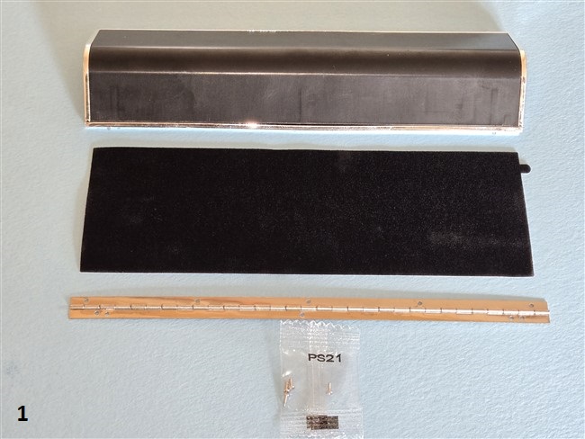

#4 Posted : 11 March 2025 16:16:17
Hi All, BigGrin

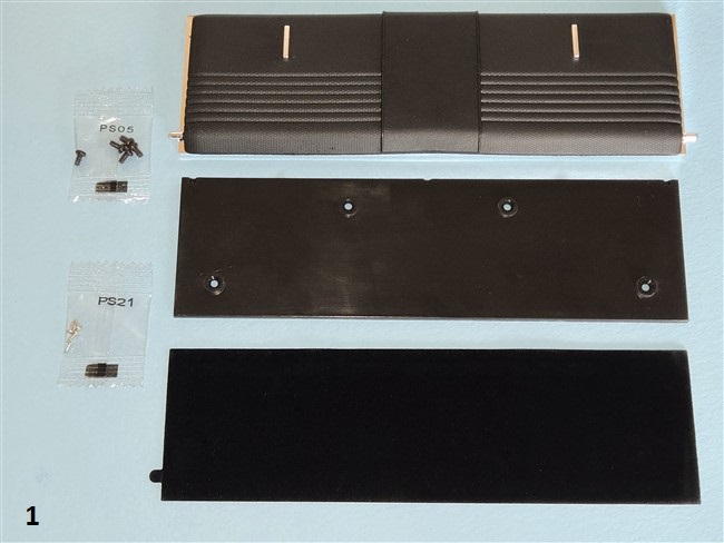

Issue 72 update time, with the Parts supplied.....Pic 1.

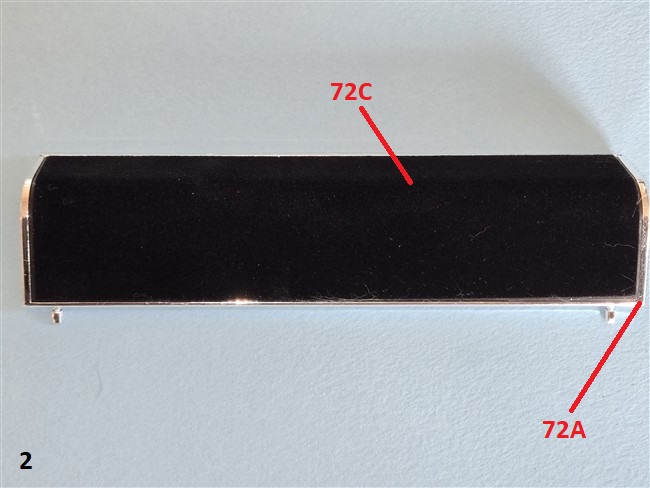

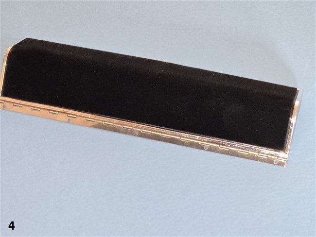

Remove the backing paper from the carpet 72-C and apply it to the outer surface of the folding panel 72-A as shown in Pic 2.

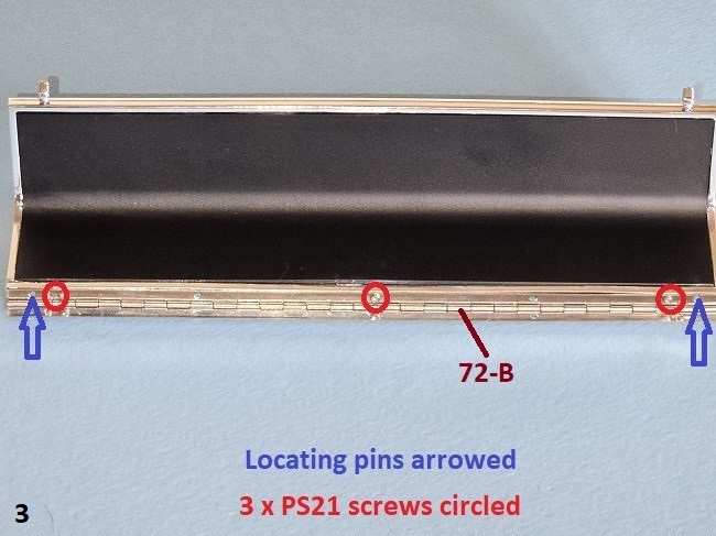

Now position the hinge 72-B onto the small locating pins of the panel and secure the parts together using 3 x PS21 screws. All shown in Pic 3.
That`s all for this update, Pic 4.
(Derek) Admin

Parts supplied.....Pic 1, you will also need the assembly from the end of the last issue #72.

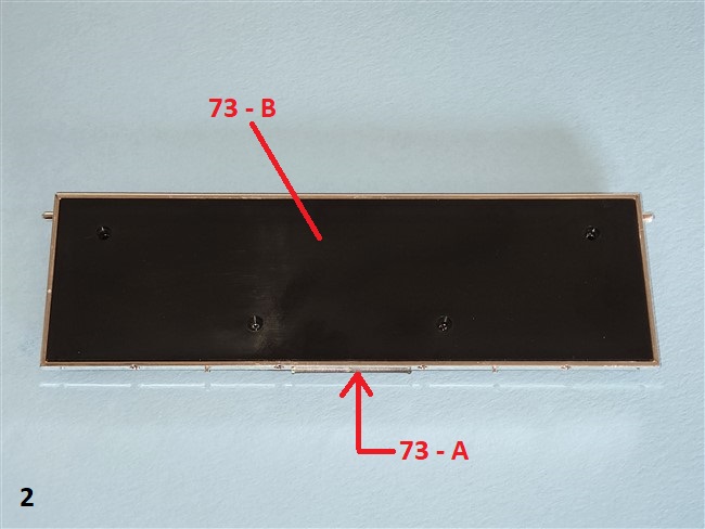

Start by placing the panel 73-B into the backrest 73-A, making sure the screw fixing holes line up, Pic 2. Then fix the parts together using 4 x PS05 screws, as shown in Pic 3.

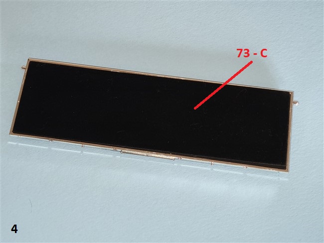

Now, fit the adhesive carpet 73-C onto the back panel to cover the screws just fitted as in Pic 4.

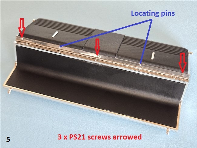

Take the panel from issue 72 and line up the free side of the hinge with the backrest, engaging the two locating pins of the backrest into the hinge. Then fix the parts together with the silver screws 3 x PS21. All shown in Pic 5.
