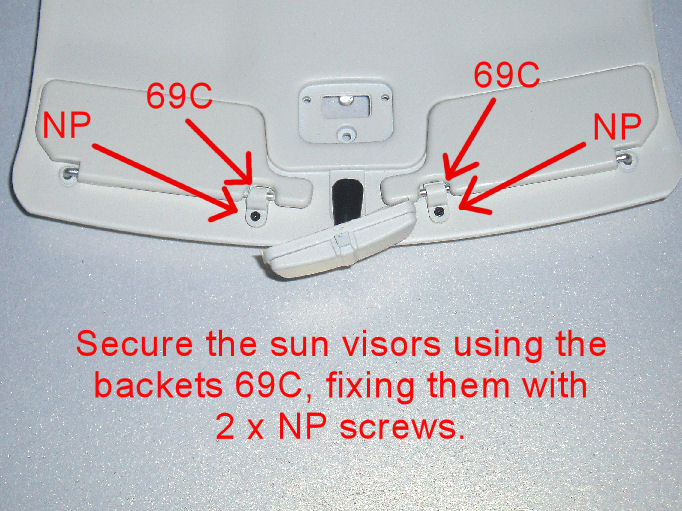

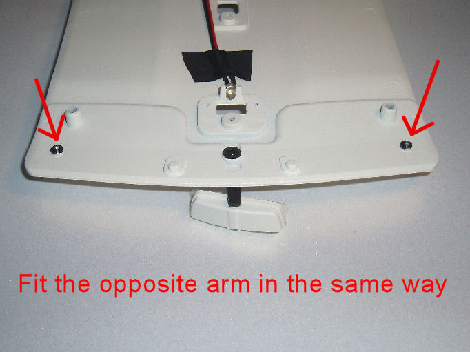

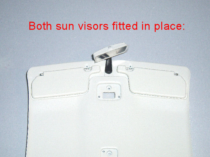

STAGE 69A:
Car interior parts.

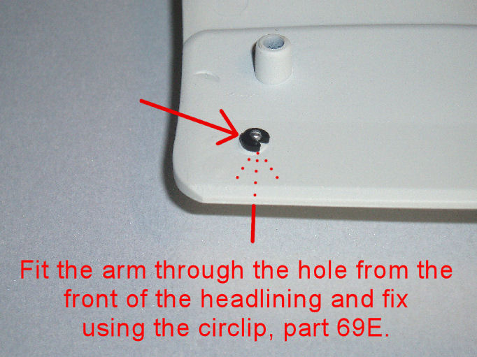

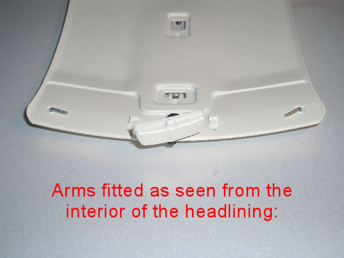

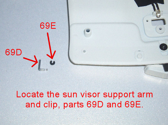

Retrieve the interior headlining, part 68A and locate the sun visor pins and circlips, parts 2 x 69D and 2 x 69E.
Fit the pins through the headlining from the front and secure with the circlips.

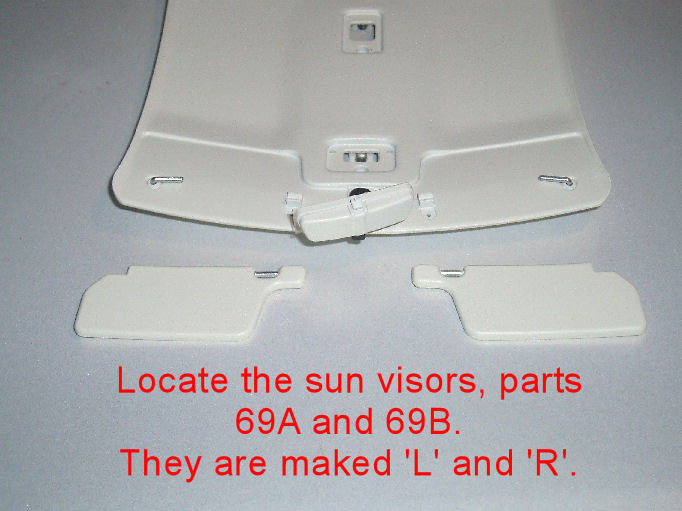

Locate the sun visors, parts 69A and 69B. The parts are marked ‘L’ and ‘R’.
Fit the sun visors onto the angled pins.
Locate the brackets, parts 2 x 69C and fit them to the headlining, holding the sun visors in place. Fix them with 2 x NP screws.

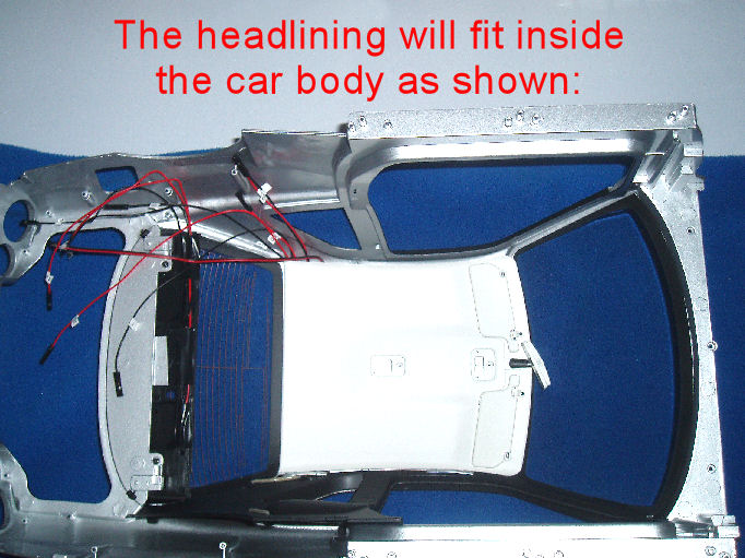

Fit the headlining in place inside the main car body, part 61A.
Do not press it down firmly yet.

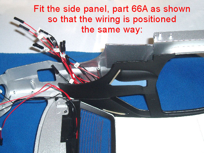

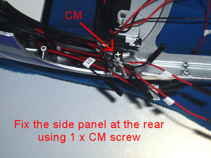

STAGE 69B:

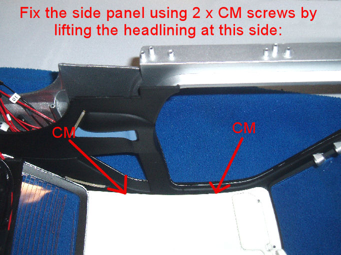

Retrieve the interior side panel, part 66A and temporarily remove the roof grab handle if you previously fitted it and position the panel inside the upturned car body. The body should be placed on a soft cloth or similar to prevent any scratches to the roof paint.
Make sure that all of the wiring on the interior side panel and headlining is exiting the body near the wheel arch.
The wiring on the rear parcel shelf should still be free inside the body.

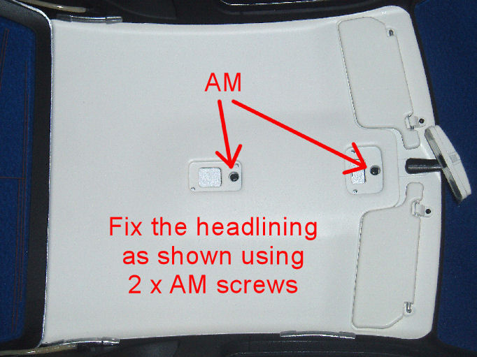

Carefully lift the headlining on that side and fix the side panel to the roof using 2 x CM screws near the door opening.
Fit another CM screw near the rear wheel arch and 1 x AAM screw at the front pillar of the side panel.

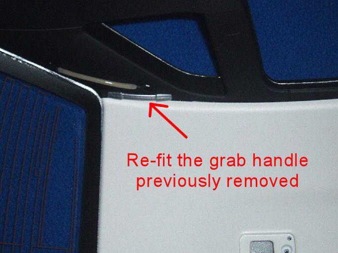

The headlining can now be pressed fully into place and the grab handle refitted.

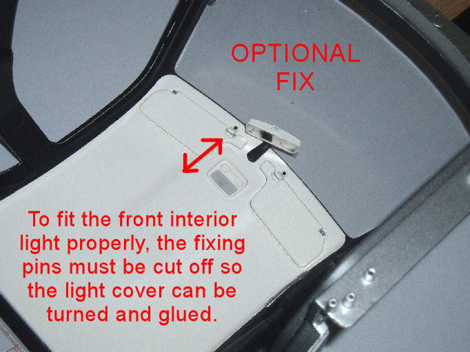

Retrieve the interior light covers, parts 67E and 67F.
These can be pressed into place on the headlining.
NOTE: The front light cover, part 67E has been manufactured incorrectly.
It fits the wrong way around so the switch panel section covers the LED, effectively preventing the light from being seen.
The printed instructions show the cover the right way round but it cannot be fitted this way.
If you wish to fix this mistake, you will need to cut off the two fixing pins on the back of the cover and carefully glue it in place the right way round.
This is ENTIRELY at the builders discretion.

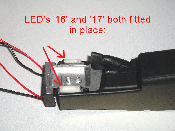

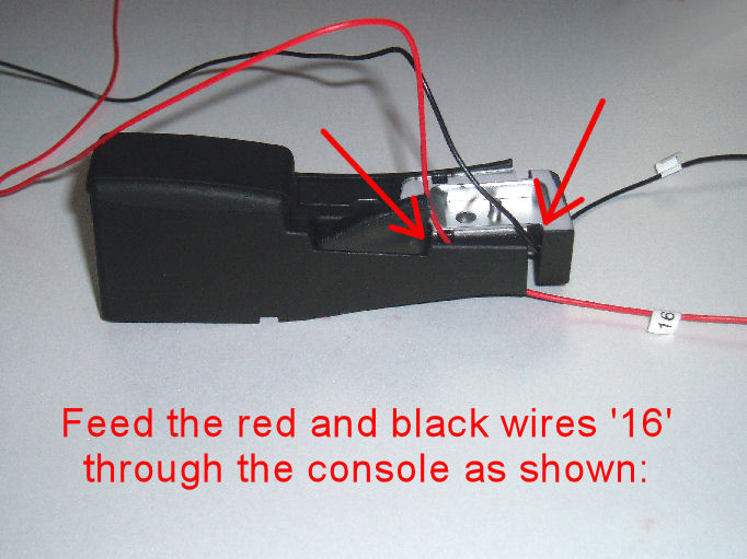

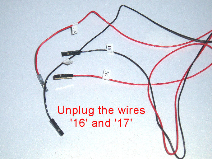

STAGE 70:
Car interior lighting.

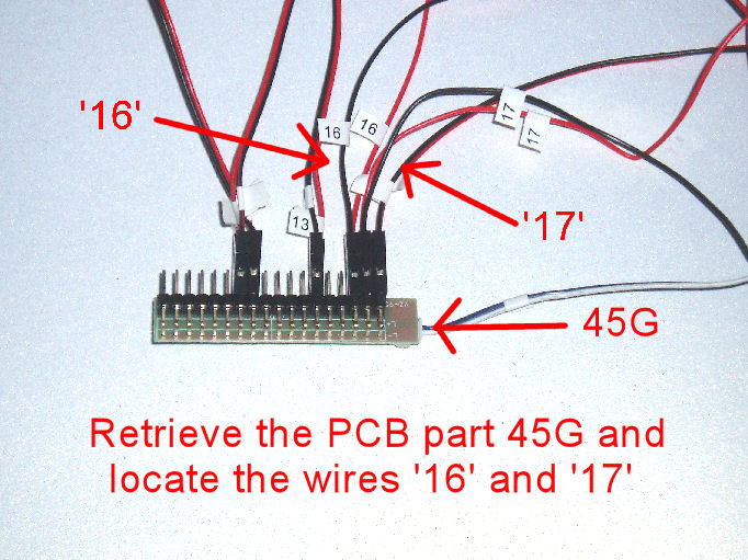

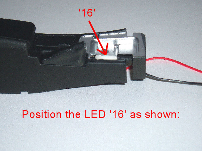

Retrieve the PCB, part 45G and remove the wires labelled ‘16’ and ‘17’.

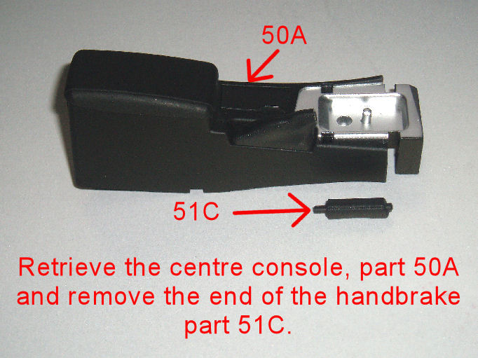

Retrieve the centre console, part 50A and remove the end of the handbrake, part 51C.
Carefully feed the two wires ‘16’ down through the rectangular holes in the right side of the console.
Take care not to damage the identifying labels on the wires.

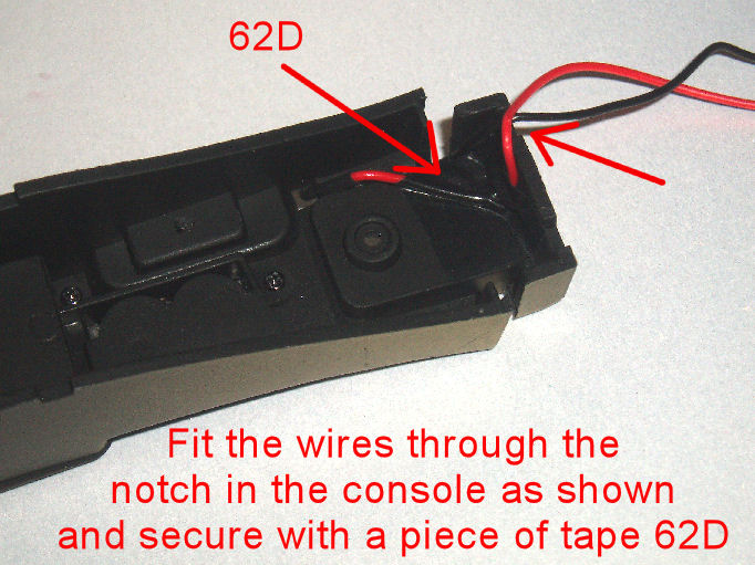

Pull the LED into position on the console and tape wires in place on the underneath using a piece of 62D tape.
Feed the wires out through the small groove at the front of the console.

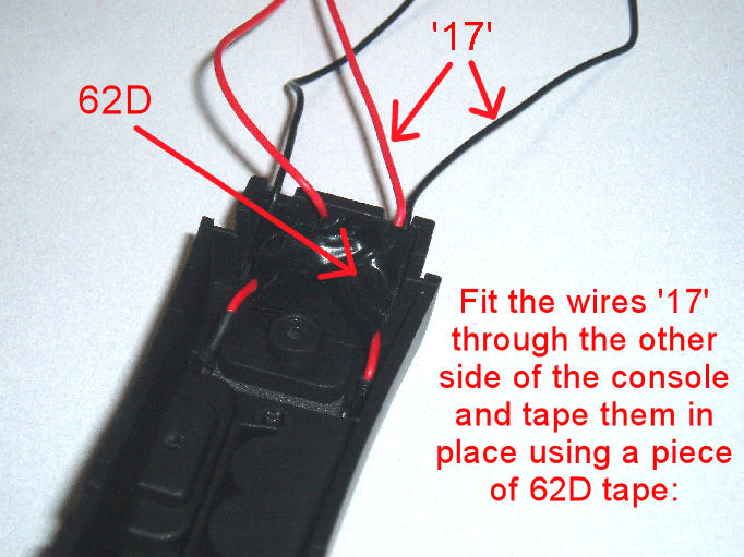

Repeat with wires ‘17’ on the other side of the console.

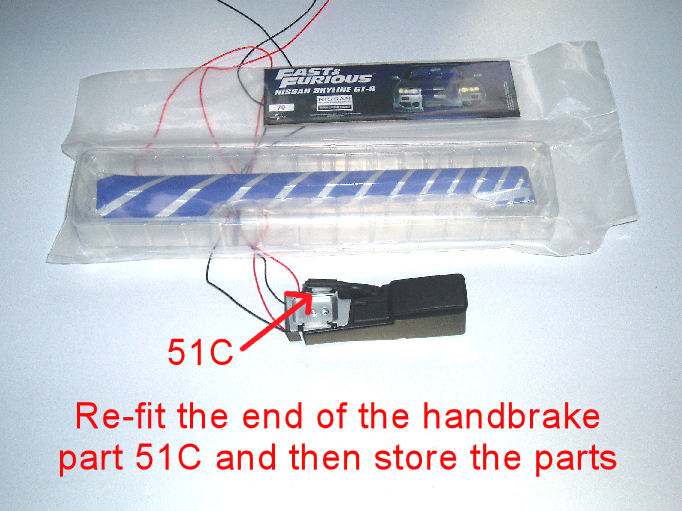

Tape the wires in place under the console and feed them out through the notch in front.
Fit the end of the handbrake, part 51C back in place.
Store the assembly and unused parts safely for now.

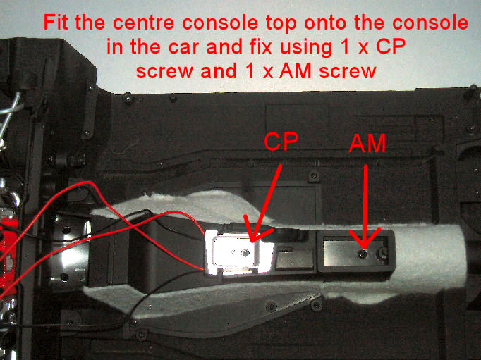

STAGE 71:
Centre console assembly.
Retrieve the main car interior floor and fit the console assemble from the previous stage to the top of the transmission tunnel.
It will only fit one way round.
Secure it using 1 x CP screw at the front and 1 x AM screw at the rear.
Make sure the wiring is exiting at the front through the two small grooves in the console, part 50A.

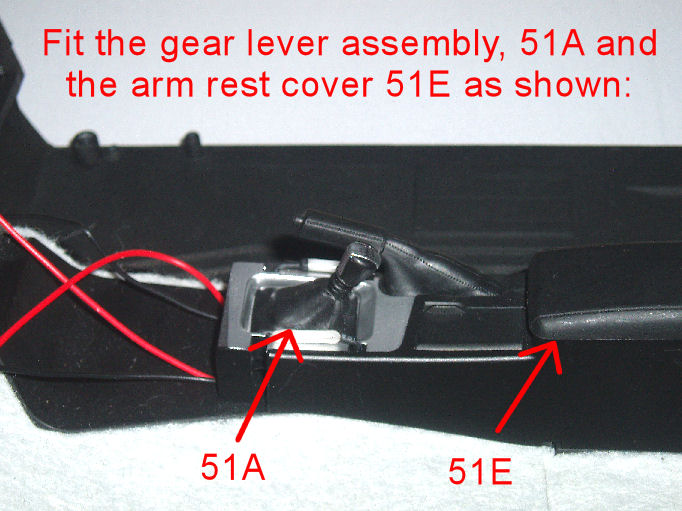

Fit the gear lever assembly, 51A into the locating hole at the top front of the console.
The lever should be pointing to the rear of the car.
Fit the arm rest, part 51E to the top of the box section on the console.
It will only fit properly one way.

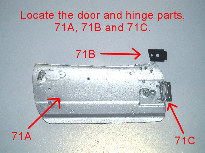

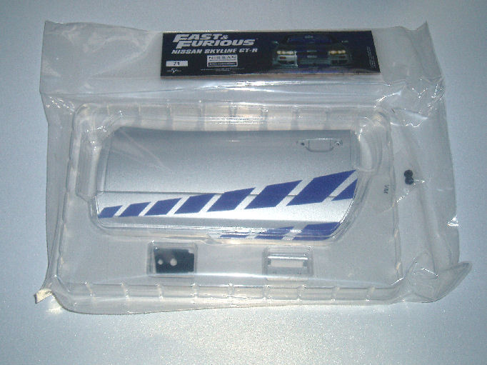

Locate the door and hinge parts, 71A, 71B and 71C.

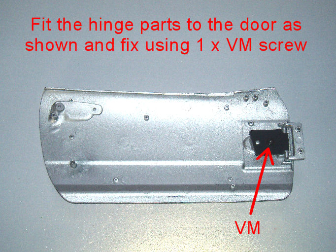

Fit the hinge, part 71C, into the recess at the front of the door so that the flat screw fixing surface is uppermost.
Fit the spring plate, part 71B in place and secure it using 1 x VM screw.

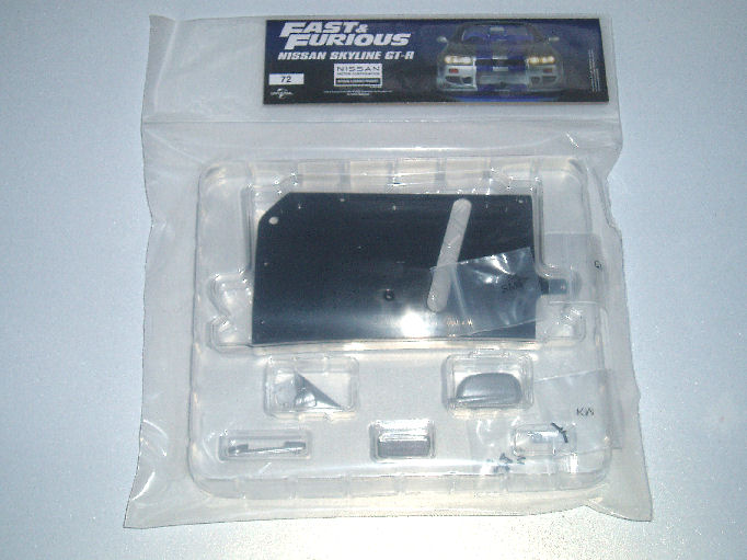

STAGE 72:

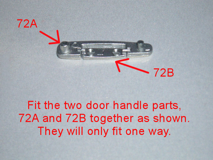

Door parts.

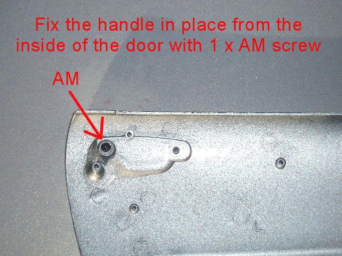

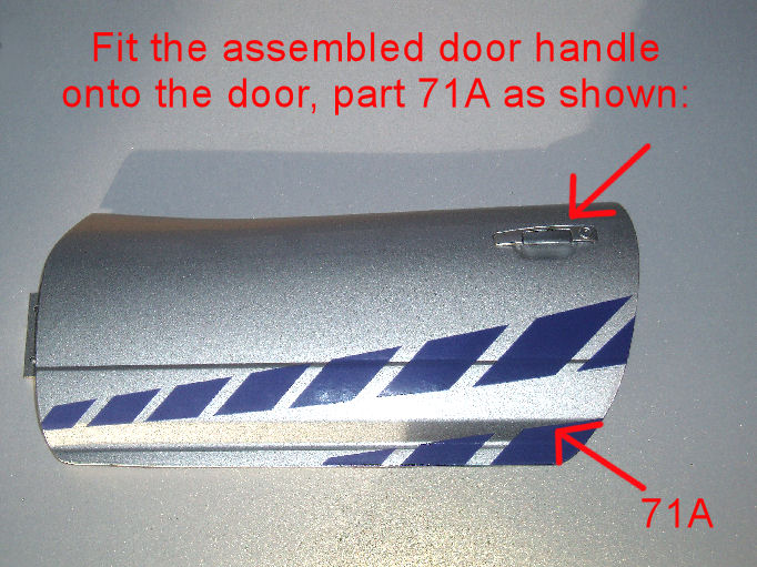

Locate the door handle parts 72A and 72B and fit them together.
They will only fit one way. Position the handle on the door, part 71A.
Fix the handle assembly to the door from the inside using 1 x AM screw.

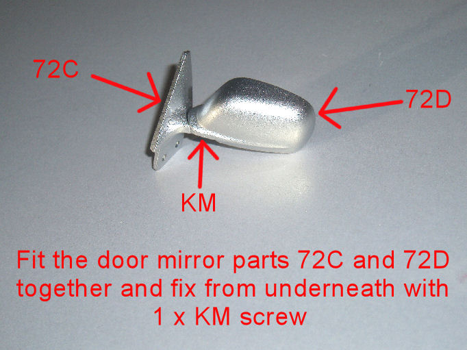

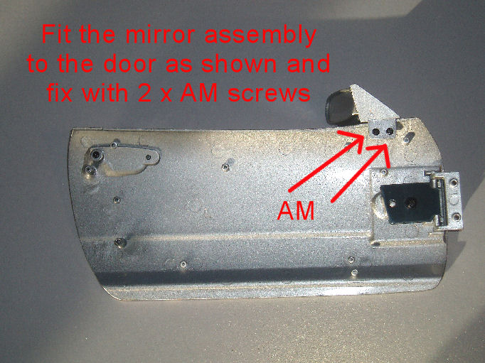

Fit the mirror parts 72D and 72C together and fix them from underneath with 1 x KM screw.

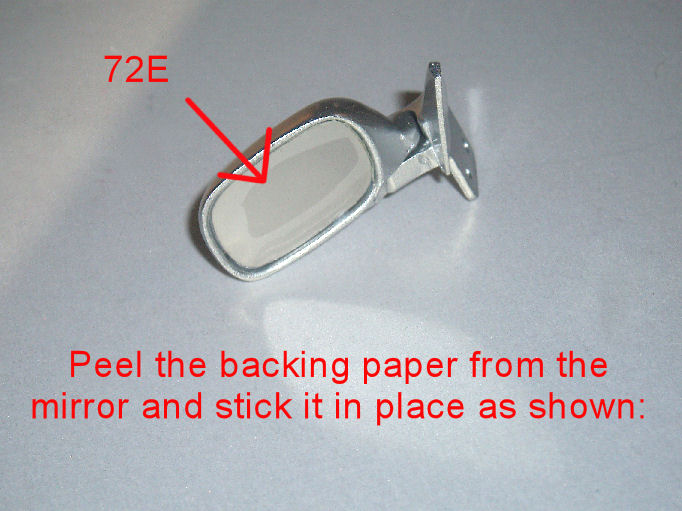

Peel the backing paper from the mirror, part 72E and stick it in place on the mirror assembly.
Fit the assembled mirror onto the door, part 71A and fix from the inside using 2 x AM screws.

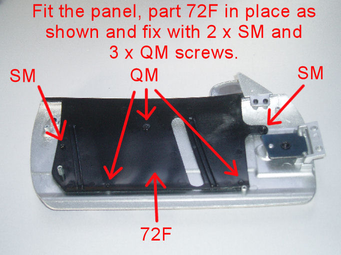

Fit the inner door panel, part 72F in place on the door and fix it using 2 x SM screws and 3 x QM screws.

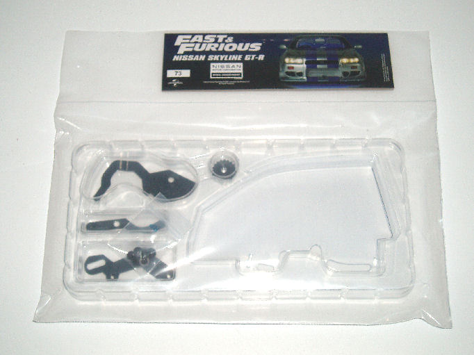

STAGE 73:
Door window parts.

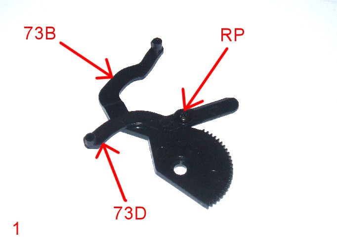

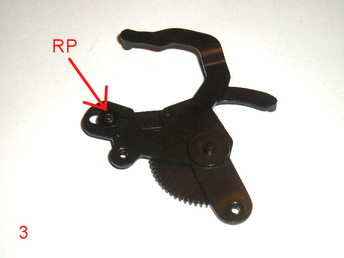

Pic 1: Fit the window mechanism parts 73B and 73D together and secure with 1 x RP screw.
Make sure the small screw posts on the end of each arm are both facing upwards in the same way.

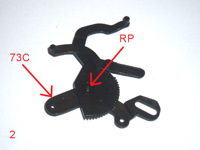

Pic 2: Fit part 73C under the assembly so that the hole in the gear part 73B is over the screw post in part 73C.
Fix the parts together with 1 x RP screw.
Pic 3: Fit the screw post on the end of the arm on part 73D through the slot in the arm of part 73C and secure with 1 x RP screw.
Pic 4: Fit the window glazing part 73A over the assembly so thet the screw posts on parts 73B and 73D go through the slots in the bottom edge of the window.
Check the picture to make sure you have the window the right way around.
Fix with 2 x RP screws.

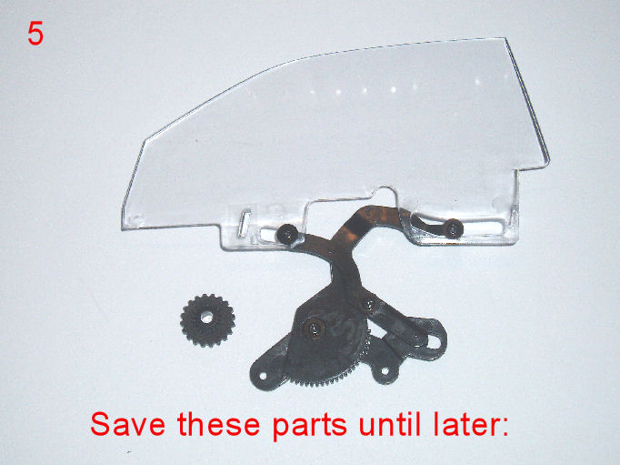

Pic 5: Shows the parts that must be saved until later.

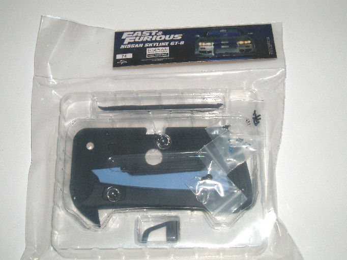

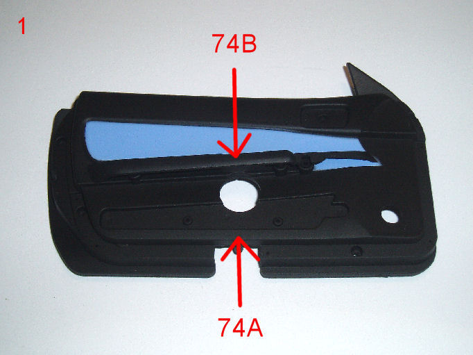

STAGE 74:
Door assembly.

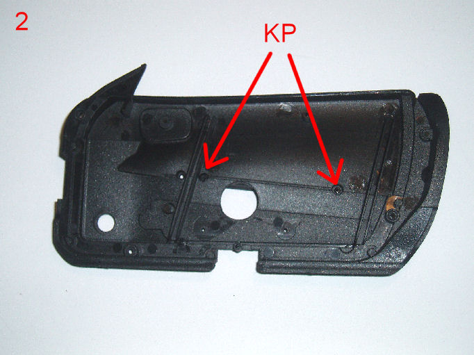

Pic 1: Fit the door armrest to the door panel, parts 74A and 74B.
Pic 2: Fix the parts together with 2 x KP screws from the other side.

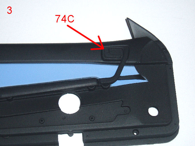

Pic 3: Fit the door pull, part 74C in place on the door panel.

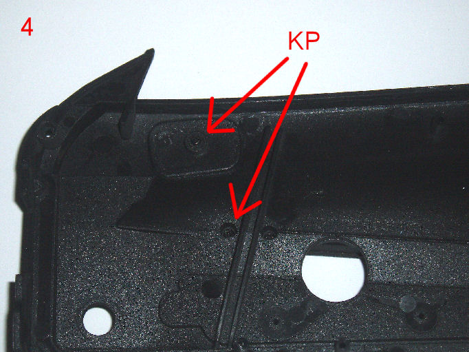

Pic 4: Fix the parts together with 2 x KP screws from the other side.

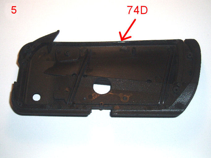

Pic 5: Fit a strip of protective tape, part 74D to the upper lip on the panel, 74A.

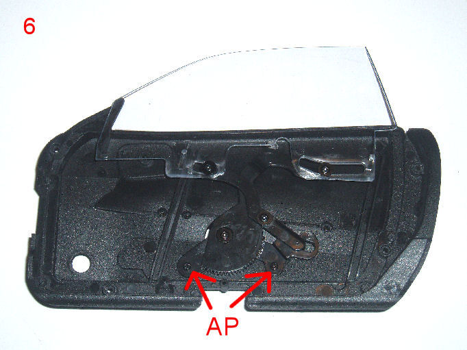

Pic 6: Fit the window assembly in place on the door panel and fix with 2 x AP screws.

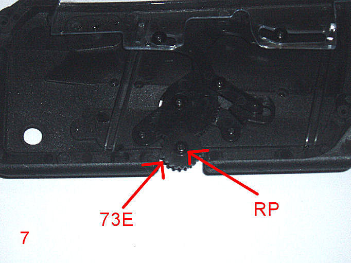

Pic 7: Fit the window gear, part 73E from the previous stage and fix with 1 x RP screw.

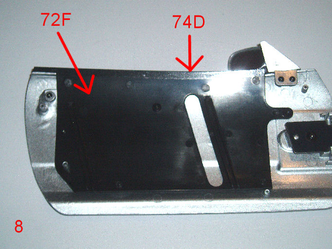

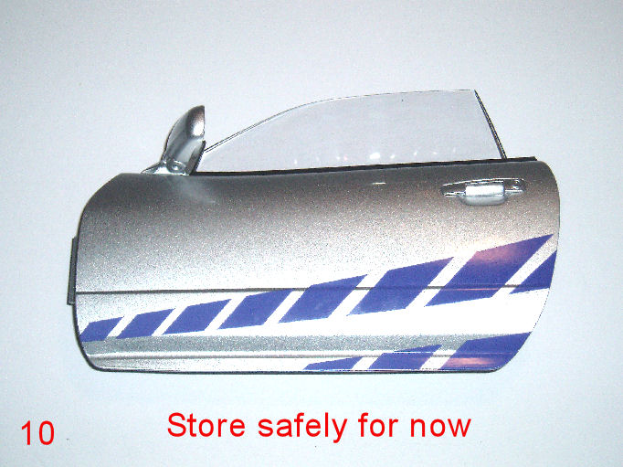

Pic 8: Retrieve the door assembly and fit a strip of protective tape, part 74D to the upper lip on the panel, 72F.
Pic 9: Fit the door panel assembly in place on the door and fix using 4 x AM screws.
Pic 10: Shows the completed stage.
