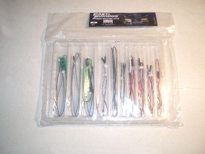

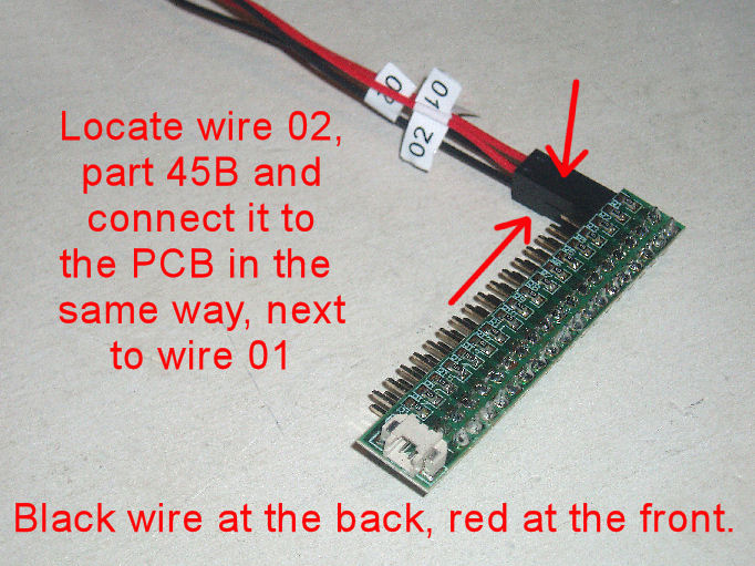

STAGE 45:

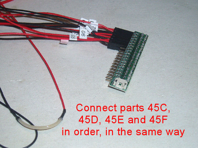

These parts are for beginning to assemble the PCB units.

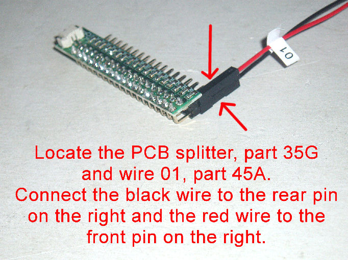

Locate the PCB, part 45G and the wire 01, part 45A.
Hold the PCB with the white connector facing you, but to the left.
Fit wire 01, part 45A to the pins on the right of the PCB, with the black wire at the rear and the red wire at the front.
Fit all the other wires, 02, 03, 04, 05 and 06, parts 45B, 45C, 45D, 45E and 45F in the same way, next to wire 01 and in numerical order.
All black wires go to the rear, red wires at the front.

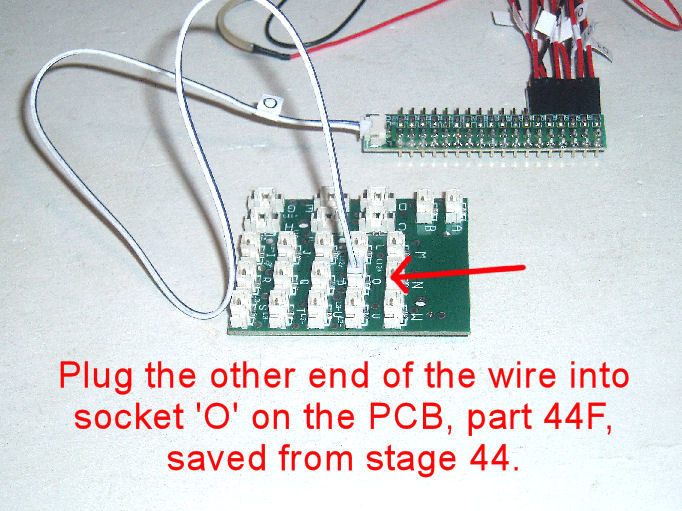

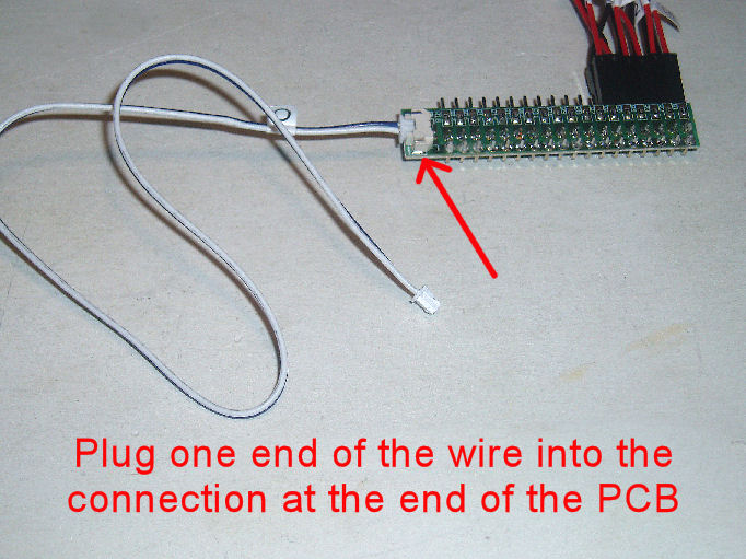

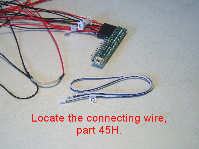

Locate the blue connecting wire, part 45H and plug one end into the white connector on the end of the PCB.
Retrieve the other PCB saved from stage 44.
Locate the socket marked ‘O’ and plug the other end of the blue wire, part 45H into it.
Store these parts safely for now.

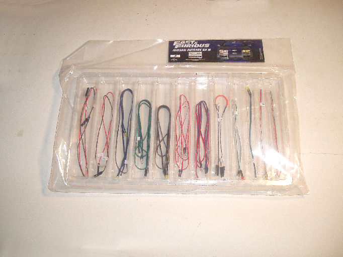

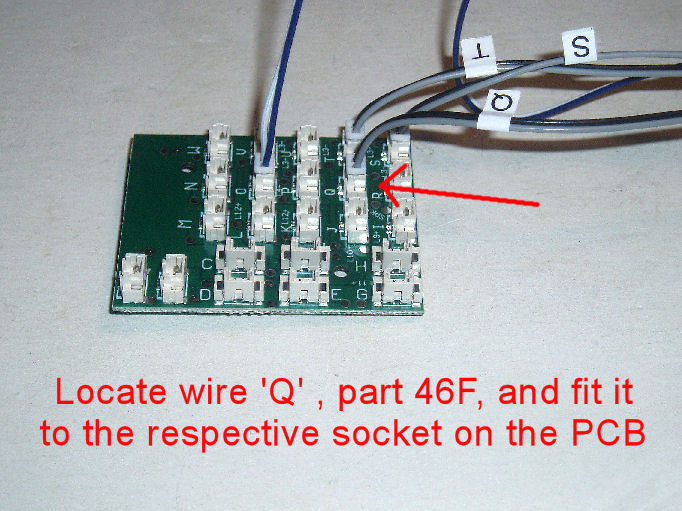

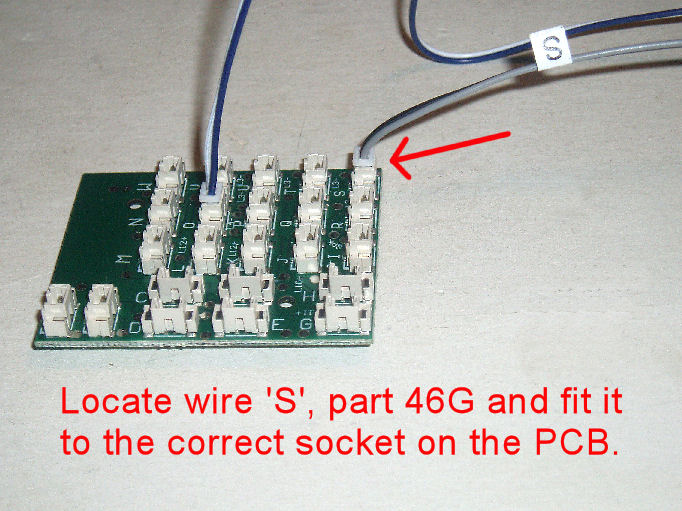

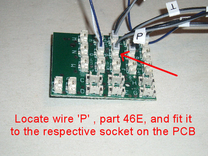

STAGE 46:

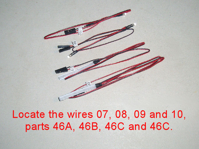

These parts are for adding more wiring to the PCB units.
Retrieve the PCB assemblies from the previous stage.

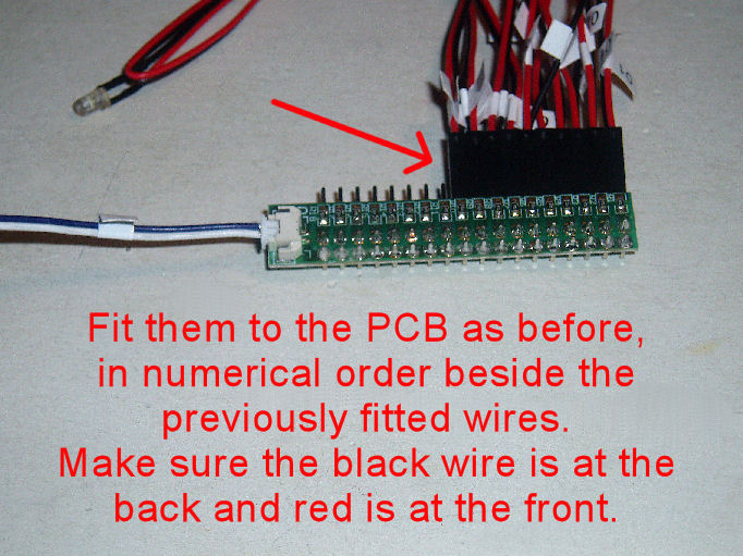

Locate wires 07, 08, 09 and 10, parts 46A, 46B, 46C and 46C.
Fit these to the long PCB, part 45G in the same way as the previous wires, adding them in numerical order next to the previous wires.
Make sure all the black wires are at the back and the red wires at the front.
Locate wire ‘S’ part 46G, and plug it into the terminal marked ‘S’ on the PCB.

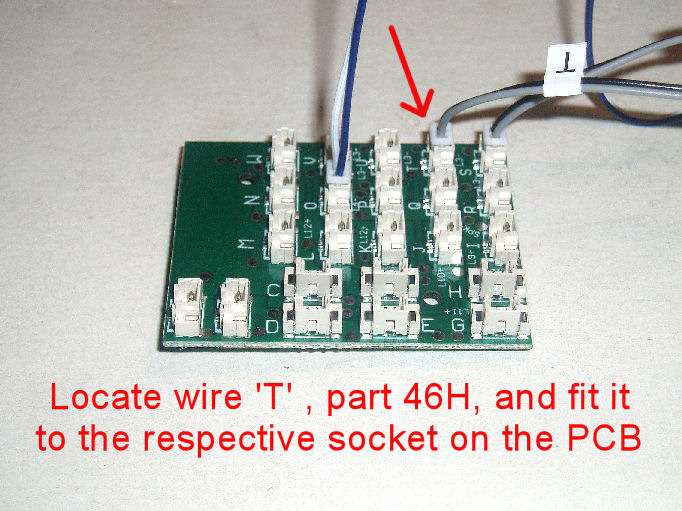

Locate the wires marked ‘T’ and ‘Q’, parts 46H and 46F, and fit them to the respective terminals on the PCB.

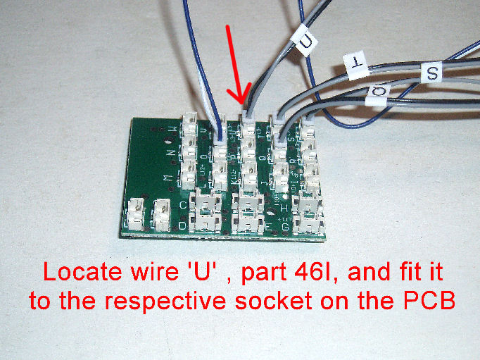

Locate the wires marked ‘P’ and ‘U’, parts 46E and 46I, and fit them to the respective terminals on the PCB.

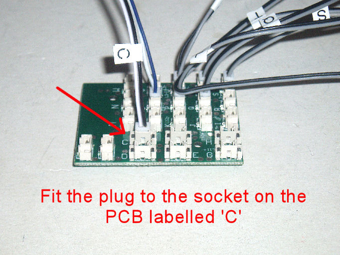

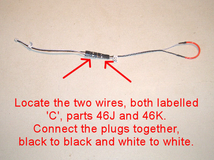

Locate the two wires, both labelled ‘C’ parts 46J and 46K and fit the plugs together, black to black and white to white.
Fit the plug on wire ‘C’ into the respective terminal on the PCB.

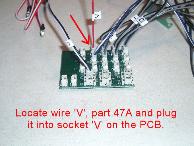

STAGE 47:

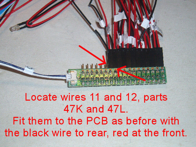

These parts are for adding further wiring to the PCB units.
Retrieve the PCB, part 45G.
Locate the wires 47I and 47K.
As with the previous wires on the PCB, fit these in number order next to the previously fitted wires, keeping the black wire at the back and the red wire at the front.
Retrieve the other PCB, part 44F.
Locate wire ‘V’, part 47A and plug it into the corresponding socket on the PCB.

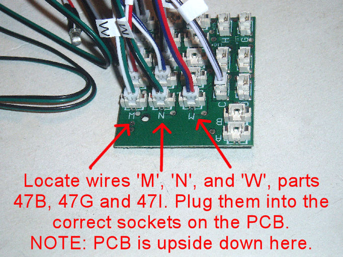

Locate the wires ‘M’, ‘N’ and ‘W’, parts 47G, 47B and 47I.
Plug them into their respective sockets on the PCB.
NOTE: Make sure you are looking at the PCB the ‘right way up’ so you don’t confuse socket ‘M’ with socket ‘W’.
Locate wires ‘G’ and ‘H’.
Plug them into their corresponding sockets on the PCB.

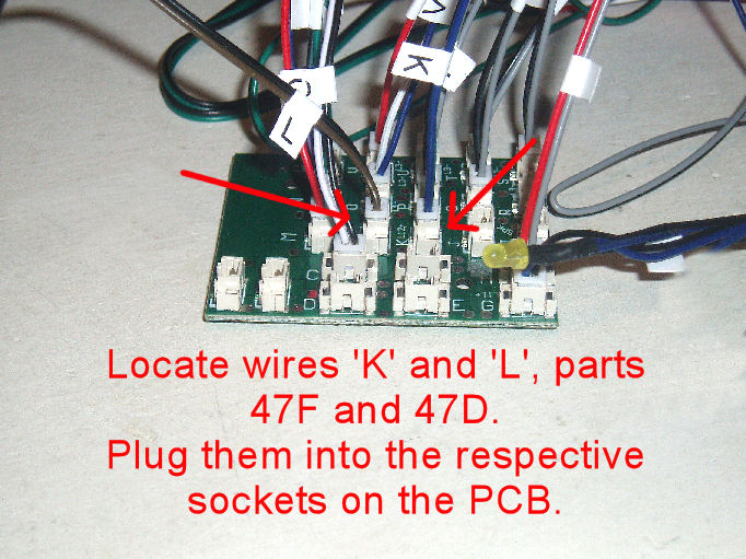

Locate the wires ‘K’ and ‘L’, parts 47F and 47D.

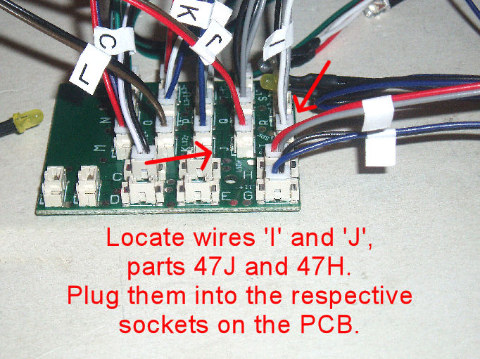

Locate wires ‘I’ and ‘J’, parts 47J and 47H.

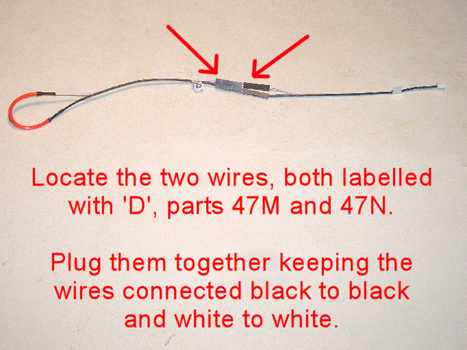

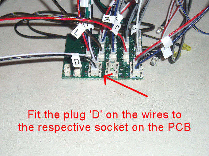

Locate the two wires, both labelled ‘D’, parts 47M and 47N.
Connect their plugs together making sure you connect the black wires together and the white wires together.
Fit the plug on these wires into socket ‘D’ on the PCB.

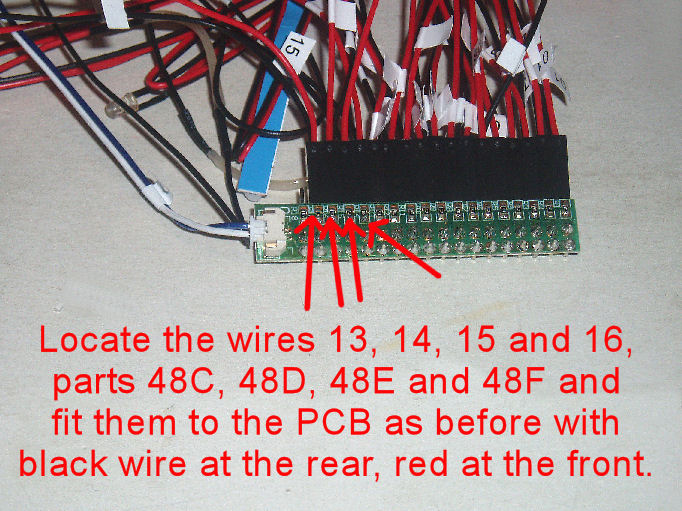

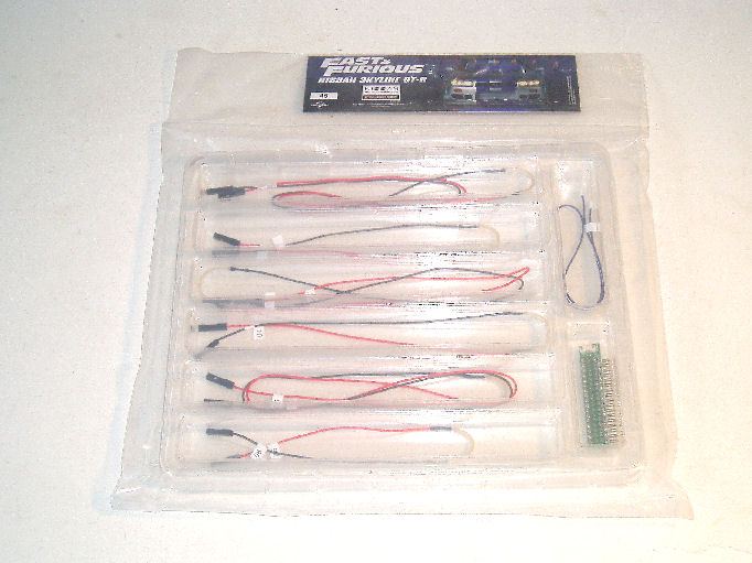

STAGE 48:

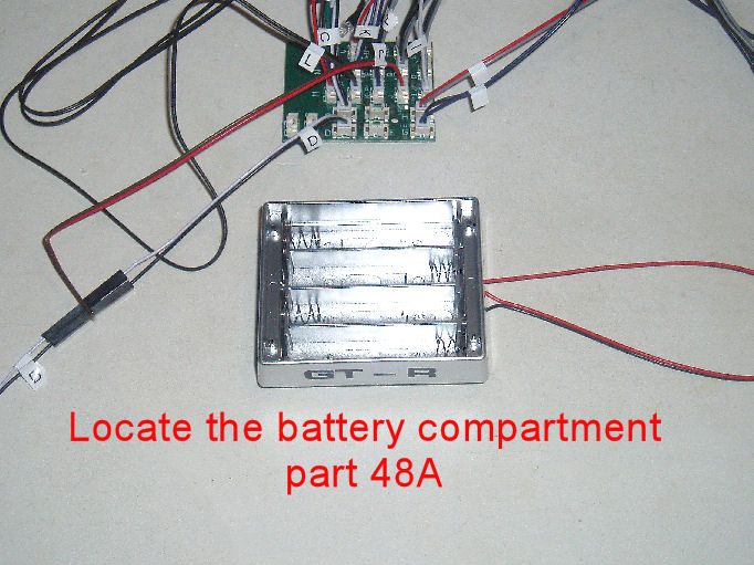

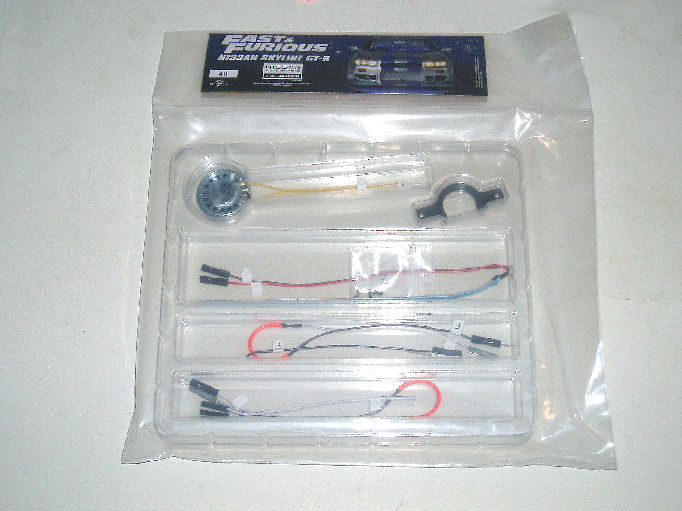

STAGE 49:
These parts are for further wiring to the PCB and testing the remote control unit.

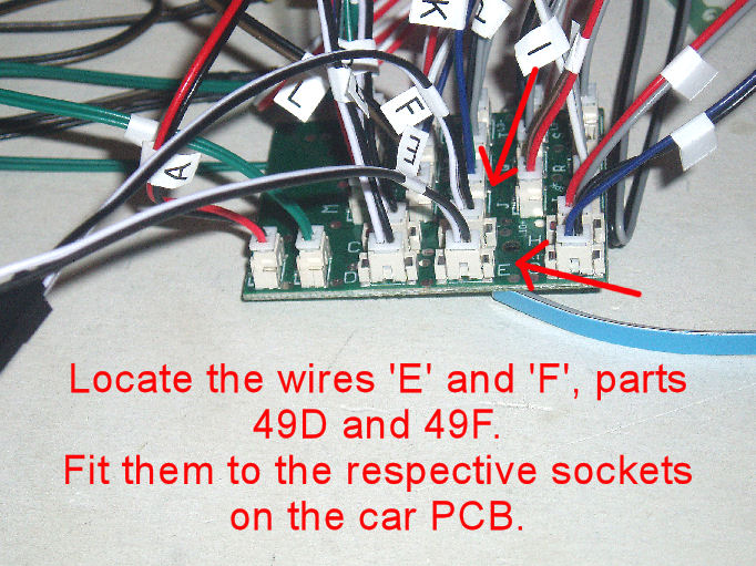

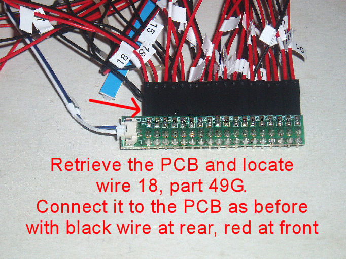

Retrieve the PCB assembly and locate the wire ‘18’, part 49G.
Fit this to the PCB as before with the black wire at the rear and the red wire at the front.

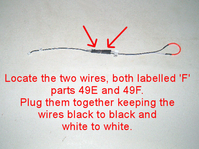

Locate the two wires labelled ‘F’, parts 49E and 49F.
Plug the wires together making sure they connect black to black and white to white.

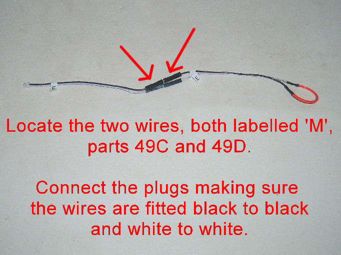

Locate the two wires labelled ‘E’, parts 49C and 49D.
Fit the wire ‘E’ into the corresponding socket on the PCB.
Fit the wire ‘F’ into the corresponding socket on the PCB.

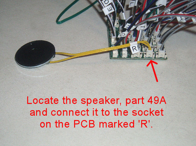

Locate the speaker, part 49A.
Fit the speaker plug marked ‘R’ to the corresponding terminal on the PCB.

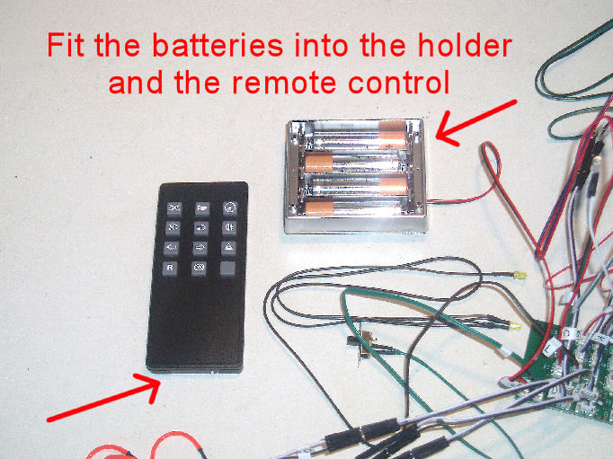

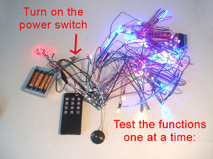

Fit 4 x AA batteries into the battery holder and a size 32 battery into the remote control.
Switch the power on using the switch attached to the PCB and starting at the top left of the remote control, test all of the buttons to make sure the functions work.
Use the printed images of the various functions (duplicated below) as a guide.
Remove the batteries after testing.

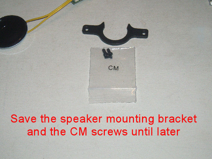

Store the parts and the speaker clamp until later.

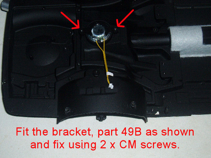

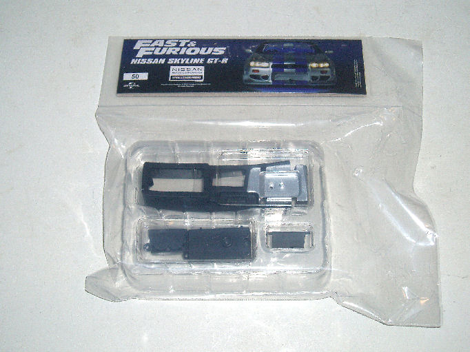

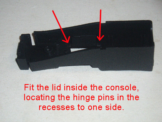

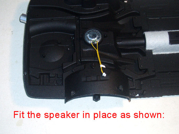

STAGE 50:

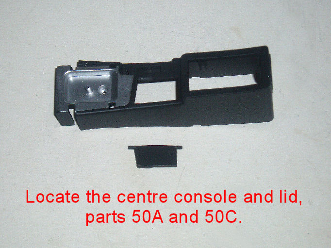

These parts are for assembling the centre console.

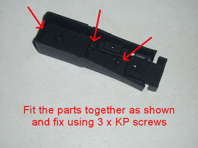

Locate the console and lid, parts 50A and 50C.
Turn the console upside down and fit the lid into the locations inside.
The lid will only fit one way.
Locate the inner console, part 50B and fit this inside the console, trapping the lid hinges in place.
Fix the parts together using 3 x KP screws.

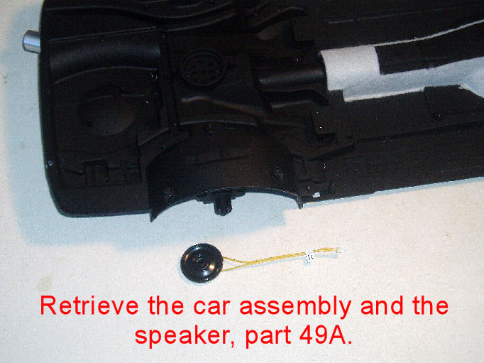

Retrieve the main PCB and disconnect the speaker, part 49A.
Retrieve the main car assembly and fit the speaker into the circular location between the rear wheel arches.
Retrieve the fixing bracket, part 49B and fix this in place over the speaker using the saved 2 x CM screws.
Store the parts safely for now.
