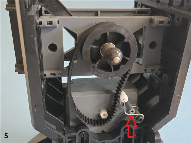

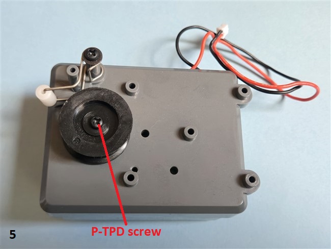

#1 Posted : 19 October 2024 15:05:59
Hi All, BigGrin
ET`s back on the table with the latest delivery, after someone decided to put a two month gap in the delivery schedule.Blink Confused

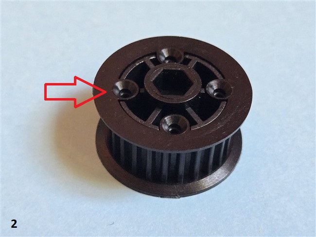

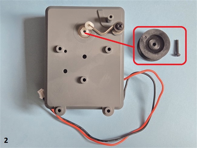

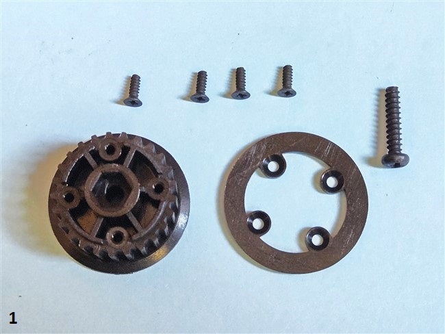

We start with Issue 39, where we carry on working on the neck mechanism.
Parts supplied.....Pic 1, you will also need the Servo-motor box from issue 29.

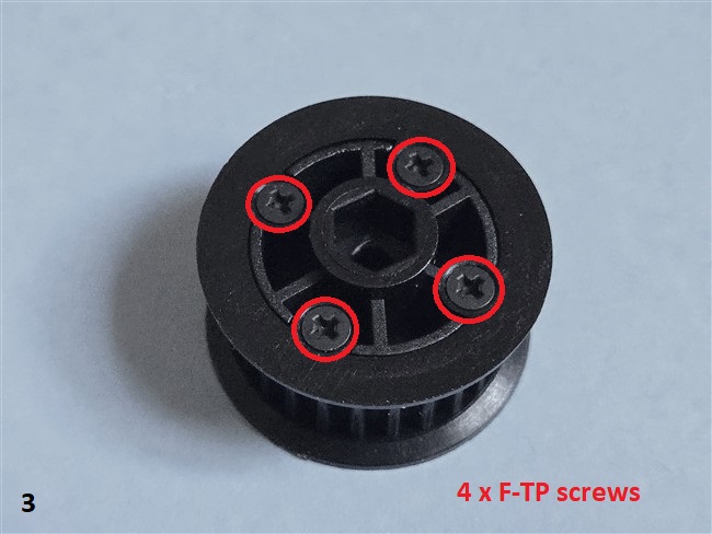

Start by placing the pulley ring 39-02 onto the pulley 39-01, Pic 2. Then fix the pulley parts together using 4 x F-TP screws as shown in Pic 3.

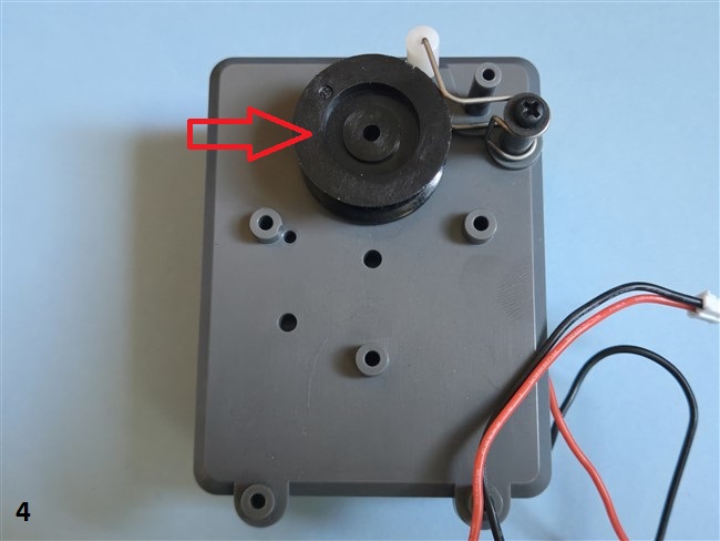

Retrieve the Servo-motor box from issue 29 and add the pulley to the hexagonal shaft on the same side as the belt tensioner. Pic 4. Note: At this point you fix the pulley in place using a P-TPD screw, Pic 5, but the first task in Issue 40 is to remove the screw and pulley. The choice is yours as to when you fit the pulley, but either way keep the parts/assembly safe until the next update.
That`s it for this update, Pic 6 gives a side view of the Servo-motor box with the pulley fitted.
(Derek) Admin

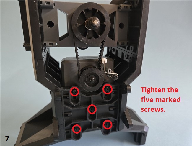

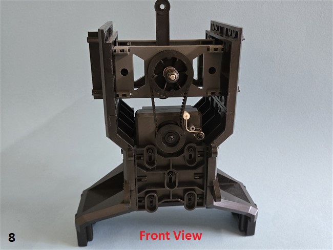

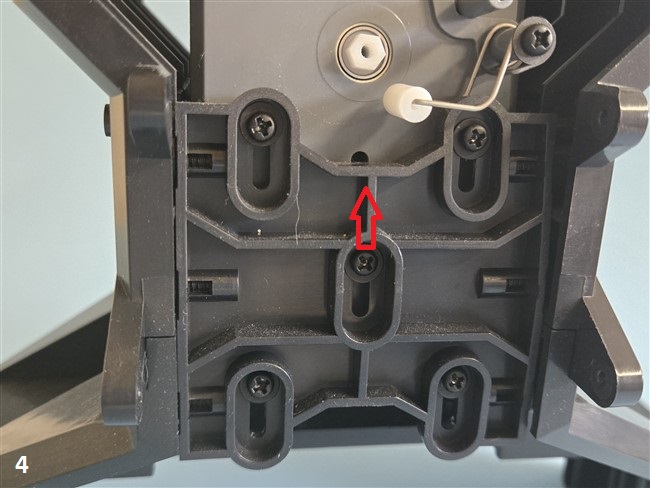

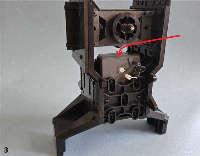

#2 Posted : 21 October 2024 19:02:10
Hi All, BigGrin

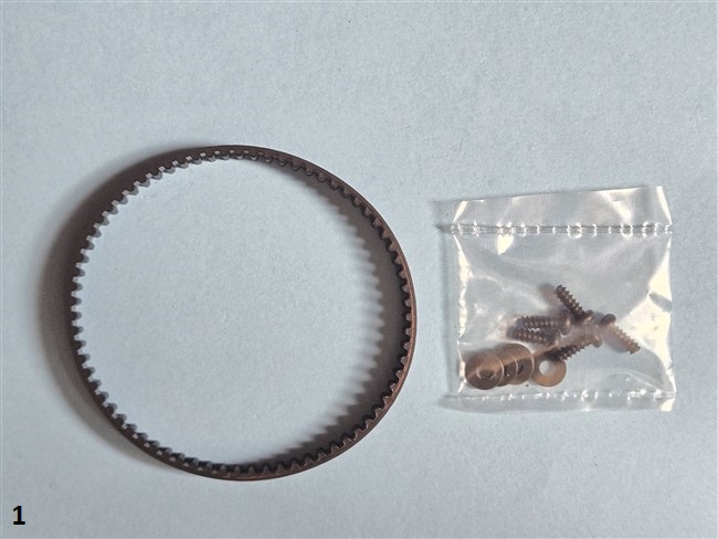

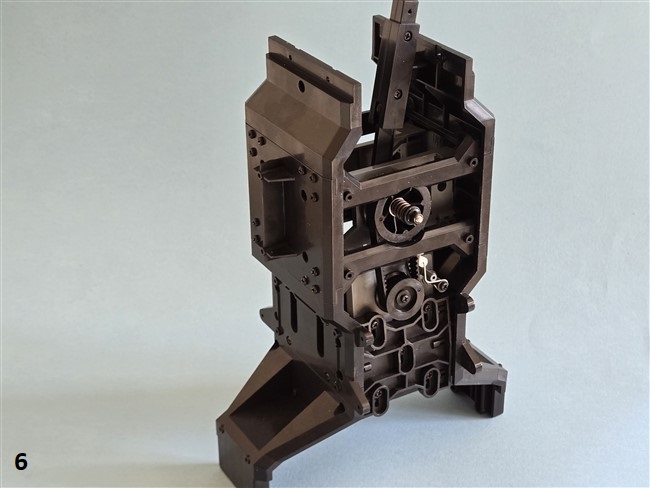

Time for the next ET update with issue 40. In this update we fit the neck servo-motor and the drive belt into ET`s body.
Parts supplied.....Pic 1, you will also need the servo-motor and pulley with screw if you did not fit it in issue 39. If you did fit the pulley in issue 39, then now is the time to remove it, Pic 2. I checked to see if the servo-motor would fit with the pulley still attached, but unfortunately not.
Feed the servo-motor into the body frame from the front side, lowering it into place, then fix its position using 5 x P-TP screws with a washer 40-02 on each, Pic 3. Note: the screws should be tight enough to hold the servo-motor in place , but allow it to slide up and down with a little resistance. Now move the servo-motor to its highest position as shown in Pic 4.

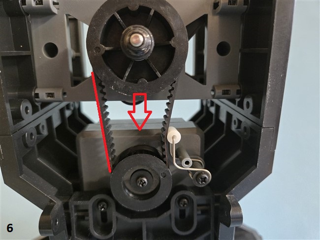

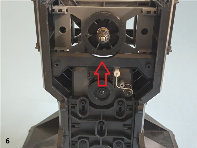

We now fit the drive belt over the top pulley, making sure that the belt tensioner is in the upward position as in Pic 5.
Its now time to refit the pulley to the servo-motor that we removed earlier. With the pulley reinstated, press the servo-motor down so that the left side of the belt (as you look at it) forms a straight line and the tensioner takes up the slack on the other side, Pic 6. Whilst holding the servo-motor in this position, tighten the 5 x P-TP screws as indicated in Pic 7.

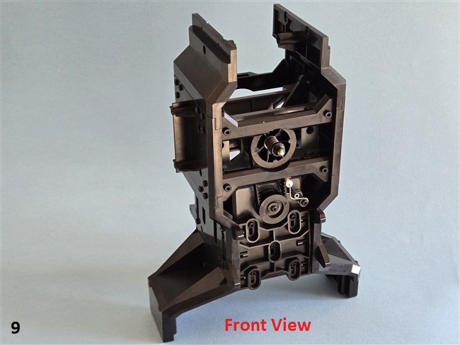

That`s all there is for this update, Pic 8 and 9 show the front and rear of the body frame as it should be now. See you soon for issue 41.
(Derek) Admin

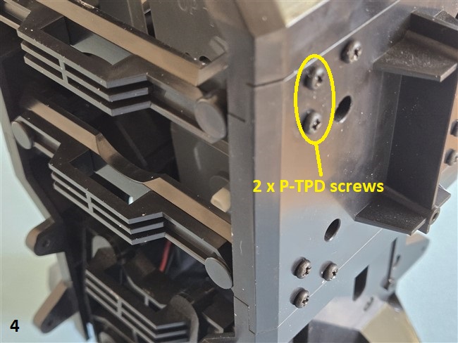

#3 Posted : 25 October 2024 14:47:53
Hi All, BigGrin
The next ET update is here with issue 41. In this update we add a front and rear support for the main body section of ET.
Parts supplied.....Pic 1, you will also need the main body section of ET that we last worked on in issue 40.

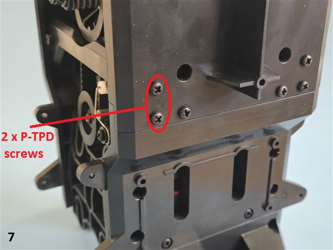

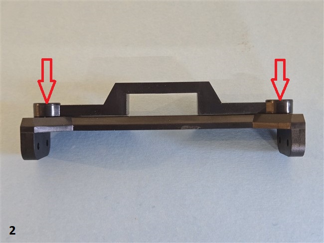

We start on the rear support, which also has a cable guide attached. Press the cable guide 41-02 onto either of the supports 41-01, Pic 2. Now position the parts in the rear of the body as shown in Pic 3, then fix it in place using 4 x P-TPD screws (two each side) as in Pics 4 and 5.
Take the second part 41-01 and position it in the front of the body as in Pic 6. This is also fixed in place using 4 x P-TPD screws (two on each side), shown in Pics 7 and 8.
That`s all for this update, issue 42 coming soon.
(Derek) Admin

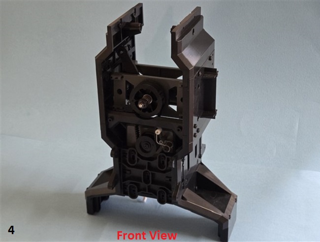

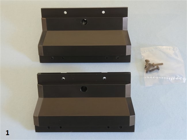

#4 Posted : 27 October 2024 12:06:40
Hi All, BigGrin

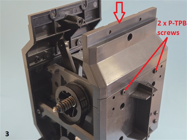

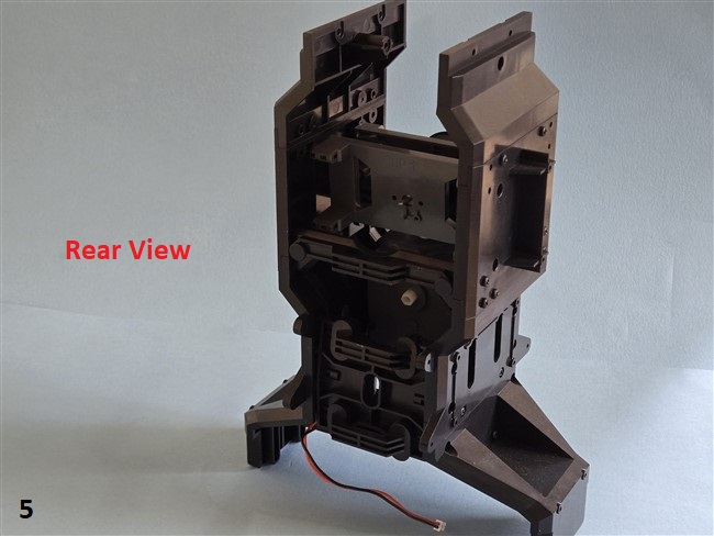

ET`s next update for issue 42 is here. In this update we will extend the main body section.
Parts supplied.....Pic 1. You will also need the main body section, last worked on in issue 41. The two upper chest side frames (42-01) are identical, so it does not matter which way round you fit them.

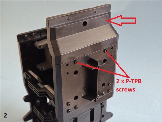

Fit one of the frames 42-01 to the main body and fix it in place using 2 x P-TPB screws, as shown in Pic 2. Repeat this operation to fit the second side frame, fixing it with another 2 x P-TPB screws, Pic 3.
That`s all for this update, Pics 4 and 5 show the front and rear of the main body section.
(Derek) Admin

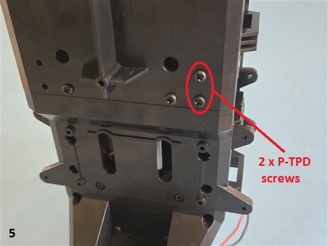

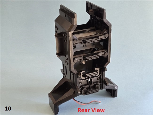

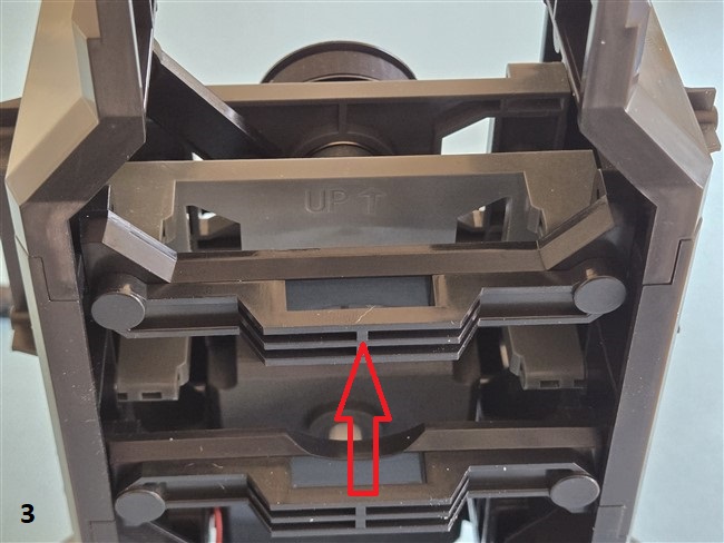

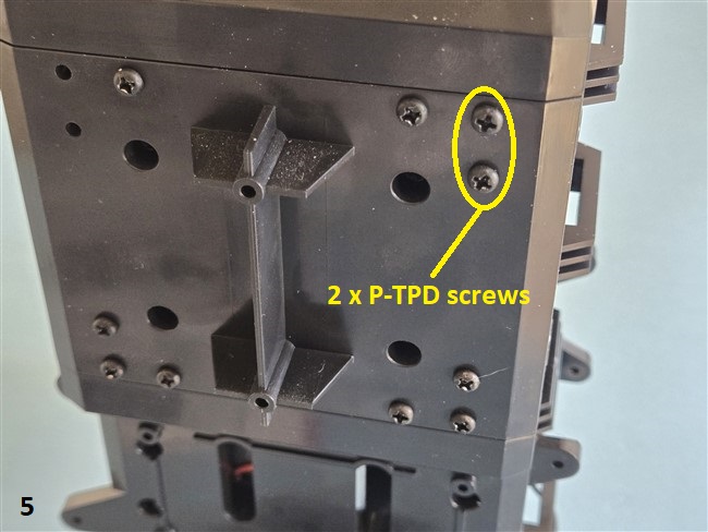

#5 Posted : 30 October 2024 12:12:57
Hi All, BigGrin

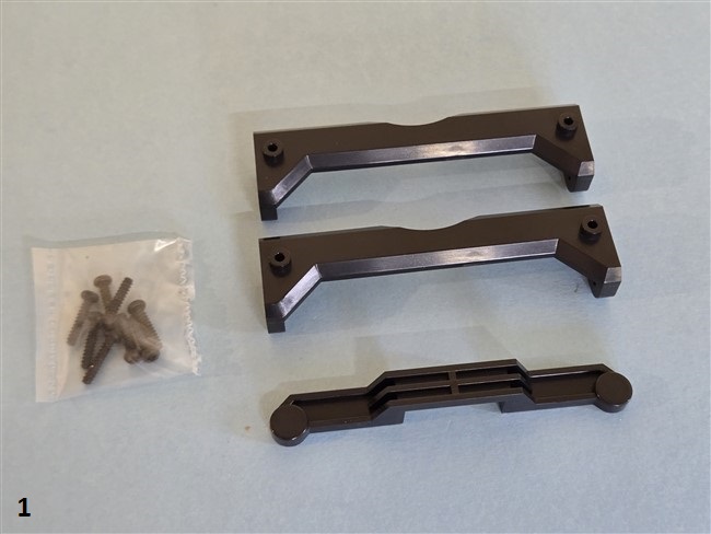

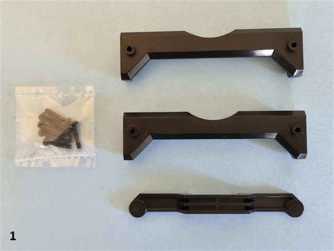

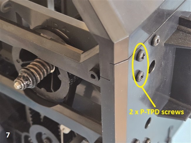

This is the update for Issue 43 of ET. Having extended the height of ET`s body frame in issue 42, we now add some more support bars.
Parts supplied.....Pic 1, you will also need the main body section, last worked on in issue 42.

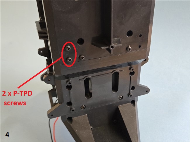

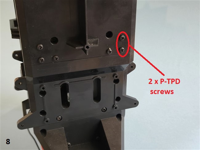

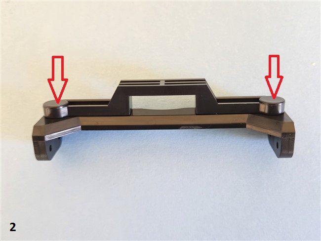

Start by adding the cable guide 43-02 to either of the support bars 43-01, shown in Pic 2. This assembly is then positioned into the rear of ET`s body, Pic 3 and fixed in place using 2 x P-TPD screws on each side, as shown in Pics 4 and 5.
Now add the remaining support bar 43-01 to the front of the body, Pic 6. This part is also fixed in place using 2 x P-TPD screws, as shown in Pics 7 and 8.
That`s all for this update, with Pics 9 and 10 showing how the body now looks.
Issue 44, the last in this pack is coming soon.ThumpUp
(Derek) Admin

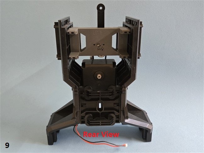

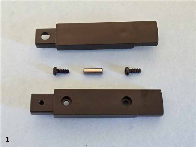

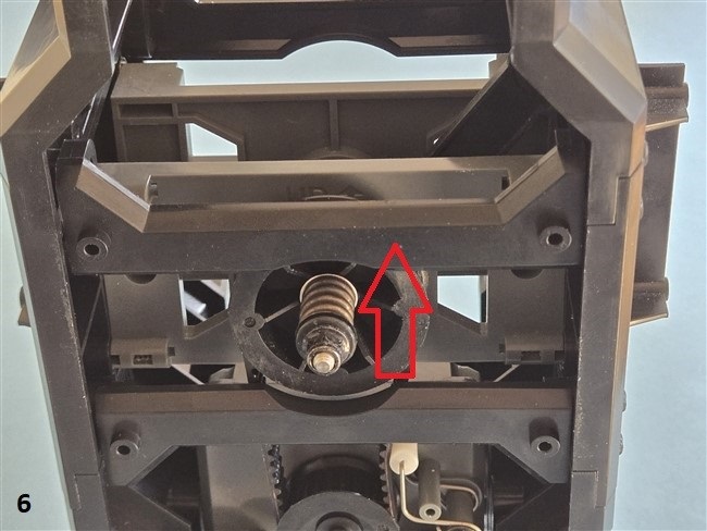

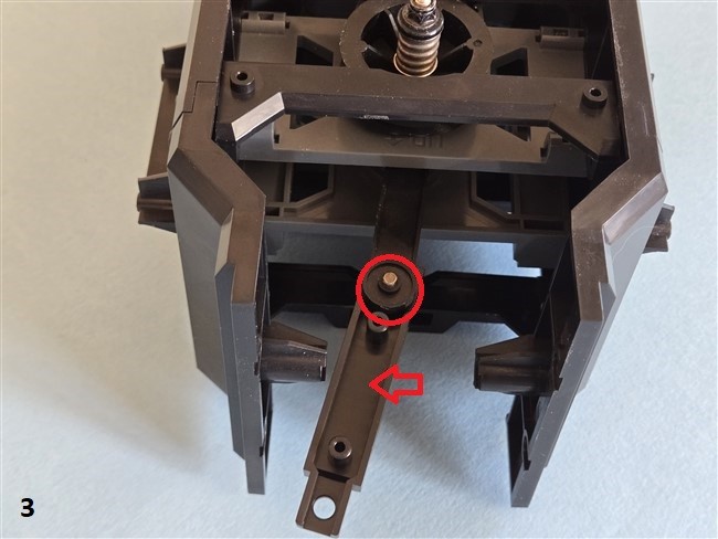

#6 Posted : 01 November 2024 12:22:25
Hi All, BigGrin
Well its time for the last update of this pack, with issue 44. In this update we extend the neck connection.
Parts supplied.....Pic 1. You will also need the main body section, last worked on in issue 43.

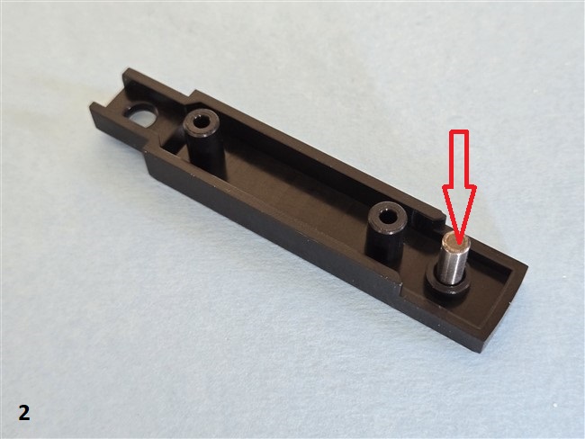

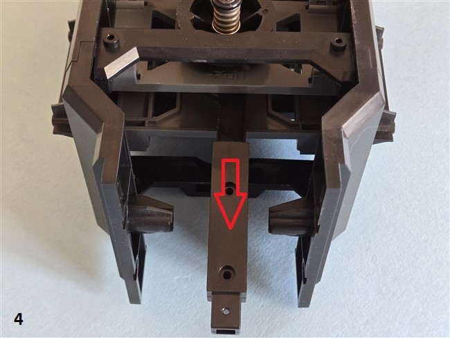

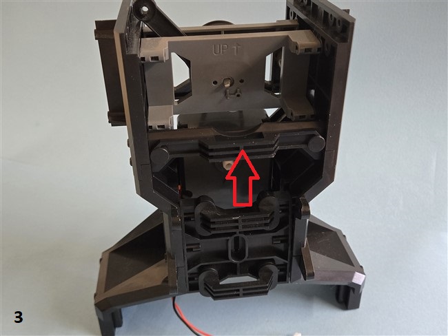

Place the connecting shaft 44-03 into position in the rear neck connector 44-02 as shown in Pic 2.

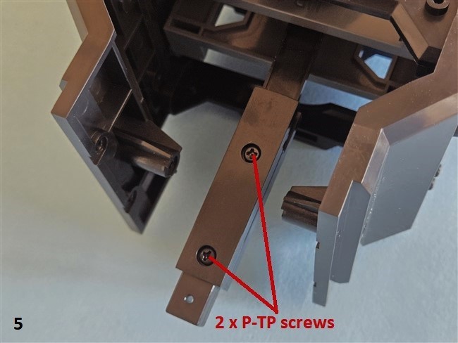

Put the main body of ET on its back face and add the rear neck connector with the shaft as indicated in Pic 3. Now place the front neck connector 44-01 into position, Pic 4 and secure the parts using 2 x P-TP screws, Pic 5.
That`s it for this update, Pic 6. I`ll see you all soon, when the next delivery arrives. ThumpUp
(Derek) Admin
