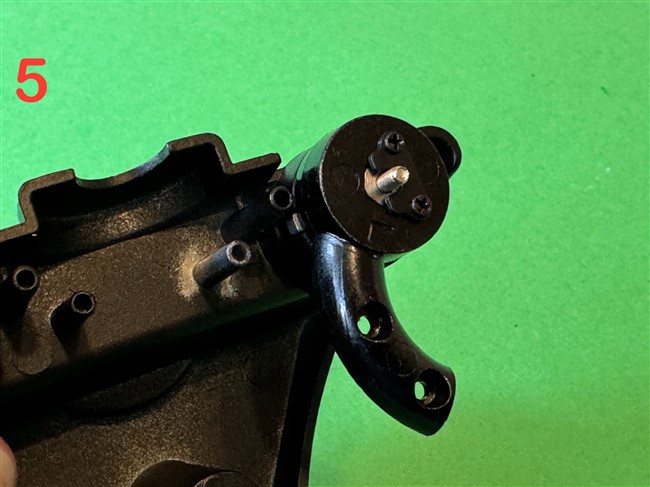

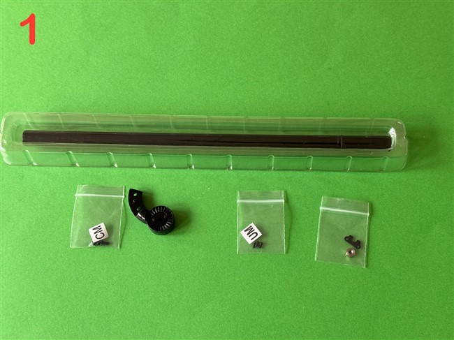

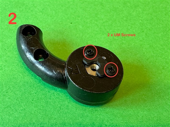

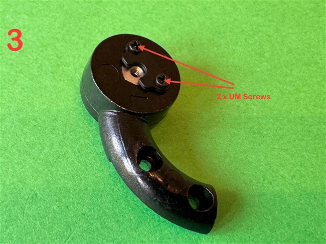

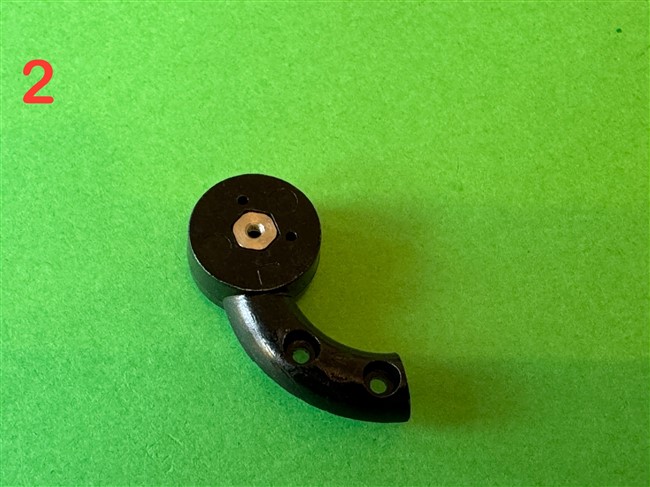

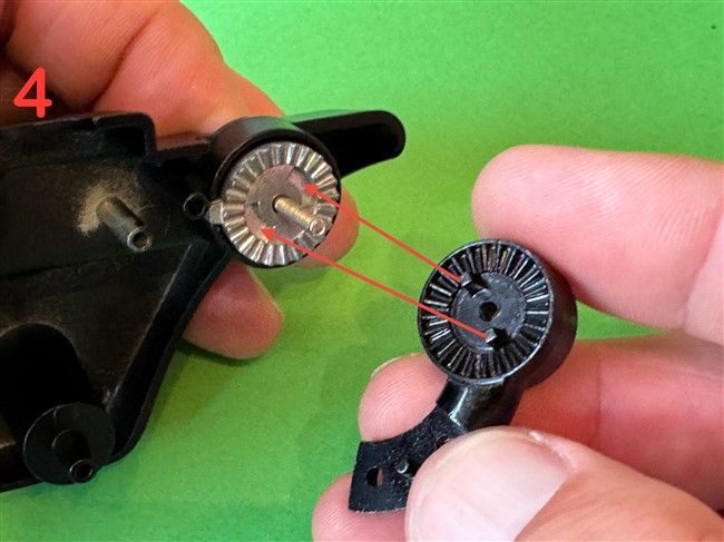

Place the nut (47A) into the hexagonal socket in the left hip (47C), picture 2. Secure the hip bracket (47B) with 2 x UM screws, picture 3.

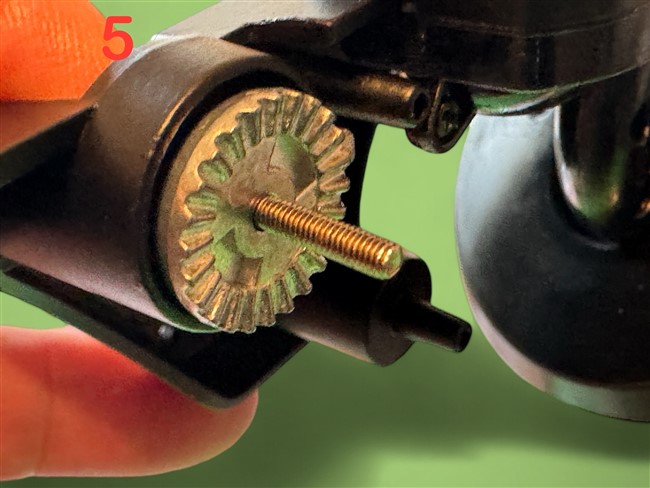

Connect the left hip to the ridged face of the left hip washer you partly assembled in the last issue, picture 4, and tighten the screw as shown in picture 5.

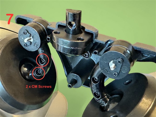

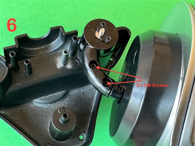

Now take the left leg assembly and connect the flat face of the left hip to the flat face of the ball joint, securing it with 2 x CM screws, picture 6.
Picture 7 shows the complete assembly for this issue.

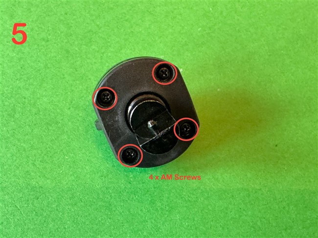

Issue 48
The Pelvis

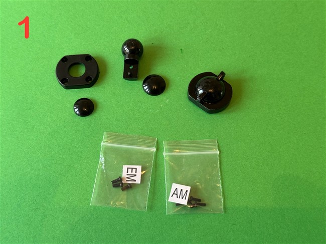

Before we start, please note that the magazine states that you have FM screws, you will note that the screws supplied for assembly are EM screws not FM as stated.

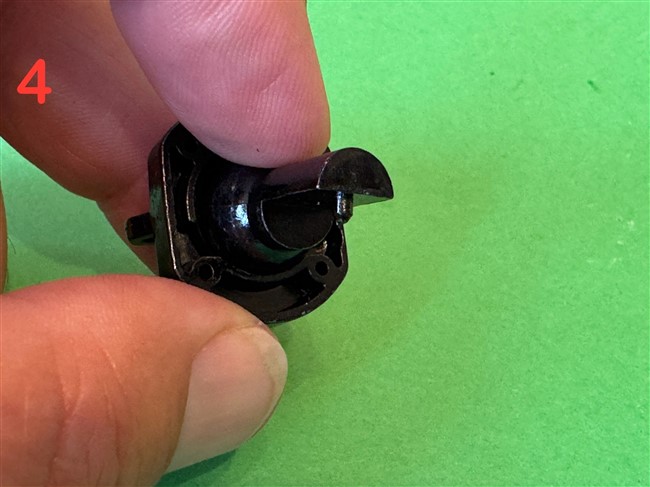

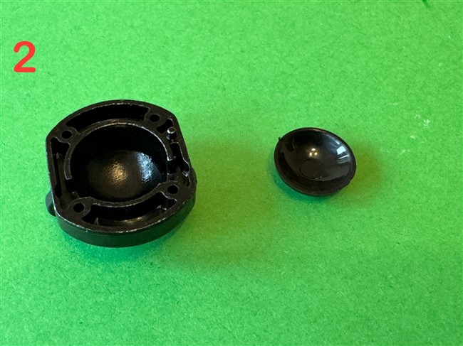

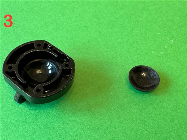

Take the recess of the lower lumbar joint support (48B) and place the larger friction pad inside followed by the smaller friction pad, pictures 2 and 3. Place the lower lumbar joint (48A) into the recess of the support, picture 4. Attach the lower lumbar support 2 (48C) using 4 x AM screws, picture 5.

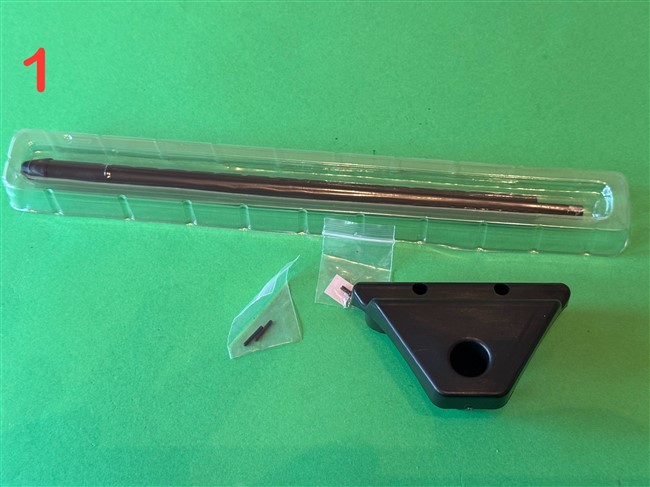

Retrieve the assembly from the last issue and secure this assembly in the centre of the upper profile of the pelvis, securing it using 2 x EM screws, picture 6.

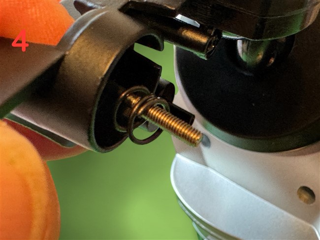

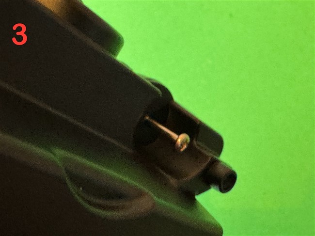

The Pelvis

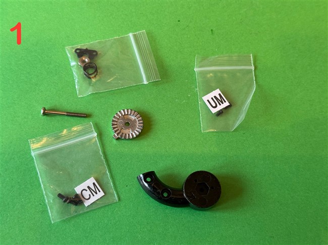

Place the nut (49F) into the hexagonal socket in the right hip (49C) and secure the hip bracket (49B) with 2 x UM screws, picture 2.
Insert the right hip screw (49E) into the upper right hole at the rear of the pelvis, picture 3.
Place the spring (49D) onto the screw as shown in picture 4. Place the right hip washer (49A) into the back of the pelvis, picture 5.
Connect the right hip to the ridged face of the right hip washer, and tighten the screw as shown in picture 6.
Now take the right leg assembly and connect the flat face of the right hip to the flat face of the ball joint, securing it with 2 x CM screws, picture 7.
Make sure the legs close and move out slightly, adjusting the hip screws if necessary. Once adjusted apply a little quick drying glue on the ends of the screws of the hip joints.

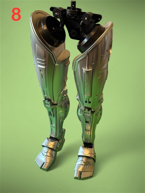

Picture 8 shows the complete assembly for this issue.

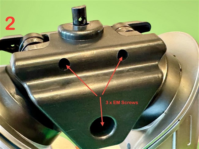

Issue 50
The Pelvis

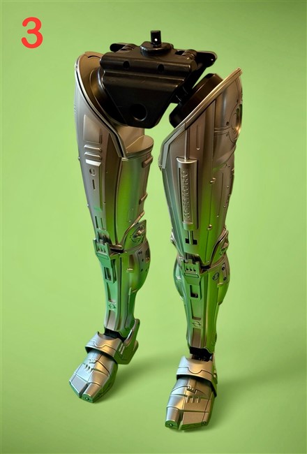

Retrieve the assembly from the previous issue and place the front part of the pelvis over the hips using 3 x EM screws, picture 2.
Picture 3 shows the complete assembly for this issue.
