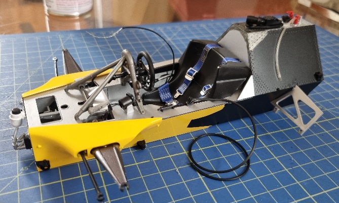

I've made a start. Front suspension and steering

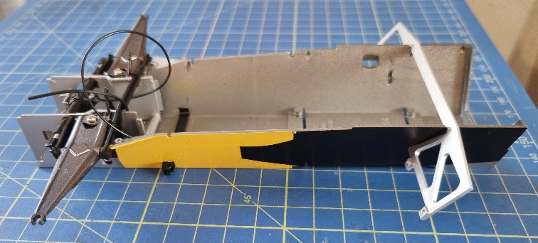

Front suspension mounted to the lower monocoque.

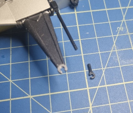

Steering arm broken. Any suggestions on how to fix it?

A little dot of poly cement and put the parts together again laying on a flat surface.
Once dry it should be fine.
I've done it before and it works.

I've tried that twice and it doesn't seem to be strong enough. I was using tamiya cement. Would some ca instant be better?

I think the best course of action for a solid repair would be to obtain a short length of metal rod such as brass or similar, drill a hole of the same diameter as the rod in the end of each half of the steering link then insert and glue the rod to connect the two halves using a good strong glue such as a two part '5 minute' epoxy? Clean the area around the joint with some white spirit or similar to remove excess glue BEFORE it dries, and then leave well alone until set. A bit of touch-up painting around the joint and no-one will ever know it was repaired?!
Glue alone will always give a weak joint, it's always best to glue AND pin in my experience. I had this kit years ago and it's a nice model when finished, so keep going and I'll look forward to following your build with interest!
Hope that helps?
Kev

Cheers Kev. I have used a bit of ca and it seems to be holding🤞. Tbf, this build is more about learning as I've said before, I have only done partworks before so this is much more of a challenge

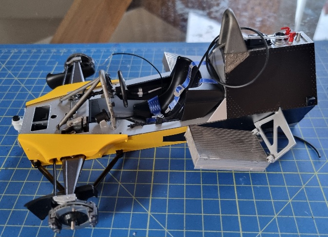

Build update: A lot more done now👍

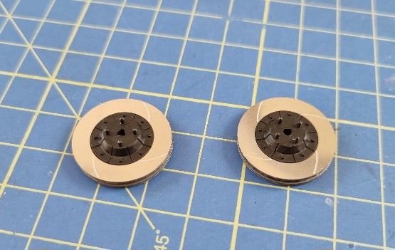

Front brake discs
Steve279021 attached the following image(s):

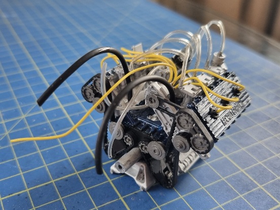

Update: Engine progress

#18 Posted : 27 September 2024 17:13:44
Posts: 5,183
Points: 15,698
This is all looking very impressive.
Keep the updates coming...Love
#19 Posted : 29 September 2024 22:13:04
Looking really good Steve, very nice work so far! Keep those updates coming! Cool ThumpUp
Kev

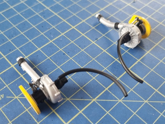

Cheers guys. Small update:
Turbos
