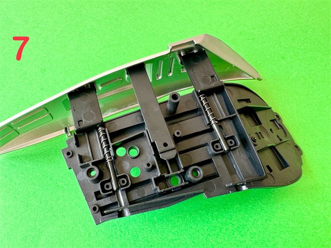

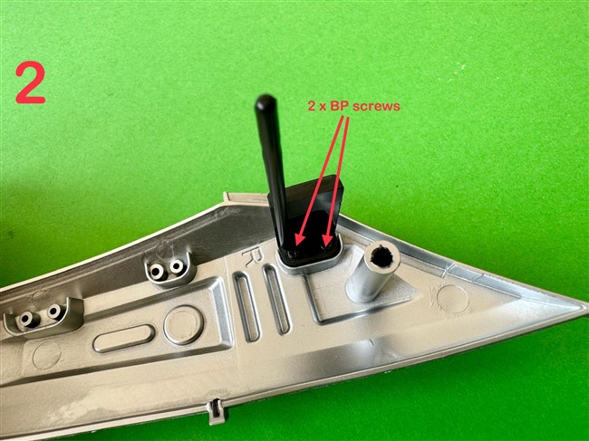

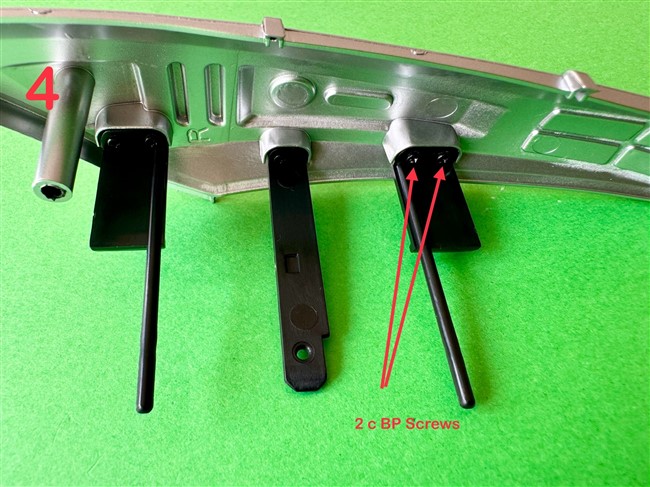

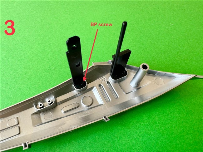

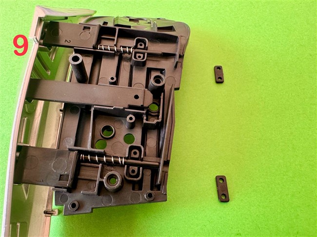

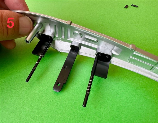

Place the upper rear rail (43B) on the inside face of the cover (43A), picture 2 and secure with 2 x BP screws. Do the same with the middle rail (43C) securing it with a BP screws, picture 3, and lastly the lower rail, picture 4. Push the springs (43E) onto the upper and lower rails as shown in picture 5.

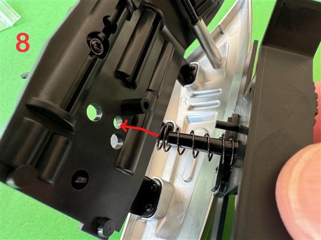

Take the final assembly from issue 42, picture 6 and connect it to this assembly as shown in the two pictures, 7 and 8.

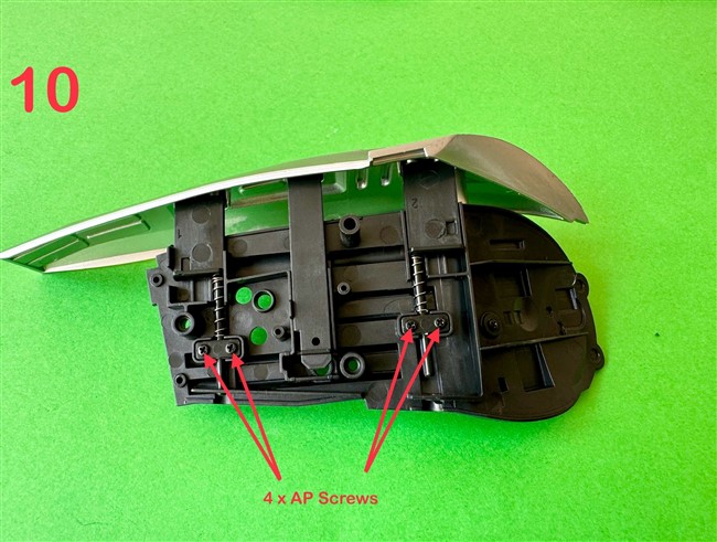

Place the two covers, (43F) and secure them in place using 4 x AP screws, pictures 9 and 10.

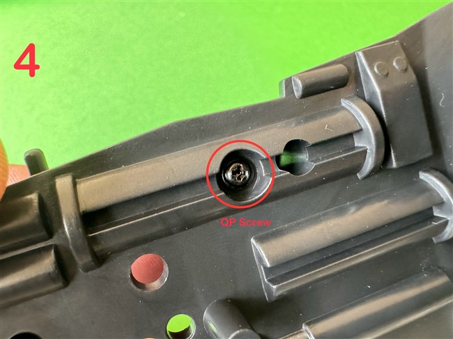

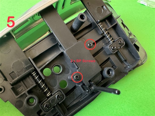

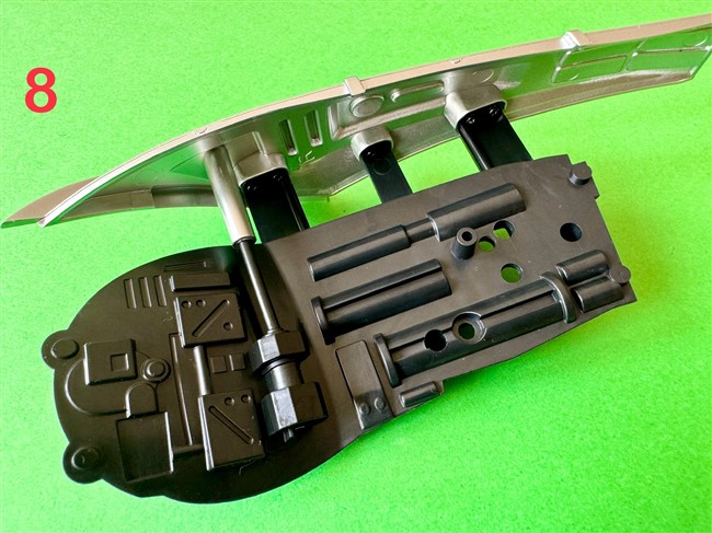

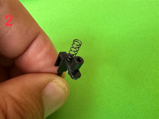

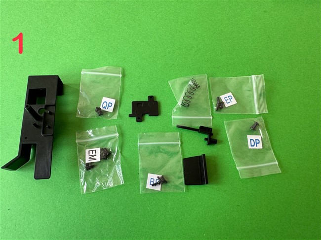

Push the spring (44F) onto the pin on the right thigh release button, picture 2. Take the assembly from issue 43 and place this assembly as shown in picture 3, making sure the thigh cover is in the out position. Turn the assembly over and secure with an QP screw, picture 4. Place the rear middle rail bracket (44D) over the rear middle rail and secure it with 2 x BP screws, picture 5.

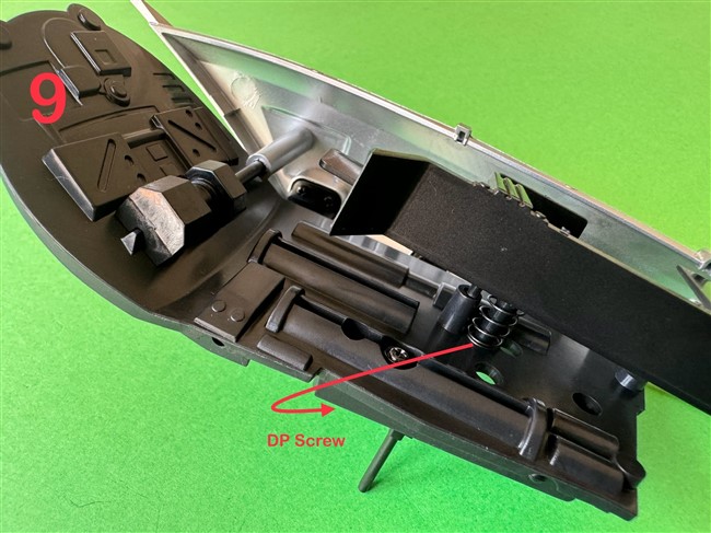

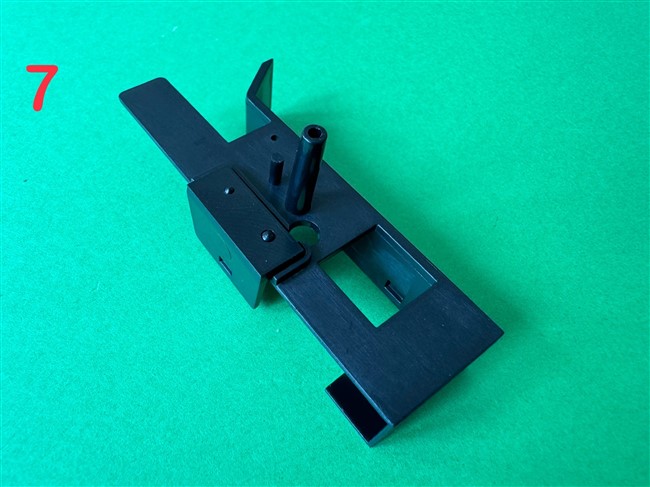

Take the gun holder part (44B) and push fit it onto the gun holder (44A), picture 6 and 7. Place the spring over the long pin on the gun holder, picture 8, and push the assembly to the back of the compartment pushing the long pin with the spring through the hole as shown in picture 8. Turn the assembly over and secure with a DP screw, picture 9.

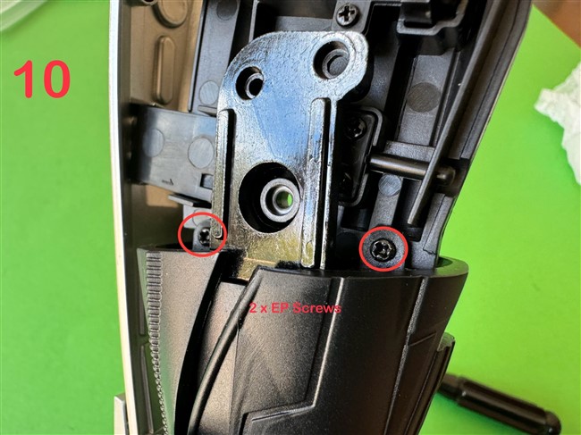

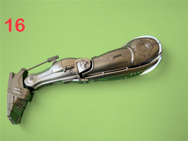

Take the calf assembly from issue 35 and connect both assemblies by fitting the thick pin on the rear face of 42A into the hole in the top of the knee, and secure both with 2 x EP screws, picture 10.

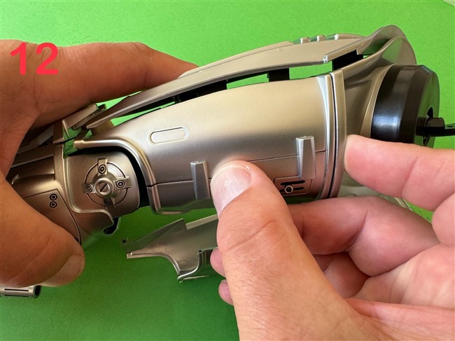

Retrieve the right inner thigh assembly from issue 38 and connect the two assemblies as shown in pictures 11 and 12. Make sure the release button rod passes through the hole in the inner thigh plate.

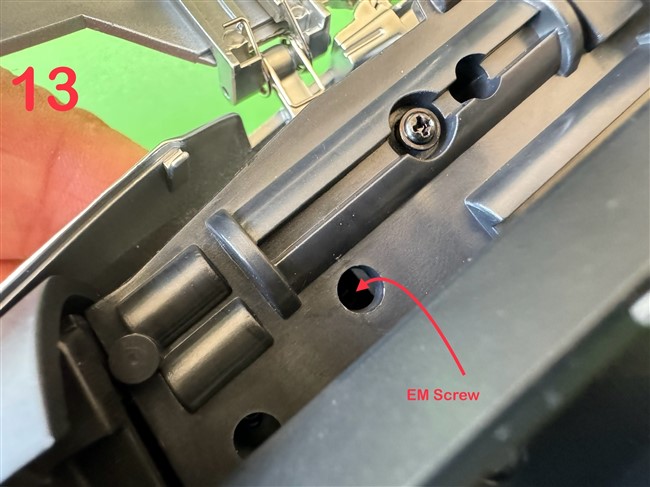

Fix the part together with an EM screw, picture 13.

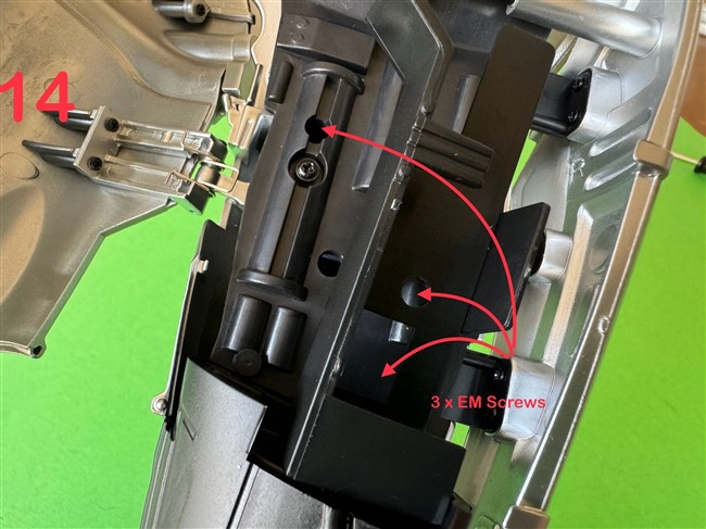

Note: You will need a magnetic screwdriver, and carefully place the screw through the hole shown to access the thread to secure the part. The next step will be the same with the next 3 EM screws as shown in picture 14.

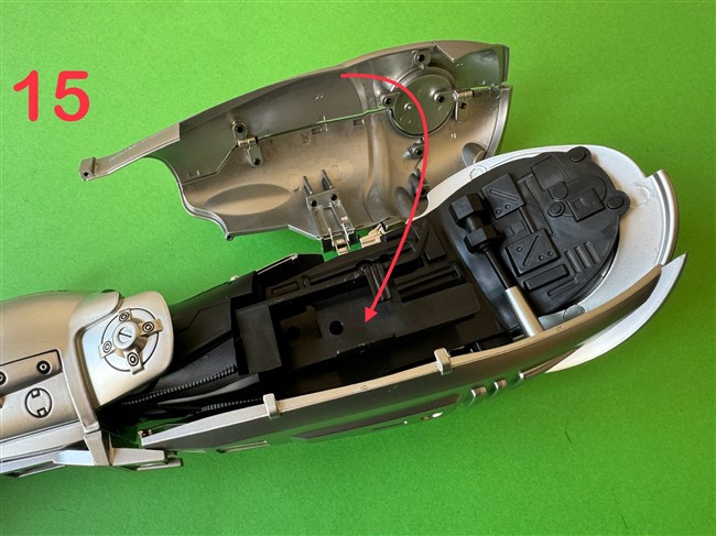

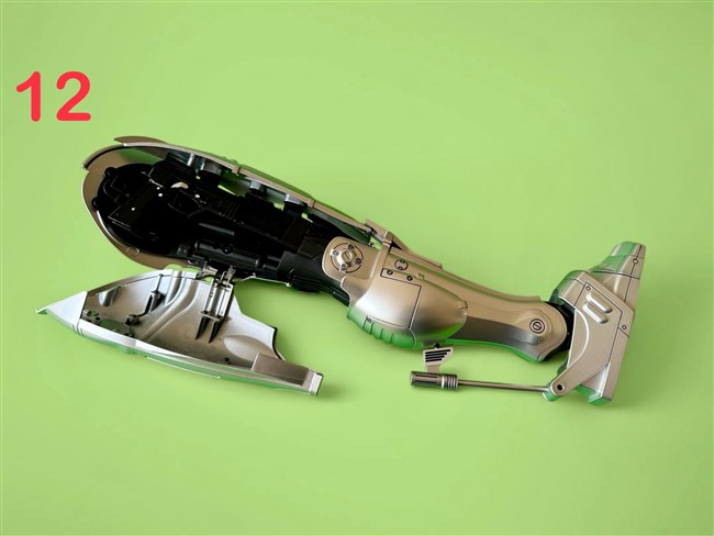

The assembly is now complete. To close the outer thigh, push it over the inner section and then holding it in position, push the front cover (43A) until it clicks into place and locks the assembly, picture 15. To open the assembly again, push the release button (44D) to release the front cover and allowing the outer thigh to fold back.
Picture 16 shows the complete assembly for this issue.

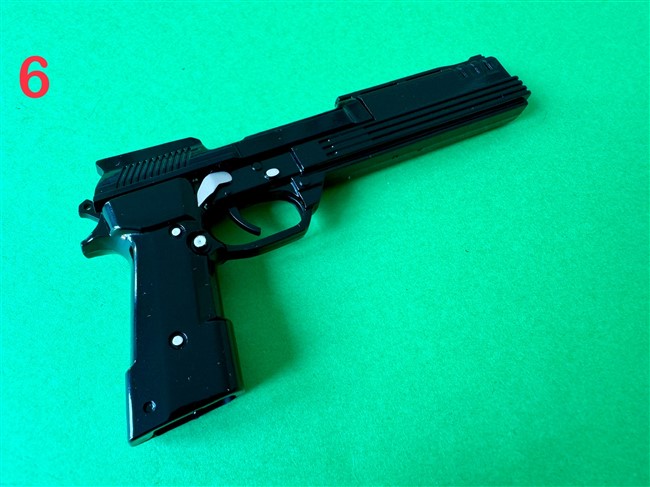

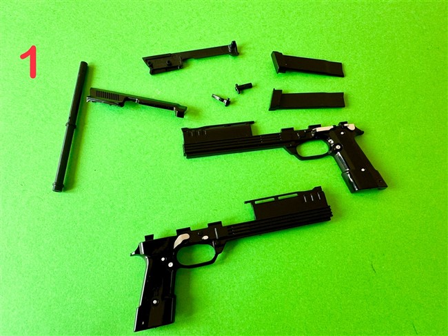

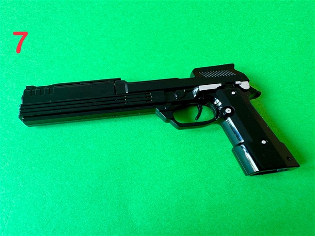

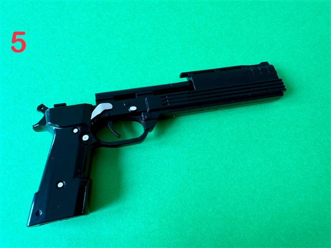

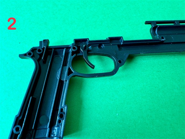

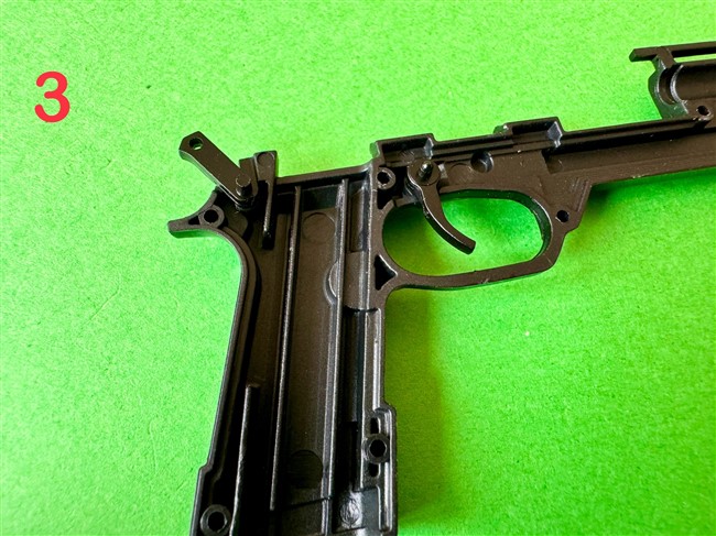

Place the trigger (45F) into the left side of the pistol (45A), picture 2. Place the slide stop (45I) into the left side pistol, picture 3. Now place in the barrel (45E), picture 4 and then fit the right side of the pistol (45B) onto the left side assembly, picture 5. Fit the right slide (45D) over the barrel and do the same with the left side (45C) and push fit together, pictures 6 and 7.

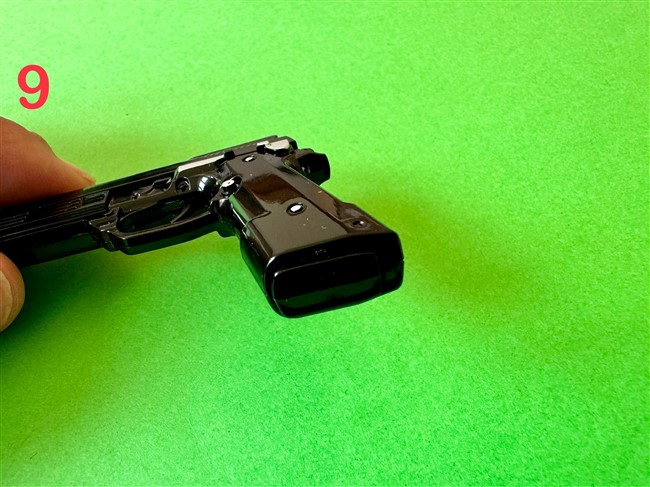

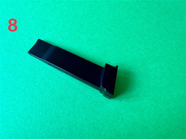

Join the magazine parts (45G and 45H) together, picture 8. Place the assembly into the bottom of the handle grip of the pistol, picture 9.

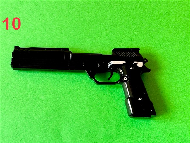

Picture 10 shows the complete assembly for this issue.

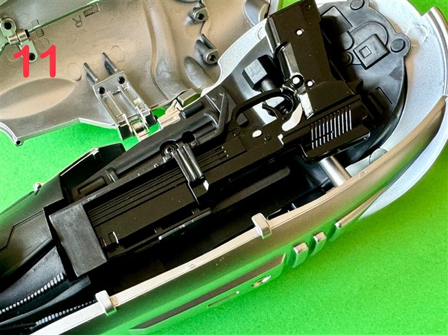

The last pictures 11 and 12, show the pistol in place inside the leg assembly.

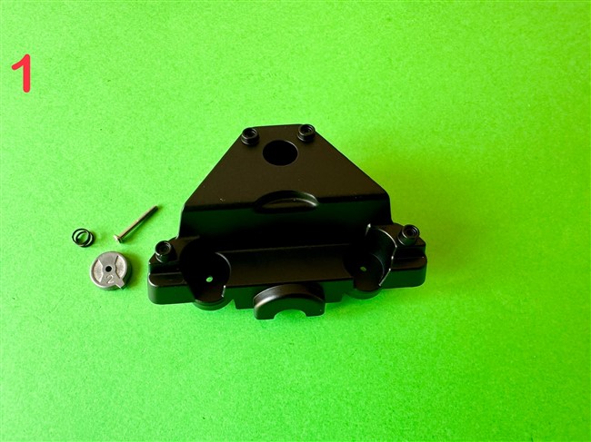

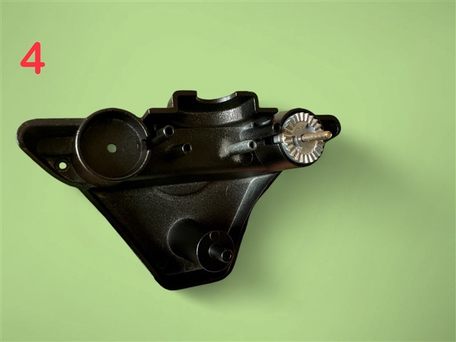

Insert the left hip screw (46D) into the upper left hole at the rear of the pelvis (46A), picture 2.
Place the spring (46C) onto the screw as shown in picture 3. Place the left hip washer (46B) into the back of the pelvis.
Picture 4 shows the complete assembly for this issue.
