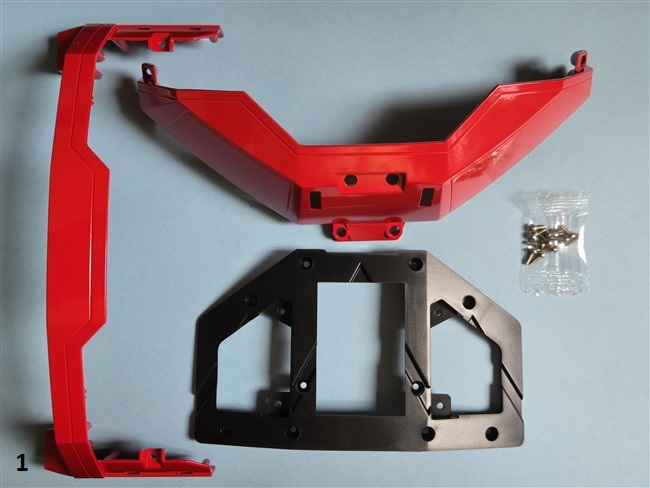

Issue 1 takes us in gently to the assembly of Megazord, where we start the construction of the Chest Shield.
Parts supplied.....Pic 1. If you don`t have a screwdriver to hand, there is one supplied with the parts in Issue 2. Blink

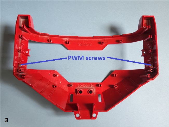

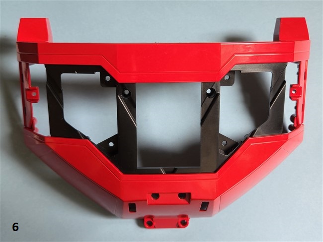

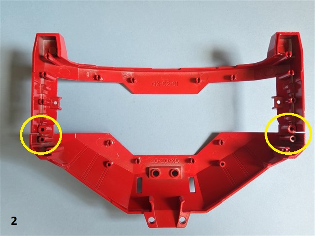

To start take the Upper/Lower chest shield parts 1.1 and 1.2. The ends of these parts interlock as shown in Pic 2, they are then secured together using 2 x PWM screws, Pic 3.

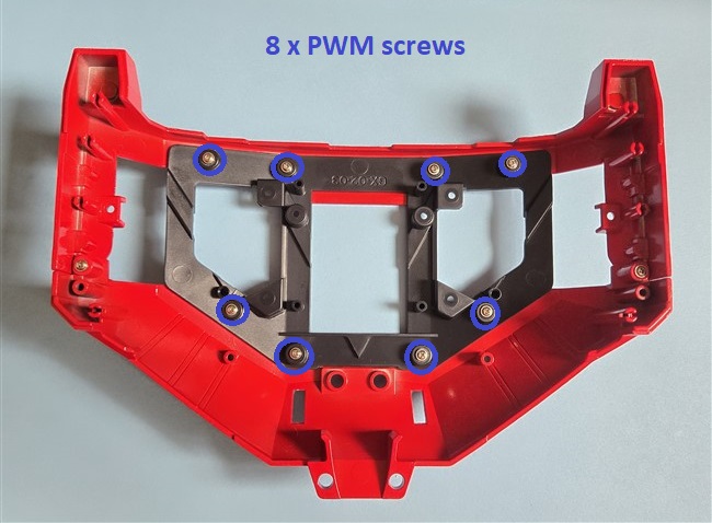

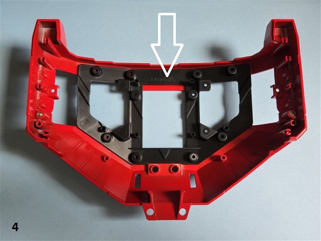

Keep the assembled parts in the same position and add the Internal Structure 1.3 as shown in Pic 4. Now fix the Internal Structure using 8 x PWM screws, Pic 5.

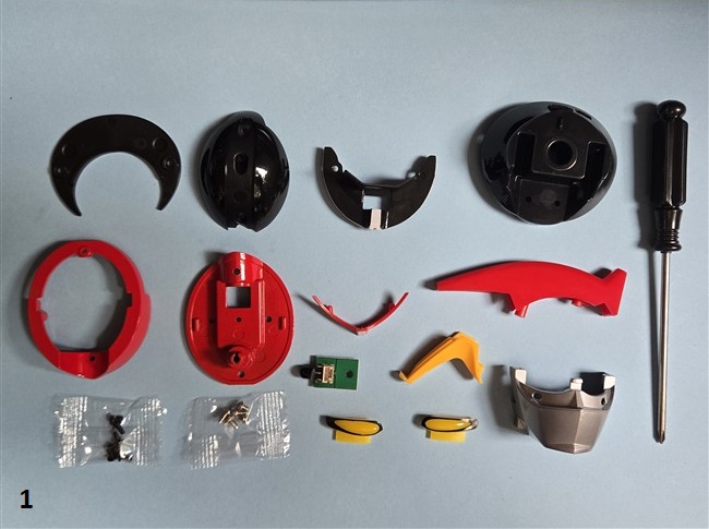

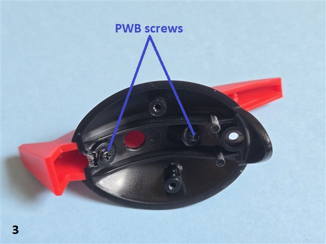

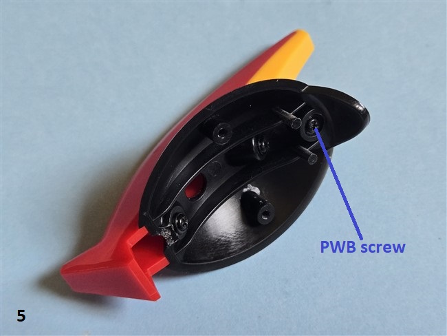

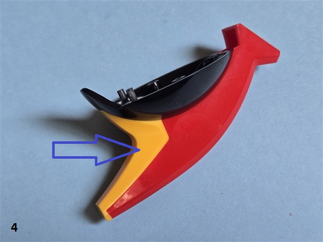

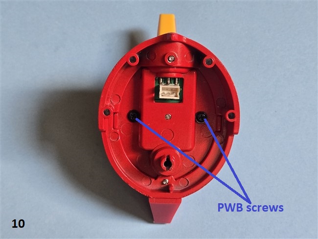

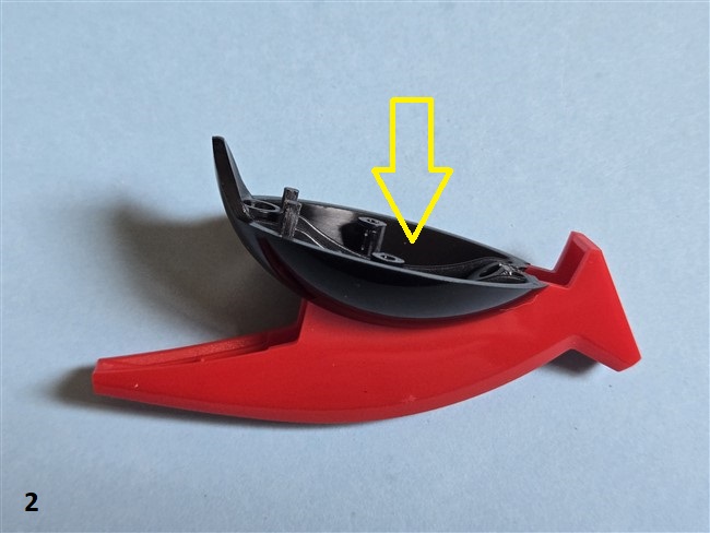

Start with the Helemet top 2.7 and the Helmet crest 1 2.10. Position the parts as shown in Pic 2 and fix the parts using 2 x PWB screws, Pic 3. Then add the Helmet crest 2 (2.11) to the assembly, Pic 4 and fix that part using another PWB screw as shown in Pic 5.

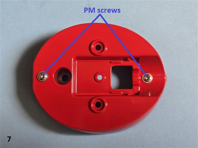

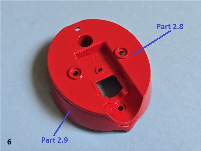

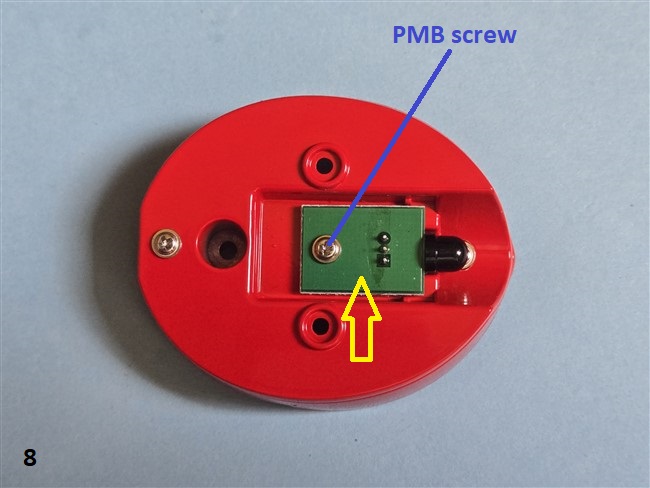

Next take the parts that make up the bottom of the Helmet, 2.8 and 2.9 . Position them as in Pic 6 and fix them using 2 x PM screws, Pic 7. Now position the led circuit board 2.17 into the helmet base and fix it in place using a PMB screw, Pic 8. Fit the top/bottom assemblies of the helmet together, Pic 9 and secure them together using 2 x PWB screws, Pic 10.

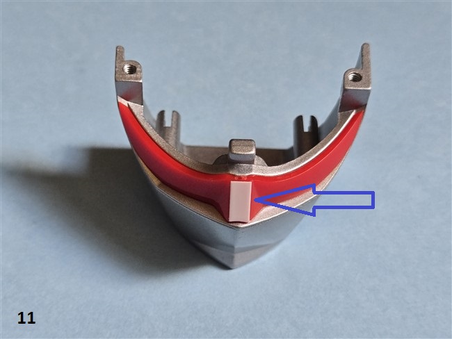

Finally, press fit the mask 2.1 and the mask upper rim 2.2 together, Pic 11.

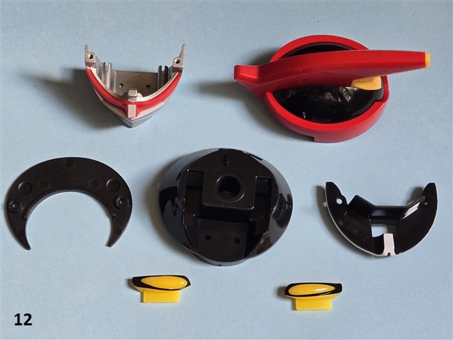

That`s it for this update and pack 1 as in Pic 12, safely store the assemblies and any unused parts till later.
