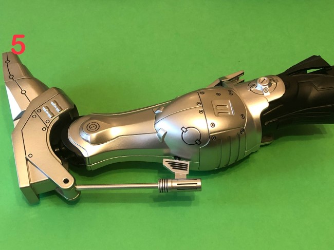

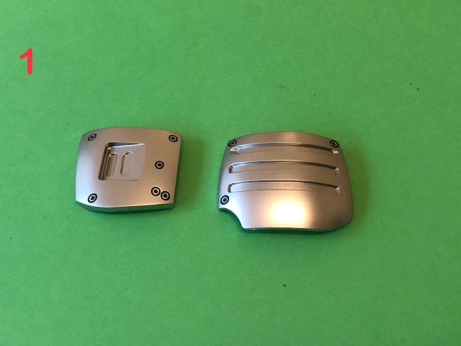

The Right Lower leg

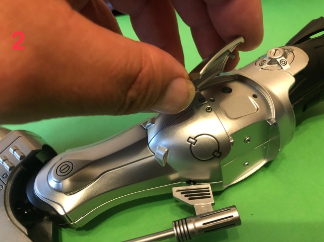

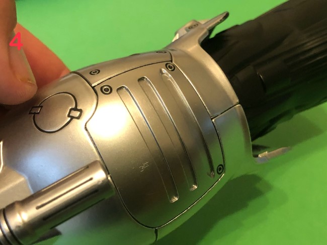

Take the assembly from issue 34 and attach (35B), the right inner knee plate, as shown in pictures 2 and 3.
Next, attach (35A), the calf plate, into position, picture 4.
Picture 5 shows the complete assembly for this issue.

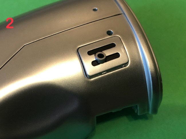

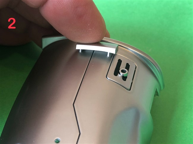

The Right Thigh

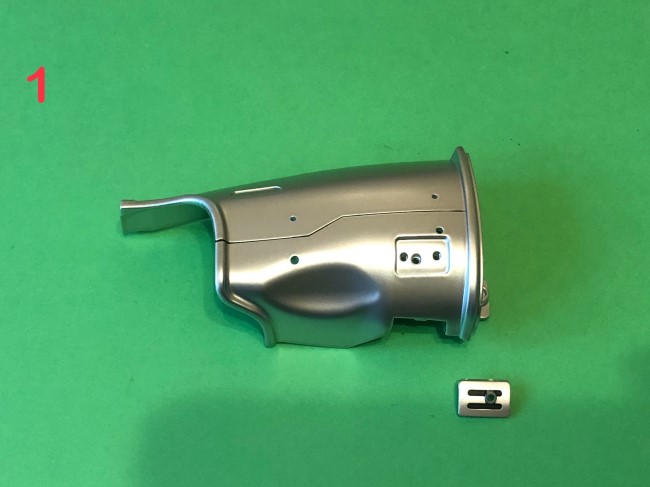

Attach the detail (36B) to the right inner thigh (36A) as shown in picture 2.
Picture 3 shows the complete assembly for this issue.

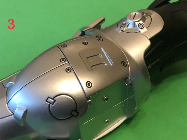

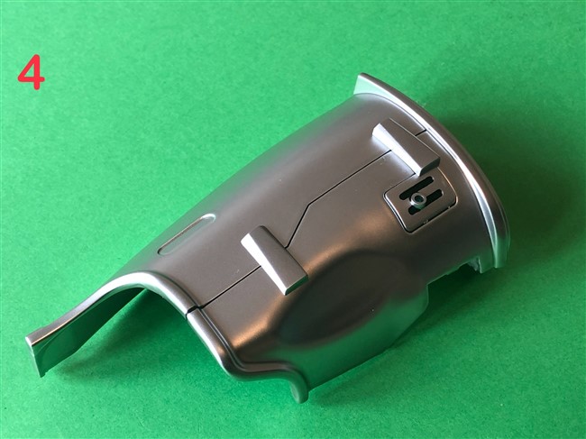

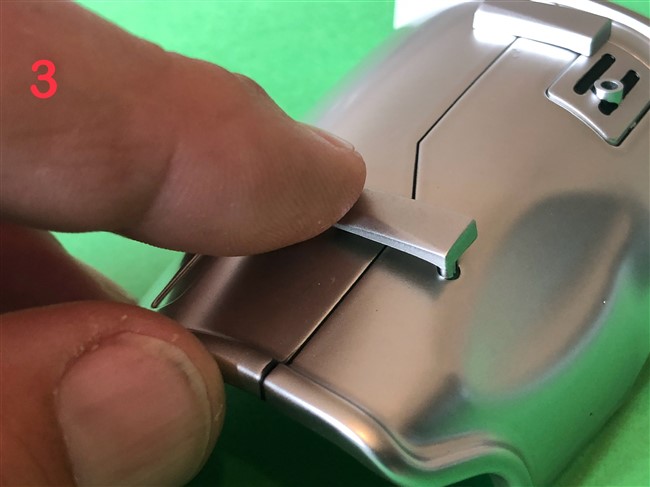

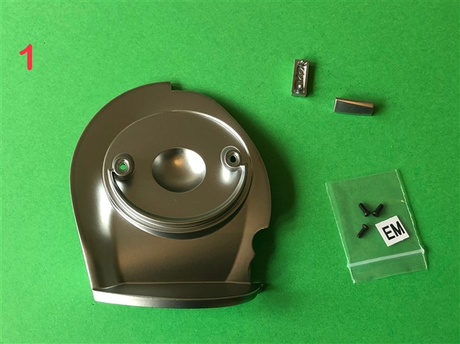

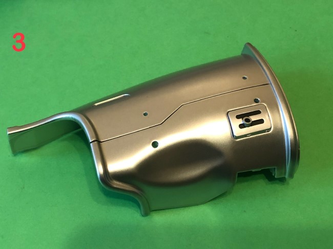

Take the assembly from issue 36 and place the right inner thigh cap 1 (37B), marked R2, onto the thigh as shown in picture 2.
Place the second inner thigh cap (37C), marked R1 as shown in picture 3. Picture 4 shows both the caps in place.

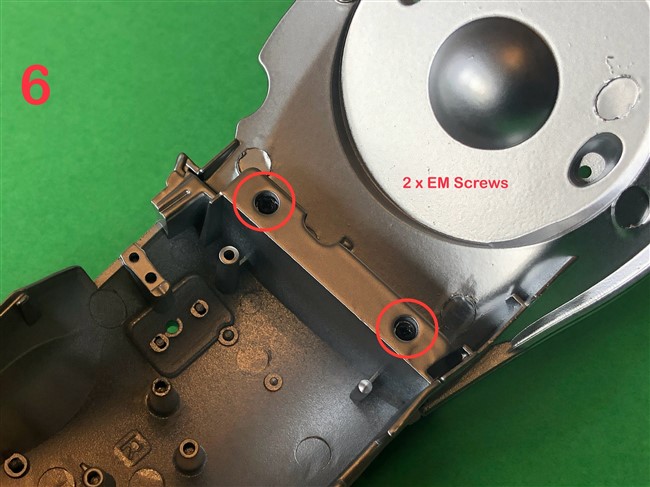

Now take the right hip plate, (37A) and the thigh as shown in picture 5 and connect the two parts together using 2 x EM screws as shown in picture 6.
Picture 7 shows the complete assembly for this issue.

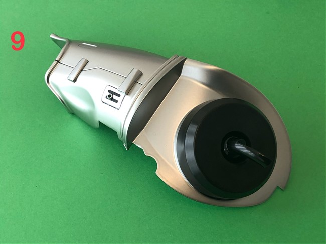

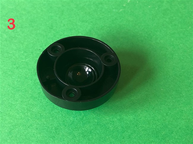

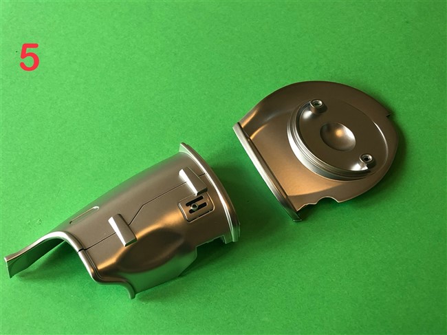

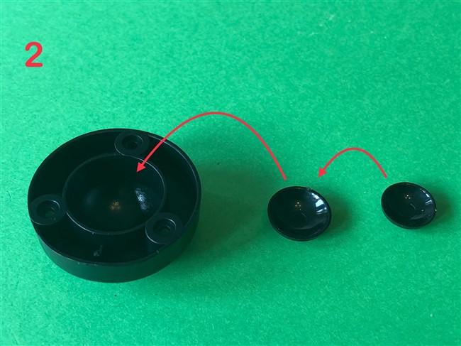

Issue 38
The Right Thigh

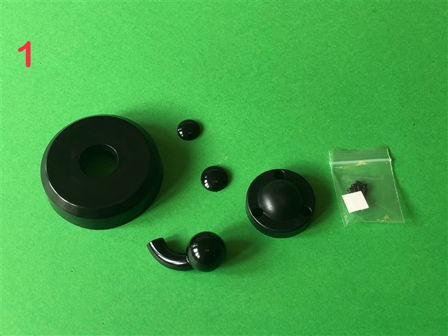

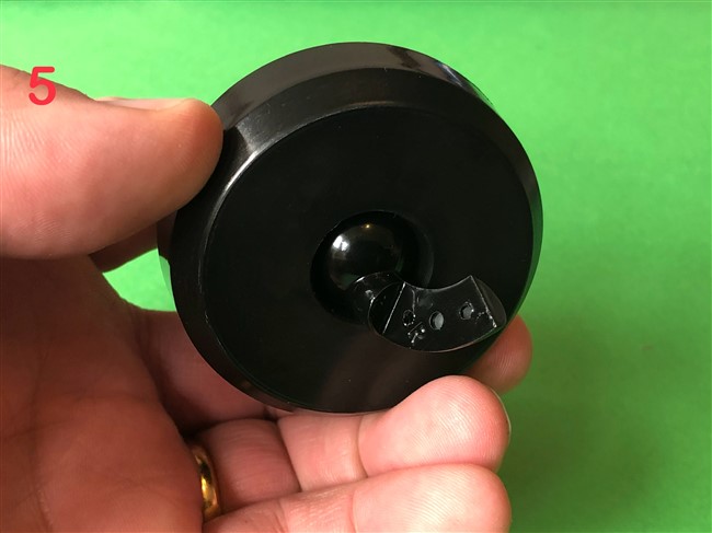

Prepare the inner ball joint by taking the two friction discs and place the larger disc, (38D) inside the inner ball joint support (38B), followed by the smaller disc, (38E), pictures 2 and 3.
Place the right hip ball joint, (38C) and place it on top of the two friction discs, picture 4.

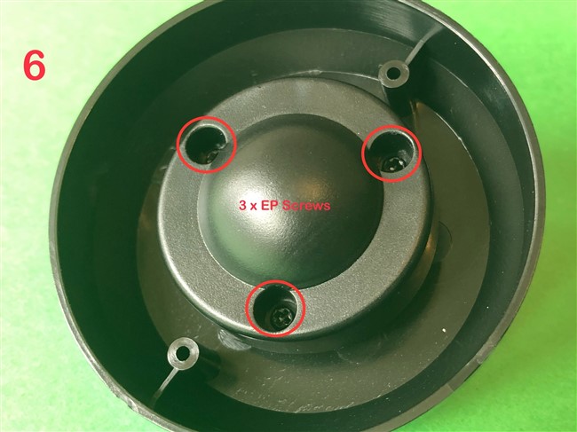

Now fit the outer support, (38A), onto the inner support, by positioning the outer support onto the pin in the inner support, so it fits into place, picture 5. Secure the assembly by using 3 x EP screws as shown in picture 6.

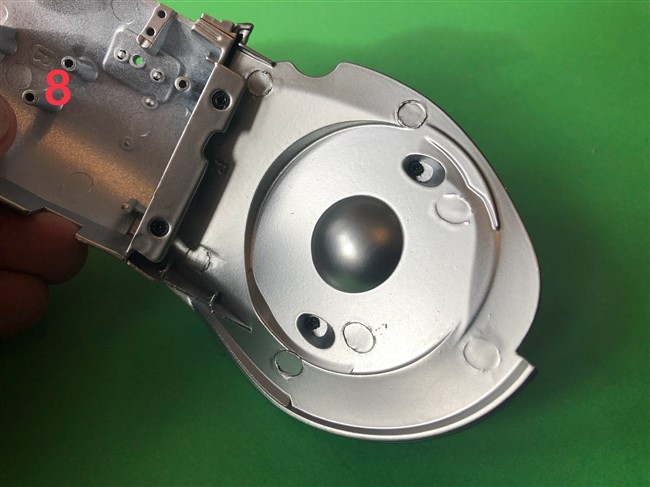

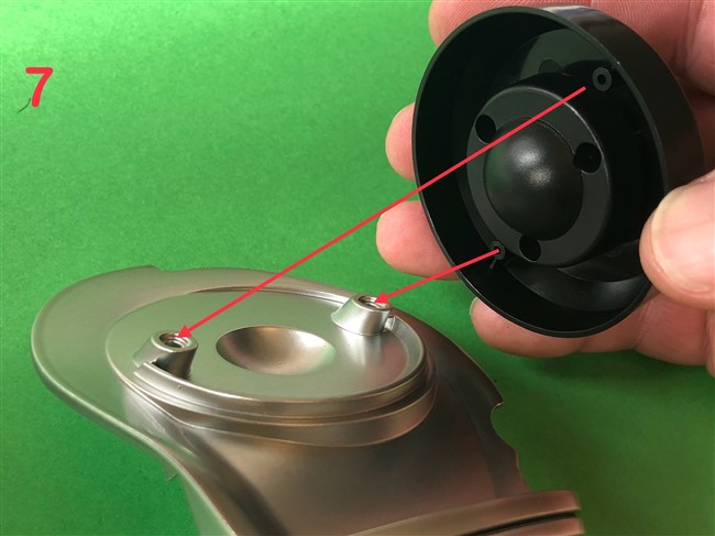

Next, place the assembly onto the hip plate from stage 37 and secure it in place by using 2 x EP screws, pictures 7 and 8.
Picture 9 shows the complete assembly for this issue.
