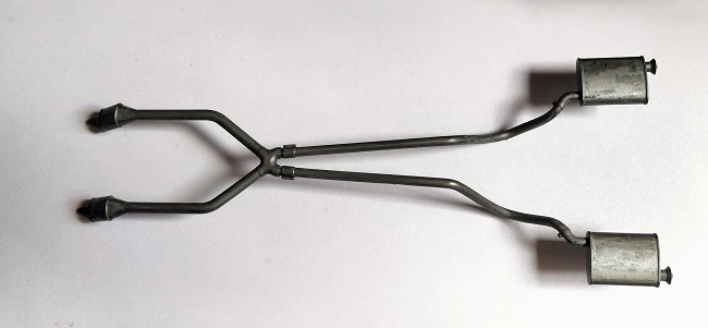

Lastly, the test: Found something that would look really cool in chrome, an exhaust pipe from an old car kit. Basic rub down from the old aluminium paint, Pic 2.

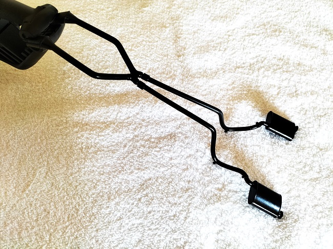

Well in between everything else, I`ve got the Pic of the Gloss Black coat. Attached below.
As my workroom doesn`t get the sun on it, I have sprayed a coat of the chrome and if it dries as well as it looks wet then its gonna be good. Have to wait and see though.

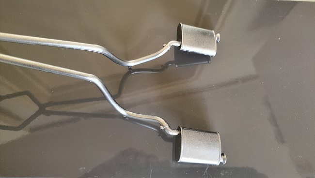

The first coat of "Chrome" has been laid and dried.
My opinion is that this is the best chrome product I have used and here`s the "but". I tell it as it is in a review.
The first coat of chrome laid very well on the pipes of the exhaust, but the larger boxes of the exhaust had minute black spots showing through. Me or the product? Not sure as I didn`t do the best prep on the boxes as I could have done.
So, can you second coat with this product?
It has to be a very light coat, or you start to get the silvery effect rather than the required Chrome.
In conclusion:
The best chrome result I have ever had. All done with rattle cans (no airbrush required).
Make sure you get the first coat on and don`t over do it, or you will have the silvery effect.
Cost, not the cheapest. That said all three cans were 400ml minimum so will do lots of chrome for the price.
The better prep work you can manage, obviously the better result.
My verdict for a first try 8/10.
First layer of chrome in attached Pic below.

Need to check out the light more when taking the Pics too, doesn`t do it the justice it deserves but there is still room for improvement. Still a good product overall. Also large cans so plenty to practice on. LOL
