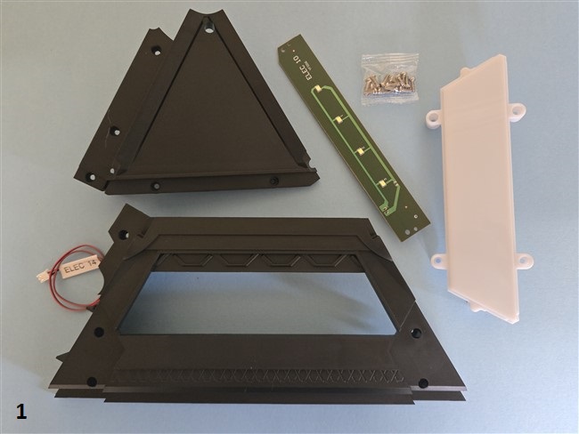

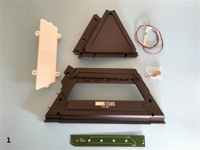

Parts supplied.....Pic 1.

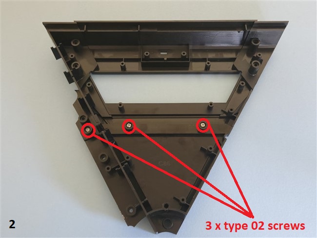

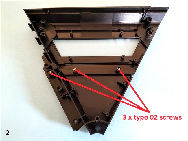

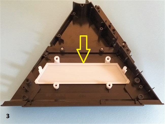

Start by fitting the main base parts C84 and C86 together, engaging the three posts of C84 into the holes of C86 and secure them using 3 x type 02 screws. Pic 2.

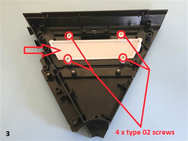

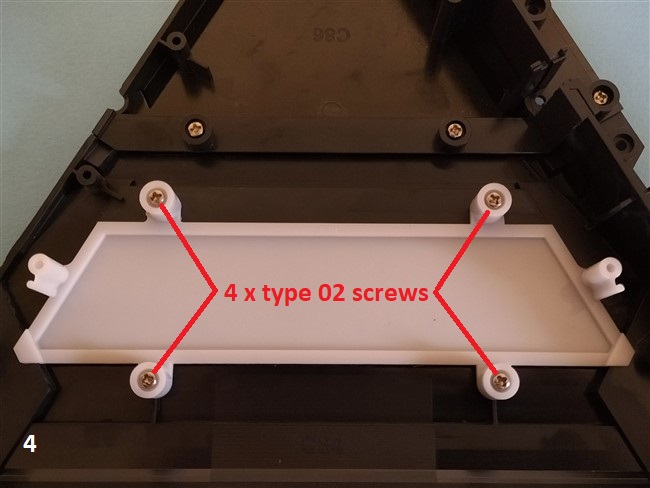

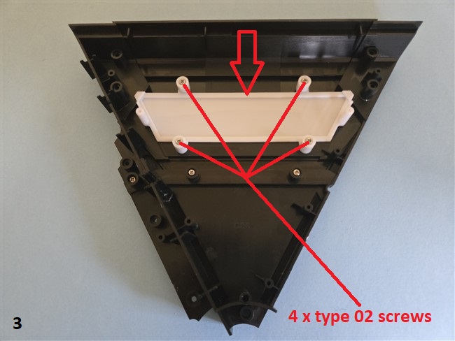

Now take the white part B10 and position it on the posts inside of the previous assembly, Pic 3 and secure it using 4 x type 02 screws. Pic 4.

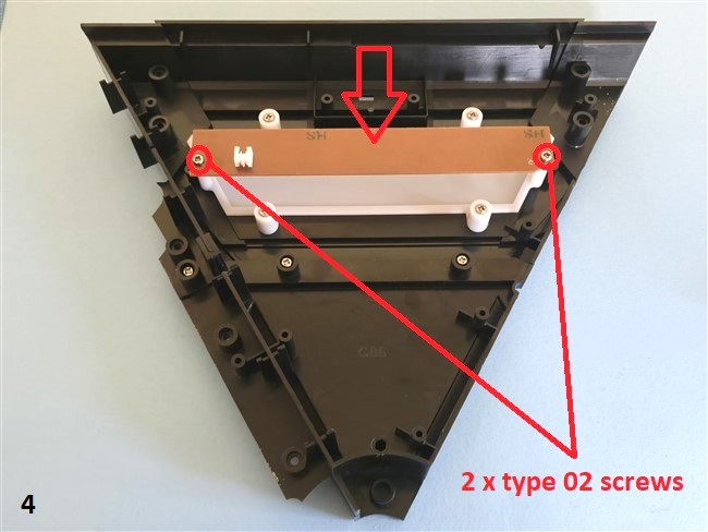

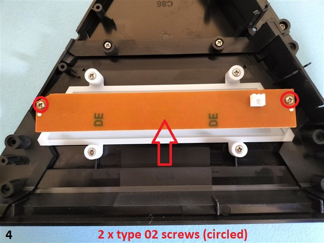

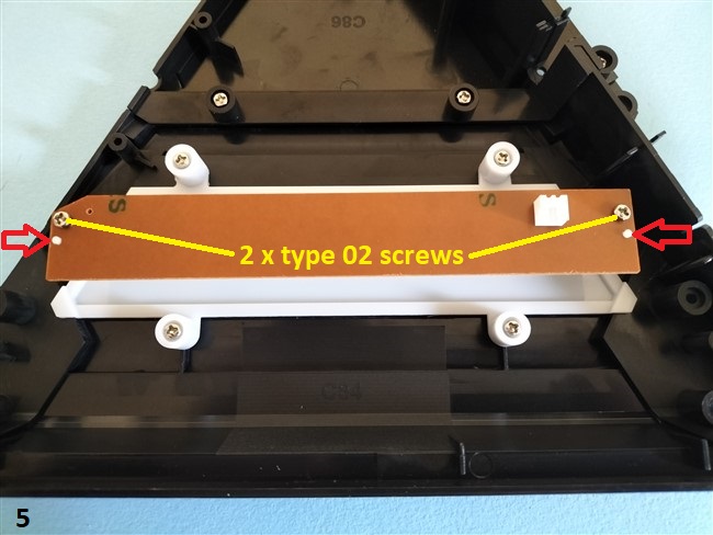

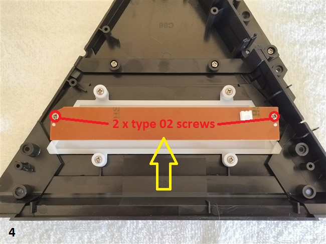

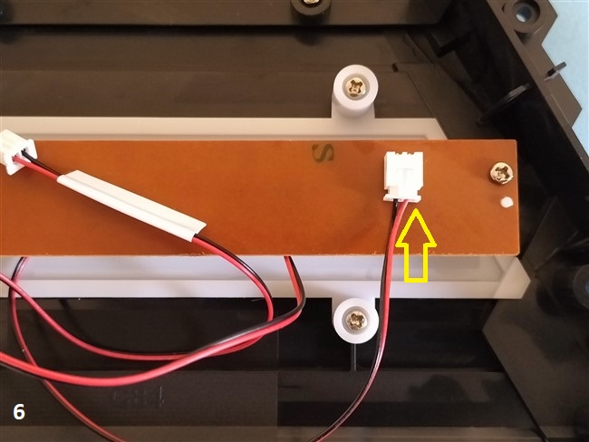

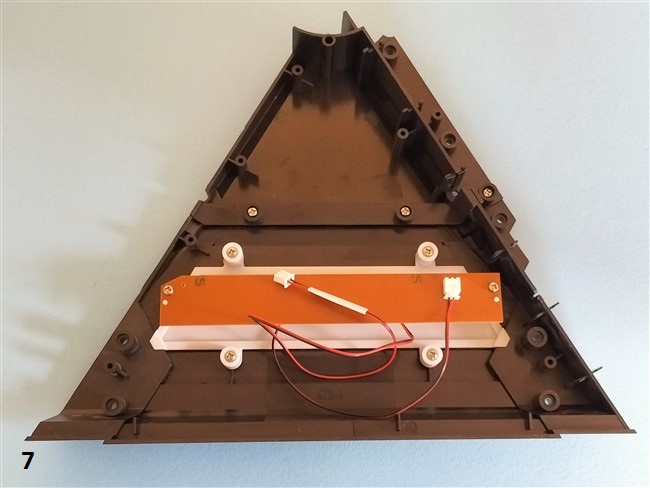

Carefully position the LED board Elec 10 over the white part, onto the two small posts (indicated by the RED arrows) and fix the board using 2 x type 02 screws. All shown in Pic 5. Then plug the lead Elec 17 into the socket on the LED board. Note: the lead will only fit the socket one way, so DO NOT force it into place. Pic 6.

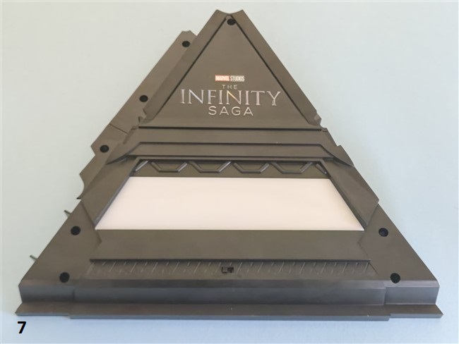

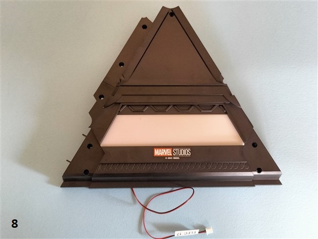

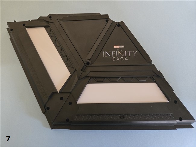

This section of the top of the base is now complete. The underside is shown in Pic 7, while the upper side is in Pic 8.

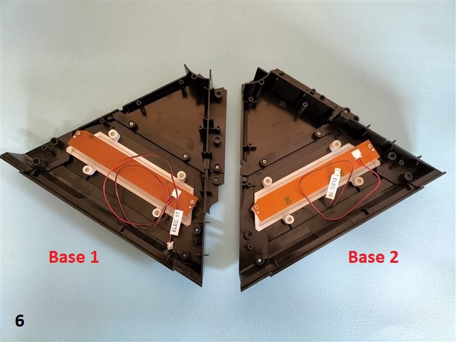

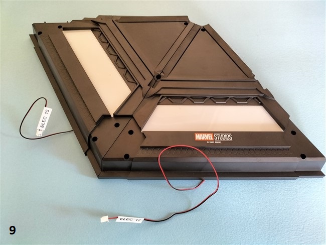

Here`s the next premium base update (Base 2), prior to me starting the next pack of the Gauntlet Official Build.
This starts as a copy of Base 1 and then we join the Base 1 and 2 together.
Parts supplied.....Pic 1, you will also need the previously built Base 1.

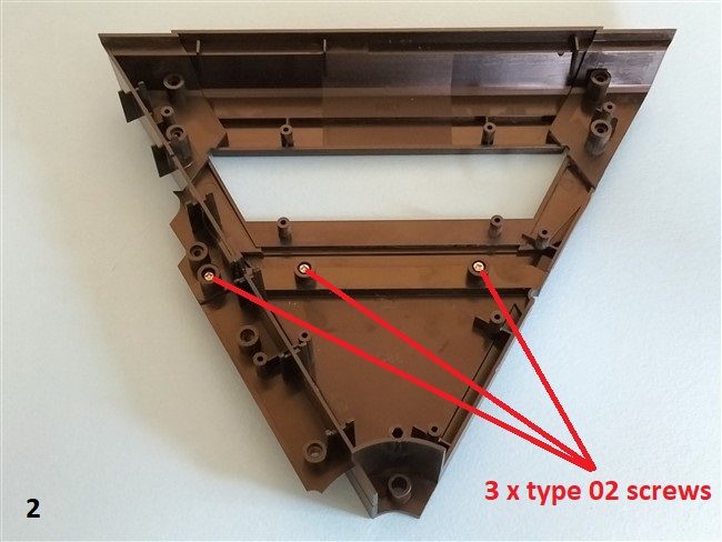

Place the two main base parts together and fix them using 3 x type 02 screws, Pic 2.

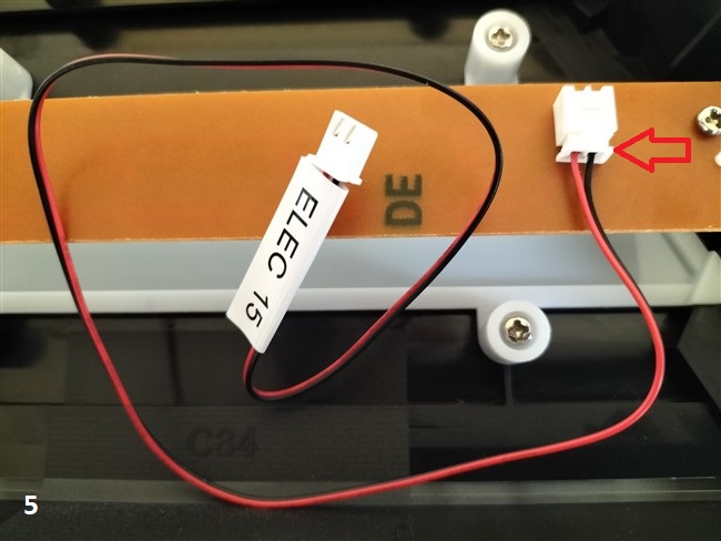

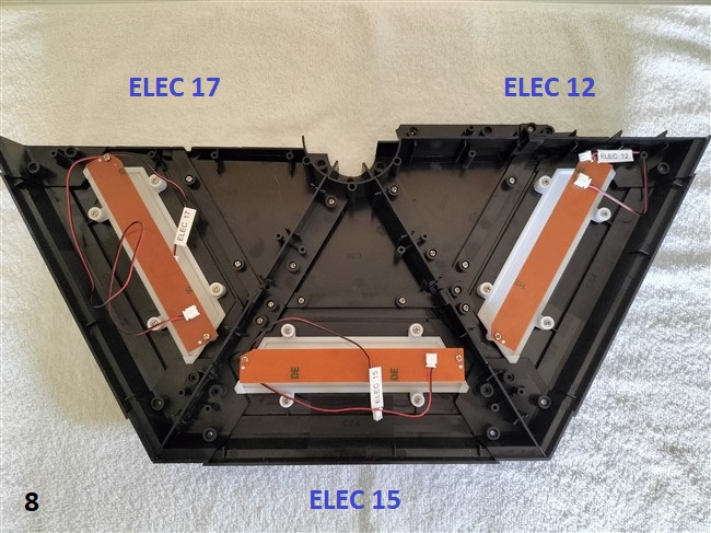

Position the white panel and secure that with 4 x type 02 screws, Pic 3. Then add the circuit board Elec 10 and secure that using 2 x type 02 screws, Pic 4 and plug in the lead Elec 15 as shown in Pic 5.

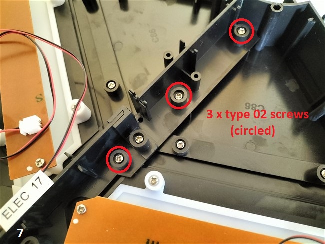

Now bring the two base parts together as shown in Pic 6. Then interlock the two bases and fix them together using 3 x type 02 screws, Pic 7.
That completes this update, Pics 8 and 9.
(Derek) Admin

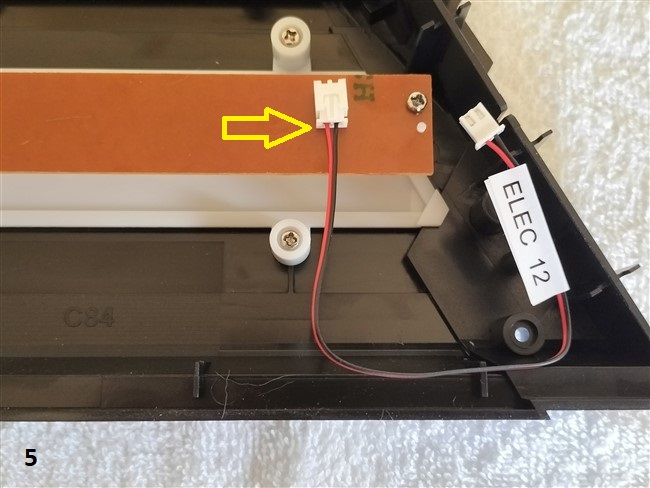

#3 Posted : 22 June 2024 12:29:06
Hi All, BigGrin

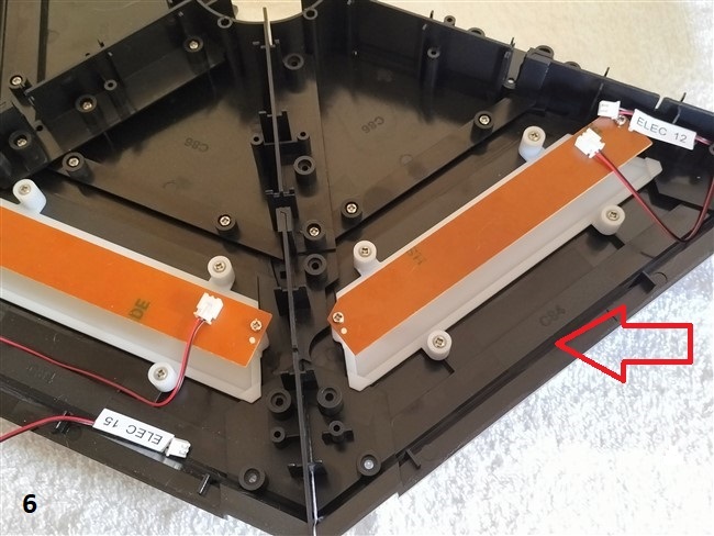

This update is for the 3rd part of the Premium base. Base 3.
Very much the same as previous base parts, except the positioning of the latest part in relation to the earlier parts. It should be noted that as the wires connected to the circuit boards are different lengths, they need to be in the correct place.
Parts supplied.....Pic 1. You will also need the other assembled base parts.
Place the base parts C84/C86 together and fix with 3 x type 02 screws. Pic 2.

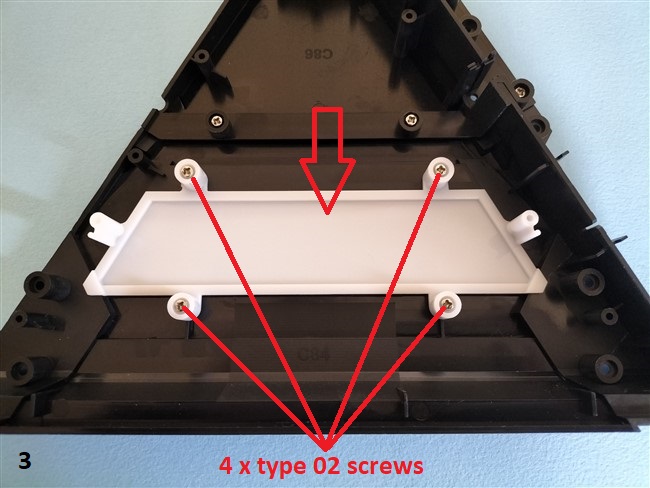

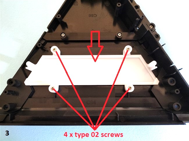

Add the white cover B10 and fix in place using 4 x type 02 screws. Pic 3.
Position the circuit board ELEC10, secure with 2 x type 02 screws. Pic 4.
Plug the lead ELEC 12 into the circuit board. Pic 5.

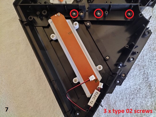

Bring in the previous base assembly and connect the new base to the right side of the others. Pic 6. Now secure the parts using 3 x type 02 screws. Pic 7.
That`s all for this one, Pics 8 and 9.

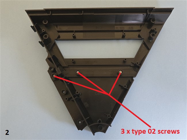

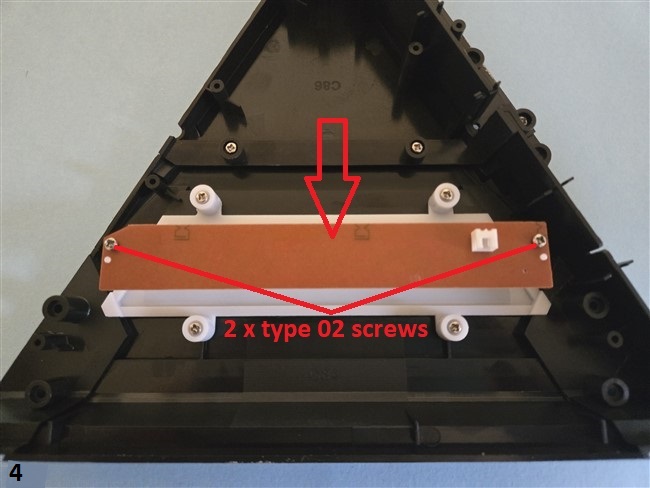

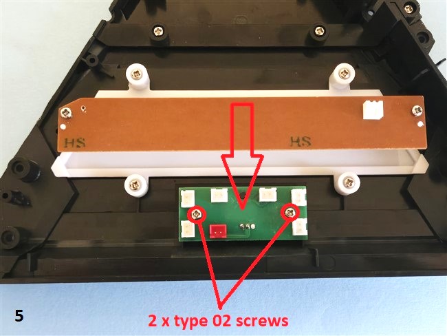

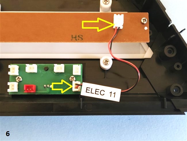

#4 Posted : 29 August 2024 20:41:36
Hi All, BigGrin
Here we are with the fourth part of the "Premium Base" (Apologies for the delay)
As for the main build, I am still awaiting the parts for issue 70. Unfortunately I have duplicated parts for issue 71 as there were coding errors of the parts at source. Cursing
I will therefore being updating issues 4 and 5 of the Premium Base to assist in the meantime.

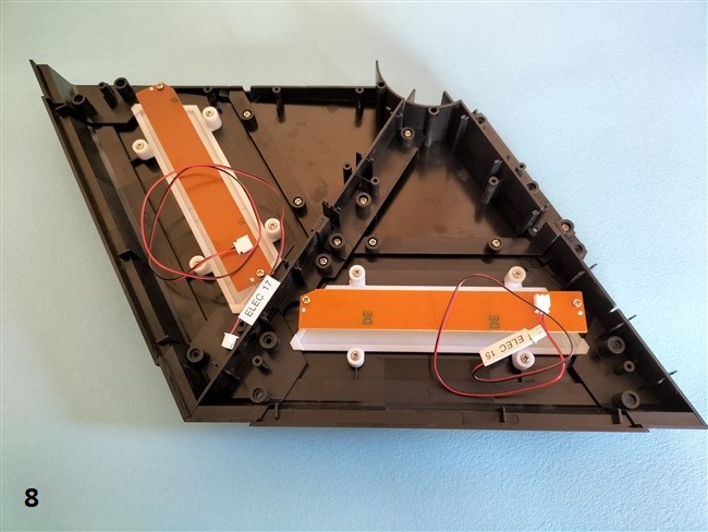

Issue 4 of the base, is not exactley the same as the previous three parts as it has a second circuit board and it appears that sections 4, 5 and 6 will be assembled and then attached to the assembly from parts 1 - 3.
So, onto stage four of the base:

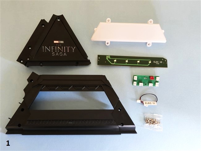

Position the main base parts C85 and C86 together and fix them together using 3 x type 02 screws, Pic 2.
Position the white cover B10 and secure it in place using 4 x type 02 screws, Pic 3. Then place the larger circuit board ELEC 10 in place and secure that with a further 2 x type 02 screws, Pic 4.
This is where this section of the base changes from the previous ones. Take the smaller circuit board ELEC 13 and place it using the orientation shown and fix it in place using 2 x type 02 screws. All shown in Pic 5.
The last task is to fit the lead ELEC 11, between the large and small circuit boards as shown in Pic 6.
That`s it for this update, Pic 7.
Stage 5 of the Premium Base coming soon. ThumpUp ThumpUp

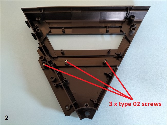

#5 Posted : 31 August 2024 14:59:54
Hi All, BigGrin
Still stuck awaiting parts of issue 70, so here is the next update for the Premium Base, #5.

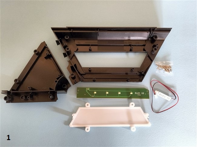

Parts supplied.....Pic 1. You will also need the base section #4 from the previous update.
Place the parts C84 and C86 together and fix them together using 3 x type 02 screws, Pic 2. Add the white lens B10 and fix it using 4 x type 02 screws, Pic 3.
Now add the circuit board ELEC 10, securing that with 2 x type 02 screws, Pic 4 and plug the wire ELEC 14 into the cicuit board, Pic 5.

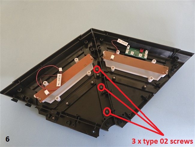

Bring in the previous base part from issue 4, position the two sections together and secure then using a further 3 x type 02 screws as shown in Pic 6.

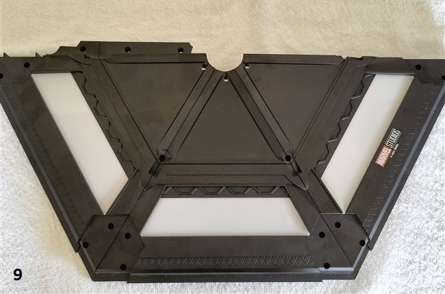

That`s all for this update, Pic 7 shows the upper side of the parts assembled.
