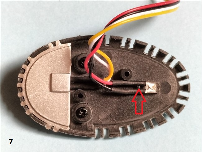

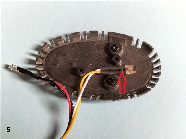

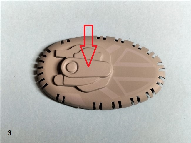

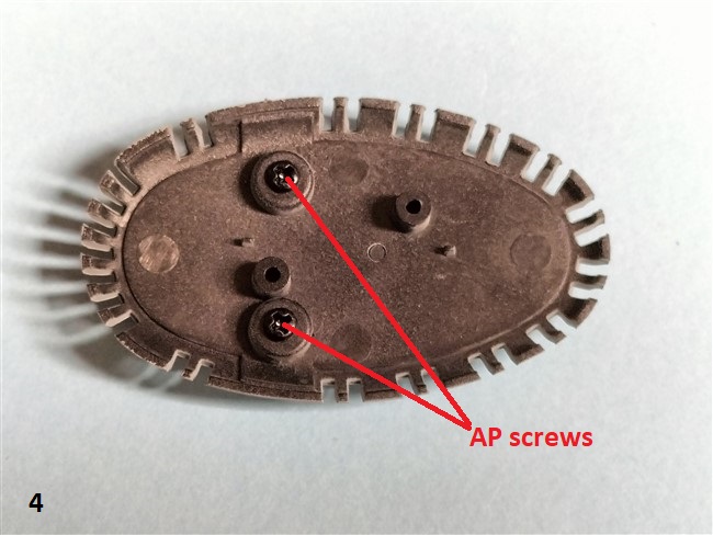

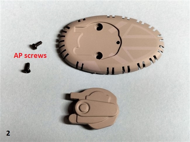

Bring to the table parts 01D - O1C and two AP screws. Pic 2. Place the parts as shown in Pic 3 and secure them using 2 x AP screws, Pic 4.
Separate the three cables supplied and select the one labelled "C", White and Yellow wires to one LED and Red and Black wires to the other.
Point to Note: The LED`s are positioned by means of a small tab that fits between the insulated connections of the LED`s.

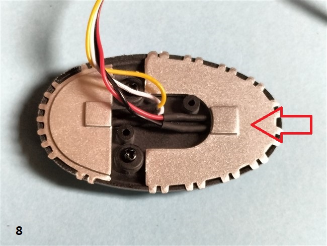

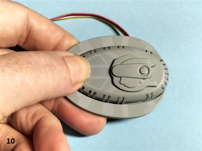

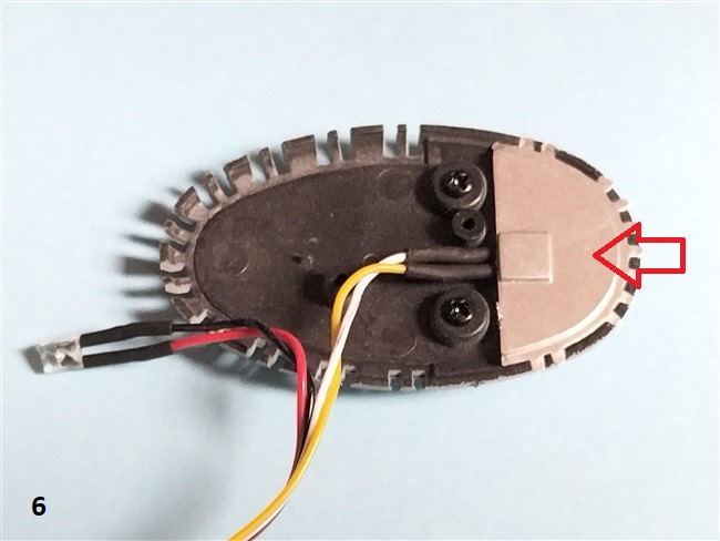

Position the LED with Yellow and White wires as shown in Pic 5. Then position the bridge rear window 01J to keep it in place. Pic 6. Now position the other LED (Red/Black wires) as in Pic 7 and retain that by placing the front bridge windows 01I over it. Pic 8.

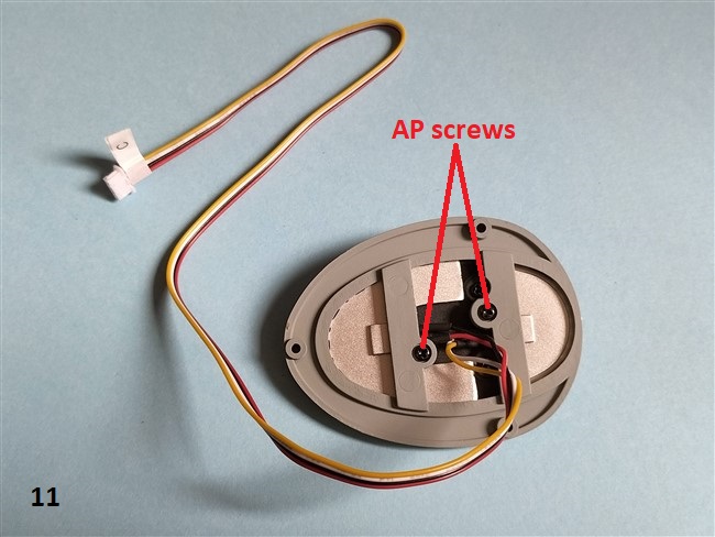

Now feed the cable from the LED`s through the bridge bottom section 01K, Pic 9. Locate the bridge as in Pic 10 and secure it using 2 x AP screws. Pic 11.

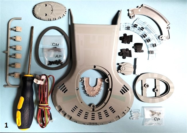

You will require the assembly from the end of part A and the rest of the parts supplied with Issue 1.

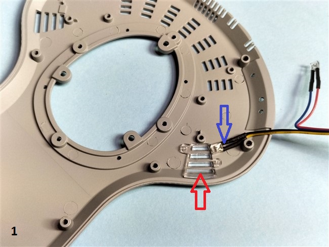

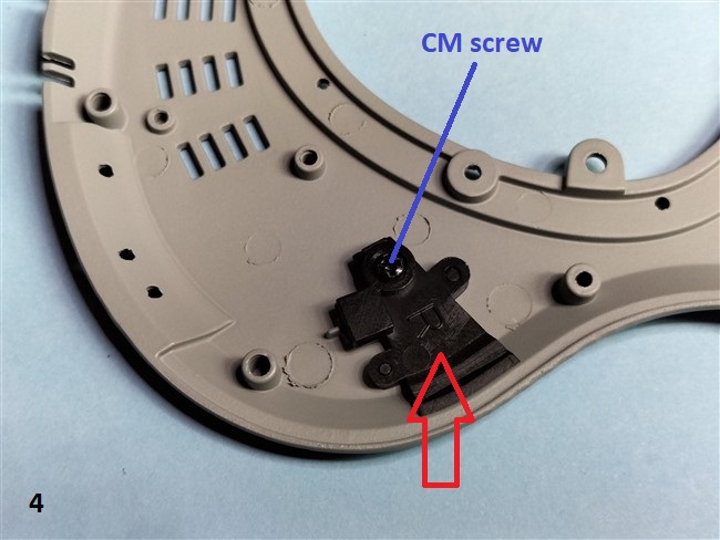

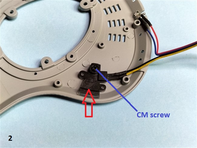

Collect the parts 01A (deck 2), the LED`s marked "B" and the emergency flush vent 01H (clear and marked "L").

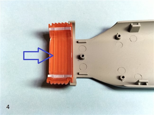

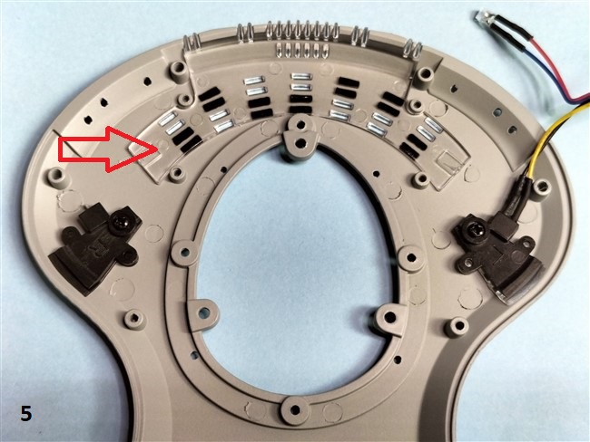

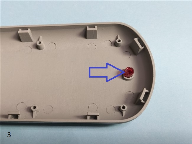

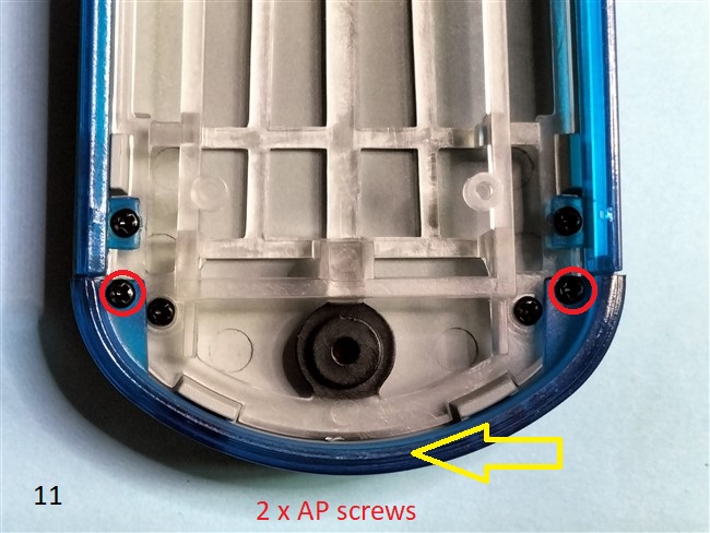

Place the clear vent 01H (red arrow) and LED with the Black/yellow wires (blue arrow) inside the deck 2 part 01A as shown in Pic 1. Now use the vent bracket 01S (marked "L") to cover the clear vent and LED and secure it using a CM screw. Pic 2.
Move over to the other side of deck 2. Fit the right flush vent 01G, Pic 3 and then the right vent bracket 01R, fixing it in place using a CM screw. Pic 4. Now press the deck 2 front window panel 01E in place. Pic 5.

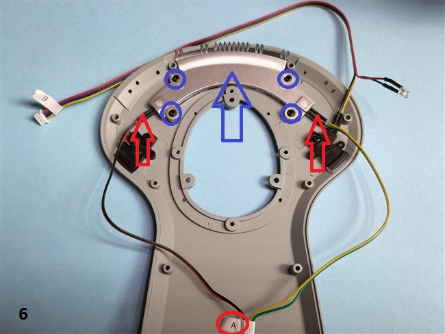

Cover the front window with the front window deflector 01F. Take the last wired LED`s (marked "A") and place the LED`s under the deflector, carefully holding the parts together fix the deflector using 4 x CM screws. All shown in Pic 6.

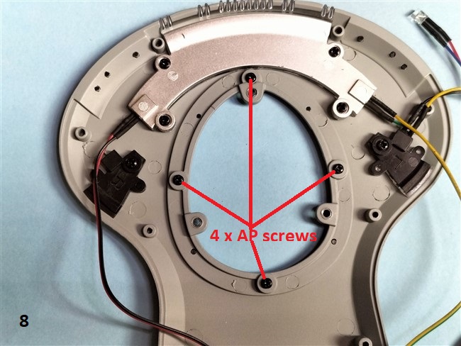

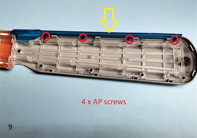

Turn deck 2 over and place the upper sensor platform 01B in place. Pic 7. Hold the sensor platform in place, turn the parts over and secure them using 4 x AP screws. Pic 8.

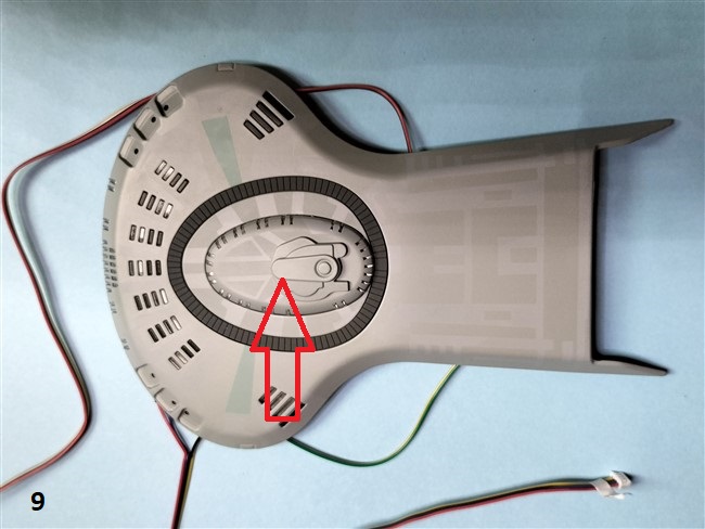

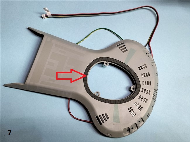

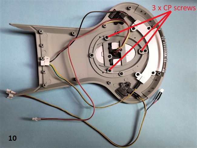

Bring the assembly from the end of Part A back to the table. Feed the cable through the top of deck 2 and position it as shown in Pic 9. Hold the assemblies together, turn them over and secure them together using 3 x CP screws. Pic 10.

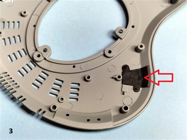

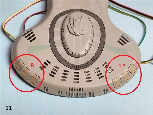

Finally, there are six escape pods to fit to deck 2 (parts 01L - 01Q). On the rear of the parts, three are marked "L" and three marked "R" and each has a unique locating pin, so they can only fit in one position. Press them to fit in the direction of the pin on the rear of each pod. Pic 11.

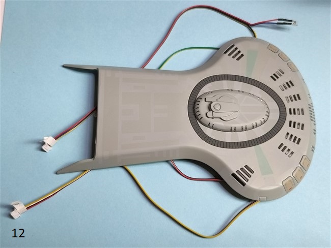

That concludes Issue 1, Pic 12. I hope you have enjoyed this first part as much as I have. See you soon for Issue 2.ThumpUp ThumpUp

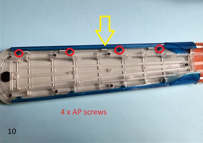

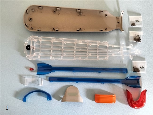

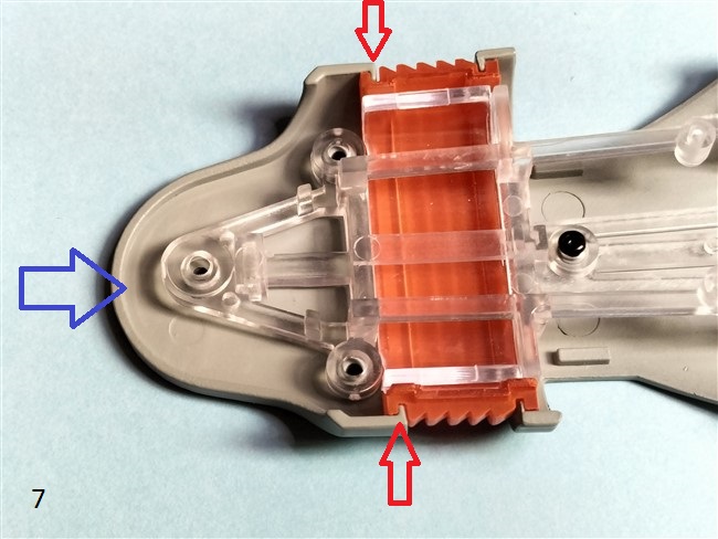

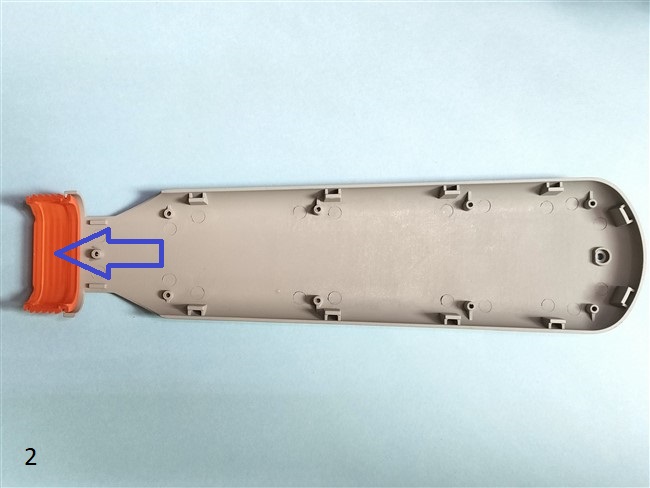

Time for the Issue 2 update, where we will build the upper section of the port warp nacelle.
Parts supplied.....Pic 1.

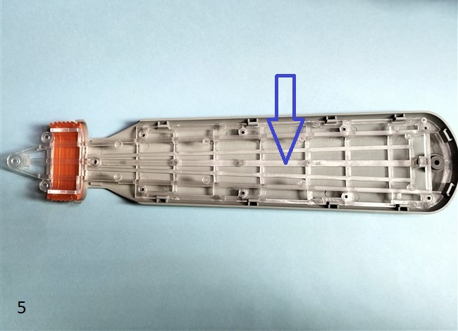

Start with the parts 2D and 2C. Engage the the thin ridge on the end of the nacelle upper 2D with the Bussard EM field projector 2C as shown in Pic 2. Then at the other end of the upper nacelle, insert the formation light 2I, Pic3. Note: This part will only fit in one orientation.
Next place the reflector 2J inside the projector 2C, Pic 4. This part will be fixed in place in the next step.

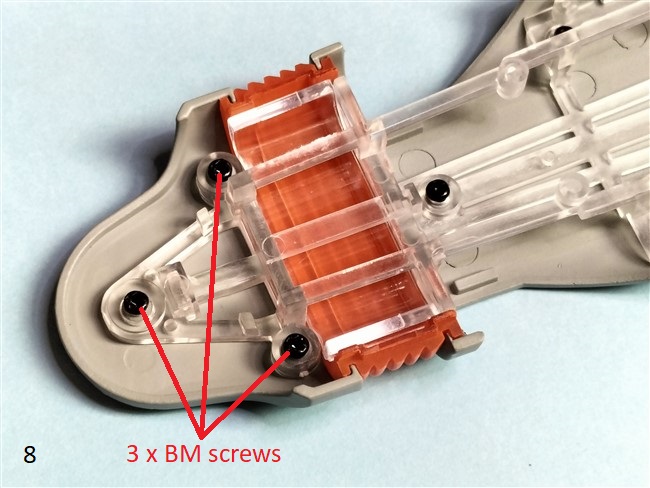

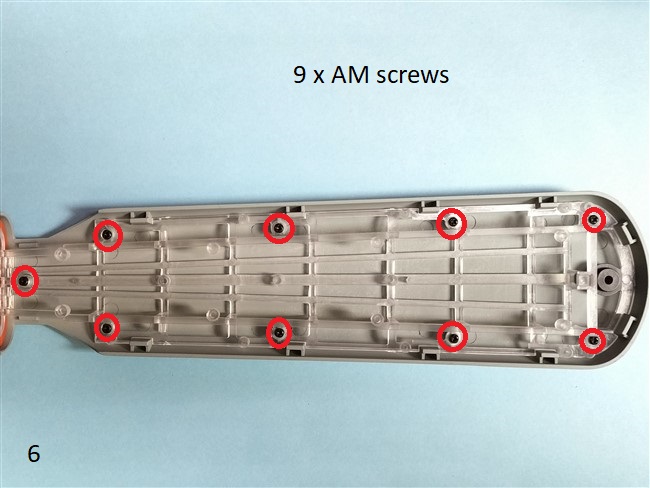

Carefully position the upper frame 2H inside the upper nacelle Pic 5 and fix it in place using 9 x AM screws, Pic 6. Now add the nacelle front end 2B, engaging the lip at the end into the slot in the field projector, Pic 7 and fix it to the frame using 3 x BM screws Pic 8.
We finish by fitting the two side field grills left and right 2F and 2E, fixing each with 4 x AP screws Pics 9/10. Then fit the rear end grill 2G and fix that with 2 x AP screws, Pic 11.
That completes Issue 2, so keep the Bussard collector 2A safely until required.
See you soon, take care and I`ll be back when pack 2 arrives. Pic 12.
