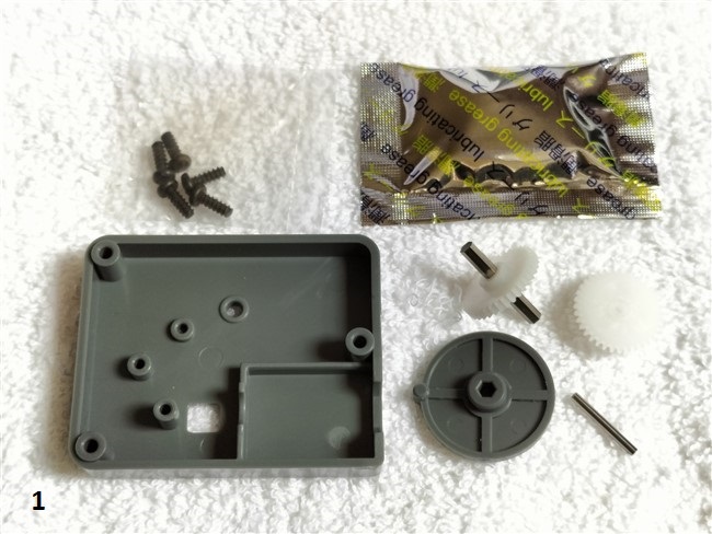

Parts supplied.....Pic 1.

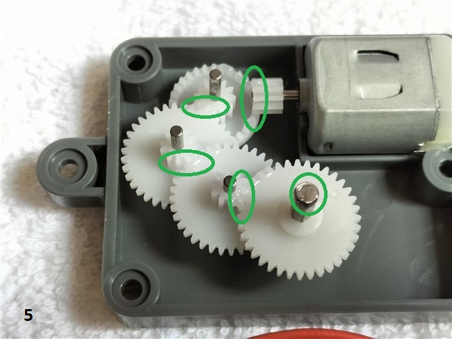

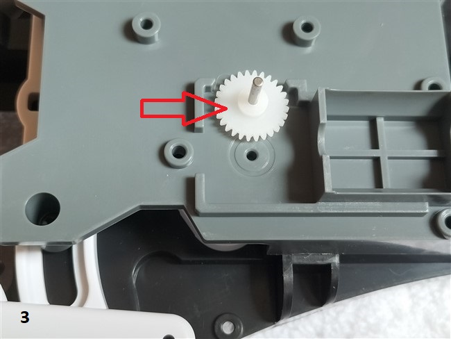

To start bring the partially built gearbox back to the table and place the round shaft (6-06) into the box as shown in Pic 2. Then add the gear (6-03) with the smaller gear uppermost onto the shaft. Pic 3. Now add the gear with the hexagonal shaft. Pic 4. Its time now to grease the gears. As the grease will be needed in future issues make the smallest nick in one corner of the foil pack and using a cocktail stick (or similar) put a small amount of grease in all the places indicated in Pic 5.(Green circles).

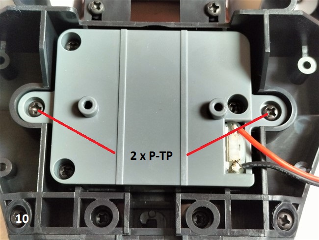

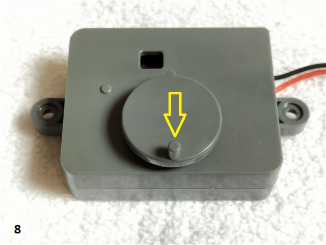

Place the servomotor cover (6-01) over the gear train Pic 6 and fix it in place using 3 x P-TP screws Pic 7. Then place the eye wheel (6-02) onto the hexagonal shaft where it extends through the gear box. It must be in the orientation shown in Pic 8.

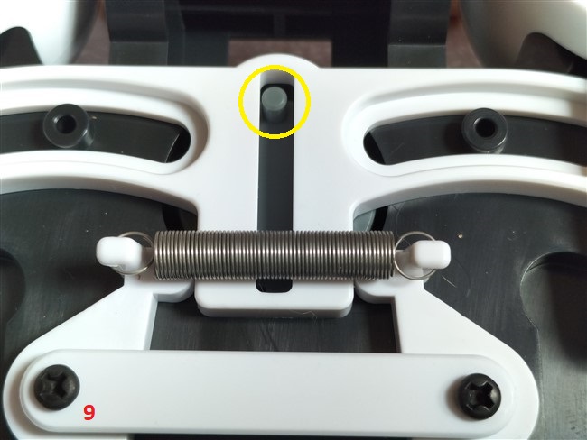

Carefully place the gearbox and eye wheel into the underside of the head assembly. If it is correctly positioned the pin on the eye wheel will be positioned as shown in Pic 9. Then hold the gearbox in place, turn the head assembly over and fix the gearbox using 2 x P-TP screws. Pic 10.

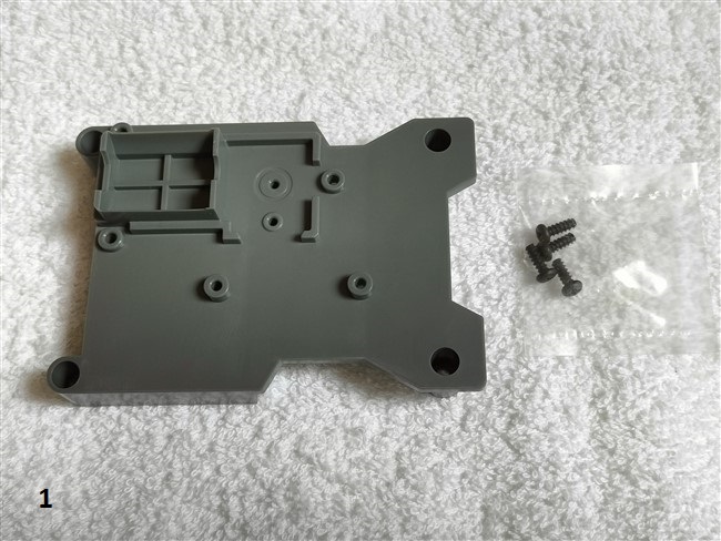

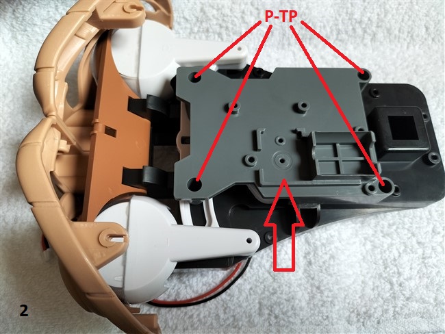

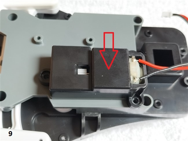

The servo motor mount sits on four posts. The front two are inside the right to left (white) slider and the other two are toward the read of the head unit. Position the base and secure it with 4 x P-TP screws as shown in Pic 2.

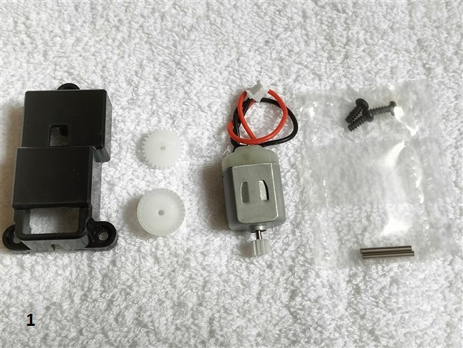

Please note: The greasing points in the instructions are either incorrect or non-existent. So please follow the marked points in my directions.

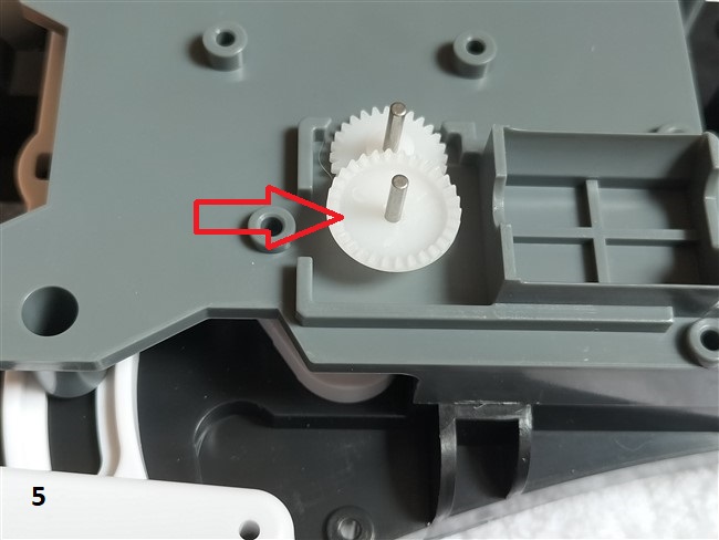

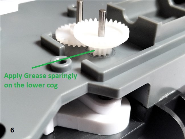

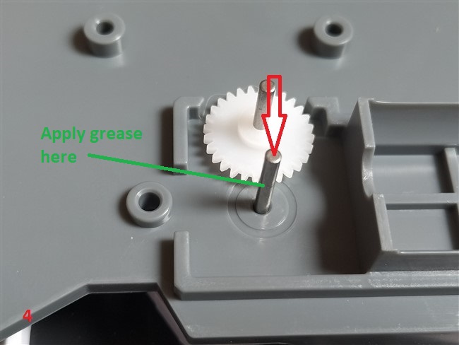

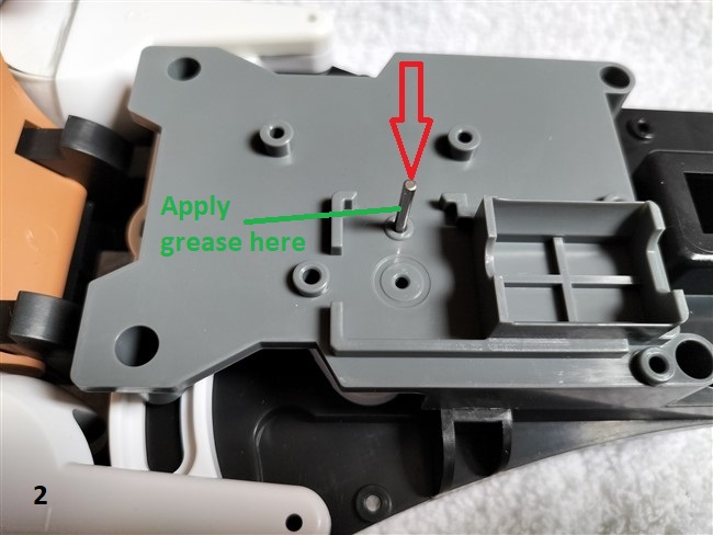

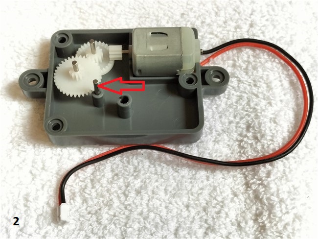

Start by placing a shaft (8-05) as in Pic 2 and add a little grease as indicated. Then add the gear (8-03) onto the shaft, with the gear teeth downwards and the raised round section uppermost, as in Pic 3.

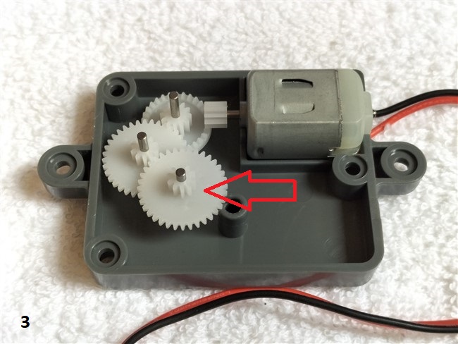

Now position the second shaft (8-05) and grease as indicated in Pic 4. Then position the gear (8-02) on the shaft with the smaller gear downwards and the cup shaped gear upwards as shown in Pic 5. Then apply some grease to the small lower gear. Pic 6.

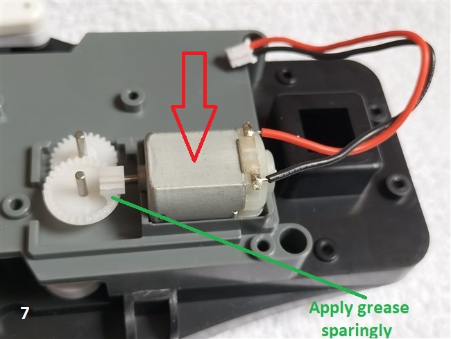

We now turn our attention to the motor (8-06) with the gear (8-04) attached to the drive spindle. Position the motor (wires uppermost), engaging the small pinion gear with the gear (8-02) and apply grease as indicated in Pic 7.

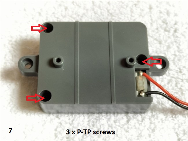

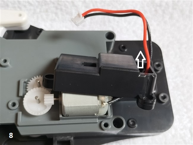

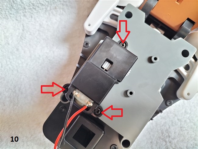

Take the Servomotor mount cover (8-01) and feed the wires from the motor through the rear hole. Pic 8. Then position the cover and press it down firmly, so the cover clips over the motor. Pic 9. Then secure the cover using 3 x P-TP screws. Pic 10.

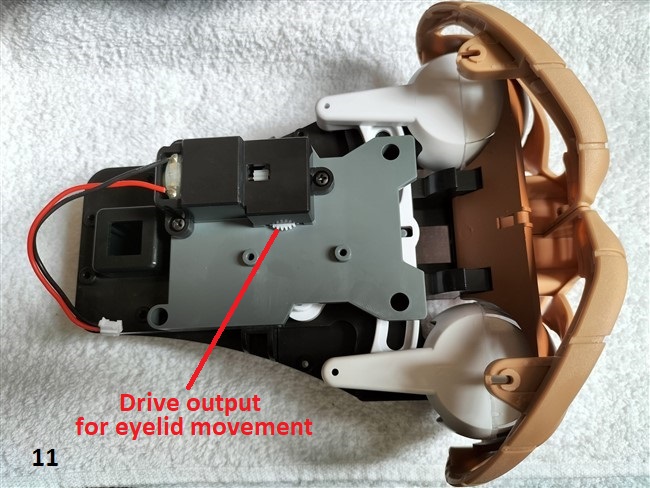

That concludes the last update for this pack. Pic 11. In the final Pic I have indicated where the drive for the eyelid movement extends through the gearbox casing.
