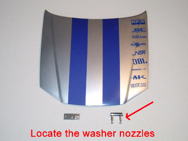

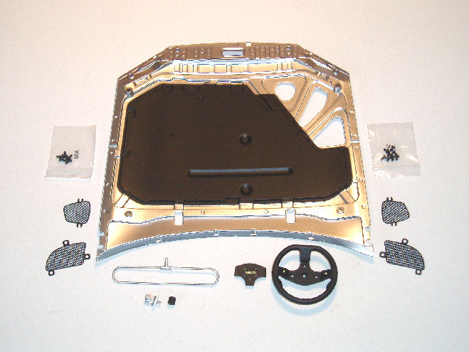

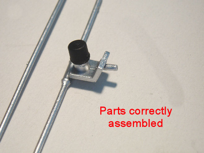

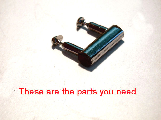

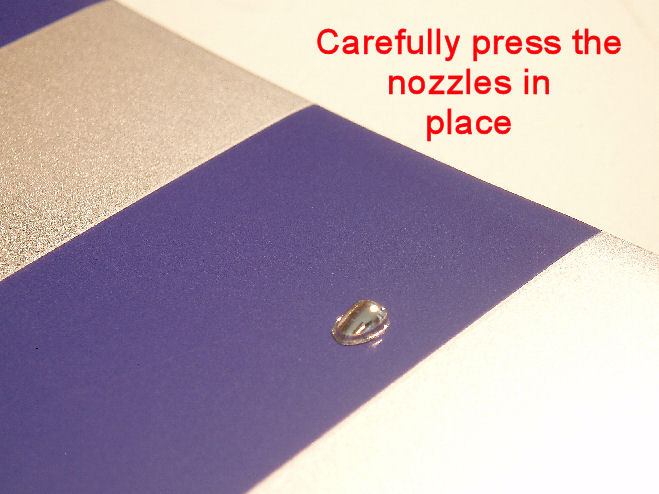

In this stage you will fit the washer nozzle jets to the top of the car bonnet (hood)
Locate the small chrome sprue holding the washer nozzles.
Carefully cut one nozzle from the sprue but do not cut off the locating pin.

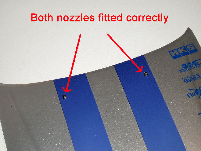

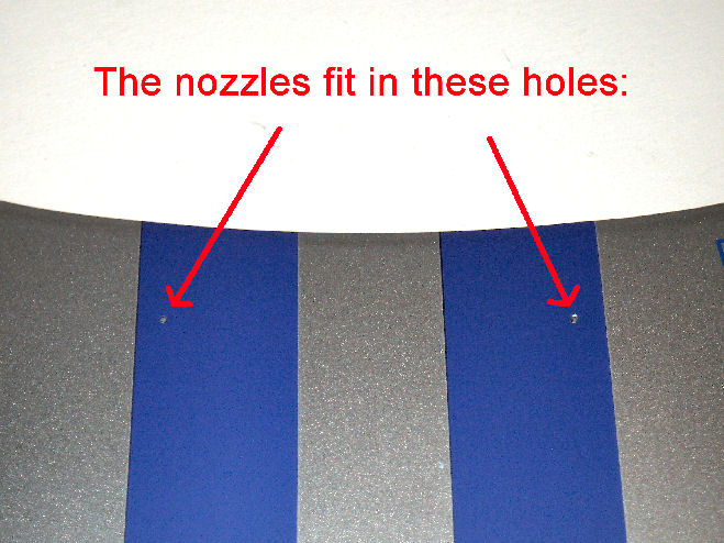

Press the nozzle into place in the locating hole in the bonnet, making sure the narrow end of the nozzle faces the forward edge of the bonnet.
Fit the other nozzle in the same way and then store the parts safely for future use.

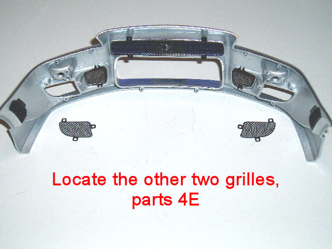

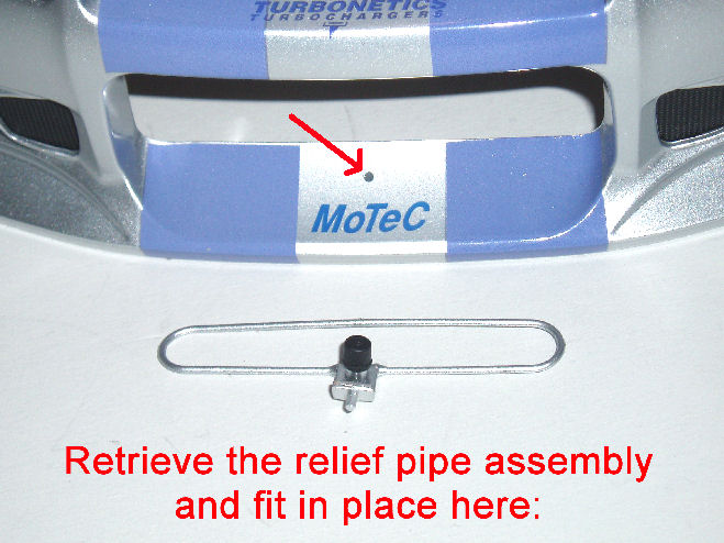

STAGE 4:
For this stage you will need to retrieve the front part of the car from stage 1.

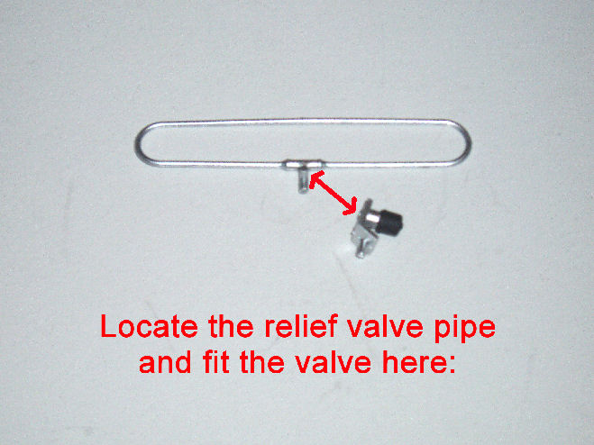

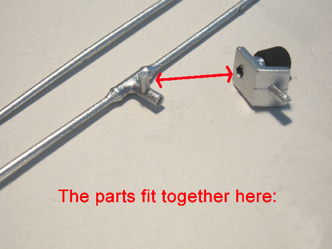

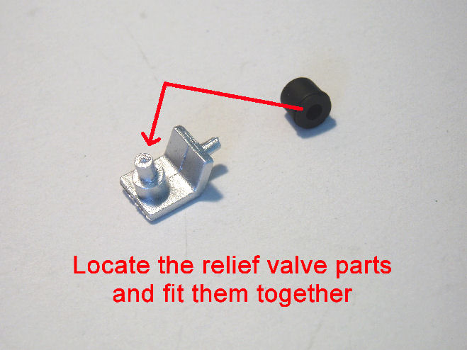

The front relief valve – parts 4A & 4C just push together.
Then locate the pressure relief pipe, part 4B and press the assembled valve onto the pin at the base.

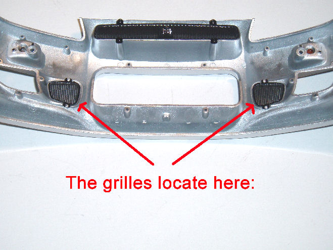

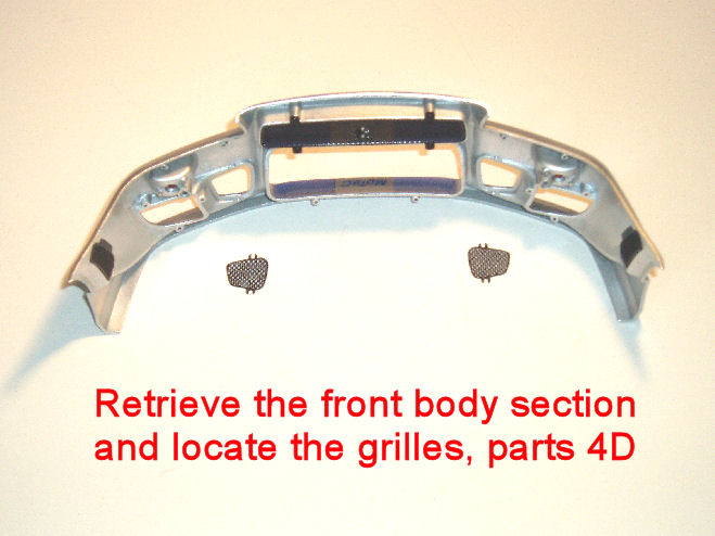

Locate the two parts 4D. They are both the same and these press into place from the inside of the car front section either side of the large grille opening.

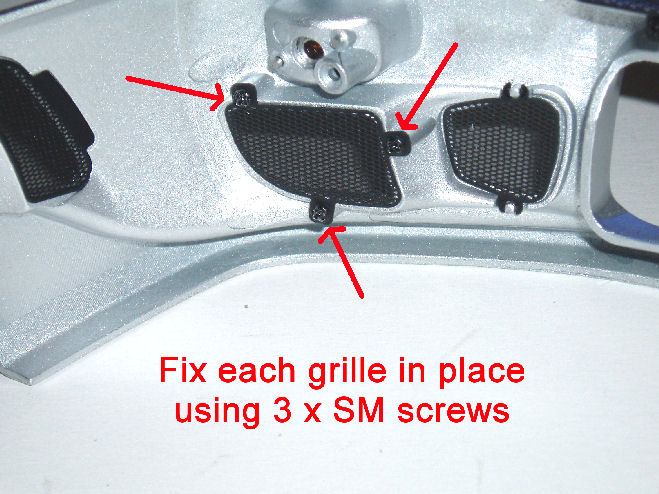

Locate the two grilles, parts 4E. These are both the same and fit in place from the inside of the nose section, either side of the two previously installed parts.
Fix these grilles in place using 3 x SM screws on each one.
Press the assembled relief valve pipe into place in the small hole in the lower front opening of the nose section. Make sure it is positioned straight, with the valve facing outwards.

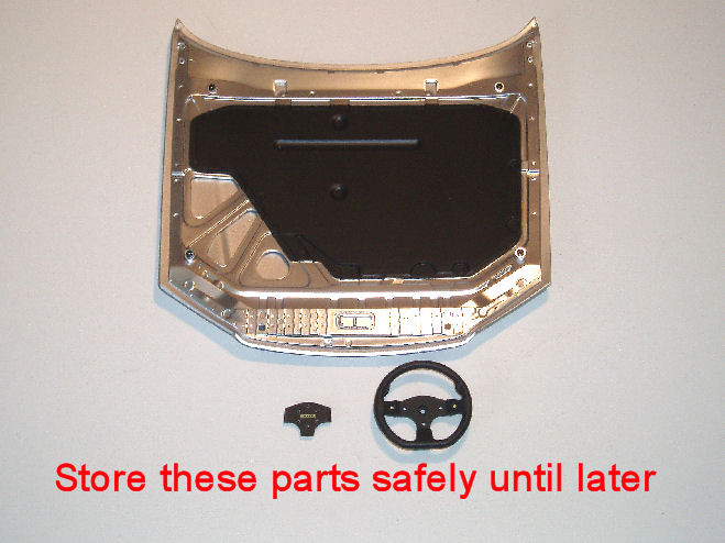

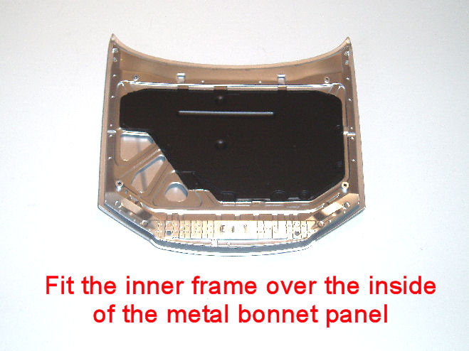

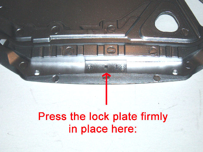

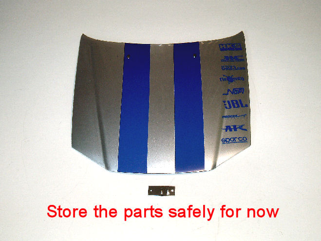

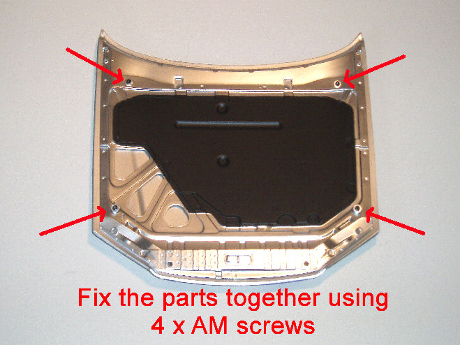

Retrieve the small lock plate from stage 3, and the bonnet frame – part 4H, from this stage.
Press the part into place on the grey side of the frame, in the narrow opening at the front angled edge.

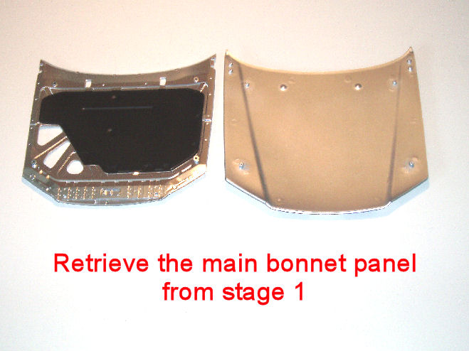

Retrieve the bonnet panel from stage 3 and position the frame – part 4H – in position on the inside of the bonnet panel, aligning the fixing holes together in both parts.
Fix the parts together using 4 x AM screws.
Store all parts safely for future use.

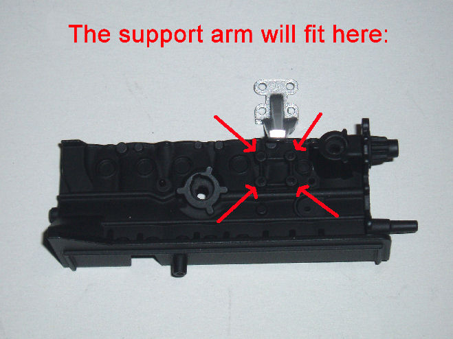

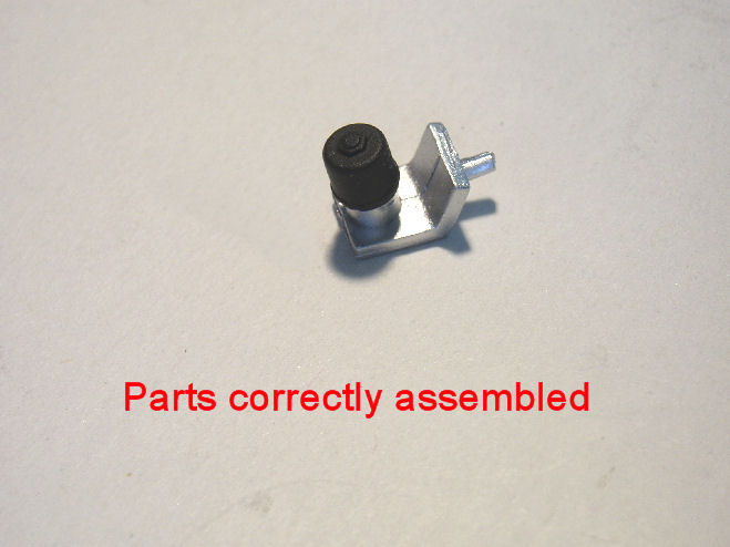

STAGE 5:

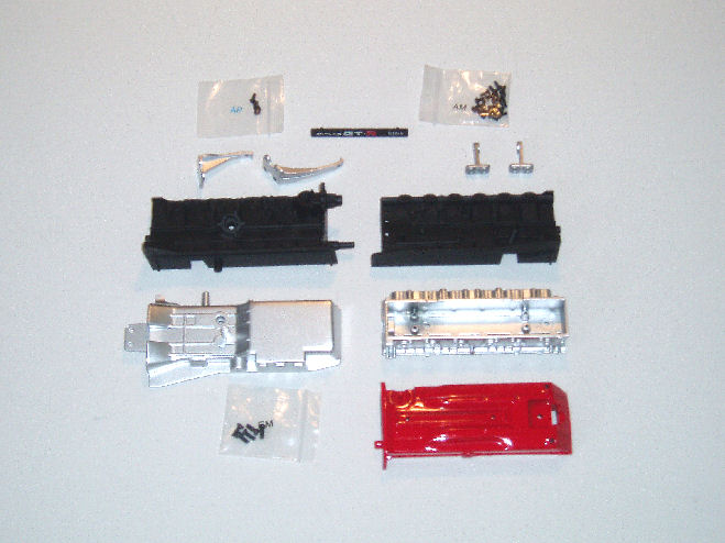

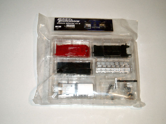

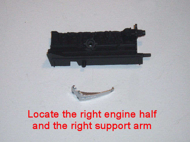

With these parts you can assemble the main engine block.

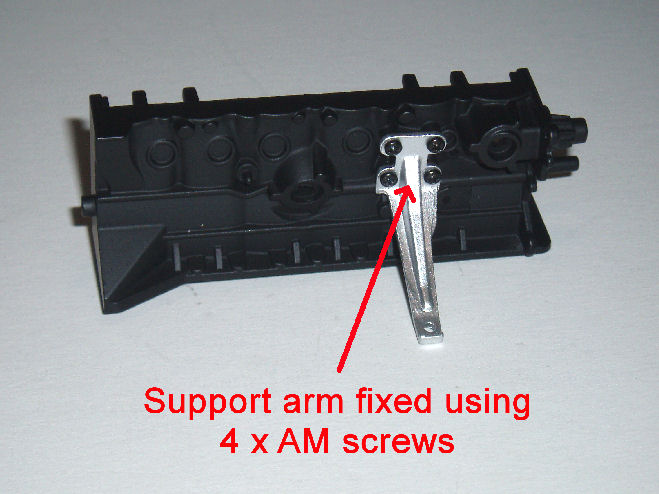

Locate the right engine block half part 5A, and the right support, 5H.
You will also need 4 x AM screws.
Align the holes in the support and fix the parts together using the 4 x AM screws.

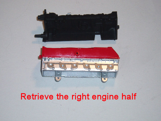

Repeat with the other engine half and support, parts 5B & 5G.

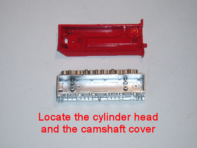

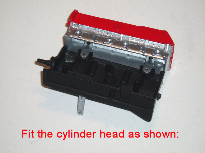

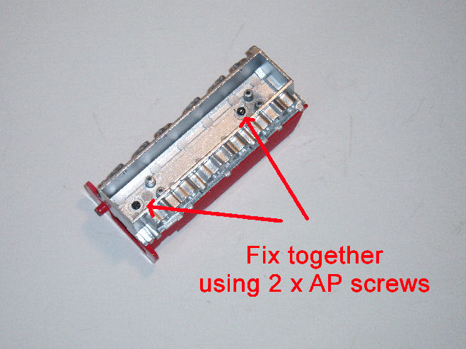

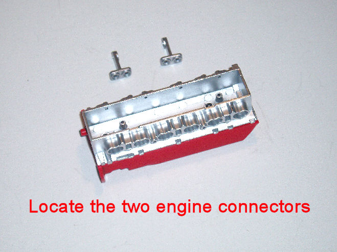

Locate the cylinder head, part 5D and the camshaft cover, part 5E.
Fit the two parts together. They will only fit one way.
Fix the parts together using 2 x AP screws.

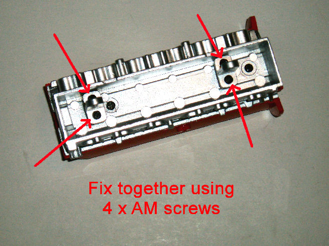

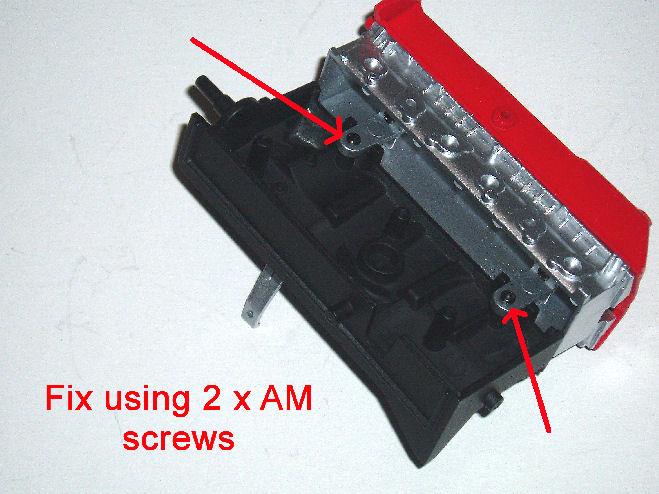

Put the two engine connecting pieces in place inside the cylinder head over the screw posts and fix using 2 x AM screws in each part.

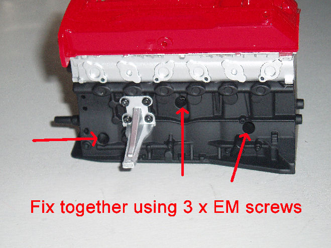

Locate the connecting pieces on the screw posts in the right engine block part.
The pieces only go together one way.

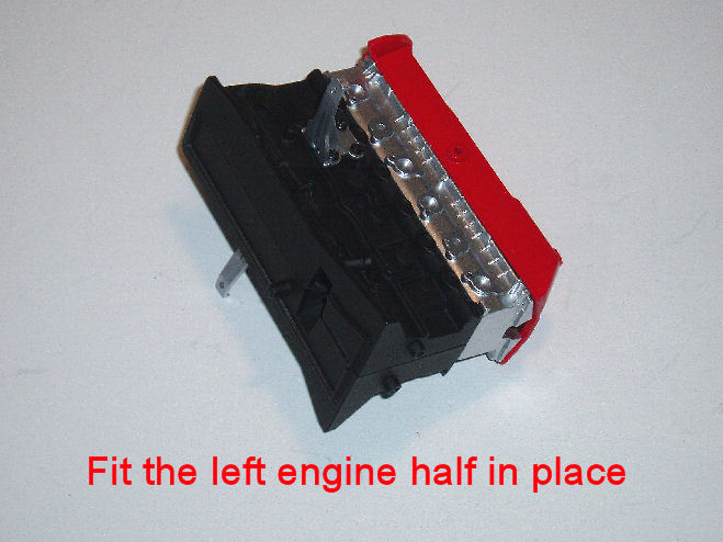

Fit the left part of the engine against the right half, so that all parts fit together properly.
Secure the parts using 3 x EM screws through the left half of the engine.

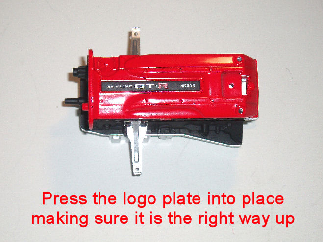

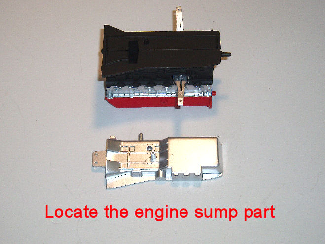

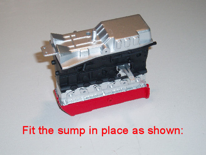

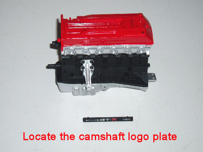

Turn the engine upside down and fit the sump – part 5C, in place and fix using 1 x EM screw.
Finally, fit the logo plate to the top of the camshaft cover making sure it is the right way round.
Press it firmly into place.
Store the assembly safely until later.
