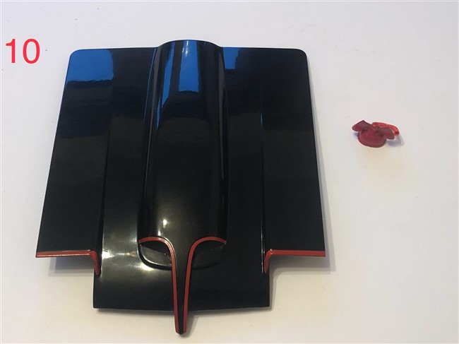

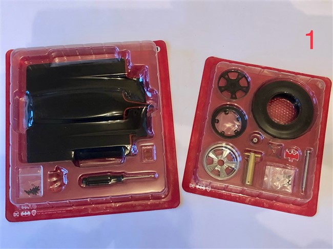

So here we go, supplied bat screwdriver at the ready.BigGrin The first two pictures show what you get in the first pack, and I have to say the parts are very impressive and well put together, and most of the parts are metal.Love
Fitting the Hood/Bonnet Frame
Picture 3

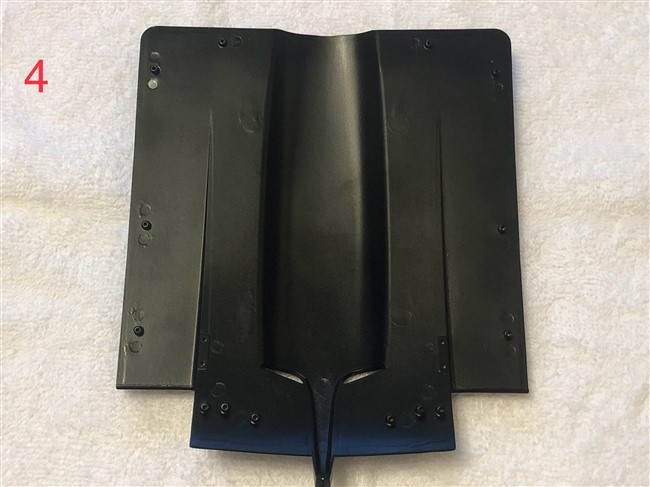

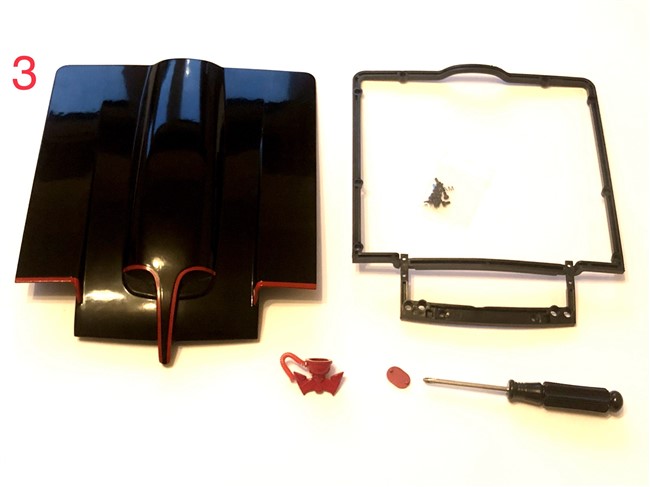

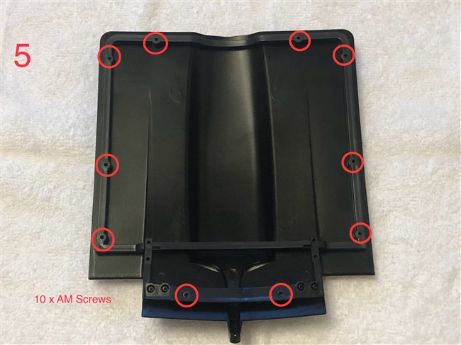

shows issue one’s parts unpackaged. Take the hood and lay it with the underside facing the top. It is recommended using a soft cloth to stop the paintwork from scratching, picture 4. Take the hood frame and lay it over the hood. As you can see you will be applying 10 x AM screws, with your new Bat screwdriver, as circled in picture 5. Picture 6 shows the screws in place.
Assembling the Bat-Phone

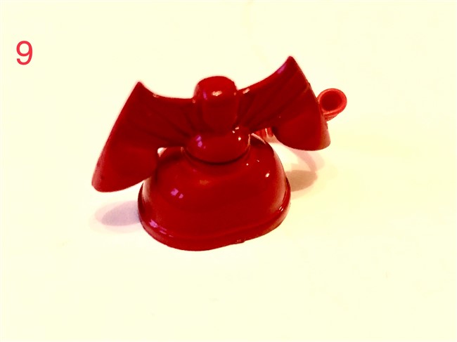

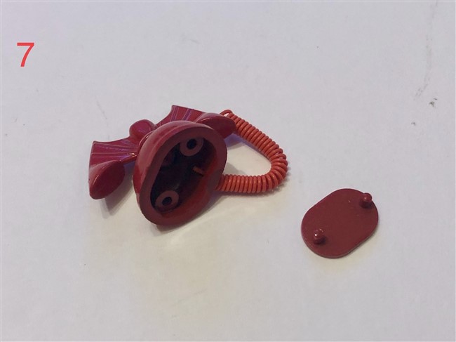

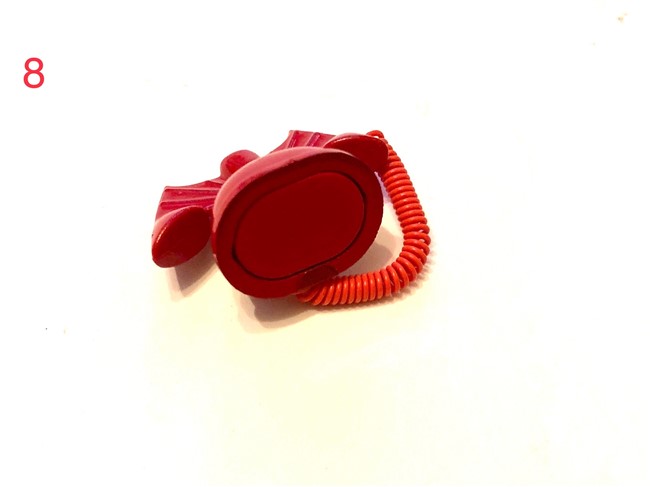

Take the Bat-phone and the bottom of the Bat-phone, picture 7 and push fit into place, picture 8. Picture 9 shows the completed Bat-phone.
Picture 10 shows the complete assembly for this issue.

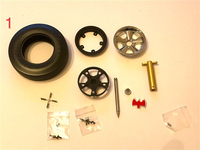

Picture 1 shows the parts for this issue.

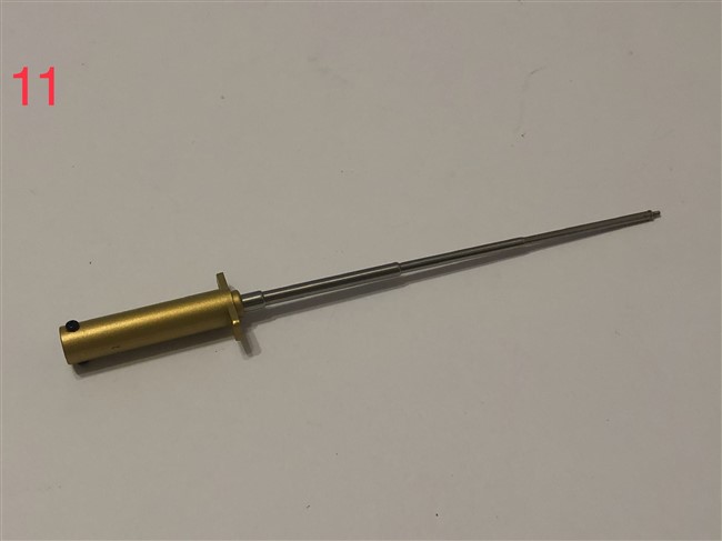

Assembling the Wheel

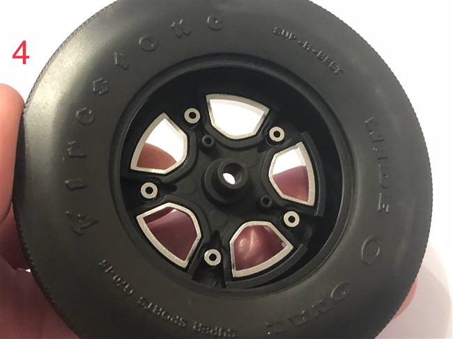

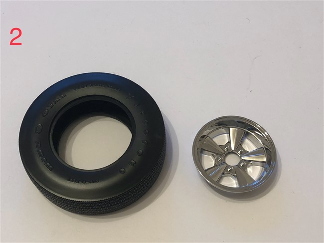

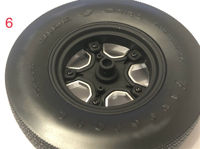

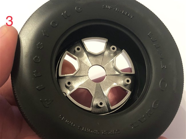

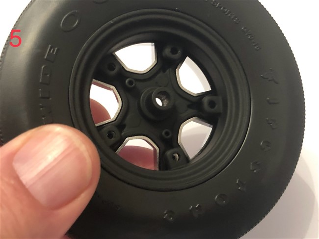

Take the tyre and the chrome wheel trim and place it into the tyre, picture 2. Turn the assembly over as shown in picture 3, and slot in the wheel centre, picture 4. Now place in the inner wheel lining up the screw holes as shown in picture 5. Secure with 5 x CP screws. Note: When fitting the screws, it is better to fit them all loosely and tightening them up once they are all in place, picture 6.

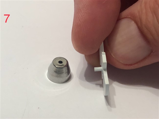

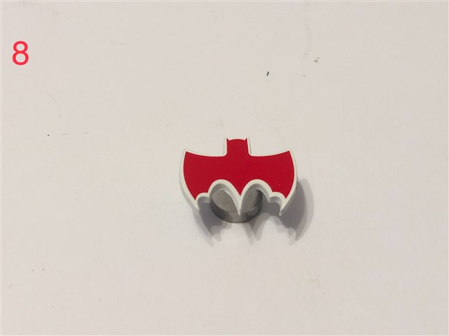

Take the centre cap, along with the Bat logo cap and push into place as shown in pictures 7 and 8.
Assembling the Antenna

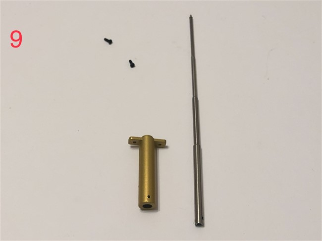

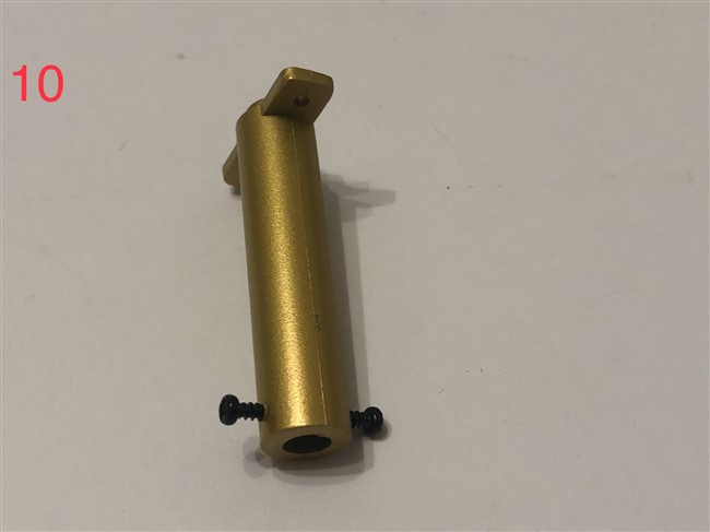

Begin by extending the antenna, picture 9. Take the antenna base and partly screw two EP screws into the holes, this makes it easier to fit the antenna into the base, picture 10. Now place the antenna into the base and line up the two holes in the antenna with the screw holes. Tighten up the screws so the base and antenna are one piece, picture 11.

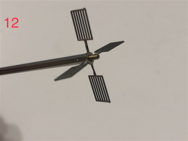

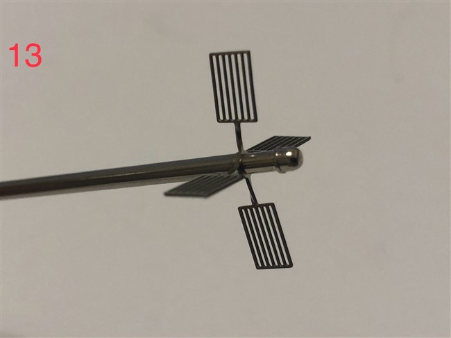

Take the antenna reflector and place over the top of the antenna as shown in picture 12. Finally screw on the antenna top to secure, picture 13.

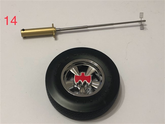

Picture 14 shows the complete assembly for this issue.
