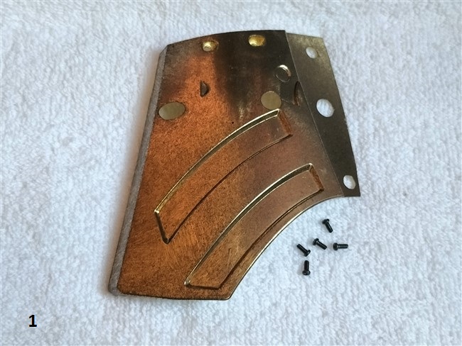

Gauntlet parts supplied..... Pic 1.

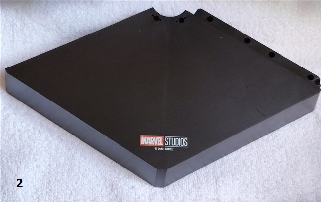

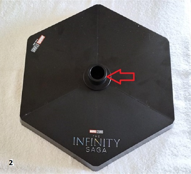

Base part supplied........... Pic 2.
Keep the base part safe for use in the near future. BigGrin

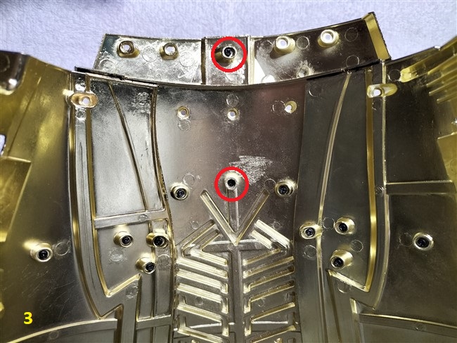

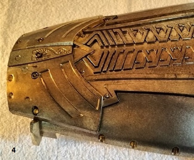

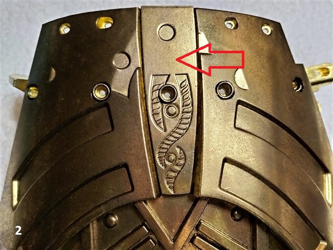

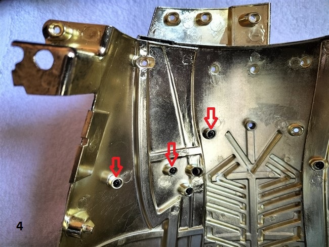

Start by placing part A64 onto the previously assembled forearm section as shown in Pic 3, Note: The main locating points are circled in yellow. Also make sure that all other locating points are fully engaged and plate A64 lies flat the the forearm plate.
Then whilst holding the parts together, turn them over and secure them using 3 x 01 type screws, supplied with this issue. Pic 4.
That`s it for this update. Pic 5

Base part supplied. Pic 2

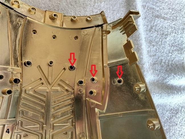

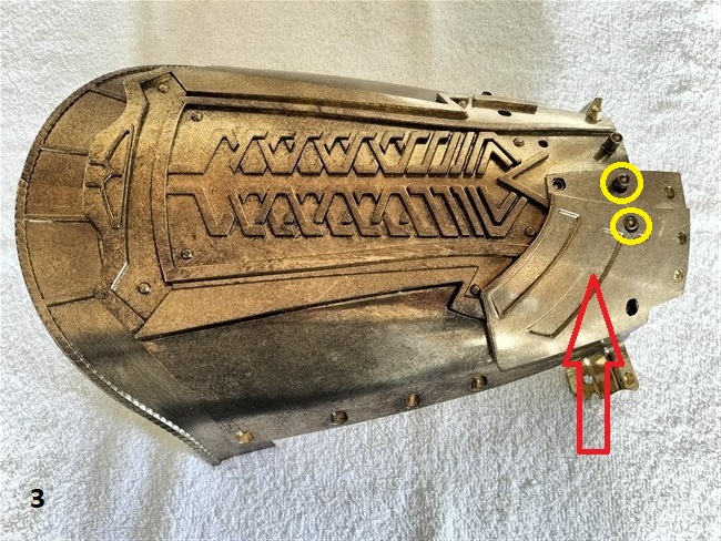

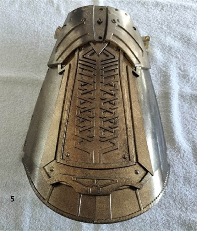

Start by positioning the armour plate A65 onto the forearm construction from Issue 42. Pic 3. Note: This part overlaps the part fitted in the previous stage, with the two main locating points circled in "Yellow". Make sure that all the location points are fully engaged and whilst holding the parts together, turn them over and secure them using 3 x type 01 screws supplied. Pic 4.
That`s it for this update. Pic 5.

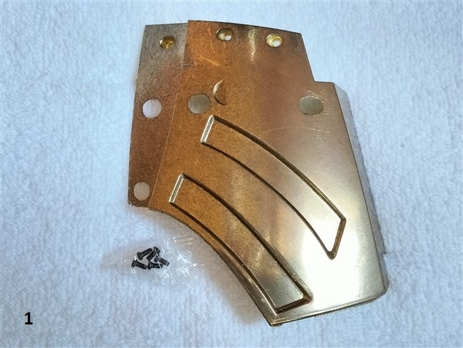

Here we go with the update for Issue 44.
I will post this in two parts: Part 1 for the Armour and Part 2 for the base.
Full parts supplied ......Pic 1.
Start by placing plate A66 onto the main forearm assembly from the previous stage. Pic 2.
Hold the parts firmly together, turn them over and fix them together using 2 x type 01 screws (black) as shown in Pic 3.
That`s all there is to the armour for this update Pic 4, will be back very soon with the update for the base. Just have to work out out how to get three large pieces to "Levitate" whilst I take the Pics. LOL LOL We`ll see. Blink

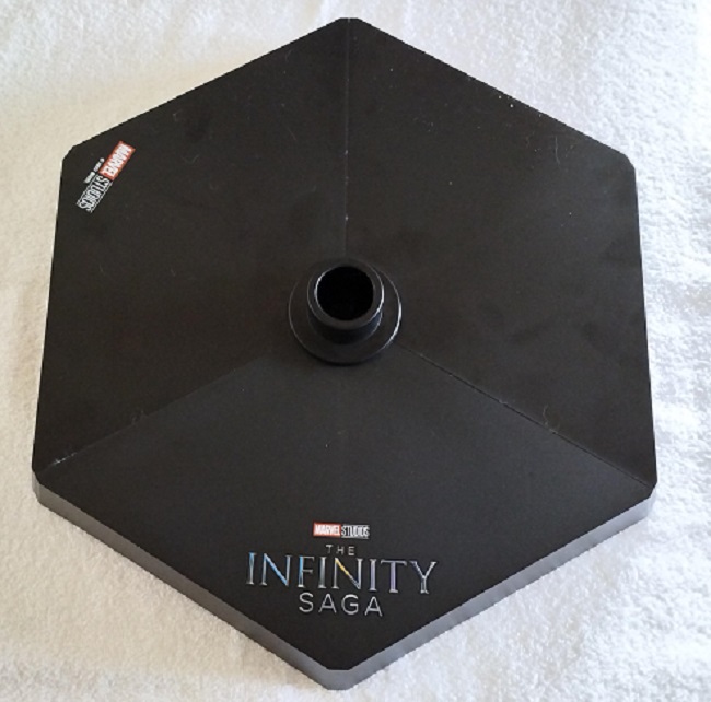

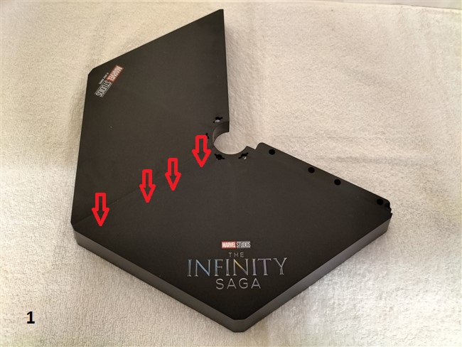

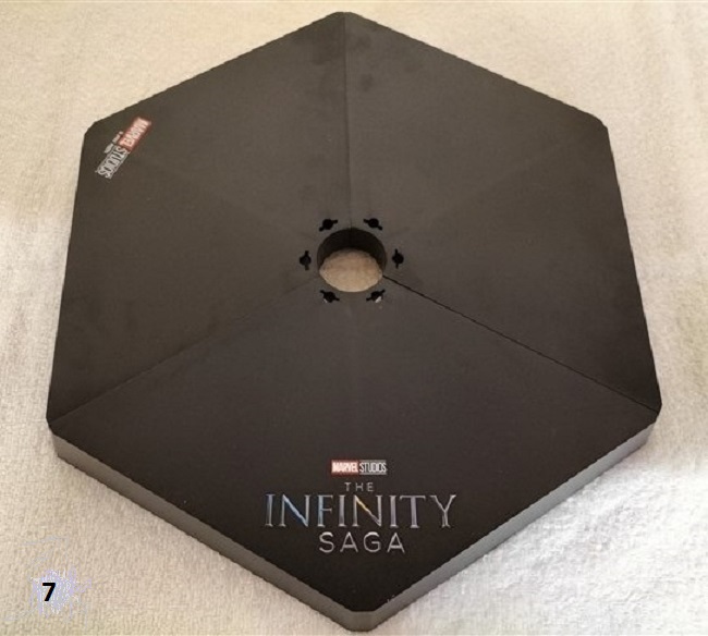

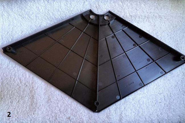

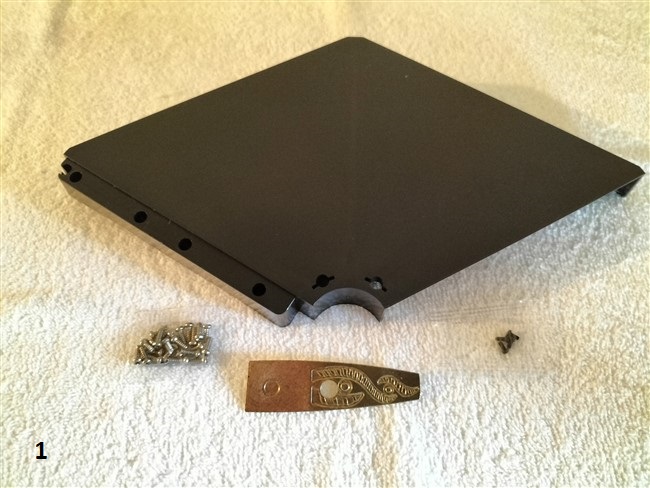

Here we are with the second part of Issue 44, where the build of the "standard" base begins. You will need to gather the three upper base parts and the three lower base parts, along with the type 02 screws from this issue.
As I have not been gifted with three hands, I changed my approach to the assembly of the three top parts.

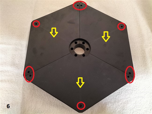

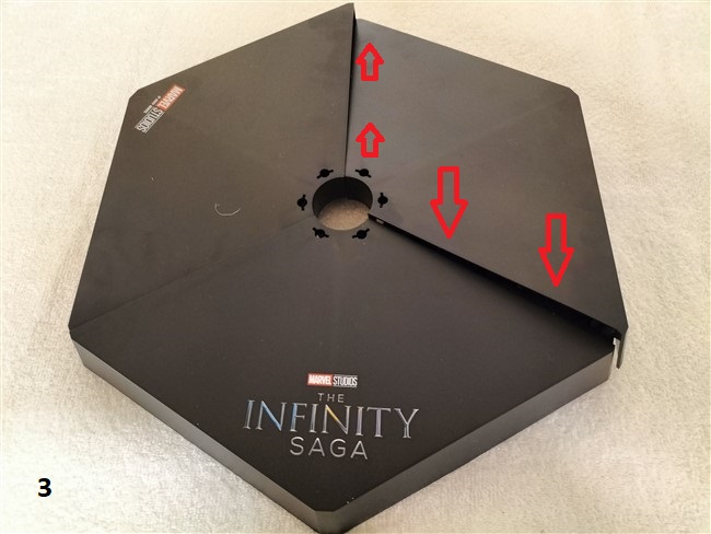

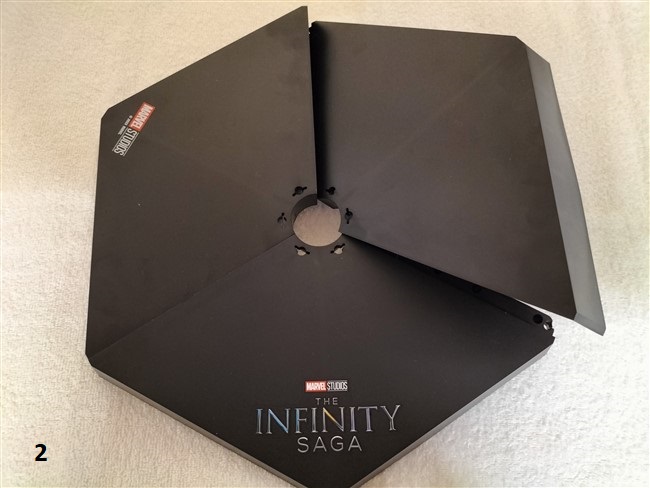

Take the two upper parts with logos on, locate the pins of one into the holes of the other and press them together. Pic 1. Then feed the third upper part in as shown in Pic 2. Locating all the pins into holes, gradually twist and press the joints together as shown in Pic 3 and 4.

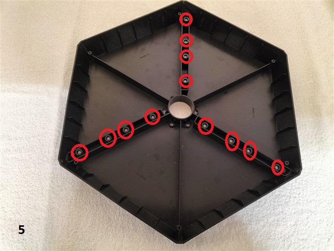

Now flip the base over and secure the three parts using 12 x 02 type screws. Pic 5.
Keeping the base in the same position, put the three lower base parts in place and secure them with a further 9 x 02 type screws as in Pic 6.
That concludes this part of Issue 44 Pic 7, with Issue 45 coming soon.

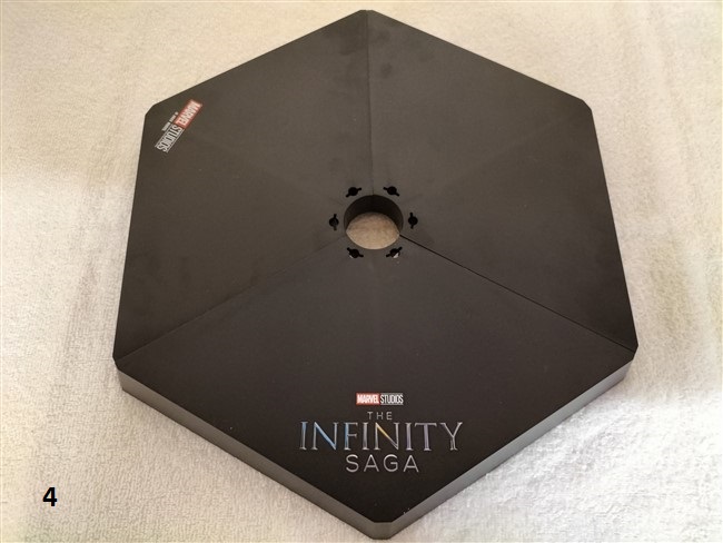

Start by pressing the part "base 03" into the centre of the top side of the base platform. Pic 2.

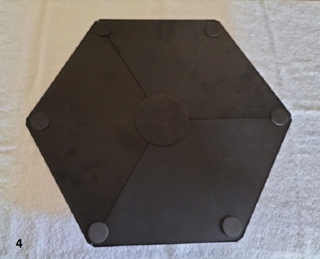

Whilst holding the upper part in place press the lower part of the centre section "base 04" into place and fix the centre parts using 6 x type 02 screws. Pic 3. Then keeping the base upside down stick the EVA pads in place over the screw holes. Pic 4.

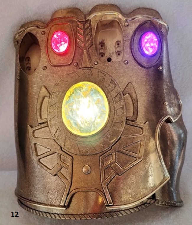

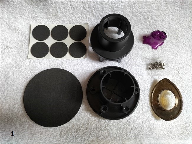

Well, here we are at the end of another pack. Update time for Issue 46. Cool
In this update we will build the "Power" stone.

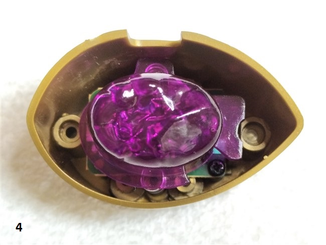

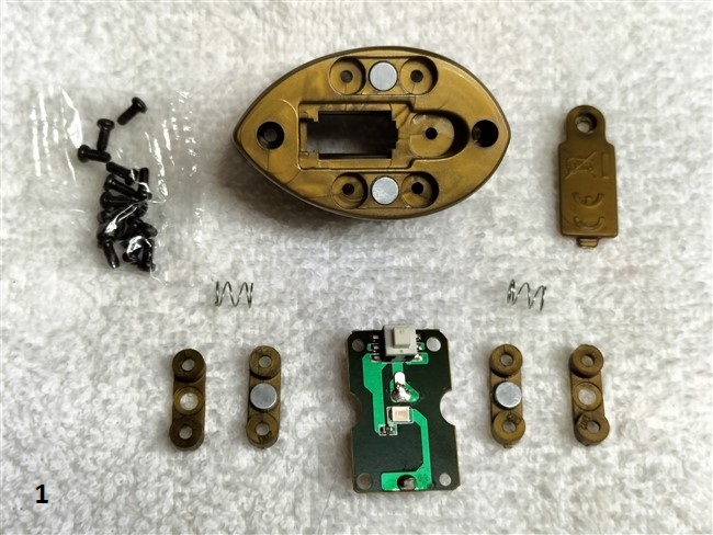

Parts supplied.....Pic 1. You will also need the two parts not used from Issue 45 and the back of the hand section of the Gauntlet.

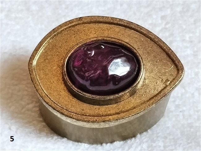

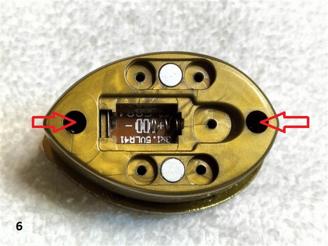

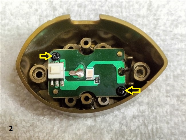

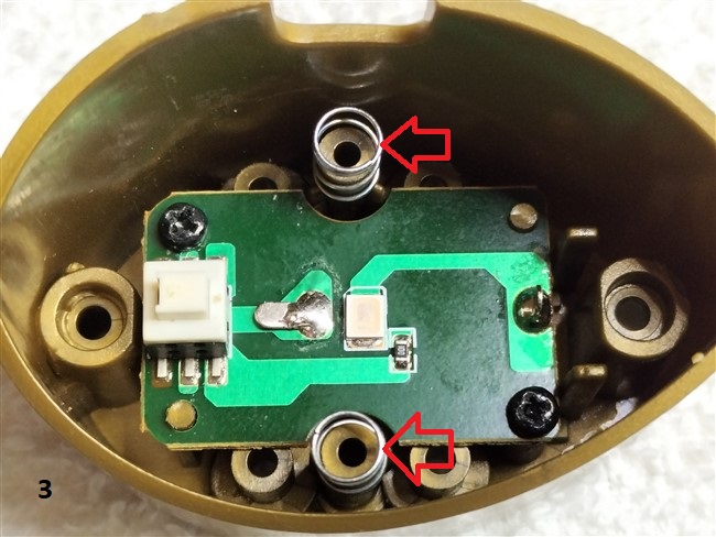

Start with the base section of the stone (C73), position the circuit board (Elec 04) inside and fix it in place using 2 x type 01 screws. Pic 2. Now place the two springs over the relevant posts as in Pic 3.
Next retrieve the stone and its surround from the previous issue. Place the stone as shown in Pic 4, place the surround over the stone Pic 5 and then whilst holding the parts together, secure them by the use of 2 x type 01 screws from beneath. Pic 6.

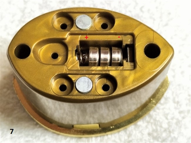

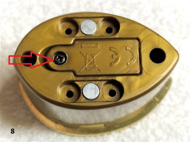

Take the supplied LR41 batteries and put them into the battery holder. Make sure the polarity is correct on all three, with the + sides towards the spring. Pic 7. Now position the battery cover and fix it in place using a type01 screw. Pic 8.

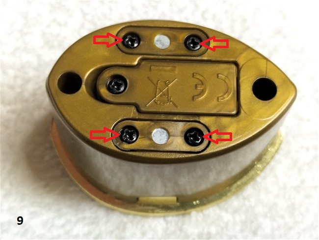

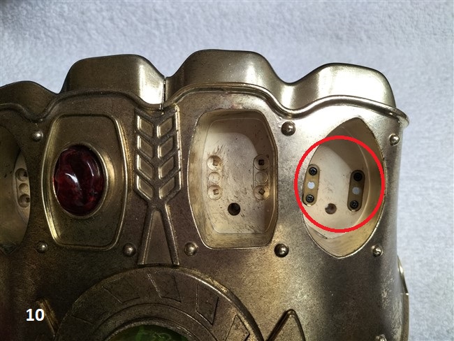

Next place the two parts D02 (without the magnets in them)over the magnets in the base of the stone and secure them with 4 x type 01 screws. Pic 9. Now fix the two parts D02 (ones with the magnets) into the right hand recess in the Gauntlet and fix them with a further 4 x type 01 screws. Pic 10.

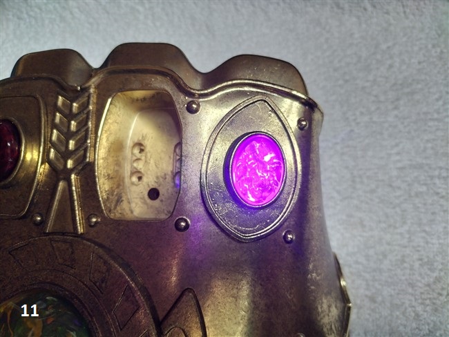

Fit and test the Power stone. Pic 11.
That concludes this update and finishes this pack. Pic 12.
