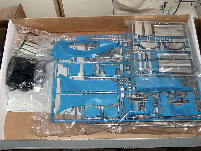

Ok, here's the other kit I'm going to start on shortly, alongside the Tamiya Tyrrell.
I like to have several builds on the go at the same time as it means I can get on with something else while waiting for paint or glue to dry.
It also means I can leave a certain part of a build that is driving me nuts (it happans...) and work on something else. Then I can go back to the annoying bit later.
I'm aware that this kit is horrible and very wrong in numerous places. I don't intend going mad and correcting it all but I will add some fixes and detail bits and bobs as I go along.

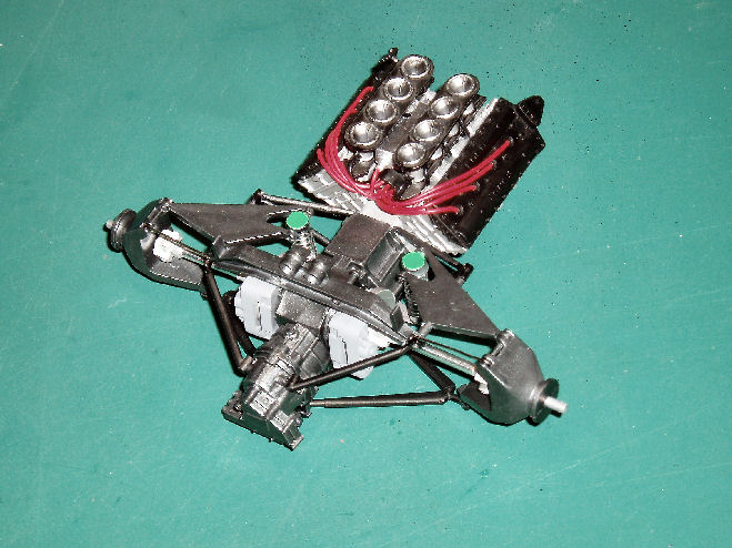

The first bits so far.
All pretty simple but the parts are a pretty poor fit, unlike the incredible Heller Citroen Traction I built a few years ago.
Lots of trimming and fiddling needed here.

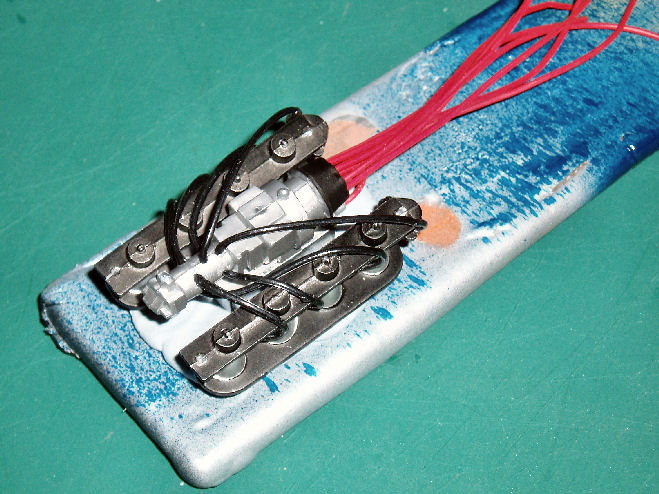

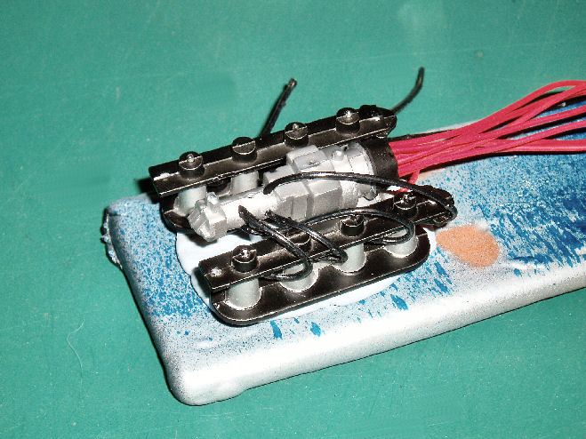

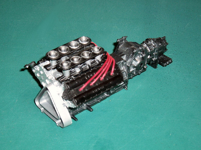

#3 Posted : 11 January 2024 11:30:27
Posts: 5,183
Points: 15,698

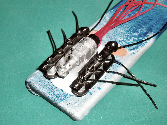

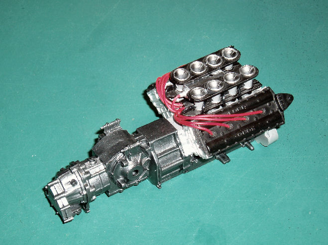

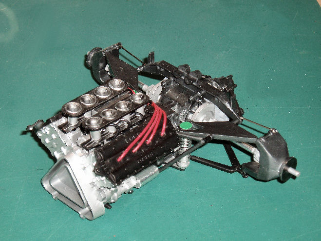

Ok - a bit more.

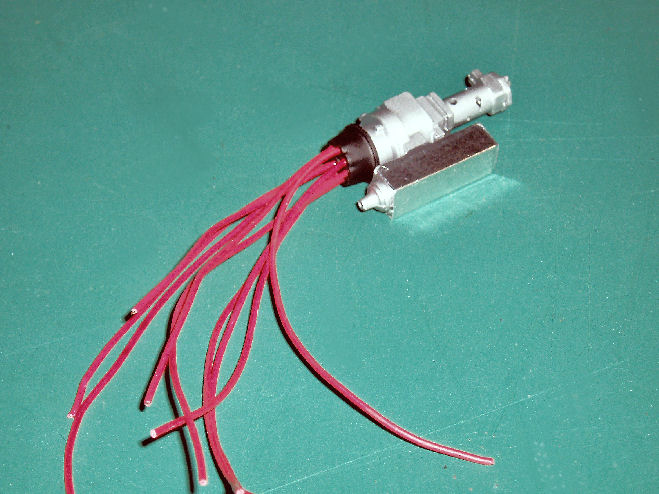

Following the kit instructions to connect the fuel lines is next to impossible.
It would mean that there is no way to make them a sensible length and they would be protruding all over the place a lot when assembled.

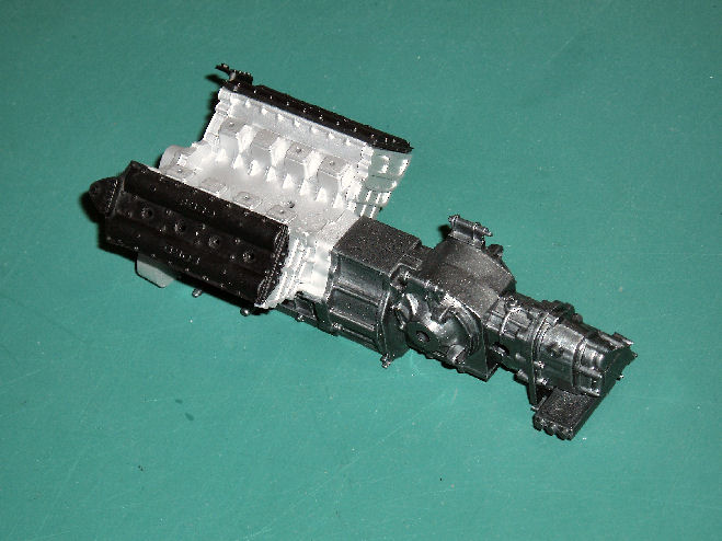

Therefore, I hit on the idea of mounting the required assemblies upside-down on a scrap of wood using Blu-tak, and cutting each fuel line to length before gluing it in place using cyano.
Once it was all sorted, I fixed the central coil/ignition system in place first, leaving the induction parts hanging loose.
When the central part was dry, the two sets of trumpets were attached.
After that, the plug leads were fitted.
I've gone for red leads to add a touch of colour.
Not prototypical, but hey ho.

Ok, I'm doing a bit more on this one for a while.
I might have mentioned it before but WOW, is this kit AWFUL!
Parts fit where they touch, stuff is warped out of shape, Bits are 'clunky' with lack of detail - I could go on.
However, we'll see how it ends up.
Some of the rear drive and suspension parts now added, and I'm beginning to put the central tub together which is a joke as the parts fit so badly.

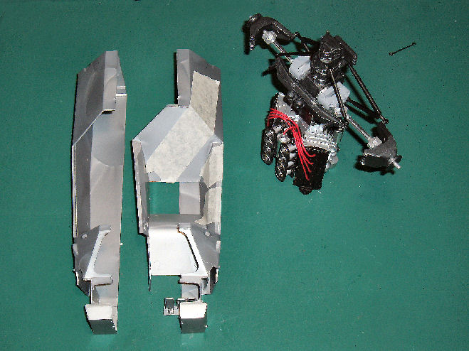

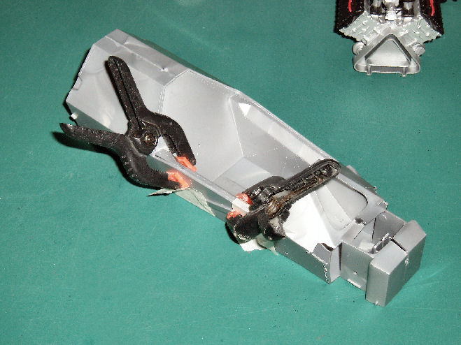

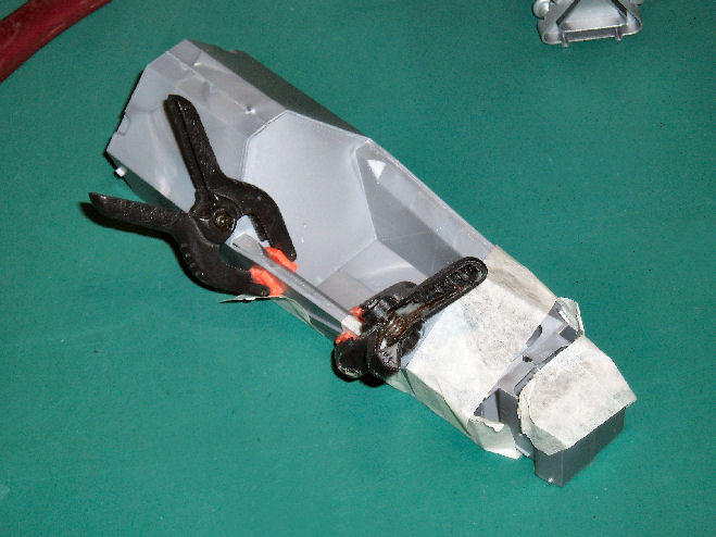

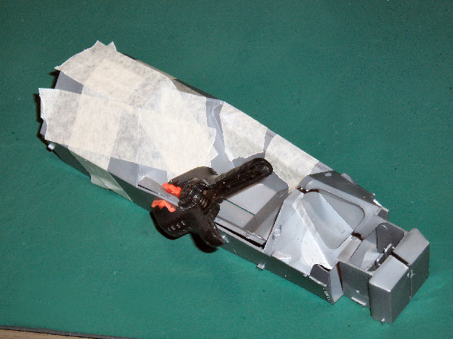

#5 Posted : 18 January 2024 10:29:12
Posts: 5,183
Points: 15,698
Let the hilarity continue...

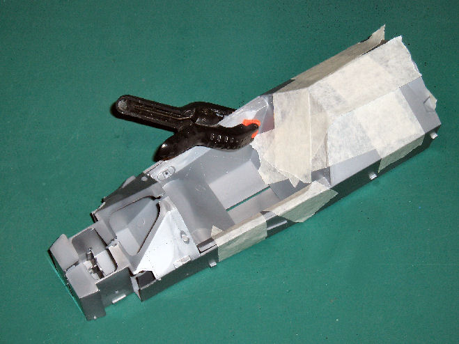

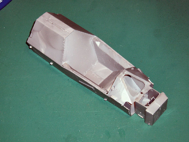

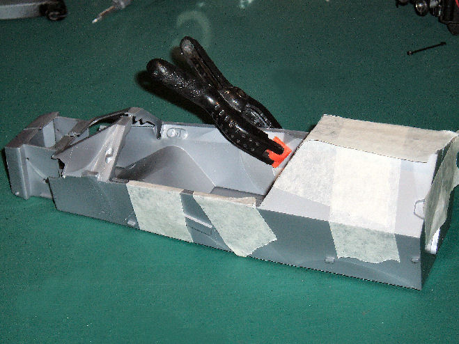

Over a 24 hour period I've been attempting to assemble the main body tub.
I say attempting, as I haven't finished yet so goodness knows how it will turn out.
I've had to glue, clamp and tape individual areas as I go along as the parts really don't fit together, almost everywhere.
The last bit of gluing and taping etc has just been done so it will be later today when I remove the tape and clamps to see the result.
Then there will no doubt be a fair amount if filling, trimming and sanding to do.
Oh - have I mentioned that this is an awful kit???LOL LOL LOL

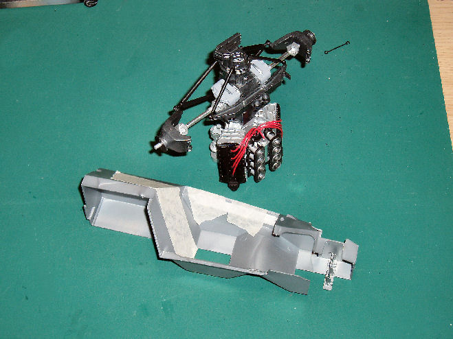

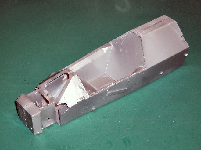

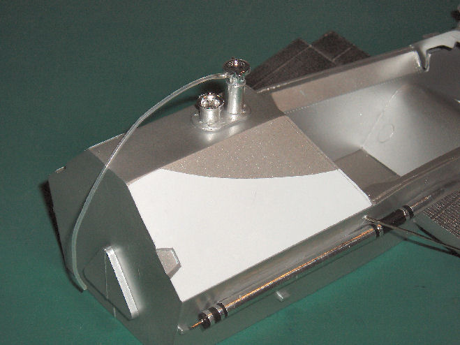

#6 Posted : 19 January 2024 13:10:49
Posts: 5,183
Points: 15,698

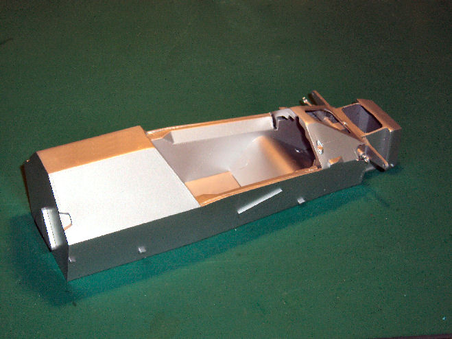

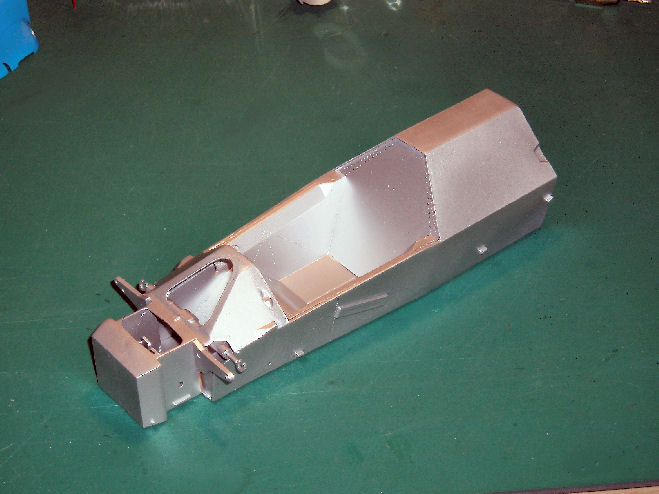

Right.
After a lot of rubbing down etc, the main tub is now ally silver all over.
Rear suspension parts and hubs now added.
The springs are laughable - as the kit doesn't contain any!
You get a plastic former, and are shown in the instructions how to wind a spring using thin wire, which they don't provide!
Luckily I have plenty of wire so not a problem.
Just another example of how naff this kit is.
(Have I mentioned that before?)

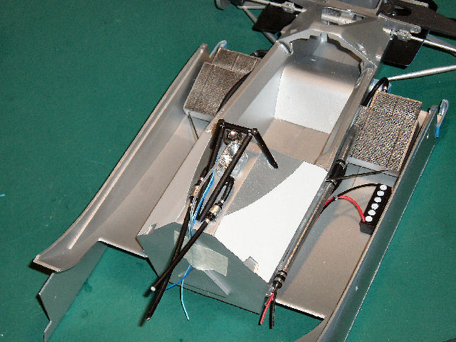

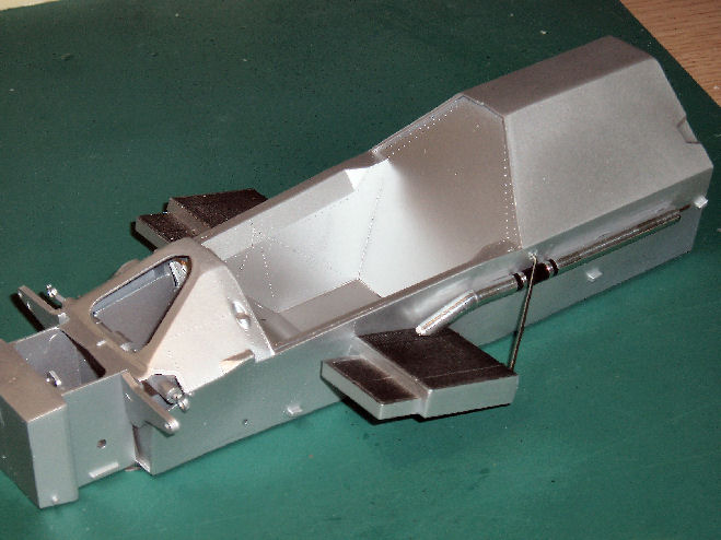

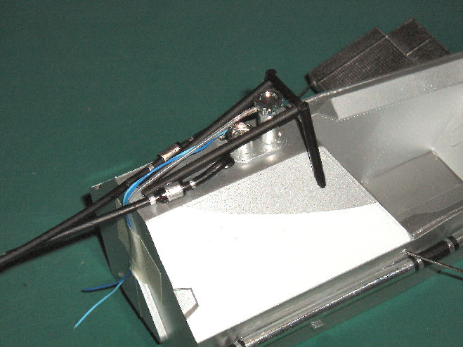

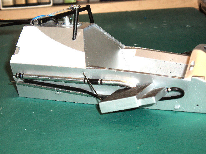

#7 Posted : 19 January 2024 18:32:04
Posts: 5,183
Points: 15,698

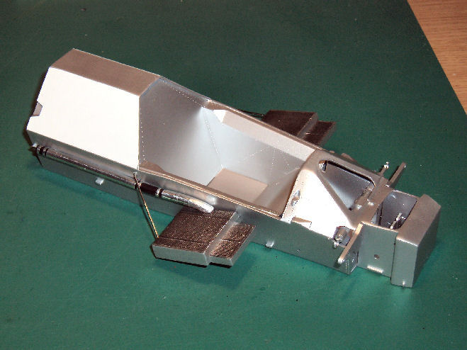

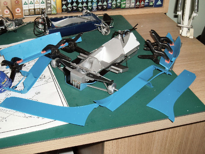

Time to start adding the plethora of missing bits to the central tub.
The first pic is the 'completed' tub according to the kit.
Apart from the two side radiators, there's nothing else.
According to my reference, there are LOADS of missing parts, pipes, wires, components - the list is BIG.
Plenty of scratch work ahead.
First off, two of the coolant pipes, and two radiator support rods.
MUCH more to scratch build and add.
Blink Blink Blink

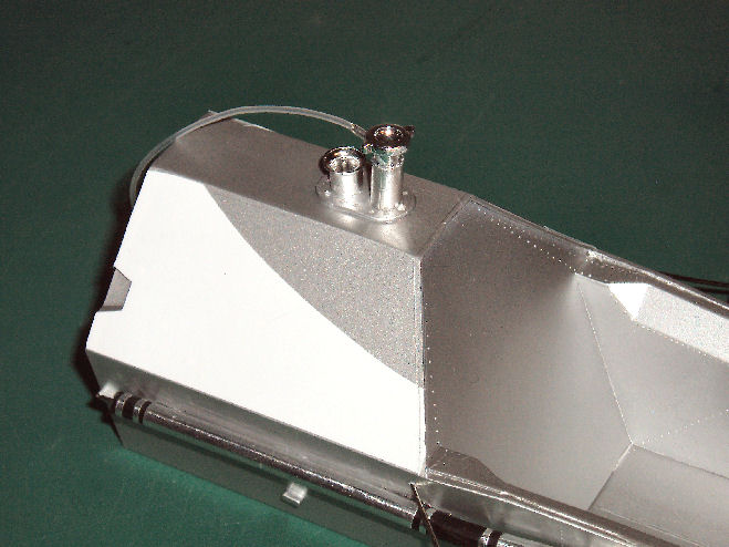

#9 Posted : 21 January 2024 12:06:33
Posts: 5,183
Points: 15,698
Many thanks Robin.
I can't imagine who it might have been that said this is a terrible kit...

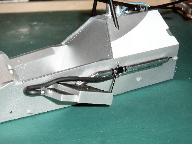

Another few missing bits added to the upper tub.
All scratch made from bits for my junk boxes.
LOADS more to go...
#10 Posted : 24 January 2024 15:22:30
Posts: 5,183
Points: 15,698

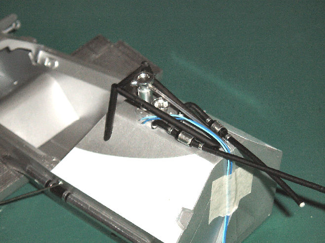

More missing parts on this one.
Everything on the upper side of the tub is scratch. The kit provides for none of it.
Still more pipes etc to go on the sides.
#11 Posted : 24 January 2024 19:01:51
Posts: 5,183
Points: 15,698
And a little more on the missing stuff.
Still more to add.

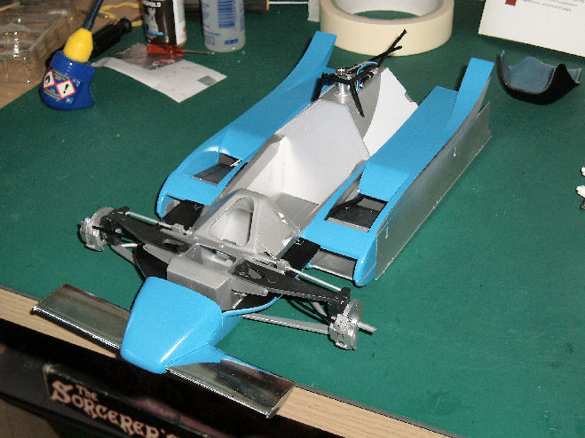

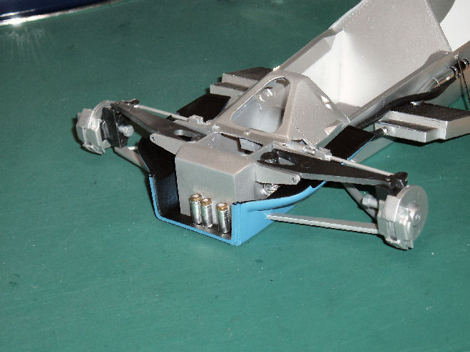

#12 Posted : 07 February 2024 17:38:18
Posts: 5,183
Points: 15,698
As with the 1/12 Tyrrell, I'm back on the Ligier too for a while.
Still adding missing bits - fluid reservoirs at the front - even though they can barely be seen when the model is complete which is why I haven't gone overboard on detailing them.
Still lots to add along the sides of the tub, but much of the next batch of add-ons fix to the floor of the side pontoons.
Just starting to put them together before paint.
Front uprights in place but brake pipes still to add.BigGrin

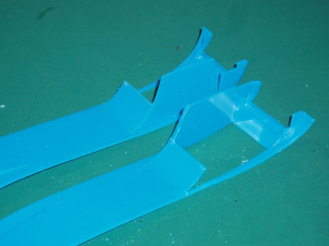

#13 Posted : 07 February 2024 23:34:32
Well done Roy, looking good you really amaze me how get round all of the problems.
Trev.

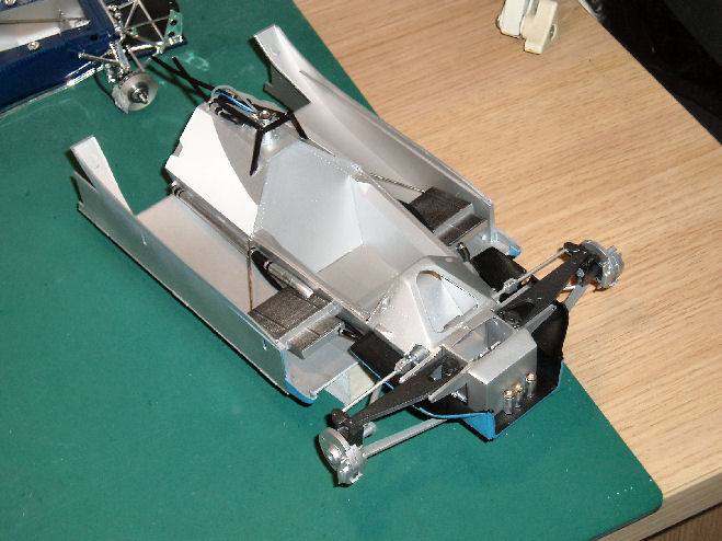

#14 Posted : 08 February 2024 14:10:55
Posts: 5,183
Points: 15,698
Many thanks Trev.
All I can say is, it's an 'interesting' build...

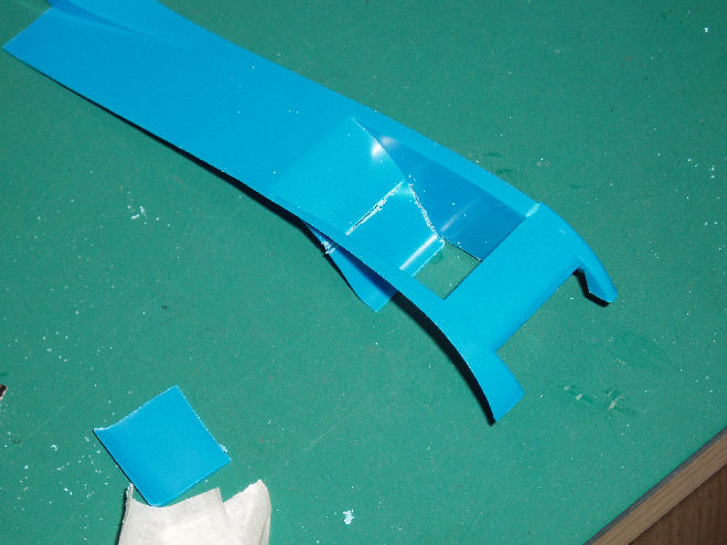

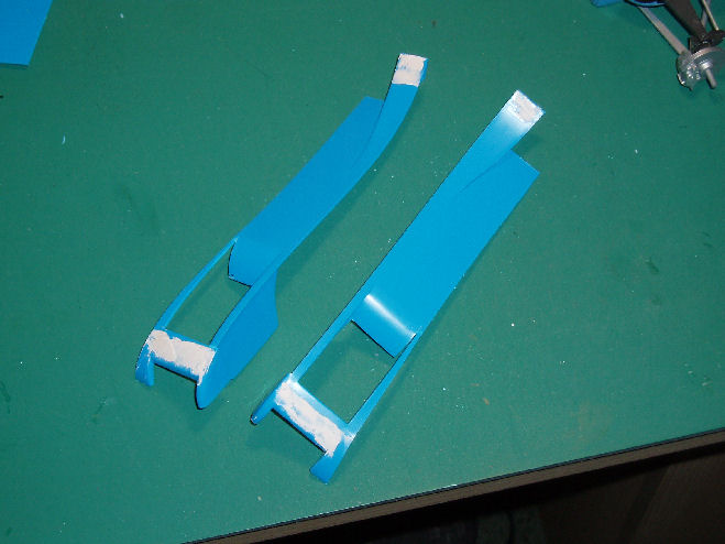

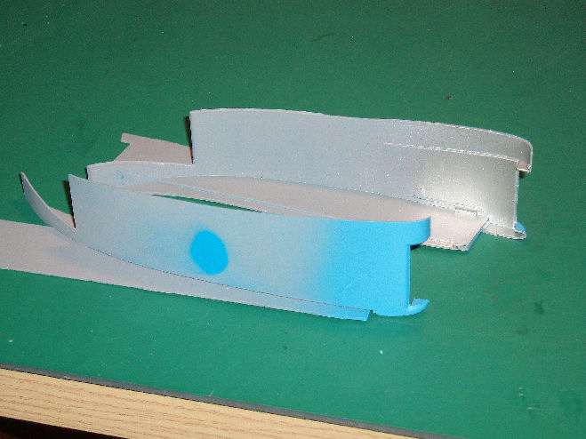

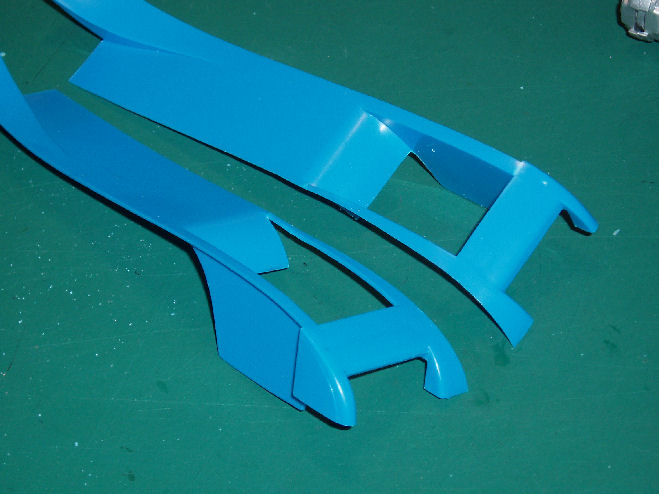

I'm moving on to the side pods now as the next bits of 'missing stuff' actually attach to the pod floors.
As the kit comes 'out of the box', the side pods are just glued to the central tub as one big piece - hence no internal detail.
However, I'm making the upper part removable which is why I'm adding the internal gubbins.
I've already found a mistake in the pod upper parts, where it curves down inside the pod near the front.
This is obviously done so that you can't see the pod interior is empty.
The curved part should stop level with the radiator which will allow the radiator supports and the water pipes to fit.
I've cut off the extra 'wrong' bit and added some filler to the sink marks in the upper surface.
On we go...

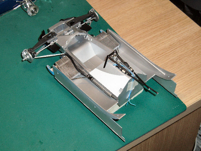

#16 Posted : 09 February 2024 13:48:48
Posts: 5,183
Points: 15,698
Many thanks Chris.

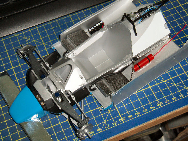

It's not going to be a mad amount of detail added, just enough so that it will look ok alongside Tamiya F1 kits. (I hope)

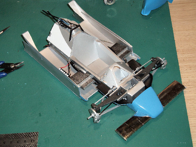

Lower side pods now painted, nose and wings assembled and fitted.
I've made a battery and put it in where there is one on the real car.
A few reservoirs and other bits of gubbins still to add to both sides.
BigGrin

#18 Posted : 10 February 2024 12:07:38
Posts: 5,183
Points: 15,698
Thanks Andy. (I might have hinted that this isn't a good kit...)
Anyway, side pod tops painted and just plonked on to check it works.
So far so good.

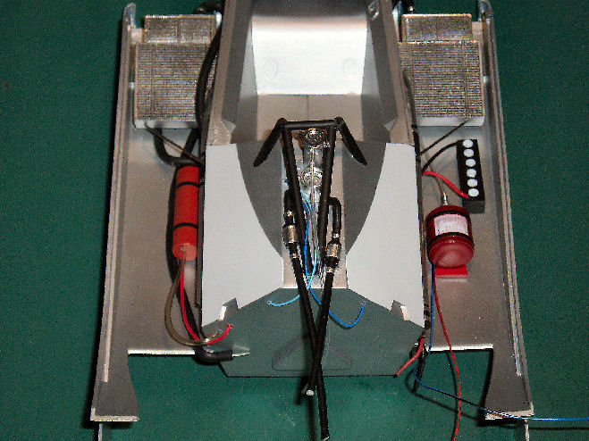

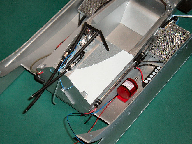

#19 Posted : 15 February 2024 11:57:40
Posts: 5,183
Points: 15,698

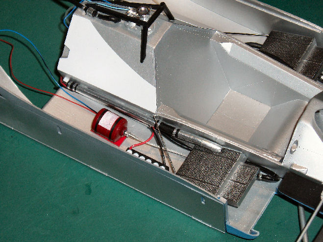

A little update on this one.
I've scratched the first of two cylinders - this one I'm guessing is part of the fire safety system.
I've copied it from one of my reference images.
Still another few pipes/tubes to add on this side, then there's another, different cylinder etc to go in the other side pod.
#20 Posted : 18 February 2024 11:28:49
Posts: 5,183
Points: 15,698
More gubbins in the side pods.
I've scratched the second cylinder for the other pod. This one is shorter and fatter, and a darker red as per my reference pics.
I Googled the fire extringuisher label and printed the decal.
Side panels and the seat to fit next, and then back onto the engine and rear end.
