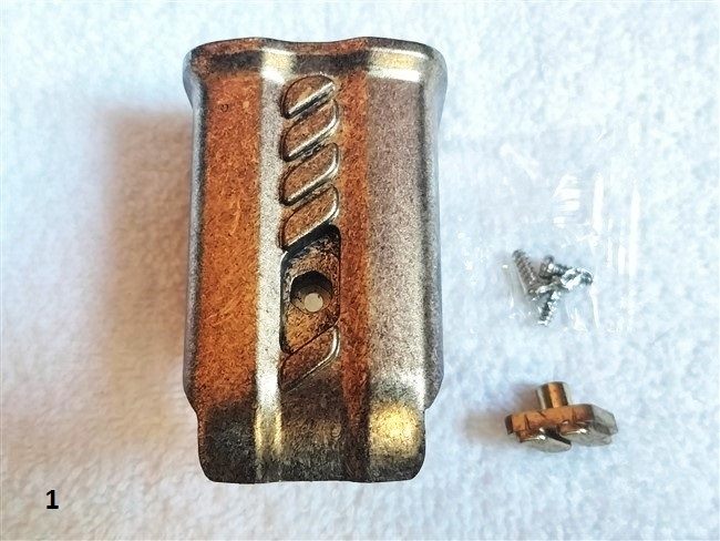

Parts supplied ...... Pic 1.

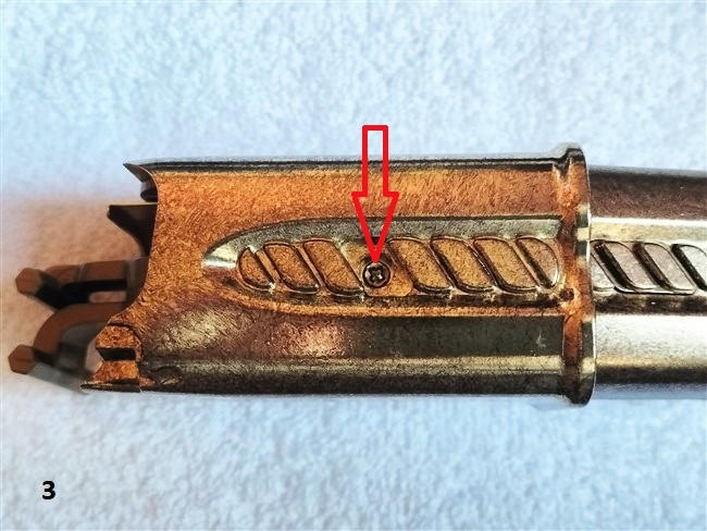

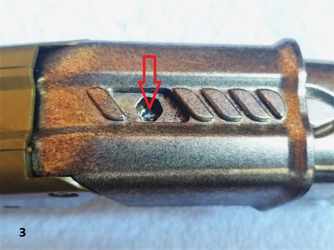

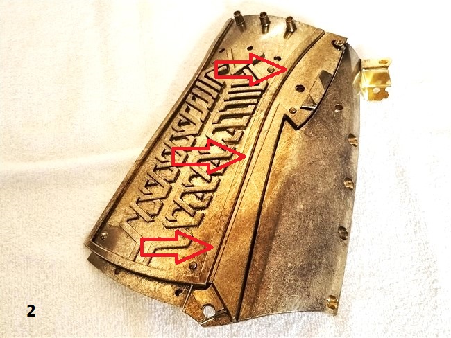

Fit the large piece of armour A21 over the finger as shown in Pic 2, making sure that this is placed squarely over the finger as it is a snug fit. When fully located use an 02 type (silver) screw to keep the armour plate in position, Pic 3. Part D08 which forms a screw cover and completes the pattern of the armour is now pressed into position as shown in Pic 4.
That completes this Issue, Pic 5.

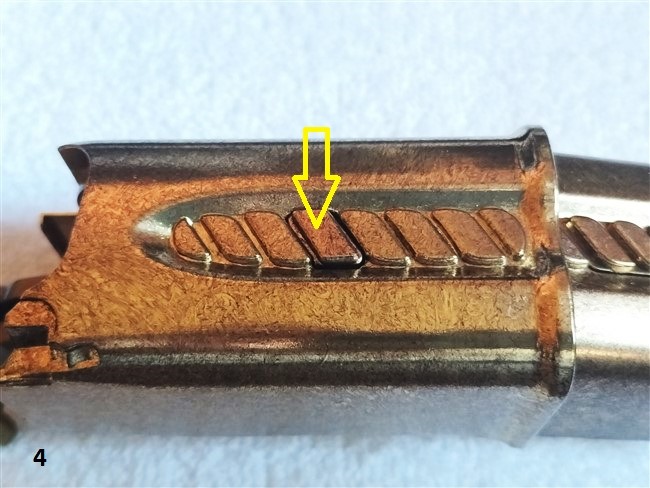

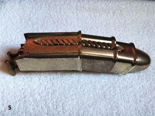

Well this update is for Issue 33 of the Gauntlet.
This update , like the last is not long and it finishes the Index Finger apart from putting it in its final position in the Gauntlet.

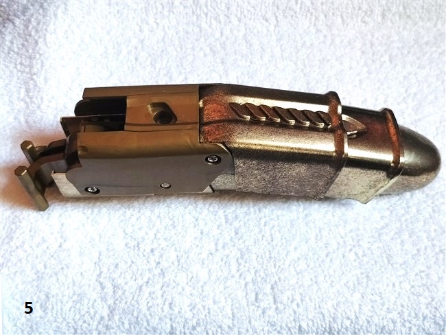

Parts ..... Pic 1.

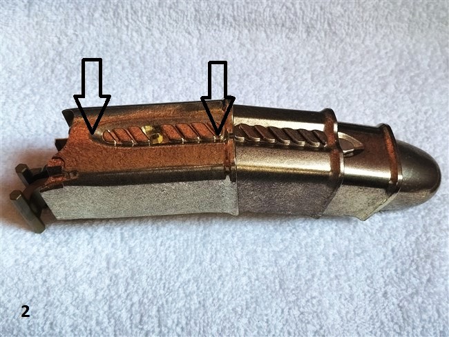

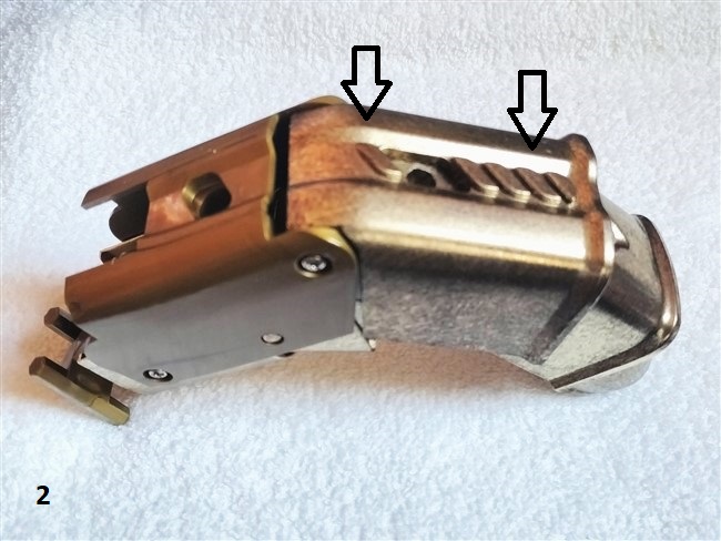

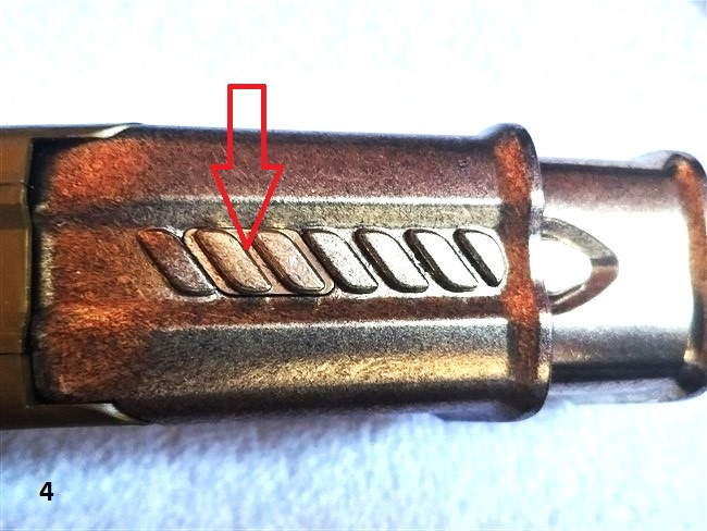

Start by fully engaging the large armour piece (99A) over the lower end of the finger. Pic 2. Then secure the part by using an 02 type (silver) screw. Pic 3. Finally press the screw cover that completes the pattern of the armour into place. Pic 4.
Blink Blink That`s it for this update. Pic 5. Carefully store the finger until required later, so that no damage occurs.

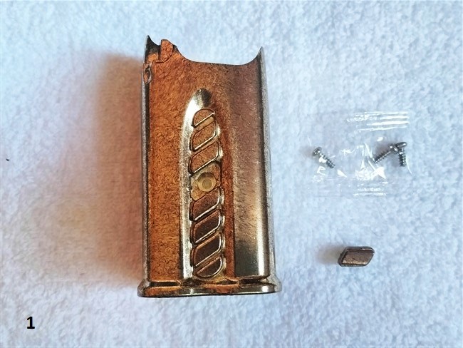

Part supplied .... Pic 1.
Yep that`s it folks. Please don`t shoot the messenger, I don`t design the distribution of parts throughout a build.Crying

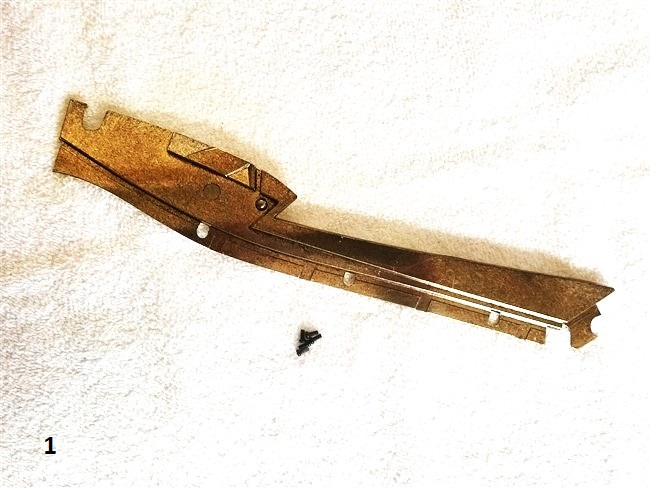

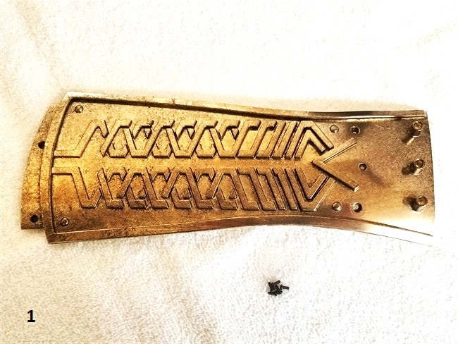

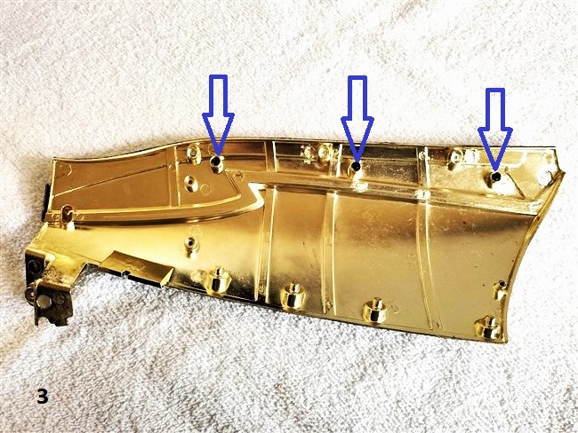

Parts ….. Pic 1.
You will also need the part from Issue 34.

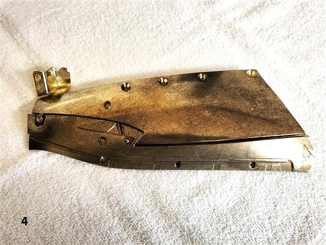

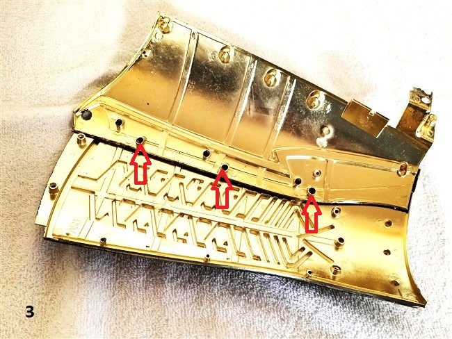

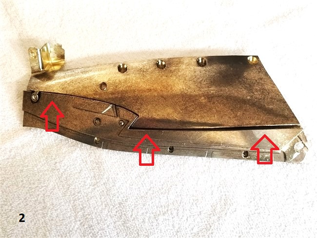

Start by bringing the two plates from Issues 34 and 35 together, making sure that the posts fully engage into the holes so that the parts lay flat against each other, Pic 2. Then whilst holding the parts together, fix them together by using 3 x type 01 screws (black) Pic 3. NOTE: If the screws won`t fully tighten, just turn them back half a turn to clear the thread and all should be ok. Don`t force them or you may strip the thread / snap the screw.
That`s it for this update, Pic 4.

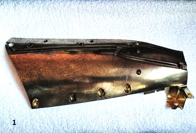

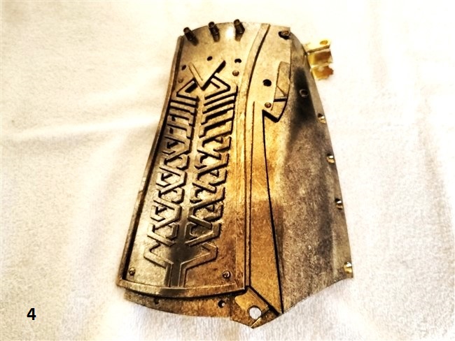

Bring the assembly from Issue 35 and locate the plate from this issue as shown in Pic 2. Holding the parts together, turn them over and fix them together using 3 x type 01 screws (black) Pic 3. NOTE: Be careful with them screws as before.
That`s it for this update Pic 4.

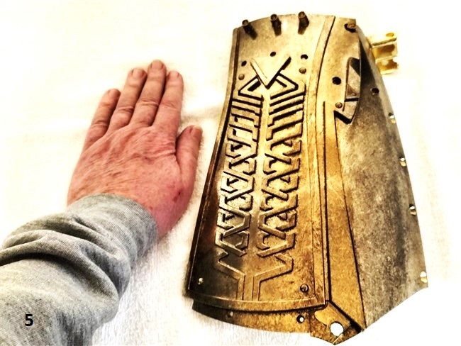

For an insight into the scale of this model, especially for those following but not building it I have added Pic 5. These plates make up the forearm guard that goes from the wrist approximately half way up the forearm.
