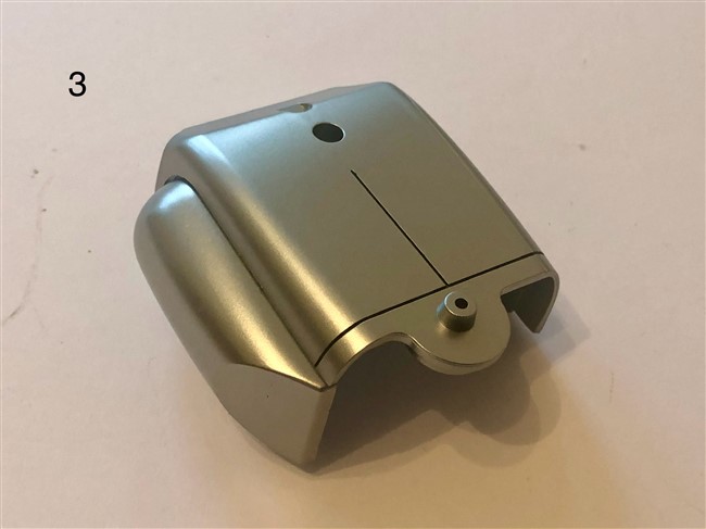

#1 Posted : 19 November 2023 17:08:32
Issue 7

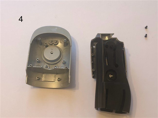

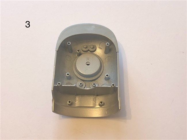

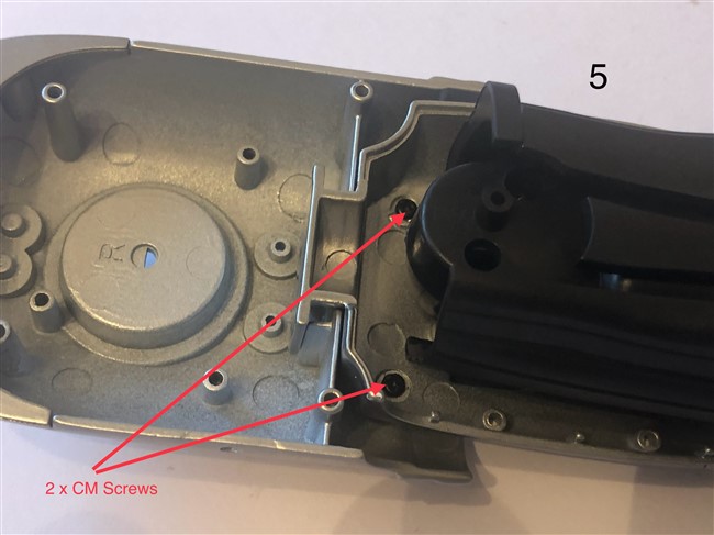

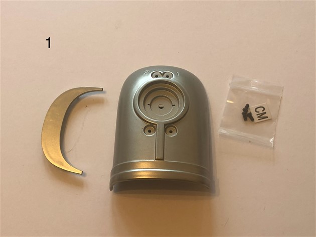

The Right Shoulder
Picture 1
shows the contents of this issue.

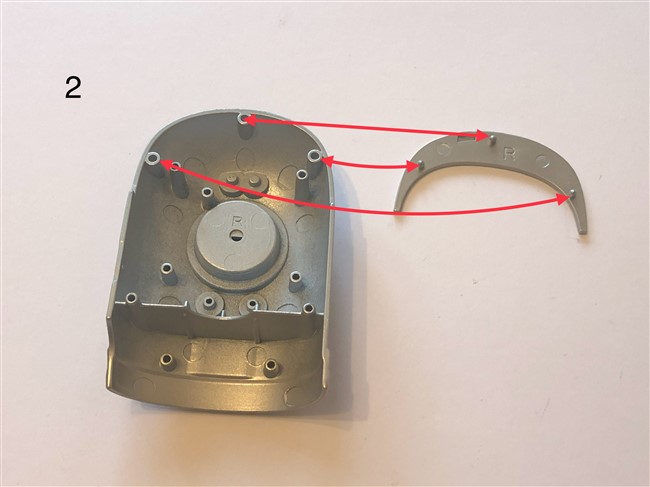

Assemble the outer right shoulder cover as shown in pictures 2 and 3.
Take the assembly you did in issue 6 and using 2 x CM screws attach it to the shoulder cover as shown in picture 4 and 5.
Picture 6 shows the final assembly for this stage.
That completes this issue.

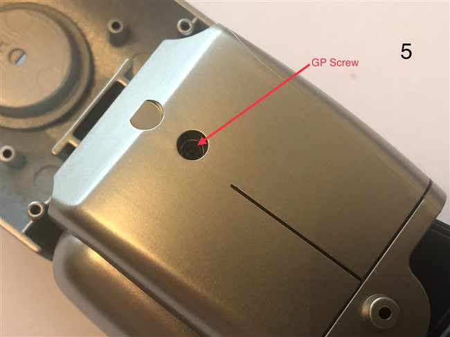

#2 Posted : 22 November 2023 20:50:30
Issue 8

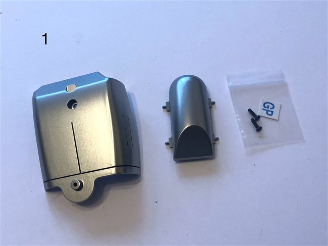

The Right Arm
Picture 1

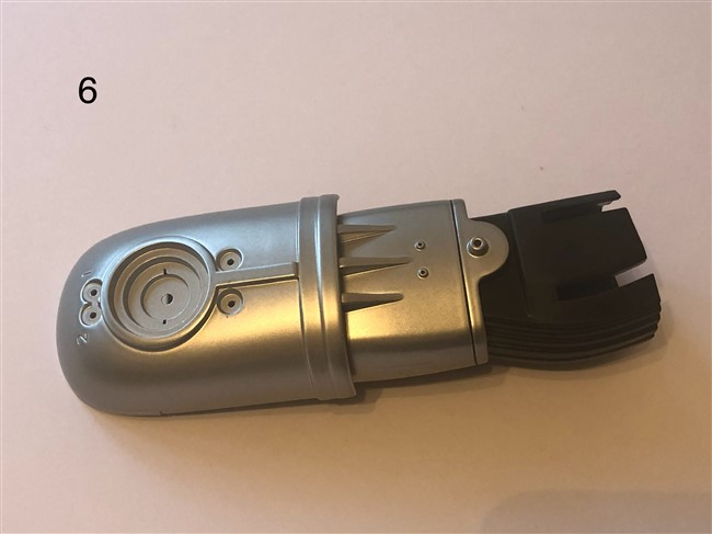

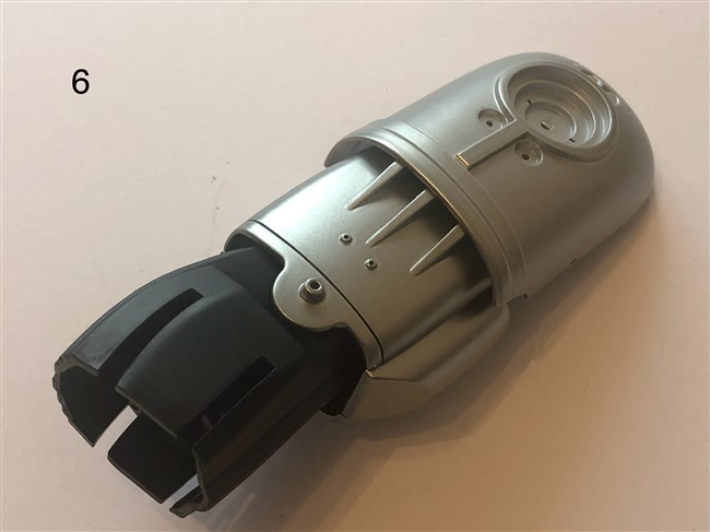

Fit the front arm cover onto the side of the inner cover as shown in picture 2. Apply a little pressure until the two pins clip into the holes. Picture 3 shows the attached assembly.
Next, align the assembly onto the arm assembly from issue 7. I found that lining up the centre hole and partially screwing in the GP screw slightly, helped with the alignment. Make sure the two pins slide into the holes as shown in picture 4. Picture 5 shows the assembly attached with the GP screw.

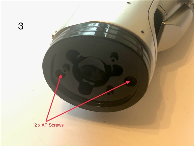

Issue 9
The Right Arm
Picture 1

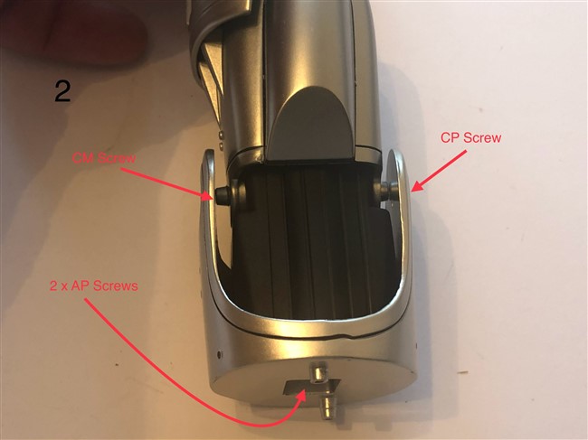

Insert the right forearm (9a) so that it fits with the two posts of the assembly you did in issue 8. Firstly, secure the bottom of this part with 2 x AP screws, picture 2.
Note: I had to jiggle it around a bit to get the screw holes lined up. Now secure the two posts with an CM screw one side and a CP screw the other side, this is again shown in picture 2.

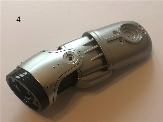

Connect the middle right forearm, (9B) to the upper forearm, it should only fit one way. Secure with 2 x CM screws, picture 3.
Picture 4 shows the final assembly for this stage.

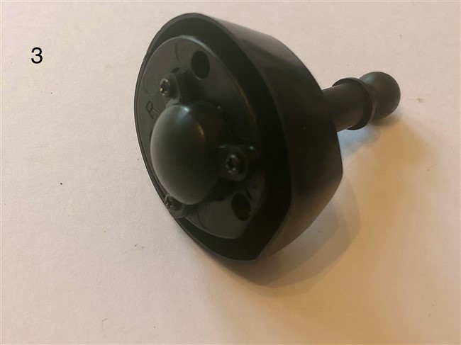

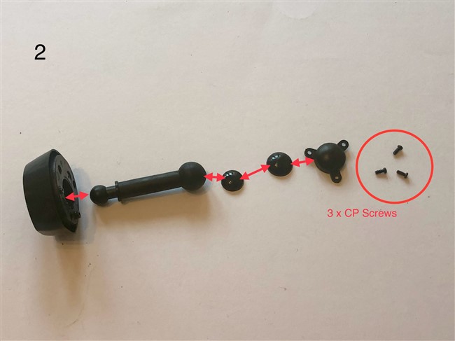

Issue 10
The Right Arm
Picture 1

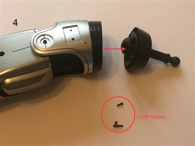

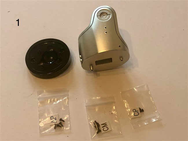

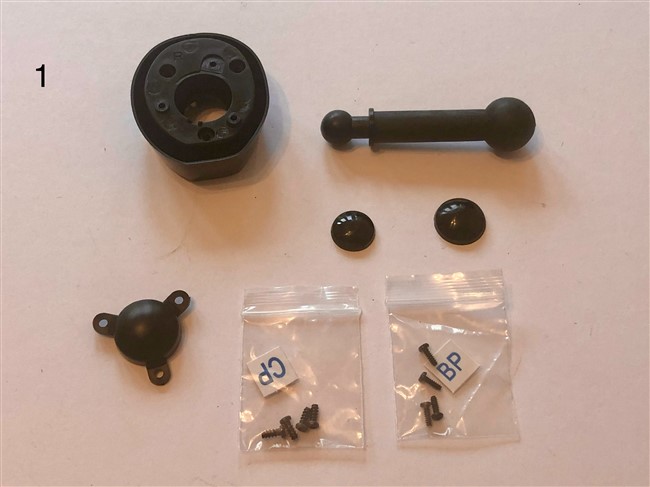

Insert the wrist joint (10B) within (10A), making sure the thinner end of the part is inserted first. Now place the friction block (10D) over the smaller friction block (10E). Holding the assembly together, fit over the parts onto the wrist joint (10B) and hold in place whilst fitting the joint bracket, which only fits into one position, and securing the assembly with 3 x CP screws, pictures 2 and 3.

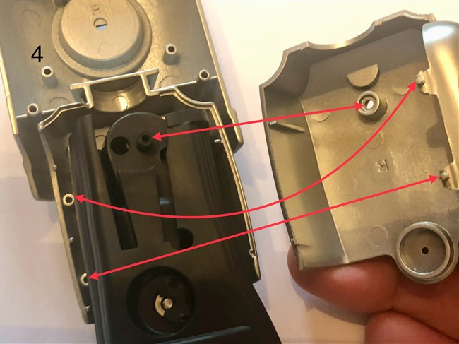

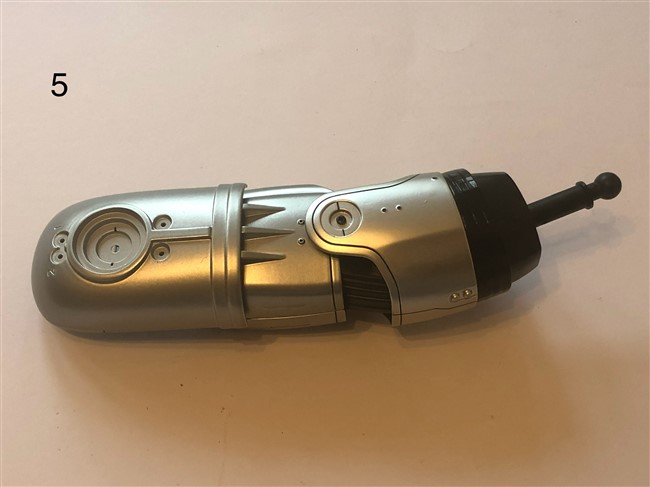

Attach this assembly onto the assembly you made in the previous issue, and secure with 3 x BP screws, picture 4.
Picture 5 shows the final assembly for this stage.
