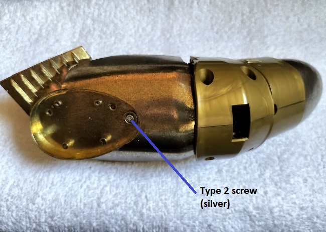

Retrieve the thumb assembly from the end of issue 16. Then place part A71 (from this issue) onto the base of the thumb and secure it in place using an 02 type screw (silver). Pic 2.
It`s as easy as that, Blink update completed.

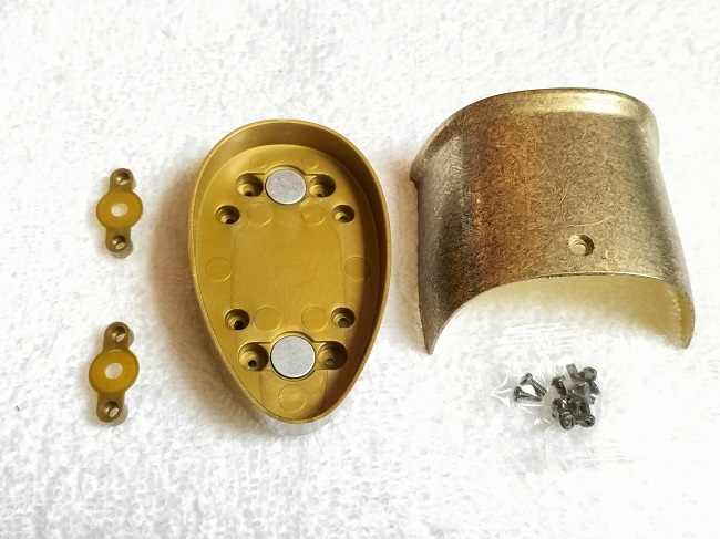

Parts supplied shown in Pic 1 as usual.

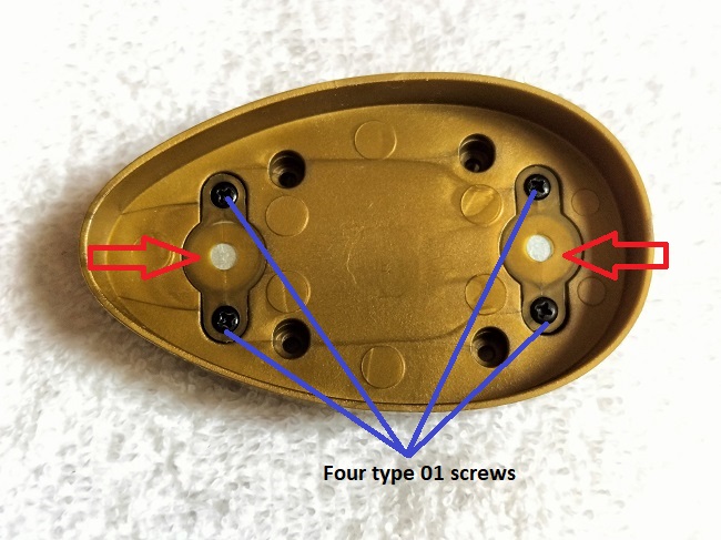

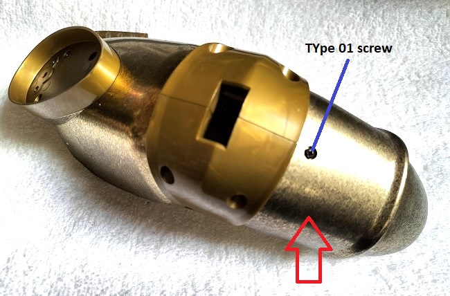

We start by positioning the two magnet holders (D03) over the magnets and secure them using four x type 01 screws. Pic 2.

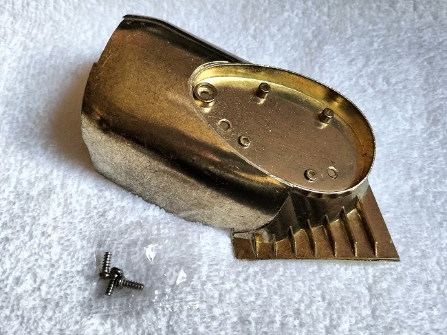

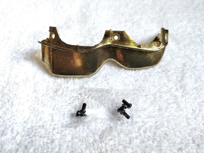

Bring the thumb assembly back from the previous issue and place the parts from the last step in place, securing them with four more type 01 screws. Pic 3.
Part A72 is now placed onto the top of the thumb assembly (between the tip and the central knuckle) and is secured by the use of an 01 type screw. Pic 4.

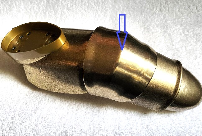

That concludes this update and your thumb assembly should be the same as in Pic 5.

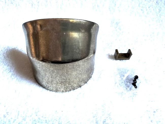

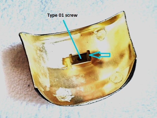

Parts for this issue are shown in Pic 1.
The first part of this update is very easy, so position part D04 inside part A73 and secure them together with an 01 type screw. (black) Pic 2.

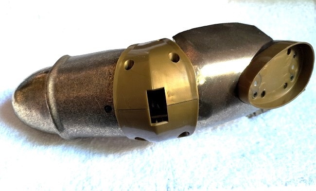

Part A73 can only fit in one orientation, that can be seen by the ridges and lines in the part. By placing the part over the thumb you should see how the parts line up. When happy with the line-up of the parts, part D04 (inside A73) should be directly above the oblong hole in the central thumb joint. Now make sure that the parts stay in line and whilst holding the thumb from the underside, press A73 down onto the thumb. Part D04 should click into place and form the armour plate for the central knuckle joint of the thumb. Pic 3. Another point to note is that the Arrow in Pic 3 is where you need to apply pressure to lock the parts together.

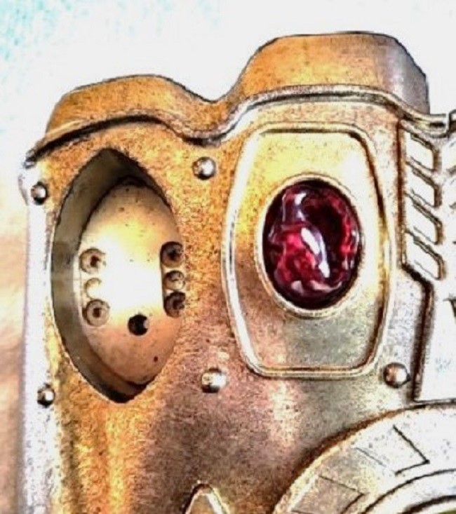

Issue 20 parts are shown in Pic 1.

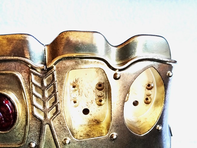

Recover the assembly for the back of the Gauntlet (Issue 10) and remove the stones if you have kept them in place. This will prevent any damage to them while you work on the inside during this update.

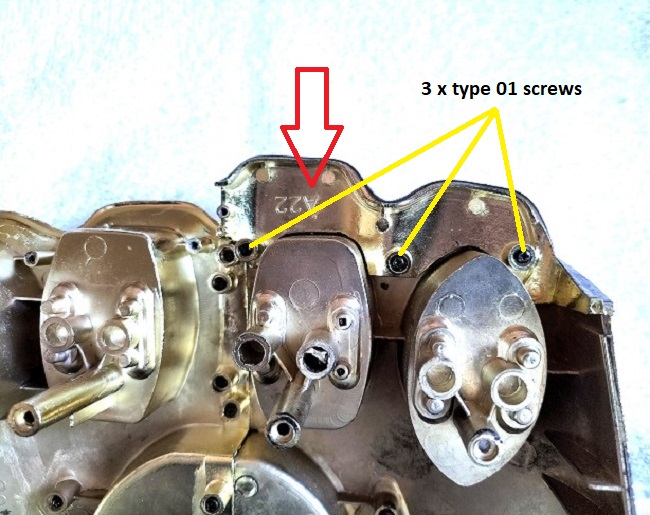

Position part A22 as indicated and fix it in place using 3 x type 01 screws. Pic 2.

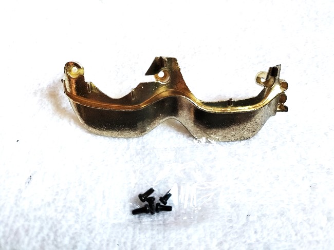

Pic 3 shows the stones replaced as this is the end of this update, but if you are going straight on to issue 21, then leave them out until the end of issue 21.

Issue 21 parts are shown in Pic 1.
Bring the final assembly back from the last update and if you replaced the stones, remove them again to save causing any damage.

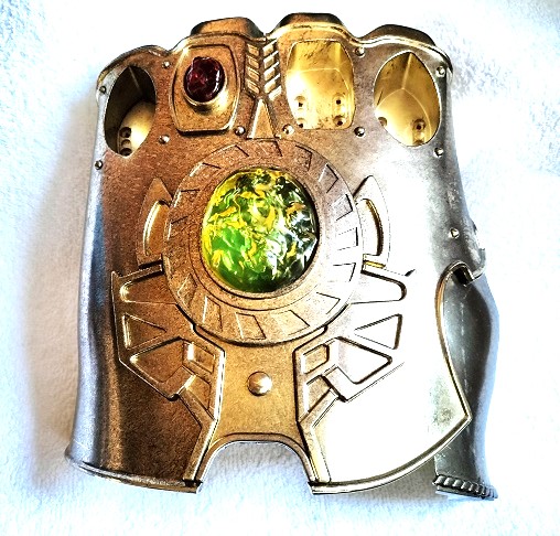

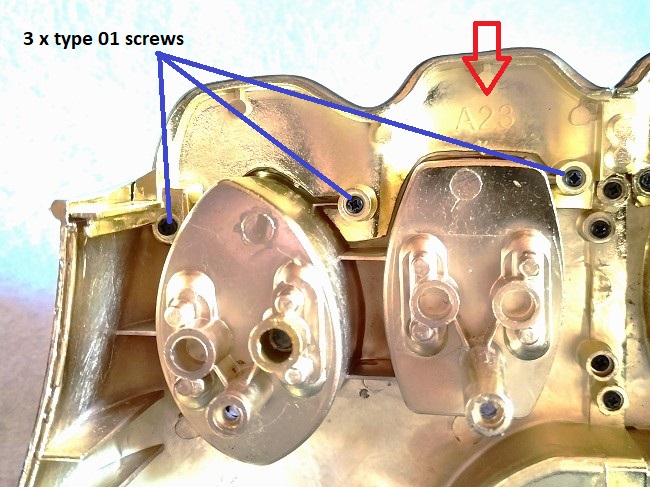

Working on the inside of the previous assembly, fit and secure part A23 with 3 x type 01 screws. Pic 2.
Pic 3 shows the outside of the Gauntlet with the stones replaced and Pic 4 shows how the back of the Gauntlet now looks at the end of this pack.
