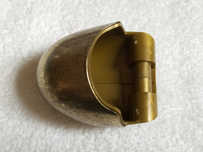

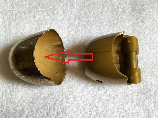

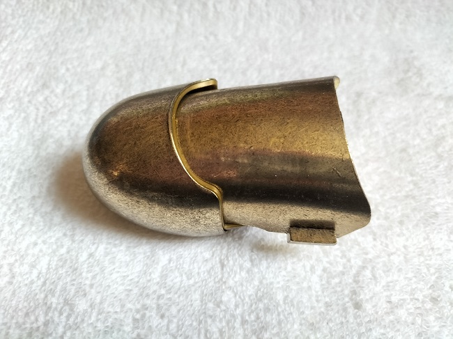

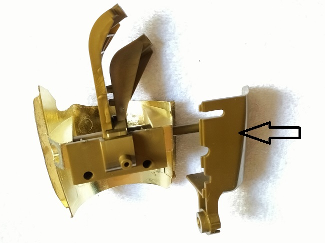

Bring parts (C62 and D20) from the parts of this stage to the table. Check out in Pic 2 how these parts should come together and then see the result in Pic 3.

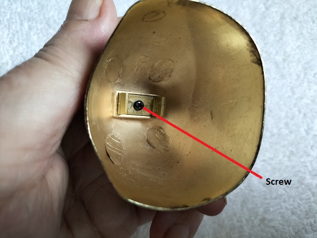

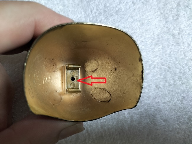

Now bring parts D04 and A68 to the table and position D04 inside A68 as shown in the moulded recess. Pic 4. Then fix part D04 into position using a type 01 screw supplied with this stage. Pic 5.
Position part A68 in line with the end assembly from Issue 11 and then push them together in the direction shown in Pic 6. When the parts click/lock together, they should be the same as that shown in Pic 7.

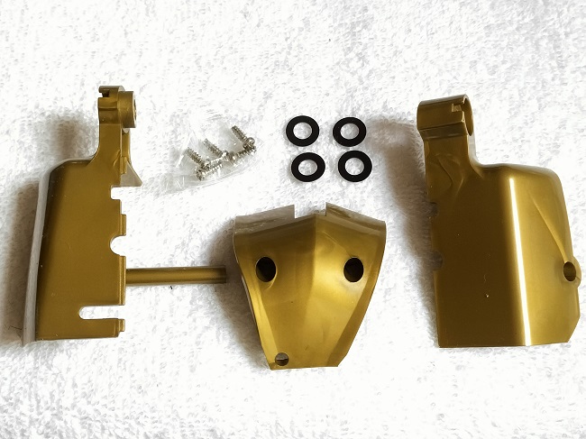

Parts supplied are shown in Pic 1. Note: the screws supplied are of the 02 type (silver).

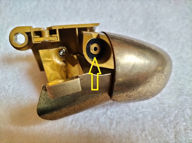

To start you will need the final assembly from Issue 12 (the thumb tip) and part A67 from Issue 11, on your work table. Position the part A67 just inside the thumb tip as shown in Pic 2. At this point these parts are not fixed together, so exercise care if you have to move them about.

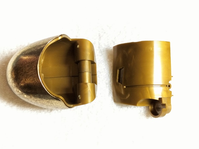

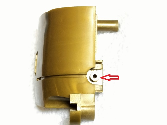

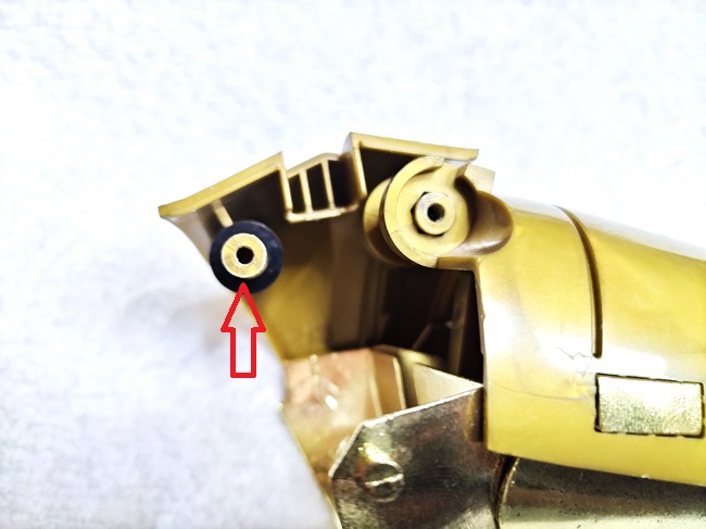

Now position one of the black washers supplied into the side of the thumb tip as indicated in Pic 3. Bring part C62 that has part D20 positioned inside it (from Issue 12) to the table. Push the internal post of part C62 through the hole where you just placed the washer, making sure that the lug fits into the hole as circled in Pic 4. The inside of your assembly should be the same as in Pic 5.

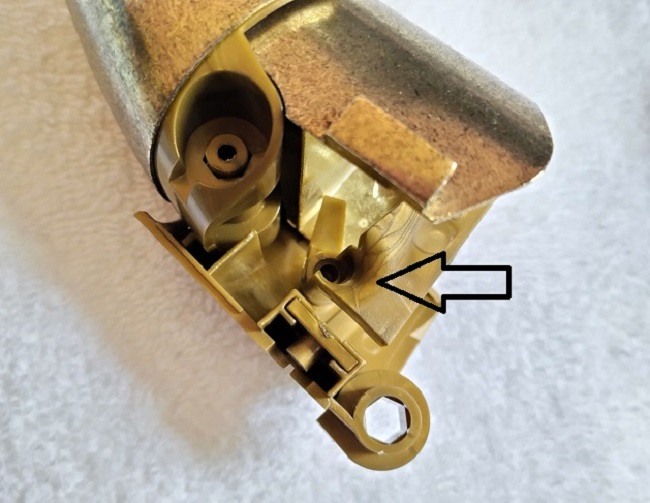

Next part to add is D19. This part fits onto a locating pin and can only fit in one position. Pic 6. Then fix it in place using a type 02 screw. Pic 7.

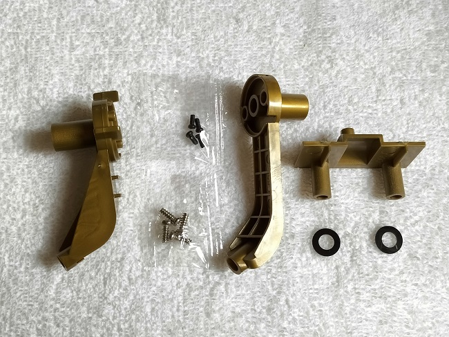

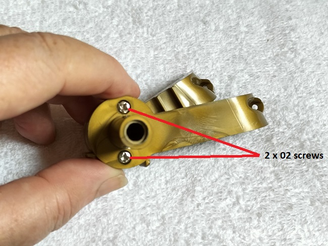

Start by positioning parts C 65 and C67 as shown in Pic 2 and connect the parts together using two type 2 screws (silver) as in Pic 3.

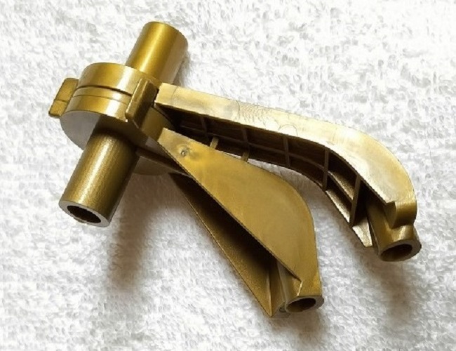

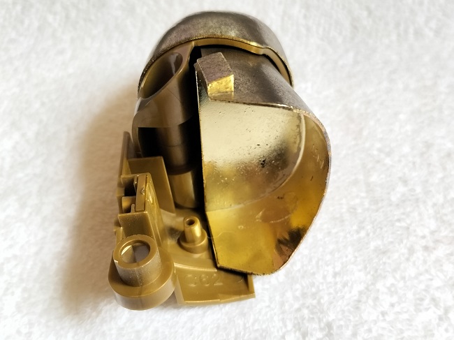

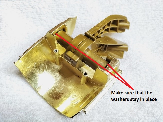

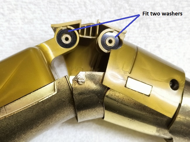

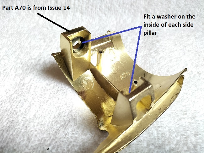

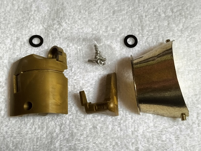

You now need to recover part A70 from Issue 14 and place the two washers (supplied in this issue), on the inside of the pillars of part A70 as in Pic 4. The next step can be a little fiddley, so take care not to damage the washers you just put in place. Position the assembly from the start of this update, in between the pillars of part A70, making sure that the washers stay in situ. Pic 5.
Now, whilst maintaining the position of the parts you just assembled, place part C66 on top so it holds the internal elements in place and locates onto the two pillars of part A70. The alignment of the parts is shown in Pic 6. Finally secure the parts together using two type 1 screws (black) Pic 7.

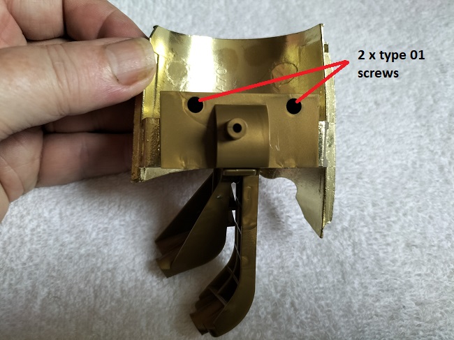

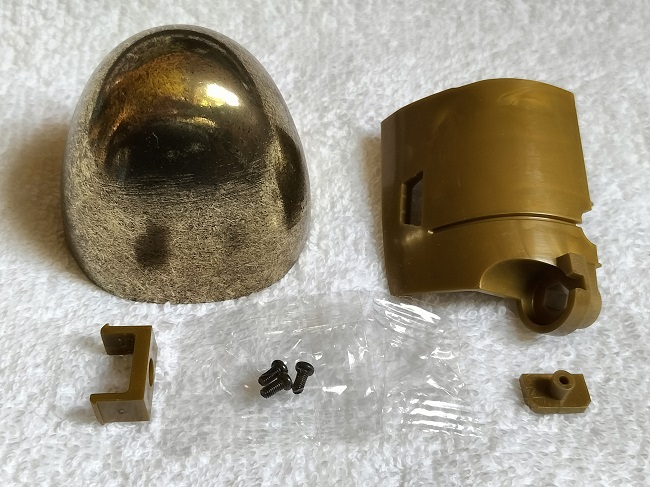

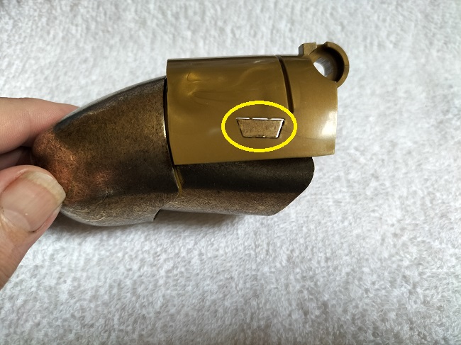

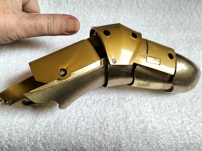

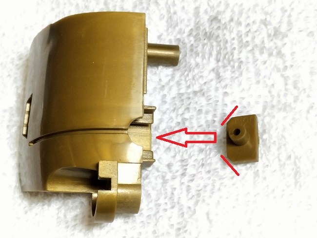

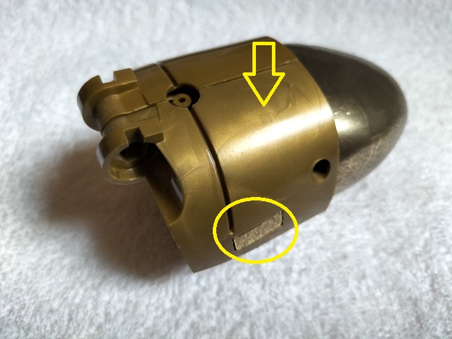

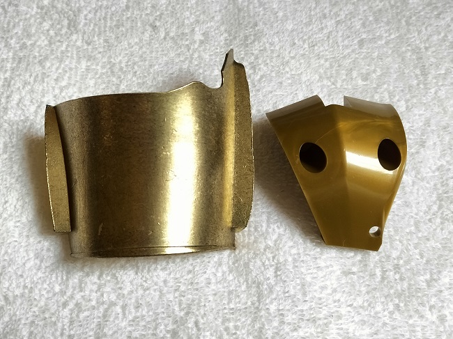

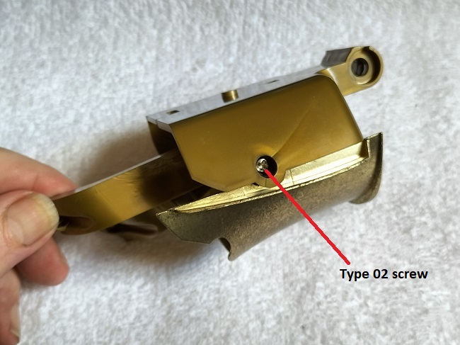

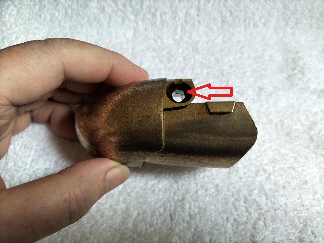

To make a start, bring the assembly from the end of issue 15 back to the table, along with part C68. Position the parts as shown in Pic 2 and feed the inner post on the inside of part C68 through the assembly from issue 15. When the part is fully inserted it should match Pic 3. Now bring the part C70 in from the opposite side until C68 and C70 meet together flush. Pic 4. Complete this assembly by fixing it together with an 02 type (silver) screw. Pic 5.

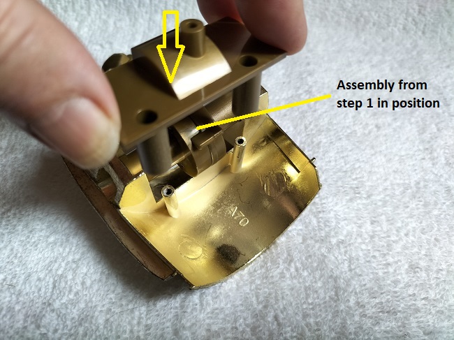

The next task is to bring the two halves of the thumb together.

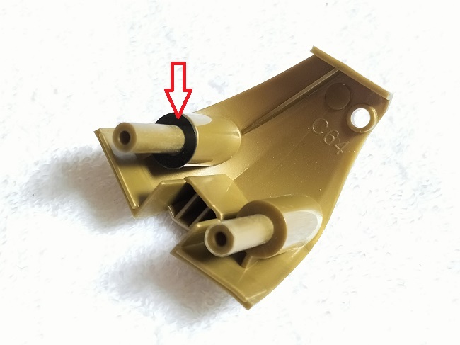

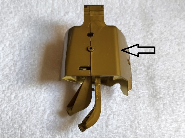

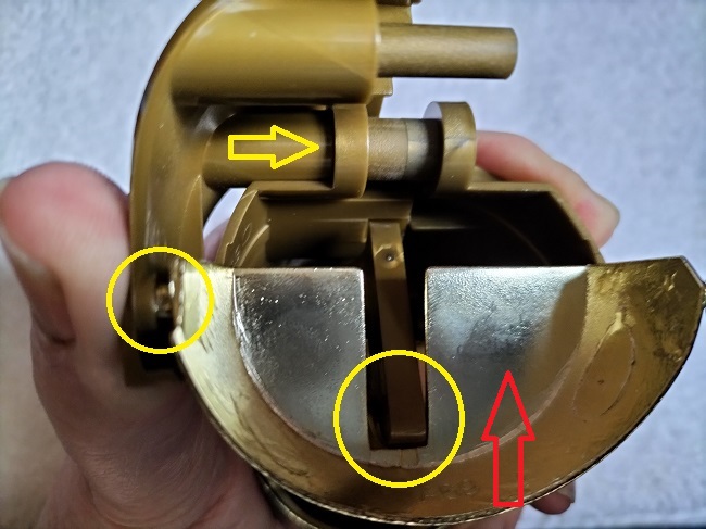

Place one of the washers (this issue) onto the post of part C64 (issue 14) as shown in Pic 6. Then bring the thumb tip assembly from Issue 12 and pass the post with the washer on (C64) through the thumb tip assembly as indicated by the YELLOW arrow in Pic 7, (but before it is fully inserted),introduce part A69 into the bottom of the thumb (indicated by the RED arrow) Pic 7. NOTE: the pin on A69 will locate into the small hole in C64. If the parts are in the correct orientation then your assembly should be the same as Pic 7 with the Yellow circles indicating the correct positioning.
If you are happy with the positioning of the previous parts, place the second washer onto the other post of part C64 as indicated in Pic 8.

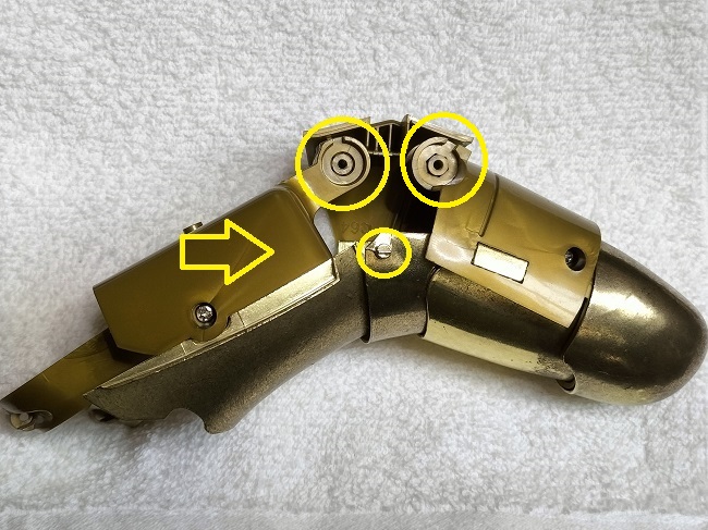

I found this next step was more easily accomplished by laying the two thumb assemblies onto a nice soft towel. Position the lower section of the thumb onto the tip section, where you just placed the washer and swing the lower section inside of the tip. Your assembly should now be the same as that shown in Pic 9. Please pay attention to the three points circled in YELLOW as this is where the next main part will be added.
