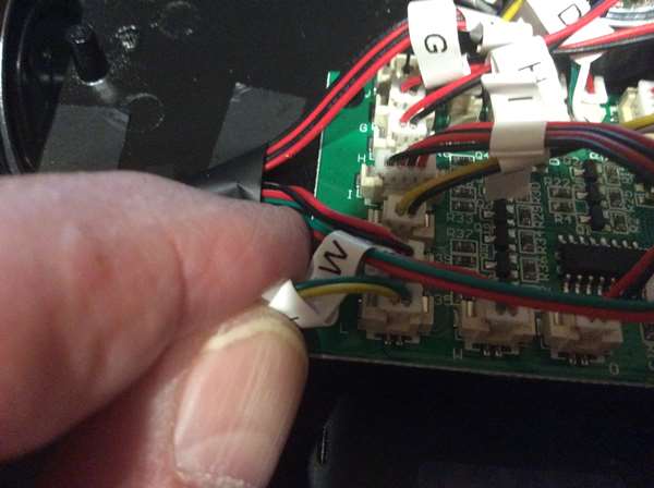

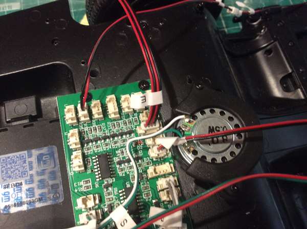

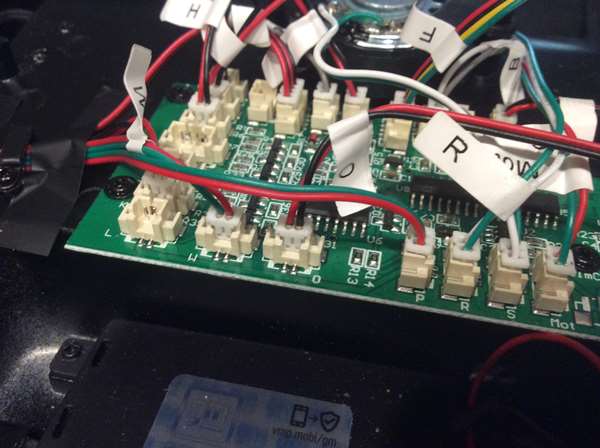

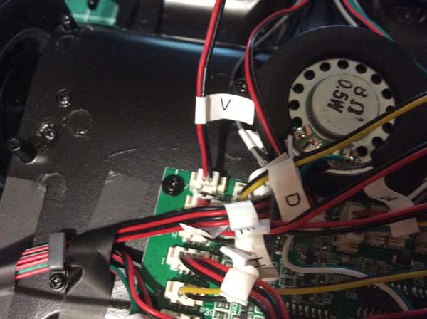

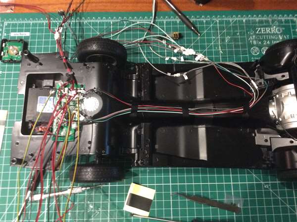

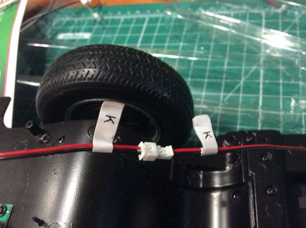

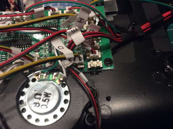

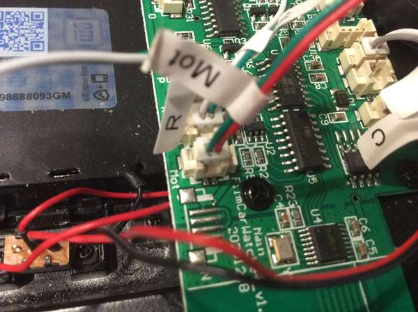

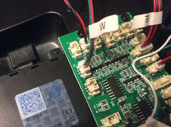

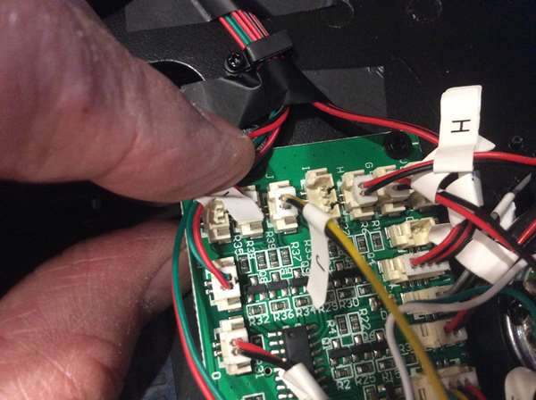

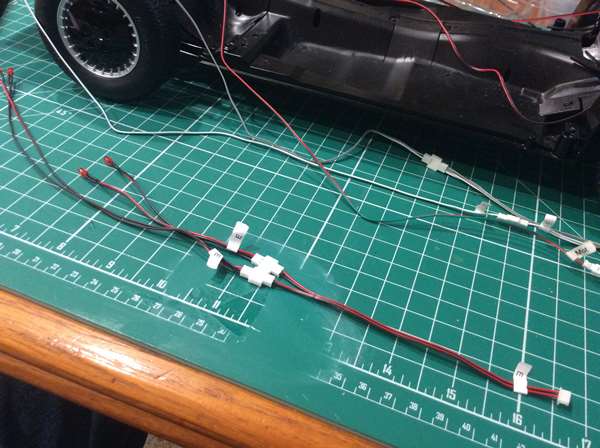

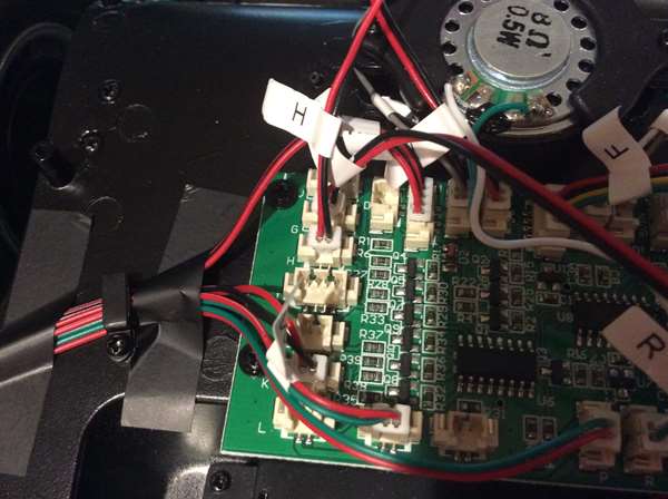

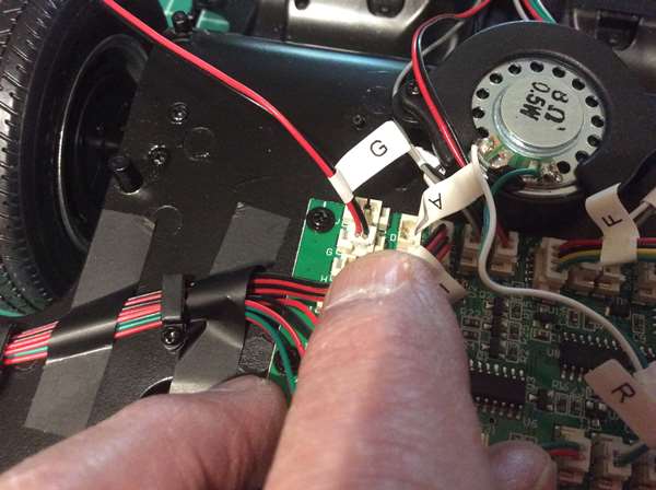

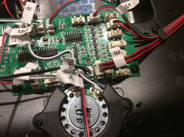

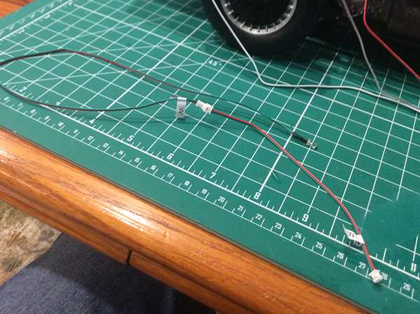

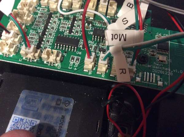

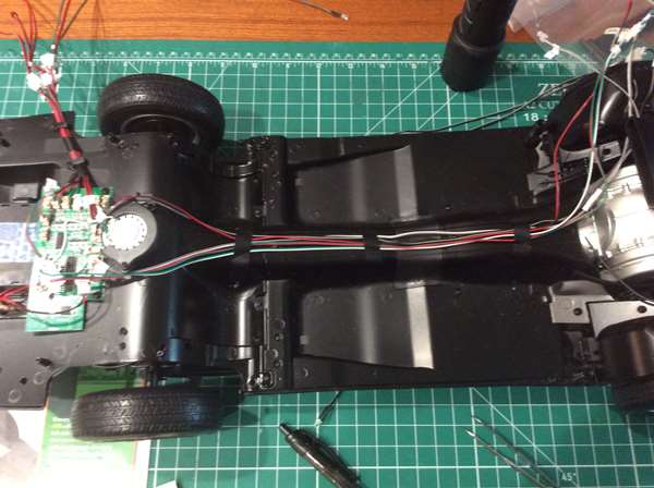

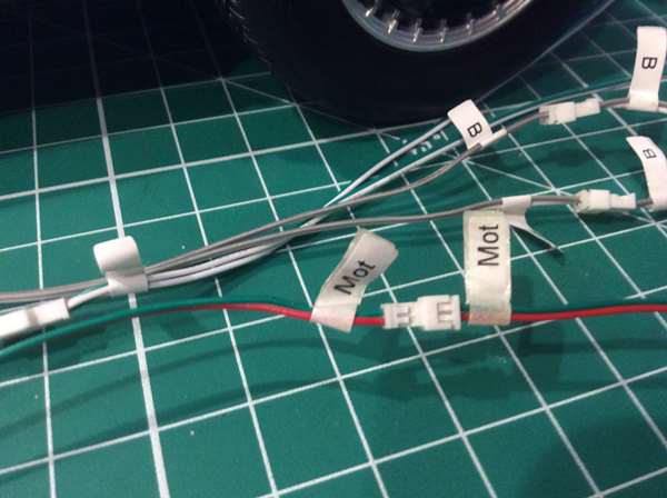

Issue 43 Wiring lights and other systems
The build guide is very confusing, trying to match wire photos by part numbers and letters to the guide steps. I matched all the wire letters, put the wires together, then followed the guide. Only had one end at this point that I had to work with. From the guide (and photos I took), plug each wire into it’s corresponding slot on the circuit board. I hope this makes it easier than trying to match part numbers to the guide, I never could tell the difference between wires from the photos.
Issue 44 More wires
I used the same method as Issue 43.
Issue 45 Con link wristband and wire testing
Fortunately the build guides for 45 and 46, assembly of the wristband are straight forward. The watch face placed into the case is a very tight installation. My thumbnails came in handy. You’ll need to get all 5 batteries (Ii had to make a trip to the drug store to get the wristband battery). Make sure the batteries are installed correctly, test the lights and sound as described in the guide.
Issue 46 Finishing the com link wristband
The only challenge I had in this Issue was getting the watch strap buckle,46A, onto the Bar,46C. It is a standard watch strap pin. Never easy. Box 11 is complete .
experten attached the following image(s):

more pics

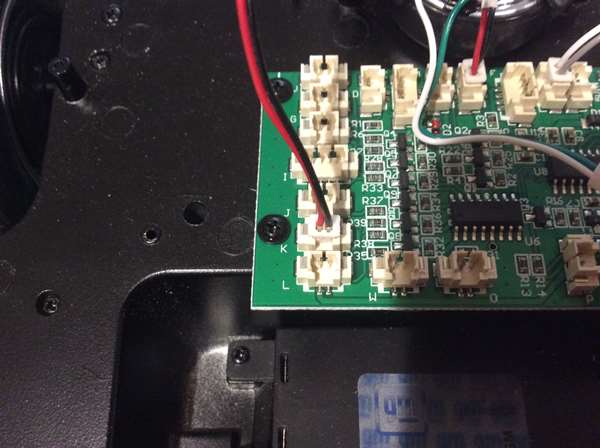

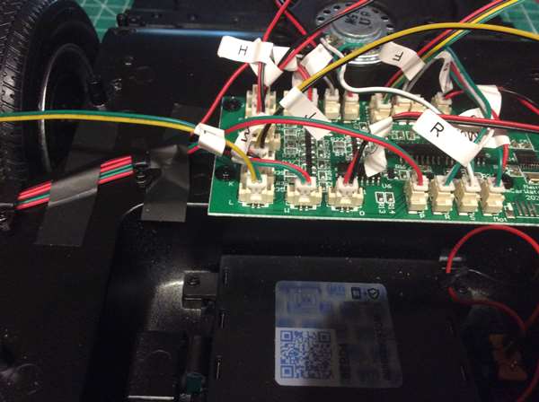

Last pics
