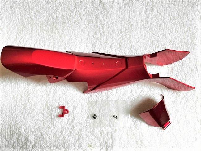

To keep the parts safe and clean until they are used at a later stage, I returned them back to the protective plastic they came in. Pic 4.

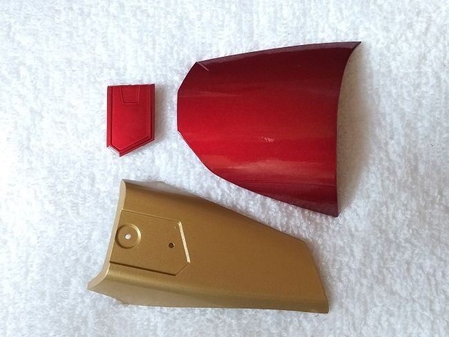

Parts supplied are shown in Pic 1.

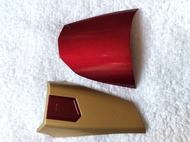

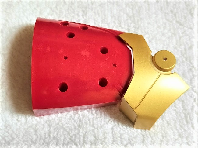

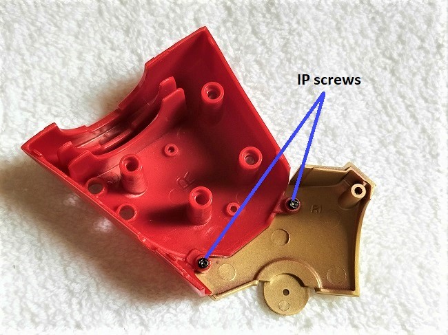

To start this issue, bring the Inner Thigh Plate and Interior Thigh Structure to your work space and position them as shown in Pic 2.

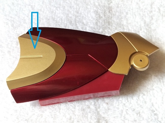

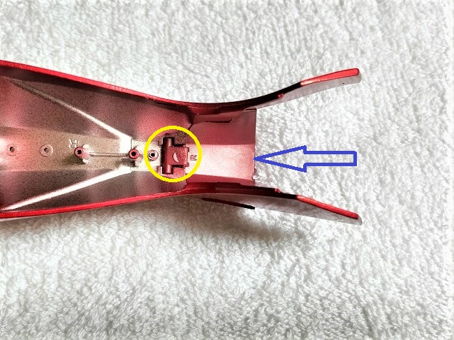

Then, holding the two parts in place turn them over and fix them together with two IP screws. Pic 3. Please Note: tighten the screws tight enough so that the two parts do not move independently of each other, but be careful not to over tighten and strip the threads you make.

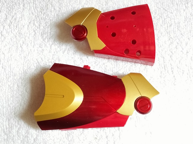

Taking cap (R1) press it into place on the construction from the previous stage, (shown in Pic 4) whilst noting that the part will only engage in one position.

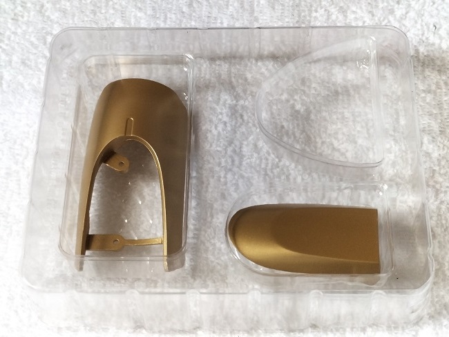

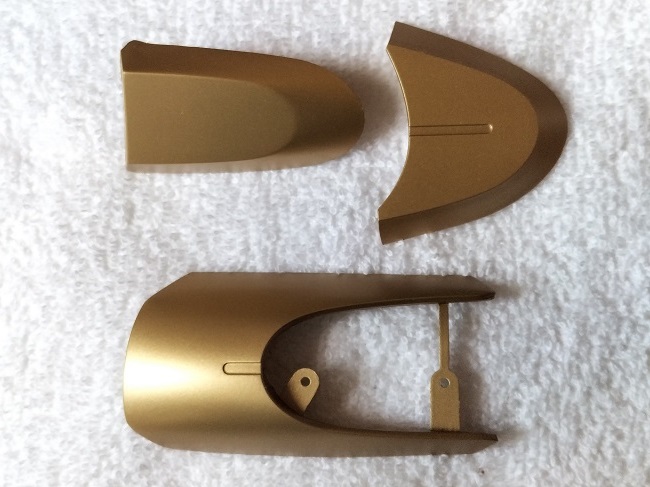

You now need to bring the sub - assembly from issue 53 (that you worked on in the last update) and press the Thigh Cap (R2) into position as shown in Pic 5. This will also fit in only one orientation.

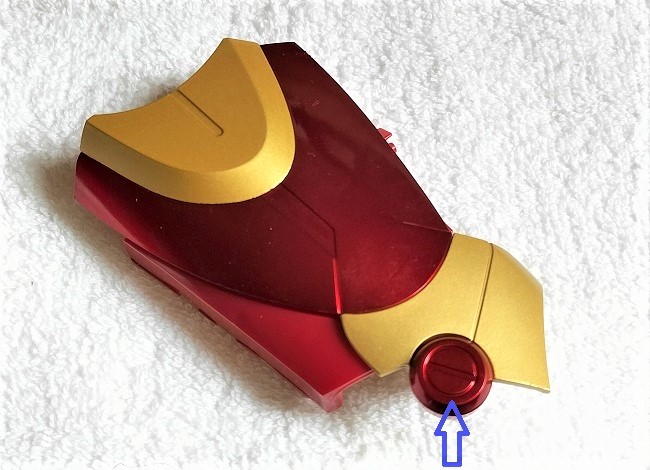

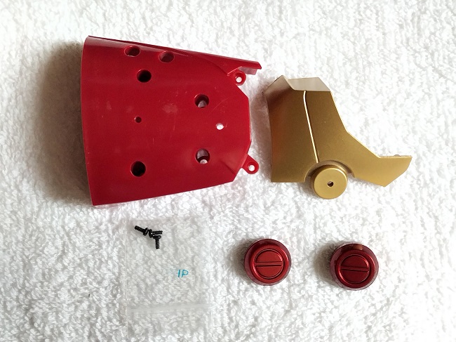

That`s it for this update, Pic 6.

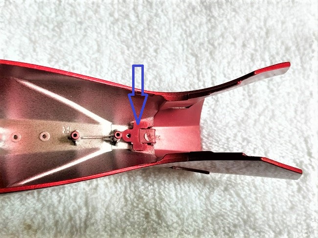

From the parts supplied with this issue, bring the shin guard and instep protector to your work place. With both parts having the insides facing upwards, slide the instep guard under the lower end of the shin guard and locate the hinge pin of the instep guard into position as indicated by the yellow circle in Pic 2.

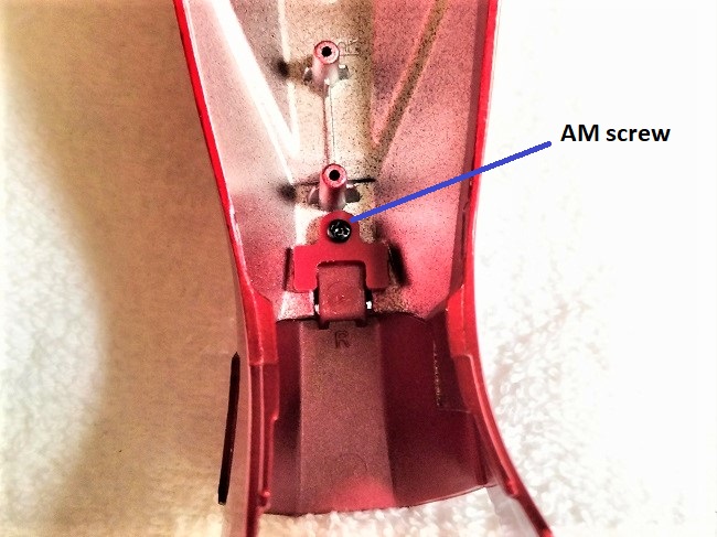

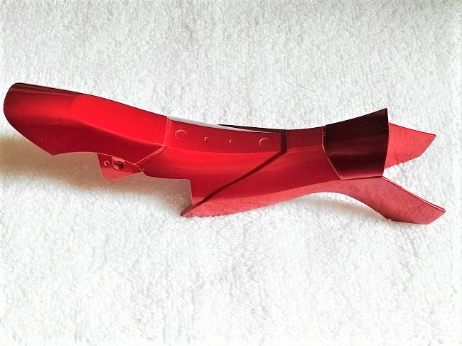

Next position the hinge support over the hinge pin of the instep guard. Pic 3. Then fix the hinge support in place using an AM screw. Pic 4. NOTE: Be careful not to over tighten the AM screw or you will strip the thread and it will not tighten and hold the instep guard in place.

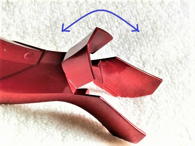

Check the movement of the instep guard as indicated in Pic 5.
That completes this issue, see Pic 6 and this pack. So see you all soon for the next updates with Issues 59 - 62 of the next pack.
